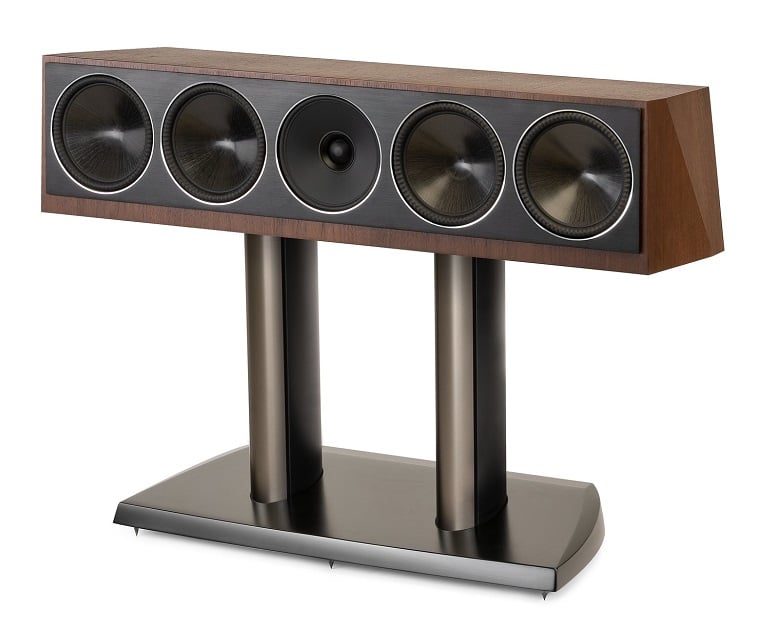

One
interesting design decision carried over from the Premier series is the use of
passive radiators as the outer transducers in the Founder Series center
speaker. This is nifty in two ways: it keeps the spacing of the
higher-frequency transducers at a closer distance thereby reducing off-axis
interference that comes with aligning drivers horizontally, and it also removes
the need for rear-mounted ports for lower bass. One problem with rear-ported
center speakers is that the ports can have a drastic acoustical load on the
rear walls or cavity which creates a bass boost that can obscure dialogue and
speech intelligibility. However, it’s not easy to place the ports anywhere else
without the speaker looking weird. Front-firing passive radiators will not
create as much acoustic loading in typical center speaker placements. They also
make the speaker look nicer than if they were front-firing ports, and they
allow the speaker to have a lower internal volume than if ports were used, so
the speaker is not as deep. It was a clever design move by Paradigm for the
Premiers, and I am glad to see it carried over in the Founder Series.

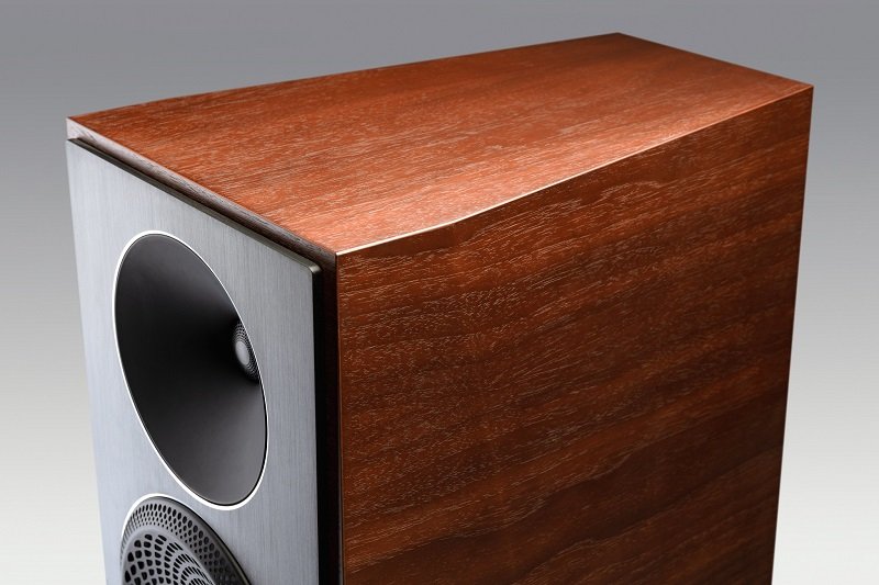

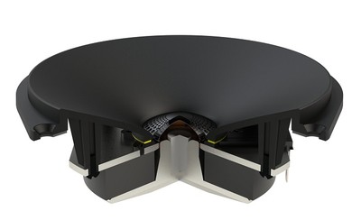

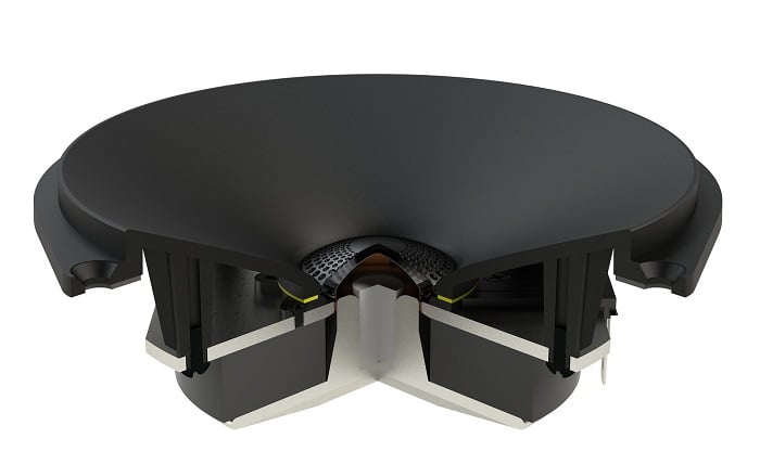

Looking at some of the things that are new and unfamiliar for Paradigm, there are the “CARBON X” bass drivers (yes, it’s all capitalized). This is the cone that is made from carbon fiber infused with minerals that Paradigm claims make for a very stiff and strong material. Maybe it is very stiff, but the name is a bit over-the-top. I think if I were an eccentric industrialist who married an art-house pop singer, we might have named our child CARBON X. Kidding aside, for whatever merits this material has as a bass driver cone, it does look pretty cool. Another diaphragm material change occurs in the tweeter and midrange driver. In the past, Paradigm had been pretty insistent on using aluminum tweeters and even termed their pure aluminum diaphragms the X-PAL drivers. In the Founder Series, Paradigm has thrown Magnesium into the mix for the tweeter and midrange drivers which they claim make them lighter and stronger. The tweeter uses a mix of aluminum, magnesium, and ceramic that Paradigm calls AL-MAC. The ceramic probably just comes from anodizing the aluminum which creates a thin layer of ceramic on the surface. The midrange cone doesn’t have any ceramic so Paradigm calls it the AL-MAG driver. It’s interesting to see Paradigm departing from pure aluminum, and I don’t think they would have done it if it didn’t result in some improvements.
One aspect of speaker design that Paradigm is paying more attention to in the Founder Series is the use of waveguides. Paradigm calls their new waveguide design the Oblate Spheroid Waveguide (OSW). Hardcore speaker nerds will recognize that name as the same as Earl Geddes’ waveguide design. Earl Geddes is rightfully considered one of the world’s foremost experts in waveguide design, so to draw upon his extremely deep and complex research into this area indicates that Paradigm is very serious about producing a top-notch high performing loudspeaker. When I noticed that the Founder speakers used what they called an oblate spheroid waveguide as I was going over the specs, I did a double-take, because many loudspeaker manufacturers don’t take that deep of a dive into waveguides unless they are designing loudspeakers for professional applications. Paradigm reports that using Geddes' research was only part of the development of their waveguide; for example, Geddes designed around compression drivers, whereas Paradigm was using dome tweeters. Indeed, the shape of their waveguide isn’t the same as Geddes’ waveguide. However, the goal of controlled directivity is surely the same. Measurements of these speakers will be very interesting to see the effectiveness of these waveguides.
Another
dramatic new design move in the Founder Series from Paradigm is the use of
coaxial drivers, and I don’t recall Paradigm having used them in the past.
Coaxial drivers, sometimes also called concentric drivers, are where a
higher-frequency driver is mounted in the middle of the cone of a lower
frequency driver. They are more popular in the car audio world, but they have
seen some growing popularity in home audio such as in KEF’s Uni-Q coaxial
drivers. In Paradigm’s coaxial driver, they use an AL-MAG tweeter centered in
an AL-MAG midrange cone that is shaped into an oblate spheroid waveguide,
thereby combining three of their innovations into a single drive unit. The
coaxial drivers are only used in the Founder Series center speaker and LCR
speaker, but that is where they are most needed. This allows the center and LCR
to have a full-sized midrange as well as a waveguide-loaded tweeter without
making the speakers impractically sized. It also lets the center speaker be a
true three-way speaker which greatly benefits the off-axis response for a
better sound over a wider area.

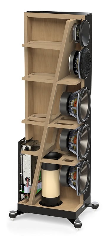

surprising feature of the Founder Series is that the bass section of the
flagship Founder Series speaker is powered. The Founder 120H has three 8” bass
drivers driven by a 1,000-watt amplifier. That should give that speaker a lot
of punch. What is really neat is that the controller has built-in ARC Genesis
room correction, so these speakers can optimize their bass response for room
acoustics without relying on exterior equalization. That is great news for
those who want better bass from a simple two-channel system. The
self-amplification also takes a load off of any outboard amp that would
otherwise be faced with driving three 8” bass drivers. That should make the 120H
easy to drive with pretty much any amplifier. Perhaps the inclusion of a
powered bass section shouldn’t come as a surprise since Paradigm did do this
for the Persona 9H, but that is a much more expensive loudspeaker than the
Founder 120H.

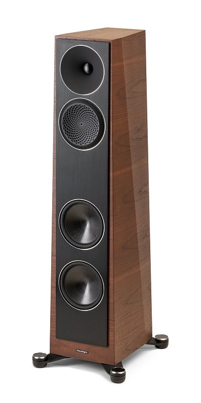

An interesting detail I noted concerns the design of the smaller tower speaker of the Founder Series called the 80F. Unlike the other Founder floor-standing speakers, the 80F is a 2.5-way design instead of a 3-way design, so the midrange driver actually plays bass driver frequencies as well as mids. This is an efficient and economic way to deal with baffle step compensation where some output is lost at lower frequencies which has omnidirectional dispersion as opposed to higher frequencies where output is more directionally restricted. Letting the midrange driver help to shore up lower frequencies makes it easier to achieve a balanced response. It also can make for a more integrated sound between the midrange and bass frequencies which may be a bit more critical for the 80H since there is a good amount of distance between the midrange driver and bass driver. A 2.5-way speaker allows the bass drivers to be mounted lower on the front baffle which is good because it reduces ground bounce reflection which can play havoc on the bass response. I think these simple yet clever engineering decisions will likely make a bigger difference in the sound than many of Paradigm’s trade-marked, all-caps buzz words.

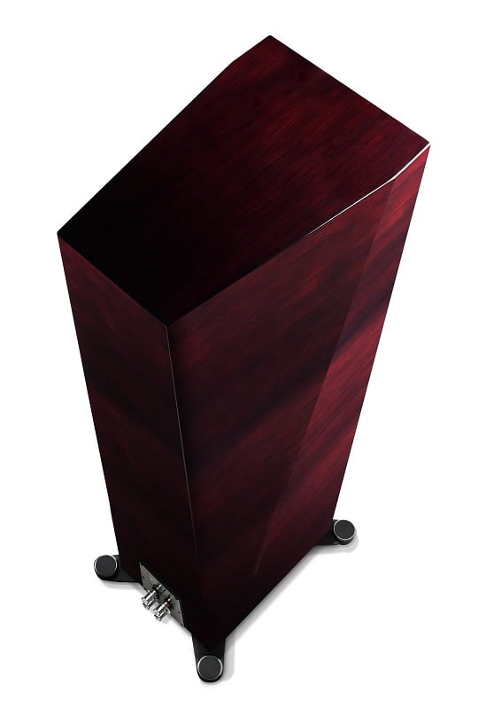

Another smart design efficiency is the use of down-firing ports on the Founder tower speakers. This can help increase port efficiency by using boundary loading to strengthen their output. Since these speakers will always be used on the floor, Paradigm can predict they will always have at least that much loading on the ports and design them accordingly. It can also help to mask port turbulence when the speaker is driven at high levels.
One other interesting feature is the way that Paradigm has arranged the bracing for the Founder Series enclosures. Most loudspeakers only use horizontal bracing, but Paradigm uses a large, tilted vertical brace as well as horizontal bracing. This vertical brace follows a slightly diagonal angular bend in the sidewall for a heavily reinforced irregular shape that should help reduce standing waves in both a horizontal and vertical direction. This vertical brace turns into a solid piece at the top of the cabinet which creates a separate enclosed compartment for the midrange driver to prevent backwave pressure from interfering with its cone. This should make for a much more inert cabinet than traditional bracing methods. As with so many other aspects of their loudspeaker design, Paradigm has a fancy name for it: “Cascade Fusion Bracing.”
