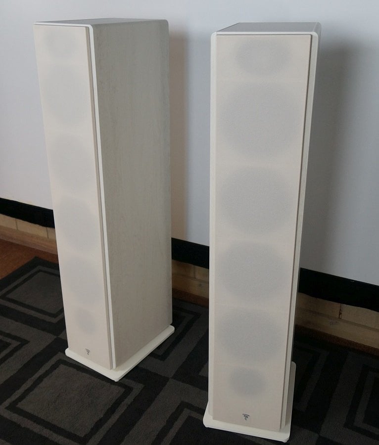

- removable magnetic cloth grille

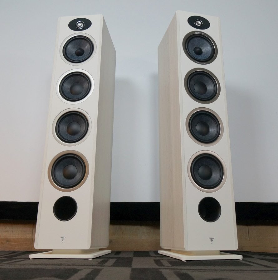

Industrial design has always been a strong point of Focal, and the Vestia No.3 does not depart from that tradition. The pair I received came in the ‘light wood’ finish which has a bleached white wood vinyl imitation on the side panels and rear panel, and a white leather-esque finish on the front and top panels. I have seen this leather-type finish before on a few speakers, and I like it. It is durable and does not show fingerprints easily, but it also gives the speaker a nice soft appearance with a sheen somewhere between matte and satin. The horizontal side edges have been rounded for a sleeker effect as well. The white sets off the black surrounds and blue fiber of the cones. The cones can be hidden by a white fabric grille for a more uniform appearance for those who want the speakers to stand out less in-room. The grille uses magnetic adhesion, so there are no grille guides, and this makes for a cleaner front baffle. The speakers are mounted on a white aluminum base which gives them a slight backward tilt for an added touch of style. The Vestia No.3s can also be had in gloss black and dark wood finishes, and while I am sure they look quite nice, this white would be my choice, especially in brightly colored rooms.

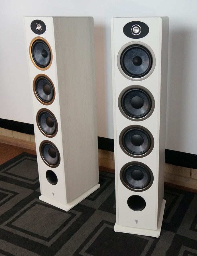

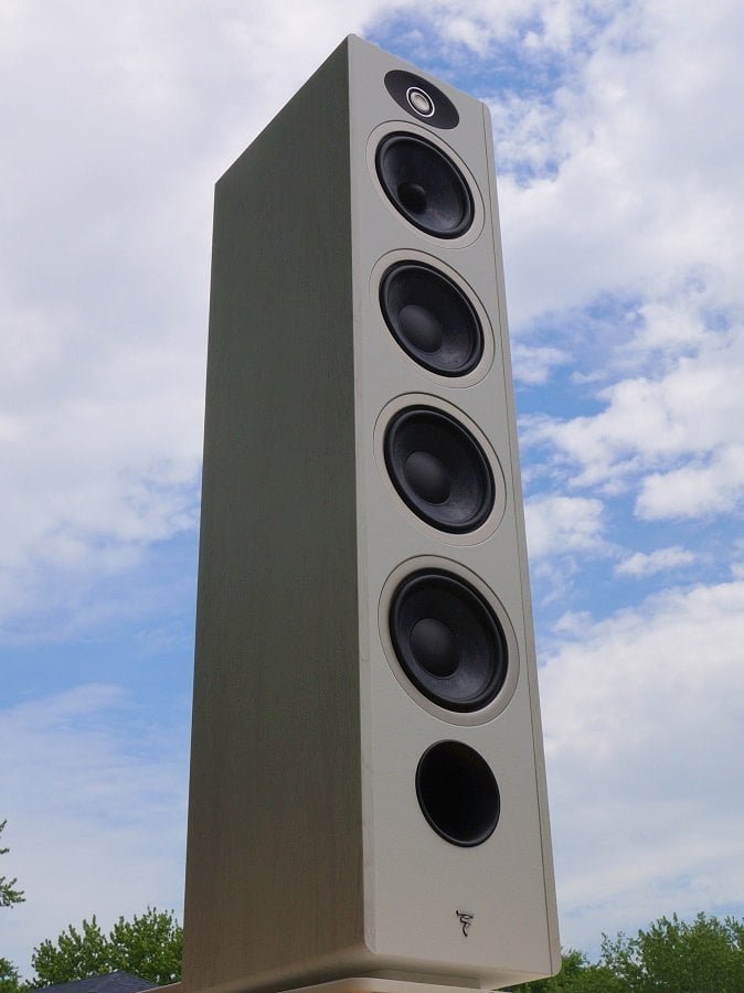

The base description of the Vestia No.3 is a three-way, ported tower speaker, but, of course, there is a lot of technical depth to them on top of that. Let’s start our design analysis at the top with the tweeter. As always Focal uses an inverted 1” dome tweeter, and they call this one the ‘TAM’ tweeter. It’s a mixture of aluminum and magnesium: aluminum for its stiffness and magnesium for its damping properties. The tweeter has an M-shaped profile and was originally developed for car audio but has been redesigned for hi-fi applications for the Vestia line. The M-shape profile helps to stave off high-frequency bending modes, and Focal specs the speaker to play up to 30kHz within a +/-3dB window. The TAM tweeter is mounted in a shallow urethane waveguide to induce a wider horizontal dispersion and narrower vertical dispersion.

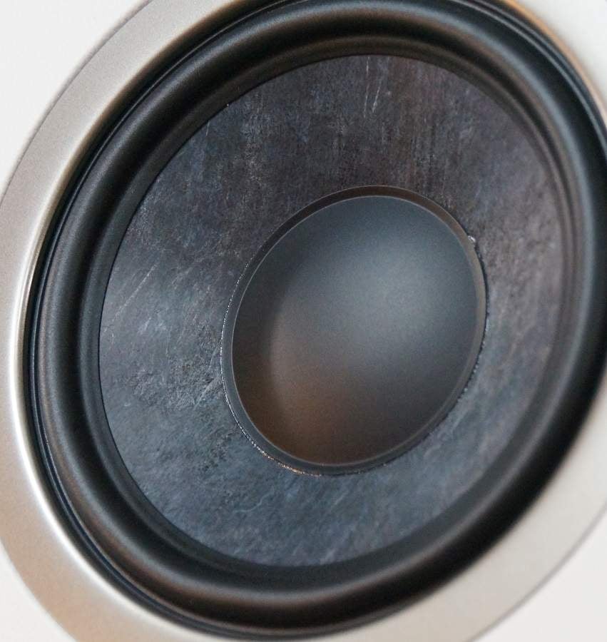

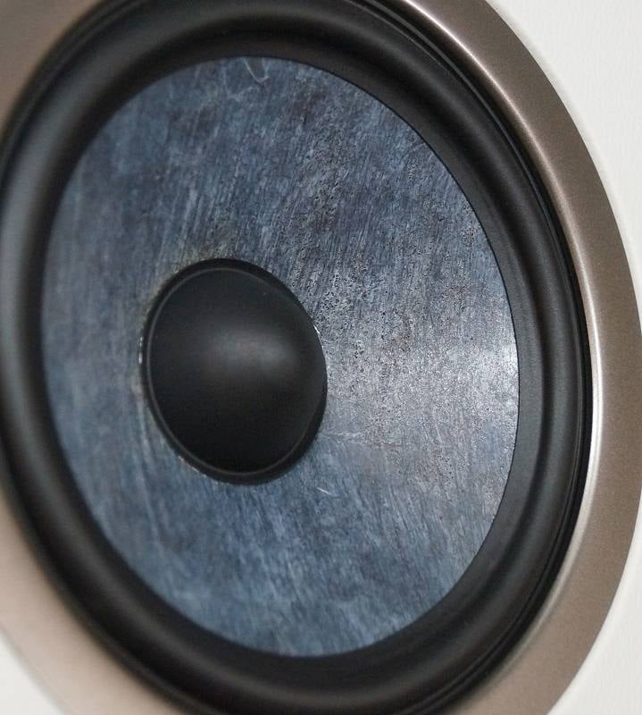

Beneath the tweeter, we have a 6.5” midrange woofer made out of Slatefiber. Focal uses Slatefiber in a number of other products including their professional studio monitors. The Slatefiber cone is made from non-woven carbon fibers that have been spun so that all the fibers are oriented in the same direction. Focal has found that woven carbon fiber doesn’t damp the cones as much but that aligning the fiber pattern offers better stiffness than cones without a direction orientation. The fibers are impregnated with a thermoplastic polymer for added stiffness and damping.
Beneath the midrange woofer, we have three 6.5” Slatefiber bass drivers. Three 6.5” woofers have about the same surface area as an 11” woofer, so they should be able to move a lot of air, and I expect this speaker to be potent in bass frequencies. One benefit to having three bass drivers is that it can help mitigate ‘ground bounce’ interference. Ground bounce is when an acoustic reflection off the floor interferes with the direct sound from the speaker and causes cancellation nulls and constructive peaks in the frequency response at the listening position. It mostly affects mid-bass frequency ranges, but by having three bass drivers, the wide spread of low-frequency emission should help to diminish the interference by adding more reflection distance points, thereby randomizing out specific nulls and peaks.
The tweeter/midrange crossover frequency is 3.1kHz, and that is fairly high for a 6.5” woofer. A 6.5” cone is large for a midrange, and I wouldn’t be surprised if we see a narrowing of directivity before we hit the tweeter’s bandwidth. Hopefully, Focal has taken measures to ensure it is not severe. The advantage of such a large midrange is that it can have a lot of dynamic range in its bandwidth, much more than the tweeter in the lower treble range, so the tweeter should be kept well away from any distortion. The midrange crosses over into the bass drivers at 280Hz, and that is a pretty sensible frequency. Such a large midrange should have enough displacement to handle that low frequency, and allocating such a wide frequency band to the midrange keeps potential phase anomalies at the edges of the most important frequency range.

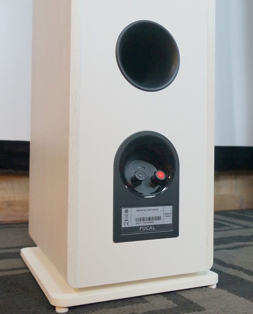

One unusual design feature of the Vestia No.3 is that it has ports on both the front and back of the speaker. The ports have the same 2.75” diameter, but they have different lengths with the front port being 4.75” long and the rear port being 6.25” long. The different lengths will give them different tuning frequencies, so the port output of this speaker will have a wider band than typical ported loudspeakers. Focal smartly placed the shallower port on the front since it will be less prone to turbulence effects, i.e., ‘port chuffing.’ The rear port will play deeper bass frequencies, and mounting it in the rear can help it load any rear surface boundaries to boost deeper bass. Also, chuffing noises are much more difficult to hear when the port is not facing the listener directly, so rear mounting the deeper port will better hide chuffing.
The enclosure is made from MDF, and a knock test indicates a thicker front baffle than side panels. The front panel feels solid, but the side panels do resonate a bit more if tapped in the right area. The grille uses acoustically transparent fabric draped over a plastic frame, and it attaches to the front baffle by way of magnetic adhesion. The grille frame isn’t tremendously thick, but it will still be a source of edge diffraction, so for the highest performance, leave the grille off, although the audible difference might only be tiny. There is only one set of 5-way binding posts, so the Vestia No.3s can not be bi-amped or bi-wired, and I regard this as a good thing. The ability to bi-amp or bi-wire is often a source of confusion and mistakes that negates any benefits it can bring. I am glad that Focal is not kowtowing toward needless audiophile feature checklists on this count.

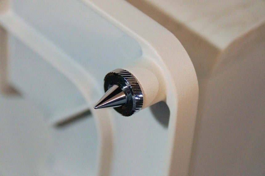

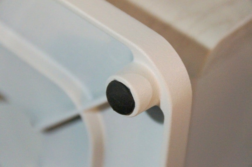

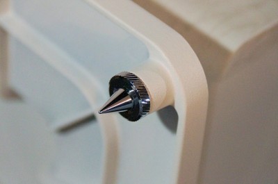

Unfortunately, one audiophile checklist feature that Focal does include is spiked feet. These are fairly pointy spikes that are good for planting the speakers in carpeted flooring, but god have mercy on anyone who accidentally sets the spiked feet speaker on their foot. The audible benefits of spiked feet are very questionable, and it has never been proven that they affect the sound. Focal also supplies some round plastic feet as an alternate, but it’s hard plastic and not really suitable for hardwood flooring, although it wouldn’t damage concrete or rock flooring. I would like to have seen some soft rubber feet that can be placed on hardwood flooring without worry.
The speaker rests on a pretty solid aluminum base that gives it a slight backward lean. Focal claims that the tilt is for ‘time alignment,’ since the acoustic centers of the woofers will be further back than the tweeter, but the audible consequence of this effect is likely nil. Rather, I think this is done for aesthetics, and I would say it is worth it because it does look cooler with a backward lean.
The sum of all this design looks to be a good-looking and competently designed loudspeaker which is par for the course for Focal. Let’s now see how it all adds up in some real-world listening…

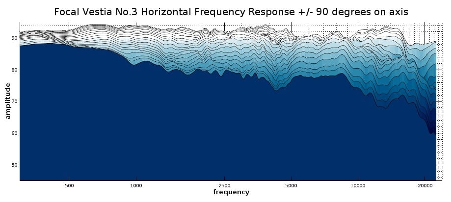

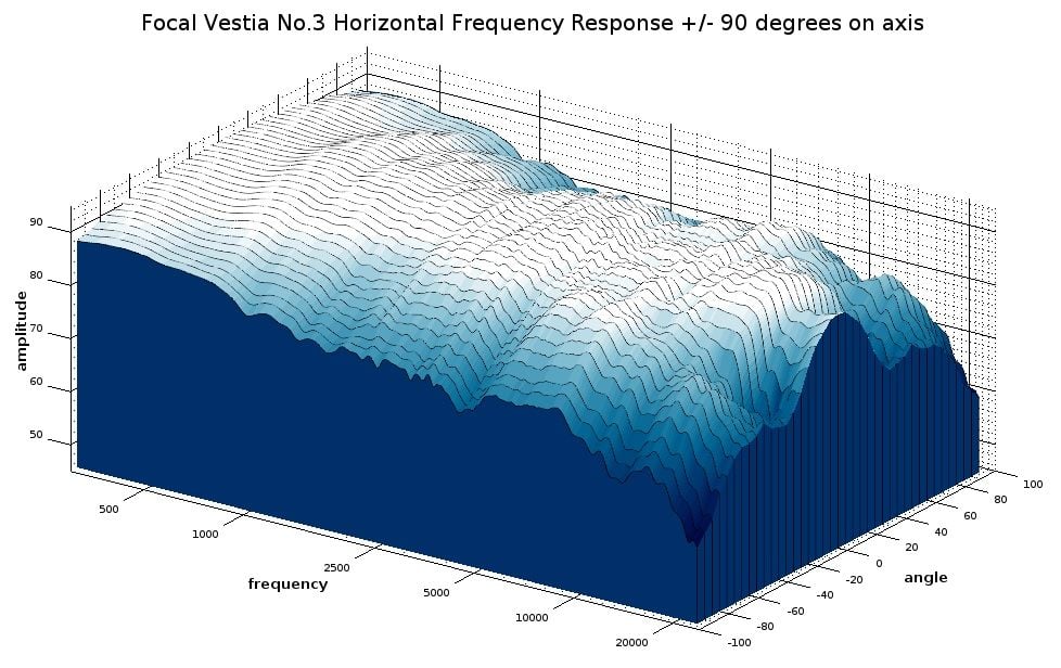

The Focal Vestia No.3 speakers were measured in free-air at a height of 4 feet at a 2-meter distance from the microphone, with the microphone raised to an 8’ elevation that was level with and aimed at the tweeter center. The measurements were gated at 8 milliseconds. In this time window, some resolution is lost below 400 Hz and accuracy is completely lost below 200 Hz. Measurements have been smoothed at a 1/24 octave resolution.

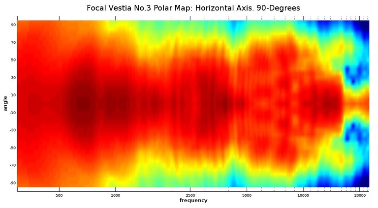

The above graphs depict Vestia No.3’s direct-axis and horizontal dispersion out to a 90-degree angle in five-degree increments. Information on how to interpret these graphs can be read in our article: Understanding Loudspeaker Measurements Part II. The measured response is generally good, but there are some peculiarities, although nothing seriously wrong. On-axis, we have a nicely flat response out to 5kHz, but then we run into a slight dip from that point up to 10kHz. That should make this speaker a bit soft on sibilants or any word that has a hissing sound such as common pronunciations of ‘s,’ ‘t,’ ‘ch,’ and ‘sh.’ I don’t mind that this range is a tad recessed personally, and it is much better to be soft here than elevated where the speaker over-emphasizes sibilants. The off-axis responses do not exhibit this recession, so if you want more enunciation in that range, just use a mild toe-in or no toe-in when angling the speaker. The most neutral response occurs at around 10 to 15 degrees, so a mild toe-in should yield the most tonally balanced sound. Another detail to note is that the response above 15kHz plunges, especially at off-axis angles. Those who want very high treble will want to be listening dead on-axis with the Vestia No.3s. I don’t regard lessened treble in this region as a big deal, since many listeners have very insensitive hearing in this range, and not much content has any significant energy in this range anyway.

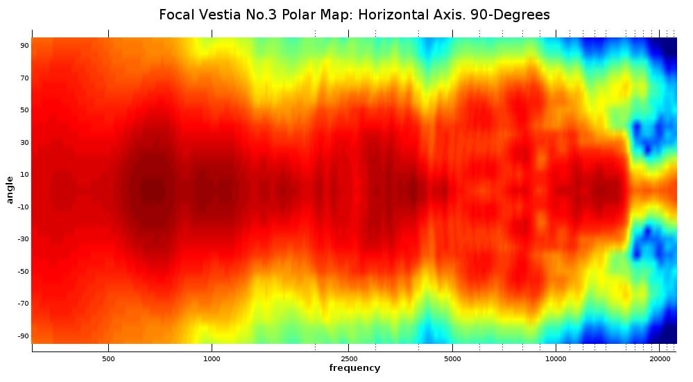

The above polar map shows the same information in the preceding graphs but depicts it in a way that can offer new insight regarding these speakers’ behavior. Instead of using individual raised lines to illustrate amplitude, polar maps use color to portray amplitude, and this allows the use of a purely angle/frequency axis perspective. The advantage of these graphs is they can let us see broader trends of the speaker’s dispersion behavior more easily. More information about interpreting this graph can be read in our article: Understanding Loudspeaker Measurements Part II.
While the Vestia No.3’s dispersion pattern is not perfect, it is generally quite good. There is some slight waist-banding at around 1.5kHz and 4kHz, but not enough to make any audible difference for anyone listening at any reasonable angle. Any listeners with a 50-degree angle of the on-axis response will be met with a reasonably full sound. The directivity matching between the mid-woofer and tweeter is not perfectly seamless but it is very good. We can see the tweeter start to beam above 10kHz, and, as we saw in the above graphs, its dispersion collapses above 15kHz. The Vestia No.3 has a fairly broad and even dispersion overall, so it won’t need any special acoustic circumstances to sound good. They are designed to sound good in any normal room.

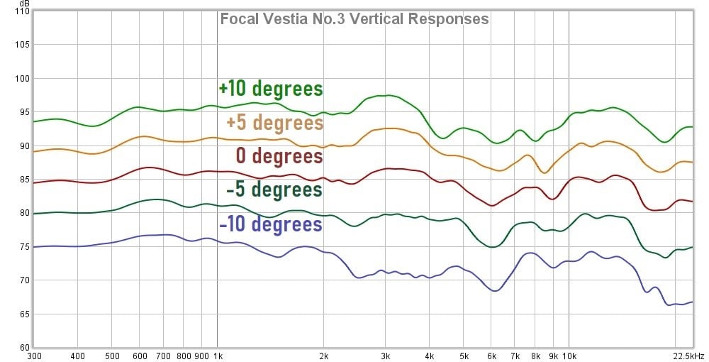

The above graph is a sampling of some of the vertical angle responses at and around the on-axis angle. Negative degrees indicate angles below the tweeter, positive angles indicate angles above the tweeter, and zero degrees is level with the tweeter. The Vestia No.3 loses linearity at angles above the tweeter height, but few people will be listening above the tweeter which sits at a 42” height. The -5 degree angle looks to have the most overall linear response, and that is for the best since that is the height that most users are likely to have their ears at. That will be about the height of the midwoofer or just below it for many listening distances. While the vertical off-axis angles get into some rocky responses, it stays well-controlled where it matters the most.

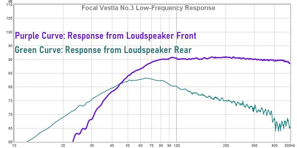

The above graph shows the Vestia No.3’s low-frequency response captured using groundplane measurements (where the speaker and microphone are on the ground at a 2-meter distance in a wide-open area). I decided to include two curves on this graph because a single measurement from the front of the speaker can not fully capture the low-frequency output of the response. The purple curve in the above graph shows the response of the Vestia when measured from the front, but that isn’t exhibiting what the rear port is doing. The green curve is output as measured from the rear of the speaker, and it is mostly acoustic energy coming from the rear port. The response as measured from the front is nicely flat down to 70Hz, and it does decline a bit to 50Hz where it takes the customary 24dB/octave slide downward. However, that wouldn’t account for the rear output which rolls off at a more gradual slope. The Vestia No.3 doesn’t have a lot of deep bass output but it does have some, enough to cover the spectrum of most acoustic music, especially if room gain becomes a significant factor. While they can deliver a pretty full sound, home theater enthusiasts and connoisseurs of electronic bass music will want to add subwoofers.

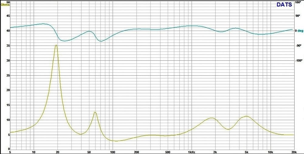

The above graph shows the electrical behavior of the Vestia No.3. Focal specifies it to be nominal 8 ohms, and that would seem to be a stretch. There is a 3-ohm minima at around 100Hz, and all of the mid-bass band hangs under 5 ohms. However, this isn’t an extraordinarily tough load as far as floor-standing speakers go, and most receivers will be able to drive them without problems. We can tell from the dip in the low-frequency saddle that port tuning is about 40Hz, and we can also see from the taller height of the left saddle peak that the resonant frequency of the drivers is much lower than that of the enclosure. There is not much else to note here, and the bottom line is that these speakers will be OK with all but the cheapest amps, not that anyone who can afford these speakers will drive them with really cheap amps.
