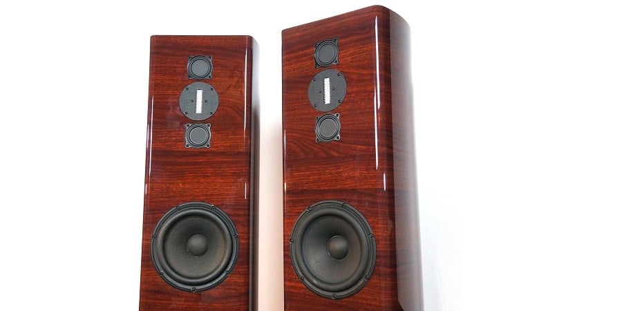

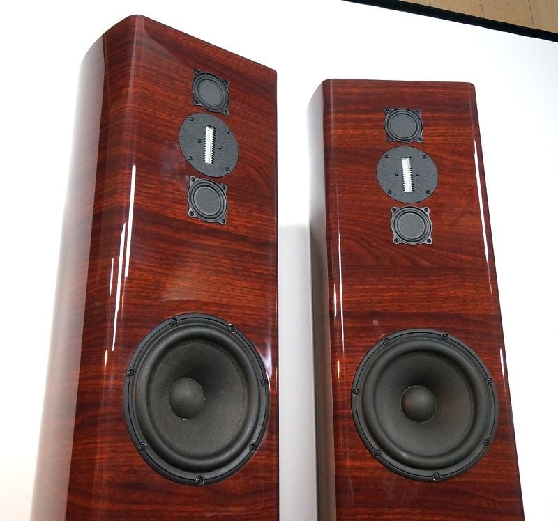

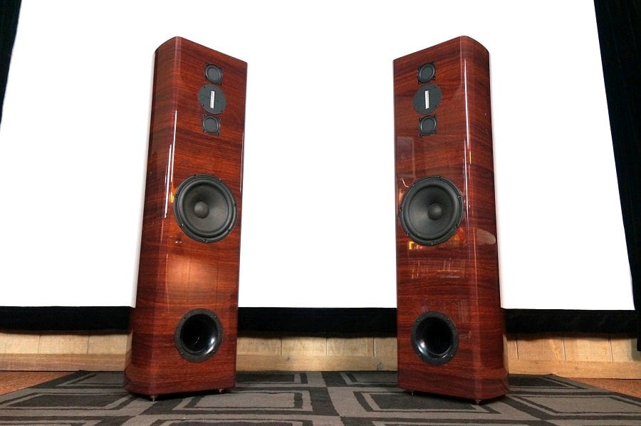

Packing and Appearance

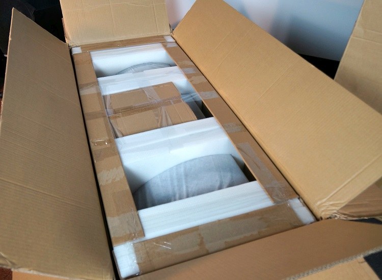

The BMR Towers arrived at my doorstep in two large and heavy boxes. Lifting them was a challenge, and I would encourage buyers to have either a dolly handy to move the packaged speakers or a healthy buddy who can help carry them. They were double-boxed with thick edge protectors lining every edge. Inside, there were four thick polyethylene foam blocks to keep the speakers safe from shock on every side. The speakers were covered in a cotton sack to protect them against moisture and scuffs. The overall packing is above average and approaches the level of care I have seen on much more expensive items.

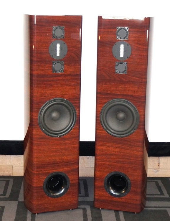

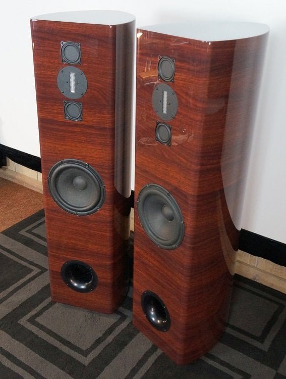

Once unpacked, the speakers surprised me with a finer gloss finish than I was expecting. These speakers are positively gleaming. I received the Rosewood mirror finish, and these speakers look much more expensive than they actually are. They can also be had in a gloss white or gloss black finish. They have a flat front baffle with rounded edges and curves back to a narrow rear baffle that just barely has enough room for two vertically installed binding posts and a label with identification information. The drivers are mounted directly on the baffle and are not set in waveguides or mounting plates. The drivers have a matte black texture and do not visually pop out very much, although I would guess they would stand out quite a bit more on the white finish.

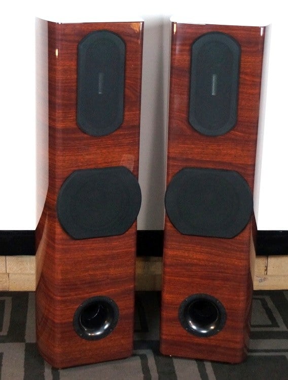

Philharmonic provides grilles to cover the drivers, and the grilles come in a two-piece set for each speaker: one capsule-shaped piece that covers the midranges and tweeter and another piece that covers the woofer. In my opinion, these grilles look a bit strange and do not improve the bare look of the speakers. I do think the speakers look nice without the grilles. The grilles are bound to be a source of diffraction, so their only useful function is to protect the drivers. If the drivers are unlikely to come into contact with anything in the environment that the speakers are placed in, the grilles would be best left off.

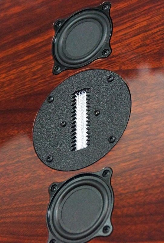

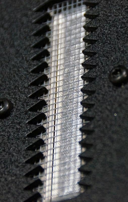

The BMR Philharmonitor uses a ribbon tweeter by the highly-regarded Serbian manufacturer RAAL. Ribbon tweeters are normally found on expensive speakers and are highly sought-after for their linearity, detail, and high-frequency extension. What makes a ribbon tweeter so special? The answer is the low mass of the diaphragm. Ribbon tweeters work by placing very thin, conductive ribbon that is usually either conductive tracings on material like Kapton or simply a very thin aluminum strip in a tightly-controlled magnetic field between two permanent magnets. When alternating current is run through the ribbon, it vibrates as its magnetic charge rapidly oscillates between positive and negative. Proponents of ribbons claim they are better as high-frequency reproducers than domes because their moving mass is much lower than domes and therefore can accelerate and decelerate much more quickly, and this quicker movement makes for a more realistic sound. However, ribbons have historically had a few disadvantages. Among those disadvantages is they are more expensive to manufacture, and they were fragile, so they were not as capable in midrange frequencies as in treble. They also need a transformer to raise their electrical impedance to a usable level, which naturally raises their manufacturing cost and makes them a larger component. The BMR Tower addresses the low-frequency fragility by just using the ribbon where it is strongest, at treble frequencies and above and not tasking it to play outside of its comfort region.
The BMR Tower uses two Tectonic BMR drivers and mounts them in an MTM configuration with respect to the tweeter. Compared to the BMR Philharmonitor, the additional BMR driver doubles the power handling of the midrange, and since that is where most music “lives,” it is a considerable advantage, especially for those who like to listen at more spirited levels. The MTM mounting arrangement accomplishes two ends. It keeps the midranges at an equal distance from the tweeter so that any vertical off-axis crossover nulls only occur at one frequency band. The midrange drivers will also greatly reduce vertical off-axis dispersion, especially at the upper end of its bandwidth, and that should make for a better match for the tweeter at the crossover point since the ribbon tweeter has such a narrow vertical dispersion. The vertical off-axis cancellation should also reduce acoustic reflections from the floor and ceiling as well.

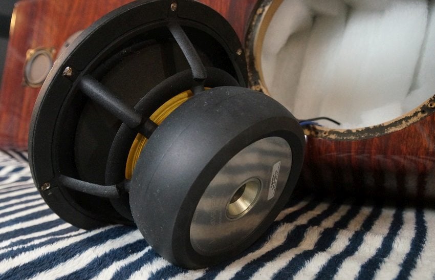

For low-frequency production, Philharmonic turned to the Scan-Speak Revelator family of drivers, an 8” bass driver that Philharmonic used in their first speaker, the Philharmonic 3, back in 2012. It has an unusually low resonant frequency of 21Hz for an 8” driver with an 88dB sensitivity. It is a fairly beefy motor section with a 2” thick magnet stack that has a 5” diameter and a 2” diameter voice coil. It also uses a very light but rigid paper cone that is attached to a cast aluminum basket. Its qualities make it a great choice for the kind of alignment it is used in by the BMR Tower: a mass-loaded transmission line. This type of transmission line doesn’t use a cabinet with internal folds for a long, convoluted path like a conventional transmission line but rather places the woofer and port at just the right locations and loads the cabinet with damping material at just the right points so that port produces output at a quarter-wave of the driver’s output instead of an entire cycle behind like a traditional vented speaker. The advantage of a transmission line is that the speaker can gain deeper bass extension and the driver is loaded more precisely for greater control over the cone’s movement. Philharmonic claims the speaker has a 22Hz tuning frequency which is significantly deeper than most ostensibly “full-range” tower speakers that seldom dig under 40Hz with serious power.

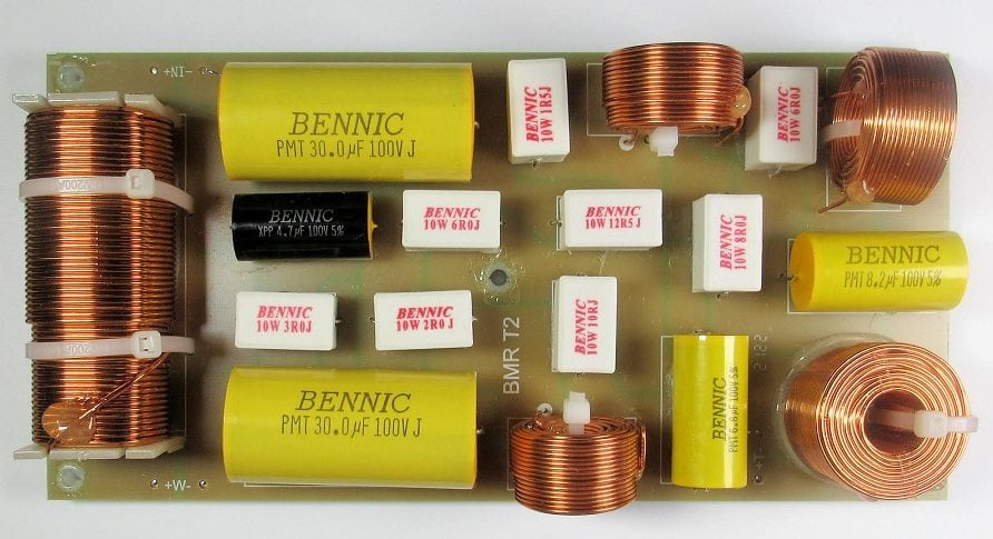

The crossover frequencies are 700Hz from bass driver to mid-ranges and 3,900Hz from mid-ranges to tweeter. The crossover circuit uses a Linkwitz-Riley 2nd order acoustic slope from bass driver to mid-ranges and a 4th order acoustic slope from mid-ranges to the tweeter. It is not a simple design and features a slew of bulky poly-film capacitors, inductors, and resistors. Clearly, a lot of tweaking was involved to optimize this circuit. The relatively high crossover frequencies will do a lot to keep the mid-ranges and tweeter out of strenuous frequency ranges and ensure that the BMR Towers will be capable of louder playback without putting the drivers into danger or incurring heavy distortion.

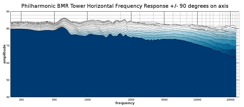

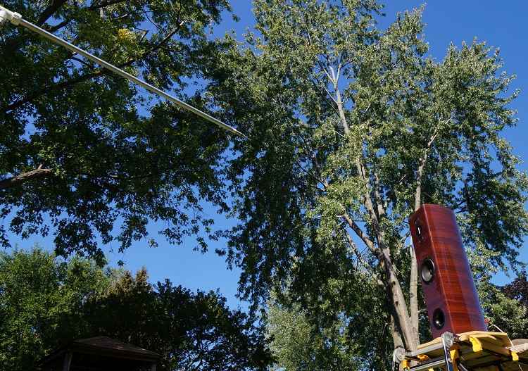

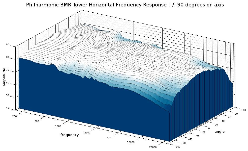

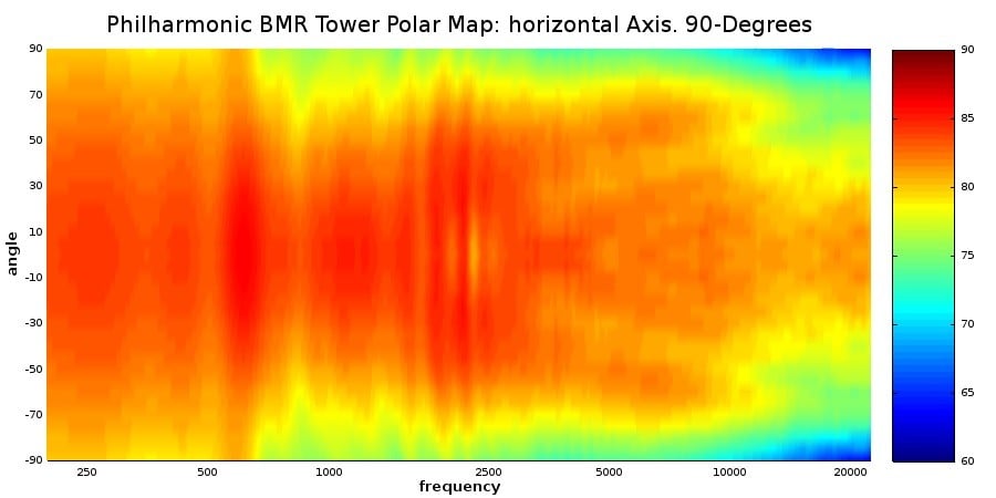

The Philharmonic BMR Towers were measured in free-air at a height of 4 feet at a 2-meter distance from the microphone, with the microphone raised to a 7.5’ elevation that was level with and aimed at the tweeter center. The measurements were gated at 8-milliseconds. In this time window, some resolution is lost below 400 Hz and accuracy is completely lost below 200 Hz. Measurements have been smoothed at a 1/24 octave resolution.
The above graphs depict the BMR Tower’s direct-axis and horizontal dispersion out to a 90-degree angle in five-degree increments. Information on how to interpret these graphs can be read in our article "Understanding Loudspeaker Review Measurements Part II". As we have come to expect from Philharmonic, this is superb behavior from an extremely accurate loudspeaker. The response is overall very flat with an ever so slight lowering of output as we get into the tweeter’s bandwidth. If that reduced tweeter output is audible at all, it would be heard as a very slight softness with regard to a speaker with a totally neutral response. Then again, this speaker preserves a wide dispersion out to a very far angle, so it may have a greater degree of higher frequency acoustic reflections with regard to other speakers that could shore up any higher frequency softness. The wide dispersion also leads to more lateral reflections which can give rise to a more spacious sound. Indeed, that is a quality that I perceived in my listening. The off-axis response bears a very high correlation to the on-axis response, so this is a loudspeaker that will sound the same at nearly any horizontal angle in the front hemisphere. That quality also allows it to be predictably equalized for those who want to play with the response via DSP.

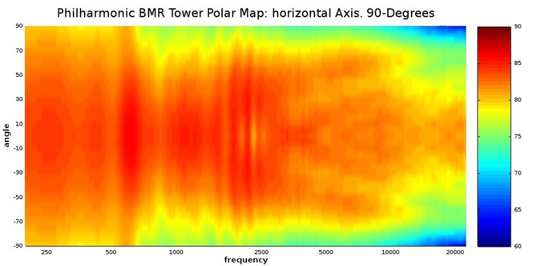

The above polar map shows the same information in the preceding graphs but depicts it in a way that can offer new insight regarding these speakers’ behavior. Instead of using individual raised lines to illustrate amplitude, polar maps use color to portray amplitude, and this allows the use of a purely angle/frequency axis perspective. The advantage of these graphs is they can let us see broader trends of the speaker’s dispersion behavior more easily. More information about interpreting this graph can be read in our article, "Understanding Loudspeaker Review Measurements Part II".
The BMR Tower can be seen maintaining a strong and even response all the way out to 70-degrees off-axis. For tonal balance, this speaker has no ‘sweet spot,’ at least on the horizontal axis. The entirety of the front area of this speaker is the sweet spot. It’s a rare speaker that would sound reasonably good at a 70-degree angle, which is almost a right angle of the BMR Tower’s forward-facing direction. Any reflected sound will have the same timbre as the direct sound, so it’s a speaker that doesn’t need any acoustic treatments to sound good. Acoustic absorbers could be used to diminish lateral reflections which might sharpen up the soundstage at the expense of spaciousness, but why buy such a wide dispersion loudspeaker and not take advantage of its unique properties to begin with?

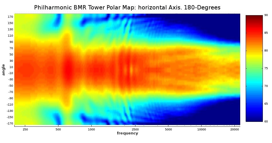

To get a better understanding of the directivity, I have expanded the view of the BMR Tower’s dispersion out to the full 180-degrees. Here we can see how rapidly output falls off as we move behind the speaker. The front hemisphere is mostly red, and the rear hemisphere is mostly blue, with only a thin strip of green separating them that hovers around 90-degrees. The evenness of these color strata nearly touches the ideal dispersion pattern for a wide dispersion loudspeaker. We saw similar behavior in the BMR Philharmonitor, but the BMR Towers seem to hold the control of this dispersion down to a lower frequency likely on account of the larger bass driver cone, larger front baffle, and front-mounted port. In this graph, we get a wider view of the slight bump in the response at 600Hz which is a port resonance. It is likely too narrow in bandwidth and too low in level to be audible and exists only as a small blemish of academic interest in an otherwise magnificent showing by the BMR Tower.

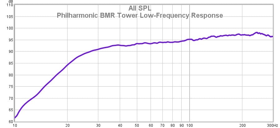

The above graph shows the BMR Tower’s low-frequency response captured using groundplane measurements (where the speaker and microphone are on the ground at a 2-meter distance in a wide-open area). The response can clearly be seen to be very smooth, but that won’t matter much since most rooms will wreck the response with typical low-frequency acoustics. The point is, whatever problems might be heard in the low frequencies, it will not be due to the speaker, which is working just fine in this range. The BMR Towers have terrific bass extension, and the knee of the response lay just above 20Hz, so Philharmonic’s claimed 22Hz tuning frequency does pan out. This is a truly full-range speaker that digs deeper than many popular subwoofers. Below the tuning frequency, the response does drop off at a 24dB/octave rate characteristic of vented systems.

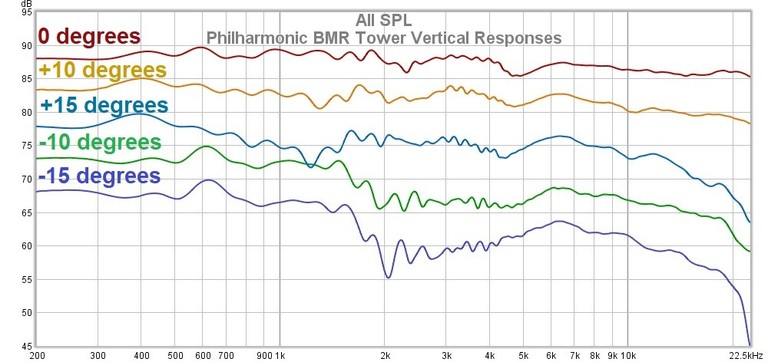

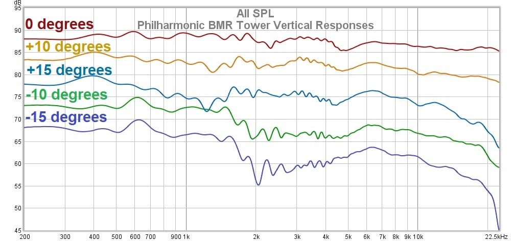

The above graph shows the response of the BMR Tower at a sampling of some vertical angles. The construction of the ribbon tweeter as well as the MTM layout of the midrange drivers should have some constricting effects on the vertical angle of dispersion. In these measurements, positive angles are above the tweeter and negative angles are below the tweeter. One surprising thing we see is that the two sides of the tweeter do not mirror each other in responses. I would have guessed that they would be much alike since the driver layout is symmetrical from the center of the tweeter which is our measurement position. What changes from that position is the enclosure; the cabinet ends right above the upper midrange driver but it continues below the lower midrange, of course. Somehow the extension of the lower front baffle is taking a toll on the midrange frequencies at that angle. This indicates that the BMR Towers are best listened at or somewhat above the tweeter height. That shouldn’t be a problem given that the tweeter is set at about a three-foot height from the ground, so unless the listener has an especially low-slung listening position, they will be listening at or above the on-axis angle.

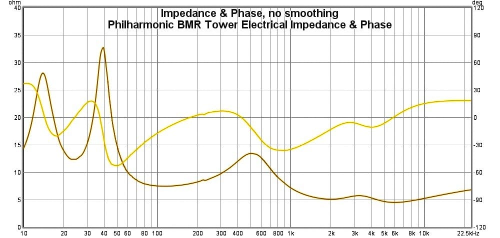

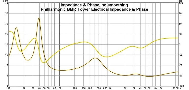

The above graphs show the electrical behavior of the BMR Towers. Here we see a relatively benign load for the speakers, and any amplifier should be able to drive them without issue. While most speakers have their impedance minima from 100 to 200Hz, the BMR Towers has its minima at 6kHz which doesn’t see nearly as much output from most content as the mid-bass range. The dip in the lower frequency saddle centers around 23.6Hz indicating the port’s tuning frequency. The upper peak of the saddle is slightly larger than the lower peak, and that indicates that the resonant frequency of the enclosure is lower than the resonant frequency of the driver but not by much. The bottom line to all of this is that the BMR Towers don’t have any special requirements for the amplifier.

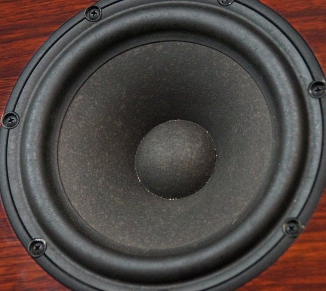

One of these woofers is not like the other.
Also, as mentioned, there is the extraordinary low-frequency extension. The only subwoofers that can surpass the BMR Towers in deep bass extension would necessarily be very large. The only advantage in adding subs to BMR Towers is addressing the effects of room acoustics. Such a system would still benefit by running the BMR Towers as ‘large’ speakers though, as additional low-bass emitters which help to average out the peaks and dips of room modes. However, sophisticated equalization would certainly be advised in that setup. If you are looking for loudspeakers that do not need the addition of subwoofers in order to reproduce seriously deep bass, the BMR Towers are very capable in that regard.
