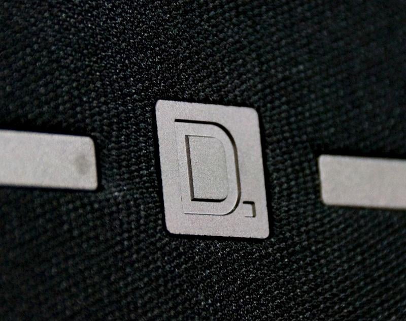

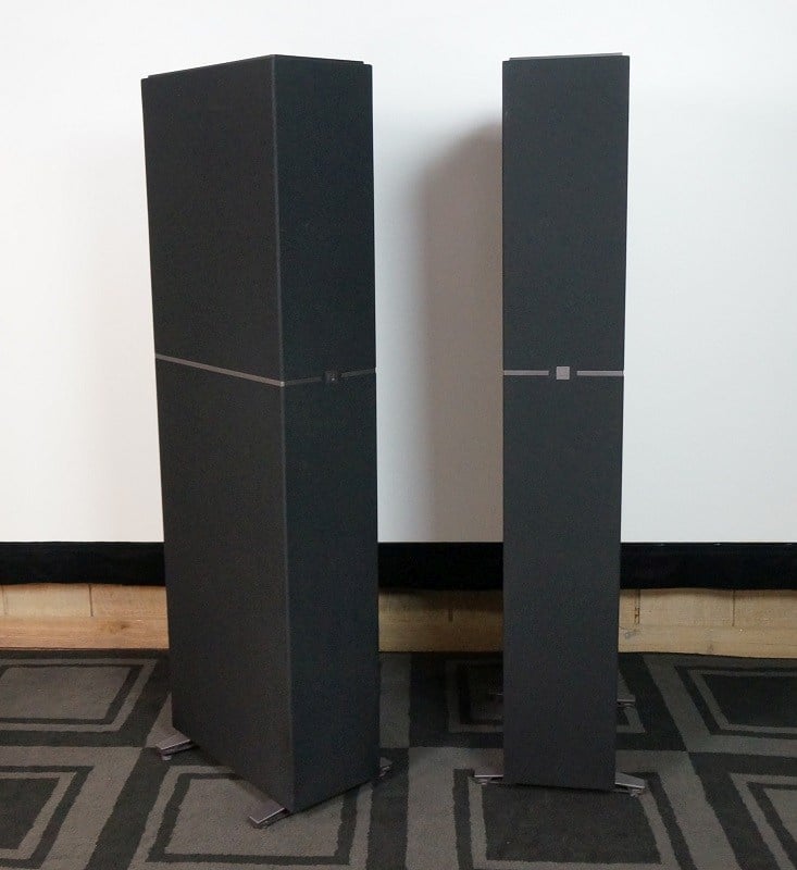

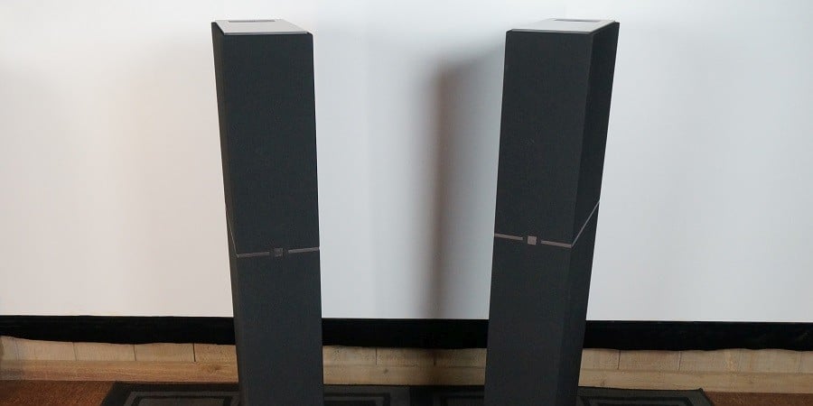

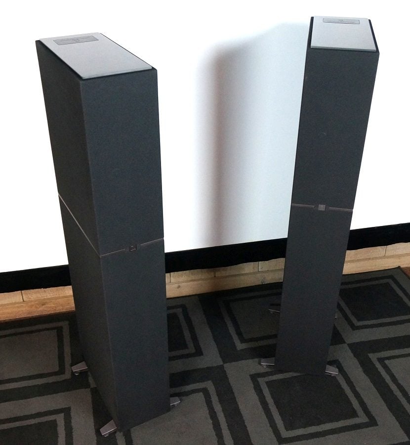

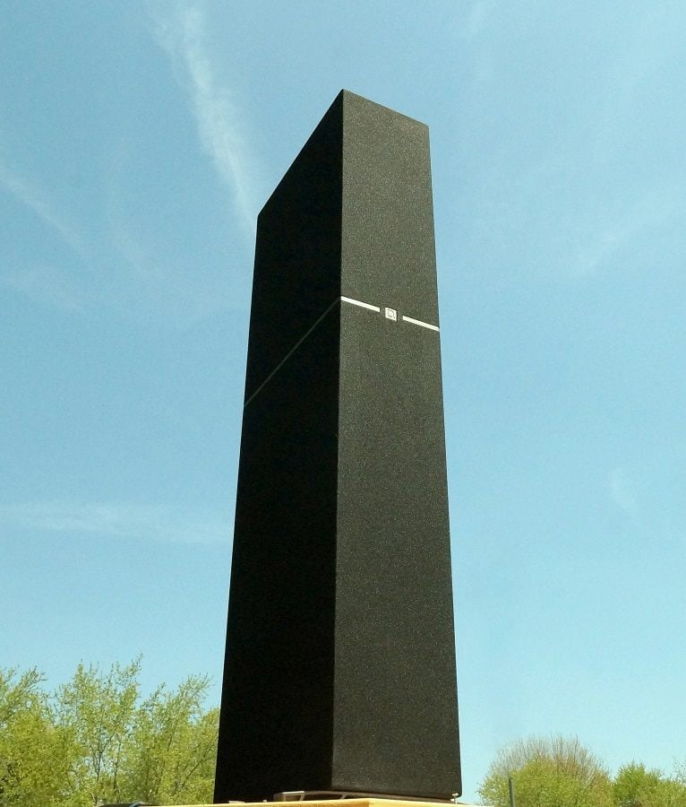

DM70 pair3At a glance, there has hardly been any aesthetic change at all between the Dymension series and Definitive Technology’s popular BP series. The DM70 are tall, nearly featureless tower speakers comprised of hard angles. The speakers are wrapped in a black fabric, but this is not some kind of grille that can be removed. The fabric shrouds any kind of mechanical elements that would otherwise be visible, so this is not a speaker where the drivers are visible. There are just a few touches that save them from absolute minimalism, such as a slim metallic belt with a buckle that bears the Definitive Technology insignia. The top of the speaker is a metal panel, and on this panel, there is a plate engraved with Definitive Technology badging. The feet are visible, but they are just disc feet mounted on some simple outriggers.

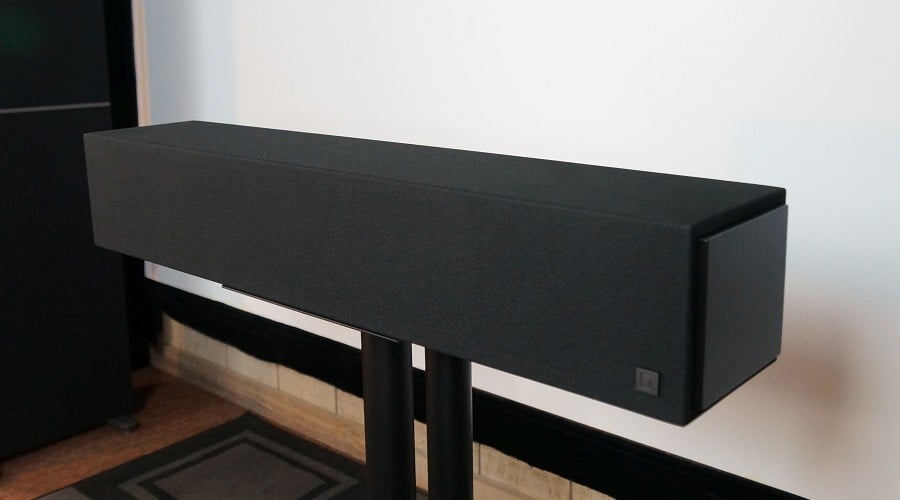

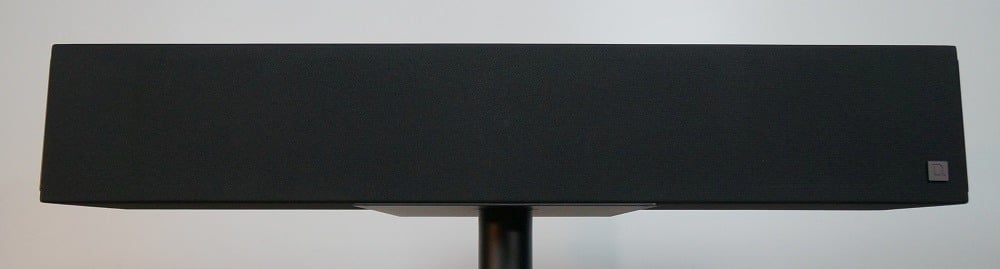

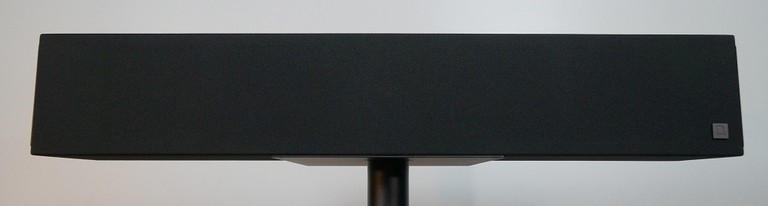

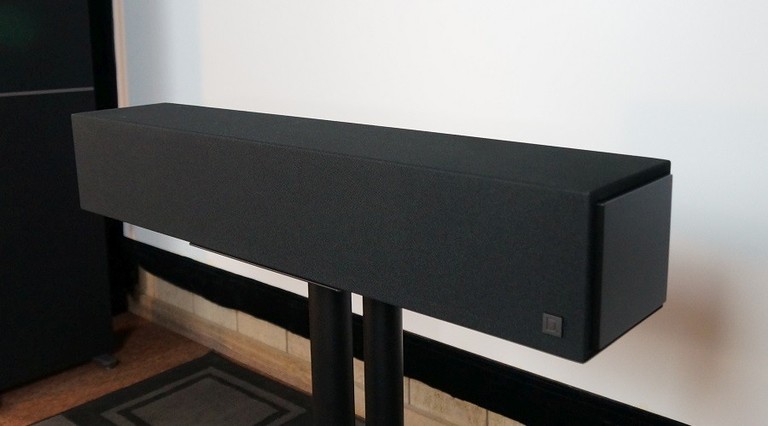

The DM20s is similarly styled; it is a thin, stretched-out oblong that is shrouded in black fabric. The only features it has is a small badge in the lower right corner and some metallic plates that cap the sides (these are actually painted MDF).  The badge is attached by a magnet and so it can be removed or oriented by 90 degrees for those who want to use the DM20s in a vertical, on-wall use. There isn’t much more that can be said to describe these speakers’ appearance. The simplicity of their styling makes them an easy fit in a wide variety of decor. I think they look nice, and they are a good lesson in how to make something look upscale through simple, without spending a lot of money on a real wood veneer with ten layers of lacquer.
DM20

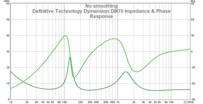

Let’s start our discussion of the Dymension speakers with the DM70 towers since they are much more complex designs. A big selling point of the DM70 speakers is their ‘bipole’ design, which is their ability to radiate sound out of the front and back. Definitive Technology claims that the bipole design creates a ‘spacious, immersive soundstage’ for an ‘incredible depth-of-field and truly enveloping listening experience.’ Is there anything to this beyond marketing hyperbole? Maybe. The DM70s are supposedly able to accomplish this thanks to a rear array of drivers that is identical to the front array and can project the same sound out of the rear of the speaker as the front. What that does is increase the ratio of reflected sound relative to the direct sound for the listener. That should make for a more diffuse sound field which may sound ‘wider’ and more ‘enveloping.’ The research in this area does suggest that a higher ratio of acoustic reflections would make the sound sources seem wider (the technical term is ‘Apparent Source Width,’ or ASW, which is defined as “the audible impression of a spatially extended sound source.”) Research also suggests that increasing reflections also increases ‘Listener Envelopment’ or LEV which is defined as “the listener's sensation of the space being filled with sound images other than the apparent sound source.” Much of the science in this area focused either on concert halls, acoustical properties of the room itself, or multi-channel listening rather than dispersion patterns of stereo speaker pairs. However, Definitive Technology’s marketing claims don’t seem to contradict existing science and may have some merit.
 DM rear array
Broadly speaking, the Dymension DM70s are 3-way speakers that use MTM arrays on the front and rear and a powered bass section that uses two passive radiators. But that is an extreme simplification, and there is a lot going on within each component that deserves discussion. Let’s start our discussion of the hardware of these speakers at the top of the frequency band with the tweeters. The tweeters use a 1” anodized aluminum oxide dome set in a shallow waveguide with a phase lens mounted in front of the dome. That isn’t an unusual design, and it has been used successfully before such as in the Demand series that we spent time with. Waveguides and phase lenses can vary greatly in effectiveness, so the devil is in the details in this regard, and we can only see how well-executed they really are in the end result.
There are two 5.25” midranges on each side which use Definitive Technology’s BDSS woofer which stands for ‘Balanced Double Surround System,’ and it gets that name because the cone uses two surrounds: one surround on the outer edge of the cone and one on the inner edge that attaches it to a large phase plug. Definitive Technology claims that this double surround system allows greater linear excursion. The large phase plug is something particular to Definitive Technology loudspeakers, and they call it the ‘Linear Response Waveguide.’  Its job is to block wavefronts from the different areas of the cone from colliding and interfering with each other. It looks to me like it would be effective in that role.
 DM bass drivers
The Dymension DM70 uses one active 10” subwoofer driver and two 10” passive radiators. The passive radiators are mounted across from each other which is a good idea. Passive radiators can have a lot of moving mass, so having them oppose each other will cancel out the momentum that they impart on the enclosure. They are also coupled together by a foam ring to help mitigate cabinet vibration. The active driver is powered by an onboard 180-watt, Class-D amplifier. The level of the subwoofer section can be adjusted by +12dB to -15dB. DefTech touts a feature of the subwoofer’s volume adjustment system that they call ‘Intelligent Bass Control’ which raises the level of the subwoofer in a nonlinear way so that higher or lower levels will not affect the sound of lower mids (Boston Acoustics implemented a similar feature in their VR960 and VR 970 speakers in 1998). The bandwidth of drivers in loudspeakers is not filtered out over a sharp drop-off but rather a gradual roll-off. If you simply raised the level of a driver within a speaker, the sound that is affected starts getting into other drivers’ bandwidths. So in a normal speaker, if you simply raised the level of the bass driver, its sound would start to be heard in the mids which would degrade the quality. Definitive Technology has solved that problem by changing the shape of the filter at each notch in the subwoofer’s volume knob so that the sound from the subwoofer section does not bleed into the midrange section.
DM70 back plateThe cabinet seems sturdy enough with most of the bracing in the upper section MTM arrays. The opposite-facing driver arrays should go a long way toward canceling out movement caused by the moving mass of the woofers and voice coils, but cabinet resonances still need to be addressed by damping and mass. The DM70 is held up by a set of outriggers where the user can choose either flat or spike feet. While the fabric sock that covers the enclosure does lend it a unique and handsome appearance, it could be a real problem for cat owners or rambunctious children. The fabric is certainly vulnerable to abuse, and I don’t think that it would be re-upholstered under warranty if a cat decided to use it as a scratching post. One advantage is that the low reflectivity of the fabric will do a lot to make the speakers disappear in low-light conditions.

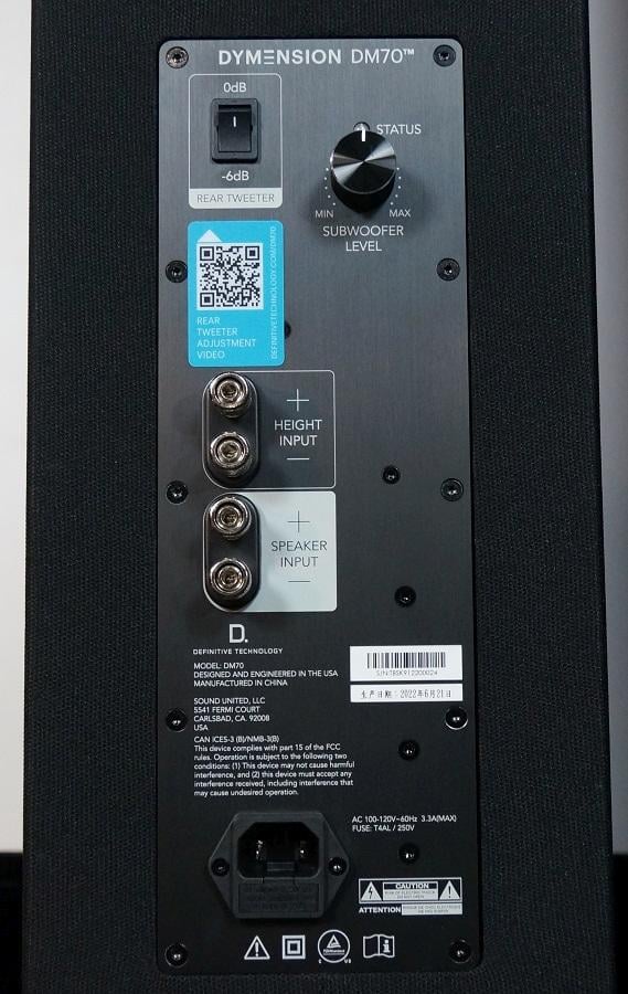

One disadvantage of the DM70s for home theaters with projection screens is there is a rear blue LED which is somewhat bright, and if these speakers are placed in front of a projection screen, the light from the LED will degrade the screen’s contrast. Users with projection screens could cover the LED with a couple of pieces of electrical tape to block the light from hitting the screen, but a switch to turn off the light would have been welcome here. Alternatively, if appearance of the speaker isn’t a big concern, users could simply rotate the speaker by 180-degrees since the rear array is the same as the front. This speaker would sound the same if it was turned around in place, since the rear-to-front design is symmetrical - so long as the tweeter level switch is set to ‘0dB.’
Connectivity is done through some typical 5-way binding posts. There is no LFE input for the subwoofer section, and that is probably a good idea to avoid confusion. These speakers ought to be set as ‘large’ in AV processors since they should have no problem with lower bass. There are also some binding posts for the optional DM90 ‘height’ speaker for Atmos systems that can be installed on top of the DM70s. Height speakers on top of the main speakers are not normally the best solution for Atmos upfiring height channels, so I would recommend users check to see if ceiling speakers can be used for Atmos height channels before resorting to setting speakers on top of the left/right mains. Definitive Technology also offers the wall-mountable Dymension DM95 speakers as an option against ceiling speakers. Without the Atmos speaker, there is a solid aluminum plate topping off the DM70.
The DM70 speaker design seems like it could accomplish its goal of issuing more acoustic reflections than a traditional speaker, and outside of that aspect, the build quality and engineering seem sensible as well. For those who might prefer the bipole aspect toned down, there is a switch on the back panel that takes the rear array down by 6dB. This could be especially helpful if the user needs to position the speaker close to the wall.

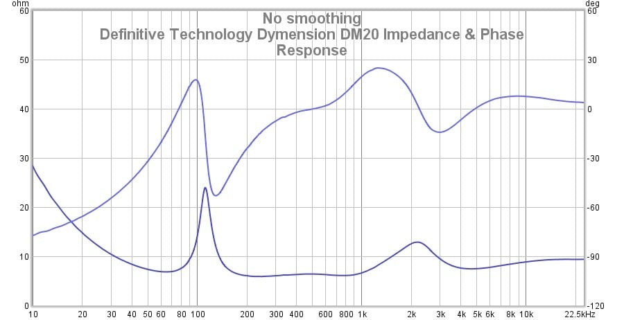

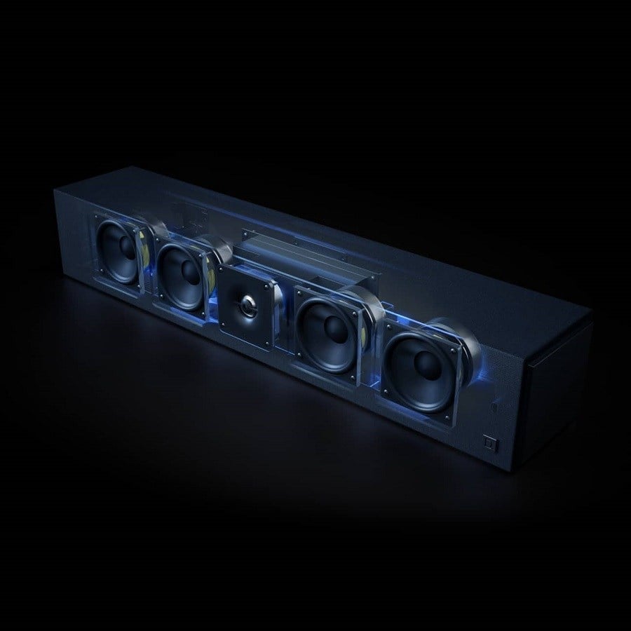

Moving on to the DM20 center speaker, it is a 2.5-way slim center/on-wall LCR that is designed to fit in tight situations. It is a lot less complex than the DM70 tower speakers and does not have a rear driver array. It uses the same aluminum oxide dome tweeter as the DM70 but not the same midrange woofers. The woofers are four composite polymer 4” cones. While the use of 4” drivers might not sound like it would have serious dynamic range, four of them equals the surface area of an 8” woofer, so the DM20 may be capable of some real punch, at least in midrange frequencies. The -3dB low-end of its spec’d frequency response is 91Hz, so it isn’t designed to play low bass. Users should set this speaker to ‘small’ in their AV processor or receiver, and they might consider a 90Hz crossover frequency. The DM20 is a sealed design that uses a low-volume enclosure, so lower bass would not have been possible, at least without sacrificing a lot of dynamic range. Definitive Technology made the right choice in exchanging low-frequency extension for dynamic range since anyone who has this center will also have a subwoofer.
DM20 rear

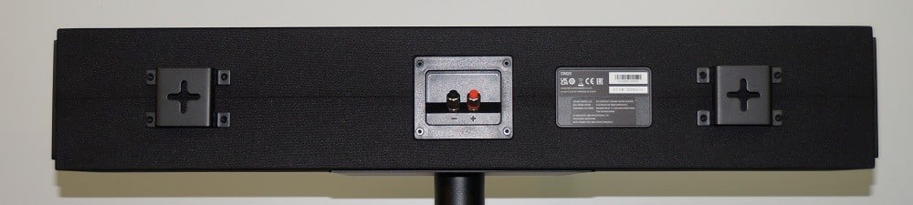

The DM20 has rear keyhole slots so that it can be mounted against the wall either horizontally or vertically. This enables it to be used as an on-wall speaker as much as a stand-mount center speaker. It is a bit hefty at 22 lbs., so make sure it is mounted onto studs or anchors. One problem is that the keyhole slots are spaced 20” apart, and this is awkward because the slots won’t quite line up with the 16” stud spacing of North American homes or 24” spacing of European homes. For this reason, I recommend that the non-stud mounting screw use an anchor, or both use anchors if the keyhole slots can’t line up with any studs.
dm20 x ray

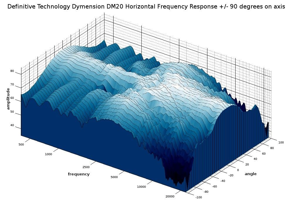

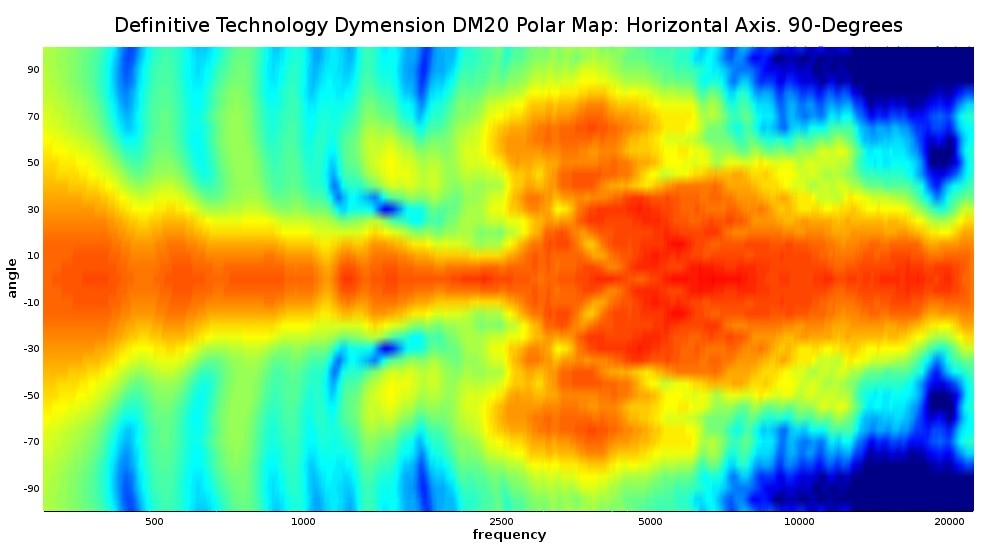

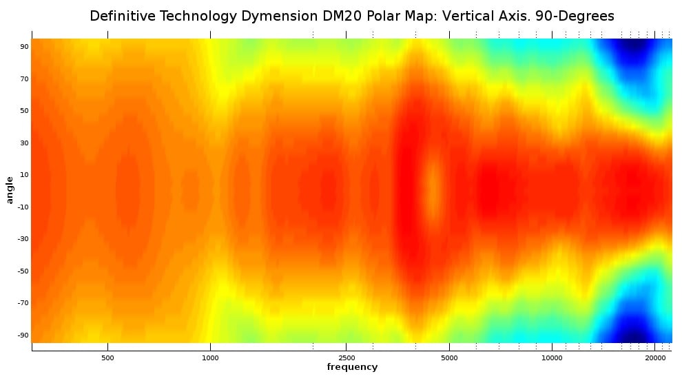

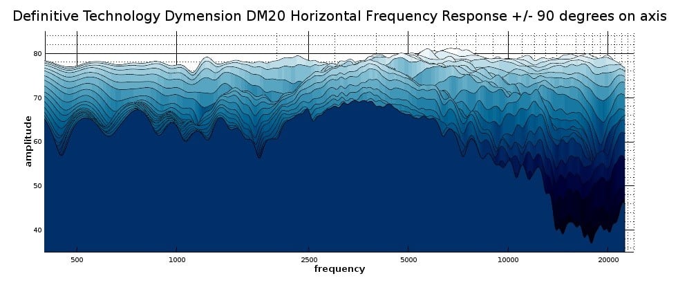

The DM20 drivers are arranged with the tweeter sandwiched between two sets of two midrange woofers in an MTM-style design (although technically this implementation is an ‘MMTMM’ but the principle is the same). This will inevitably give rise to interference nulls at off-axis angles that horizontally-aligned MTMs are known for. We have talked about this at length multiple times in articles such as: Vertical Vs. Horizontal Center Speaker Designs, Vertical Vs. Horizontal Center Speaker Designs - An Alternate Perspective, and Center Channel Speaker Design Additional Considerations. To boil down a complex engineering issue, MTM designs can have very good responses at the on-axis angle but can have very poor responses at off-axis angles along the plane of the drivers. For horizontal MTM center channels, that means if you are seated off to the side relative to the center speaker, you can be met with a subpar sound because of a depression in an important frequency band, typically the midrange to upper midrange. All MTMs will have this problem to some extent, but some will have it more severely than others. The DM20 ameliorates this somewhat by going with a 2.5-way design where the outer mids have a much lower low-pass frequency than the inner mids.
I decided to test for this off-axis interference cancellation by listening for any timbral shift in the off-axis versus on-axis sound in the DM20s by playing a white noise as well as dialogue and music samples. It was quite evident in this speaker. Listening at an off-axis angle causes a significantly audible spectral shift in this speaker as opposed to having it face the listener. There was a definite ‘hollowing out’ of sounds that had midrange energy. I could still understand dialogue at off-axis angles, but the timbre had shifted at those angles, and not for the better. At an on-axis angle, everything sounded full and fairly good. For this reason, I wouldn’t advise the addition of the DM20 to a set of DM70s for the purpose of getting center imaging for far off-axis listeners (>15 deg). To be sure, the DM20 can anchor center channel sound to the right location, but the qualitative hit that it suffers at off-axis angles may negate its advantages. And to reiterate what I said before, any low-profile center speaker would inevitably have the same problem. The DM20s are not at all unique in this regard.
It should be kept in mind that this off-axis interference cancellation only happens when the DM20 is used horizontally, and users who choose to use it as vertically mounted on-wall pairs will not have this problem. However, it does mean that the vertical dispersion will be a bit narrow with vertical mounting, so users should try to mount the DM20s with the tweeters roughly around the ear level of the listening position.

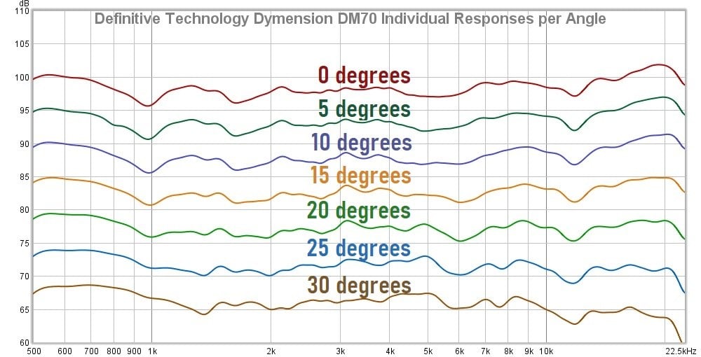

In my 24’ by 13’ (approximately) listening room, I set up the speakers with a few feet of stand-off distances between the back wall and sidewall and equal distance between the speakers and the listening position. I angled the speakers to face the listening position. The listening distance from the speakers was about 9 feet. No room correction equalization was used. Processing was done by a Marantz 7705 and the amplification was done by a Monoprice Monolith 5x200 amplifier. No subwoofers were used. All music listening was done with the DM70s alone in two-channel stereo, and I brought in the DM20 for movie watching.
I should say that before I sat down to do some serious listening with this speaker, it took a little while and some extra positional tweaking to get a balanced sound between the left and right DM70 speakers. For most speakers, I can place them in the same spot for an even soundstage between the left and right speakers, but the DM70s did take more work to get a balanced sound. It’s possible that their unusual acoustical properties were reacting to my room differently than traditional speakers, but setting these up was a bit more involved than normal. Also, I found that the soundstage didn’t stabilize until I was at least as far back as my typical 9-foot listening distance. At closer proximities, it was difficult to get a good stereo-center image.
