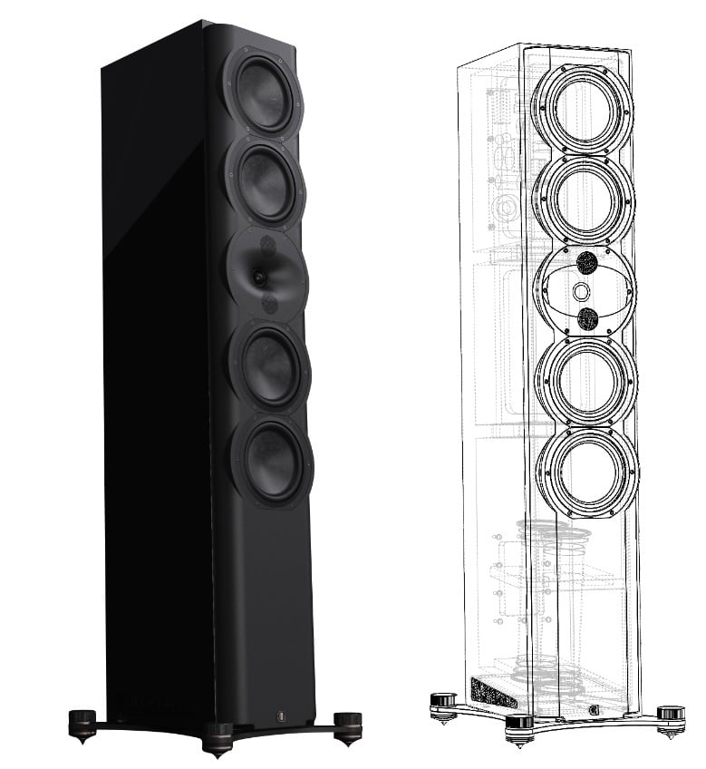

Reference series counterpart. As with the Signature series, the Reference
series has a large tower using four 7” bass drivers (the R7t), a bookshelf

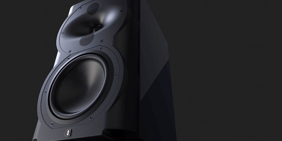

speaker (the R4b), a dual bass driver stand-mount speaker (the R5m), and an

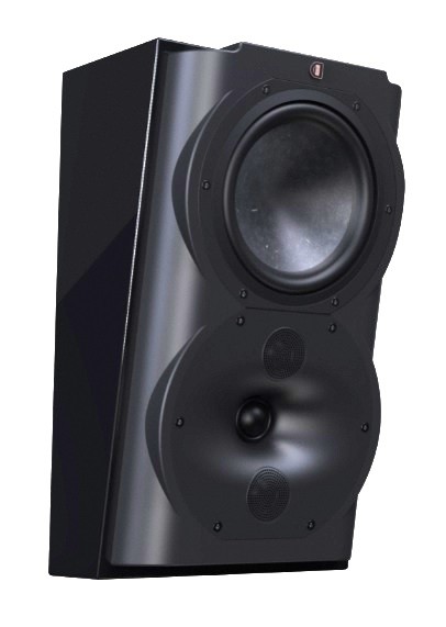

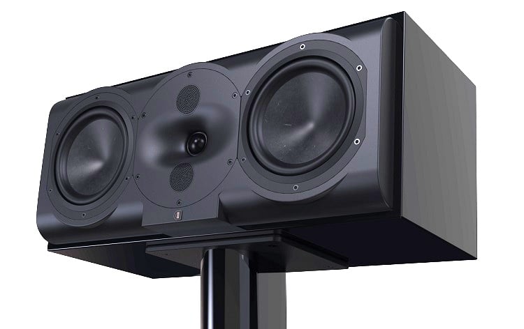

angled height speaker (the R4s). The Reference series has a center speaker, the
R5c, and although it is not a massive quad bass driver center like the S7c, it
does look to be formidable in its own right. The Reference series also has a

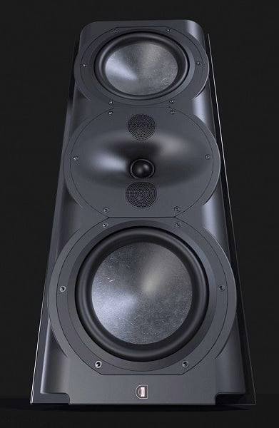

smaller scale tower speaker that has no Signature counterpart, the R5t, which
has two bass drivers instead of four. The Reference series promises a large

The R series also saves some cost in not having as over-the-top cabinetry as the S series. For example, the S series had a 3” thick front baffle whereas the R series ‘only’ has a 2” thick front baffle. R series side panels and interior bracing are a mixture of ¾” and 1” thick boards as opposed to the S series 1.2” thick pieces. This is like going from extreme overkill to merely overkill. The R series is still using high-density fiberboard so the enclosures are more rigid and inert than the standard MDF most speakers are built with. This can be seen in the weight specification in the R series; the 105 lbs weight of the R7t is not something you want to lift solo!
