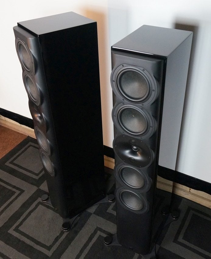

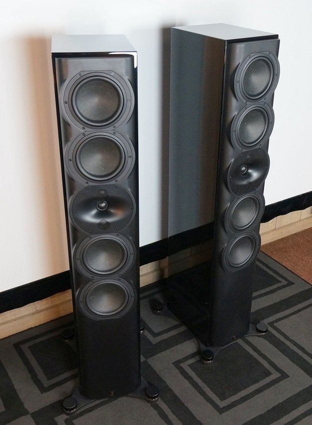

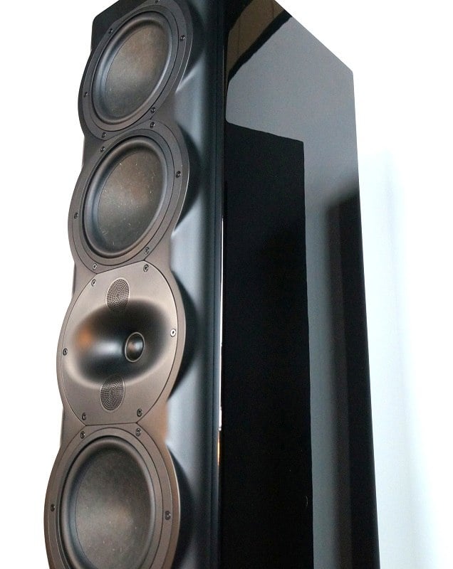

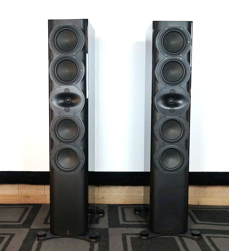

The R7ts are large speakers but not huge. They aren’t going to disappear in a living room, but they won’t totally dominate the space either. They do have style and visual flair but in a restrained and mannered way. They look classy without being showy or pretentious, at least in my opinion. The R7t speakers look like a slightly smaller version of the S7ts, so I will just borrow some of my description of their appearance from the S7t review:
Their most visually distinguishing element has to be the driver array; people who like symmetry will like the look of the R7ts. The drivers are mounted in five circles that protrude from the front baffle with the middle circle housing the tweeter and midrange domes. You could fold the driver array in half either vertically or horizontally, and the halves would be identical. The front baffle has heavily rounded edges with the protruding driver mounts being an intrinsic part of the structure. This baffle is mounted on the main bulk of the enclosure, which is a typical hard-edged oblong shape, although the cabinet does have a slight backward tilt which gives it a bit more flair than if it were standing totally upright.

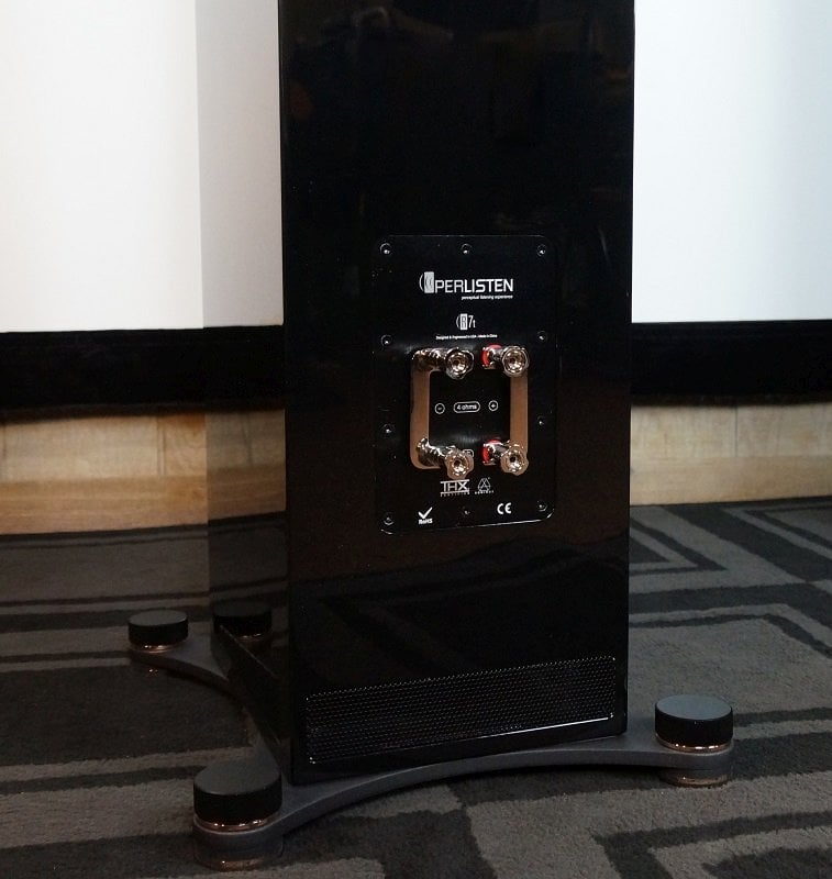

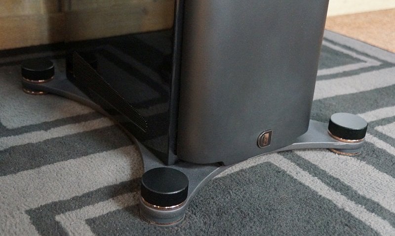

The base is a thick steel plate with some hefty feet sticking out from the corners. The feet have some brass rings above and below the plate as well as polished brass spiked feet which is a nice touch of class. The binding post plate is a brushed black metal plate with gleaming chrome binding posts joined by a similarly polished jumper.
R7t pair7The R7t cones are a bit different than the S7ts in that the woofers have a black paper pulp texture instead of the lustrous TexTreme checkered texture of the Signature series. The Tweeter is also a black fabric dome instead of the grey dome of Signature’s Beryllium tweeter. The R7t speakers only come in a gloss black finish at the time of this writing, but a gloss white is expected to be available in the future. I do wish they came in other finishes such as a matte finish, but the demands of the market would make those options costly since most people would only buy the gloss black. The gloss finish is impeccable with no orange peel effect that is sometimes seen on less refined gloss finishes. Grilles are optionally available for the R7ts.They are some magnetically adhesive perforated aluminum discs that just cover the drivers. They do a good job of protecting the cones unlike many other grilles which are just fabric-draped frames, but they don’t improve the appearance of these speakers at all.

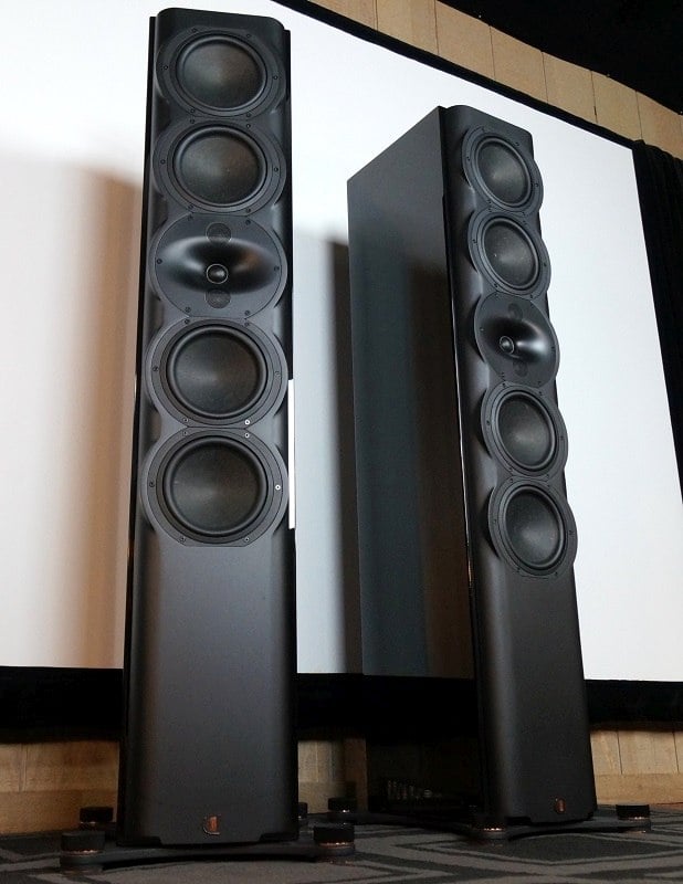

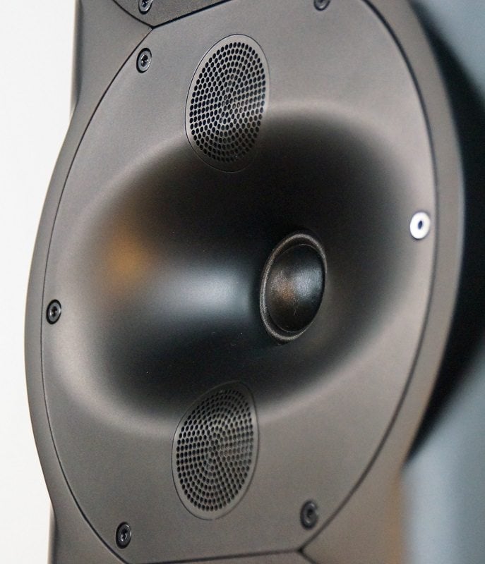

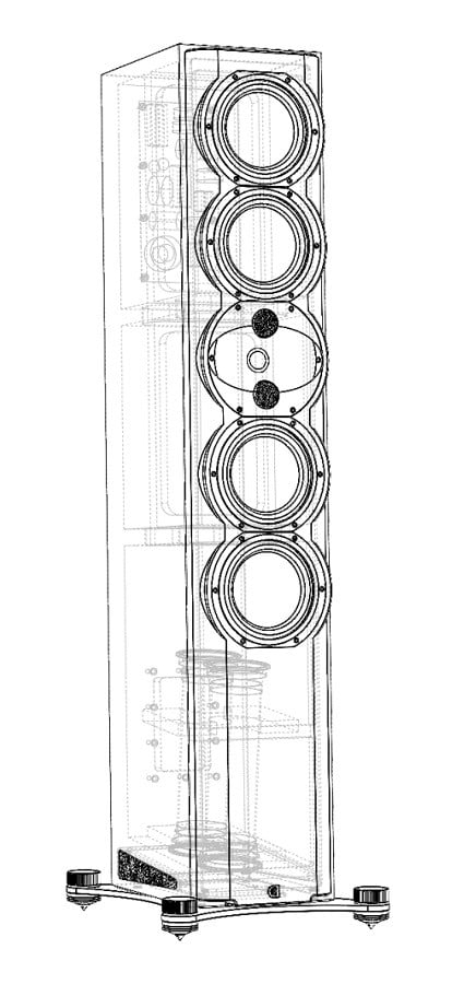

The R7ts are technically a 3.5-way tower speaker, but to leave it at that is greatly oversimplifying its design. Perlisten’s speakers are unique in the hi-fi loudspeaker world, and I would say one of their most distinct and significant design features is the DPC array. This is a Perlisten-exclusive design that leads to some pretty cool performance attributes. Since the R7t speakers share the same design structure as the S7t speakers that we already reviewed, we will just quote from that review where the design description would be the same, and we will do that here with the DPC array:

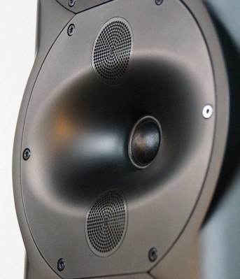

On the surface, it looks like a 3-way speaker in which a dome tweeter is nested between two midrange domes and four 7” woofers, but this is not a conventional WMTMW speaker. Instead, the drivers form an array where they largely work with each other rather than in their own separate frequency bands, so there are a lot of overlapping bandwidths in the crossover filters. This is done to create an acoustic beamforming effect where all the drivers sum up on an intended listening angle and subtract elsewhere. In order to accomplish this, the drivers in the array do not operate at the same amplitude levels or even the same phase angle. In fact, to make the beamforming work, the spacing of the drivers must be precise, both in height and width, but also in depth, and this is why the midrange drivers are mounted ahead of the tweeter in spatial positioning. The advantage of this beamforming is a whole lot of output delivery to a specific direction without needing to throw sound everywhere at a high level. Perlisten calls their beamforming array the DPC waveguide where DPC stands for Directivity Pattern Control.
R7t close  R7t DPC array

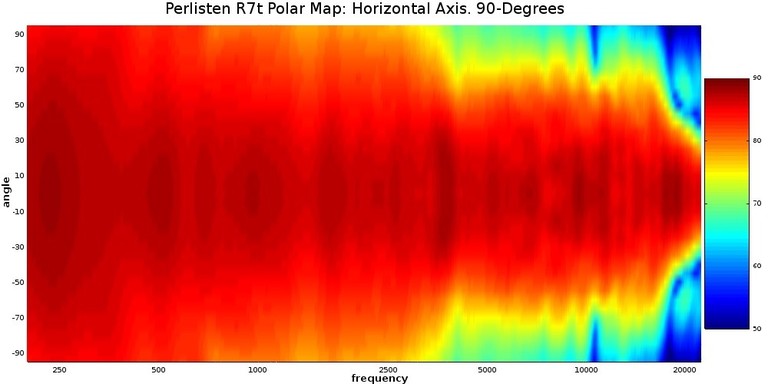

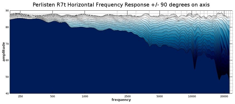

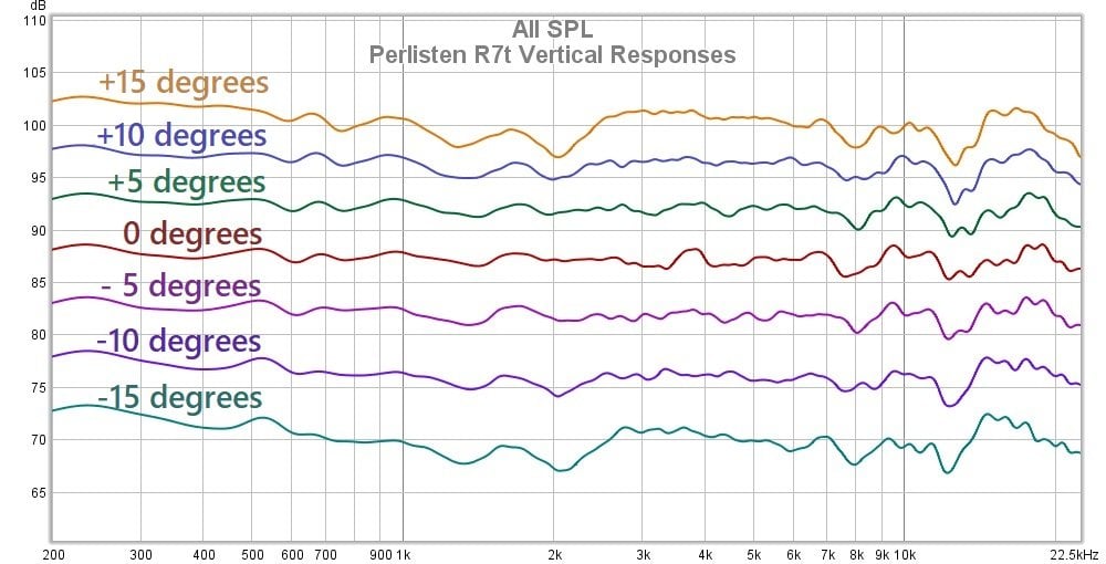

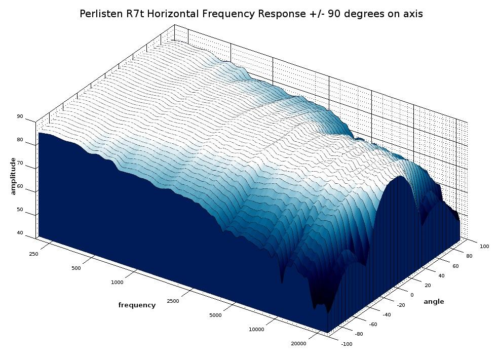

The beamforming restricted angle occurs on the vertical axis in the R7t speakers. The performance targets for this speaker are a wide horizontal dispersion and a narrow vertical dispersion. The reason is that any room with multiple listening positions is likely to be spread out on a horizontal plane but unlikely to be spread out much on a vertical plane, so it’s a good idea to have a full sound projected out over a wide angle horizontally so all the listening positions are met with a high-quality sound. It is also beneficial acoustically since it has been shown that lateral acoustic reflections from sidewalls can enhance the spaciousness of the sound, and many people find that to be pleasing. On the other hand, it can be beneficial to restrict the vertical dispersion angle. There is an argument that vertical reflections can reduce a sense of spaciousness (by diminishing inter-aural cross cancellation), although that is based on research conducted for larger room acoustics such as auditoriums and it isn’t certain how valid that is for domestic living space-sized rooms.
Normally, speakers just use a waveguide on the tweeter to restrict vertical dispersion, but the problem with that is it only affects the tweeter’s bandwidth while the woofers and midrange drivers are usually projecting sound out at a wide angle in all directions. Some manufacturers place the midrange in a horn or use very large woofers, but either solution necessarily makes the speaker very large. Through the ingenuity of beamforming, Perlisten has found a way to restrict vertical dispersion over a much wider bandwidth without needing the speaker to be gigantic. Perlisten also does incorporate a state-of-the-art waveguide on the tweeter, but that is to control directivity in higher treble frequencies where their beamforming array isn’t active.
The central DPC array in the R7ts is comprised of three 1” silk dome drivers. The 1” drivers use some pretty beefy neodymium magnets in the motor, and that amount of force should have a tremendous level of control over the moving assembly of the domes. Silk is a common material for a tweeter diaphragm and the reason for that is because it works so well without being very expensive. It is light and stiff, and it can operate up to very high frequencies without incurring significant deformation or break-up modes. A waveguide is used to control dispersion on the center tweeter, so the beam-forming of the DPC array operates mostly over the bandwidth of the other domes as well as the bass drivers down to 500Hz or so.
 R7t cone

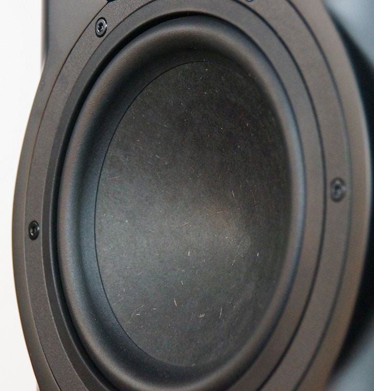

Also included in forming the array are the four 6.5” bass drivers. Their cones use a material that Perlisten calls “HPF pulp,” where HPF stands for Hybrid Pulp Formulation. This is a mixture of long and short fibers as well as bamboo for a stiffener and wool for damping. This is a light and stiff cone composition that can hold a response out to a very high frequency. The motors are beefy ones, as would be expected. They use shorting rings and an aluminum coil in a large iron magnet. Some might complain that using aluminum is mere cost-cutting, but it was a deliberate decision by Perlisten for performance reasons. As we stated in the review of the S7t: “That might seem slightly counter-intuitive seeing as how copper is more conductive, but that extra electrical resistance can be made up by simply using a larger gauge wire, and the larger gauge wire has the added benefit of being better for thermal dispersion since it has a lot more surface area from which to radiate heat. What is more, even with the larger gauge wire, it is still lighter than copper, so using aluminum reduces moving mass, thereby making the driver more sensitive.” The combined surface area of the four 6.5” drivers adds up to the surface area of a 13” driver, so these speakers should be able to move a lot of air for some real potent lower frequency output.
R7t X ray viewAs was mentioned before, Perlisten’s DPC array requires a very unusual crossover circuit design that features a lot of overlapping frequency bands instead of the normal segregation of frequency bands for each driver type. This is very carefully done so that the phase cycle of the output from the drivers sums up where it is desired and subtracts where it is not. The upper and lower bass drivers play up to 200Hz, the middle set of bass drivers play up to 1.4Hz, the upper and lower 1” domes play from 1.4Hz to 4kHz, and the tweeter plays from 1.4kHz and above. It can be thought of as a 3.5-way design, but, as was mentioned before, that would be oversimplifying what is going on. The crossover circuit uses heavy-duty 1% air-core tolerance inductors and 2% tolerance capacitors and non-inductive resistors. They aren’t quite as overbuilt as the crossover circuits seen in the Signature series, but they still promise very firm control over the signal to the drivers. The R7ts have dual binding posts and can be bi-amped for those who have extra sets of amplifiers.
The enclosure is made from a mixture of 1” thick and ¾” thick HDF and has a 2” thick front baffle. The interior is divided by three windowpane braces, so the cabinet feels very solid. At 105lbs., it is not an easy lift. It is jam-packed with acoustic damping stuffing. There are two bottom-mounted ports, and they have a 3” diameter and a 12” length and are flared on both ends. Those are some serious port dimensions and are larger than what we see on many subwoofers, so the R7ts should have some serious low end kick. A benefit of down-firing ports is that the speaker can have these large ports without needing to put a bend in them. Bending the ports is tricky to do without incurring port turbulence at lower drive levels than straight ports would have. Bottom-firing can also help to mask any unwanted port noises at high drive levels while using the base plate to assist in acoustically loading the ports for a more powerful low end. The speakers come with port plugs, but there aren’t many circumstances that would justify using them in a design like this. The only circumstances I can think of where it would make sense to plug the port would be if the speakers were placed in such a small room that room gain was really blowing up the low end and equalization isn’t available for some reason, or if the user wanted to use subwoofers crossed at a very low frequency like below 50Hz where the phase rotation of ports might make it more difficult to integrate the sub. Outside of those two unusual circumstances, I would discourage the use of the port plugs since they would hurt more than they would help in the vast majority of circumstances. Perlisten should probably not even have included them as standard items in order to protect less informed users from unintentionally degrading the sound by installing them without really understanding what they do.
The plinth base and feet are solid steel pieces that weigh a considerable amount on their own, and they do a lot to give these tall speakers solid footing; they wouldn’t be easy to knock over. Users have the option of using some brass spiked feet for carpeted surfaces or skipping the spikes for a softer, rubber feet bottom that is more appropriate for hard flooring. The binding posts and terminal plate use nickel-coated brass which looks quite fully chromed and quite nice. The jumpers and binding posts have a heavy-duty feel much as would be expected from a luxury loudspeaker of this pricing. As was mentioned before, grilles can be had for the R7ts, but as an optional extra. They are magnetically attached to the front baffle, and they have a strong grip. They are perforated aluminum discs and do offer serious protection against anything that could hit the drivers.

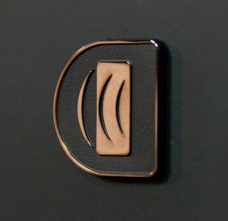

THX Dominus logo

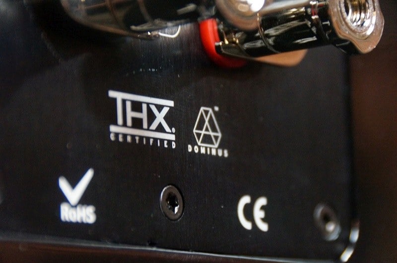

As THX-certified Dominus loudspeakers, the Perlisten R7ts promise an extraordinarily wide dynamic range. “Dominus” is THX’s most extreme certification, and it indicates that the speakers can reach THX Reference Level performance at a 20-foot distance from the speakers within a 6,500 cubic foot room. Those who want to know more about Dominus can read our coverage of that certification in this article: The THX Dominus Line Has Finally Been Breached, but the short version is that these are tremendously powerful loudspeakers.

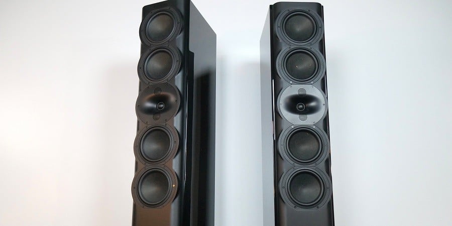

R7t rearWhy Does the S7t Cost 2X More than the R7t?
Obviously, the R7t is a hell of a speaker, but what are the physical differences between it and its upscale counterpart, the S7t? Why would anyone spend double the price for the Signature series parallel? As mentioned before, the Beryllium and TexTreme driver diaphragms are lighter and stiffer but far more expensive. The driver motors are also more powerful, so the drivers have more displacement, superior power-handling, and less distortion. The crossover components in the Signature speakers are more robust and also offer higher power-handling and better performance stability over higher currents and temperatures. The Signature series also has thicker baffles, braces, and enclosure paneling. It is also lined with an additional layer of damping that the Reference does not have. The quality control is stricter on the Signature series which has pair matching within an incredible 0.5dB, so tolerances are extremely tight on driver components. The Signature series uses Rhodium plated binding posts on a heavy-duty binding post plate, whereas the Reference series nickel plated posts on an aluminum plate that is half as thick. The Signature series comes with grilles standard, but grilles are optional for the Reference series. This all adds up, and the Signature series is better built and higher performing, but its uncompromised nature really raises the price. Whether it is worth the extra cost is a matter of personal preference, of course, but you are getting much more than just a slightly larger loudspeaker in the S7t.
