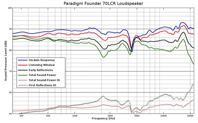

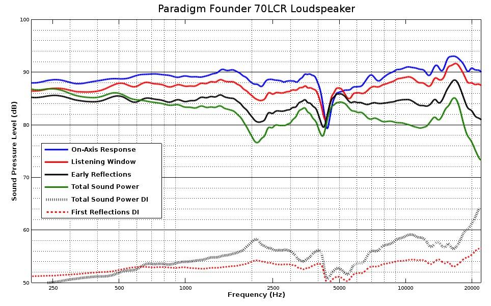

  • Wide dispersion center in 70LCR

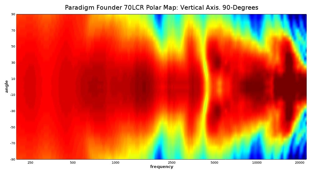

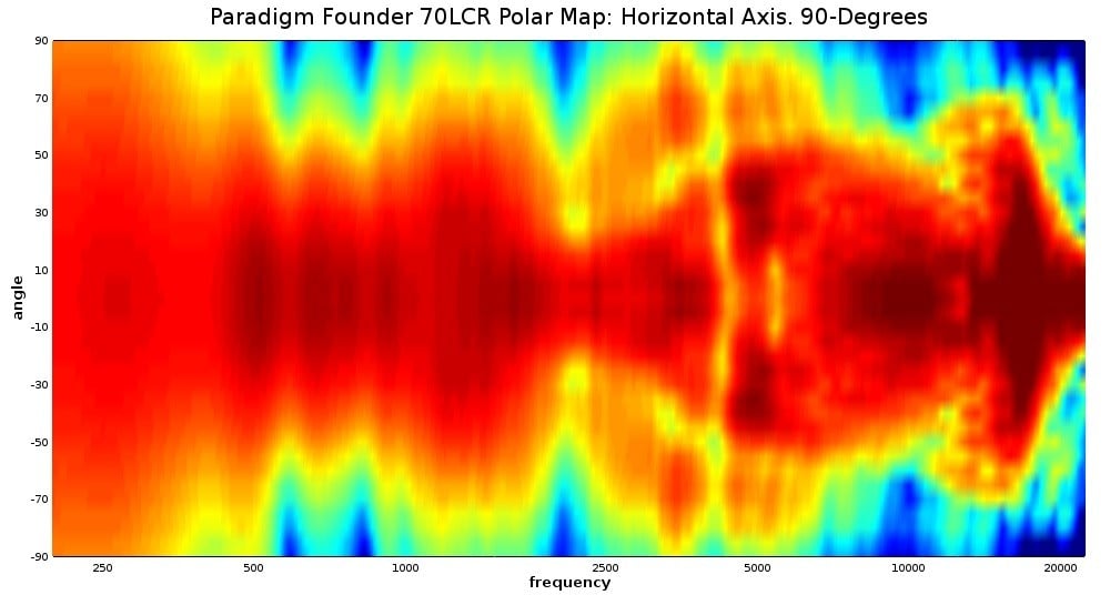

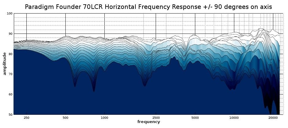

  • Erratic on and off-axis response from 70LCR

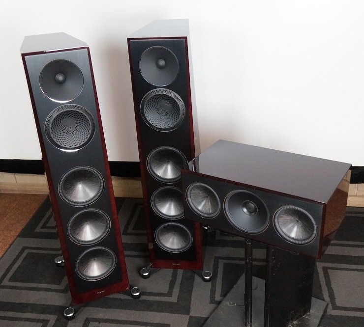

Appearance

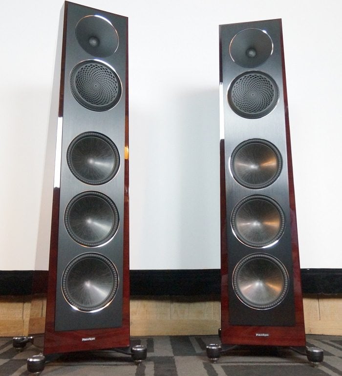

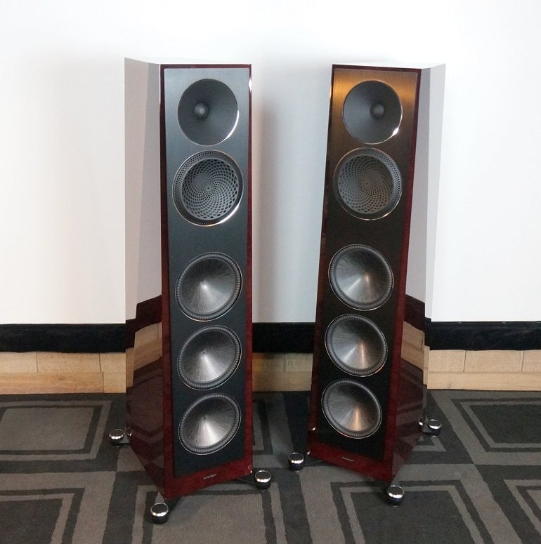

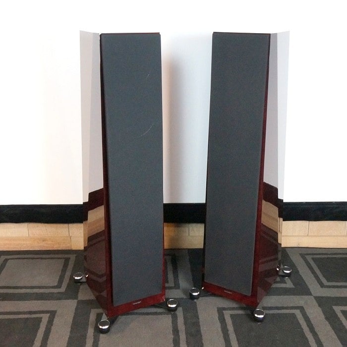

The Founders speakers are not inexpensive, but they do look every penny of their price, if not more. They look like true luxury items.
100F pair grilles3 100F pair14

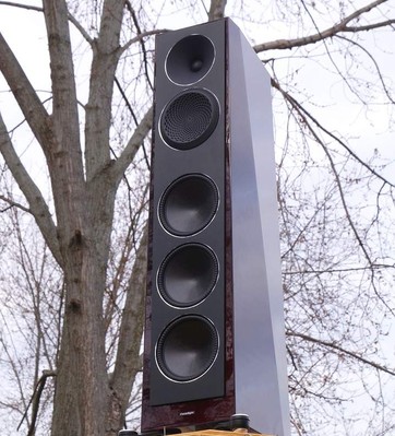

The pair that I received came in a “Midnight Cherry” wood veneer that is one of the nicest I have seen to date. The veneer is a deep reddish color with dark grain and has a highly polished finish. The cabinet holds a black finely brushed aluminum front baffle that the drivers are mounted on. The drivers themselves are attractive and almost look like jewelry embedded in the front. All of the drivers have a polished brass trim ring that gleams in the light. The tweeter has an intricately patterned ‘PPA’ lens cover and is mounted in a satin black conical waveguide. The midrange driver also uses Paradigm’s signature PPA covering that gives it an elaborate geometric pattern that is quite eye-catching. The bass driver cones have a streaking that looks like they were marbled, and they are encircled by a ribbed surround that looks like beading all around the cone. Of course, with the grille on, this driver array is all hidden by a flat, black fabric, and the grille dulls the appearance of the speaker considerably.
70lcr grille2 70lcr
The 100F speakers have a diagonal crease on the side which helps to make the speakers less boxy and more interesting. A small Paradigm badge hangs near the bottom of the front baffle and the speaker ends in black outriggers that are topped with metallic rings. I have to say that the industrial design of these speakers is outright beautiful, and they could fit in nicely even in a very high-end interior decor.

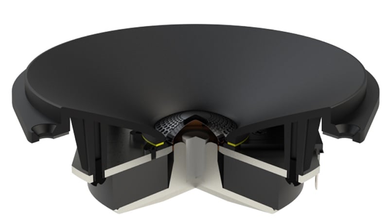

There is a lot going on with the Founders speakers. Both the speakers under this review have some significant differences, so we will just discuss the 100F speaker for now and then explain how the 70LCR differs afterward. To begin discussing the design, we will simply start at the top with the tweeter. The Founder speakers use a 1” dome tweeter made from aluminum, magnesium, and ceramic that they have termed AL-MAC.  The ceramic probably just comes from anodizing the aluminum which creates a thin layer of ceramic on the surface. In the past, Paradigm had been pretty insistent on using aluminum tweeters and even termed their pure aluminum diaphragms the X-PAL drivers, so the infusion of magnesium and ceramic is a slight departure for them. This combination of materials should push ‘break-up’ modes to higher frequencies with respect to pure aluminum. Break-up modes are when the driver diaphragm is moving so fast that it begins to deform and can not hold a stable shape. When the diaphragm loses its shape, the frequency response becomes very erratic and it can have negative audible consequences.

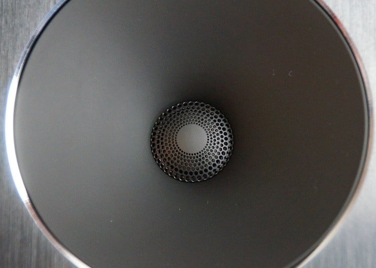

100f tweeter cut awayThe tweeter is covered by Paradigm’s PPA lens which looks like a small grille for the tweeter dome. PPA stands for “perforated phase-aligning” lens and it serves a function similar to phase plugs, in that they prevent frequencies generated by different areas of the cones from conflicting with each other which can happen at frequencies with a shorter wavelength than the diameter of the dome. In the pattern cut into these ‘driver lenses,’ we can see the larger holes start from the outer rim and become smaller as we move inward toward the center. Higher frequencies will be more affected by regions of the grille with smaller perforations, so they will be more greatly hindered by the central region of the driver lens. This means that the higher frequencies generated by the more recessed center of the dome will be blocked from interacting with those same frequencies that are generated by the more forward edges of the dome. Theoretically, this will help to keep all the sound generated by the dome to keep better phase-coherence which will make for a smoother frequency response.
The tweeter is mounted in a waveguide that Paradigm calls the “Oblate Spheroid Waveguide” (OSW). The naming and design of this waveguide draws from renowned loudspeaker engineer Earl Geddes’ research into waveguides. Earl Geddes is rightfully considered one of the world’s foremost experts in waveguide design, so Paradigm has turned to the right source in designing their waveguide. Given the source research used to derive this waveguide, we would expect the OSW to have a good degree of directivity control with a smooth off-axis response throughout the tweeter’s frequency band. With a smooth off-axis response, the speaker should have a more consistent sound over a wider area as well as lessening the need for acoustic treatments or equalization for optimal sound quality.
Something else to note about the tweeter is the use of an iron ferrite magnet in the motor instead of a neodymium magnet. Neodymium may be smaller and more expensive than magnetized iron, but it is more subject to heat build-up since its smaller surface area cannot disperse heat as effectively. The greater surface area of the equivalently powerful iron magnet can radiate heat more efficiently so the tweeter will be less subject to thermal compression than a neodymium motor.

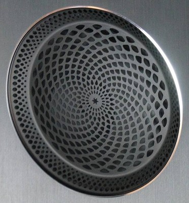

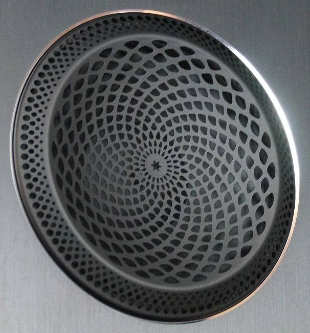

100f midrange  100f midrange ppa

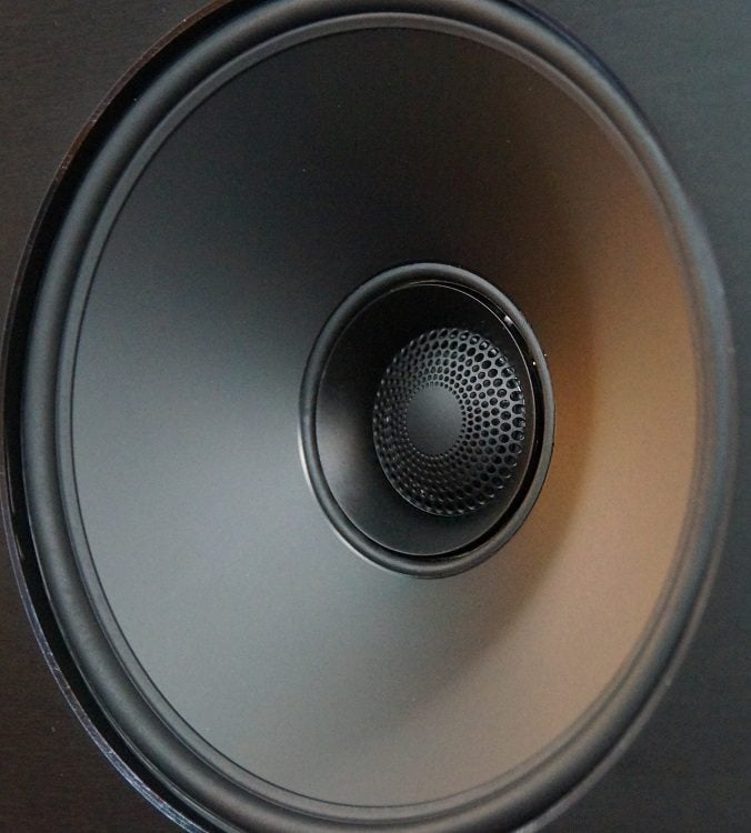

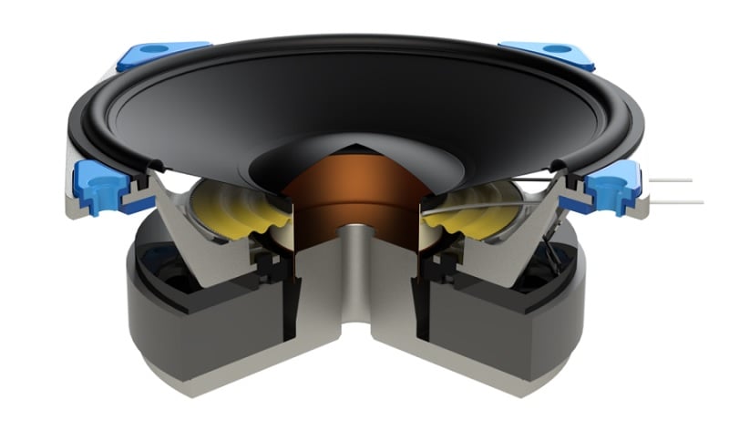

Moving down to the midrange driver, we can see that it is also using a PPA lens but obviously a much larger one. Aside from sorting out phase conflicts, the PPA lens would also seem to be a good protective barrier for the midrange driver, much more so than most grilles. The midrange cone has a 6” diameter and is made from an aluminum and magnesium mixture that Paradigm calls “AL-MAG.” This is not to be confused with the tweeter material that they call AL-MAC which uses ceramic in addition to aluminum and magnesium. Other notable features of the midrange driver is the 2” diameter voice coil on a heat-resistant polyamide former, a cast aluminum basket, and a vented pole piece; all of that should add up to a fairly robust driver.

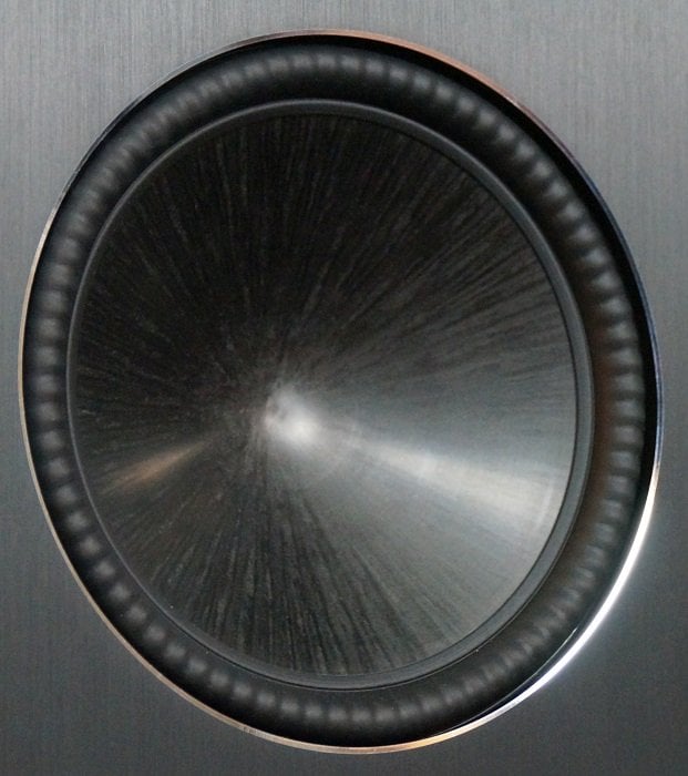

100f woofer
Moving on to the bass drivers, they look to be using a very large magnet around a 1.5” diameter voice coil that has plenty of room for excursion. The 7” diameter cones are made from a material that Paradigm calls CARBON-X (yes, it is all capitalized). CARBON-X is a single-piece cone construction that uses carbon infused with minerals, and the minerals must be what gives it that streaking color. Paradigm claims this material is very stiff, and it seems to be quite stiff in touching it. The CARBON-X cone is attached to a cast aluminum basket with a pleated surround that Paradigm calls the ART surround system, where ART stands for “Active Ridge Technology.”  Paradigm says the ART system allows for more headroom than conventional half-roll designs. When typical surrounds are stretched at high excursions, particularly in the inward-stroke, deformations can occur from the high tension, and these deformations can cause distortion or even tears in the surround. This ridged surround design by Paradigm supposedly reduces these deformations by directing material stress to points that can better cope with it due to the shape of the surround. Paradigm claims that ART allows 1.5 times the excursion for the same surround roll which can result in a 3 dB increase in headroom.

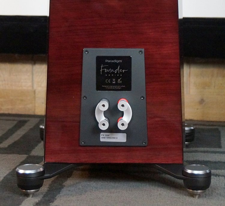

100f rear
The crossover circuit uses 2nd order electroacoustic slopes for both the bass driver/midrange crossover and midrange/tweeter crossover.  The crossover frequencies are 500Hz and 2.1kHz. 2.1kHz is a somewhat low frequency for a 1” dome tweeter, but such a low crossover frequency ensures a better directivity match with the 6” midrange driver. The tweeter has a pretty beefy motor and it is also assisted by a waveguide so it should be able to deal with that low crossover frequency. The 100F has dual binding posts and so has the option of bi-amplification. In most home audio loudspeakers, I think that the bi-amplification ability is nonsense, but I am almost willing to give the 100Fs a pass here since three heavy-duty 7” bass drivers should be capable of a lot of power handling. Paradigm’s “Maximum Input Power” spec for the 100F is 250 watts. That is a fair bit more than what most AVRs are capable of. For those who want a bit more dynamic range and have the extra amplifiers handy, bi-amping looks to be a reasonable choice, although if possible I would just get one serious amp to drive the entire speaker as one circuit and avoid the complications of bi-amplification.

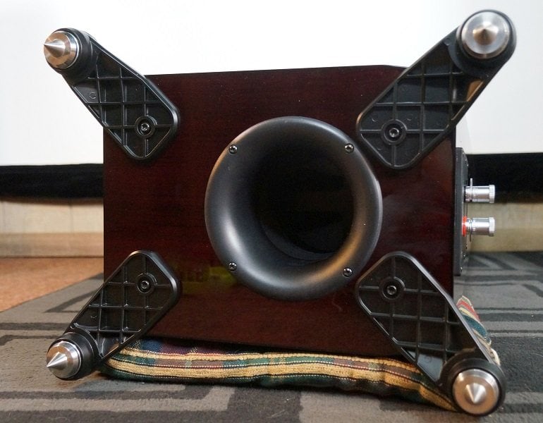

100f port
A 7 ½” deep port with a 4” diameter is mounted on the bottom of the speaker to give provide deep bass. That kind of length-to-width ratio would not suggest an extremely deep tuning point, and I wouldn’t guess that the 100F speakers would extend below 30Hz from just knowing those dimensions, but we shall see the port tuning frequency in the measurements section. The decision to mount the port on the bottom would help to give it some additional loading from the floor boundary.
The feet are some very sharp spikes mounted on metal outriggers that have to be assembled upon unpacking. The user can omit the spiked feet and just use the rubber discs above the spiked feet. The spiked feet are only useful for carpeted surfaces unless you use the discs that protect hard flooring. If the user slipped with lifting the speakers, the spikes could leave a significant gash in any hard flooring. I wish loudspeaker manufacturers would stop using spikes like these. Their only advantage is that they don’t leave an impression on the carpet from a long-term placement. Spikes haven’t been shown to lead to any acoustic advantage whatsoever (read our article: Speaker Spikes and Cones - What’s the Point?). They just make the speaker more unwieldy to set up and a potential hazard to homes that have children. However, one thing I do like about the feet is that their depth can be adjusted by a knob on top of the feet so that all four feet can make solid contact on the floor even if the floor is uneven.

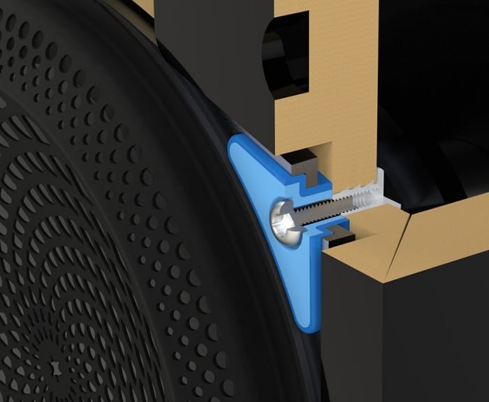

shock mount bracingAnother design decision that I have to question the efficacy of is Paradigm’s “Advanced SHOCK-MOUNT Isolating Mounting System” - and yes, the capitalization is again from Paradigm. In this system, the drivers are mounted to the cabinet with a bracket that has an elastomer cushioning which provides a layer of damping so that the movement of the drivers is not mechanically transmitted to the cabinet. The problem with this system is that now the drivers are not going to have as rigid of a mounting system as they would have had otherwise; the cabinet is supposed to absorb the vibrations caused by the drivers. The cabinet should be constructed well enough so that those vibrations do not become a problem, and the Founders cabinetry definitely looks good enough in that regard. But by having a soft-mounting system for a driver, the driver itself would be vibrating more, which is far from ideal. This looks to be a solution for a problem that can potentially be much worse than the problem itself - and I don’t think there was really an existing problem to begin with.
Editorial Note by Gene DellaSala
Speaker manufacturers often gasket their drivers to create a better seal while also minimizing conductive resonances on the front baffle so I can appreciate Paradigm’s unconventional approach here. If we put aside the argument about the isolation benefits of Paradigms new “Advanced SHOCK-MOUNT” system, there are two-fold benefits from serviceability and assembly standpoints.  The weight of high-quality drivers like the ones used in the Founder series have a tendency to strip lesser threaded inserts upon assembly or servicing. Paradigms approach should minimize this concern and in fact upon speaking with them, they did tell me it does prevent over tightening of the drivers during assembly.

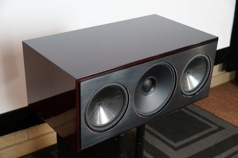

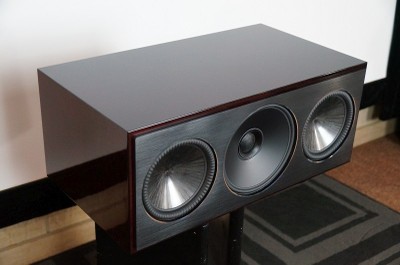

70lcr4

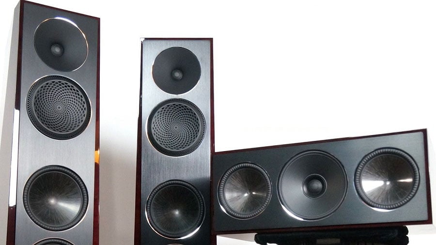

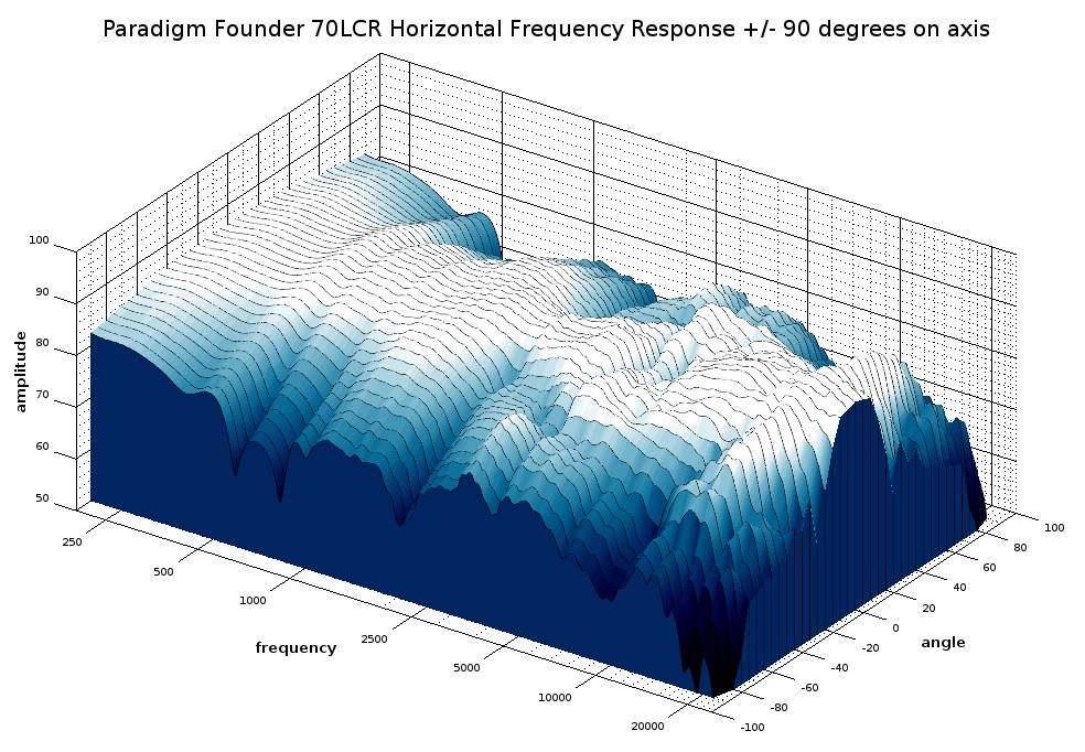

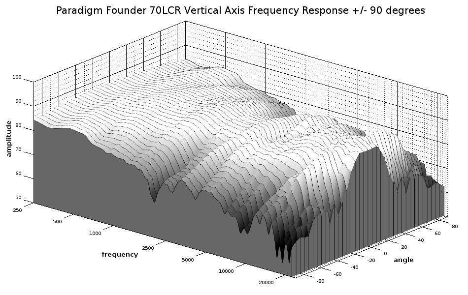

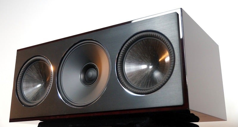

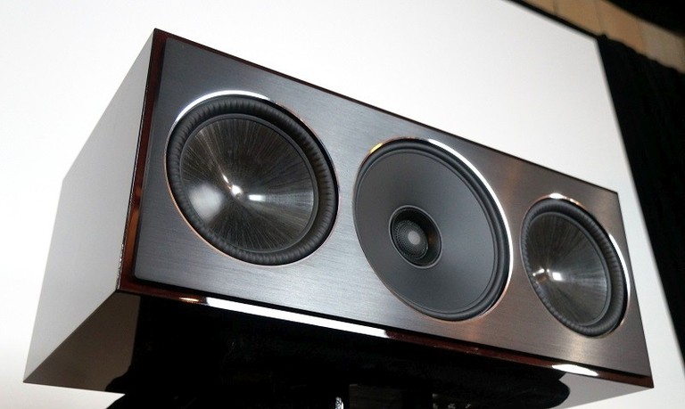

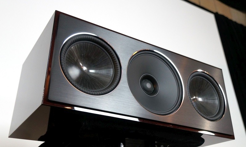

The 70LCR is an interesting and uncommon design that deserves a separate discussion. It can be used as a center or front left/right speaker, hence the name ‘LCR.’ There are other speakers that have been designed with that use in mind, but the 70LCR’s design holds an advantage that makes it better for this type of use than most other LCR speakers: it is a 3-way design instead of a 2-way design. The reason why that is advantageous is that the dispersion pattern will not change as much from laying it down horizontally or standing it up vertically. That is not at all the case with most MTM (midwoofer-tweeter-midwoofer) speakers, because they change their character a great deal just from this simple orientation switch.  Essentially, if you change the orientation of a normal MTM speaker in this manner, it can’t really be considered the same speaker.
The Founder 70LCR achieves a 3-way design by using a coaxial driver for the tweeter and midrange driver. Sometimes also called concentric or coincidental drivers, coaxials work by nesting the tweeter in the center of a woofer. The advantage here is that there is no distance difference between the points of acoustic emission of the tweeter and woofer, so there are no off-axis points where they are not in phase with each other. Any time drivers are separated by distance, there will be a phase conflict relative to the wavelength of the distance difference. This manifests itself in major gaps in the frequency response at off-axis frequencies where the distance difference between the drivers can become substantial. In other words, if you are listening to a speaker where the drivers do not have equal spacing to your listening position, you could be missing big chunks of the sound. We mostly see this as an issue in horizontal center speakers that simply place a tweeter between two woofers (the above-mentioned “MTM” design). With such speakers, if you are not seated in a dead-ahead direction with respect to the speaker, you could be missing a great deal of sound, especially in the critical speech band which can really hurt dialogue intelligibility. The 70LCR shouldn’t have this problem at all.
70lcr coaxialMuch of the driver technology is the same as the rest of the Founder series, including the CARBON-X woofers, the AL-MAG midrange cone, the AL-MAC tweeter dome, and so on. The major change is the motor topology of the midrange driver and tweeter; the magnetic fields of the driver motors being so close to each other is bound to be a source of complication. Paradigm says they have addressed this with something that they call the Dual-Sync Continuous Flux Motor, but they haven’t explained how it works. Another change is that the midrange cone serves as the waveguide for the tweeter, so it takes on Paradigm’s OSW geometry to do so.

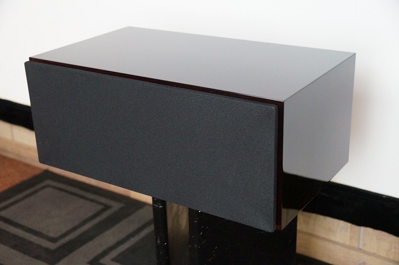

Since the enclosure is intended to be used in either a vertical or horizontal orientation, there is no front badging that would make it visually awkward for either set-up. The binding post plate is aligned for horizontal orientation, but that doesn’t affect the operation of the speaker at all. The 70LCR is a sealed enclosure design, and that is a sensible choice considering this speaker will probably mostly be used as a center speaker. Most center speakers are placed in a quarter-space placement where they are near two surfaces, and that can induce a lot of boundary gain in low-frequencies, so the speaker isn’t likely to miss the extra bass from a port. What is more, using a ported design would necessarily make the speaker larger, and many people have trouble finding space for their center speakers as it is. The sealed design makes the 70LCR more versatile for placement. However, it probably would stand to benefit from the addition of a subwoofer more than a ported design for those looking to use it as a full front-stage set.

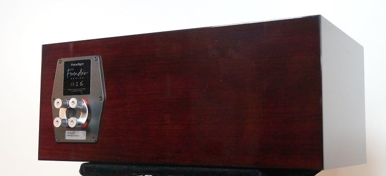

The 70LCR has dual binding posts, so the user can opt to separately amplify the bass drivers if they wanted. I don’t think the bi-amping ability is warranted in this case. Given the specs of this speaker, it isn’t likely to be able to take more than a couple of hundred watts continuously. If you need that kind of headroom, there are a lot of amps that can put out that much, so why get into the extra complexity and thus potential problems of bi-amping? And don’t even get me started on “bi-wiring.”
70lcr rear
Since subwoofers are so ubiquitous, speakers like the 70LCR are something I would like to see more of: high-output stand-mount speakers that leave deep bass duties to the subs. These types of speakers have most of the dynamic range of tower speakers without the size or extra cost. Most people, especially in the home theater hobby, already have subwoofers and are likely crossing over the deep bass around 80Hz, and that negates the need for the bass extension advantage that towers have over stand-mount speakers. With no need for the extra bass extension, the only advantage that tower speakers have over stand-mounts is the extra dynamic range, but the 70LCR isn’t likely to be at a serious disadvantage against the Founder tower speakers or most other home audio tower speakers when bass below 80Hz isn’t being considered.

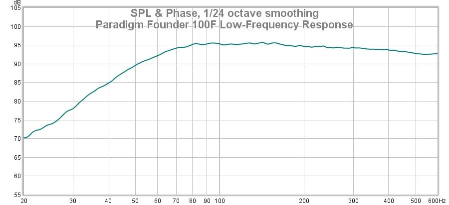

For something that could show off the Founder 100F’s dynamic range as well as their bass extension, I found a killer dubstep album in “Collapse” by Levitate. This is another terrific release from Division Recordings that explores new sounds and new ideas in music within the context of electronic bass music. As would be expected from this genre, these tracks are heavy on bass and utilize substantial compression for loud playback. While it is a bit on the experimental side, it still is intended to be played loud, and so that is what I did in order to see how the Founder speakers would react to a high drive level.
One thing I found out right away was that the 100Fs can easily get louder than I can tolerate. My amplifier can only put out 120 watts per channel but that was more than enough to blast me out of my seat like the guy in the Maxell advertisement. Even at these elevated levels, I didn’t hear anything unintended such as distortion or compression. While these aren’t huge tower speakers, I do think they have sufficient dynamic range to handle a large room. Their bass extension seemed to be fine, but I do think that subwoofers would have brought a bit more lower-end grunt to the deeper notes in some of these tracks. There is deep bass output, but not quite on the level of mid-bass output. My guess is that the speakers are a bit over-damped in the low end in order to prevent too much boost from boundary gain. Unfortunately, the stand-off distances that I have for these speakers (about 4’ from the backwall and 3’ from the side walls) leave them a bit dry for music with substantial deep bass. I also think they give up a bit of extension for more dynamic range which isn’t a bad trade-off depending on the circumstances and  intended use. We will get a closer look at their extension in the measurements section.

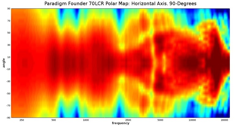

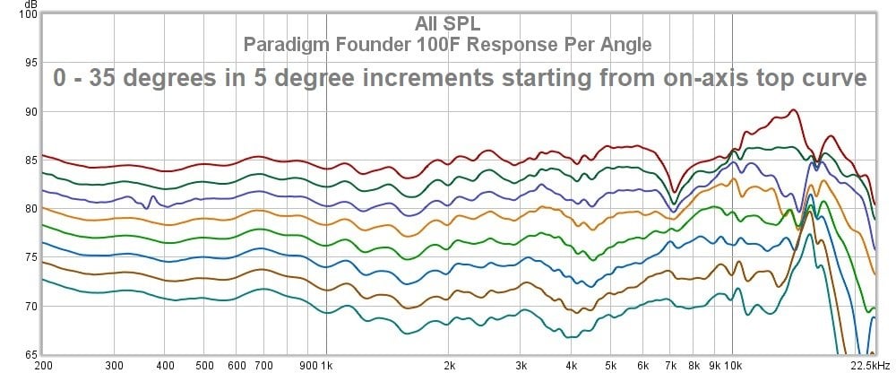

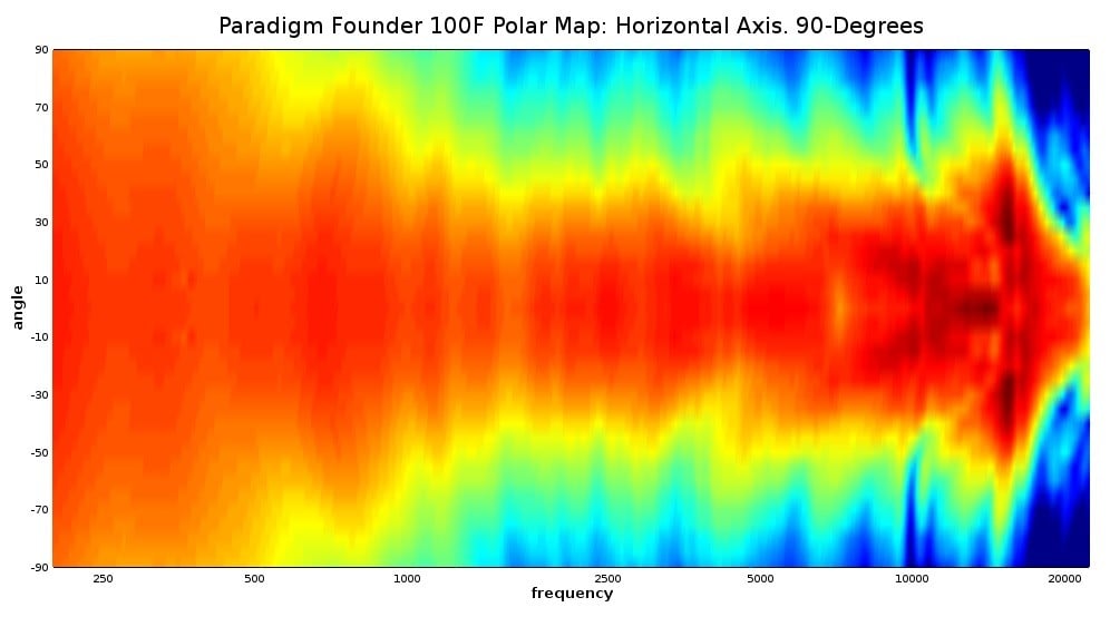

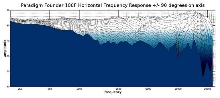

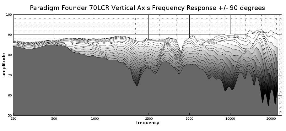

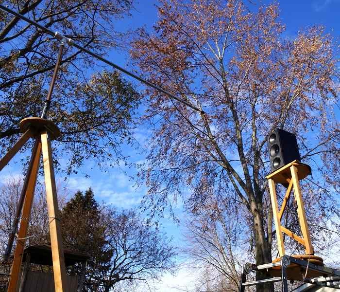

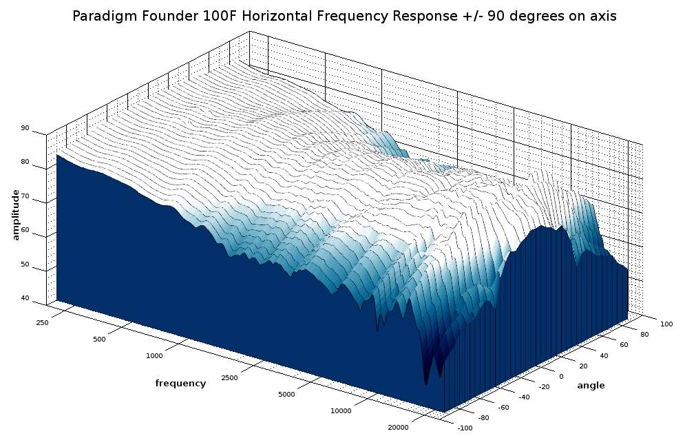

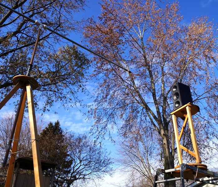

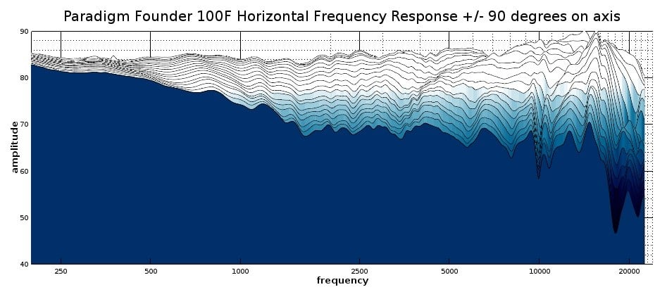

I don't so spin on tower speakers because I don't have a way of testing the full circumference of a tower speaker on its longitudinal axis without messing the speaker up. However, the data I do provide is, in some ways, more useful than a spin-o-rama graph.
The polar map of the 100F is good and certainly better than average. Yes, it would sound different than the Revel F208.
buckchester, post: 1531868, member: 78944
The polar map doesn't look great on the 100f. Do you think if you listened to it side by side with something more neutral, like a Revel f208, you would notice the difference?
