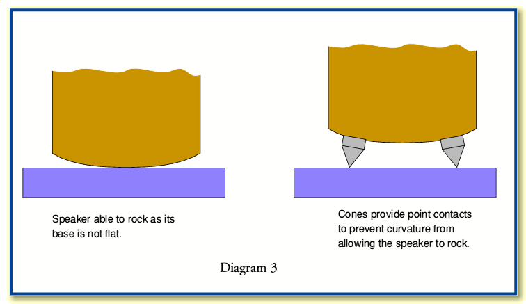

From the explanations given above it seems reasonable to expect spikes on a speaker stand to be capable of having an effect. So what about cones between a speaker and its supporting stand? For our second example, let’s look at diagram 3.
Diagram 3
Engineers are often asked to produce flat surfaces. Alas, ‘flat’ is a nice theoretical ideal, but can sometimes be awkward to obtain in practice, especially when objects are being subjected to various forces which have the effect of bending or distorting their shapes. Diagram 3 illustrates this by considering what happens when the bottom of a loudspeaker unit isn’t actually flat, but bulges downwards in the middle.
Ideally, if both the bottom of the speaker and the top of the stand are flat, they will make firm contact over a large area. The system would then be fairly stable, and would efficiently link forces and vibrations between the two. However if the bottom of the loudspeaker is curved then it might not remain stable on the stand. The curvature shown on the diagram is exaggerated for the sake of clarity, but should indicate what would then happen. With a curved base, any sideways forces would cause the speaker to wobble back and forth on top of the stand. However if we place some cones in between the speaker they act as ‘legs’ to support the speaker in a few locations. This means we can now remove the effect of the underside of the speaker not being flat, and the result may be stable again. Hence cones may improve the stability of the speaker-stand combination by removing any problems due to the surfaces not being flat.
As with the spikes on the base of the stand the cones would, in principle, act here by giving a firmer and better-defined mechanical link, so do not “isolate” the speaker when behaving as described. In practice, however they may not always be required when used with decent loudspeakers and stands. The reason for this is that – although not perfectly flat – the surfaces of the speaker and stand may be flat enough that when they press together their elasticity allows them to deform and come into contact over most of the surfaces. Hence in practice, the surfaces may often be flat enough for any imperfections not to matter.
