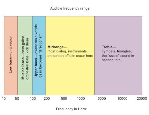

Now is a good time to present a few basic definitions for the sake of this conversation. We’ve talked a lot about bass, midrange and treble, so let’s define more precisely what we mean. Sound waves that vibrate or oscillate through the air are measured in cycles per second, or Hertz (named after German scientist Heinrich Hertz), commonly abbreviated as “Hz.” The frequency of sound waves audible to humans range from 20 Hz in the bass to 20,000 Hz (20 kHz) in the treble. (Well, women and young children can hear that high; a middle-aged man is lucky to make it much past 13-14 kHz. Your grandfather needs his hearing aid because his ears are toast by 3 kHz. That’s why he’s always saying, “Huh?”) See figure 1 for an explanation of what we generally refer to as bass, midrange and treble, expressed as Hz (LFE stands for “low-frequency effects”).
Audible Frequency Range
As you can see, the midrange—from roughly 200 Hz to 3,000 Hz—is where most of the “action” takes place. If an audio device can cover this range with reasonable accuracy, then people will regard it as doing a pretty good job of conveying intelligible information. Most TVs, phones, AM radios, PA announcement speakers in supermarkets, etc. cover this frequency range. It’s a wide enough frequency range that people can easily understand what is being said or recognize musical melodies, but it’s nowhere near wide-ranging enough to be considered high fidelity.

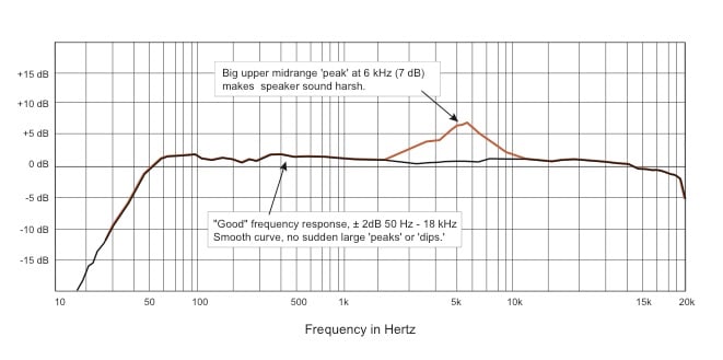

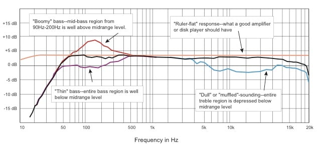

For that, the audio device—in this case, speakers—must be able to reproduce far deeper into the bass and reach much higher into the treble. However, the range of frequencies covered by an audio device is just part of the story. Just as important—even more so—is the concept of flat, accurate frequency response.
