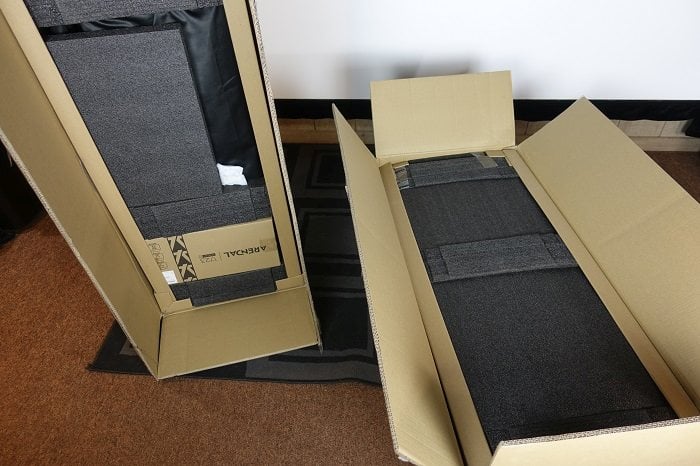

the Arendal packing was some of the best I've seen.
The 1723 S Towers arrived at my house on a heavy-duty plastic pallet. The boxes were secured to the pallet and covered in a plastic wrap and had security tape lining the edges. There were edge protectors and corner protectors on the outside as well as the inside of the boxes. Inside the boxes, polyethylene foam blocks sandwiched the top and bottom of the speakers, and there was a foam stand-off piece in the middle. In addition to that, there were polyethylene sheets on the inside of the box protecting nearly the entire surface of the speaker. The speakers were covered in a fine fabric drawstring sack that felt like rayon. Inside the boxes, white gloves were included for handling the speakers so as not to get any fingerprints on the gloss finish. The overall packing was some of the best I have yet seen, and the packing nearly prepares these speakers for war. It seems that Arendal really doesn’t want to deal with damage claims with shippers, and they have prepared their speakers accordingly.

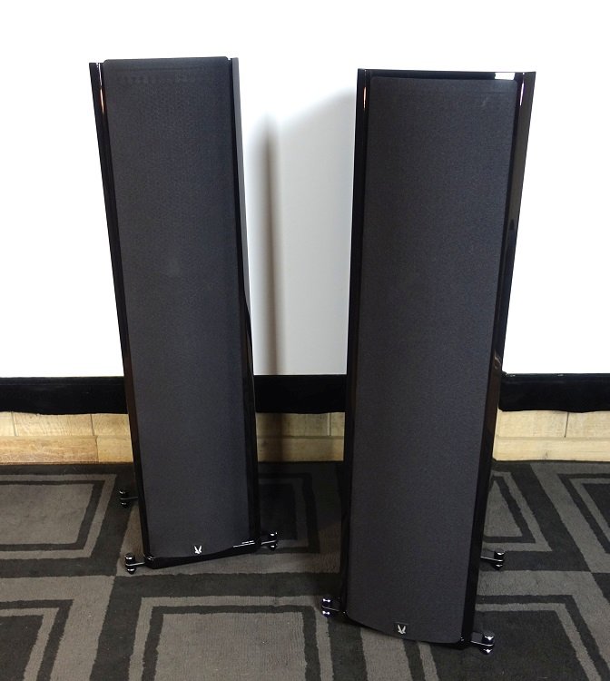

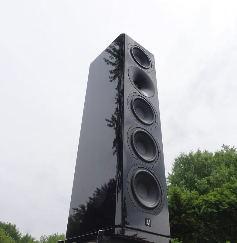

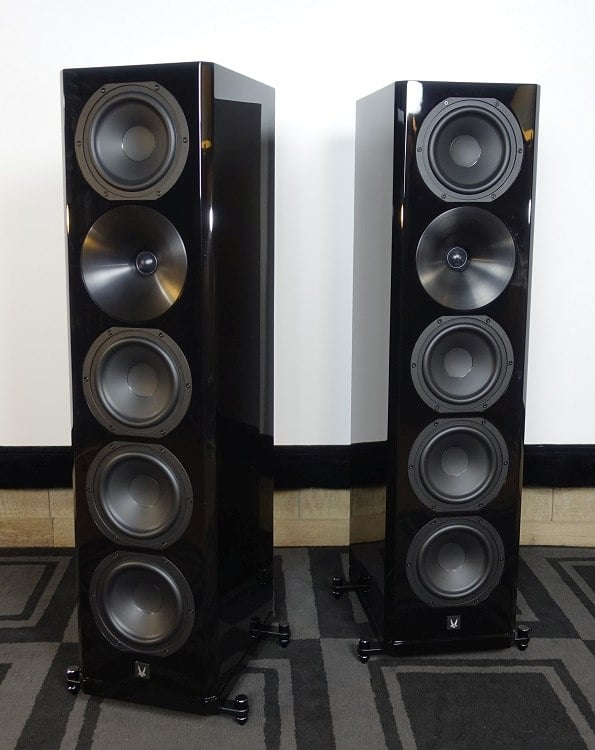

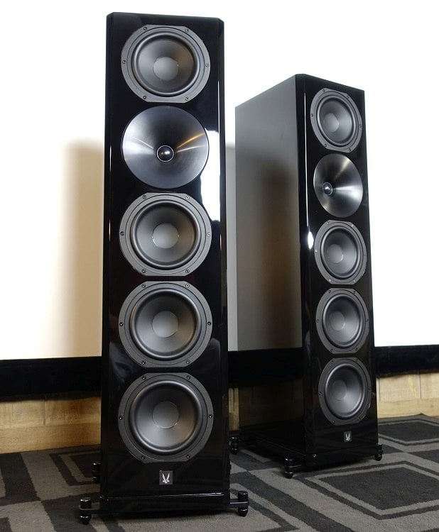

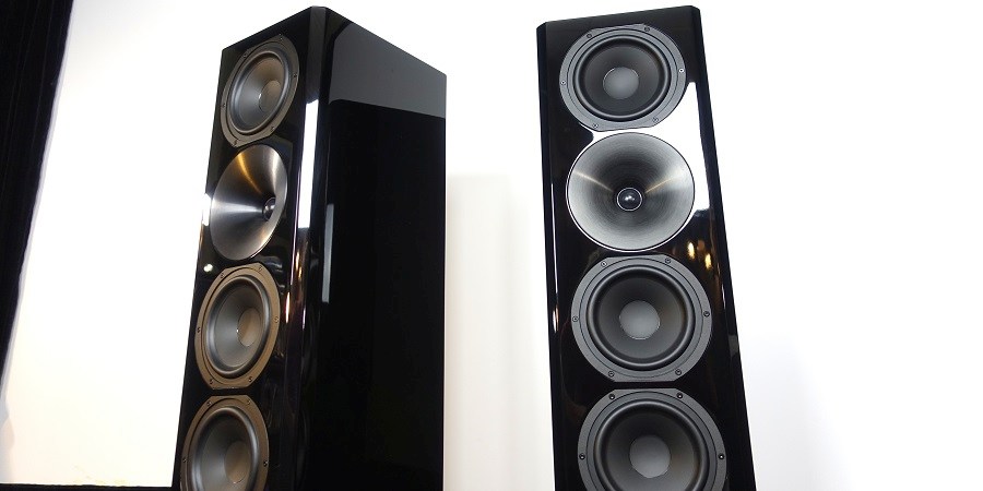

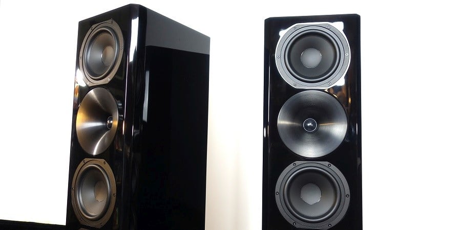

Once unpacked, the 1723 Tower S speakers stand as gleaming gloss black towers with five front-facing drivers that look primed to do battle. The vertical edges are beveled, and the base has a slot, and these details help to give the 1723 Tower S some style. It looks somewhat stately, but with all of those exposed drivers, it looks muscular as well, so the car analogy would be something like a luxury performance vehicle. A large magnetically adhesive grille almost totally hides the front baffle for a much more subdued appearance for those who don’t want to see drivers. The grille has some curvature as well as an Arendal badge at the bottom so it still keeps a touch of style instead of just blanking out the speaker like so many other grilles do. Much like Arendal’s other products we have reviewed, the 1723 S Tower smacks of solidity and quality, with a solid aluminum waveguide and finely machined aluminum outriggers, as well as HDF construction and a brushed aluminum backplate. These speakers look nice, and, much like the 1723 Monitors I reviewed before them, they do look like they should cost more than what they do.

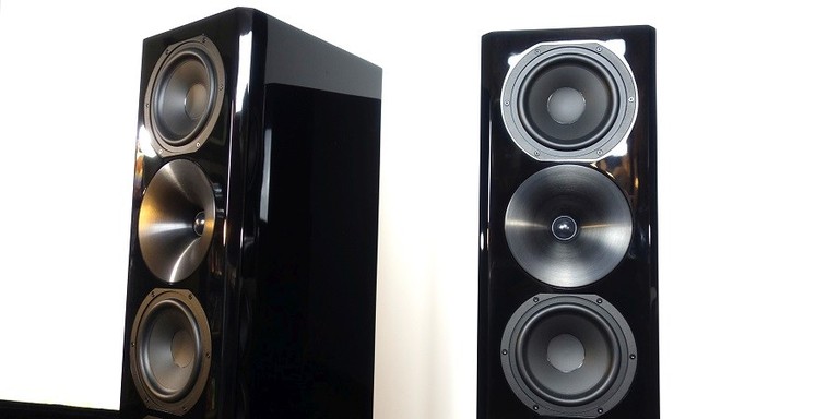

If the 1723 Tower S were to be summed up in a single sentence, I would call it a 2.5-way floor-standing speaker using four 6.5” woofers and a horn-loaded tweeter. But there is far more to a speaker like this than base specs. Each component has many noteworthy design characteristics that make these speakers more sophisticated than the everyday tower speaker. Let’s get into the nitty-gritty by first talking about the tweeter. Since the tweeter is largely the same as was seen in the 1723 Monitor, we will just quote ourselves from that review:

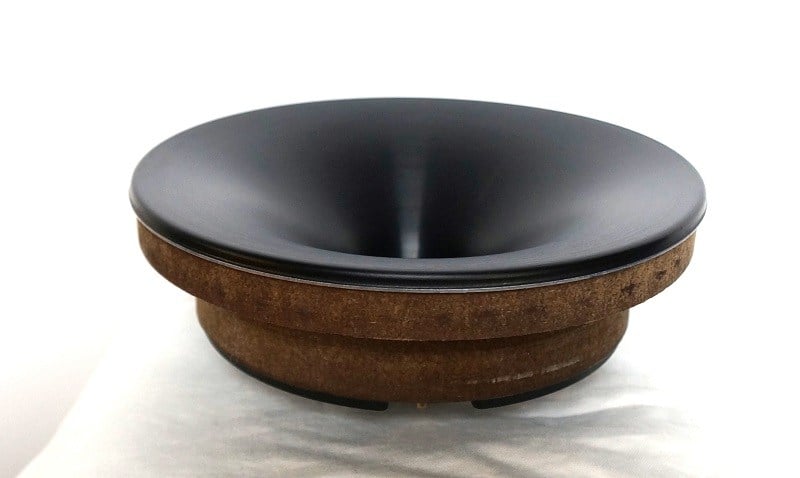

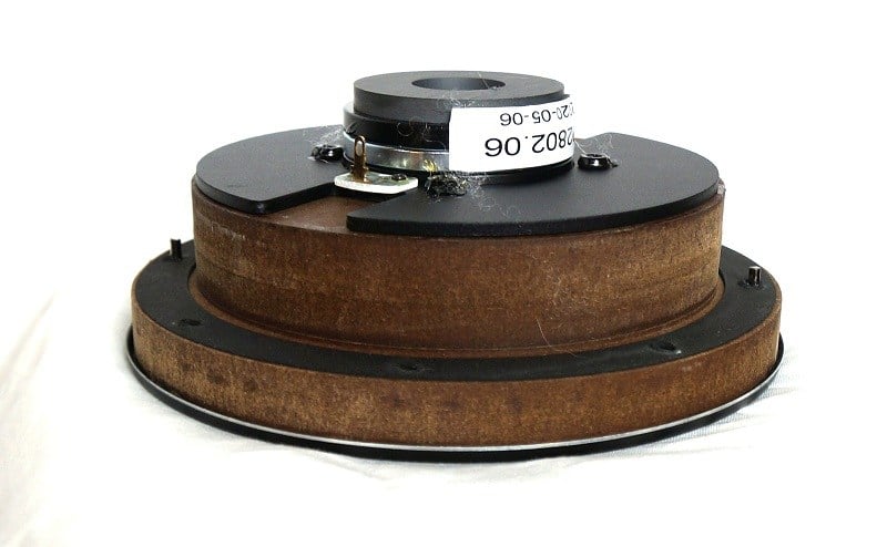

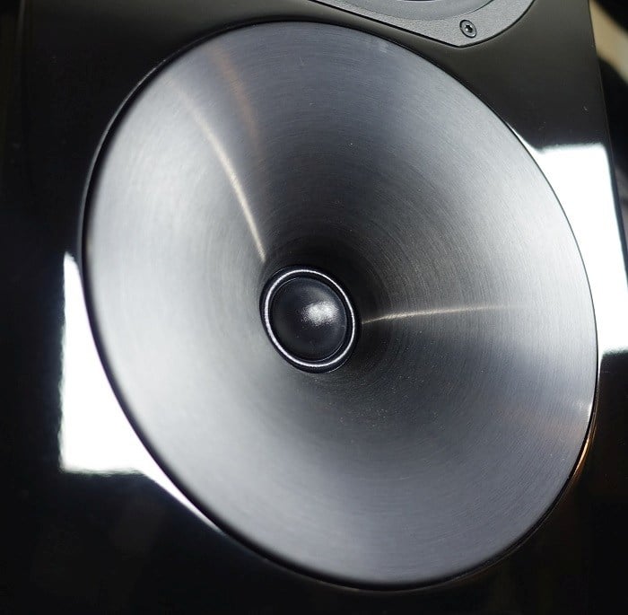

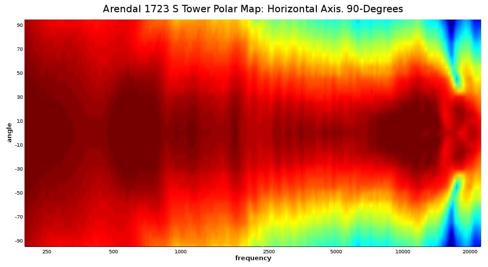

The tweeter is a 1.1” synthetic soft dome loaded into a spherical aluminum waveguide. The waveguide should help control dispersion by constricting the lower end of the tweeter’s band but also widening the high end. This is done so that the dispersion remains more consistent than what normally occurs for dome tweeters without a waveguide, which is a very wide dispersion at their lower end that ends up becoming narrow at the top of the tweeter’s frequency range. Arendal’s literature states that the tweeter uses a neodymium ring magnet, copper and aluminum shorting rings, ferrofluid cooling, as well as an aluminum heatsink and a damped rear chamber to mitigate resonances from backwave radiation.
1723 S tweeter2
Removing the tweeter, we can see that the waveguide is reinforced by some MDF-type wood that must have been CNC cut to shape to fit. We also see that there is a bucking magnet on the back of the tweeter, possibly to help contain the magnetic field of the neodymium magnet in the motor. The neodymium magnet is a very large one and holds an extremely powerful magnetic field. This is a very heavy-duty tweeter that should be capable of a far greater dynamic range than a normal dome.

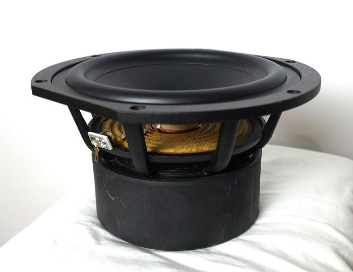

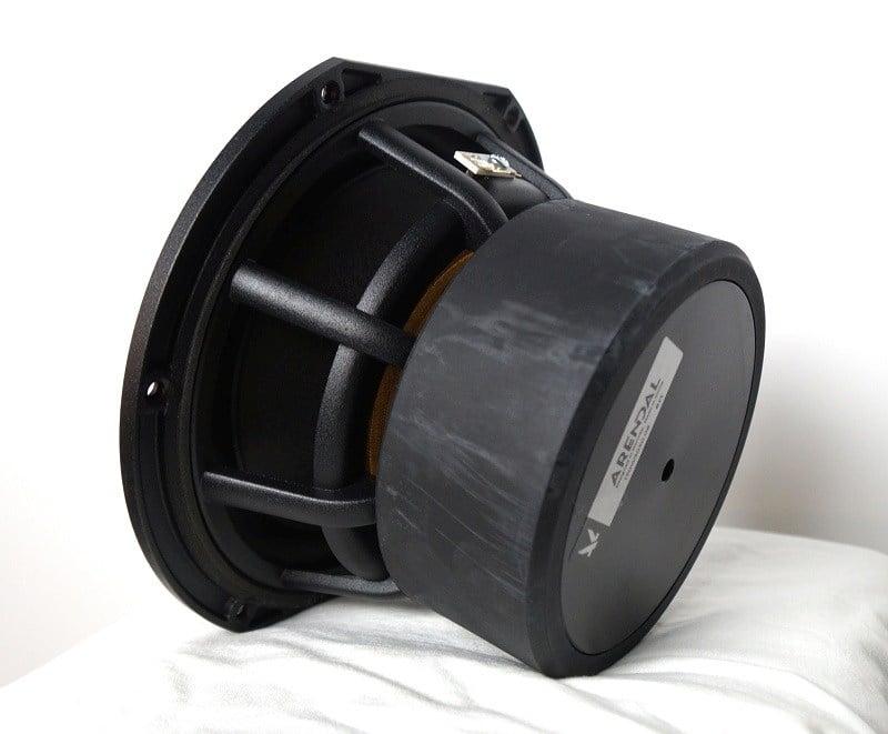

The four 6.5” woofers of the 1723 Tower S speakers use long pulp fiber cones with an inverted dustcap and a nitrile-butyl rubber surround. The suspension has been optimized using finite element analysis for linear travel in both directions. The voice coil uses copper-clad aluminum wire for a good balance of low weight and conductivity. The motor uses a 1 1/8” thick double stacked magnet with a 4 ½” diameter, a very beefy magnet for a 6.5” driver (although what really counts is the actual magnetic field strength in the voice coil gap rather than the magnet size). It also has an aluminum shorting ring for the purpose of lowering induction effects. The surface area of four 6.5” woofers is about equal to a 13” woofer, so the speaker as a whole should be capable of a lot of displacement in bass frequencies.

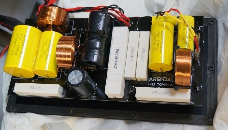

1723 S crossover circuit rotated
1723 S rearThe crossover circuit uses fourth-order electro-acoustic slopes on the tweeter and woofers at 1.5kHz. The lower two woofers are low-pass filtered at 100Hz, which is an unusually low crossover frequency for a tower speaker. The phase rotation of such a low crossover might make it tricky to precisely integrate a subwoofer for those who intend to do that. In fact, crossing these over a subwoofer would give the bass drivers such a small bandwidth that it wouldn’t be worth it. I would calibrate these to be used as a full-range speaker if I wanted to use a subwoofer. So I would not run the 1723 S Towers as ‘Small’ speakers. The crossover circuit itself uses higher-performing parts such as heavy-gauge air-core inductors, polypropylene capacitors, high-power resistors, thick PCBs, and twisted-pair multi-strand wiring. It’s a heavy-duty crossover circuit with the kind of build quality we have come to expect from Arendal.
The enclosure is made from HDF (high-density fiberboard) which helps to make these medium-sized tower speakers feel heavier than their size. The front baffle is 1” thick and the side panels and bracing is also 1” thick. The cabinet is chocked full of acoustic damping stuffing, indeed there might be more in these cabinets than I have seen in almost any other loudspeaker. The grille is a perforated metal sheet wrapped in black fabric. It adheres to the cabinet magnetically, and the magnet has a fairly strong grip, so even though it’s a relatively heavy grille, it will not fall off easily. The feet are mounted on some solid metal outriggers, and users have the option of using either rubber half-domes or metal spikes. The rubber feet are obviously the choice for hard flooring whereas the spikes might be a better idea for carpeted surfaces.

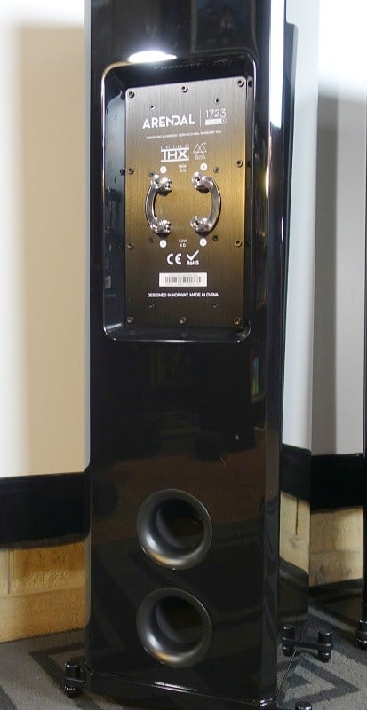

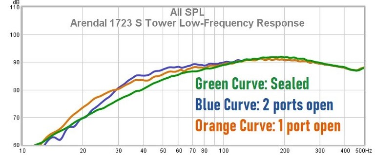

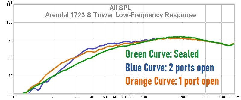

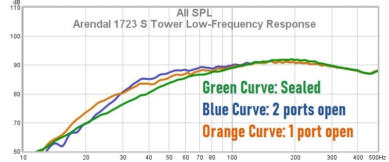

There are two rear-mounted ports with an approximately 2.6” diameter and a 6.5” length that are flared on both ends. Arendal provides port plugs that enable the 1723 S Towers to have variable port tuning as well as a sealed operating mode. Leaving both ports open will allow the widest dynamic range in bass frequencies although it won’t dig quite as deep. Sealing one port will give up some headroom but lower the extension so the user can get some deeper bass. This mode might be better for those users who don’t push the speakers very hard and have a smaller room. Sealing the ports will reduce both output and extension. The only real reason to seal the ports on a speaker like this is to get it to blend better with a subwoofer if there are some integration problems. Most people are better off not sealing any of the ports on this speaker.

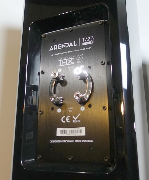

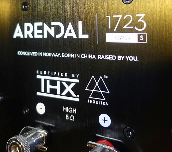

The speaker connections are high-quality polished rhodium binding posts mounted in a large brushed aluminum backplate. Two sets of binding posts allow the user to bi-wire or bi-amp the speakers. While it’s usually more advisable to use a single amp for the vast majority of home audio speakers, the 1723 S Towers could probably use a fair bit more power than what a typical AVR can deliver, so for more headroom, bi-amping looks like a viable option for this particular speaker. There is rarely ever a good cause to bi-wire a speaker, so just don’t do that.

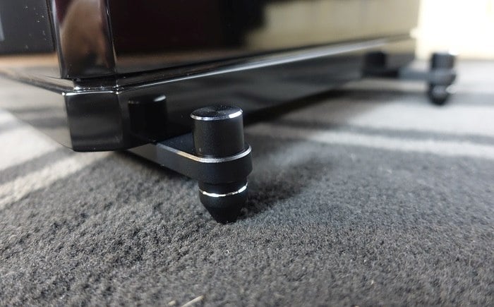

The good news is that 1723 S Towers keep the same incredible level of build quality as the 1723 Monitors that I reviewed before. They are not inexpensive speakers, but I wouldn’t normally expect this level of build quality at this price point (well, maybe from Arendal I would, but they have raised that expectation for themselves). What we should expect from a design like this is a good balance of dynamic range and bass extension. Now let’s see if they can deliver that in some actual listening…
