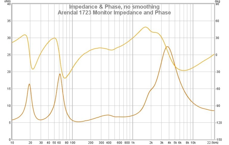

  • Impedance: 4-ohm nominal
  • Recommended Amplifier Power: up to 400 Watts RMS @ 4 ohms

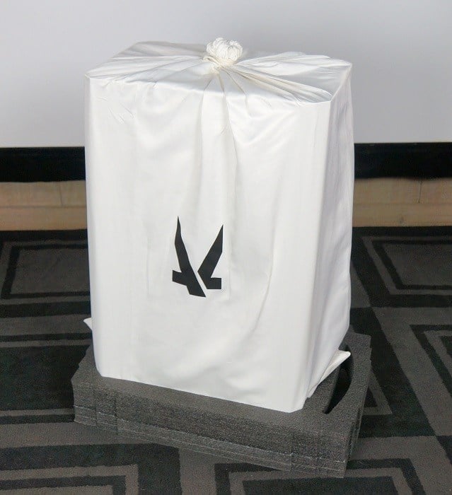

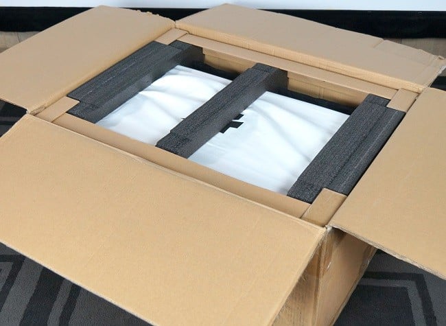

Packing was good for the 1723 Monitors, but it needs to be since they all ship by parcel post from their warehouse in the Netherlands. They were packed in a sturdy cardboard box with edge protectors all around. They were sandwiched between two polyethylene pieces with another piece protecting the middle - a good idea for the shape of this speaker. Inside, the speaker was covered in a drawstring rayon sack to protect it against scuffing and moisture, a very elegant touch! Furthermore, they come shipped with cotton gloves to handle the speaker without leaving fingerprints on the finish. That is certainly going the extra mile and shows pride in their product.

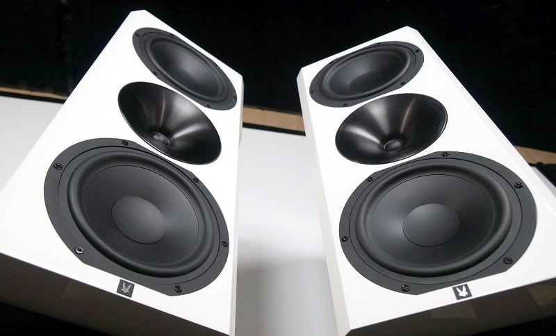

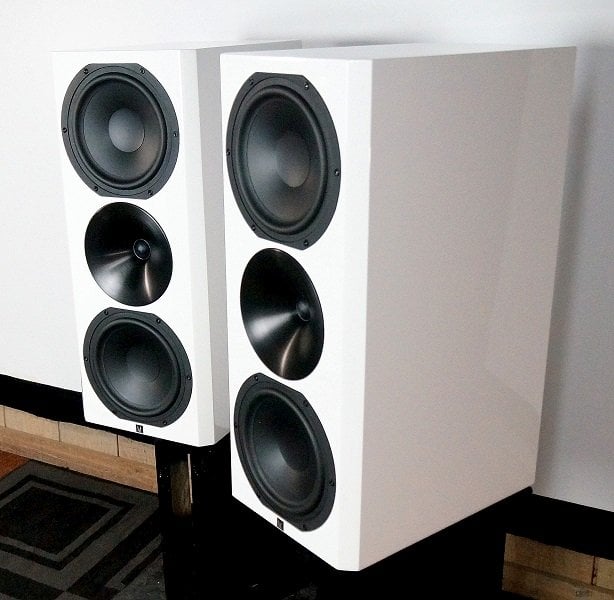

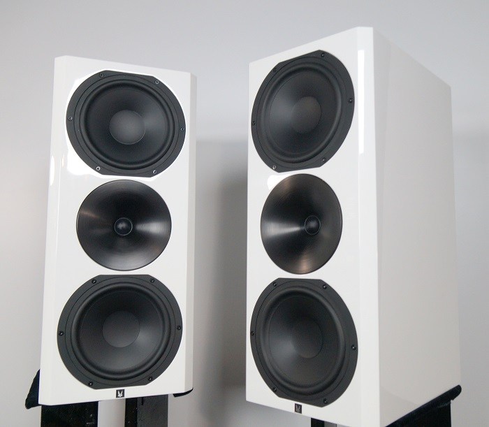

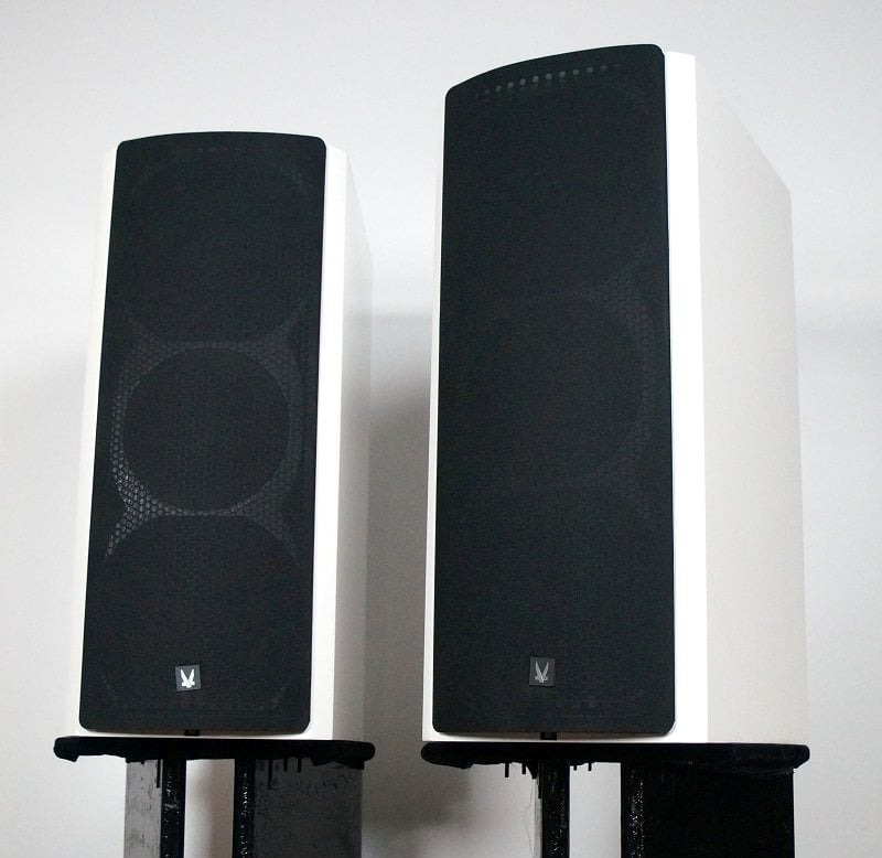

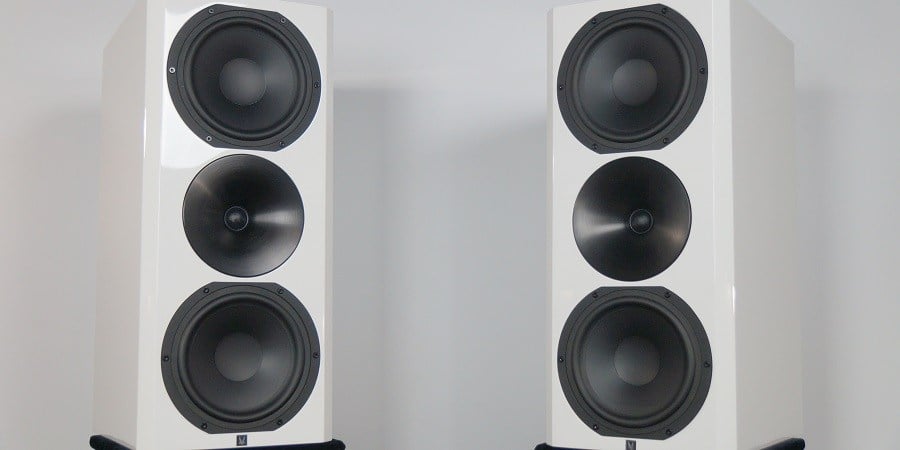

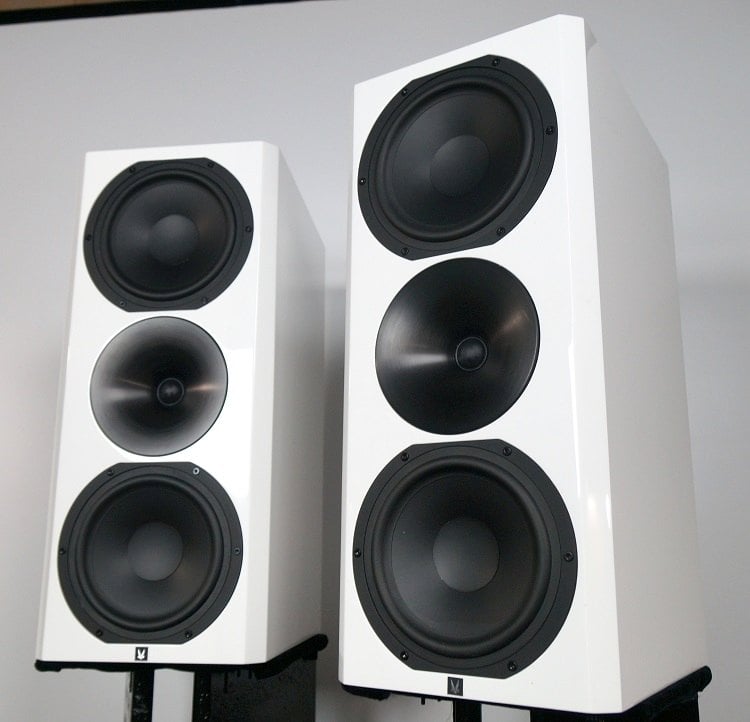

Once uncovered, the 1723 Monitor is quite an attractive speaker of its type, that being a large stand-mount speaker. It had an unexpectedly fine gloss white finish over a front baffle with beveled edges and some sleek-looking drivers. The bass drivers had a clean, satiny luster, and the tweeter had a similarly silky sheen mounted in a brushed aluminum waveguide. There are included grilles that use magnetic adhesion, so there are no grille guides on the front baffle, which preserves a very clean look. The grilles have a light rounded shape so they look a bit nicer than just black fabric hung over a frame, although I think the speaker looks nicer without the grille. The rear-mounted binding post plate also had a brushed black aluminum finish with rhodium-plated binding posts and jumpers. Overall, it’s big but very classy-looking. The 1723 Monitor also comes in a matte white, matte black, and a gloss black finish. Not having seen the other finishes in person, I have to think that the gloss white would look the nicest, but given the stylistic sensibilities seen here, I am sure they all look very nice.

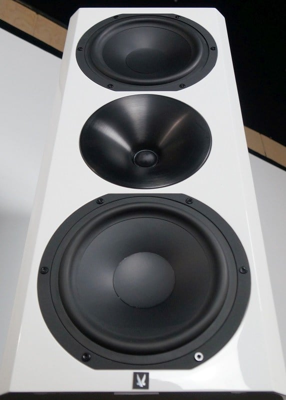

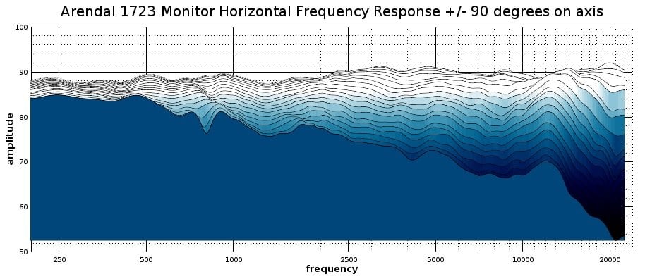

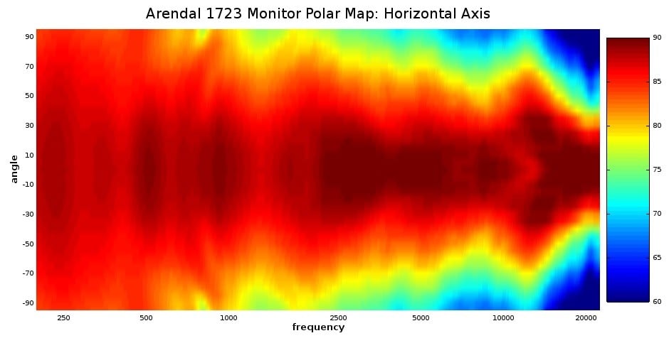

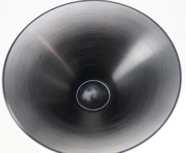

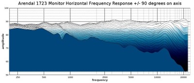

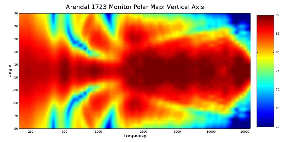

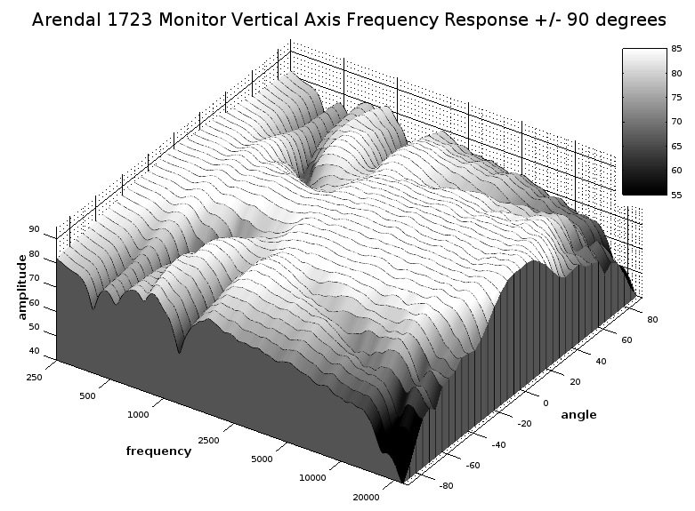

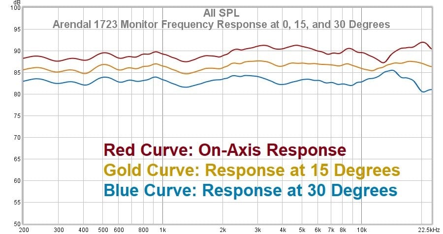

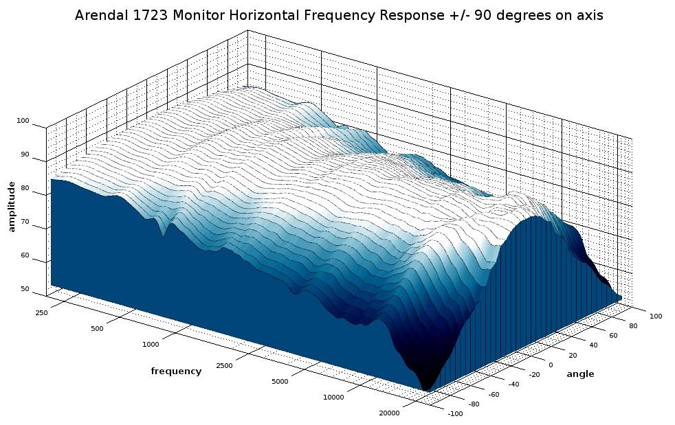

1723 tweeter2The 1723 Monitors are a two-way MTM design using 8” woofers and a waveguide-loaded dome tweeter. The overall design, as well as the THX-Ultra certification, suggests a stand-mount speaker with a relatively high dynamic range as well as controlled dispersion. Let’s take a closer look at it to explain what it does to achieve its design goals, and let’s start from the top of the frequency band, the tweeter. The tweeter is a 1.1” synthetic soft dome loaded into a circular aluminum waveguide. The waveguide should help control dispersion by constricting the lower end of the tweeter’s band but also widening the high end. This is done so that the dispersion remains more consistent than what normally occurs for dome tweeters without a waveguide, which is a very wide dispersion at their lower end that ends up becoming narrow at the top of the tweeter’s frequency range. Arendal’s literature states that the tweeter uses a neodymium ring magnet, copper and aluminum shorting rings, ferrofluid cooling, as well as an aluminum heatsink and a damped rear chamber to mitigate resonances from backwave radiation.

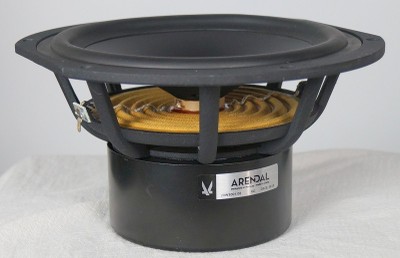

 1723 woofer   1723 bass driver4

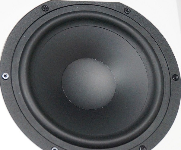

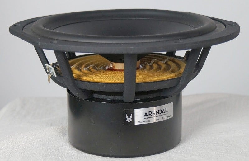

The two 8” woofers of the 1723 Monitors use long pulp fiber cones with an inverted dustcap and an nitrile-butyl rubber surround. Removing the driver from the cabinet, it looks to have a 1” diameter voice coil, a shielded motor, and venting done under the spider. Shielding can keep more of the magnetic flux within the motor assembly, but it isn’t seen much anymore since it was mostly used to prevent stray magnetic fields from interfering with the picture of CRT screens. The motor is hidden behind the shielding, but the driver is fairly heavy and solid, so I would guess it has a pretty hefty magnet. Arendal’s literature states that it uses an aluminum shorting ring, suspension optimized by FEA analysis, and copper-clad aluminum wiring for the voice coil. It looks like a capable driver, and two 8” cones have nearly the same surface area as a 12” cone, so the bass system of the 1723 Monitors should have a pretty serious dynamic range.

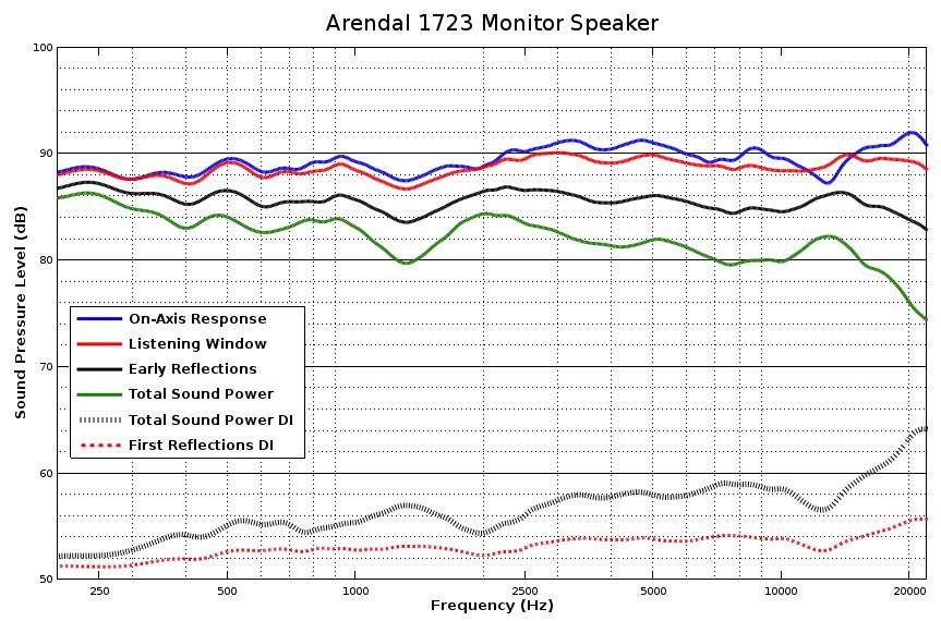

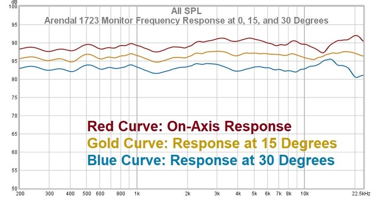

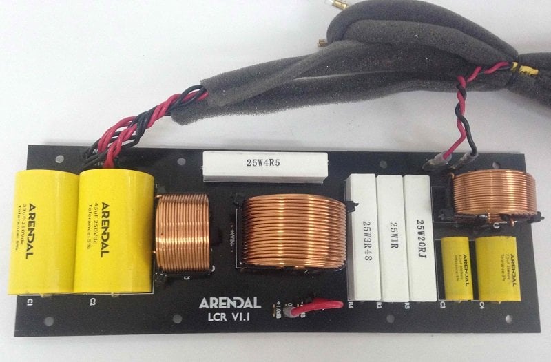

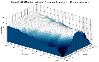

1723 crossoverThe tweeter crosses over to the woofer at 1.5kHz, which is a very sensible crossover frequency going to an 8” cone for preserving smooth directivity, so long as the waveguide shape is well-conceived. The crossover slopes are all fourth-order, which is quite steep and surprising for a loudspeaker of this price point. These are electric-acoustic slopes, so they combine with the natural roll-off of the driver and are not purely electric slopes, at least for the tweeter. Arendal specifies their crossovers to use heavy-gauge air-core inductors, polypropylene capacitors, high-power resistors, thick PCBs, and twisted-pair multi-strand wiring, and, from taking a look at the crossover circuit, it is no joke; these are some beefy capacitors, inductors, and resistors. The 1723 Monitors allow the user to bi-amp/bi-wire them, but I have to question the need for bi-amping in this instance, even for a speaker as beefy as these. However, with a specified 400-watt RMS power-handling ability, there is a better case for bi-amping ability with these than many other home audio loudspeakers. The binding posts are plated look like nickel plating but are actually plated in rhodium, which was chosen for its conductivity, corrosion resistance, and hardness.

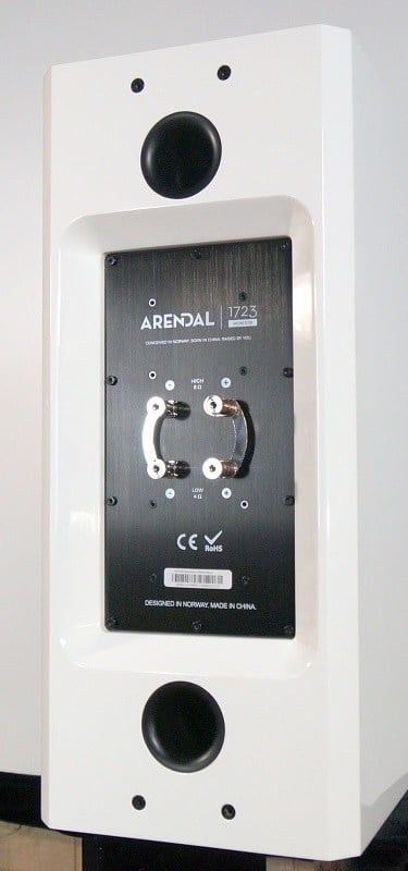

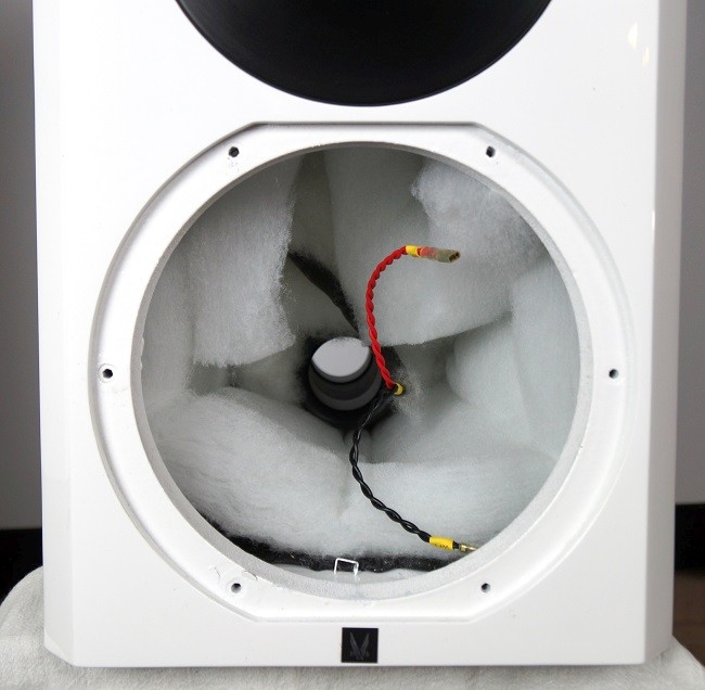

1723 interiorThe enclosure has a very formidable construction that uses high-density fiberboard instead of medium-density fiberboard all around. I measured the front baffle at a 1” thickness and side panels to be ¾” thick. There is a window brace at the midsection of the cabinet. The cabinet is very generously stuffed with polyfill and the interior surfaces are lined with a soft, nearly gel-like substance that Arendal calls a “butyl-based differential mass damping layer” to dull internal pressure waves from resonating the cabinet. I thought that was going the extra mile, but Arendal also has the interior of the cabinet painted, although not with the gloss finish. The advantage to putting a layer of paint on the interior is that it is better protected against moisture affecting the wood of the cabinet. The 1723 Monitors do not come with feet attached, but they do come with some small adhesive rubber feet that the user can attach; I would recommend owners do so to preserve the finish on the bottom surface. Might as well keep it nice all over when you can. The grille uses magnetic adhesion but with very strong magnets, so it does not come off easily. The grilles need that strong adhesion since they use a perforated metal frame wrapped in black fabric. They really do protect the drivers from getting hit by foreign objects instead of just hiding the drivers with a sheet of fabric like most grilles. Arendal proudly boasts that there is very little plastic used in their speakers.

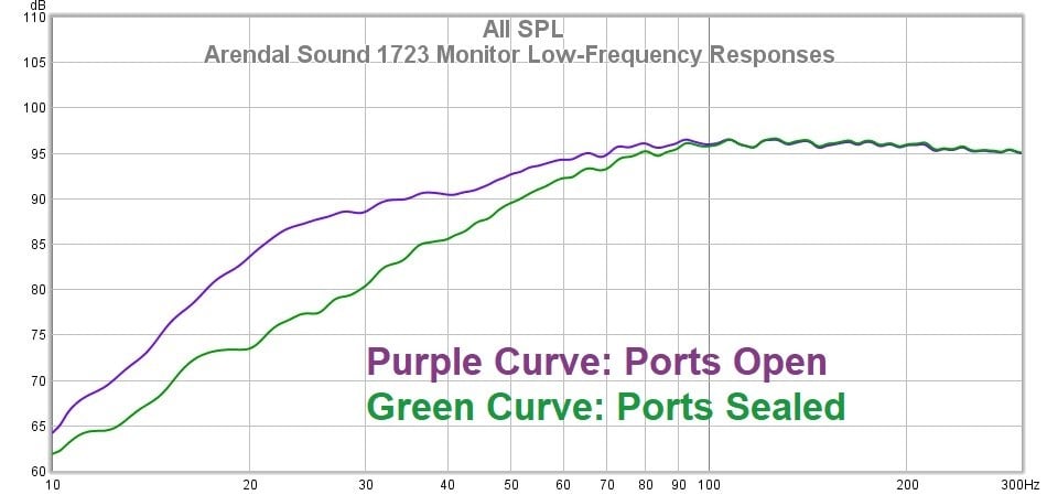

There are two 2” diameter ports mounted on the rear with 7” lengths. They are flared on both ends and come with port plugs for those who want to shut down port output. Killing port output will reduce bass headroom but it makes the phase response a lot more simple, and that can help the speakers integrate with subwoofers better. Another advantage of sealing ports would be for center channels where boundary gain can really boost bass output, and that excess bass can degrade speech intelligibility. However, unless you are getting excess bass from the speakers’ placement, I would advise users to run the 1723 Monitors with the ports open.
1723 backThe 1723 Monitors boast THX Ultra certification which means, among other things, it can hit THX Reference levels in a 3,000 cubic feet room with a 12-foot distance from the speakers. THX Reference level loudness is 105dB peaks with low distortion, so it takes some real firepower to achieve that at a 12-foot distance in a 3,000 cubic foot room. But THX loudspeaker certification is more than just dynamic range; it assesses frequency response, dispersion characteristics, electrical behavior, and time-domain behavior too. In other words, it has to be an all-around good performer. What is more, the qualities that THX looks for aren’t just to say whether a speaker is good or not but rather how well it will fit in the context of an overall THX system. What THX is looking for is predictable behavior so that the program content will sound very similar on any THX-certified system. THX is about ensuring that whatever the audience sees and hears is what the content creators intended. So if you have something that is stamped with THX certification, it is just one piece of a system that could faithfully reproduce the source material, if the chain of signal reproduction follows THX prescriptions from top to bottom.
