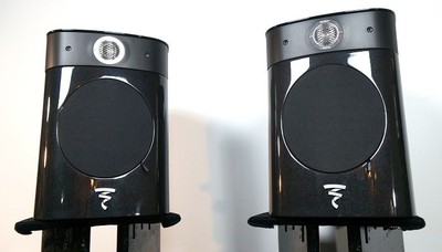

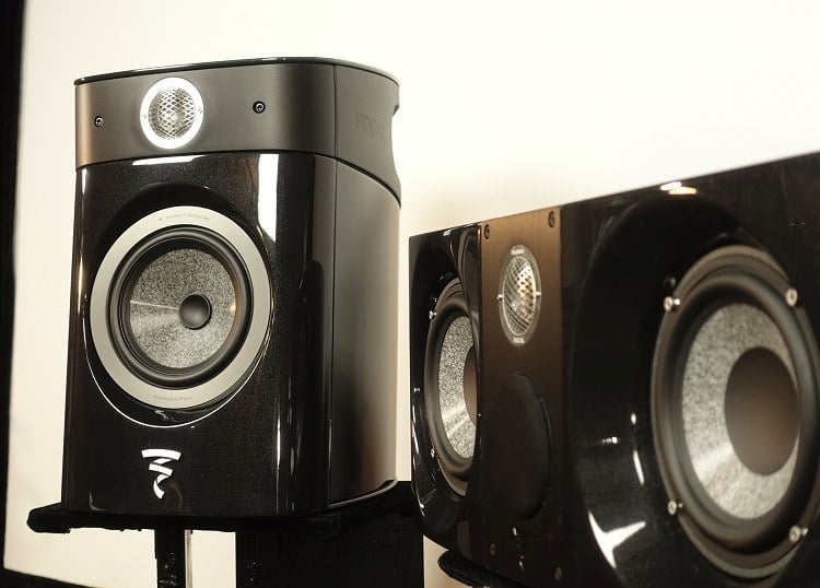

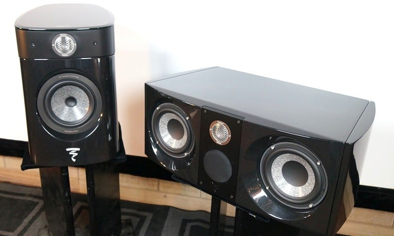

Appearance

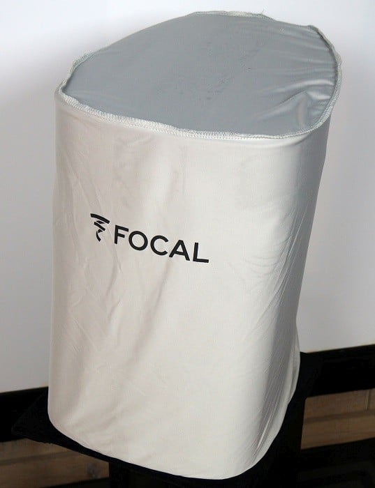

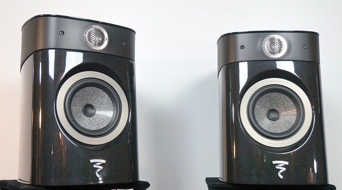

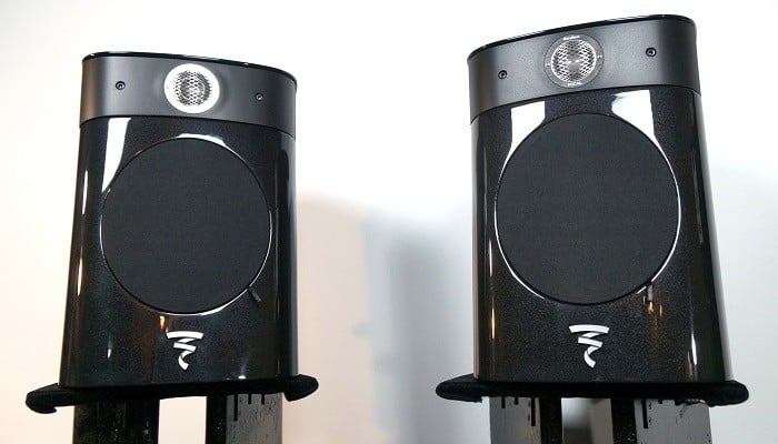

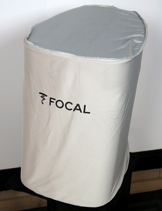

The Sopra No 1 arrived in a very tough cardboard box with thick
polyurethane foam blocks providing a good cushion from shock and space from the
box sides. Inside that, they were wrapped in a luxurious rayon drawstring sack
to protect against moisture and scuffing. Once out of the sack, the speakers

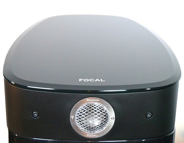

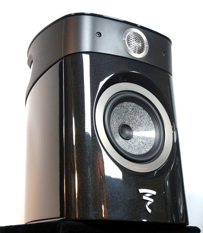

were revealed to be a stunningly beautiful design. The Sopra bookshelf speakers
had a rounded enclosure with an angle at the portion continuing the tweeter.
The tweeter’s housing was made from black brushed aluminum, and in the back,
there was an aluminum wireframe protecting an opening (whose function we will
describe in the ‘Design Analysis’ section). The main bulk of the cabinet was
finished in a very fine gloss black with a slight scintillation that you might
find in a luxury car finish. The Sopra bookshelf speakers were topped off with
a glass piece with gently beveled edges.

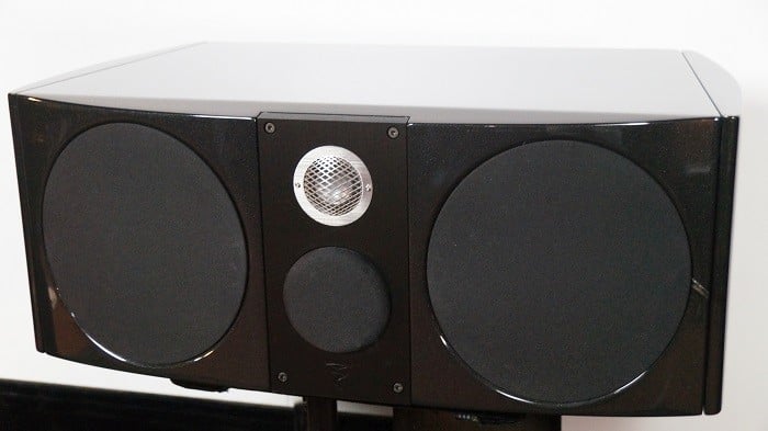

The tweeter was protected by a built-in aluminum wireframe grille, but the woofers have a removable grille that is just a fabric-covered round plastic frame. However, the woofers look so gorgeous (as woofers go) that I wouldn’t dare hide them with a grille. The woofers are sunk fairly deep into the cabinet, and the cones have a marble look to them. They are encircled by a nice brushed aluminum trim ring. The Sopra center is mostly the same except it doesn’t have a separate chunk of the cabinet for the tweeter, nor does it have the Sopra bookshelf speaker’s tweeter ‘vent.’ It is a three-way design using the same kind of marble looking midrange cone as the bass drivers. The Sopra center has the midrange driver and tweeter set into a black brushed aluminum panel on the front baffle.
All in all, the Sopra speaker set has a truly high-end demeanor, both in looks and in feel. These are heavy for their size; the Sopra bookshelf speakers weigh nearly 42 lbs each. The build quality is clearly at a very high level. These speakers are drop-dead gorgeous and among the nicest I have dealt with yet. They are not cheap speakers, but, at least in feel and appearance, you really are getting your money’s worth. These speakers are manufactured in France, and there is pride in craftsmanship in every corner.

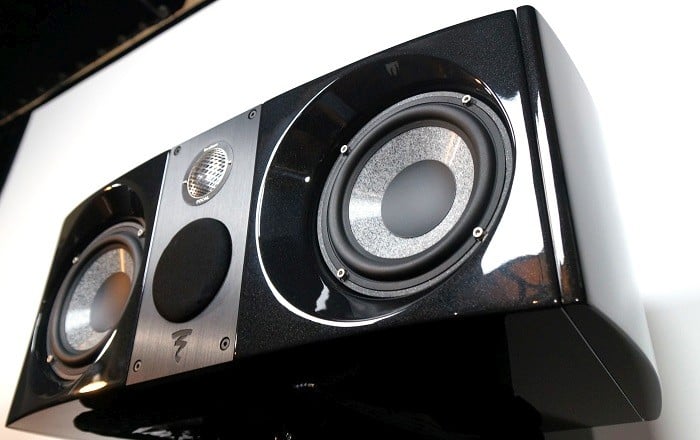

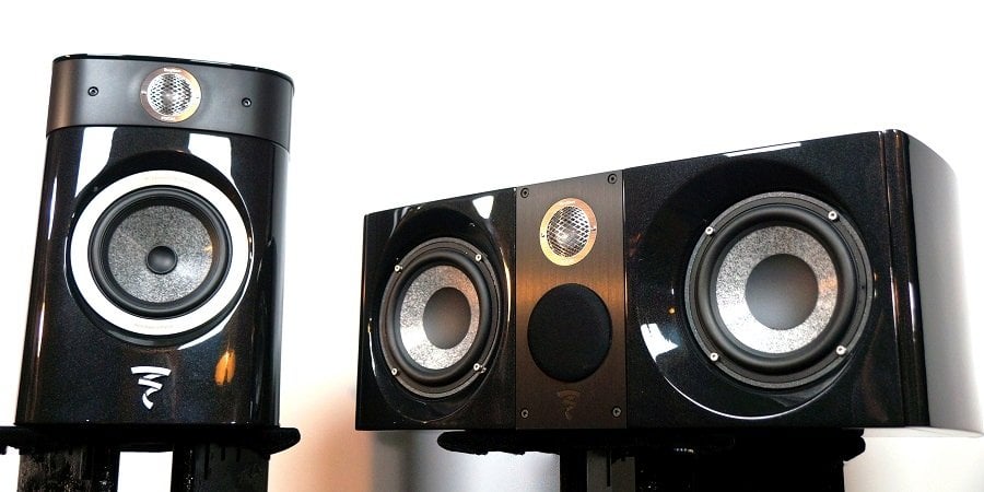

Focal has packed a lot of technology into the Sopra speakers,
and so we have a lot to unpack in our design analysis. The Sopra No 1 bookshelf
is a two-way design using a 1” dome tweeter and 6.5” woofer, a very common
design on the face of it, but the details -and there are many details- are what
separates it from other bookshelf speakers of the same basic spec set. The

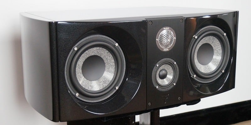

Sopra Center is a three-way using a 1” dome tweeter, 3” midrange, and two 6.5”
woofers. That is not an unusual spec set for a center speaker, but again, it is
how Focal goes about achieving these specs that elevate the Sopra Center. These
speakers take traditional loudspeaker designs and boost them to the nth degree.

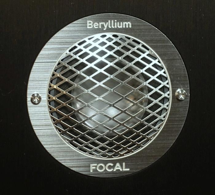

Let’s start our discussion of the design of the Sopra speakers at the top with the tweeter. The Sopras use an inverted beryllium dome tweeter. Beryllium is a great material for a tweeter diaphragm for the reason that it is a very light metal (30% lighter than Aluminum) and extremely stiff (4 times stiffer than Aluminum) with good damping characteristics. Other metals such as aluminum and titanium being heavier and less stiff bend and flex in rapid motions more easily than beryllium. This means that cones made out of aluminum and titanium lose their uniform motion at lower frequency oscillations than beryllium. Or, to put it another way, aluminum and titanium cones will start to bend and flex at frequencies that beryllium is able to maintain its shape. In layman’s terms, beryllium is more “pistonic” over a wider frequency bandwidth than those other metals.
Beryllium’s ability to hold
its shape for a greater frequency band is a big advantage for driver
performance. When cones start to flex, this is called breakup, and it can have
serious negative consequences for sound reproduction. What is normally seen
when cones, domes, and other transducer diaphragms begin to break up is a very
erratic frequency response: large spikes of upper-frequency resonance that can
sound pretty bad. For soft materials like fabric domes, the breakup resonances
can be mild, but as a result of that material’s softness, they usually do not play high
frequencies nearly as well as stiffer metal domes. What can be had with
beryllium is a driver that can play to relatively high frequencies without the
intrusion of breakup.
The reason beryllium is seldom used in loudspeakers despite being a superior diaphragm material is the expense of manufacturing it. In its unprocessed form, it is very toxic, so it takes special procedures to safely handle versus traditional diaphragm metals. Owners of speakers using beryllium do NOT have to be alarmed about its toxicity since once it is formed into a solid shape, it is no longer hazardous (unless you try to eat it). However, the safe manufacturing procedures make it far more expensive than other tweeter types.
Focal uses an inverted dome
rather than a typical convex dome because they claim it achieves a “better
mechanical interface between the voice coil and dome, ensuring that all of the
vibrational energy is transmitted into the dome and radiated as sound rather
than partially lost as heat in the dome surround,” to quote Focal’s white paper. In other words, they claim it is more efficient. I don’t
know that it really is more efficient, but I don’t think that Focal would just
decide to do that without some reason to believe it is the better choice, so I
think their claim is plausible.

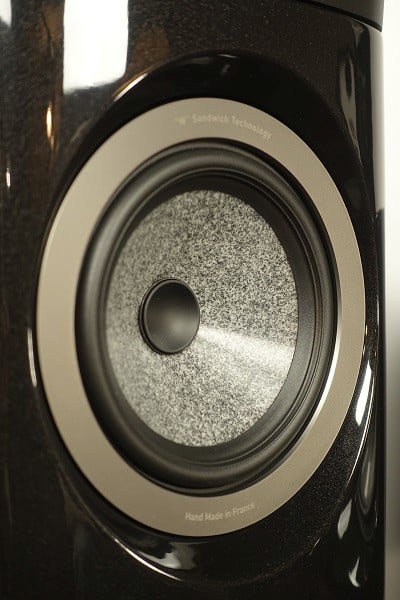

Moving down to the woofers,
the Sopras use Focal’s vaunted ‘W Sandwich’ cone composition. This cone
material sandwiches structural foam with fiberglass tissue surfaces. It is an
evolution of sandwich cones that Focal has been making since the 1980s. Focal
claims it is very light and rigid but also has good damping characteristics
compared to cones using a single material. Focal is not the only manufacturer
making these types of layered cones in an effort to make something that is
light, rigid, yet well-damped, but their solution of using structural foam does
seem to be an inspired choice.

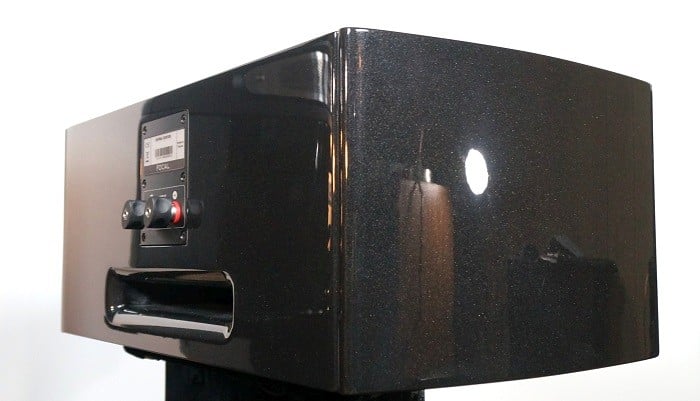

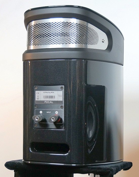

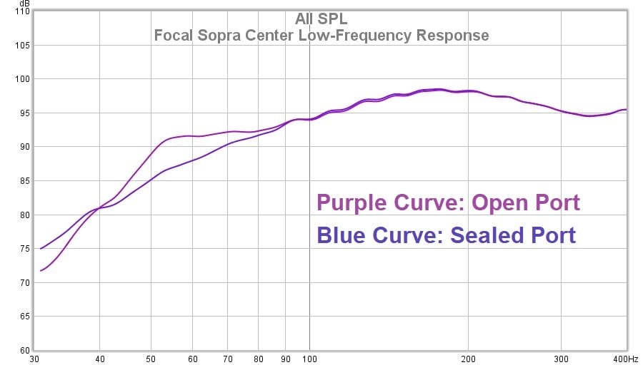

Both the Sopra No1 and
Sopra Center are ported loudspeakers with slot ports on the back of each
speaker. The port is built into the cabinet, at least as far as the panel
extends, and there is a slight flaring on the outer edges. Both speakers

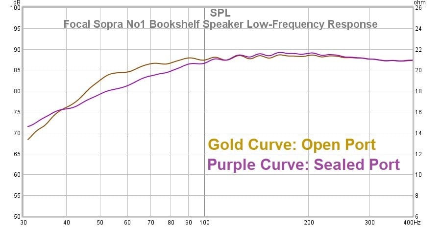

include foam port plugs for those who want to seal the ports. Sealing the ports
could help the speakers integrate with subwoofers better since ports can cause
some odd phase behavior that isn’t as easy to match at the sub crossover point.
Sealing the center speaker may also be a good idea if the center has to be
placed in a more enclosed space where boundary gain can really bump up the bass
levels. Elevated mid-bass can hurt speech intelligibility so it’s something to
avoid in a center channel speaker. Outside of these circumstances though, I
don’t see a good reason to seal the ports.

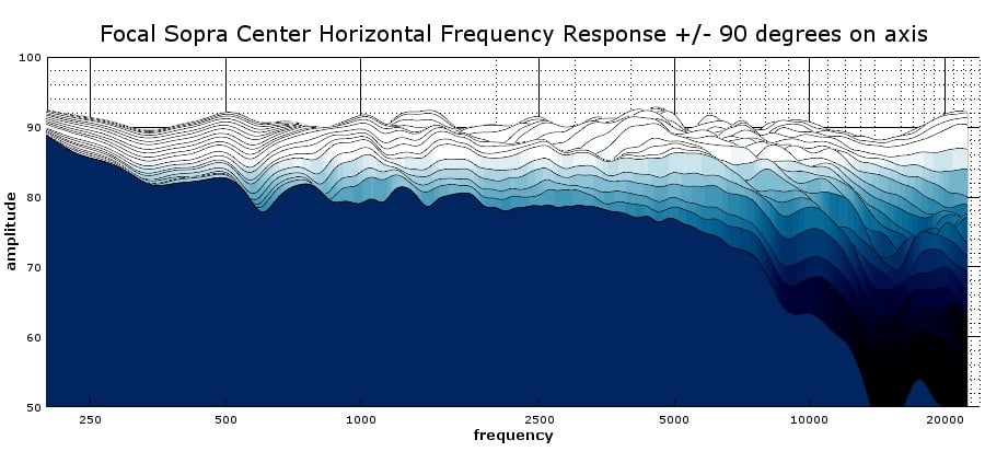

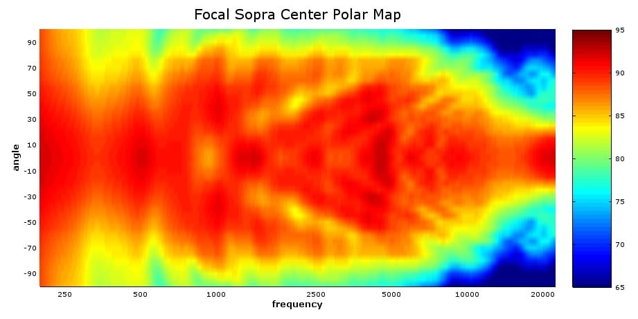

Focal Sopra N°1 Bookshelf & Center Speaker Measurements Conclusion

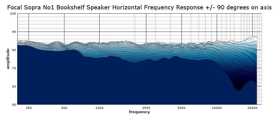

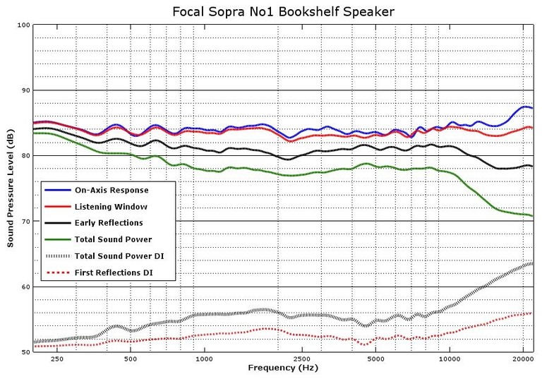

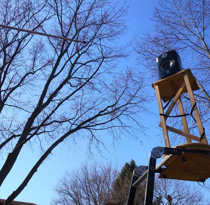

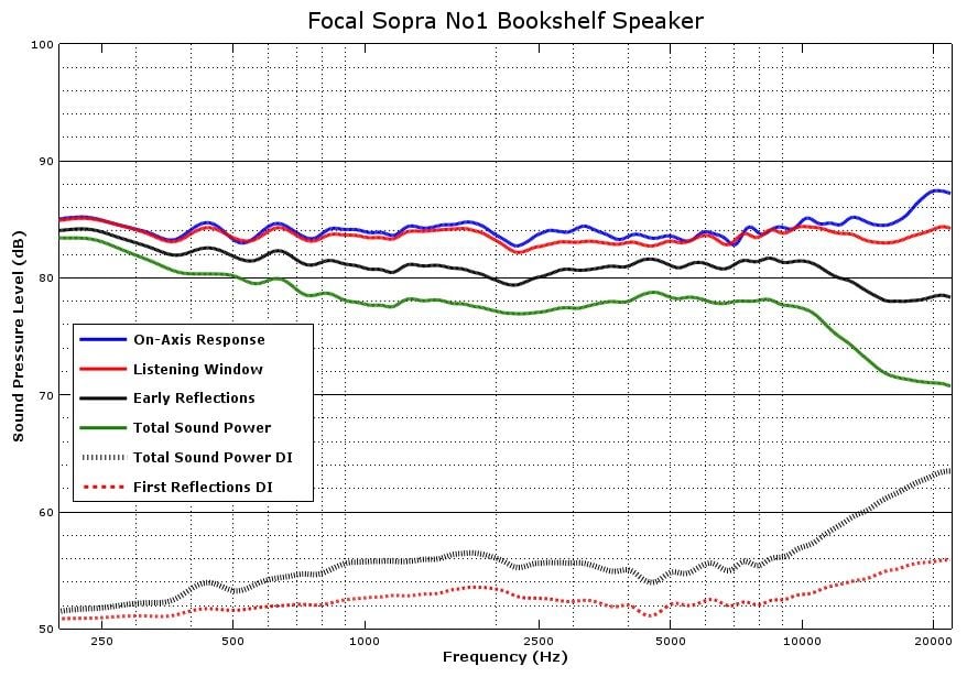

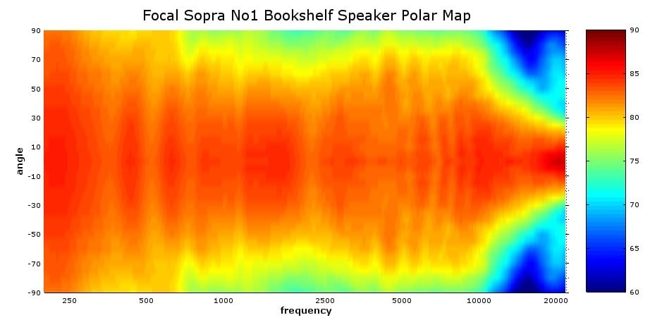

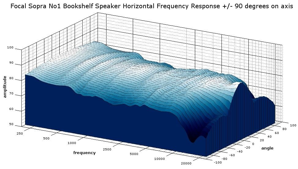

The Focal Sopra No1 bookshelf speaker and Center were measured in free-air at a height of 7.5 feet at a 1-meter distance from the microphone, and the measurements were gated at a 10-millisecond delay. In this time window, some resolution is lost below 250 Hz and accuracy is completely lost below 110 Hz. Measurements have been smoothed at a 1/12 octave resolution.
The above graph shows the direct-axis frequency response and other curves that describe the speakers’ amplitude response in a number of ways. For more information about the meaning of these curves, please refer to our article Understanding Loudspeaker Measurements Part 1. The above-measured performance is superb. The No1 Sopra boasts a terrifically neutral response on and off-axis. A few interesting points of interest: there is a slight on-axis boost in the highest audible treble region. This might give the speaker a bit more “air” if listened to dead on-axis. Off-axis, the tweeter does begin to beam slightly past 10kHz as many dome tweeters do when not installed in a waveguide. On the Sopra No1s, this is surprisingly mild though since we see little evidence of that in the ‘Listening Window’ curve and mostly in the ‘Early Reflections’ curve. This means that the beaming doesn’t really affect dispersion much out to a 30-degree angle off-axis. We do see an ever-so-slight directivity error where the tweeter’s dispersion is just a hair wider than that of the woofer at the crossover point, but this is very unlikely to be audible. Most two-way bookshelf speakers with a 1” dome with no waveguide and 6.5” woofer have a bit more significant directivity mismatch than we see here. This directivity is as good as I have ever seen for a speaker of this design type. We only show this ‘spin-o-rama’ style graph for the Sopra No1 bookshelf speaker since we aren’t able to capture the full circumference of the Sopra Center’s vertical response which is needed for this graph.

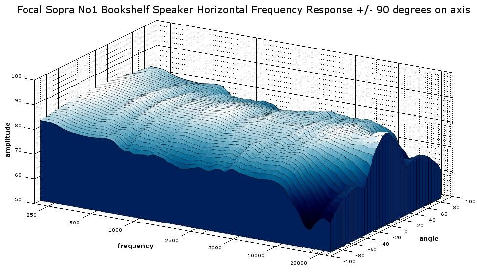

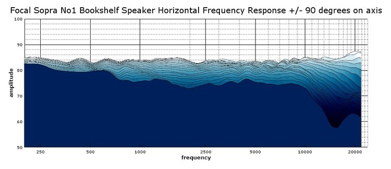

The above graphs depict the Sopra No1 bookshelf speaker’s lateral responses out to 90 degrees in five-degree increments. More information about how to interpret these graphs can be read in this article: Understanding Loudspeaker Review Measurements Part II. One thing we can see more clearly in this graph is the width of the dispersion and specific responses per angle. We can see that the Sopra No1 is a very wide dispersion loudspeaker all the way out to 10kHz, and its off-axis response corresponds beautifully to its on-axis response. This speaker can be listened to at any angle in the entire front semicircle of the tweeter’s height and it will sound good. If you want to hear those extremely high frequencies above 15kHz, you should stay within a 25-degree angle of the tweeter. However, there isn’t much content in that frequency band. Furthermore, most male adults over 30 have some high-frequency loss in that region, and if you are a male adult over 55, you are unlikely to have any significant hearing left in that band at all. We can see from these graphs that the most neutral response seems to be from ten to fifteen degrees, but that is only because of the rise of the on-axis response of the tweeter past 15kHz. This speaker has a neutral enough response that it could easily be used as a studio monitor if you wanted to record music and be sure that your loudspeakers are giving a faithful reproduction of the recording. That is all the more impressive coming from a passive loudspeaker; most studio monitors use all kinds of DSP equalization to achieve a flat response, but the Sopra No1 has an intrinsically flat response. This is an exceptionally accurate loudspeaker.

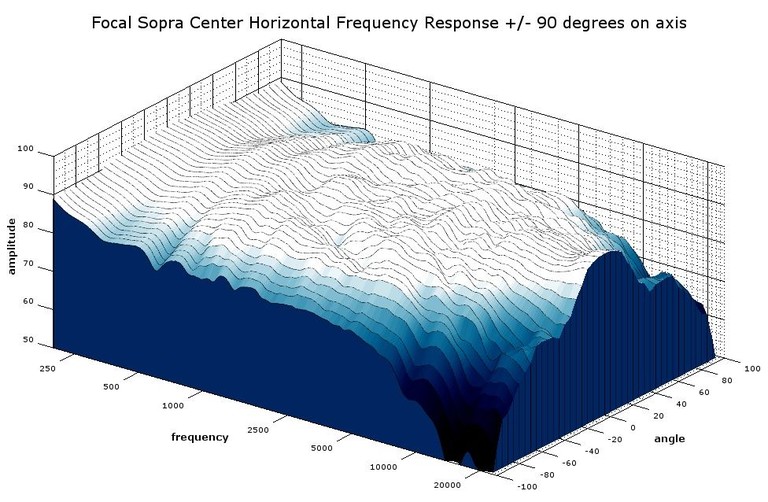

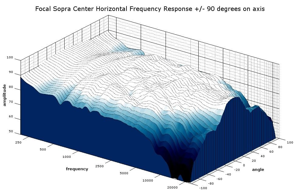

Moving on to the Sopra Center, we can see that it doesn’t present as pristine of a response as the No1 bookshelf speakers, but it isn’t at all bad. It is a somewhat ragged response but the small peaks and dips adhere to a generally neutral response. Like the No1 bookshelf speakers, the dispersion is quite wide. One minor problem is that all of the little peaks and dips of those waves occur at different frequencies as you move off-axis, so any equalization done to one frequency range may exacerbate some response flaw at another angle. This speaker wouldn’t take well to fine EQ’ing, although it is flat enough that you could do broad EQing over a wide range like a tone control. I think that the overall response is neutral enough that it doesn’t need any assistance from equalization, except perhaps in lower frequencies where room modes dominate.
One nice thing to see in a center speaker is the absence of cancellation lobes from the bass drivers. The bass drivers are crossed over to the midrange driver at a low enough frequency so that the horizontal response isn’t squeezed by phase cancellation of the woofers fighting each other off-axis. That gives these speakers a much wider angle of coverage than typical MTM center speakers (Audioholics has discussed the matter at length in these articles: Vertical vs Horizontal Center Speaker Designs, Vertical vs Horizontal Center Speaker Designs - An Alternate Perspective, and Center Channel Speaker Design Additional Considerations). That is a relief to me because I would consider the horizontal dispersion pattern of a typical MTM center speaker to be unacceptable in the Sopra Center’s price range.

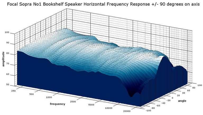

The above polar map graphs show the same information that the preceding graphs do but depict it in a way that can offer new insight regarding these speakers’ behavior. Instead of using individual raised lines to illustrate amplitude, these polar maps use color to portray amplitude and this allows the use of a purely angle/frequency axis perspective. The advantage of these graphs is they can let us see broader trends of the speaker’s behavior more easily. For more information about the meaning of these graphs, we again refer the reader to Understanding Loudspeaker Review Measurements Part II. The polar map of the Sopra No1 bookshelf speaker puts up a good showing here with some interesting features. The first thing we can see is that this is a very wide dispersion speaker with off-axis energy that doesn’t really drop off much even out to 70-degrees. The dispersion is fairly uniform out to 10kHz with very slight waist-banding around the crossover frequency at 2.2kHz. The shape of the tweeter’s beaming above 10kHz is, as was mentioned before, better than normal for a tweeter lacking a waveguide. Even out to 20kHz, you still get a solid response past a 20-degree angle. That is abnormally good for a dome tweeter. Most dome tweeters have a laser-like beam at that frequency where you would need to be right on-axis to be hit with any real acoustic energy at all.
The Sopra center has a similar dispersion pattern to the No1 bookshelf speakers but there are differences. There are some visible irregularities within the dispersion, but nothing too erratic. There are some slight V-shaped nulls that move outward as frequencies rise. I am not sure what that is due to, perhaps some kind of baffle diffraction? The treble begins to narrow at slightly lower frequencies than the No1 bookshelf speaker. On the whole, this polar map shows good behavior. This center speaker will cover a wide area with a full sound. Those sitting way off-axis may miss a bit of high treble, but I don’t think that will be a big deal. The vast majority of people who listen to a system with this speaker will be sitting within a 25-degrees of the on-axis angle where they will be met with a strong signal that exceeds the best of human hearing in high-frequency extension.

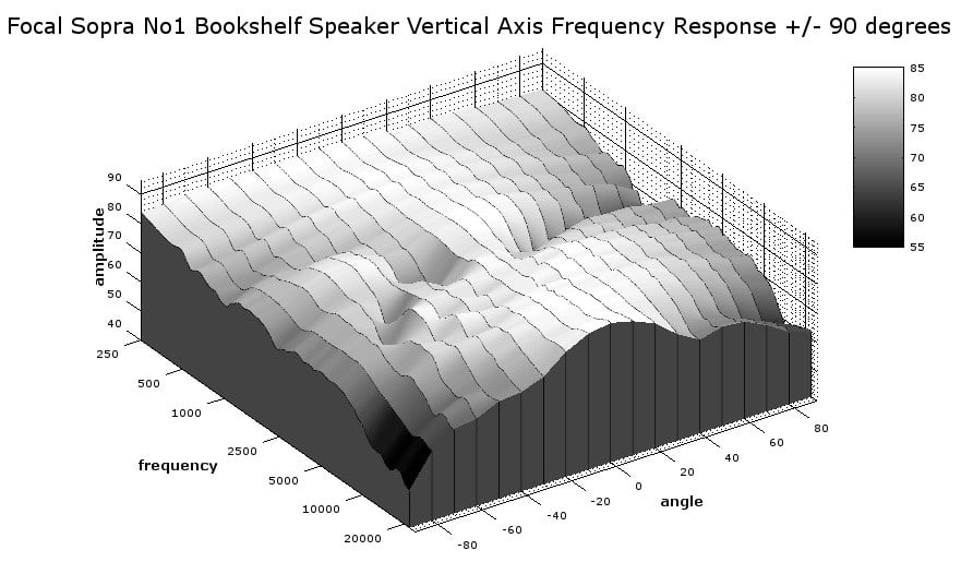

The above graph shows the Sopra No1 bookshelf speaker’s response behavior along its vertical axis where zero degrees is directly in front of the tweeter, negative degree values are below the tweeter, and positive degree values are above the tweeter. It should be said here that the vertical response isn’t nearly as critical as the horizontal response, so an imperfect vertical dispersion is much less of a problem. We can see that the on-axis response is the place to be with this speaker, as expected, but plus or minus ten degrees doesn’t change the response much. Past ten degrees in either direction, we do see some significant nulls form from the woofer and tweeter falling out of phase with each other. These speakers are best listened to at tweeter height, but there is some tolerance before major errors creep in the vertical dispersion response. One interesting thing to see is how narrow the crossover nulls are, and that indicates that the Sopra No1’s are using fairly steep crossover filters. The good news about that is acoustic reflections from vertical surfaces won’t deviate too severely from the on-axis sound, and the more that the acoustic reflections resemble the direct sound from the speaker, the better it is for the overall sound heard in-room.
The above graphs show the Sopra No1 bookshelf speaker’s low-frequency responses that I captured using groundplane measurements (where the speaker and microphone are on the ground in a wide-open area). Again, we see a nicely flat response from the Sopra No1. Port output gains the user a stronger response down below 50Hz but doesn’t seem to offer that much more output at a nominal drive level. The real advantage is the restricted excursion that the driver sees around port tuning frequencies, which means that the sound it does output will be far more linear. Focal specifies a -6dB point of 41Hz, and that doesn’t seem to be the case here. It looks to me that it would be closer to 50Hz. Nonetheless, this speaker does have usable bass below 50Hz, and it should capture almost all of the bass in conventional acoustic music save for certain genres like pipe organ recordings.
The Sopra Center’s low-frequency response isn’t quite as neutral as the No1 bookshelf speakers. There seems to be a high-Q hump centered around 175Hz. The bass on the Sopra Center may be slightly thick, although I didn’t notice anything like that in my listening. As with the No1 bookshelf speakers, the port gives it a solid response down to 50Hz. Automated EQing systems like Audyssey or Dirac probably make the elevated bass a non-issue since they tend to equalize the low-frequency response quite heavily. There is a lot of bass here, so sealing the ports might not be a terrible idea if the speaker is being placed on a shelf and near a back wall or especially in an entertainment center cavity.

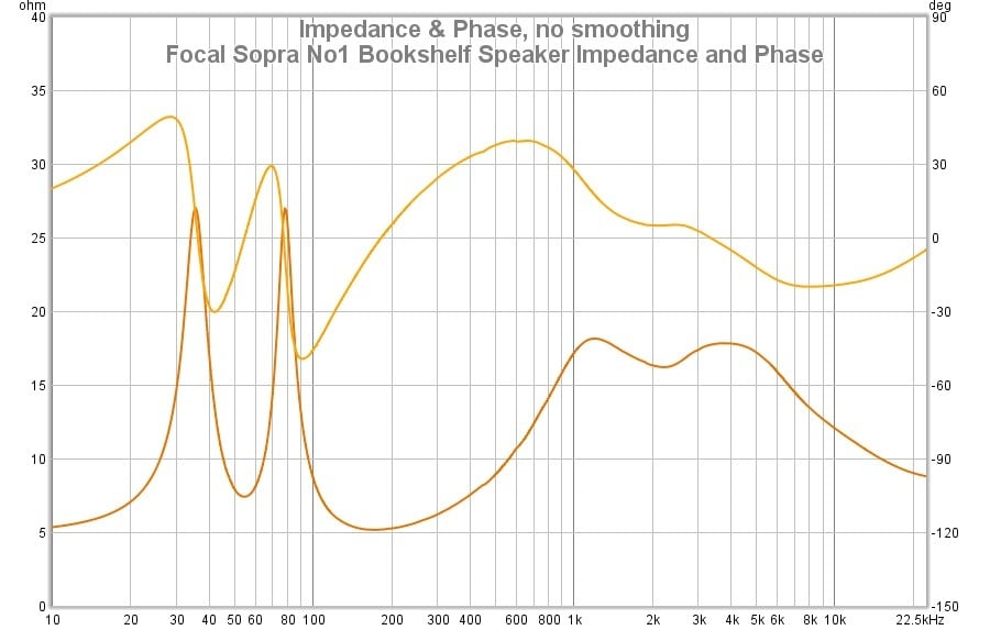

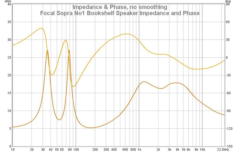

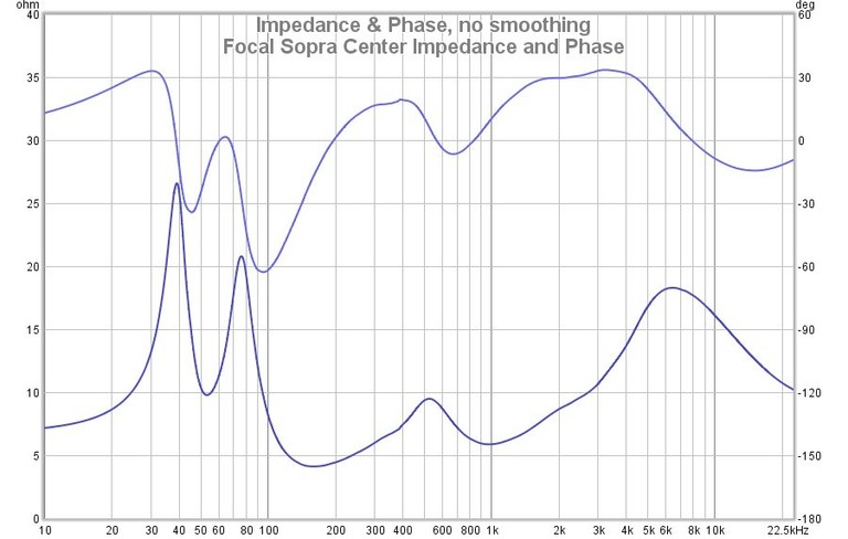

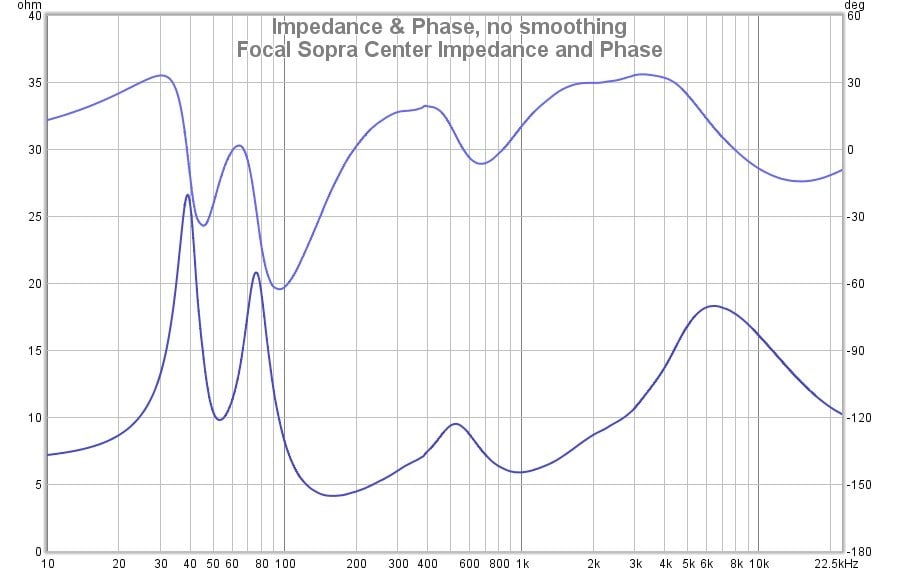

The above graphs show the electrical behavior of the Sopra No1 bookshelf speakers. Focal rates this as an 8-ohm nominal load with a 3.9 minima. From 10Hz to 22kHz, I didn’t measure anything as low as 3.9 ohms. The impedance does touch 5 ohms in the mid-bass region. Overall there is nothing to worry about here even for budget amps, not that anyone is going to drive some Focal Sopras with a budget amp. The dip in the saddle indicates that the port tuning frequency is about 55Hz, and the even levels of the peaks around the saddle indicate that the port’s tuning is a very good match for both the enclosure and driver.
The Sopra center is a tougher electrical load than the No1 bookshelf speaker. I measured an impedance minima of 4.1 ohms in the widely used mid-bass region, and it’s interesting to note that is where we saw a wide hump in the response. Outside of the mid-bass region, there isn’t anything that could even slightly tax any competently made amplifier. The dip in the saddle just above 50Hz is revealed to be the port tuning frequency. The taller height of the first saddle indicates that the resonant frequency of the enclosure is higher than that of the driver. A cheap amp might struggle with the mid-bass impedance and phase of this speaker if played at high levels, but again, any amp this speaker is likely to be paired with will not have any problem with this electrical load.
I measured the Sopra No1 bookshelf sensitivity to be 87.8dB for 2.83v at 1 meter. That is a very close match for Focal’s own spec of 88dB for those same conditions. That is a pretty healthy sensitivity for a bookshelf speaker of its design and low-frequency extension. I measured the Sopra Center sensitivity to be 90.1dB for 2.83v at 1 meter. Again, not far from Focal’s own spec of 92dB. These are not low-sensitivity speakers, and they will get plenty loud for most people’s tastes without running into their maximum rated power handling. It also makes the Sopra’s center impedance minima less of an issue if you were planning on running that $4,000 center speaker with a $200 AVR amp.
