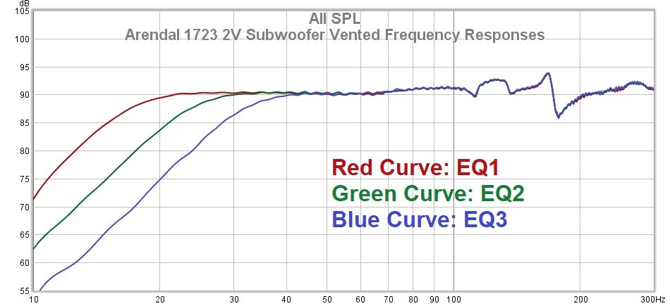

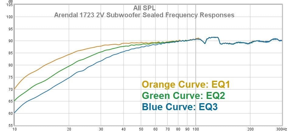

- Frequency Response:
EQ1 Sealed 17-200Hz (+/-3dB)
EQ2 Sealed 24-200Hz (+/-3dB)
EQ3 Sealed 34-200Hz (+/-3dB)

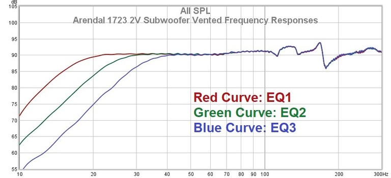

EQ1 Vented 15-200Hz (+/-3dB)
EQ2 Vented 21-200Hz (+/-3dB)
EQ3 Vented 38-200Hz (+/-3dB)- Enclosure Type: Sealed / Vented

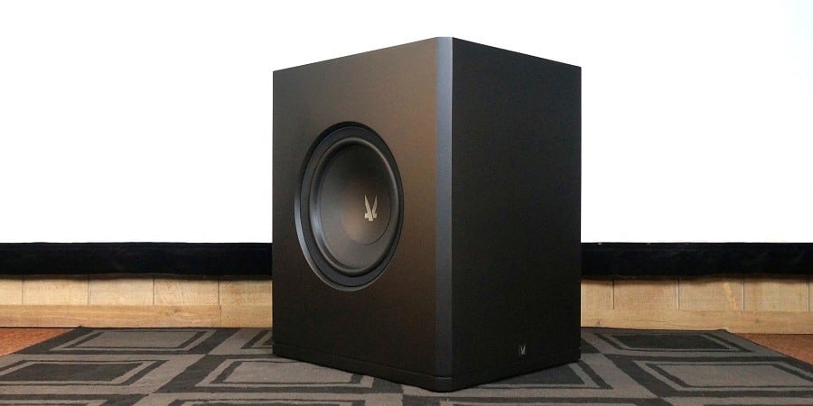

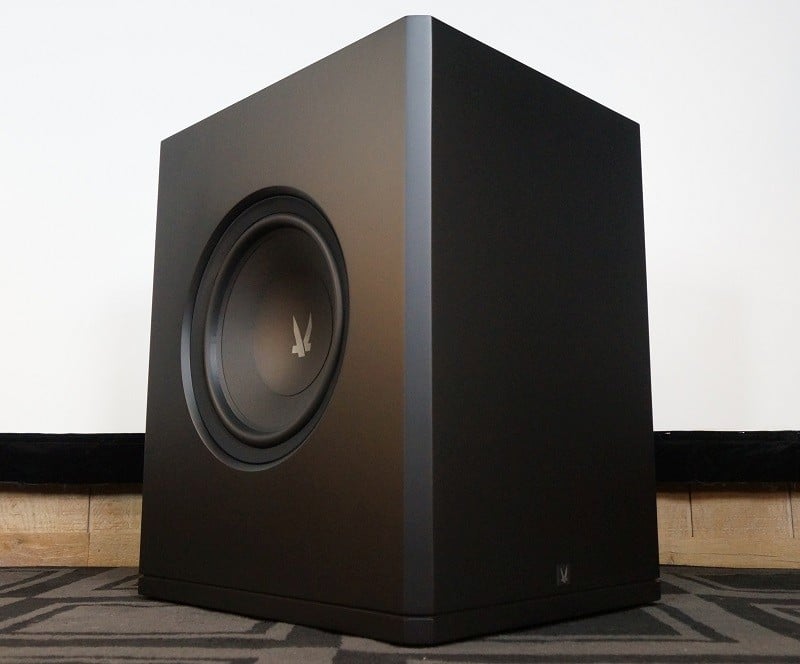

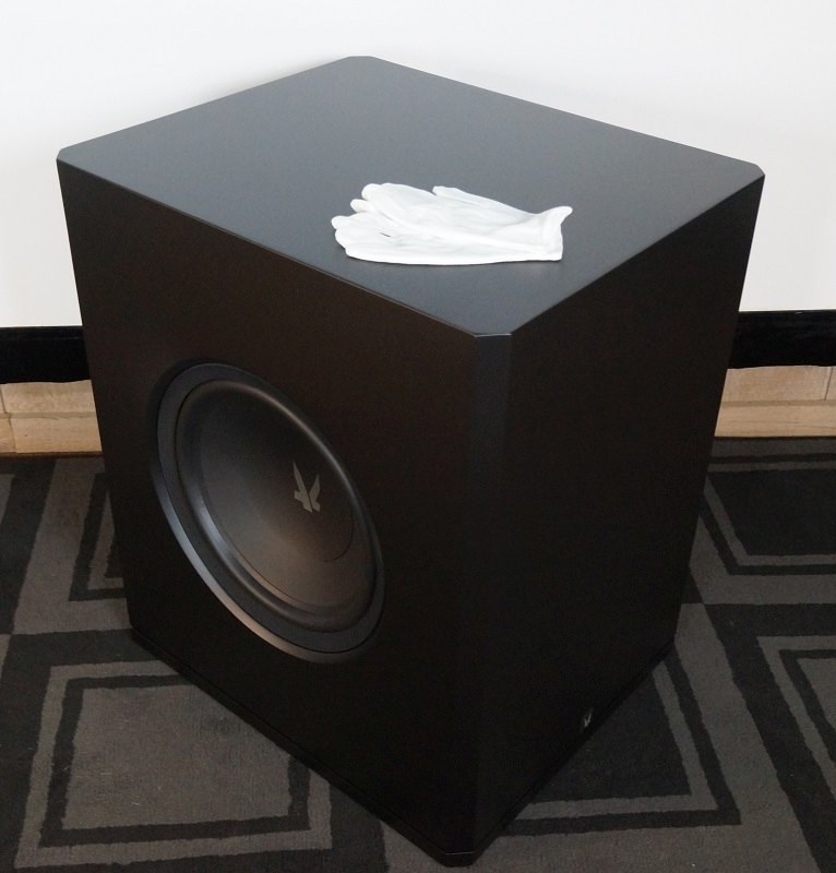

Packing and Appearance

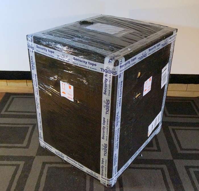

The 1723 2V arrived in a large box that was covered in plastic seal and security tape. Upon opening the box, I was surprised to see polyethylene foam pieces covering not just the top and bottom, like we see in most subwoofers, but foam guarding every surface. Virtually the entire sub was protected by a thick sheet of foam. That is nice to see and will help ensure the sub’s fine finish is not so easy to contact as just going through a layer of cardboard. Inside the foam packing, the sub itself was covered with a very posh rayon drawstring sack to protect it from getting scuffed by the foam packing. Included in the packing was a pair of white cotton gloves to protect the subwoofer from fingerprints in the unpacking process, another touch of class on top of the rayon sack. Altogether the packing is first-rate on the 1723 2V; not surprising on a product of its $3k pricing, but welcome nonetheless.

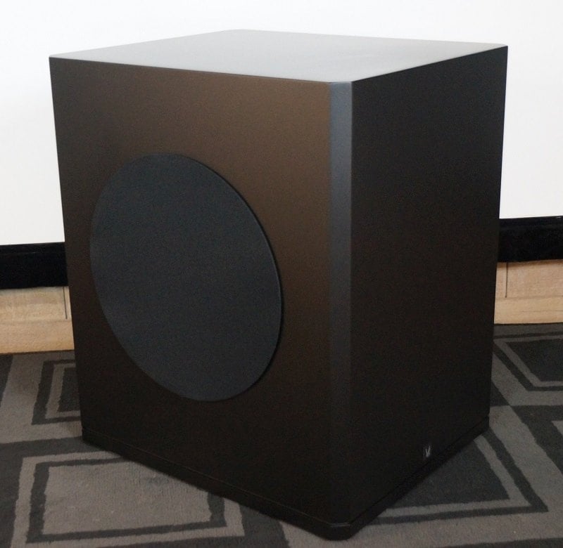

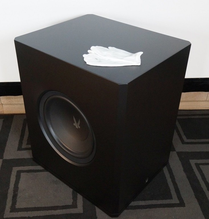

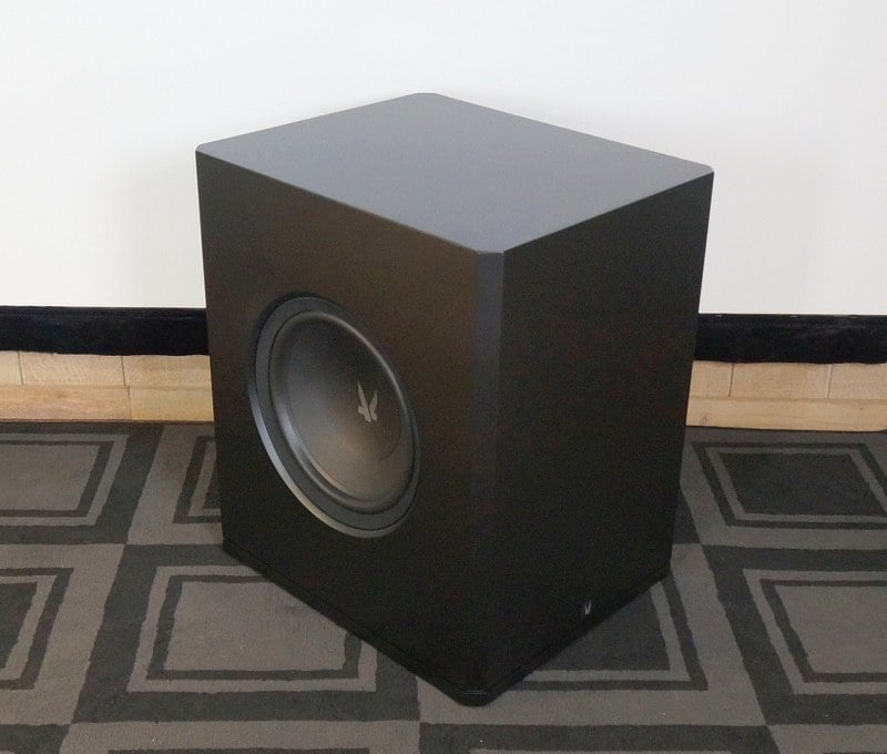

Once unpacked, the Arendal 1723 2V stands like an austere monolith. If prehistoric apes had found this in their midst, it would have imparted to them the capacity to use tools (cue “Thus Spoke Zarathustra”). The 1723 2V is available in matte black and matte white finishes as well as gloss black and gloss white finishes, and I received the matte black. ‘Matte’ black is a bit of a misnomer though, and I would characterize this finish as satin black. There are many manufacturers who claim a satin finish that is not as fine as this; typical Norwegian modesty. There is no getting around how large this sub is, and that is certainly a major visual attribute. The vertical edges are beveled, which gives it a more stately demeanor, and the rest of the edges have a very slight rounding that does help to soften the appearance. As large subs go, it is fairly nice-looking by virtue of its minimalism. There are two woofers on opposite sides of the enclosure, so chances are, one of the woofers will be exposed (unless you use the grilles). The magnetic grilles are circular and only cover the woofer instead of the entire front panel like most other subs. In my opinion, the grilles do not improve the appearance of this sub and only help to protect the cone. The cone is pretty nice looking, and the frame is hidden by a trim ring so there are no exposed screws. The texture of the cone bears a similar satin black as the rest of the enclosure except for the Arendal logo printed in the dustcap. There is also a small Arendal logo at the bottom of the front panel. Aside from all of that, it is just smooth, featureless black. The clean look of the 1723 2V helps to offset its huge size and perhaps make it more palatable for those who would otherwise object to such a behemoth.

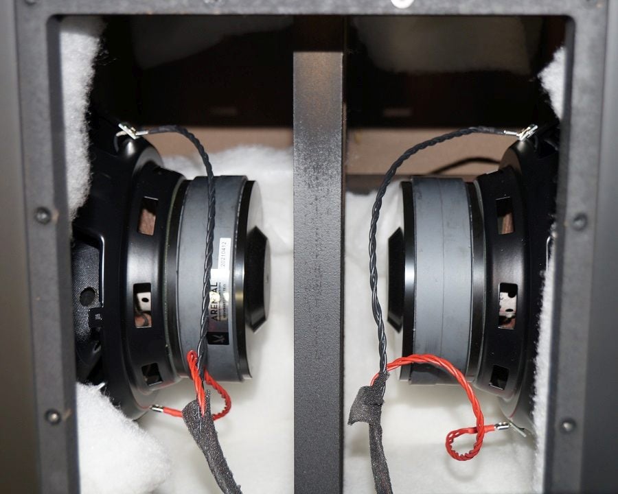

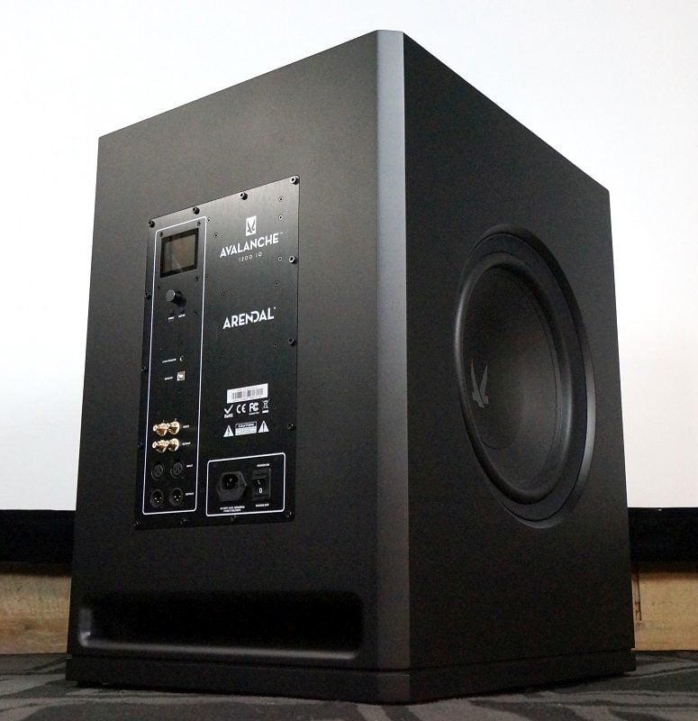

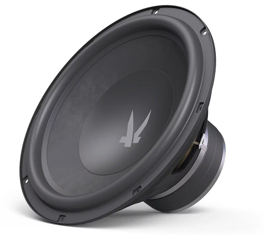

The basic design of the 1723 2V is that of a large subwoofer that uses two 13.8” woofers in a slot-ported enclosure. That can be a recipe for a lot of high-quality bass, surely, but it all depends on how well the recipe is executed. Let us examine the ingredients, and we will start with the drivers. The cones are made from a combination of long fiber pulp and fiberglass and are attached to the baskets with a nitrile-butyl rubber surround and a Connex spider. The voice coil has a 2” diameter and uses aluminum wiring around a polyamide former. The basket is a thick stamped steel frame that connects to a beefy motor comprised of a 1 ½” stack of two magnets that are 6” in diameter. There is a heavily bumped-out backplate for longer excursions with reduced risk of hard bottoming, and venting is done under the spider. There are multiple aluminum shorting rings used for reducing inductance. Arendal claims it has a 50% higher excursion than the previous generation of 1723 subwoofers.

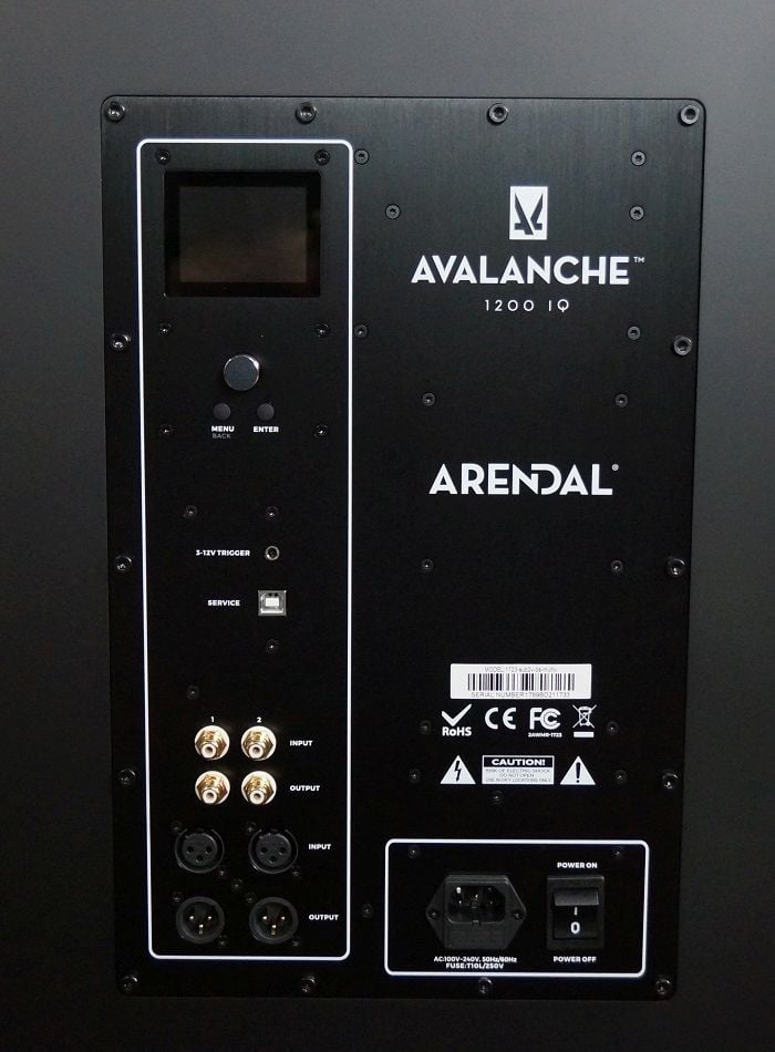

The drivers are powered by a 1,200 watts RMS class-D amplifier that Arendal calls the “Avalanche” amplifier. The user controls the 1723 2V sub not through traditional knobs but rather through a 2.6” color LCD screen. This enables a lot more control over the sub than an array of knobs. You can adjust how each input is controlled individually, and aspects of control include different crossover slopes as well as high-pass slopes, wake-up times and wake-up sensitivities, operating mode selection, and even a 7-band parametric equalizer. The 1723 2V has a pair of RCA inputs and output as well as balanced XLR inputs and outputs. The outputs can be handy for daisy-chaining subs in a multi-sub setup as well as running the signal to some active speakers. A subwoofer needs highly sophisticated processing to deal with all of that, and the Avalanche amp has that with a 32-bit microcontroller. The microcontroller is also constantly monitoring performance parameters so that the sub is always operating in safe conditions. Some of the parameters monitored include output voltages, power supply rail voltages, and amplifier temperatures. If it senses anything amiss, it immediately shuts down the unit to prevent damage.

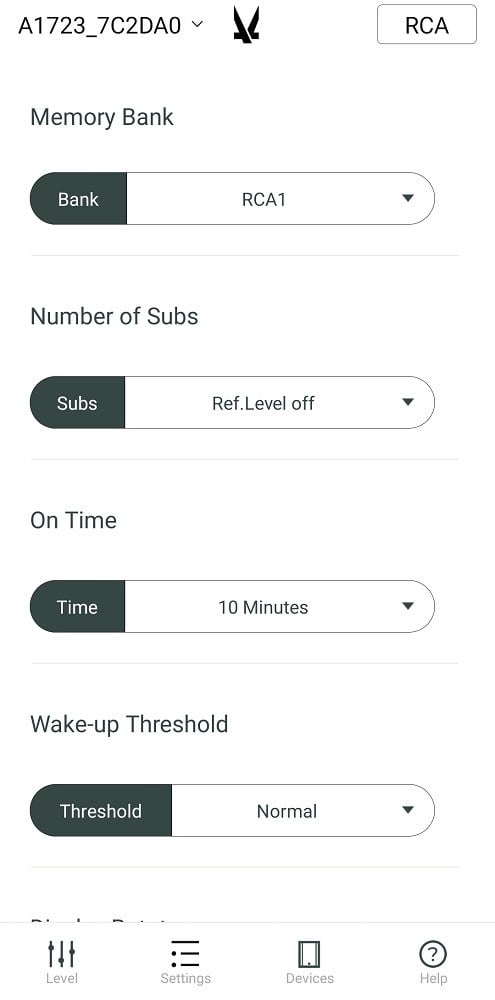

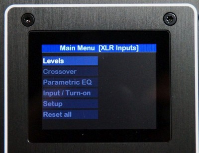

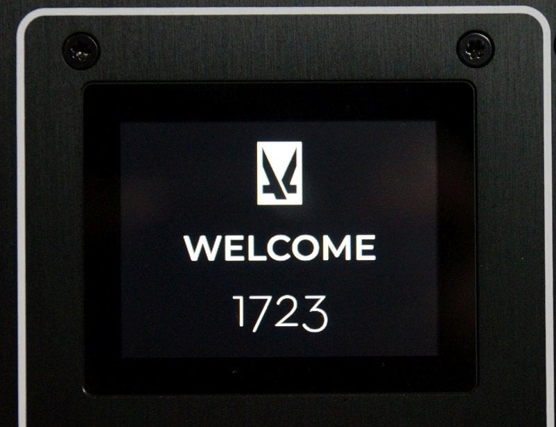

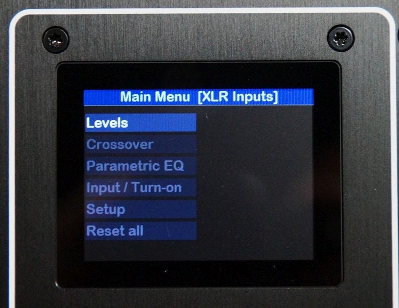

The 1723 2V can be controlled by an app for iOS and Andriod for those who don’t want to have to get up off their sofa to change the settings of the subwoofer. All the same settings from the LCD screen can be controlled by the app. The app also has a test tone for when you want to make sure it can produce a signal. One nice thing about the app is the graphic display of the parametric equalizer for those who want to see the effect that their changes have on the response. The app also has a time delay setting that can be changed by 0.25ms increments out to 50ms which can come in handy for situations in a multi-sub system where the subs have different distances. The ability to change time delay can synchronize all the subs so that their arrival of sound can hit the listening position simultaneously.

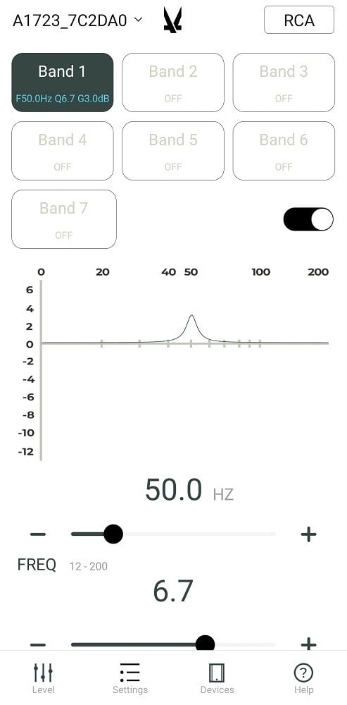

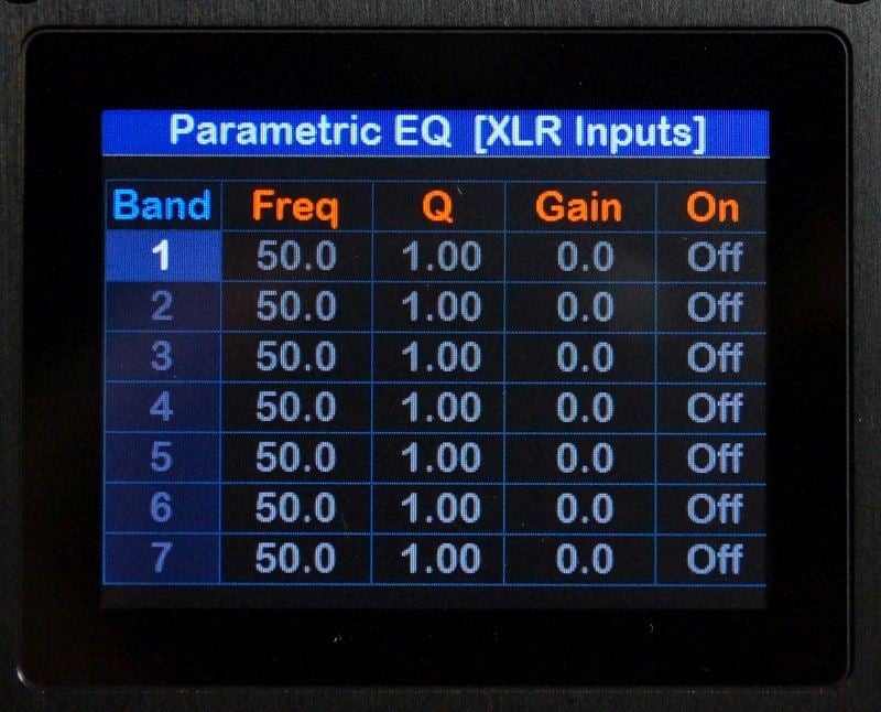

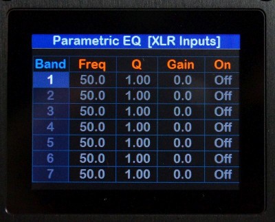

No Need for External Equalizers!
With a 7-band parametric equalizer, each Arendal 1723 subwoofer has a great deal of flexibility in taming the response from the inevitable damage inflicted by typical room acoustics. What is more, a multiple 1723 subwoofer system can be globally controlled as subwoofer groups in the Arendal sub app, so that equalization can very easily be extended to multiple units which is the best way to equalize low frequencies in a multi-sub system instead of having an different equalization for each sub. That feature, plus the ability to set delays in such fine increments on each sub, essentially does away with the need for external equalization in a multi-sub system altogether. All the user has to do is measure the system response and make the required changes in the app. With this ability, it's worth experimenting with higher-crossover frequencies in a multi-sub system as well since room modes don't stop at the standard 80Hz crossover frequency. With a multi-sub system, localization from higher crossover frequencies will be less of a concern since the bass will likely be emanating from several different directions thereby balancing out any particular localizable source.
The drivers and amplifier are mounted in a stout high-density fiberboard enclosure that constitutes the bulk of the weight of the unit. The driver mountings are 2” thick, and the side panels are 1” thick. There is a windowpane brace running along the length of the cabinet to reinforce the mid-section, along with plenty of stuffing to help damp rear pressure waves. One element that also helps to brace the cabinet is the slot port. The port is constructed by running some parallel panels from the back to the front of the cabinet as well as halfway up the front panel and ends in a flaring. This adds more rigidity to the side walls as well as more mass. It is considerably heavier than using cylindrical ports but is a more elegant integration of the vent to the enclosure. Another elegant touch is the mounting of the drivers on opposite sides of the cabinet. The mechanical transfer of energy from the moving mass of the drivers to the enclosure is canceled out completely by the opposite driver per Newton’s laws of motion. This means that the drivers impart no rocking motion on the cabinet. Contrary to popular belief though, there is still a need for a braced cabinet since dual opposed driver mountings do nothing to alleviate internal pressure forces.
 The 1723 2V comes with a port
plug in case the user wants to run it in a sealed operating mode, but there is
no sense in getting a sub this large to use it in a sealed configuration. It
negates the point of this subwoofer. Many ported subwoofers include port plugs
nowadays, and it’s not an expensive addition, so I can see their reasoning as
“why not.” However, all it does is rob the subwoofer of lower-frequency output.
Sometimes users will want to temper the low-end in cases of rooms that get a
lot of pressure vessel gain which can confer a big deep frequency boost that
can make for a boomy sound, but the better solution to that is equalization
rather than plugging the port. EQ’ing can shape the response of the sub much
more precisely and leaves all the headroom intact. The 1723 V2 has a powerful
parametric EQ onboard so that is what should be used to alter the response.

As was mentioned previously, the 1723 2V includes grilles that cover the cones. The grilles are attached with some magnets that have a good amount of force, so they do not come off easily. There are some rubber feet that give about 3/4” clearance from the ground. That isn’t a lot of room for fingers that have to lift the sub, and I would wish for just a bit more height to safely lift the sub by hand. The feet have the Arendal emblem molded into the bottom which is a nice point of detail for the sub.

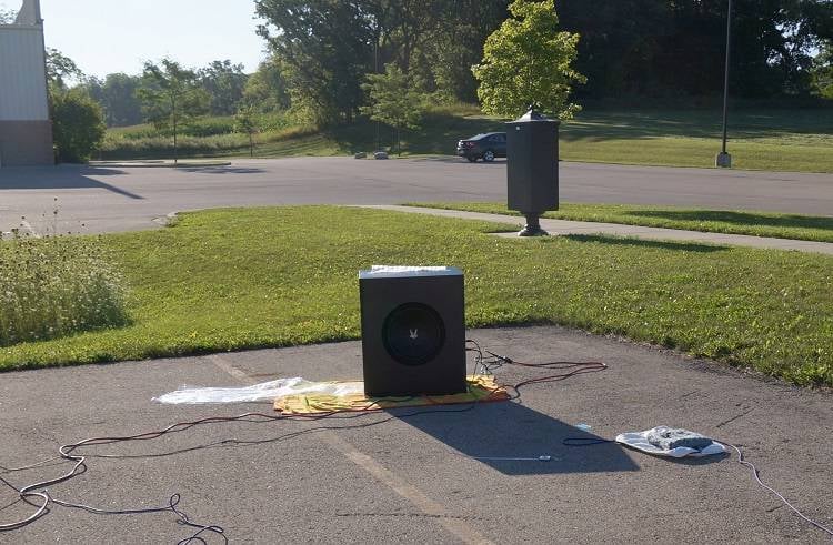

Testing on the Arendal 1723 2V was conducted with the microphone facing the port and woofer at a 1-meter distance and using the distortion numbers for those test results. Test results at 20Hz and below were also used for those results. Further testing was conducted at 8-meters for 25Hz and above. This was done to offset the distance difference from the opposite side driver which would have had which would not fairly be reflected in 1-meter or 2-meter measurements. Distortion results are posted from 1-meter results due to the much higher noise floor in 8-meter testing. The temperature was recorded at 69F degrees with 53% humidity. The subwoofer’s gain was set to maximum, phase was set to 0, and the low pass filters were left off.
The above graphs show the measured frequency responses for the Arendal 1723 2V subwoofer. We see a terrifically flat response throughout the subwoofer band frequencies. Upper bass extension extends beyond 300Hz, although we do see some port resonances just below 200Hz in the vented configurations. Those resonances aren’t likely to affect anything in typical crossover frequencies or even abnormally higher crossover frequencies. The key response curve in all of these is the EQ1 setting in the vented mode. Barring some odd acoustic situation, that is the advised operating mode for a sub like this. In that curve, you get a near totally neutral response from 100Hz down to 20Hz with very usable output down into infrasonic bass. This is a large sub meant to produce deep bass at high output levels, so all of the other configurations are mostly extraneous. However, we have published them so readers can see the full range of this subwoofer’s behavior.
Performance Tip: Use the Arendal 1723 2V subwoofer in EQ1 setting for best performance.

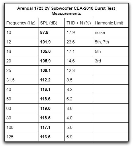

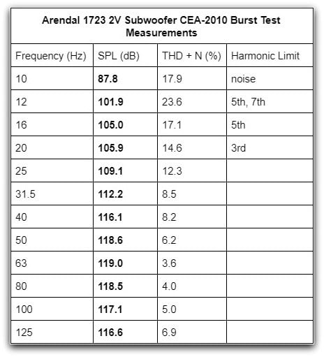

CEA 2010 Data for Arendal 1723 2V Subwoofer (2 meter RMS)
 The above CEA-2010 measurements
are short-term bursts that show the subwoofer’s clean peak SPL before heavy
distortion sets in. Our measurements have been referenced to 2-meter RMS, which
is 9dB down from the standard requirement for the measurements to be shown at
1-meter peak. However most publicly available CEA-2010 measurements are shown
at 2-meter RMS, so we followed that convention. It should be said here that
while special measures were taken to fairly capture output from the 1723 2V, it
still might not quite add up to what a more conventionally designed subwoofer
could get. Output produced from the driver on the opposite side of the
enclosure from the microphone’s position may still be under-reported,
especially at 80Hz and above.
The 1723 2V puts up some big numbers as would be expected from something of its specs. It has serious mid-bass output that touches 119dB at 63Hz, so it can cause bruises when asked to, and it does so with finesse as well, seeing as how it can’t be made to exceed 10% THD. Something else to note is the 12Hz and 16Hz output; the 1723 2V is able to belt out a lot of extremely deep bass. Not surprising for such a large sub but impressive nonetheless. These are some big numbers from a big sub that can fill a big room, and with this level of performance, it easily achieves our Bassaholics ‘Extreme’ Room Rating.

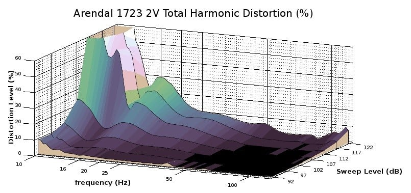

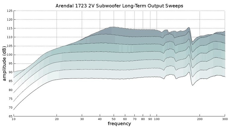

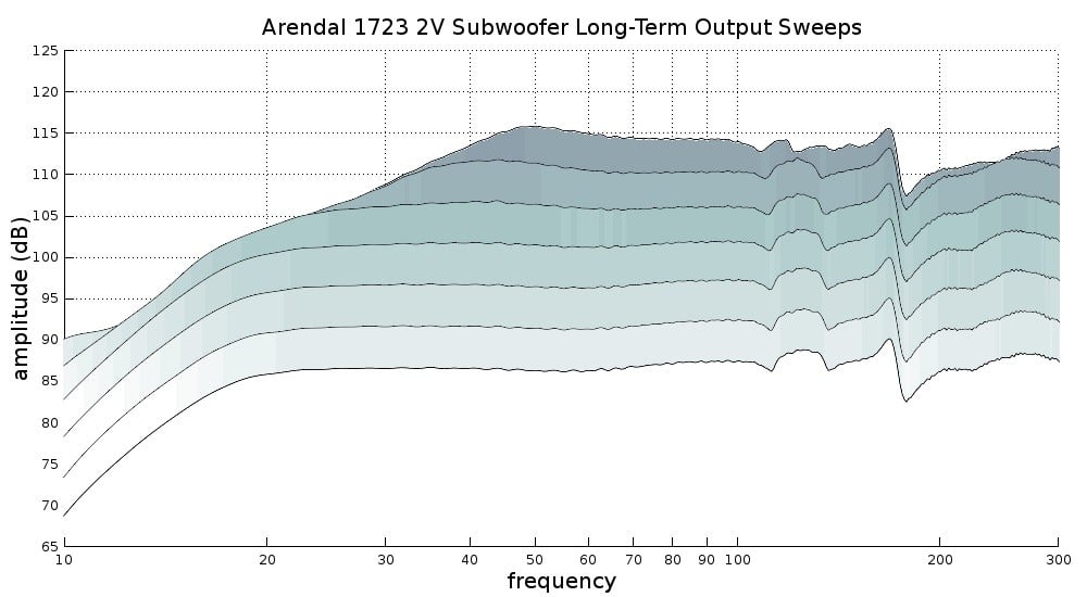

Testing for long-term output compression was done by first conducting a 20-second sweep tone where 50Hz hit 90 dB with the subwoofer scaled to a 2-meter distance from the microphone. We then conduct further 20-second sweeps by raising the gain by 5dB until no more output could be wrung out of the subwoofer. These tests show us the long-term continuous headroom that the subwoofer is capable of. The 1723 2V holds its shape nicely out to the 105dB sweep before compressing the low end of the response. At higher levels, it does run out of steam in deep bass, although there is still a massive amount of mid-bass on top before the amplifier gives up. 115dB continuous from 45Hz and above is a nice line to see on a graph, but it is pretty stunning to hear in person. This thing has tons of punchy bass output for music. One thing to note is that the slope of the response below port tuning at any point is relatively shallow for a ported subwoofer, so we are seeing a bit more extreme deep bass than would be expected, and that is exhibited in the 16Hz and 12.5Hz burst measurements.

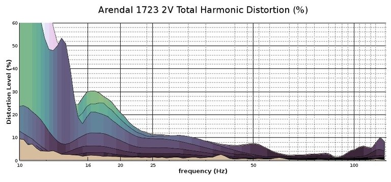

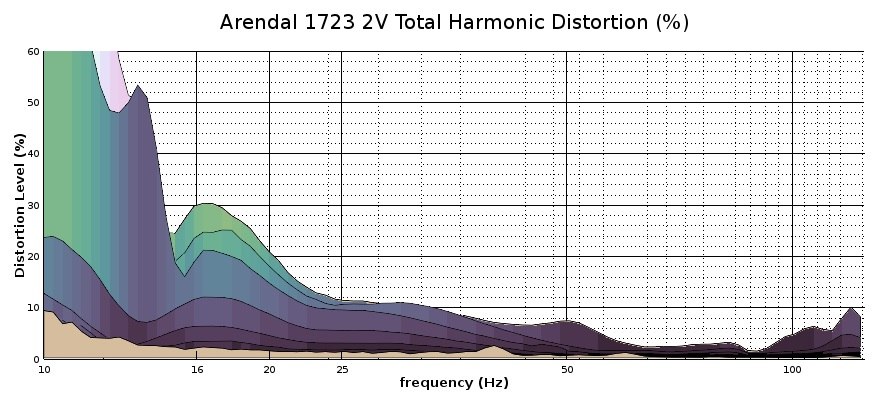

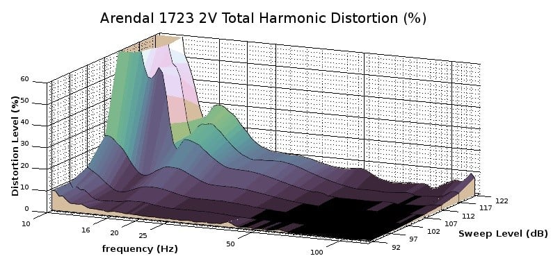

The above graphs show the corresponding total harmonic distortion to the long-term output graphs. Essentially, they depict how linear the subwoofer remains for the corresponding drive level seen in the long-term sweeps. The quantity being measured is how much of the subwoofer’s output is distortion and is shown here as a percentage. At nominal levels, the 1723 2V is extremely clean and hovers around 1% to 2% THD until below 20Hz—totally inaudible. This is truly extraordinary performance.. Crank it to its maximum output, and it still keeps a respectable composure, barely exceeding 10% THD until below 25Hz. It isn’t super-happy at port tuning when pushed really hard and maxes out at 30% THD, but we have to remember that output at that level in that frequency range is 20dB down from higher frequency ranges on account of the compressed response shape, so distortion wouldn’t be very audible in anything but sine wave test tones. I certainly didn’t notice any in my own listening. Overall, this is a great showing, especially considering the output levels that are being produced.

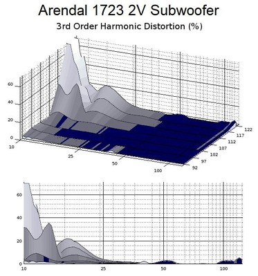

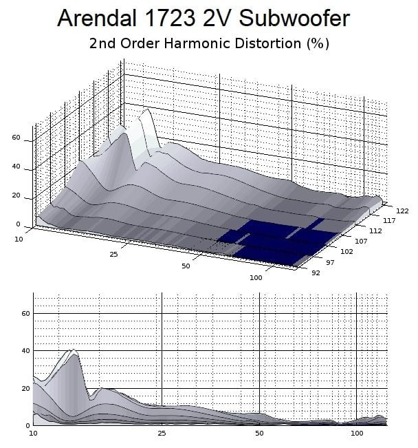

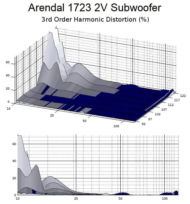

The above graphs depict measurements of the constituent harmonics from the long-term output sweeps and are what the total harmonic distortion measurements are composed of for the 2nd and 3rd harmonics. These individual harmonics can give us a clue as to what might be the cause of some quirk or non-linearity. We are only showing the 2nd and 3rd here because they more or less reflect the higher even-order and odd-order behaviors, although higher-order harmonics tend to be much further down as a percentage of distortion compared to the second and third.
Above 16Hz, the dominant distortion type for the 1723 2V subwoofer is even-order and primarily the 2nd harmonic, but it is still relatively low in quantity. Even-order distortions are particularly difficult to perceive in music because of their harmonious relationship to the fundamental, and the 2nd order doesn’t exceed 10% until nearing 20Hz, so it would almost certainly be inaudible for music as well as movie effects sounds. The more audible odd-order harmonic distortion doesn’t raise its head until the drivers are being stressed at high-excursion levels below 25Hz, and again, in the frequency range where it is popping, up, overall output is down considerably, so it isn’t something that is going to be heard at all in real-world use. There isn’t much to worry about here, especially so when taken into context the distortion type and drive levels that these distortions are occurring at.

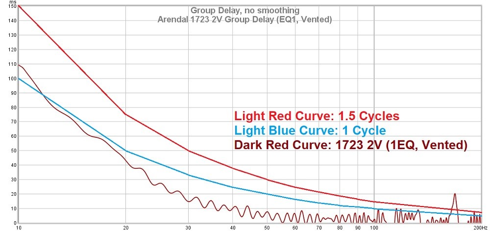

Group delay is the measurement of how much time it takes for individual frequency bands of an input signal to be produced by the speaker. It can indicate that some frequency components are developing slower than others or are taking longer to decay. It is generally thought that 1.5 sound cycles are needed for group delay to be audible at bass frequencies, although there is an argument that group delay should remain under 20ms to be completely unnoticeable, but that is likely meant for mid and upper bass frequencies. One remarkable feature of the 1723 2V is that it manages to keep group delay below one cycle down to such a deep frequency. Most ported subs exceed one cycle of delay since the port output has a 180-degree lag behind the woofer’s oscillation. The 1723 2V has managed to avoid this. Group delay almost hits one cycle at port tuning but doesn’t quite make it. Delay stays very low all the way down below 30Hz before exceeding our worst-case scenario of 20ms, and by then the frequencies are so deep that any kind of phase distortion would have to be extreme for human audibility, a level of delay way beyond anything seen here. There is some fuzziness in mid-bass above 100Hz that exceeds one cycle, and that seems to be caused by port resonance; that all goes away when the port is sealed. It lays too far above common crossover frequencies to be concerned about anyhow. All in all, this is a terrific showing as far as time-domain performance goes. Within subwoofer-band frequencies, this 1723 2V has a superb transient response.
The Downside
 Before wrapping this review
up, we will briefly go over the strengths and weaknesses of the product under
evaluation, and, as always, we will start with the weaknesses. A discussion of
the weaknesses of the Arendal 1723 2V could only be a short one since this sub
has few weaknesses. One unavoidable drawback of a sub like this is the sheer
size and weight; it is not easy to handle. That isn’t so much a weakness as it
is a simple trade-off in getting a sub of this caliber of performance. There is
no way to get big deep bass without the subwoofer being large itself. Arendal
probably could have made it lighter by going with MDF instead of HDF
construction, but that would come at the expense of the build quality. So much
of audio engineering is a matter of trade-offs, so you can never have
everything. If you want a premium quality subwoofer and are able to handle the
size and weight, the concessions that Arendal makes will be well worth it for
you. And if you can’t handle a subwoofer this large and heavy, the good news is
that there are a lot of great subwoofers that are smaller and lighter,
including some from Arendal themselves. You would have to buy multiple smaller
subs to equal the 1723 2V performance, and that is a valid strategy for an
easier-to-handle setup (on the other hand, you could get multiples of the 1723
2V for something truly mind-blowing).

Something else that might be a drawback for those who are trying to get the most possible output for their money is that there are other subwoofers that do offer more raw output for the same price range. While the 1723 2V offers a tremendous level of output, Arendal isn’t trying to win SPL drag races with it. It is a product that is well-rounded in every dimension, and to pursue raw output above all else is not the balance they are looking for. To make a car analogy, as is so often done for audio products, the 1723 2V is like a “grand touring” luxury car; it has a high displacement engine as well as a heavy-duty build, advanced features, and a sleek appearance. It isn’t as fast as a pure track car, but it’s plenty fast without suffering deficits in any other aspect.
That brings us to the discussion of the strengths of the 1723 2V; it is such a well-rounded subwoofer that it is strong in every aspect of design. It isn’t lacking in anything. The performance is superb; it has a terrific extension with substantial output down to an astonishing 12Hz. 115dB continuous midbass headroom will punch you in the chest all day long with your favorite party tunes. Excellent time-domain performance ensures that the bass is snappy and will not lag behind other components of the sound mix. And its low distortion ensures that the sound that you do hear is what is intended by the artists and sound engineers rather than inadvertent noise added by the system.
The build quality is terrific, and this subwoofer has a sense of solidity that befits its pricing. The enclosure remains inert, even at high output levels, and you could rest your drink on it without fear of it vibrating off of the sub (although I recommend using a coaster so as not to mar the top surface of the lovely finish). It could be used as a speaker stands for a bookshelf speaker or a monitor such as the 1723 THX Monitors for the ultimate Arendal floor-standing speaker system (again, put a protective matte on them for that use). Two 1723 2V subs as speakers stands for some 1723 THX Monitors would be an absolutely monumental setup.
The technology and sophistication are second to none in its price class. App control, LCD screen, control based on inputs, seven-band parametric EQ, master control for subwoofer groups, control over input sensitivity, wake-up sensitivity, and control over many more parameters make this sub a fine-tuner’s dream-come-true. You can dial it to perfection, and the onboard parametric EQ negates the need for an outboard equalizer to take down peaks caused by problematic room acoustics. What is more is that it has advanced real-time monitoring over many elements of electrical activity, and it can modify its operation to function optimally in changing circumstances or just shut itself down if it detects anything potentially dangerous so it won’t allow itself to be damaged.
On top of the performance, build quality, and advanced features, it also looks nice as far as large subwoofers go. Beveled edges, sleek woofers, and a fine satin or gloss finish do a lot to make this a classy-looking audio product. It can be loud in sound, but it isn’t loud in appearance. One thing that can be done to alleviate its size is to use it as an end table; since its vibrations are so minute, it won’t rattle anything off, so a table cloth can be placed on it and allow it to be used as a surface to hold stuff.
