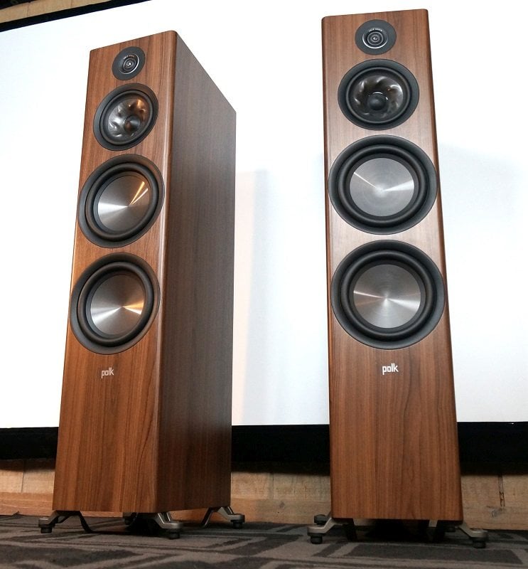

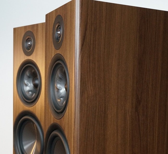

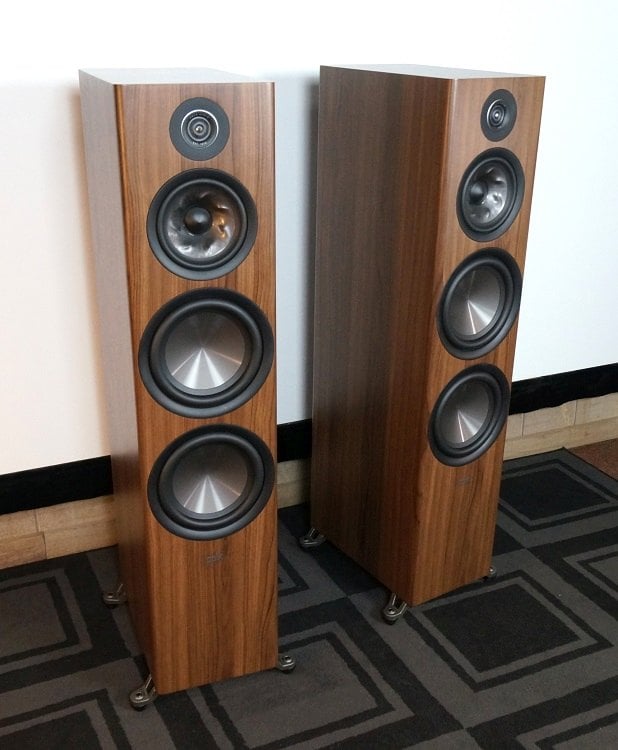

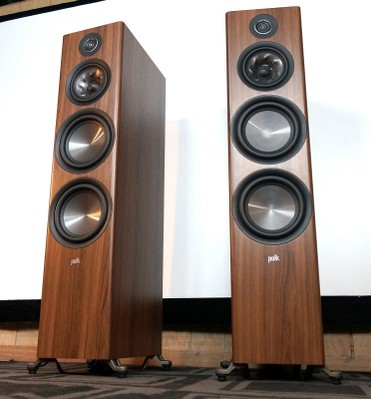

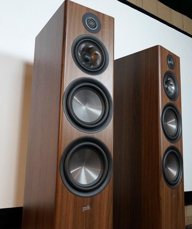

Appearance

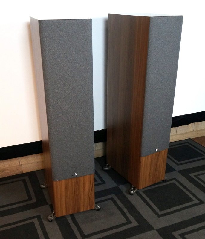

At a glance, the Reserve R700s look like pretty typical floor-standing loudspeakers. Their overall shape and styling do not push the envelope in terms of industrial design. That is not to say they look bad at all; on the contrary, I think they look nice. But maybe the “Reserve” part of their name signifies how aesthetically reserved they are. It is only when you take a closer look at them where they do have some elements that set them apart from other loudspeakers in this class. Details like the turbine midrange cone or the ring radiator tweeter are slightly unusual as is the “power port” base design. On the whole, the styling is conservative but too simple to become stuffy or staid.
The enclosure can be had in a textured vinyl black or a walnut veneer. I received the walnut veneer, and I think this is the finish to get between the two available finishes. The walnut veneer looks quite nice. It is not a real wood veneer but rather a vinyl imitation. However, it is not at all obvious and quite a convincing imitation. The cabinet has rounded edges, which is a welcome touch to give it a sleeker and more inviting appearance. The magnetically attachable grilles really dull the appearance of the R700s. I think the exposed drivers give it a more interesting appearance but without turning it into any kind of eyesore since it already has sedate styling. The bass driver cones have a cool metallic sheen, and so do the midrange cone and tweeter to a lesser extent. The midrange has some nifty swirling fins in the cone that gives it a bit of flair, and the tweeter has a pointed pole piece that also lends a nice touch of visual detail. All of the drivers have trim rings that hide the screws, thereby giving the ungrilled appearance a bit more class. Overall, the Reserve R700s are so understated that they could fit unobtrusively into just about any interior decor. They are simply ‘nice’ without being particularly eye-catching or unattractive.

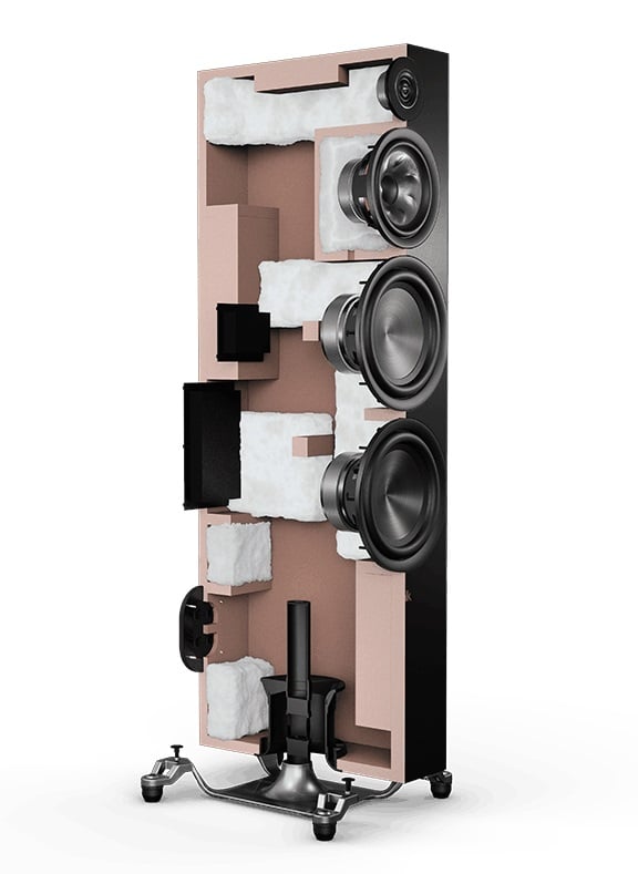

Design Overview
As mentioned, Polk’s Reserve series draws a lot from their Legend Series, so we will be quoting our Legend review since they share very similar or the same components. To start with the obvious, the Reserve R700 is a three-way floor-standing speaker with a down-firing port. Getting into a more detailed discussion of the speaker, we will start at the top with the tweeter. It uses a 1” ring-radiator tweeter that Polk has relied on for some time on their higher-end loudspeakers. Ring-radiators are a bit different from standard dome tweeters. The way ring radiators work is that instead of having the voice coil former affixed to a dome as in traditional dome tweeters, the voice coil former is simply connected to two large soft ringed suspension pieces: an outer ring and an inner ring. The inner ring is connected to a stationary rod in the center that also holds that needle-looking phase plug. Whereas in normal dome tweeters, the acoustic radiating surface is the dome. In a ring radiator, the acoustic radiating surface is these two large suspension rings. Normally the suspension bits in drivers are used merely to hold an acoustic radiating surface in a manner where it only has one plane of travel, back and forth.
To quote from our Legend series review:

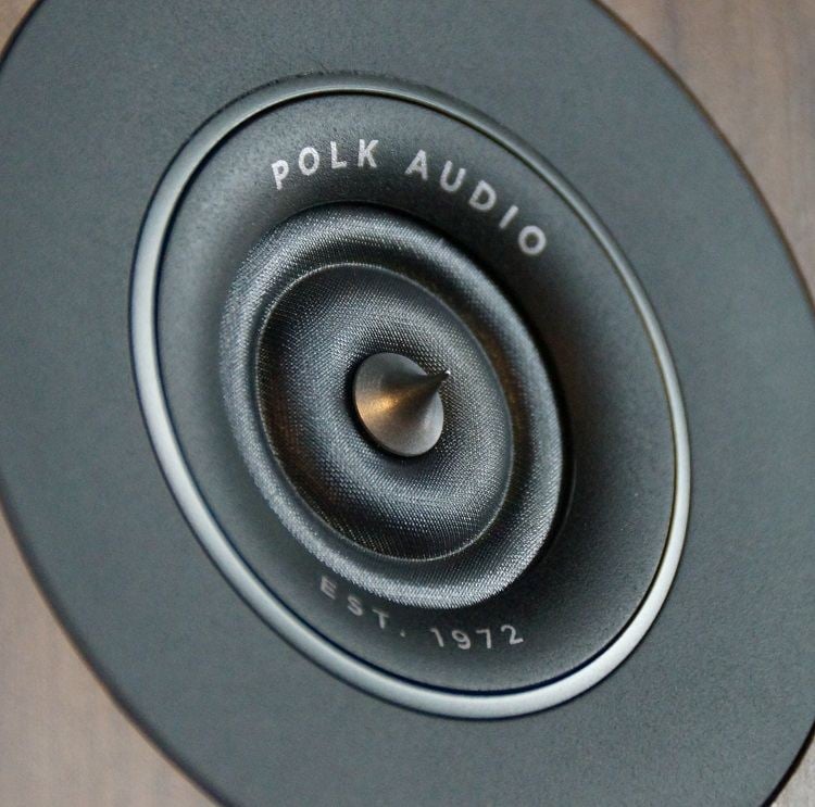

"One of the advantages of ring radiators is that ‘break-up’ modes are pushed out to much higher frequencies versus typical dome tweeters. ‘Break-up’ modes are where the radiating surface, whether that be a dome, cone, or plane, loses its shape from playing frequencies so high that it bends only part of the surface instead of the entire surface. It can really hurt the sound quality of any speaker where it is not controlled. Another advantage is that ring radiators can easily play to ultrasonic frequencies since the soft suspension piece being driven is usually much lighter than traditional dome materials."
The tweeter has a copper cap that should help to drive down inductance, which will give it a wider bandwidth as well as less distortion. It also has a highly-damped rear cavity that will reduce resonances from backwave radiation.

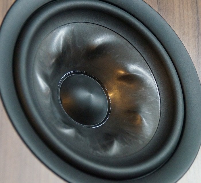

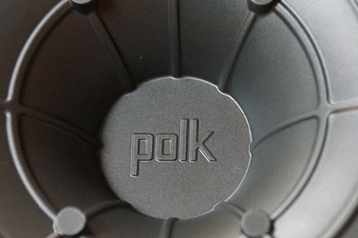

With the midrange driver, Polk again uses a 6.5” turbine midrange similar to that found on the Legend speakers. Again, quoting from our Legend review that uses the same technology:
“The cone has a peculiar shape that Polk calls the ‘Turbine Cone.’ The cone shape has seven fin-type protrusions that form a vortex pattern hence the name ‘turbine.’ The shape and number of these fins are claimed to make the cone stiffer which can drive break up modes higher in frequency where they will be easier to filter out by the crossover circuit.”
The fins are only part of the measures utilized by Polk to thwart cone break-up, and one other tactic they use is the material composition of the cone itself. Polk calls it the foam core polymer injection cone, and it is a very stiff foam with a dense exterior that sandwiches a light but rigid interior foam structure. It is lighter, stiffer, and better damped than more typical cone materials. The result of the turbine shape combined with the foam core cone are drivers that can play to relatively high frequencies before break-up artifacts start affecting the sound. That means that any cone misbehavior will be easily filtered out of audibility so that it does not intrude upon the tweeter’s bandwidth.

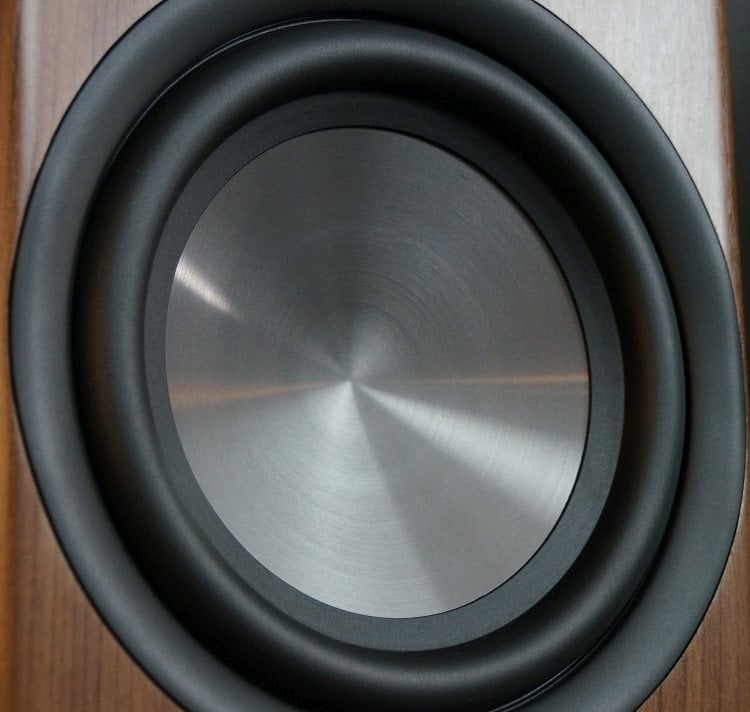

Getting into the bass drivers, the R700 uses two 8” polypropylene cones with some beefy half-roll surrounds that look like they could move plenty of air if given the opportunity. One interesting design detail about the bass drivers and midrange driver is that they use dual opposite-facing spiders so that any one-way bias in excursion by one spider is negated by the other spider. This should lower even-order harmonic distortions as well as do more to keep the voice coil aligned and restricted from lateral movements. The midrange and bass drivers also use shorting rings in order to reduce induction effects, which again broadens their bandwidth and reduces distortion.

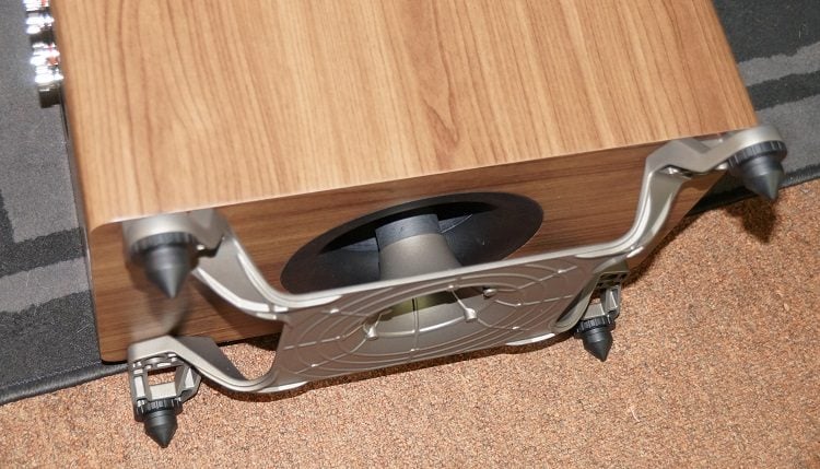

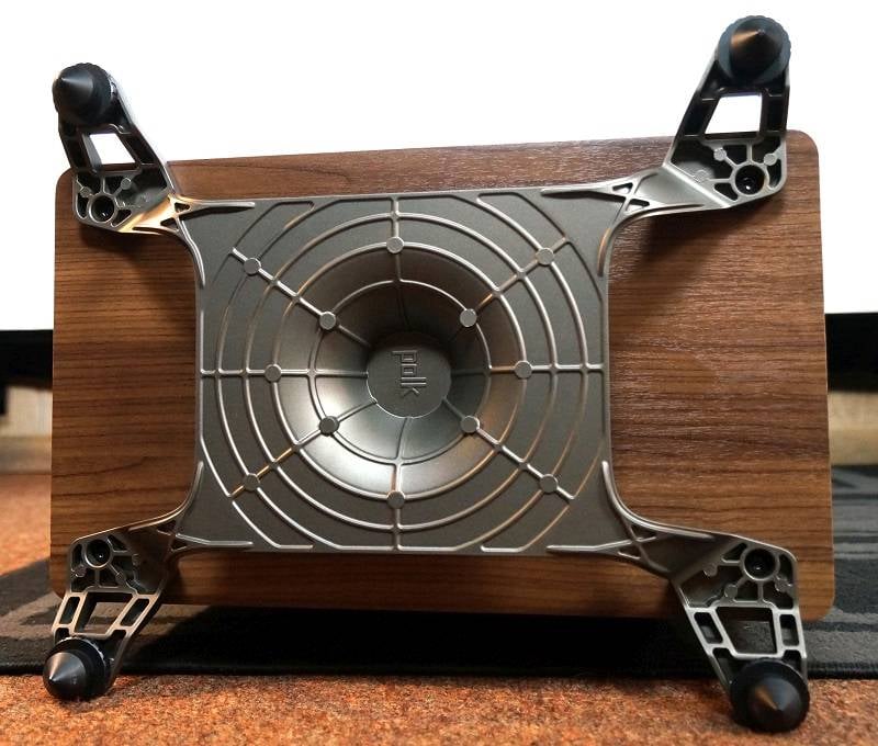

The port on the R700 is quite interesting and shows some thought was put into pushing standard port design forward. Polk has always had their ‘Power Port’ technology which places a prong mounted on a base into the port opening that is supposed to reduce port turbulence by controlling the travel of air at the port’s exit. For the Reserve R700, Polk has evolved this technology into ‘Power Port 2.0.’ In this iteration, instead of a prong at the port’s exit, there is a tube that goes up into the port and is shaped into a set of closed-pipe absorbers that act as Eigentone Filters (an eigentone is an acoustic resonance caused by parallel boundaries). These filters are strategically located to reduce unwanted port resonance. Resonances above the port tuning frequency are usually unintended and can be high enough in level to affect the frequency response. Polk claims that the Eigentone Filters can reduce these higher resonances by as much as 14dB, which is a major reduction in audibility.
The cabinet is robustly built with plenty of internal bracing and acoustic damping. The midrange driver gets its own sealed enclosure within the cabinet. The base is a solid metal piece that holds some conical feet and does a good job of giving the speakers a stable platform. The terminal cup has two sets of five-way binding posts, so the R700s can be bi-amped or bi-wired. These speakers could probably handle a bit more power than what a normal AV Receiver can produce, so users might be able to extract a few more dB out of them by bi-amplification. For the most part, these speakers should be adequately powered by a decent AVR. It’s worth noting the R700s are IMAX Enhanced certified, which means they meet some threshold of performance, although, like THX certifications, the exact specifications are not known. However, so far the other speakers that have received IMAX Enhanced certification that we have covered have all had very good performance, so that does bode well for the Reserve R700 as well as IMAX Enhanced certification itself.
With a 6.5” midrange driver and two 8” bass drivers, the overall design suggests a loudspeaker with a fairly wide dynamic range, and with design cues from the Legend series as well as IMAX Enhanced certification, they look like they would have a neutral tonality as well. Let’s not see if all of this technology delivers on its promises with some real-world use…

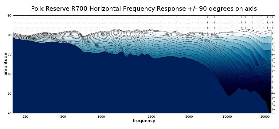

The Polk Reserve R700 Towers were measured in free-air at a height of 4 feet at a 2-meter distance from the microphone, with the microphone raised to a 7.5’ elevation that was level with and aimed at the tweeter center. The measurements were gated at 8-milliseconds. In this time window, some resolution is lost below 400 Hz and accuracy is completely lost below 200 Hz. Measurements have been smoothed at a 1/24 octave resolution.

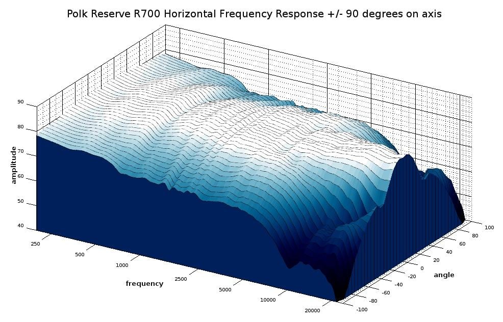

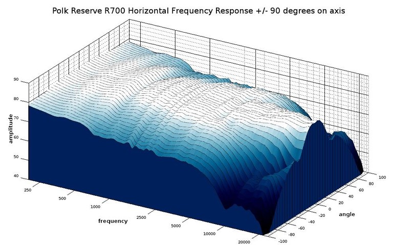

The above graphs depict the Polk R700 Tower’s direct-axis and horizontal dispersion out to a 90-degree angle in five-degree increments. Information on how to interpret these graphs can be read in our article "Understanding Loudspeaker Review Measurements Part II". The first thing to observe is the very flat response at and near the on-axis angle. This is a neutral loudspeaker. The on-axis window would be characterized as +/-1.5dB from 200Hz to 20kHz by our measurements. This is exceptionally good, especially for this price range. We do see that the tweeter loses off-axis dispersion above 6kHz and beams in a fairly narrow pattern by 10kHz. At high treble frequencies, output is down considerably outside of a 25-degree angle. While listeners don’t need to be dead on-axis to hear the full range of treble from the R700s, they should be roughly around the on-axis angle, so these speakers might require a slight toe-in for an optimal listening experience.

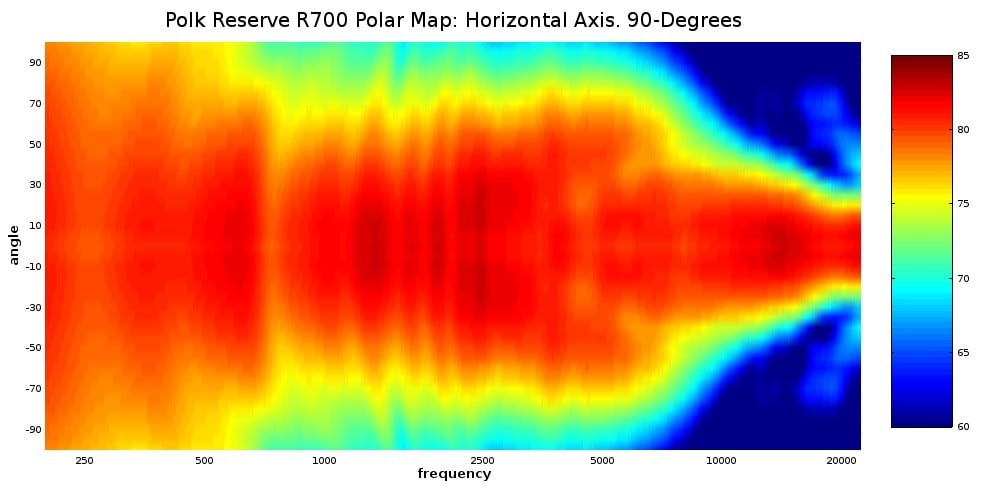

The above polar map shows the same information in the preceding graphs but depicts it in a way that can offer new insight regarding these speakers’ behavior. Instead of using individual raised lines to illustrate amplitude, polar maps use color to portray amplitude, and this allows the use of a purely angle/frequency axis perspective. The advantage of these graphs is they can let us see broader trends of the speaker’s dispersion behavior more easily. More information about interpreting this graph can be read in "Understanding Loudspeaker Review Measurements Part II".
In the polar map of the R700, we can see that the directivity is pretty consistent out to 6-7kHz after which the beaming tweeter constricts dispersion. This general tweeter behavior was also seen in the ring radiators used in the Legend series. Listeners who are seated past a 30-degree angle off-axis might hear a softer presentation than those listening closer on-axis. However, most listening situations place most listeners within a 25-degree angle of the speaker’s ‘aim,’ so this isn’t likely to be a problem. And for those few who are extra-sensitive to high treble, simply adjusting the angle of these speakers can act as an automatic filter to soften the sound. All you have to do is have the speakers facing straight forward with no toe-in angling, and that should place the listening position at about a 30 to 35-degree angle which will shear off a lot of output above 10kHz.

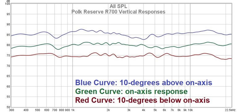

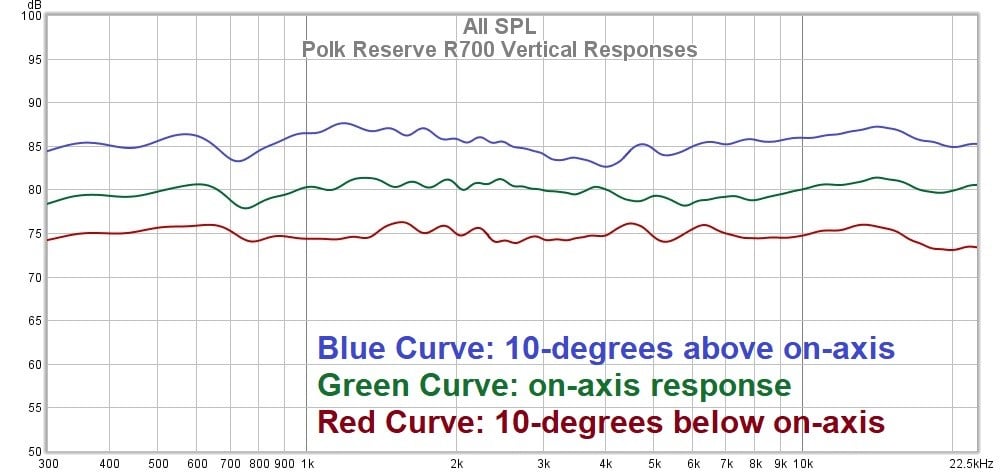

The above graph shows the response of the R700 at a sampling of some vertical angles. One interesting thing we can see in comparing these responses is that the -10-degree angle looks to be the most linear response. That is so linear that there are plenty of studio monitors that aren’t as accurate! The advantage there is that angle is more likely to be the vertical angle that most people listen to rather than the tweeter height which is a bit high (the tweeter sits at a 42” height). This has always been a problem with many larger tower speakers; the tweeter, which is normally the reference angle for listening, is always mounted too high. Polk has addressed this, and in normal use, listeners will be met with a beautifully neutral sound.

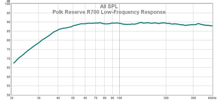

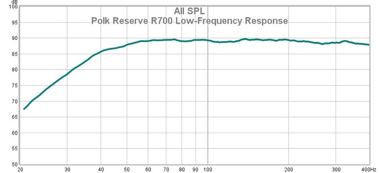

The above graph shows the R700’s low-frequency response captured using groundplane measurements (where the speaker and microphone are on the ground at a 2-meter distance in a wide-open area). As with upper frequencies, we see a very flat and accurate response. The port tuning frequency seems to be in the mid-30Hz range from looking at this response alone, although that does get confirmed in the impedance measurement below. Below that point, the roll-off slope looks to be a standard 24dB/octave decline that most traditional ported speakers will have. With room gain, users can expect strong bass down to 30Hz. It’s nice to see that Polk didn’t do anything unusual and just stuck with a hard target of a neutral response. This kind of low-frequency extension should be able to catch almost all bass in music recordings and much of the bass in movie sound mixes. For movies, the addition of a subwoofer would bring benefits to deep-digging science fiction, action, and horror movies, but they certainly aren’t absolutely necessary. Those looking for a speaker that can easily get by without a sub have a good choice in the R700s.

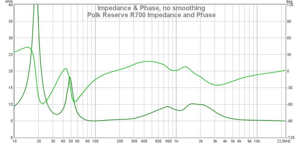

The above graphs show the electrical behavior of the R700 Towers. These speakers are not the most benign electrical load nor are they particularly burdensome. It’s a very normal response, and I would have to say the nominal impedance is about 6 ohms. From this graph, we can tell that the port tuning frequency is about 35Hz. The mismatch of the peaks around port tuning indicates that the resonant frequency of the drivers is lower than that of the enclosure. The bottom line from the impedance and phase graph is that pretty much any normal amplifier will be able to handle these speakers with no problem.
I measured the sensitivity at 88.9dB at 1 meter for 2.83v. That is very close to what Polk reports. That is pretty typical for loudspeakers in this class. Users will not need a monster amp for these speakers to get loud. However, they should be able to take a good deal of power if a beefy amp is available.
