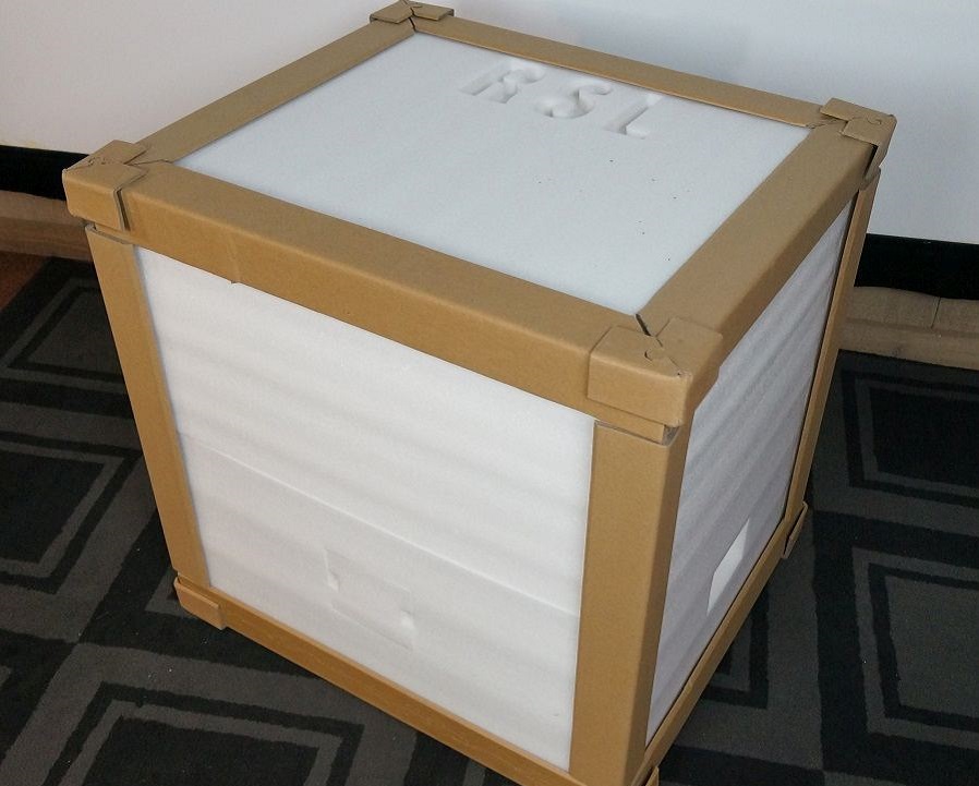

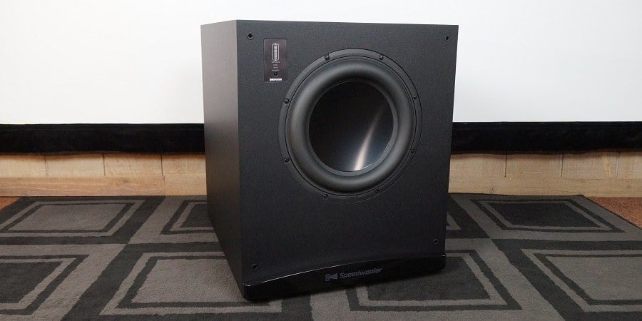

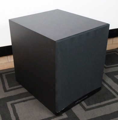

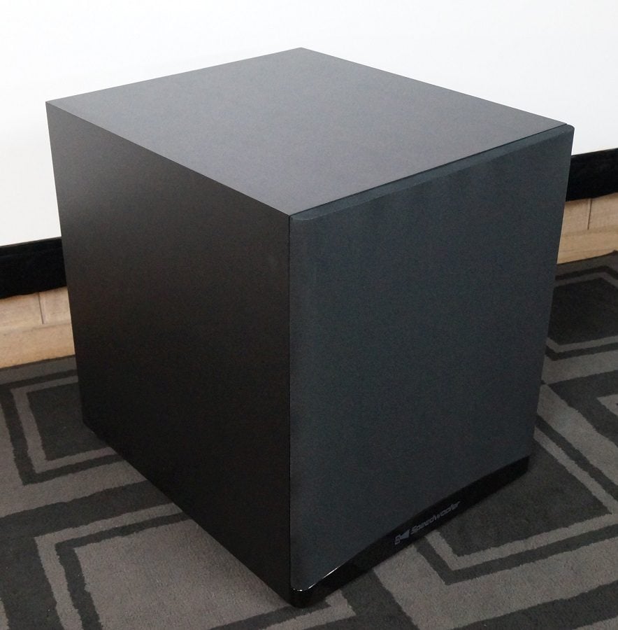

The Speedwoofer 12S arrived at my home in a worrisome large cardboard box. I knew it would be a good-sized sub, but the box made it look like it would be huge. This was not the case, because the packing was very formidable and gave the subwoofer a lot of protection from rough shipping. Indeed, this is one of the best-packed subs I have seen at any price. It is double-boxed, and inside the inner box, the polyethylene foam packing pieces had thick edge protectors and corner protectors on every edge and corner of the unit. What is more, the polyethylene foam pieces didn’t just sandwich the top and bottom of the sub but covered the entire surface area. The top foam piece even had the letters “RSL” etched in it. The sub itself was covered with a soft foam sack to prevent it from moisture contact or getting scuffed. This packing had to have been expensive, but it shows that RSL cares about getting their product to end users in good condition. Parcel companies will have to really put in extra effort to damage this sub during transit (but I do not doubt that they will give it their best try). As someone who deals with a lot of speaker and subwoofer packing, I have to tip my hat to RSL here!

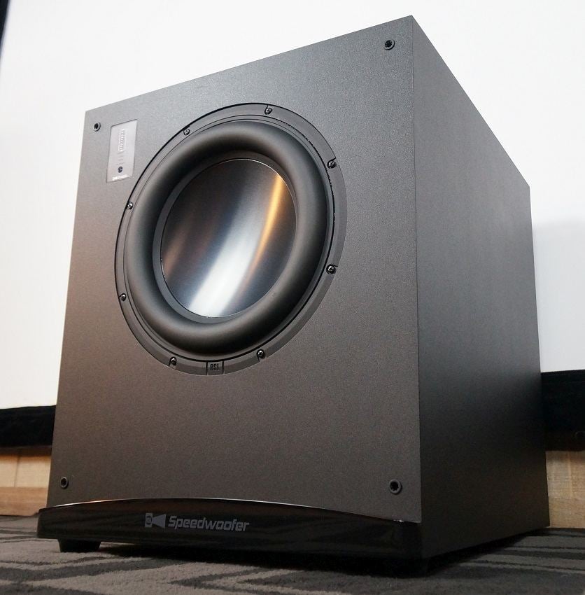

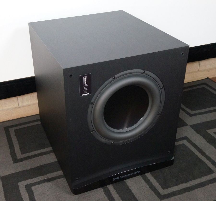

Once unpacked, we are faced with a fairly typical sub with a few minor stylistic flourishes. The finish is a dark textured vinyl that we often see in subwoofers and speakers in this price range. It doesn’t reflect a lot of light and doesn’t scuff or scratch easily. It also doesn’t show fingerprints like a satin or gloss finish would. With the grille on, the Speedwoofer 12S is a nearly featureless black box. The grille does round the front edges and corners which helps to soften up the appearance somewhat. It gently curves over a lower base piece that is finished in a plastic gloss and has the model name printed on it. With the grille removed, the woofer is exposed, but I think it’s a cool-looking cone. It is basically a larger version of their 10S cone, a smooth concave aluminum piece held in by a beefy half-roll surround. There is an RSL logo tooled into the bottom of the die-cast frame. There is an LED indicator meter mounted in the top left of the front baffle, and when active, its light is visible through the grille fabric. With the grille off, the edges are all hard ninety-degree turns, and the corners are hard angels too. For this reason, I think a lot of people are going to be using the grille; tripping and falling on the uncovered edges or corners of this sub could be pretty nasty. Overall, the Speedwoofer 12S doesn’t look bad but it isn’t going to win beauty contests among subs in this class either. This is very much a function-over-form design, so then let’s now talk about the design…
Design Analysis

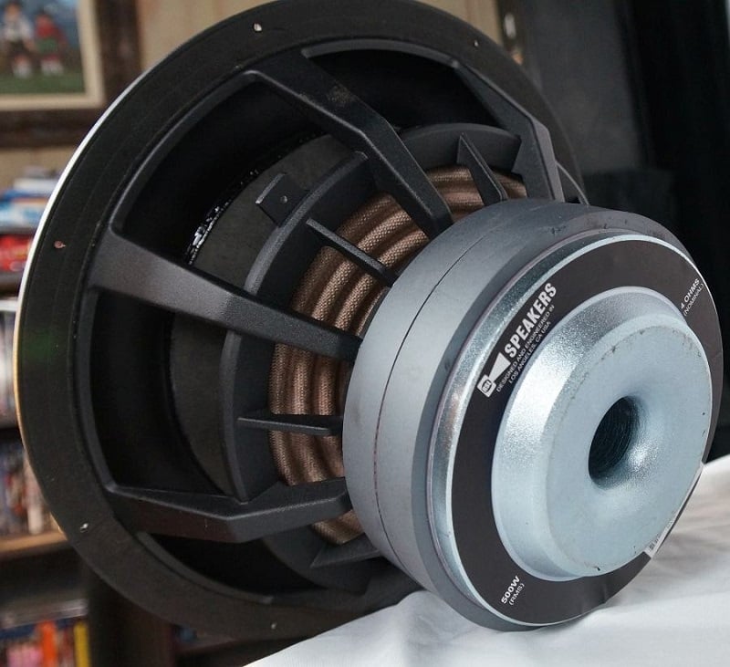

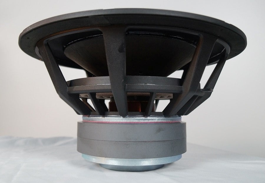

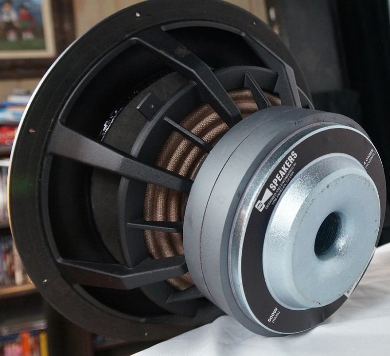

The Speedwoofer 12S shares a lot of the design of the 10S albeit scaled up a bit, but it does take some engineering departures from RSL's popular 10” sub. Let’s start our analysis of the design with the driver. The 12S, as its name suggests, uses a 12” driver. The cone material of the 12S driver is the same as the 10S: a Kevlar-reinforced paper cone with an aluminum dustcap. The cone attaches to a beefy cast aluminum frame by a nitrile rubber surround and two Nomex spiders. The dual spider suspension system is interesting and is not something seen on the 10S. The spiders face each other in a mirrored configuration, and the advantage that brings is any non-linearities on one side of the spider’s travel are negated by an inverse motion, and this design should help to reduce even-order harmonic distortion products. This suspension system should offer very even motion for both inward and outward travel of the moving assembly. By using two spiders, the former should also be much more restricted to a single plane of motion, and unwanted lateral movement should be greatly reduced. The moving assembly should be much more difficult to knock out of alignment, so this driver should be more durable than typical drivers.
The FEA-optimized motor uses a large 2 3/4” diameter multi-layer copper voice coil. It is surrounded by a 6.5” diameter stack of two magnets with a combined thickness of 1 ⅝”. While the magnet dimensions don’t fully answer the question of how much magnetic force it generates, I would guess it is pretty powerful. Venting is done under the spiders as well as through the pole piece. The back plate is bumped out to allow for greater excursion distances. Altogether, this is an extremely hefty-looking driver for a sub at this price point.

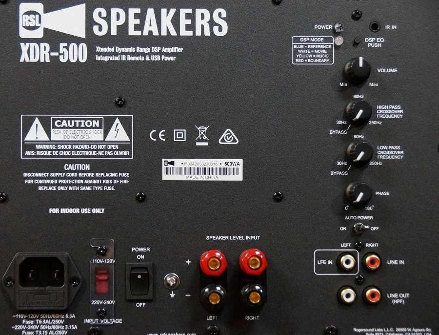

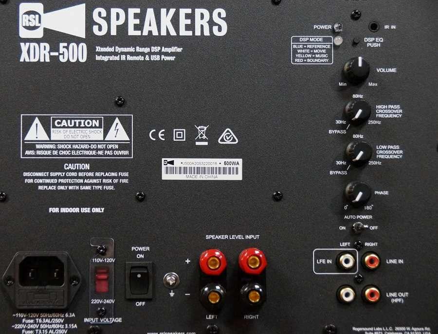

The driver is powered by a 500-watt Class-D amplifier called the XDR amp (where XDR stands for eXtended Dynamic Range) with some sophisticated digital signal processing onboard. It uses a double-precision 56-bit, 50 million-instructions-per-second DSP processor that has four different preset response curves: Reference (has the least equalization), Music (places more emphasis on music-band frequencies), Movies (boosts the deep bass response), and Boundary (filters out deeper frequencies so as not to bother neighbors). Class-D amplification gives the 12S very high efficiency, and the standby power consumption is only 1 watt as well. What’s more, the amplifier of the 12S uses a new heatsink technology for greater thermal efficiency and capacity. Input connectivity consists of left and right RCA connectors, as well as speaker-level connectivity. It also has left/right RCA outputs. There is a USB power port for easier integration of a wireless receiver. The controls are fairly standard: Volume knob, variable phase knob, low-pass filter (30Hz to 250Hz with a 24dB/octave slope), and auto-on power switch. The 12S also has a chassis ground screw on the amp plate that can help those trying to get rid of a ground loop hum.

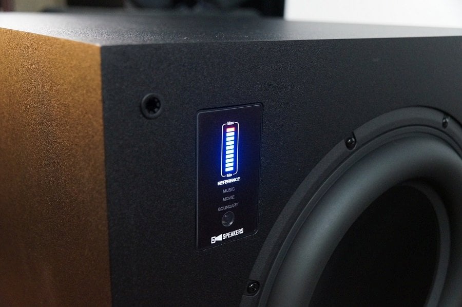

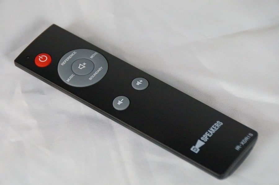

While the 12S doesn’t have app control, it does come with a remote control that can change the DSP mode and volume level and also has a mute function. There is also a front-mounted multi-segment LED meter that can show levels for volume as well as display muting or DSP modes. This is useful because the user can easily see what adjustments are being made on the sub itself when using the remote. One quirk of the system is that the ‘auto-on’ can be overridden on the remote control so the sub is ready to reproduce any signal without needing to be activated by an amplitude threshold, but the remote is also needed to undo that to go back to ‘auto-on.’

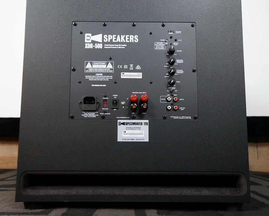

The one non-standard control is very cool: a high-pass filter knob for the RCA outputs that have a 30Hz to 250Hz range with a 24dB/octave slope. This is very useful for simpler systems that have no bass management such as two-channel rigs with a simple stereo preamplifier. You can route the signal from the pre-amp to the sub and then to the amplifier, and the sub can do all the bass management with the user simply setting the high-pass filter at the same frequency as the low-pass filter. It does make me wish that the 12S had balanced XLR or ¼” inputs and outputs, since balanced connectivity combined with adjustable high-pass filtered outputs would be especially useful in small ‘prosumer’ studio systems.

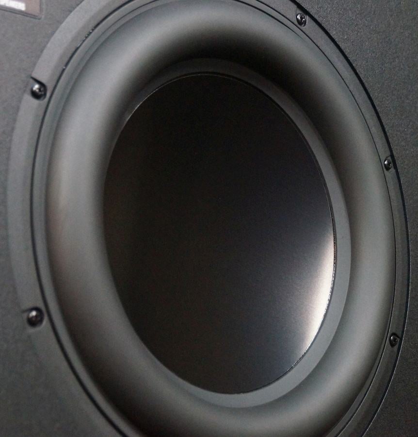

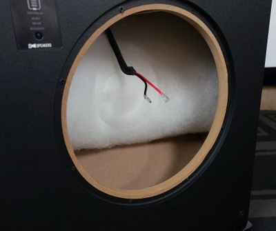

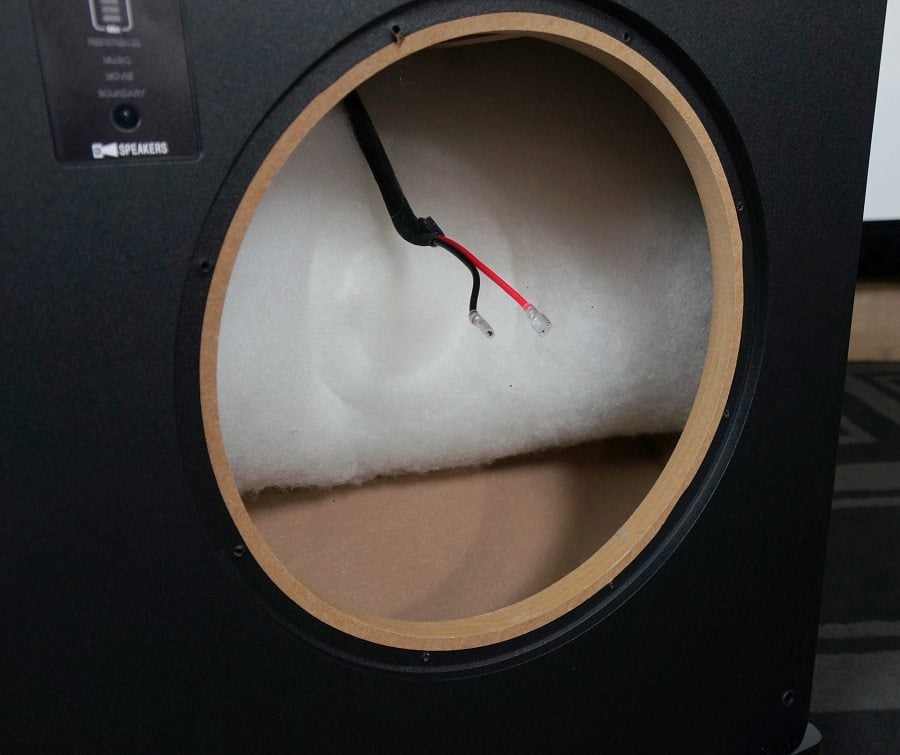

The 12S has a 1” thick laminated front baffle and ¾” thick side panels. The enclosure features RSL’s ‘compression guide technology’ that divides the interior space into three different chambers where the backwave pressure from the rear of the cone can compress and expand in a manner that reduces resonances. it seems to borrow from transmission line theory, which can get quite complex. Within the sub, there is a solid diagonal piece that stretches from the lower front of the enclosure to the upper rear, so there are two larger compartments in the enclosure. The upper rear of the sub is open so that the backwave goes over it into the lower compartment. There is an opening in the front of the lower compartment that opens up to a slot port that extends to the back of the sub. The larger chambers divided by the diagonal piece are filled with a thick batting material for damping internal waves. I don’t know how well it works with respect to traditional ported enclosure designs, but it does add a lot of internal bracing to the sidewalls of the 12S. It also has two braces running along the top panel, as well as a plethora of corner bracing to reinforce the edges. This sub is very sturdy, and it feels like it in both weight and also a knock test on the panels.
The grille is a thick frame with fabric stretched over it. It is held on by some sturdy plastic pegs that squeeze into rubber-lined grille guides. It’s a stout grille and wouldn’t be easy to break. The feet are some rubber cylinders that thankfully give fingers enough clearance to lift and lower the sub by hand. Some heavy subs just don’t leave enough clearance to safely lower the unit to a carpeted floor without the risk of crushing some fingers. RSL provides two sets of furniture sliders for both hard surfaces and soft surfaces. The hard surface furniture sliders have a soft, slippery bottom that enables the 12S to be slid over hard flooring without the risk of scratching it. The soft surface furniture slider enables the 12S to be slid over carpeted surfaces easily. It’s a big and heavy sub, but RSL has provided means of moving it into position without needing to strain back muscles.
Overall, it looks like the 12S is going after deeper bass extension and a bit more overall output than the 10S from comparing the size of the driver versus the enclosure size. The ingredients are there to make it happen. Let’s see how it pans out in practice…

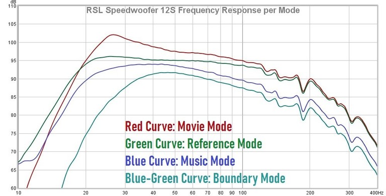

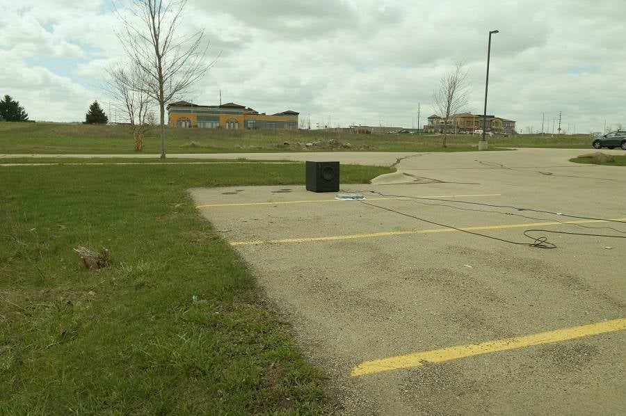

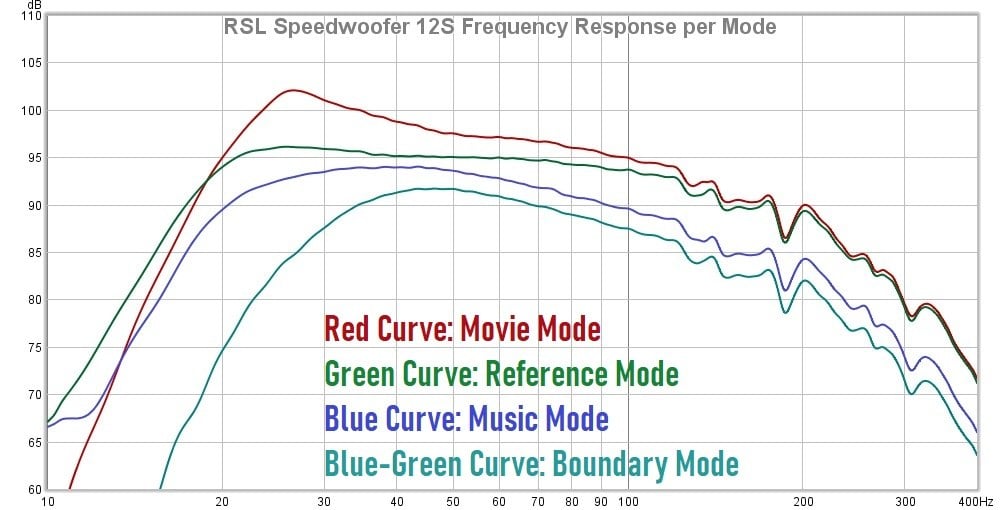

Testing on the RSL Speedwoofer 12S was conducted with the microphone facing the woofer at a 1-meter distance with measurements scaled back to a 2-meter distance by subtracting 6dB. The temperature was recorded at 55F degrees with 55% humidity. The subwoofer’s gain was set to maximum, phase was set to zero, and the low pass filters were set to bypass.
The above graph shows the measured frequency responses for the Speedwoofer 12S subwoofer. It should be kept in mind that these responses were measured with the microphone facing the woofer, and some of the port-generated output isn’t fully represented in this orientation, so this subwoofer’s frequency response does extend a bit deeper than what is shown on these graphs. Users have a variety of different tonalities to pick from. ‘Reference Mode’ holds the most neutral response and is nearly ruler flat from the low 20s to nearly 100hz. ‘Movie Mode’ tips up the bass from 20 to 40Hz, and that should give a bit more oomph to effects sounds such as explosions. ‘Music Mode’ shaves off some low-end that might alleviate room gain, and ‘Boundary Mode’ shaves off a lot of low-end so as to be less noticeable to neighboring rooms. Individual tastes should determine what mode to be used, but RSL tells me that most of their customers prefer ‘Reference Mode.’ That isn’t surprising to me as it should yield the most balanced sound, at least in a room that doesn’t get a lot of low-end gain. My room does not get much gain, so I did appreciate the “Movie Mode” to add a little bit of punch on movie night. RSL provides something for everyone here.

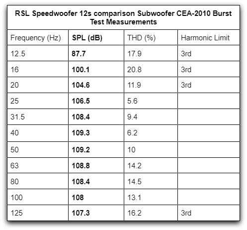

The above CEA-2010 measurements are short-term bursts that show the subwoofer’s clean peak SPL before heavy distortion sets in. Our measurements have been referenced to 2-meter RMS, which is 9dB down from the standard requirement for the measurements to be shown at 1-meter peak. However most publicly available CEA-2010 measurements are shown at 2-meter RMS, so we followed that convention.
The Speedwoofer 12S posts respectable
numbers in mid-bass (which, for subwoofer-band frequencies, we will classify as
50Hz and above), but it packs a much more serious punch in deep bass. Relative
to the 10S, the Speedwoofer 12S doesn’t really exceed its output at 50Hz or
above, but it makes gains at lower frequencies, and the lower it goes, the
larger the gains. For example, at 16Hz, the 12S can hit 100.1dB whereas the 10S
hits 86.5dB. That is over a 13dB difference, and that means that you would need
more than four 10S subwoofers to equal a single 12S at 16Hz. At 20Hz, the 12S
more than doubles the output that the 10S can produce. At 25Hz, the 12S exceeds
the 10S by nearly 70%, and at 31.5Hz, the 12S still outperforms the 10S by over
50%. By 40Hz, the 12S’s lead shrinks to a 2dB advantage, but that still
constitutes a 25% output difference. Relative to other subwoofers, the 12S
maintains more headroom in deep bass than in mid-bass. Many subwoofers in this
class have more disparity between mid-bass and deep bass headroom. This burst
test data places the 12S in Audioholics’ Bassaholic ‘Large’ Room Rating,
meaning it should be able to handle a room of 3,000 cubic feet. It easily
surpasses the 25Hz threshold for the large room rating, but only clears the
frequency band above that by a couple of decibels. For information on how the
room ratings are determined, please read our article “Bassaholic Subwoofer Room Size Rating Protocol”.

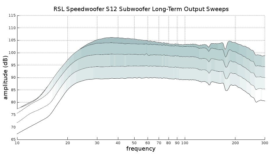

Testing for long-term output compression
was done by first conducting a 20-second sweep tone where 50Hz hit 90 dB with
the subwoofer 1 meter from the microphone (graph has been scaled to 2 meters
for easy comparison with our other review measurements). We then conduct
further 20-second sweeps by raising the gain by 5dB until no more output could
be wrung out of the subwoofer. These tests show us the long-term continuous
headroom that the Speedwoofer 12S is capable of. Again, we should note that the
microphone orientation that this sub was tested in does not fully reflect port
contribution, so it does have a bit more low-end output than what is shown
here. This testing was done with the 12S set in ‘Reference’ mode, but running
the subwoofer in ‘Movie’ mode would end up at the same response shape and max
output when the amplifier and driver have nothing left to give. The subwoofer
doesn’t really change its response shape until the last few dB and keeps a
nicely flat response up to then. And even so, the differences between the
nominal response shape and the maximum output response aren’t gigantic. The 12S
keeps good control over its response at all drive levels and doesn’t compress
as much as most subs that we push to the limit.

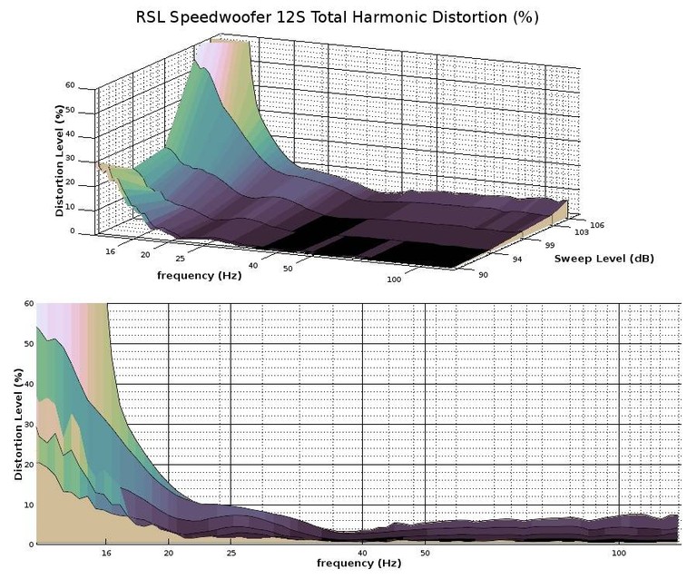

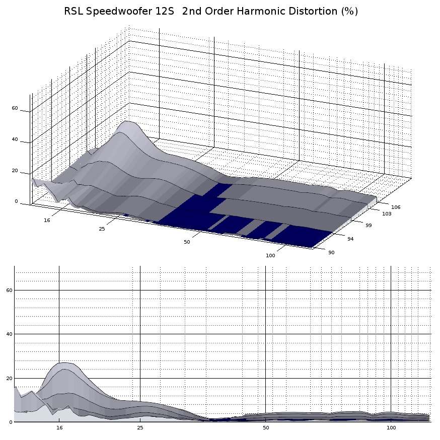

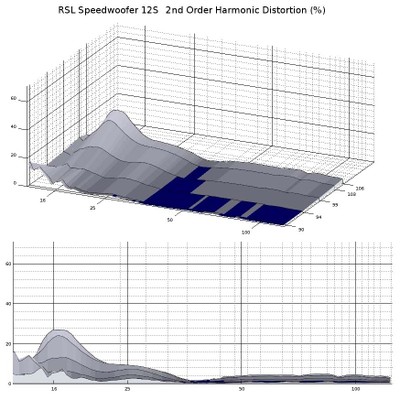

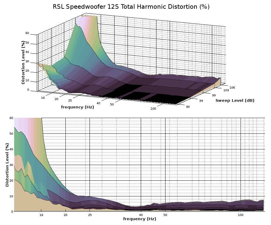

The above graphs show the corresponding total harmonic distortion to the long-term output graphs. Essentially, they depict how linear the subwoofer remains for the corresponding drive level seen in the long-term sweeps. The quantity being measured is how much of the subwoofer’s output is distortion and is shown here as a percentage. The 12S puts up a very nice showing here, never surpassing 10% THD above 25Hz even at the maximum drive level. The last few decibels of its performance envelope do push it a bit above 10% THD at 20 to 25Hz, but at lower drive levels, the output is very clean. At the 90dB sweep, the 12S keeps THD below 10% at 16Hz, and at higher frequencies for the same drive level, it is vanishingly low, not even registering 1% THD. At higher drive levels than 90dB, the 12S isn’t very happy at 16Hz and below, but it isn’t producing much output in that range anyhow so any distortion products wouldn’t be terribly audible. Overall, the 12S is fairly buttoned up and is averse to producing noises that aren’t in the source signal, no matter how loud it is cranked. On this count, it separates itself from the Speedwoofer 10S again; while the 10S has about the same level of output above 50Hz, the 12S keeps output a lot cleaner in that range when driven hard. In fact, the 10S would probably be perceived as being a louder sub since the harmonics would be a lot more audible than the fundamentals. If you want a subwoofer that doesn’t lose fidelity no matter how hard it is pushed, RSL looks to have brought one to the table.

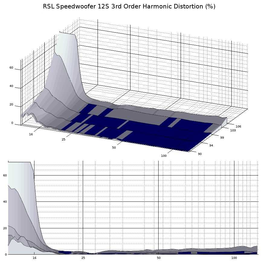

The above graphs depict measurements of the constituent harmonics from the long-term output sweeps and are what the total harmonic distortion measurements are composed of for the 2nd and 3rd harmonics. These individual harmonics can give us a clue as to what might be the cause of some quirk or non-linearity. We are only showing the 2nd and 3rd here because they more or less reflect the higher even-order and odd-order behaviors, although higher-order harmonics tend to be much further down as a percentage of distortion compared to the second and third.
The distortion products of the 12S look to be a mixture of even and odd-order harmonics. At around port tuning, even-order harmonics are dominant, and below that, odd-order harmonics take over. It’s possible that the back pressure from the enclosure and port is preventing the cone from oscillating as far inward as it is moving outward. The good news is that even-order products are more difficult to discern, so the higher percentage of even-order from 16Hz to 25Hz is less likely to be audible than if they were odd-order. The explosion of odd-order harmonics at 16Hz and below at the higher drive levels is inconsequential, because, as we noted before, the output is dropping like a rock at this point, so there isn’t much of a signal left to distort at such low frequencies.

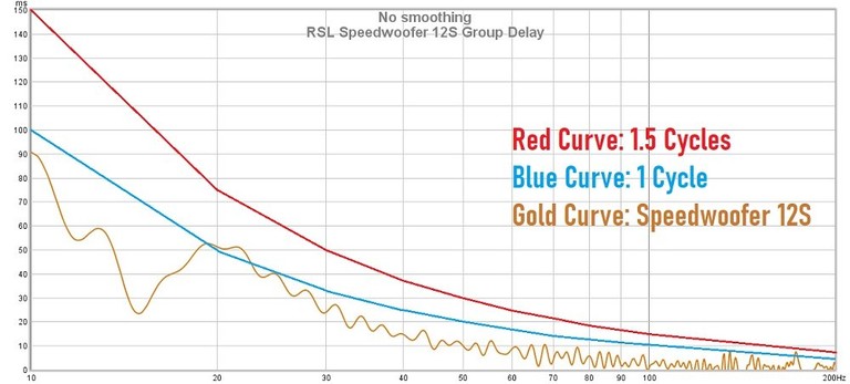

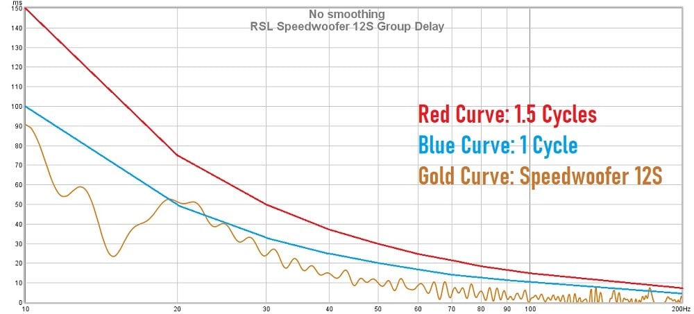

Group delay is the measurement of how much time it takes for individual frequency bands of an input signal to be produced by the speaker. It can indicate that some frequency components are developing slower than others or are taking longer to decay. It is generally thought that 1.5 sound cycles are needed for group delay to be audible at bass frequencies, although there is an argument that group delay should remain under 20ms to be completely unnoticeable, but that is likely meant for mid and upper bass frequencies.
The 12S does well in this measurement, not surpassing 1 cycle until just above 20Hz and even then just barely. It should be noted that this group delay measurement was done in ‘Reference’ mode which is the mode least shaped by DSP equalization, according to RSL. Other modes did elevate the group delay a bit more but not by much, except for ‘Boundary’ mode which added significantly more group delay below 50Hz. I doubt many people will use Boundary mode, and RSL tells me that the vast majority of their buyers use Reference mode. The group delay seen in the above graph gives no cause for concern, and nothing there would be audible in typical use. The time domain behavior of the Speedwoofer 12S is very competent, and it makes a good choice for anyone who is looking for a sub that isn’t laggy-sounding or bloated. Something else that should be noted is that the performance seen here is a marked improvement over the group delay exhibited by the Speedwoofer 10S.
