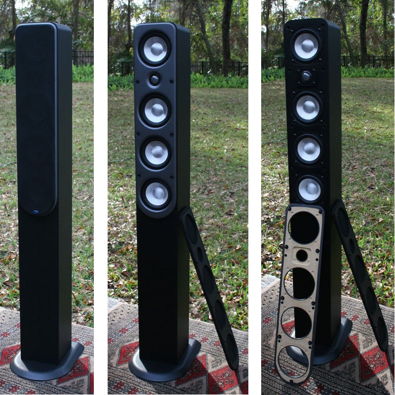

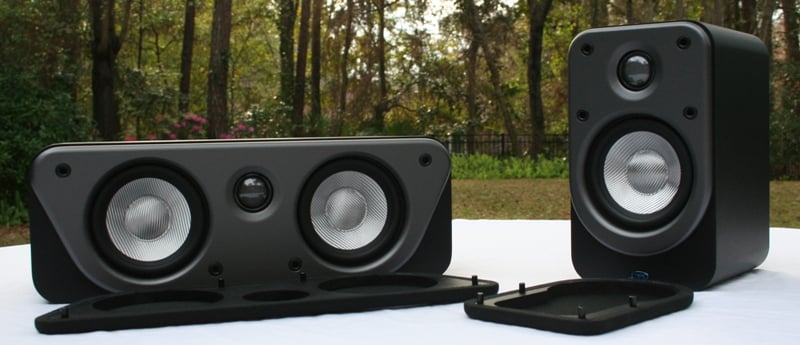

While each of the EF50T tower speakers were packed in their own box (as were the E10s Sub and EF50C center), the EF50 bookshelf speakers were packed together. And boy are they small. At only 8.5" tall, the bookshelves are so tiny that they almost seem out of place with the rest of the speakers in the system. While the center and bookshelves both have threaded inserts on the back for wall mounting, there was a disturbing lack of feet options. Since the center in particular will probably sit on a shelf, the lack of rubber feet seems like a "preproduction" error that most likely will never be encountered by Joe Consumer. Or at least I hope.
Each of the speakers (sans
sub) has what amounts to dual grills. The top grill is an actual grill with
acoustically transparent speaker cloth while the lower "grill" is a faceplate
that outlines the drivers. The faceplate attaches to the cabinet itself while
the grill attaches to the faceplate. There are multiple color options (none
were provided with the review samples so I can't speak to their quality of fit
and finish) available to help integrate the speakers into your décor. This is a
pretty neat idea in that it adds a bit of customization without the need for
hardware or simply changing the grill color. My issue here was that the
grill/faceplate/cabinet connections were often inconsistent in their ability to
stay together. On one of the tower speakers, the faceplate was nigh impossible
to remove while the other could be knocked off with your elbow as you walked
by. While this may be a preproduction issue, I urge EMP to ensure a tight fit
between all these components. While nothing shook loose, the grills and
faceplates were so easy to remove that my 2 year old could do it (and did… a
lot). I personally want a little more protection for my drivers especially
considering how vulnerable the tweeter is without the faceplate.

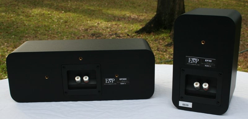

The fit and finish of the
speakers was mostly good. That vinyl black matte veneer is very forgiving. I
did notice a bubble or two near the bottom of the speakers but nothing that
would make me think that it was a systematic issue. The silver five-way binding
posts on the back may not have the audiophile approved finish, but they did
look very nice with the silver drivers. None of the speakers (except for the
sub) were ported so placing them near a wall or in a cabinet will be less of a
problem (please read our

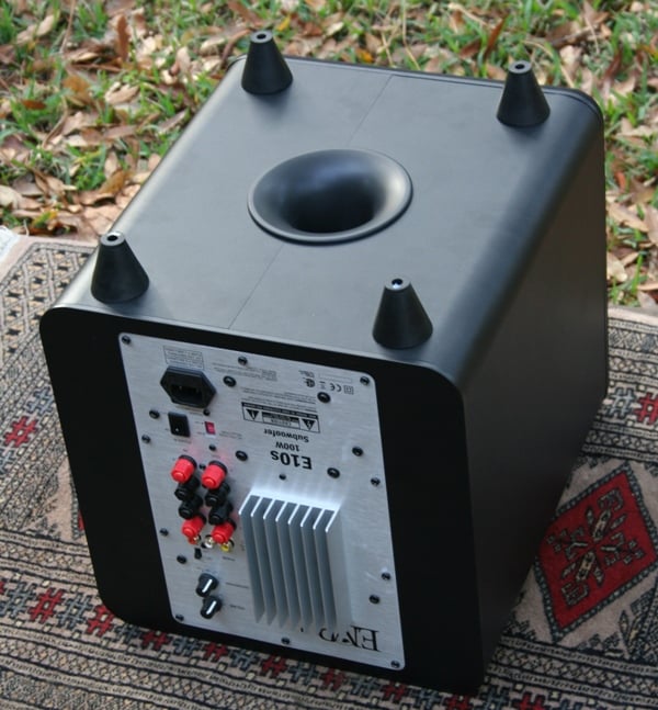

article on in cabinet installation for more details). Even the sub with its
downfiring port shouldn't offer much in the way of placement issues. Everywhere
you were required to attach something to a speaker (feet/base) EMP provided a
threaded insert. The rubber feet of the EF50T speaker were even on a threaded
post so that they could be removed if you changed your flooring.

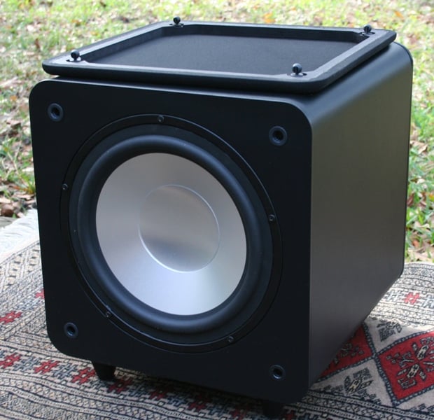

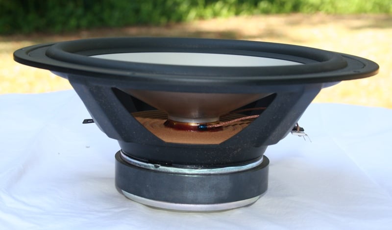

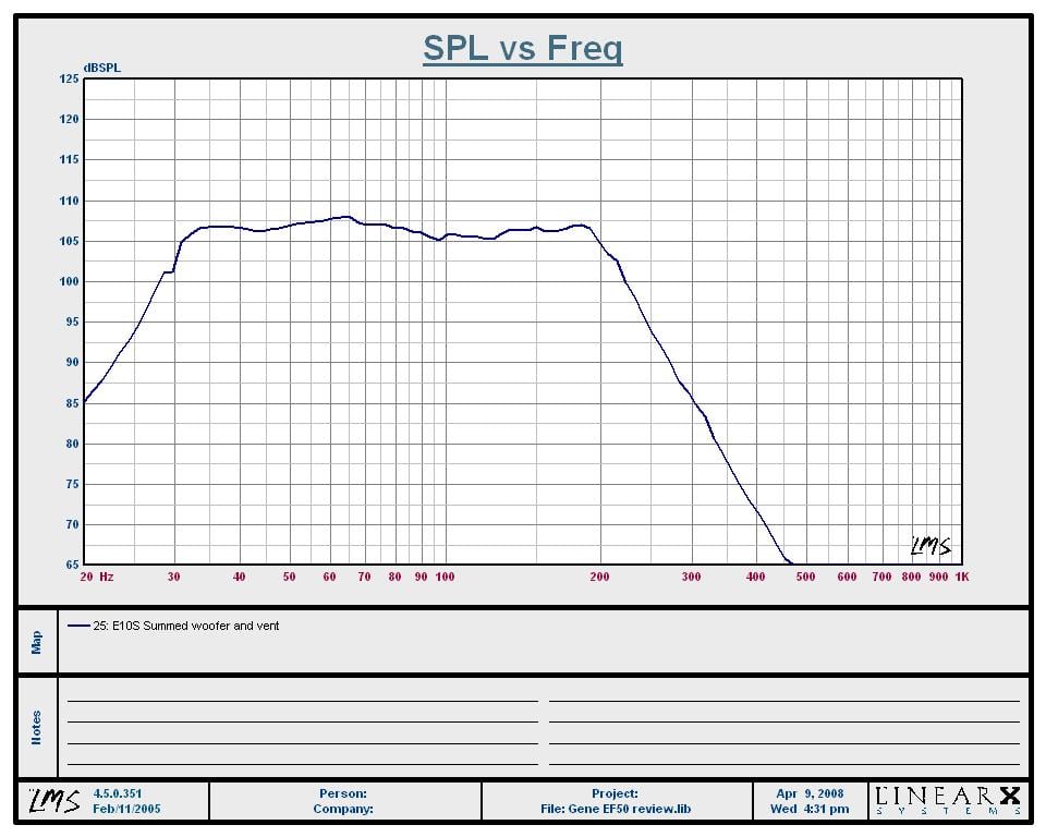

The sub is a front firing 10" with a downfiring flared port. While
it generally disappears in whatever corner you set it up in, taking off the
grill (no faceplate here) gives you an excellent view of the 10" aluminum

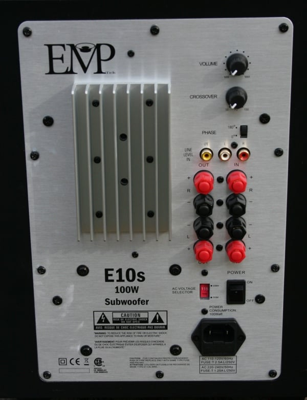

cone woofer. The amp plate has all the usual with volume and crossover
frequency knobs, phase switch, LFE line level input, L/R line level input, and
high level inputs and outputs. For 90% or more of us, you'll use the LFE input
which defeats the crossover setting in favor of your receiver's setting. I had
two issues with the E10s - First there was no "on" mode. The
"on" setting basically engaged an "auto" setting which
shuts down the amp if there is no signal present for a period of time. It took
just about a second for the sub to respond once a signal was present. My other
issue is that there is no status indicator light on the sub. Basically you
can't tell if it is on and working properly without making it play something.
I'd prefer an indicator light that was off when the unit wasn't powered on,
green when it was active, and some other color when in standby mode.

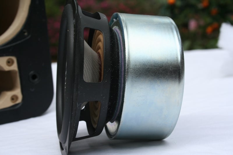

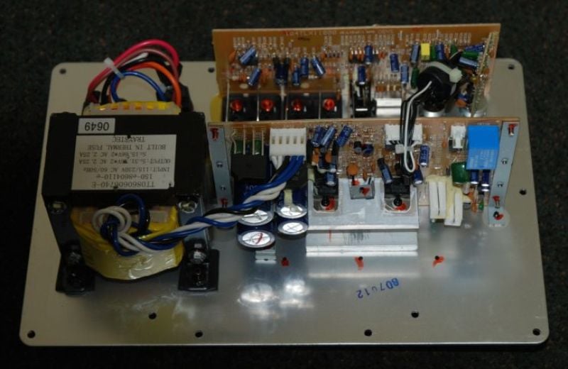

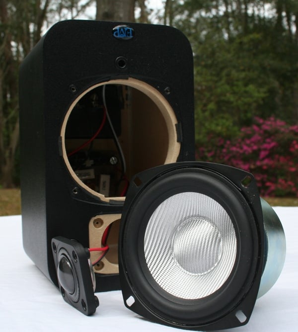

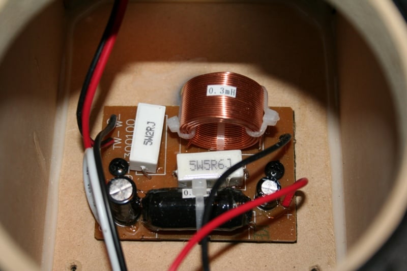

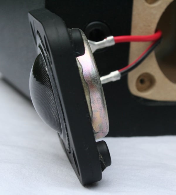

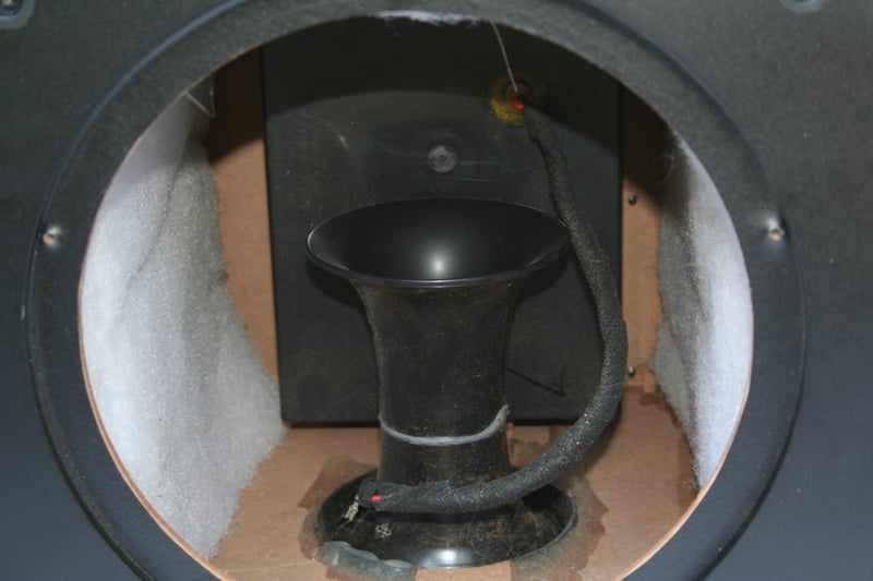

Taking the speakers apart I
found that the cabinets were all constructed out of 1/2" MDF with heavily
glued edges. Center bracing wasn't found on any of the speakers but the sub at
all edges and the towers along the edge of the front baffle had some triangular
bracing. The sub also had an addition brace along the bottom. The speakers
themselves, especially the surrounds, were small enough that they actually self
braced themselves and did not require any additional bracing. They all felt
suitably inert. The sub, in particular, sounded much more inert than many of
the subs I've tested.
All the speakers contained some polyfill to help dampen them with the sub having it glued to all the walls. The towers had three huge pieces jammed into the bottom. The drivers (sans sub) were all shielded so you don't have to worry about magnetic fields messing with your legacy CRT or DVR. All the baskets on the woofers looked to be stamped. The subwoofer utilized a fairly large magnet and the woofer itself is extremely heavy. The crossover utilized air core inductors with electrolytic caps and film bypass caps to improve the overall performance. The subwoofer port was flared to reduce turbulence and the amp utilizes and analog power supply with a fairly hefty E-core transformer and a linear amp.

You're going to read this again in a moment, but I was very impressed with the E10s sub. I decided to play, at near reference level volume, "Piano Smasher" off the Blue Man Group The Complex album. This is a torture test for subs that seems almost cruel. Fortunately, the E10s was up to the challenge and held together very well. There were moments that sounded a bit mushy but overall the sound was articulate and punchy. Even at low volumes you could feel the bass filling the room. At higher volumes you could feel it filling your stomach. Want to have a good time (for an AV geek that is)? Take the grill off, jack up the volume, and watch that 10 just piston out those low frequencies. Good, clean, geeky fun!
Many, many moons ago I reviewed the SVS SBS-01 system. The E10s sub from EMP is expected to cost about the same as the PB10 sub from SVS (no longer in production). While acoustic memory is about 3 seconds and it's been a bit longer than that, I won't make any hard claims. From memory, it seems like both the subs have something going for them. The SVS definitely hit lower but I couldn't say for certain that it was any louder. The E10s has no problem filling up my smallish size listening room (a feat considering that it is open to other rooms). The E10s might be tighter overall and probably a tad more musical. Regardless, it is about 1/2 the size and for that, I'd say that the performance differences are pretty negligible.
Cable TVEven though there is a
dearth of good programming on TV right now (thanks WGA), I did manage to sit
through a few shows. While I don't generally consider HDTV to be very taxing, I
was watching an episode of Stargate: Atlantis one night when I really noticed
how impressive the E10s can be. Atlantis, like its superior predecessor (both
of which are infinitely inferior to Farscape), likes to have a very low rumble
throughout any scene that is set on a space ship (and some that aren't I've
noticed). The E10s absolutely shook the house with that rumble. I couldn't
believe it. A sub that small with a 10" driver shouldn't have that much
impact. I could literally feel it in my chest.
MoviesI was sort of on a
movie watching kick during the evaluation of these speakers. A few HD DVDs made
it in there (Pitch Black, Knocked Up, Lady in the Water, about a third of
Disburbia) and plenty of DVDs (Descent, Star Wars Episode 2, Return of the
Jedi, Finding Nemo, Murder Party, Severance). Star Wars Episode 2 was played
just for the opening sequence to see how the E10s handled the low end. I had
already determined that it didn't play much below its rating by using the Rives
disc (rated at 29Hz and I got nearly no output at 25Hz), but I wanted to see
how it did with really low information. I pumped up the volume and tried to
make the sub bottom out. No go. It just rolled off gently. That's the sign of a
well manufactured sub.

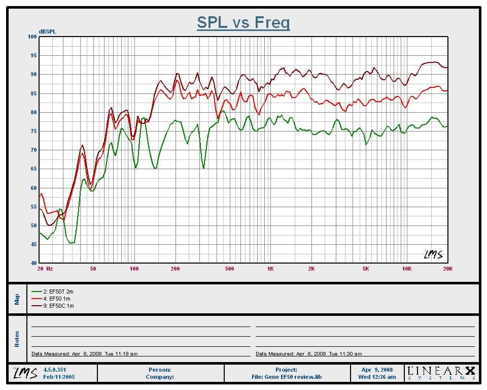

EF50 Measurements and Conclusion
Measurement method: 1 meter on Axis (1/12th Octave smoothed)
The EMP EF50C center channel was horizontally mounted and produced an in-room frequency response of roughly +-3dB from 150Hz to 20kHz. The frequency response of the bookshelf EF50 speaker was nearly identical. The EF50T tower speaker also measured similarly but with a bit more bass extension below 100Hz allowing for an easier blend with a subwoofer without the need of turning the crossover up too high to make the subwoofer localizable. Based on these measurements, it’s easy to see that this system plays well together and should provide a seamless blend required for a convincing multi channel experience. This also explains why I thought the system sounded better with a 100Hz crossover rather than 80Hz.
EMP E10s Sub Summed Woofer and Port
The EMP E10s subwoofer has a very flat response from about 200Hz down to 33Hz with the -3dB point around 30Hz (exactly as the specifications state). While the sub won't provide some of the subsonic slam that other, larger, ID subs will, the tradeoff is a small form factor and easy placement. For so small a sub, it has a lot of slam and great linearity.
