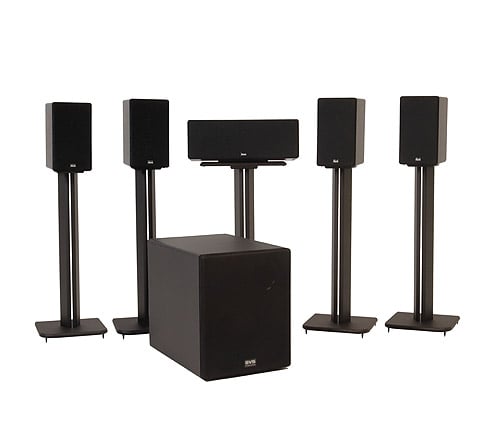

SBS-01 (Fronts/Surrounds) | SCS-01 (Center) cont’d PB10-ISD (Subwoofer) |
- Stupendous Movie Performance
- Bookshelf Fronts/Surrounds blend well
- LOUD and DEEP
- Average music performance
- Disproportionate center channel
- HUGE subwoofer

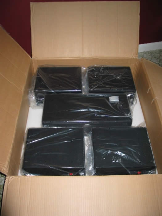

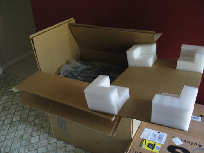

They tried to deliver the speakers when I was out of town over Thanksgiving. When I got back, I had the "Tomorrow is the last chance before we send them back" notice (not a happy camper). I called UPS and arranged to pick them up the day after the last delivery attempt. On my way home from picking up my son, I saw the UPS guy driving away from my neighborhood and quickly flagged him down. It was raining but I gladly offered to pick them up from him right there and then... until I saw the size of the boxes. "Umm..." was all I could say as I contemplated how I was going to explain to my wife that I let my little one walk home in the rain just so I could get the speakers home one day sooner. Luckily, the driver must have caught what I was thinking because he offered to turn around and deliver them for me. Whew! Another potential "grounds for divorce" argument avoided.

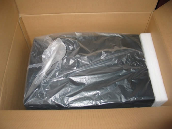

After two delivery attempts, the boxes were pretty thrashed, but luckily everything was really well packed. The subwoofer was double boxed and the speakers were completely encased in Styrofoam. SVS was also kind enough to supply me with a couple of stands (the same as the ones displayed on the website with the speakers). This box had taken a severe beating as well, but once again nothing was really damaged.

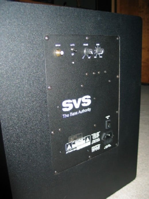

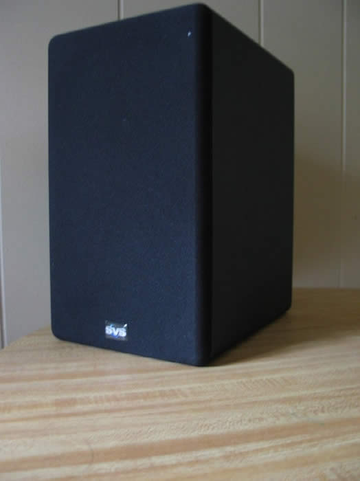

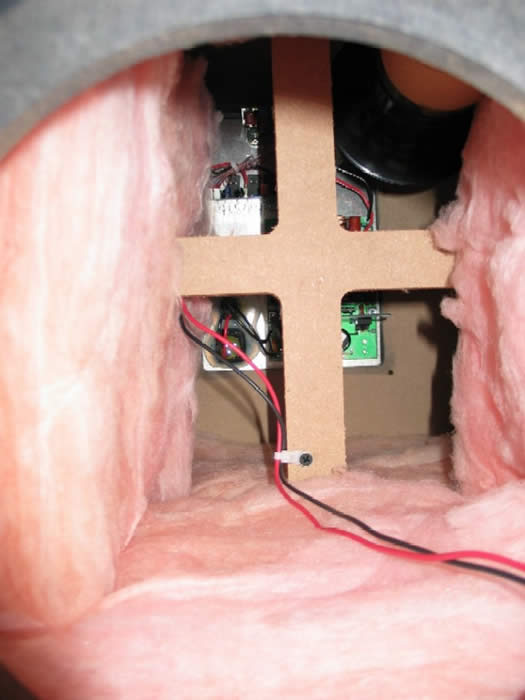

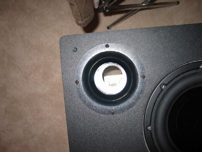

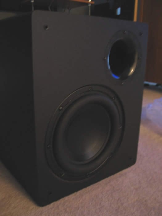

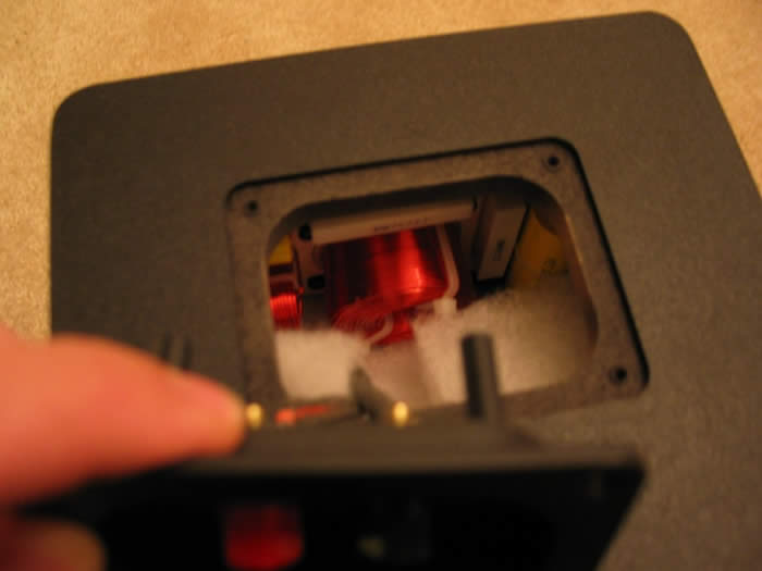

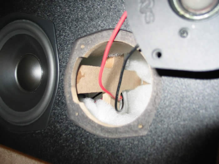

Opening the subwoofer, I found it to be internally braced across the middle and corners and the box was lined with fiberglass insulation. The port was flared at both sides and extended over a foot into the enclosure. If you shine a light down the port, you can see the back of the amp. The sub is constructed out of 1" MDF at the front and 3/4" everywhere else with rounded corners. The fronts/surrounds are a sealed design constructed out of 15mm (close to 5/8") MDF and also possessing rounded corners. The woofers have a glued down trim ring giving the front a very clean look. Inside, the enclosure was filled with polyfill and seemed to be very well put together. Personally, I was surprised at the weight of the surrounds as they were heavier than I expected. The center was similar except for an extra woofer making it almost twice the size of the surrounds. The grills were all very sturdy and attached via chrome posts.

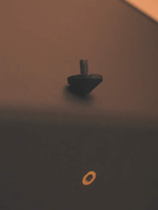

The subwoofer was equipped with six "compliant floor isolation points" aka - plastic spikes. They looked to be suitable for either short pile carpet or hardwood floors (they weren't sharp). In my longer pile carpet they just sank in. They are removable and threaded such that they can be replaced with more traditional metal spikes if one desired. The provided stands were black and easily assembled. They too were equipped with plastic spikes (also not sharp but much more tapered and longer). I imagine that they would have worked effectively if I could have installed them. I could fit none of the spikes (they were not threaded, simply push in) into the provided holes. The bases were large enough that they were plenty sturdy and I had no fear of them tipping over (even with a 2.5 year old running rampant). There was an installable plastic masking system to "hide" the wires but a hole in the front suggested that you not use brightly colored speaker wire. When I first assembled the stands I was sure they were too tall but even in a reclined position, they brought the tweeter to the proper ear height.

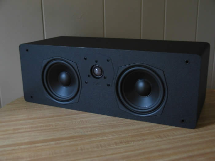

Honestly, I don't know how I feel about the aesthetics of these speakers. Let me explain why. They come in any color you want - as long as it's black. Some claim that black is best because it will blend into any decor. OK, I'll give you that. But... who are these speakers marketed too? The small size of the bookshelves suggests that they are looking to please the more Feng Shui among us (read: wife). The larger (nearly twice as large as the surrounds) center is certain to raise an eyebrow while the size of the sub (just as big as the EP500 which I consider to be HUGE) may provoke paroxysms (and not the good kind). I've asked various guests their opinions of the looks of the speakers and have received varying answers. My suggestion: Know what you are getting yourself into. If the "black box" look is what you like, you'll be fine. The center is definitely larger than you'll expect and you may want to prep your wife well in advance about the sub (you'll both still be shocked). Proper placement and some advanced planning should help a great deal.

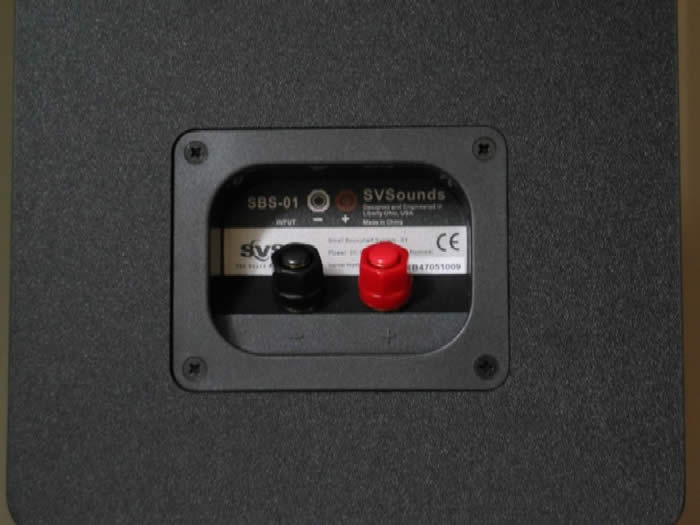

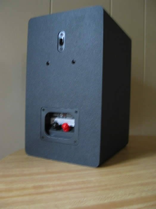

Mounting options were numerous. All speakers (with the obvious exception of the sub) had threaded holes and keyholes in the back for wall mounting that the center had threaded holes on the bottom as well. The center had a provided stand that raised the speaker a couple of inches but allowed for vertical tilt. The stand was in two parts. The base was simply flat with a concave piece cut out of the center. The speaker sits on a piece of wood with a flat side and a convex side. The convex side fits in the concave cut out which allows the speaker to be tilted a few degrees up or down. The convex piece is lined with a sort of velvety material which provides enough friction so that once positioned, the speaker would be unlikely to move (depending on how loud you pump that sub I suppose). Let's just say it didn't move on me - your results may vary. While this is not the most high-tech audiophile solution I've ever seen, I felt it was a really nice touch and shows the consumer the level of commitment SVS has to the surround experience. More often than not, in my experience, the center channel is the more horribly misplaced speaker in a system. Fronts are floorstanders or on stands, surrounds are on stands or wall mounted, but the center is tucked away in the entertainment center or on top of the TV. This encourages the user to point the speaker directly at the listening position, something that users at this price point may not otherwise think to do.

I used the test tones from the Denon AVR-3805 to set the speaker levels. The center channel was between 5 and 7 dB lower than the mains (fairly similar distance from the main listening position). According to the specs, it should have been only 2 dB difference but in my room and setup it was apparently more. It is my contention that this center will end up doing double duty in one of the other speaker systems that SVS lists as "coming soon" on their website. As I previously mentioned, the provided stand allows you to adjust the angle, making targeting the prime listening position from above or below your display a breeze.
I set up the speakers in a traditional 5.1 arrangement except that I had the sub in my normal (and believe me) optimal location - midway on the side wall. I have moved my reference sub (all 70+lbs of it) more times than I can count and this is the only (feasible) location in my room for a sub that will not excite the room modes to the point of making a mess of the frequency response. I had to play with the phase a bit but eventually I got a fairly smooth response. I found the sub to be an exceptional performer justifying all the faith the SVS-ites have in their cult... ah... speaker manufacturer. I literally, couldn't believe that this was a $400 sub. My biggest problem in this review was that the size of the sub, being so similar to the EP500, tricked my mind into making a direct comparison. Comparing a $400 sub to a $1200 sub is not exactly fair, but the SVS still held its own! Impressive!
