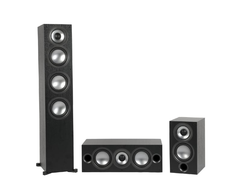

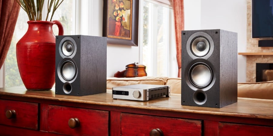

When comparing the Uni-Fi 2.0 speakers to their predecessors, a few differences jump out right away. Perhaps the most noticeable physical change is the location of the ports on the bookshelf and center-channel models. Gone are the rear-facing ports that caused customers to worry about placement in acoustically-compromised locations, such as close to a wall, or — heaven forbid — inside a media cabinet. The front-firing ports on the Uni-Fi 2.0 models allow for greater freedom of placement, according to Elac. The UF52 towers are still rear-ported, but it stands to reason that customers who opt for floor-standers will likely have a bit more real estate to work with. (In my experience, even front-ported speakers will fare much better when given some breathing room from boundary walls.) Comparing spec sheets reveals another big change from the first generation Uni-Fi speakers. While the originals presented the user’s amp with a 4-ohm load, the Uni-Fi 2.0 models have a nominal impedance of 6 ohms. The sensitivity spec remains the same at a fairly low 85dB, but according to Elac, the higher impedance of the new speakers makes them compatible with “virtually all AV receivers.” In order to accomplish this, an entirely new 3-way crossover was required. The Uni-Fi 2.0 crossover network is reportedly an “enhanced design” that offers improved response linearity and better driver integration, all while making the speakers easier to drive. Jones told CNET’s Ty Pendlebury that the chunky 1.5-pound crossover is so large that it has to be glued into the cabinet.

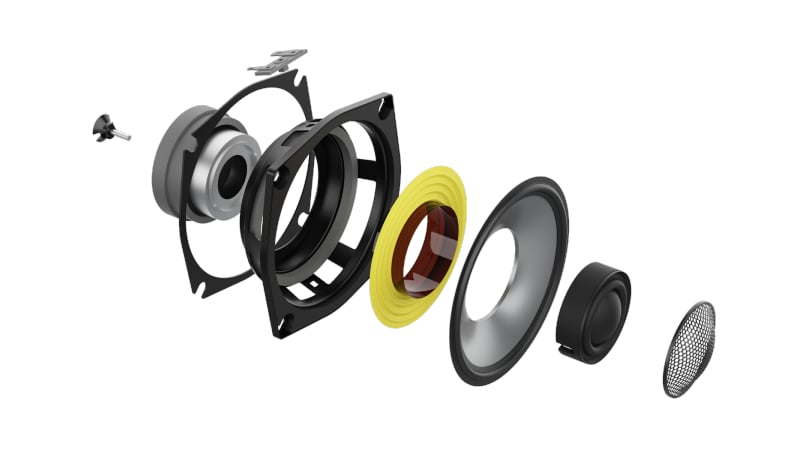

Clearly, these updates show that Andrew Jones and his team at Elac are paying attention to the desires and concerns of their customers. But Uni-Fi 2.0 isn’t just a tweaked version of the original Uni-Fi; it’s a completely new design from the ground up, including all new custom-designed drivers. Perhaps that should be expected from a company that describes itself as “passionate about driving innovation and refining its existing products.” It’s certainly to be expected from Jones, who never seems to rest on his laurels for more than a few months. The concentric tweeter/midrange driver found on all three Uni-Fi 2.0 speakers still features a 1-inch soft dome tweeter and a 4-inch aluminum midrange, but the drivers themselves have more in common with those found in Elac’s premium Navis range of active loudspeakers than with the drivers used in the original Uni-Fi series. The new tweeter features a wider surround, which reportedly enhances extension both at the top and at the bottom of the tweeter’s frequency range, resulting in improved blending with the midrange driver. The crossover point between the two drivers is at 2kHz, versus 2.6kHz in the original Uni-Fi. The new midrange driver features a larger-diameter voice coil, which not only creates the extra room required to accommodate the wider surround for the tweeter, but also exerts greater control on the midrange driver’s aluminum cone. The cone itself sports a new geometry and a new low-profile surround. An all-new neodymium magnet assembly does the heavy lifting.

Low-Frequency information, below 200Hz, is handled by an all-new 5.25-inch aluminum cone woofer. (The UB52 bookshelf speaker has one woofer, while the UC52 center-channel speaker has two, and UF52 floor-stander has three.) The cone is made from a single piece of dish-shaped aluminum, resulting in improved stiffness. Behind the scenes are an oversized magnet, a large-diameter voice coil, and extended pole piece, which work together to deliver “improved accuracy and bass dynamics,” plus “a smoother response and greater transparency,” according to Jones and company.

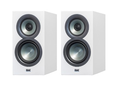

Providing robust support for these new drivers, the all-new cabinets are engineered with thick MDF outer walls and strategically-placed internal bracing to add stiffness and reduce cabinet vibration — and the audible colorations that come along with it. The cabinets are wrapped in black ash vinyl, which arguably looks nicer than the grey vinyl wrap found on the original Uni-Fi series, but not as nice as the satin painted finishes found on the Uni-Fi “Slim” series, which was launched a few years ago for the European market. The Slim series eventually proved popular here in the U.S. as well, despite costing up to 50% more than the regular Uni-Fi speakers, and without any sonic differences whatsoever to distinguish them from the originals. Although some audiophiles are loathe to admit it, sometimes looks matter nearly as much as sound. The Uni-Fi 2.0 speakers do borrow their svelte form-factor from the Slim series; the new speakers are slimmer, taller, and deeper than their original Uni-Fi counterparts, which look a bit squat and dumpy by comparison. Elac has not yet revealed whether the Uni-Fi 2.0 line will be offered with an upgraded finish option for an upgraded price. But earlier this year, Elac launched a speaker line called Debut Reference, based on the company’s current entry-level Debut 2.0 models. The Debut Reference uses the same basic design as the Debut 2.0 speakers, but with higher-quality finishes, better-built cabinets, and tweaked drivers. Will we see a Uni-Fi Reference line in the near future, or will Andrew Jones’s next creation be something else entirely?
