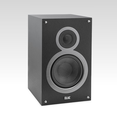

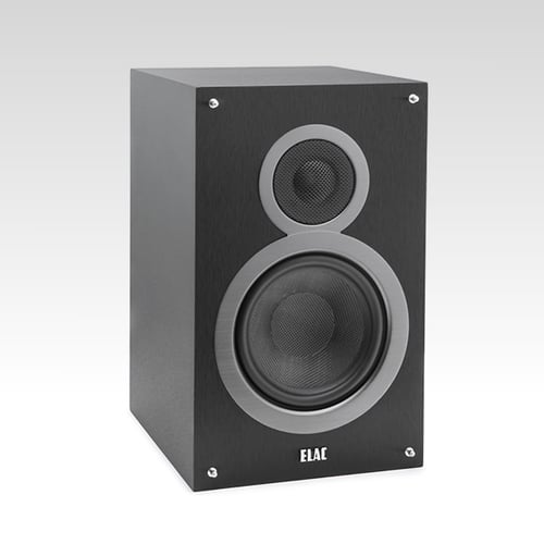

ELAC B6
The ELAC B6 Monitor Speaker
The ELAC Debut line has every speaker combination for setting up a two channel, multi-channel, and even immersive-audio/Dolby Atmos configuration.  The Debut series consists of two bookshelf speakers (B5 & B6), one floor-standing speaker (F5), one center speaker (C5), one Atmos add-on speaker (A4), and three powered subwoofers (S10, S10EQ and S12EQ).  ELAC claims this series of product represents a new level of performance at affordable price points. If Andrew Jones’ previous work is any indication, then we have every reason to believe in that statement.
The entire line of Debut speakers utilizes custom designed drivers engineered for maximum performance and musicality. The woofers employ aramid fiber cones which are said to provide superior strength to weight ratio over other materials allowing more flexibility in design to achieve a smoother extended response. Other woofer design attributes include an oversized magnet and a vented pole piece.

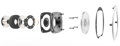

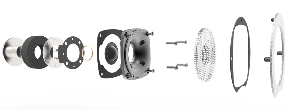

ELAC Waveguide
ELAC's new waveguide for the Debut speaker line's silk-dome tweeter
A newly developed silk-dome tweeter is recessed in a waveguide with a deep spheroid profile that ELAC says delivers improved directivity control and shields the tweeter wavefront from cabinet diffraction.   Crossovers are one area where more expensive speakers leave lower models in the dust.  ELAC says that a refined multi-element crossover provides the perfect blending of drivers to deliver a coherent audio experience traditionally found on speakers costing substantially more.
