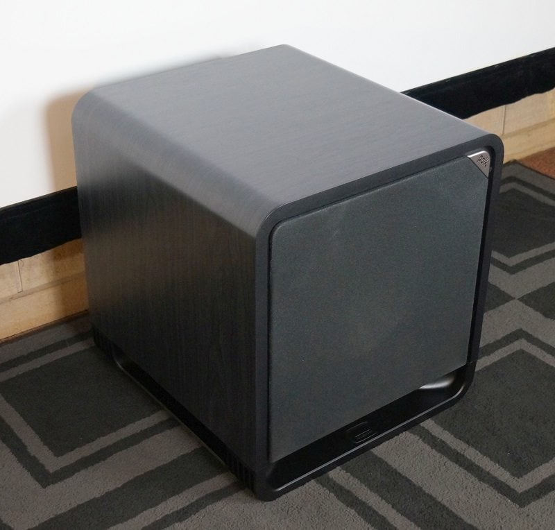

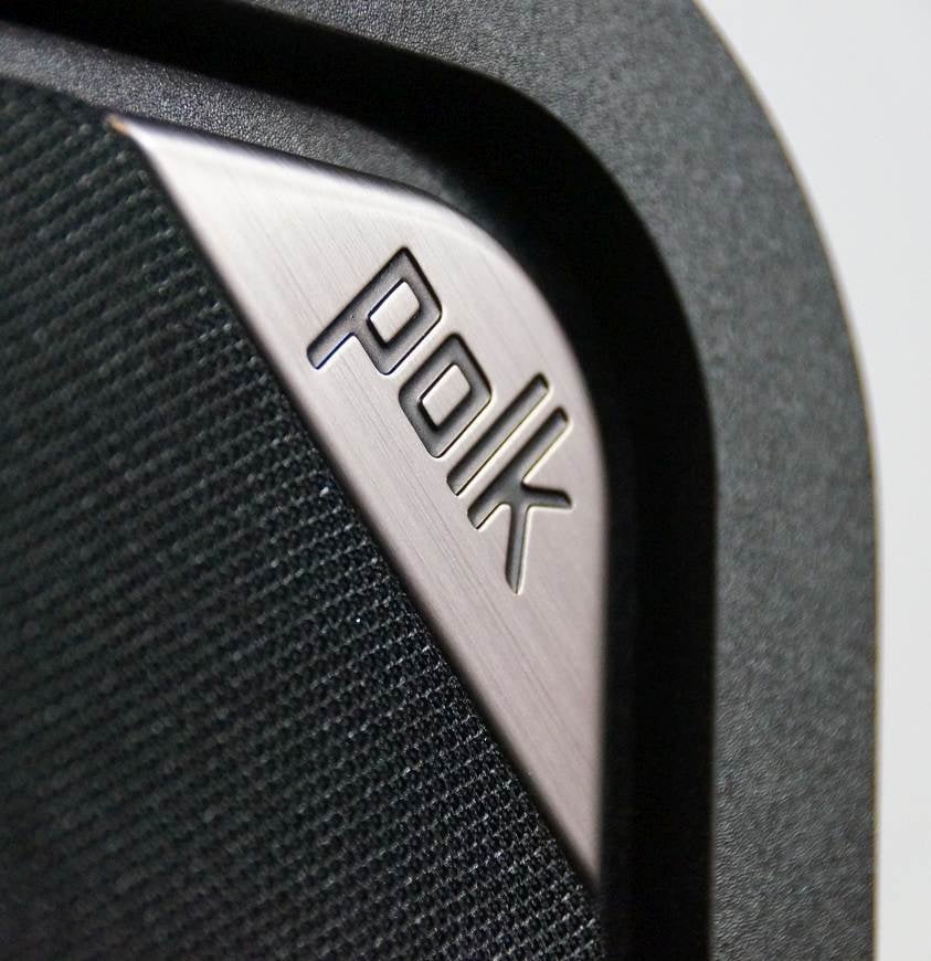

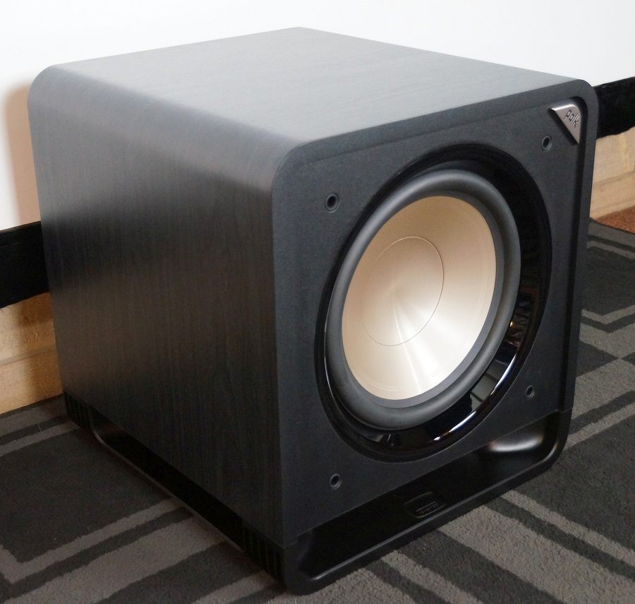

As ~$500 subwoofers go, the HTS 12 is fairly nice-looking. The basic shape is a black cube, but it takes steps to soften up any blockiness. The longitudinal edges on the top and bottom are heavily rounded, so there are no hard corners. The inset for the front baffle has rounding similar to the outer shape, and it carries into the base platform that the sub rests on. The base platform is a single large plastic molded piece that perfectly contours with the cabinet's shape. With the grille on, the front baffle is a featureless black fabric plane with the exception of a Polk badge in the upper right corner. With the grille removed, we can see the platinum-esque luster of the driver that matches the Polk badge. It is surrounded by a black gloss trim ring and is set in a black textured vinyl front baffle. The whole effect is unexpectedly stylish for a budget subwoofer. Of all the subs in this price range, I have to say this one looks the nicest.

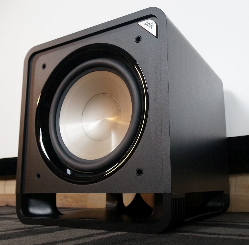

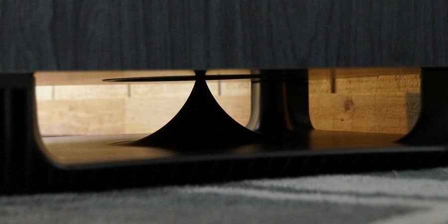

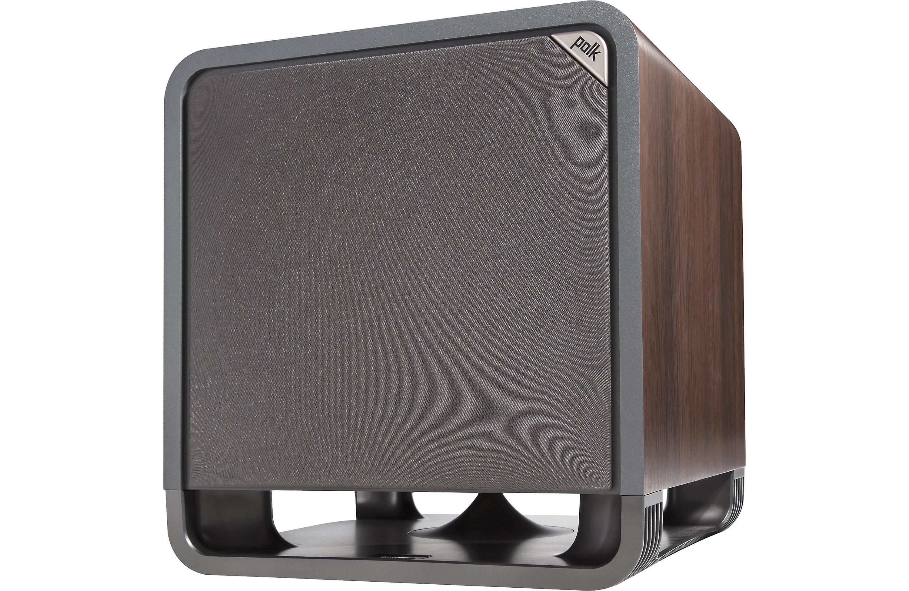

The Polk HTS 12 is not a very complex subwoofer. Much about it is fairly typical subwoofer design albeit with one major exception. What really separates it from other subwoofers is the implementation of Polk’s patented ‘Power Port.’ This is a port that is heavily flared on both sides and also has spikes entering both sides of the ports (the spike on the inner end of the port is obviously not visible unless you take the sub apart). The goal of the Power Port design is to reduce port turbulence.
HTS12 port
For novices to loudspeaker design, the function of ports on speakers and subwoofers is to produce sound more efficiently in low frequencies than the drivers are able to by themselves. They do this by using the backward motion of the woofer into the cabinet to resonate the air mass within the port. This resonance is called Helmholtz Resonance and uses the same principle to produce sound as when someone blows air over the top of a bottle and a clean note can be heard. In a loudspeaker or subwoofer port, the air mass has to remain uniform and stable when being vibrated in order for this resonance to work. However, after a certain point of high excursion, the woofer moves so much air in the enclosure that the air mass within the port cannot maintain cohesion and instead becomes disrupted so the airflow in the port becomes chaotic. Instead of producing a clean signal, the port now generates wind noise that we call port turbulence. This, of course, is an unwanted distortion that can sound pretty bad.
Much research has been undertaken over the decades in finding optimal port geometries in order to maximize the stability of the port air mass at higher drive levels, and Polk’s Power Port is their effort at satisfying this design goal. The idea is that the spikes sandwiching both ends of the port help to guide the ends of air mass to make a more orderly entrance and exit of the port thereby maintaining cohesion for higher levels of oscillation. It’s hard to tell how well it really works versus standard port designs, and only Polk’s engineers know that much, but I doubt that Polk would go through all of that expense and effort for a technology with only negligible returns. It seems to work in practice; when I ran test tones through the HTS 12 at maximum volumes, I didn’t hear anything that sounded like port turbulence, so I think that Polk is probably on to something with their Power Port design.
HTS12 cone3   HTS12 rear

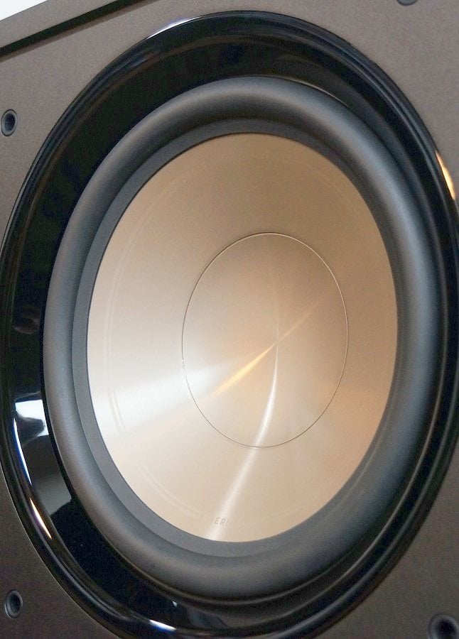

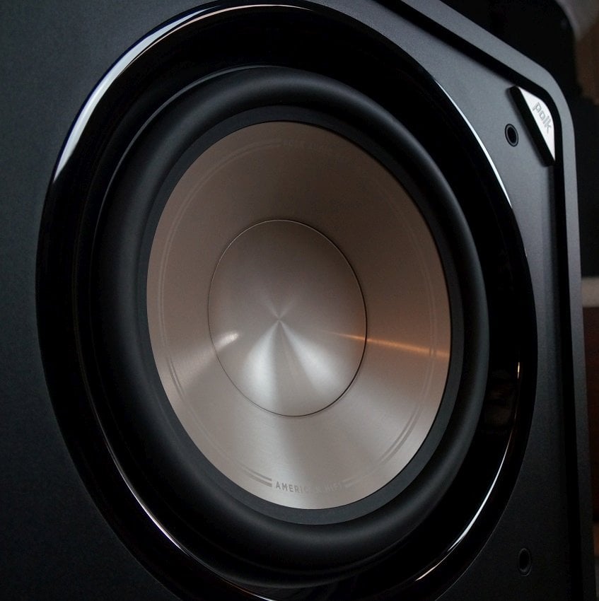

Outside of the port and the industrial design of the HTS 12, the remainder of it looks fairly standard, but that is good so long as it is executed competently. The driver uses a polypropylene cone that is affixed to a stamped steel frame by a 1” thick surround. The motor doesn’t look huge, but without knowing the magnetic flux, we don’t know its true strength. Ventilation is done in the frame underneath the spider. It does have a slightly bumped-out backplate for longer excursions before bottoming out.

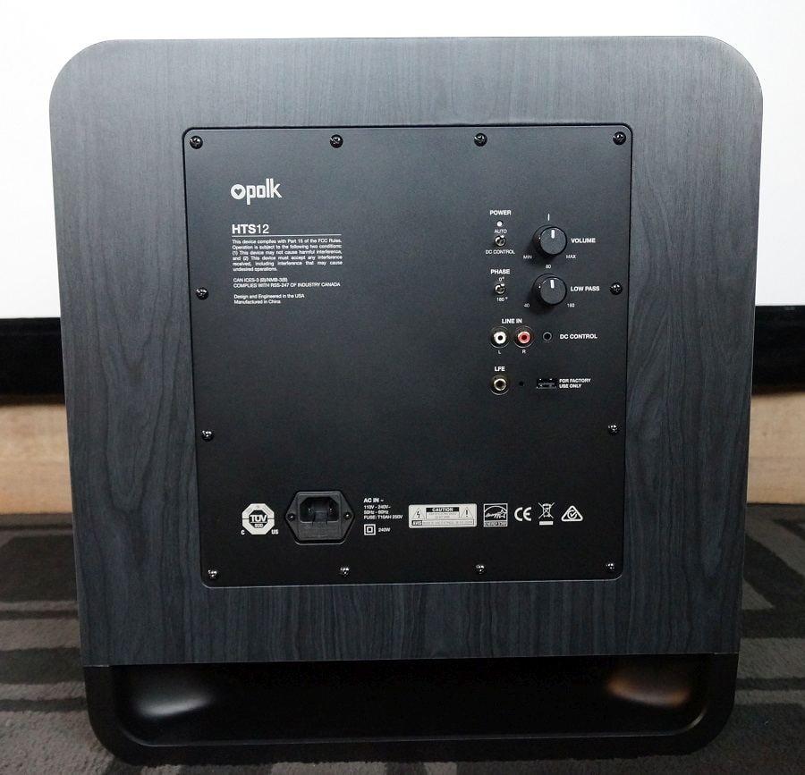

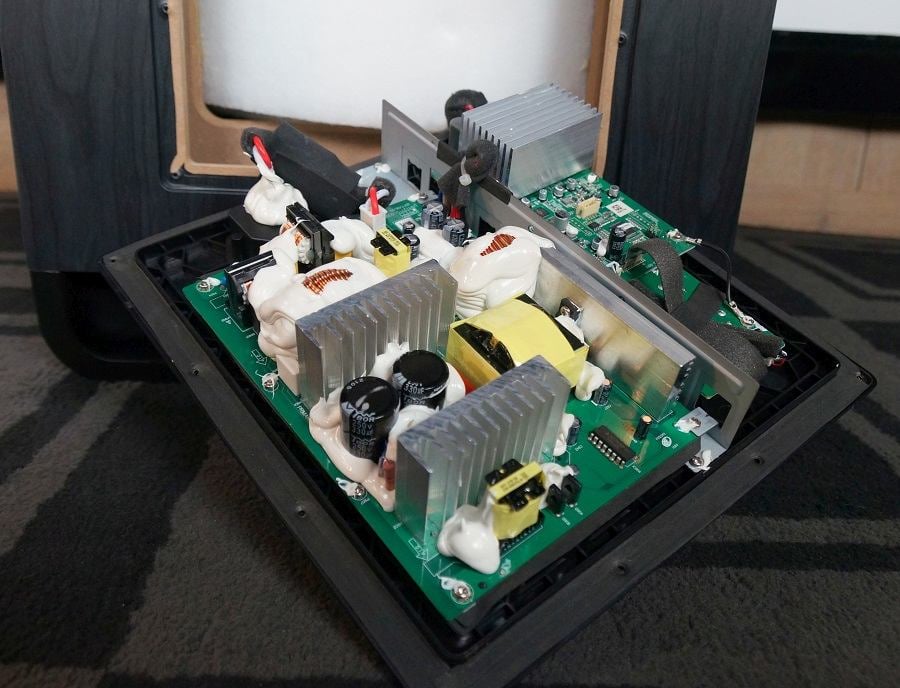

HTS12 amplifier   HTS12 amp plate

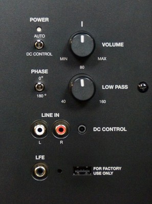

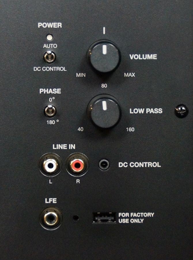

The HTS 12 is powered by a 200-watt class-D amplifier (400 watt peak) with a basic feature set. Controls consist of a volume knob, low-pass filter knob ranging from 40Hz to 160Hz, power/auto-on switch, and a 0-180 degree phase switch. Connectivity only consists of a left and right RCA inputs set as well as an LFE RCA input. The amp board itself has four aluminum heatsinks, and that combined with the class-D design bodes very well for thermal control. In electronics, heat is the enemy of long-term reliability, and the HTS 12 has taken serious measures for heat dissipation.
The enclosure is unexpectedly well-built for this price point. While the side paneling is only ½” thick MDF, there are two windowpane braces, corner bracing, and double-layered paneling for the front-baffle. The interior is also chocked full of acoustic stuffing. The structure of the cabinet combined with the beefy plastic base make this a fairly sturdy subwoofer.
