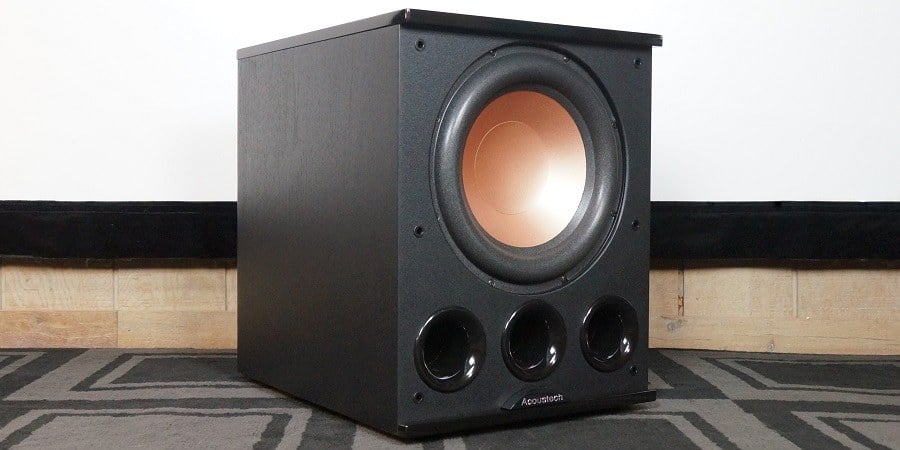

PL-300 Packing and Appearance

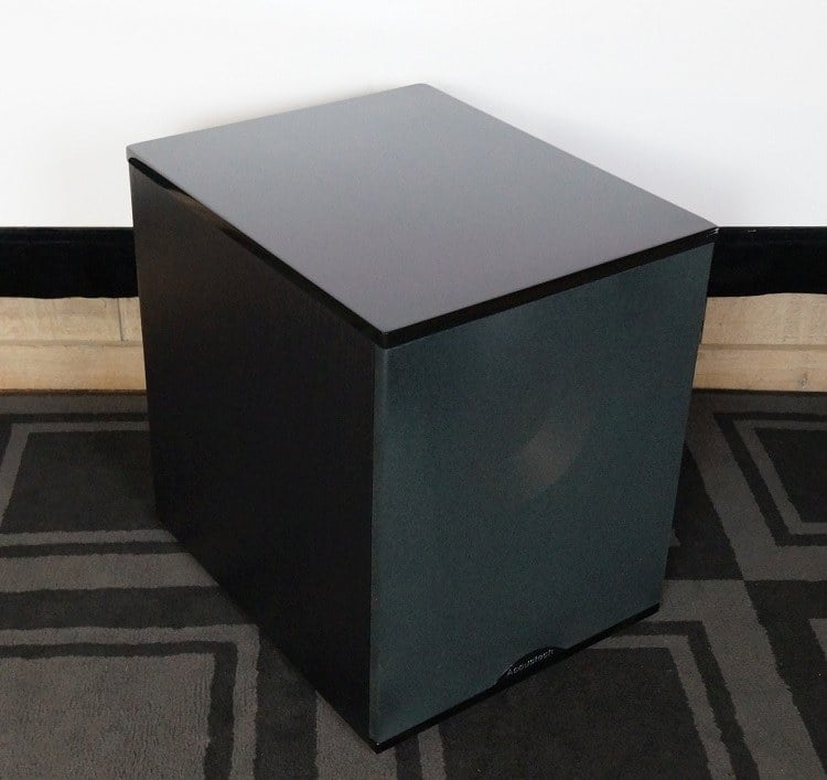

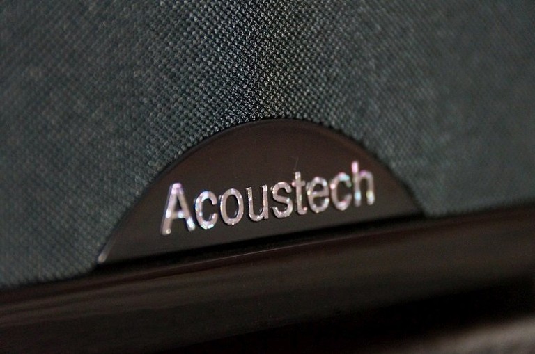

The PL-300 arrived at my home in a cardboard box with lots of printing on it to let the recipient know exactly what it contained. The sub is wrapped in a soft foam bag to protect it from moisture and scuffs. It is sandwiched by two thick polyethylene foam blocks and is protected on the sides by Styrofoam pieces. This packing is better than what I would have expected given the price. Most subs, even much more expensive ones, do not make an effort to protect the sides and merely use foam top and bottom pieces.

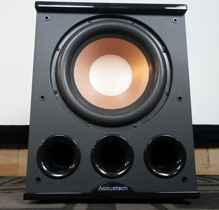

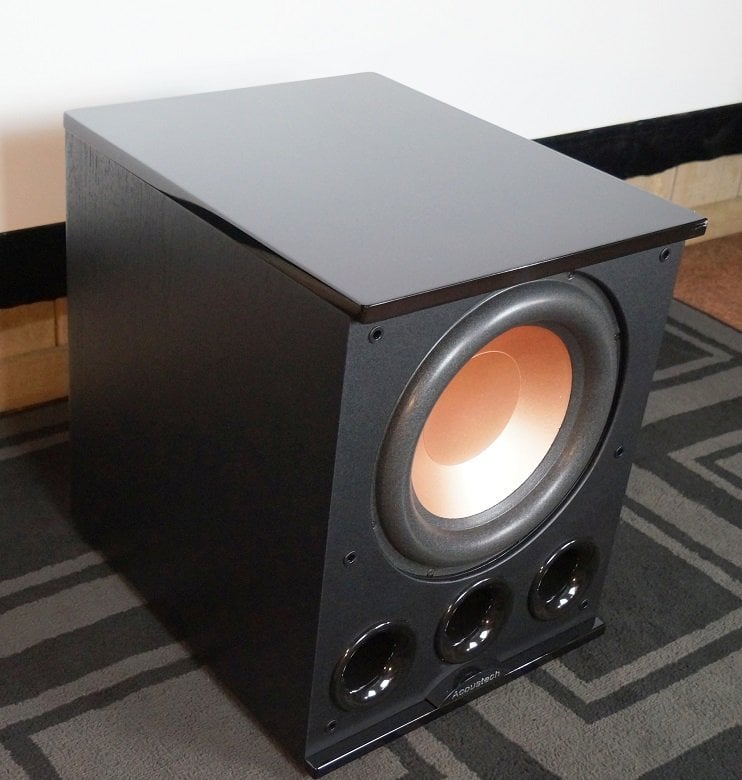

The PL-300 is somewhat distinctive in its appearance in this class of subwoofers. It is not a huge sub, but most people would not consider it small either, so it is up to the industrial design to make it a pass or go in most people’s living rooms, and I think that most people will be ok with it. With the grille on, it is a black box with a glossy top. The grille doesn’t completely hide the driver, so the driver is still slightly visible through the grille fabric, but the front baffle is largely cloaked. As with many other subs, it looks plain with the grille on, and not particularly notable. Remove the grille, and the platinum-colored driver is exposed along with the three glossy ports. The driver’s surround is quite beefy, and it makes the PL-300 look like it means business. The top and bottom panels of the enclosure are built to form edges with the grille, so when the grille is off, the top and bottom have some overhang. I think that the exposed front baffle with its mixture of silver and gloss black gives the PL-300 a toyish aesthetic that some people may find slightly tacky, and probably most people will run this sub with the grille attached. I could see younger people preferring the more flamboyant appearance of the platinum driver. The good news is that BIC gives users the choice between the sedate appearance with the grille on or the jazzier appearance with the grille off, so it can work for either preference.

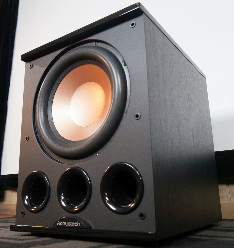

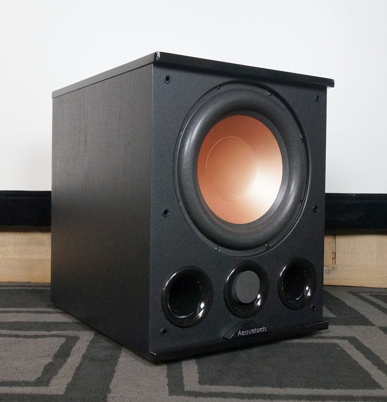

To explain to those who are new to loudspeaker design and are looking for an entry-level subwoofer: the function of ports on speakers and subwoofers is to produce sound more efficiently in low frequencies than the drivers are able to alone. They do this by using the backwave off the woofer in the cabinet to resonate the air mass within the port. The port’s length and width affect the frequencies at which the port generates sound; the longer a port is with respect to its width, the deeper frequencies it will produce. However, the more volumetric area a port has, the more output it will generate at its resonant frequency, and this is usually accomplished by simply making the port wider, but without lengthening the port by the same ratio as expanding its width, its resonant frequency will rise. Placing multiple ports in a speaker or subwoofer will act like one port that has the width of all the ports combined. In a variable-tuning system, the user can exchange output headroom at higher frequencies for lower frequency output by plugging one of its ports, thereby increasing the length of the ports with respect to their collective width. This enables the subwoofer to play deeper frequencies far more effectively but at the cost of output potential at some frequencies above that point.
The PL-300 comes with a port plug by which one of the ports can be plugged in order to lower the tuning frequency. Those who are interested in the deeper bass that the sub can produce should keep the plug installed in one of the ports (it doesn’t really matter which port), but they do so at the expense of headroom in frequencies above port tuning. It also has an equalization switch called the “Bass Boost Switch” that sets the sub to take greater advantage of the different port tuning configurations. In the “Bass Boost” setting, deeper output is supposedly enabled by the amplifier’s high-pass filter. In its “Max Output” setting, the filters allow more bass in higher frequencies. That is what the user manual says anyway. Our measurements section gives a more explicit look at the actual behavior of the port tuning system, and they seem to tell a slightly different story.

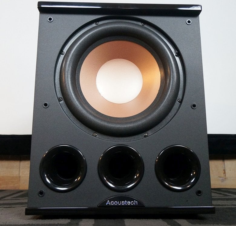

The PL-300 driver uses a polypropylene cone that is set inside a very fat surround that makes it look like it could have massive excursion. The surround attaches to a stamped steel frame. The motor uses a 5” diameter magnet with a ¾” thickness, and that is about what would be expected, although we don’t know its true power without knowing its magnetic flux or how much the iron has been magnetically charged. Venting is done through the pole piece. Despite the beefy surround, excursion is going to be limited by the motor in this driver, so I wouldn’t guess it will have a huge throw not that anyone should expect huge throw from a $450 subwoofer.
The amplifier is spec’d with a 350-watt RMS power rating, and the literature touts a 1,400 peak dynamic power. Peak dynamic power doesn’t really mean a whole lot in this case. It is how much power can be produced with a 1kHz tone for 20ms with a 480ms rest period. Since most other subs just use an RMS continuous power specification, that is more meaningful for us as a point of comparison. 350 watts RMS is a lot for a below $500 sub, and there are few if any in this price range that can match that amount of power. The PL-300 uses a BASH amp (Bridged Amplifier Switching Hybrid), a technology that tries to combine the sound quality of AB amplifier topologies with the high efficiency of Class D amplifiers. Controls on the amp are pretty standard except for the “Bass Boost” switch. There is a gain knob, a 0-180 degree phase switch, a low-pass filter knob that runs from 30hz to 90Hz, an internal/external crossover switch, and an auto-on/off switch. There is also an input voltage switch for 240 voltage for non-North American users.
The enclosure uses 5/8” thick MDF and has some bracing at the cabinet midsection. It has some polyfill lining the sides. The three ports are flared and have a 17” depth with a 2 ½” width. The feet are some simple cylindrical rubber pieces.
All in all, with the exception of the variable-tuning capable triple port system and the 350-watt RMS amplifiers, the subwoofer design is about what would be expected of something at this price point. Let’s now see how this all adds up in some listening…

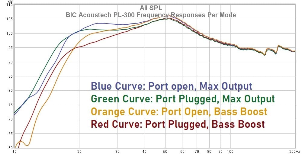

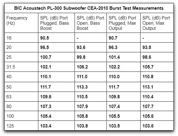

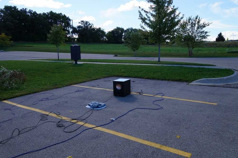

Testing on the BIC Acoustech PL-300 was conducted with the microphone facing the woofer at a 1-meter distance with measurements scaled back to a 2-meter distance by subtracting 6dB. The temperature was recorded at 59F degrees with 70% humidity. The subwoofer’s gain was set to maximum, phase was set to zero, and the low pass filters were set to bypass.
The above graph shows the measured frequency responses for the PL-300 subwoofer per its operating modes. While these responses are not the perfectly flat ones that we often see with DSP subs with a finely EQ’d response, there is still a lot to like here considering the price of this sub. Plugging the port maintains a strong response to below 20Hz, especially in the “Max Output” setting. In fact, the “Max Output” with a plugged port is probably the setting that makes the most sense for this sub and is the one I would recommend. The main advantage of this sub is its deep bass extension, and that is what I would try to exploit as much as possible. The PL-300 does have a somewhat peakish response centered at 50Hz, and that combined with a downward slope above that point indicates that the driver is running into induction effects. Induction occurs when the voice coil’s motion in the magnetic field creates a counter-current, but the problem is that the counter-current creates an opposing magnetic field that diminishes the initial, desired field. Many drivers use short-circuiting rings (often just called ‘shorting rings’) in the motor structure to address this, but that does add a significant cost increase to the driver, and given the cost of the PL-300, it probably doesn’t have a shorting ring. The addition of a shorting ring would have brought down the 50Hz peak and brought up the reduced mid-bass output above 60hz.
While the sub could have had a tidier response with a shorting ring, the reality is that typical room acoustics will mangle the response much more than induction effects, so it’s not a big deal in practice. Plus, many users will just use an auto-EQ system like Audyssey, which will fit the response to its target curve anyway, so the natural response of the sub is almost a moot point. That being said, those who don’t EQ their subs might be left with softer mid-bass with a traditional 80Hz or higher crossover frequency. As I mentioned in the ‘listening sessions’ part of this review, I initially thought I had a slight phase mismatch due to this response when I measured the room response. What is more, induction effects do reduce overall headroom by making the system less sensitive in mid-bass frequencies, so the PL-300 will run out of steam in mid-bass earlier than if shorting rings had been employed. This can be negated if the user has the option of using a lower crossover frequency like 60Hz as I did.

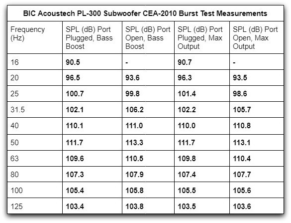

The above CEA-2010 measurements are short-term bursts that show the subwoofer’s clean peak SPL before heavy distortion sets in. Our measurements have been referenced to 2-meter RMS, which is 9dB down from the standard requirement for the measurements to be shown at 1-meter peak. However most publicly available CEA-2010 measurements are shown at 2-meter RMS, so we followed that convention. For $450, the PL-300 is putting out some pretty good numbers. Since this is the sub being pushed to its maximum limits, plugging the port is making a much larger difference than the ‘Bass Boost/Max Output’ switch. Plugging the port delivers more headroom at 25Hz and below, but leaving it open delivers more headroom at 31.5Hz and above. With the ports open, the PL-300 struggled at 20Hz and would not post a passing result at 16Hz. If this sub is being used for music, I would run it with the ports open, but for movies with very deep bass, plugging a port would be my choice. We can see that bass above 80Hz is really getting hammered by induction effects, so I would not use a crossover frequency above 80Hz. If the user has speakers with very capable mid-bass headroom then 60Hz might be even better so that the PL-300 is pouring power into ranges where it is most effective rather than dumping power into ranges where it is less efficient. Altogether, these numbers illustrate the trade-offs that are being made with the variable tuning system, and the user can decide where the sub’s strengths should lay.
These burst test numbers make the PL-300
a peculiar sub to assign our Audioholic’s Bassaholic Room Rating. With a port
plugged and set to “Max Output” mode, this subwoofer clears our ‘Large’ room
rating for deep bass at 25Hz but barely clears the bar for 31.5Hz to 63Hz for
the ‘Medium’ room size. That nets this sub a ‘Medium’ room size rating
indicating it should be sufficient for strong bass in a room of up to 3,000
cubic feet, although this particular sub will have more deep bass than most
subs that achieve the ‘Medium’ room rating.

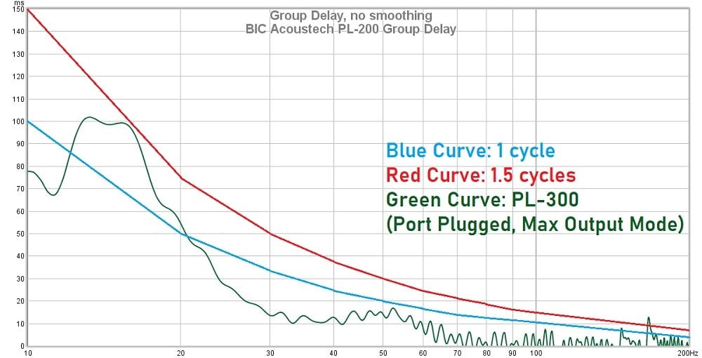

Group delay is the measurement of how much time it takes for individual frequency bands of an input signal to be produced by the speaker. It can indicate that some frequency components are developing slower than others or are taking longer to decay. It is generally thought that 1.5 sound cycles are needed for group delay to be audible at bass frequencies, although there is an argument that group delay should remain under 20ms to be completely unnoticeable, but that is likely meant for mid and upper bass frequencies.
The results shown here are very good. The PL-300 doesn’t even cross below lowest threshold of concern, 20ms, until well below 30Hz, and it doesn’t reach 1 cycle of delay until 20Hz, the lower edge of what is commonly considered humanly audible frequencies. The time-domain performance exhibited much better than what I was expecting given that this is a low-cost subwoofer that is more geared for home theater. I believe a reason for that is the simplicity of the system as a whole; there just aren’t a lot of filters interfering with the individual frequency timings of this sub. We do see a hump that centers around 50Hz, and I think that is at least partly due to inductions effects again. Past research has shown that induction can take a toll on transient performance, and here we see a rise in group delay where the inductance-related peak is. However, it is still so low that this is an academic matter and not one that is humanly audible, so it isn’t anything to be concerned about. Nonetheless, technical improvement in group delay is another argument for the addition of a shorting ring. Port tuning seems to be maybe 18Hz in this tested mode with a port plugged, and that is extremely deep for such a low-cost sub.

On top of the output and extension, the time-domain performance of the PL-300 is good. For the music ranges of 30Hz and above, it does not rise above 20ms, and it only surpasses 20ms below 30Hz which is too deep in frequency to matter for human hearing acuity. In other words, the PL-300 is not a ‘slow’ subwoofer, especially for most music bass which seldom dives below 40Hz.
