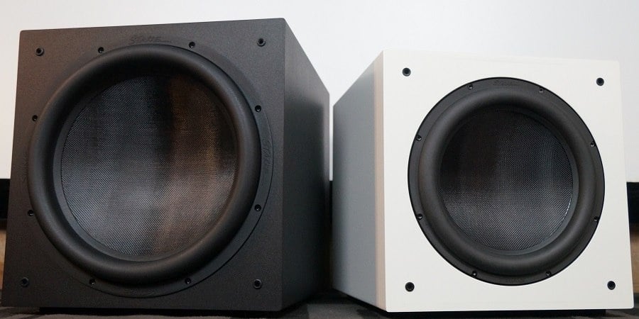

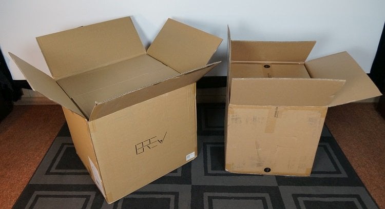

SW boxes.jpgThe SW15 and SW12 arrived double-boxed, and I was pleasantly surprised at that measure since they aren’t tremendously expensive subs. Inside the inner box, the subs were sandwiched between four extended polyurethane edge protectors and were covered in a neatly fitted plastic wrapper. The packing on both subs was very good and should enable them to survive the gauntlet of harsh shipping that the major parcel shipping companies enjoy inflicting on so many of their deliveries.

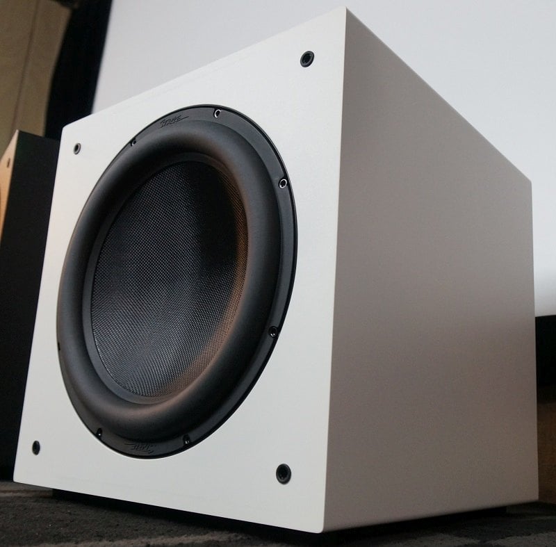

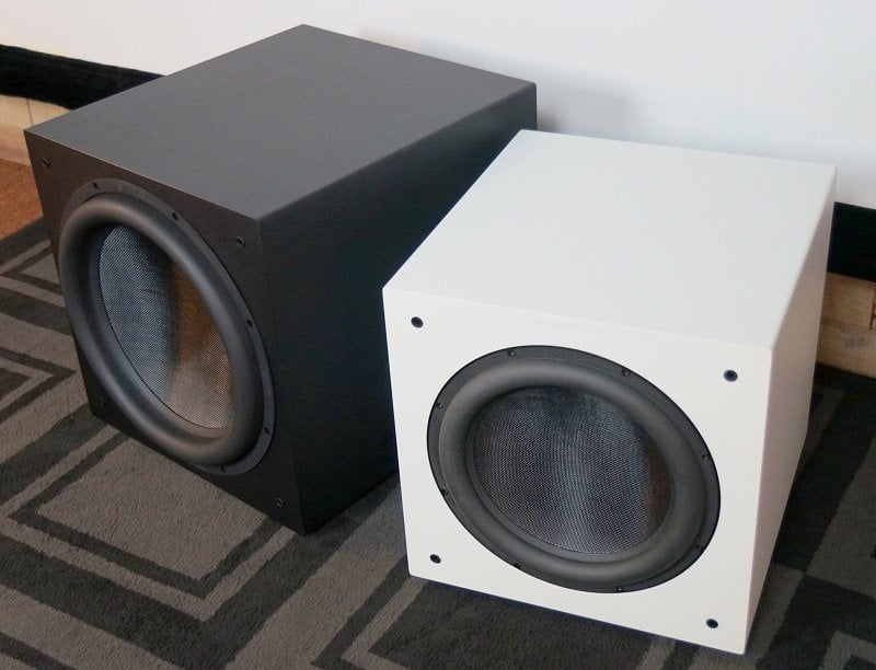

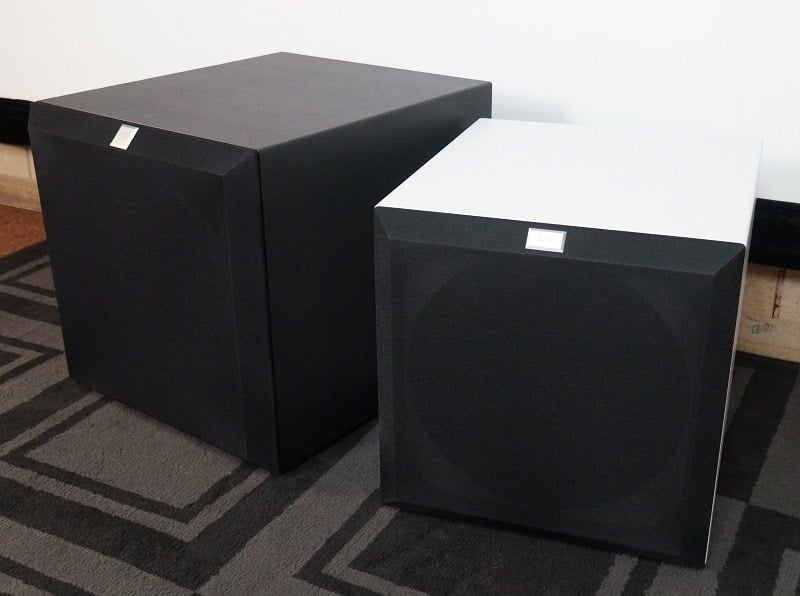

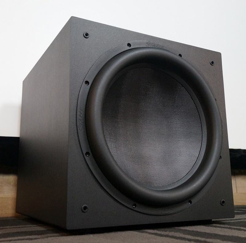

Once out of the packing, the SW12 and SW15 are revealed to be normal and nice-looking subwoofers. The matte finish they use is a finely textured vinyl wrap that I have seen in many other speakers and subs. It’s not bad, and you have to look closely to make out the texture. One nice thing about it is that it isn’t very sensitive to fingerprints like perfectly smooth finishes are, and it is a bit more durable as well, so it won’t scratch or scuff easily if you accidentally brush up against it. It is not quite a high-end satin black level finish, but it is fine for the pricing. The SW15 can only be had in black, while the SW12 can be had in white as well, and I think the inclusion of a white finish will be a welcome option for many buyers. The horizontal edges of the subs have a slight rounding which makes them look a bit more mellow than if they had hard edges all around.

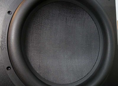

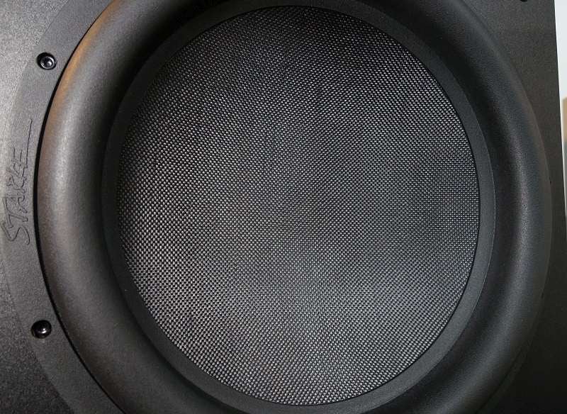

With the grilles on, they are fairly simple-looking boxes, although the grilles have a beveled edge as well as a metallic Starke Sound badge at the top edge which does give them a bit more style than most sub grilles. Without the grilles, we get to see the cones, and seeing as how the cones aren’t very complex looking in themselves, the grilles don’t do a lot to make the subs less busy-looking. They mostly just protect the cones. The cones are merely concave glass-fiber weaves inside of a fairly substantial surround. The frame edges are trimmed with a ring that has the Starke logo imprinted on it. The amp plate in the back has a nice smooth metal texture that isn’t covered by black paint like so many other plate amps, and I think it looks a bit classier for that reason. Altogether the SW12 and SW15 are fine and inoffensive-looking subwoofers. It would be hard to screw up the appearance of a sealed subwoofer since it is such a simple type of loudspeaker, and Starke Sound managed to turn in a decent-looking pair of subs that is in line with their pricing.

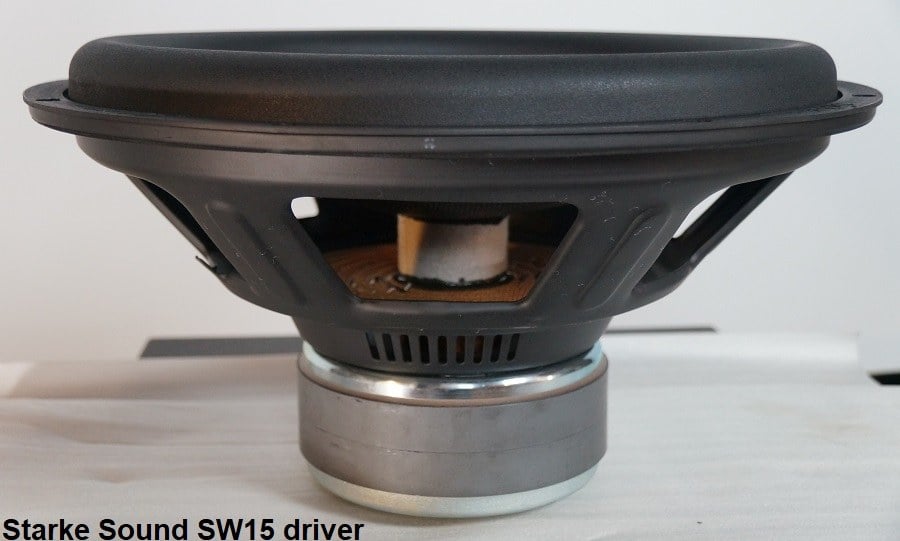

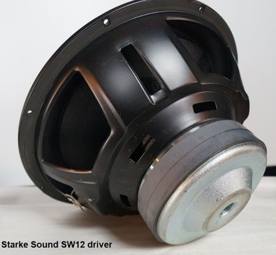

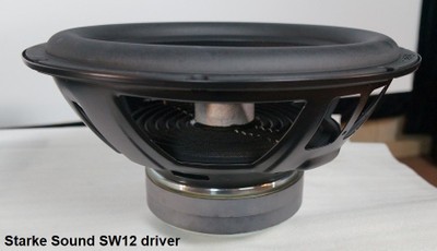

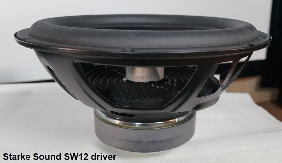

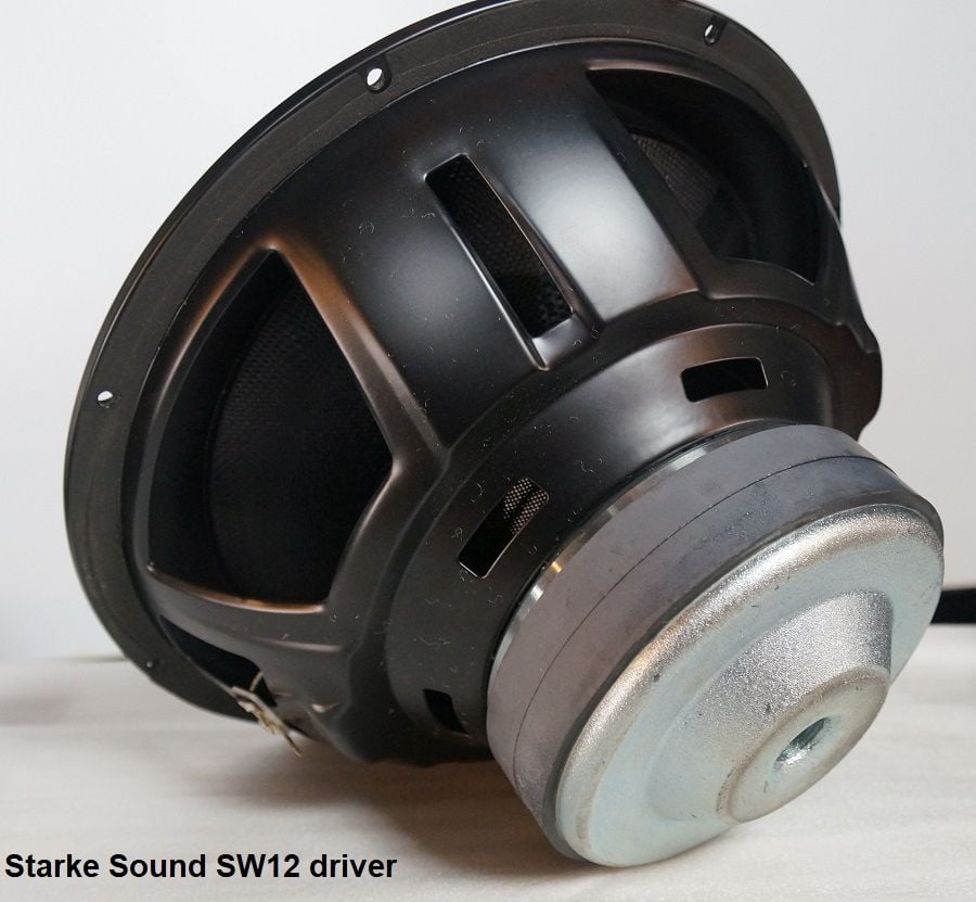

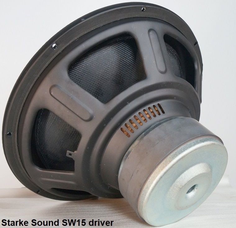

The SW12 and SW15 are not terribly complicated subwoofers. They are sealed subwoofers that use straightforward design decisions for their purpose. Let’s begin our discussion of their design with the drivers. Both drivers use glass-fiber cones that are great for a tough and stiff material yet very light as well. It is a more robust material than treated paper or polypropylene and looks a bit more interesting as well. The cones are attached to the driver via a large rubbery surround and Nomex spider. The SW15’s surround is particularly large measuring 1 ¼” tall and 1 ¼” wide. That should enable it to have fairly high excursions without getting in the way. Both subs use thick cast steel baskets with large spokes so the moving mass is solidly affixed to the motor. The motors’ magnets are comprised of a stack of two 6” diameter rings, and the SW15 has a larger magnet than the SW12 with magnets adding up to a 1 ¾” tall stack vs. the SW12’s 1 ¼” tall stack. Both subs have a 2” diameter voice coil that uses Polyimide Copper Clad Aluminum Wire that Starke Sound lists as PICCAW wire in their spec sheet. This is a wire that has a high-temperature covering on it. The motors are vented in the basket under the spider and also through the pole piece. The backplates are bumped out to allow for higher excursion.

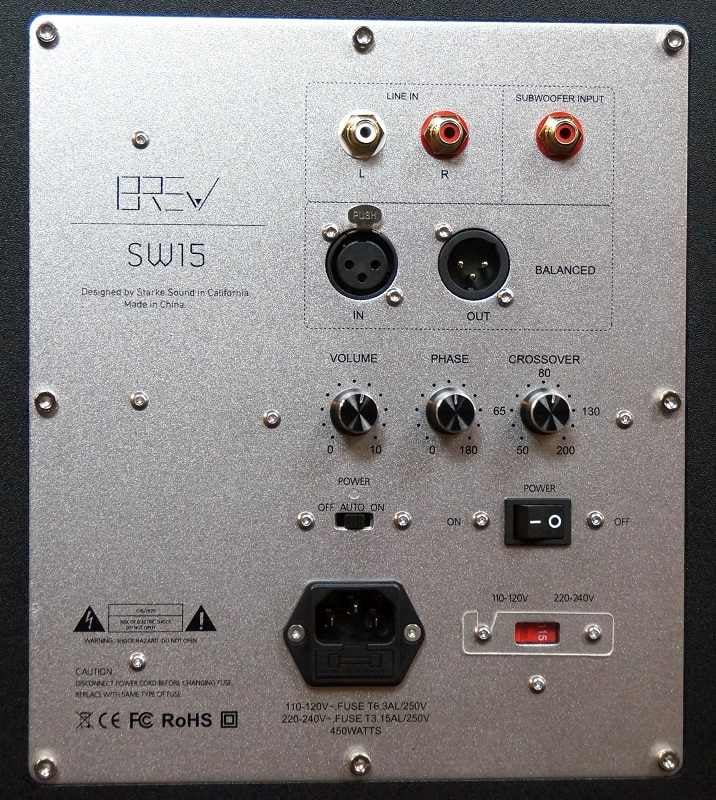

The drivers are powered by class-D plate amps with the SW15 amp spec’d at 475-watts RMS and the SW12 amp spec’d at 450-watts RMS. That is so slight of a difference of power that I have to guess the SW15 is spec’d higher since it possibly uses a lower impedance driver which pulls more power from the amp, but the amp is the same between them. The subs’ have RCA left and right inputs as well as balanced XLR inputs and outputs. Balanced inputs and outputs are a nice surprise to see on subwoofers at these price points. The subs only have the standard controls of volume, phase, and low-pass filter knobs, although one slightly unusual feature is that the low-pass filter knob goes all the way up to 200Hz. The only difference between the amp plates on the SW12 and SW15 is that the SW15 also has a LFE RCA input along with the left and right RCA inputs.

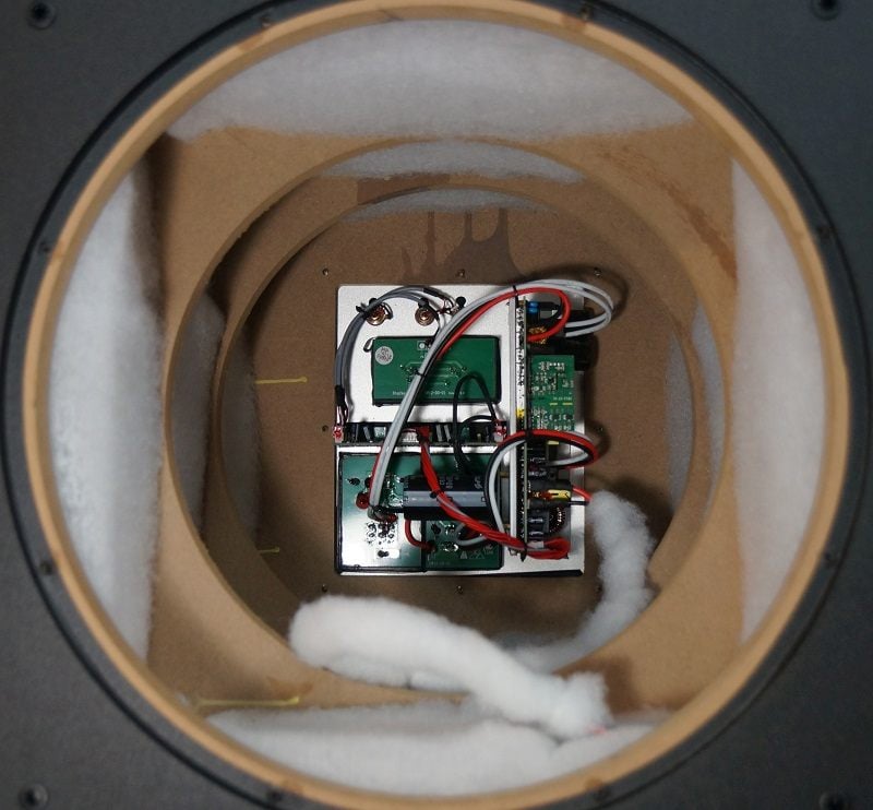

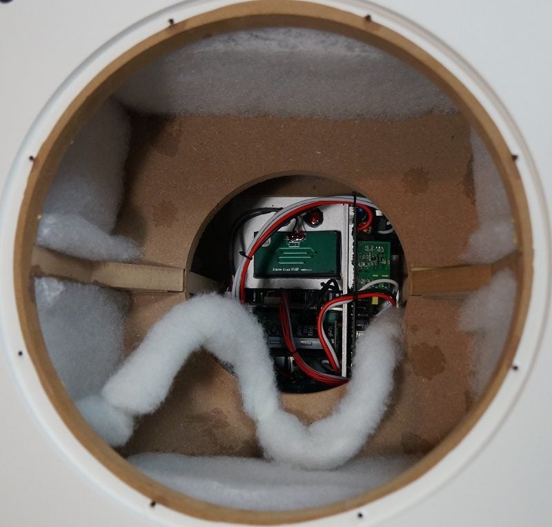

The cabinets are made from MDF, of course. The SW15 is a bit more sturdy construction with a 1 ¼” thick front baffle and two vertical braces, whereas the SW12 uses a 1” thick front baffle and a vertical joined with a lateral brace. Side panels and braces on both subs use ¾” thick boards. There is polyfill-type stuffing lining the walls and speaker cable. The subs have simple rubber feet that give them a ¾” clearance from the floor. The grilles adhere to the front using fairly standard grilles pegs and grille guides. The grille frame itself is quite thick and pushes the fabric covering about an inch forward from the front baffle, thereby giving the cones and surround plenty of space to flex.
Overall, the design of the SW12 and SW15 look to be sensible and uncomplicated, and they don’t give any cause for complaint in any of the individual components. But the components don’t tell the story of any loudspeaker or subwoofer. The real story is told by the design as a whole. How well balanced are these components, and what were the trade-offs made by the engineers for the end result? The answer to that requires both real-world listening as well as objective measurements, so now let’s start by giving these subwoofers some time with our ears…

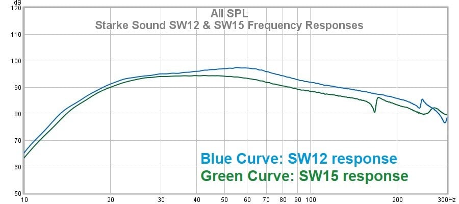

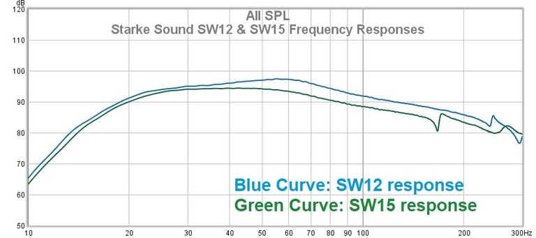

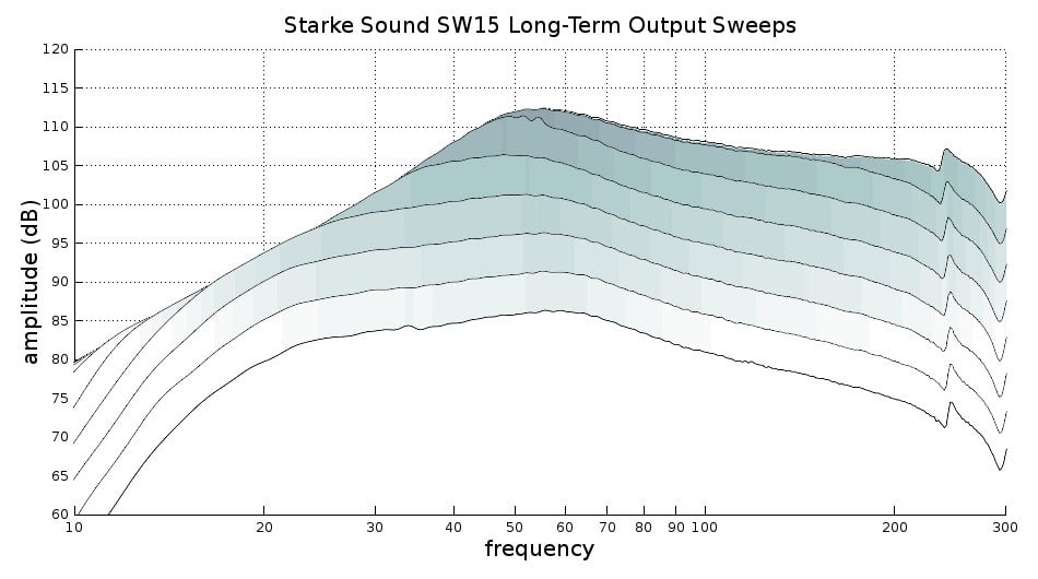

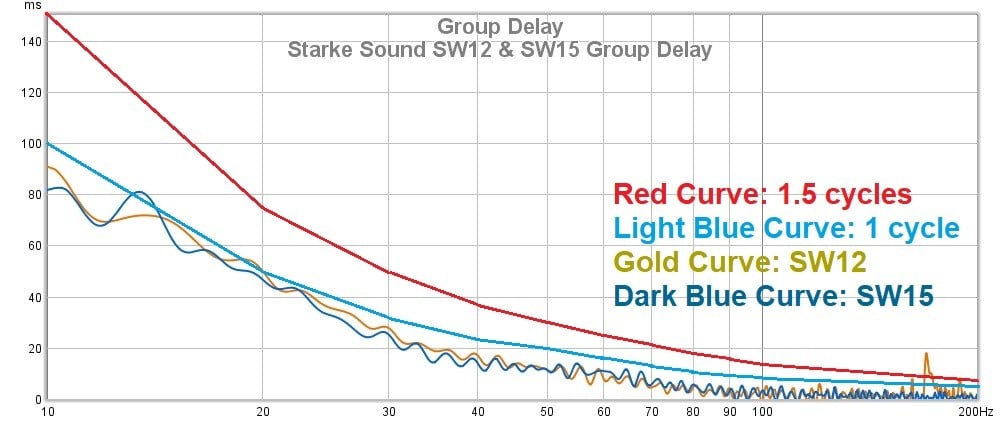

The best placement for a single sub in my room gives me a relatively flat response for an un-EQ’d single subwoofer, with a window of +/- 4 dB from 25 Hz to 100 Hz with no broad dips in important ranges. This location trades low-end room gain for a relatively flat response, a worthwhile trade for my tastes. The receiver used was a Pioneer Elite SC-55 and the crossover was used mostly at 80 Hz. As always, I will note here that since room acoustics have a huge effect on low frequencies, the way these subwoofer sound in my room at my listening position is not necessarily going to be the way they sound anywhere else for anyone else, so readers would do well to keep that in mind, and not just for this subwoofer in this review but for any subwoofer in any review.

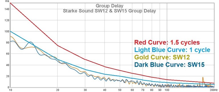

Neither sub sounded slow on the attack or decay of the double bass in this album. The twang of each pluck sounded as if it were coming from one sound source rather than two. As with what was heard on the pipe organ music, the SW15 had more force. However, the disparity wasn’t as obvious on this album, and I would guess the reason is that the double bass doesn’t dig quite as deep in lower frequencies as the pipe organ. Both subs could provide a slight visceral thwack on the attack of each pluck. Both subs had no problem following the more complex playing of the passages with more dense notation, and the bass sound never fell into fuzziness or confusion. Again, the SW12 was surprisingly potent for its size and specs. In fact, unless you are listening to this type of content at loud levels, I would think the SW12 would suffice nicely for most people’s tastes. A larger room might require the SW15, but if your application is jazz, the SW12 is a terrific little subwoofer that does justice to this material.

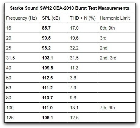

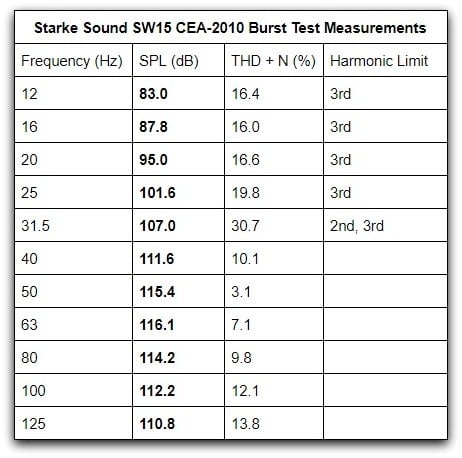

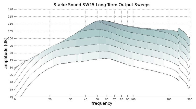

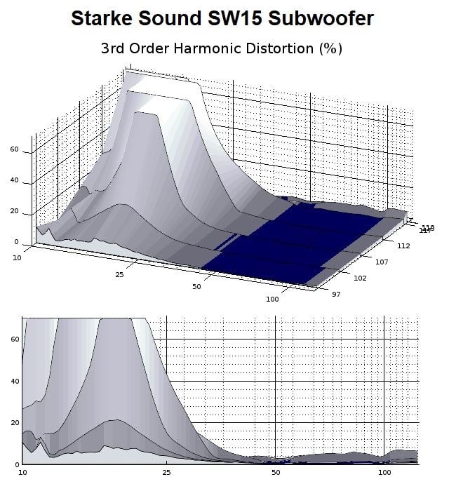

I started off with the SW12. I gradually cranked the volume, and it was rocking pretty hard, putting out lots of clean, deep bass at an elevated loudness level. I cranked it a bit more, and it quickly became unhappy. The good news is that it lets you know where its limits are without any uncertainty. This is preferable behavior to subwoofers where the distortion creeps in more surreptitiously that can mess up the sound without the listener quite sure where the problem lies, although I would prefer a limiter where the sub simply isn’t allowed to reach that level. Nonetheless, the SW12 was able to achieve a surprising output level before it hit its limits. The SW15 showed itself to be significantly more capable on “Skin Out” and didn’t break a sweat at output levels where the SW12 was making a very obvious flutter noise. Track 7, “Purple Frog,” buzzed my sofa so much that my remote control fell off the armrest. It was as if I had installed a tactile transducer directly to the seat. Its deep bass abilities reminded me of the output capabilities of ported subs, and it matched the low-frequency energy on this album to an almost violent degree. It wasn’t able to be overdriven like the SW12, even though its motor wasn’t that much larger and the amplifier was not more powerful than the SW12. For the last track, I decided to have some fun and ran both subs simultaneously. That pulverized my room, and I stopped after just a couple of minutes since I was afraid of what could be rattling loose in other rooms of my home. It was a fun couple of minutes though.
I concluded from listening to “Skin Out” and others like it on both of these subs that if you are the kind of person who likes to crank the volume and blast your system without worrying how it will handle itself, go for the SW15. Not only does it have more headroom than the SW12 (which should be obvious from the driver diameter difference) it can’t be pushed into making ugly sounds or running into acute limiter behavior. The SW12 performs better than would be expected for a sealed 12.” However, when its limits are reached, the party is over.
