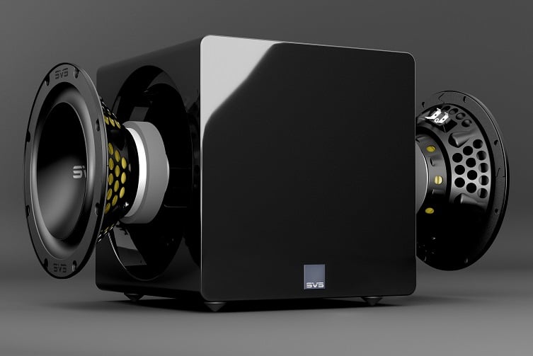

For all of their problems, there is a high demand for a sub of very small size, and that is an opportunity that SVS. For the above-stated reasons, SVS knew this old microsub formula wouldn’t do, so they worked on their own approach. To start with, they use a dual-opposed design where two 8” drivers are mounted on opposite sides of the enclosure. That cancels out rocking motion since the driver’s oscillation negates each other with perfect timing. That also takes advantage of more surface area which lessens the need for single-driver excursion to hit target SPLs; two 8” cones have about the same surface area as an 11” cone, but an 11” cone would not be able to fit on any of the sides of a sub this small. Reducing the need for huge excursion also makes the drivers more efficient and therefore doesn’t need massive power just to wake up. Reducing the need for super high excursion also reduces induction problems by needing less coil. SVS also addresses induction by adding an aluminum shorting ring in the motor that should help inhibit its effects.

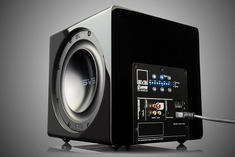

The 3000 Micro bears many of the features that have made their way down the line of SVS’s subs since the introduction of the 16-Ultra series which include smartphone app control, 50 MHz Analog Devices Audio DSP, MOSFETs on the output stage of the amplifier, and the ‘Intelligent Control Interface’ plate amp controls. We have covered those features extensively in other reviews and previews of SVS products, so we won’t go over them again here, suffice it to say that SVS has squeezed a hell of a lot of technology into such a small container. It does come at a price though, and, at $800 (includes shipping), the 3000 Micro does cost a bit more than the 1000 Pro subs and is equally-priced with the SB-2000 Pro. One nifty attribute of the 3000 Micro which enhances its value is that its standard finishes are piano gloss, in either gloss black or gloss white. Its petite size and pretty finish should make it unobjectionable for all but the most aesthetically-austere households, and even then its small size makes it easy to hide out of sight.
