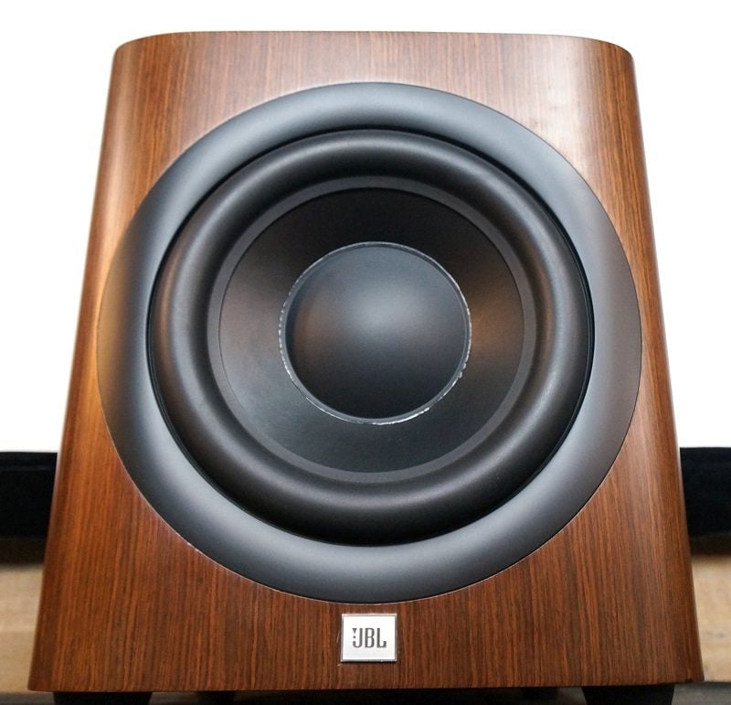

Appearance

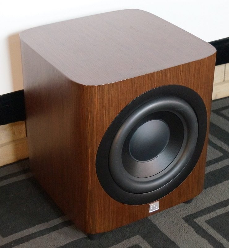

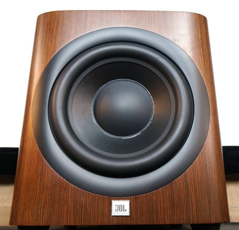

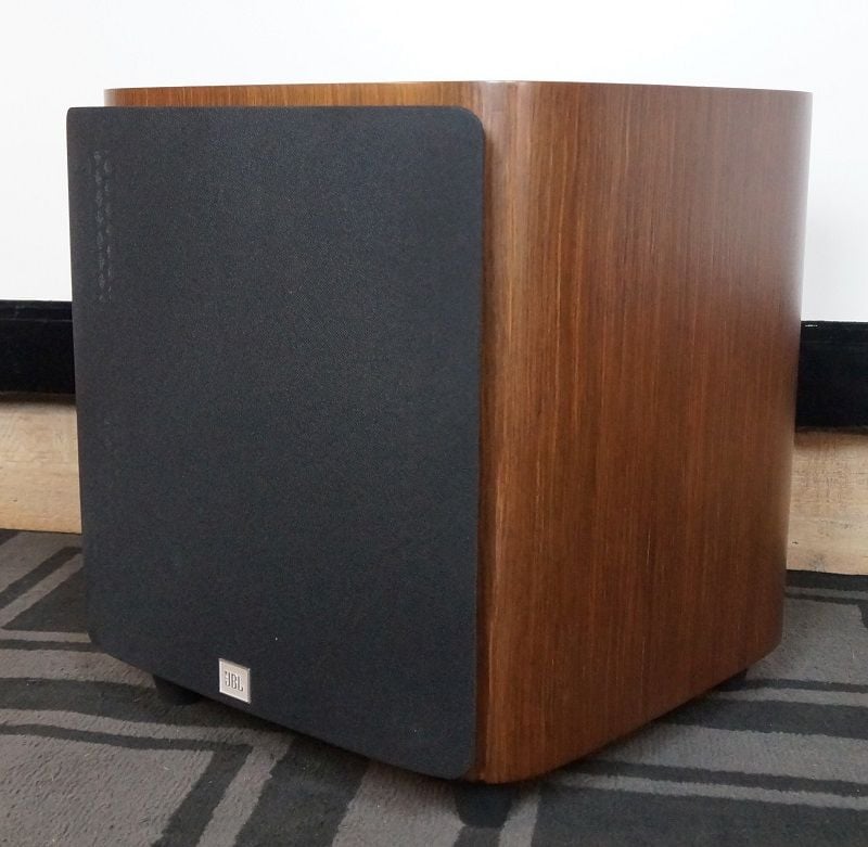

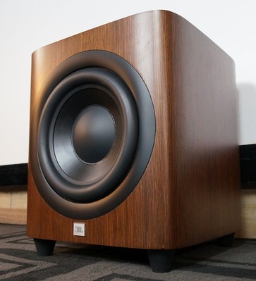

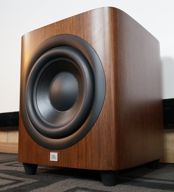

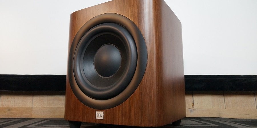

As subwoofers go, the HDI-1200P is a pretty nice-looking one. It is approximately a 17” cube in overall size, so it’s not very large as subwoofers go, and that goes a long way towards making it visually acceptable for other household members. It also has a furniture-grade finish and build quality, and by that, I mean nice furniture. The model I was sent had a real-wood walnut veneer with a satin finish, but they can also be had in a gloss-black and grey oak veneers. The walnut veneer is very elegant; indeed, it is one of the nicest walnut veneers I have seen to date. The cabinet has heavily rounded corners on the vertical plane that furthers its furniture aesthetic. The woofer is simple and not an eyesore, and it is surrounded by a black trim ring so there are no visible frame screws. It comes with a simple grille that uses magnetic adhesion so there are no grille guides on the front baffle. The grille makes the sub look plainer, as usual, and, while it may help to protect the cone from blows, I don’t think it improves the appearance of this sub. The cabinet is elevated off the ground a fair bit by some tall cone feet. It is a classy-looking unit that does not call attention to itself and would not be out of place in an upscale living room or bedroom.
Design Analysis
The HDI-1200P would appear to be a simple ported subwoofer on the surface, but there is more than what meets the eye. One would expect a pretty beefy driver in a $3,000 subwoofer, and the HDI-1200P does not disappoint in this regard. It has a massive motor section that is designed with what JBL calls the ‘Symmetric Field’ design. This is where the pole piece is extended above the top plate to control stray magnetic flux, which makes the magnetic field above the top plate symmetrical with the field below the top plate. A more even magnetic field on both sides of the top plate would leave the HDI-1200P with reduced odd-order harmonic distortions since the voice coil would have a more equal force on both sides of its excursion.

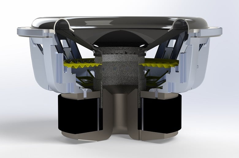

JBL HDI-1200p 12" Subwoofer Driver
The HDI-1200P’s driver magnet is a big one and should provide a lot of force to throw the moving assembly around with a high degree of control. It has a 3” voice coil which is a fairly large diameter coil for a 12” driver. The depth of the motor looks like it would give the former a lot of room to move so the driver should be capable of large excursions that are mechanically limited primarily by suspension tension. The suspension is made of Conex for the spider and nitrile-butyl rubber for the surround and is computer optimized for linear travel both outward and inward. The pole piece has a large vent to efficiently exchange hot air for cool air. There is also an aluminum shorting ring to help reduce even-order distortions that result from current induced by the voice coil itself as it oscillates in the magnetic field. The HDI-1200P uses a hefty cast aluminum frame, and the cone is made with high-density pure pulp in what JBL calls the ‘PolyPlas’ cone which is polymer-coated cellulose fiber material.
JBL HDI-1200p 12" Amplifier
The HDI-1200P driver is powered by a 1,000-watt RMS class D amplifier, that’s a lot of power for a single 12”, but that particular 12” is a lot of driver. The amp controls are the usual volume knob, phase switch, and low-pass filter controls, and it also has a single-band of parametric equalization which could be useful for taking down a room-induced peak in the response. The amp has monitoring and protection against poor quality AC power in case your wall outlet power delivery isn’t always perfect. It has a pair of balanced XLR inputs and unbalanced RCA inputs for connectivity.

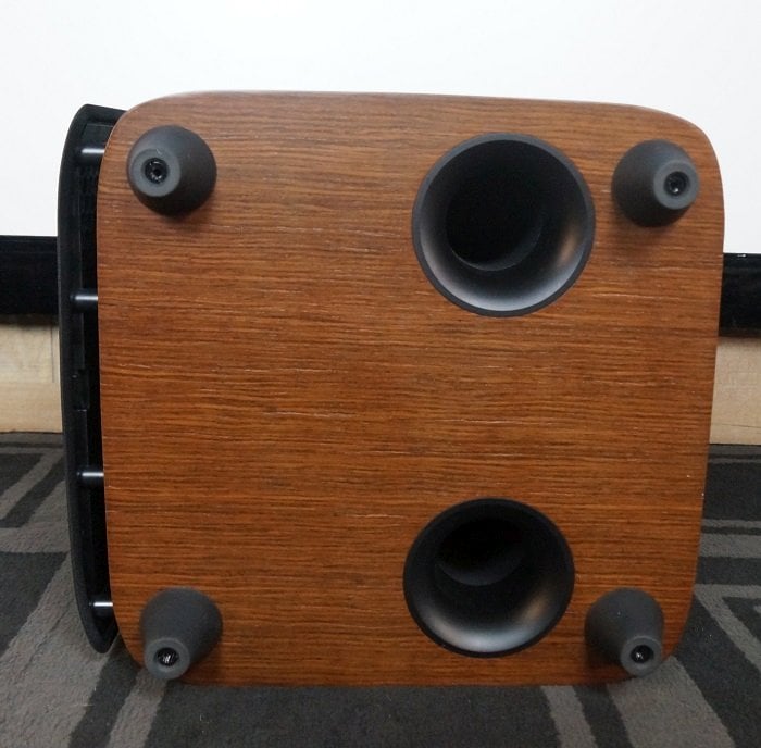

JBL HDI-1200P Subwoofer: Front View (left); Bottom View (right)
The enclosure is a stout MDF construction. There are two down-firing ports on the bottom of the sub that have a 3” diameter and a 13” length and are flared on both ends. That is a lot of diameter for that length so I would expect the HDI-1200P not to be tuned to a super deep frequency, but it should have a whole lot of port-generated output within its bandwidth. The feet are some large rubbery cones that end in a small ring instead of a sharp tip. They are soft so you can set them on a hardwood floor without worrying about putting a scratch on the flooring. You can also screw in some metal spike tips that are provided by JBL. These narrow metal spikes are sharp, and if they have the weight of the sub behind them if set down on a human foot or hand, they will go through flesh pretty easily, so those who opt to use the spikes should be careful. I’m not sure there is really a good reason for using spikes in a product like this (the “mechanical uncoupling” argument does not hold water with me) except to give it some more clearance from carpeted surfaces. The tall feet are necessary to give the ports adequate clearance from the ground to function well.

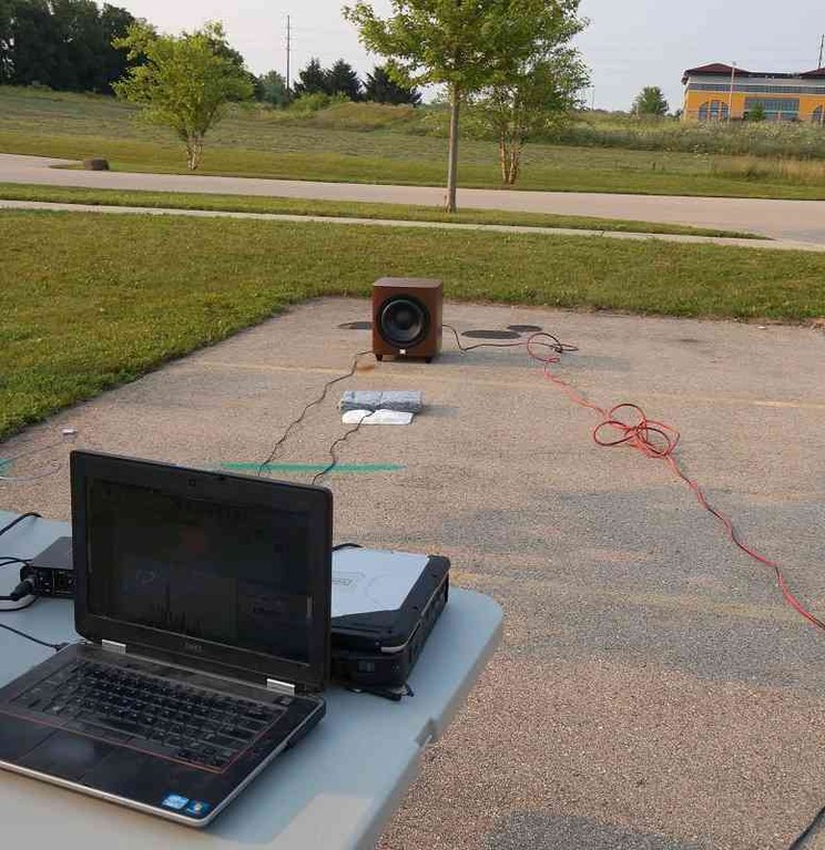

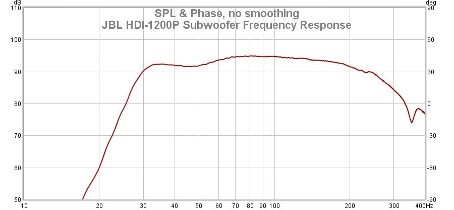

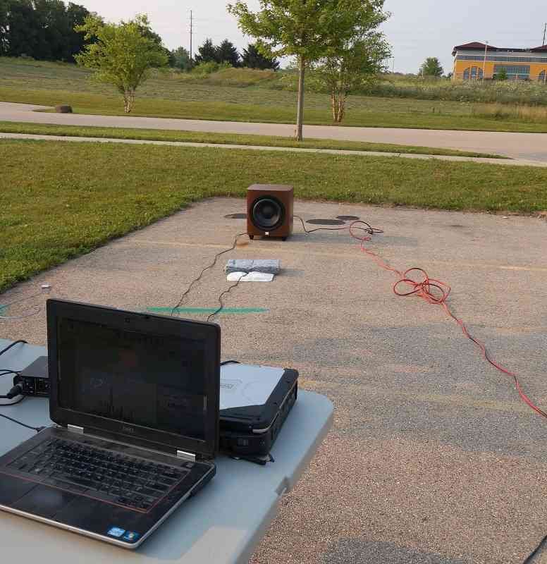

Testing on the HDI-1200P was conducted with the microphone facing the woofer at a 1-meter distance and then scaled back to 2-meters in our graphs by subtracting 6dB in output. The temperature was recorded at 65F degrees with 80% humidity. The subwoofer’s gain was set to maximum, phase was set to 0, and the low pass filters were left off.

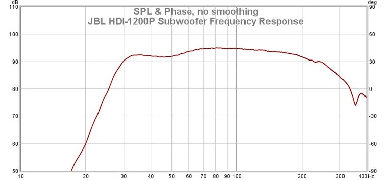

The above graphs show the measured frequency responses for the JBL HDI-1200P subwoofer. Here we see a fairly neutral response although not quite absolute perfection. JBL’s spec for the response as “28Hz - 150Hz (-6dB)” is accurate. The anechoic range of this sub is pretty much 30Hz to 250Hz, and the in-room response should be able to extend that down to 25Hz or so in average domestic room sizes. The ports look to be tuned to around 30Hz, so this is not the deepest-digging subwoofer around, but that is what would be expected of a small ported enclosure. This extension should be enough to capture 99% of recorded music bass content and 90% of recorded movie bass content. However, there are some movies with extremely deep bass that might lose something with a 30Hz roll-off. It is nice to see some real upper bass extension, and these subs could easily be crossed over as high as 200Hz if the user wanted. The advantages of this are that a multi-sub system can address room modes above standard crossover frequencies without worrying about localization. The subs are also likely to deliver a greater dynamic range than most speakers are able in this mid-bass band as well. This extended upper bass range can be useful, so it is nice to see here, and unexpected since many of these long-throw, small-cone drivers tend to be on the heavier side which can just kill the response above 100Hz.

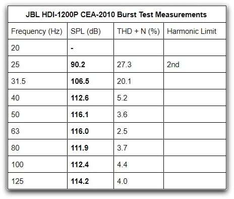

The above CEA-2010
measurements are short-term bursts that show the subwoofer’s clean peak SPL
before heavy distortion sets in. Our measurements have been referenced to
2-meter RMS, which is 9dB down from the standard requirement for the
measurements to be shown at 1-meter peak. However most publicly available
CEA-2010 measurements are shown at 2-meter RMS, so we followed that convention.
The HDI-1200P was able to pass a 25Hz test tone, although not comfortably since
that frequency lay below the port tuning frequency. As the frequency response
measurements show, this sub is built for 30hz and above. 50Hz and 63Hz turn in
an especially strong showing here, and that range serve as the basis for the
fundamental frequency for a great deal of music, so the HDI-1200P should be
able to give a very solid foundation for music even at loud listening levels.
The response does taper off a bit at 80Hz and above, and that could be due to
the weight of the moving mass or maybe induction chipping away at higher bass
frequencies. The 31Hz tone burst was amp limited, and frequencies above that
could not be pushed into any significant distortion levels. The sub is
exceptionally clean above 30Hz, and it is evident that non-linear distortion
was a parameter that JBL took seriously in their performance targets. While the
HDI-1200P doesn’t technically qualify for our Bassaholics ‘Medium’ room size rating since it misses the output requirement at 25Hz, I will
give it a ‘Medium’ anyway since it considerably exceeds the requirements for
the ‘Medium’ room size rating at 31.5Hz and above.

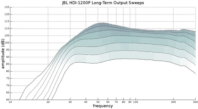

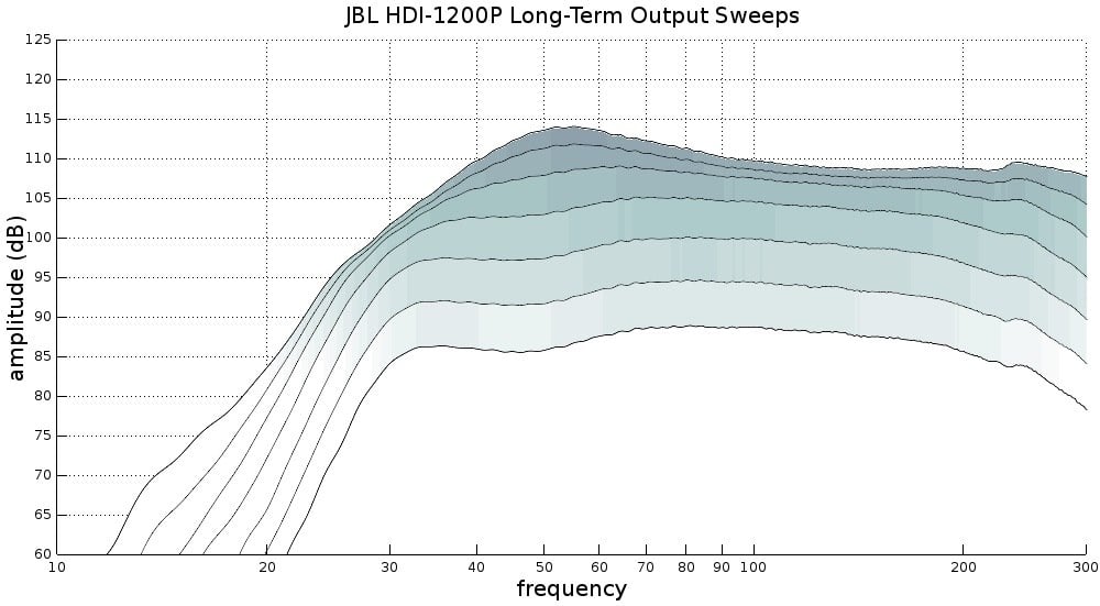

Testing for long-term output compression was done by first conducting a 20-second sweep tone where 50Hz hit 90 dB with the subwoofer 2 meters from the microphone. We then conduct further 20-second sweeps by raising the gain by 5dB until no more output could be wrung out of the subwoofer. These tests show us the long-term continuous headroom that the subwoofer is capable of. The HDI-1200P holds its response shape fairly well out past the 100dB level, and then what looks to be a moderate induction-related peak pops up centered around 50hz. The aluminum shorting ring isn’t quite enough to negate induction effects completely, but that is not a surprise given the large 3” voice coil with such a long throw. It’s a lot of copper with a lot of motion under a lot of magnet. There are certainly less expensive subwoofers that do offer more output, but this is overall a respectable level of output for a small ported 12”.

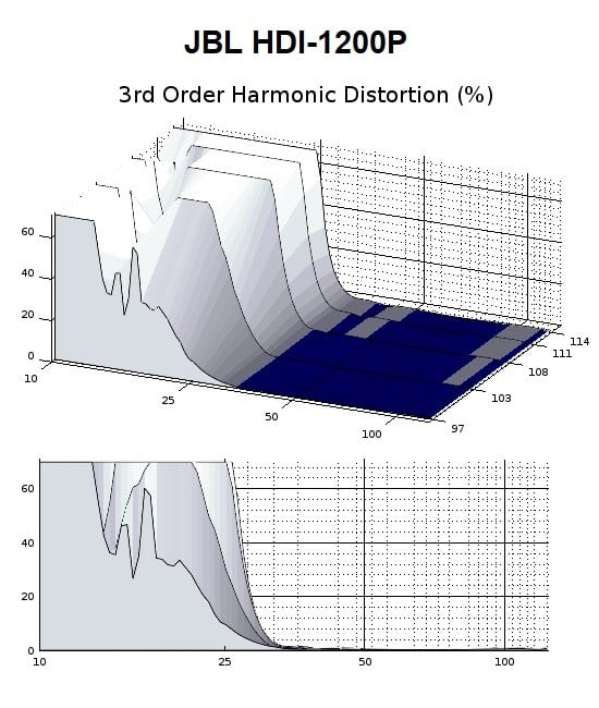

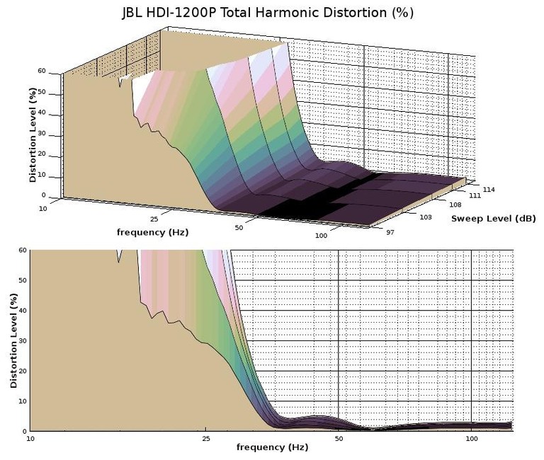

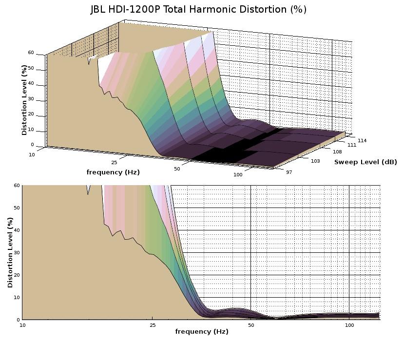

The above graphs show the corresponding total harmonic distortion to the long-term output graphs. Essentially, they depict how linear the subwoofer remains for the corresponding drive level seen in the long-term sweeps. The quantity being measured is how much of the subwoofer’s output is distortion and is shown here as a percentage. As we saw in the burst measurements, the HDI-1200P is very happy at 30Hz and above but isn’t really built for anything under 30hz. It should be kept in mind that while distortion takes off like a rocket below 30Hz, output falls like a rock below 30Hz, so any distorted output will be very far down in level relative to clean output. Take a close look at the response shape seen here, and it is essentially an inverse of the frequency response shape. So don’t think that the sub will make all kinds of distress noises if it is pushed to play deep bass since it drastically reduces all output below 30Hz. It might make some audible distortion if only fed sub-30Hz sinewave test tones, but it wouldn’t be loud in level, and in real-world use, any distorted output would be masked by the much louder signal content above 30Hz.

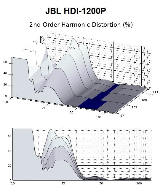

The above graphs depict measurements of the constituent harmonics from the long-term output sweeps and are what the total harmonic distortion measurements are composed of for the 2nd and 3rd harmonics. These individual harmonics can give us a clue as to what might be the cause of some quirk or non-linearity. We are only showing the 2nd and 3rd here because they more or less reflect the higher even-order and odd-order behaviors, although higher-order harmonics tend to be much further down as a percentage of distortion compared to the second and third.
What is interesting in the harmonic components of the HDI-1200P is that there are no odd-order distortion products to speak of within its operational range of 30Hz and above. JBL’s ‘Symmetric Field Design’ technology seems to be working extremely well! I don’t normally expect much of those kinds of marketing buzzwords, but the proof is in the pudding here. The nice thing about this is that the odd-order harmonics are much more audible than even-order harmonics, especially in music content, so what little distortion the HDI-1200P has is of the more benevolent variety. Even-order harmonic distortion can scarcely break over 5% which is what we also saw in burst testing. This is a very clean subwoofer that cannot be pushed into any audible distortion in its intended operating range.

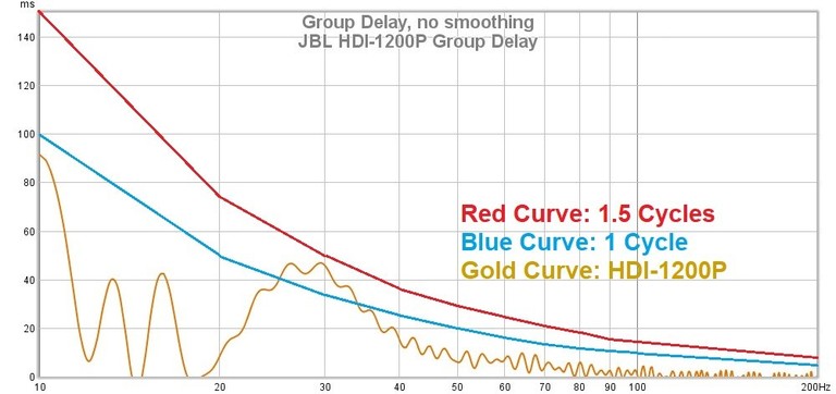

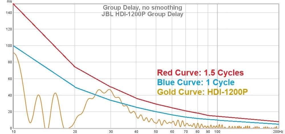

Group delay is the measurement of how much time it takes for individual frequency bands of an input signal to be produced by the speaker. It can indicate that some frequency components are developing slower than others or are taking longer to decay. It is generally thought that 1.5 sound cycles are needed for group delay to be audible at bass frequencies, although there is an argument that group delay should remain under 20ms to be completely unnoticeable, but that is likely meant for mid and upper bass frequencies. Ported subs must necessarily exceed at least one cycle of group delay as a consequence of the ported design, but the HDI-1200P restricts its group delay to as little as possible. Port tuning frequencies just above one cycle and then quickly back down outside of port-resonance. The group delay is very unlikely to be anywhere near audibility since it occurs at such a deep frequency. By 40Hz, it is below 20ms which is one-fiftieth of a second, so the time domain behavior in music ranges is quite good. There shouldn’t be any audible bloat or overhang at all from the HDI-1200P, and those who hear that from a system with an HDI-1200P subwoofer are certainly suffering from room acoustics problems or calibration problems because it isn’t coming from the subwoofer itself.

The JBL HDI-1200p Subwoofer Beautiful Real Wood Veneer
The odd aspect of the
HDI-1200P is that here is a modestly sized sub that compliments the HDI
loudspeaker series, which are fairly large speakers for the most part. One
would think that the buyers of the HDI speakers would be able to accommodate a
