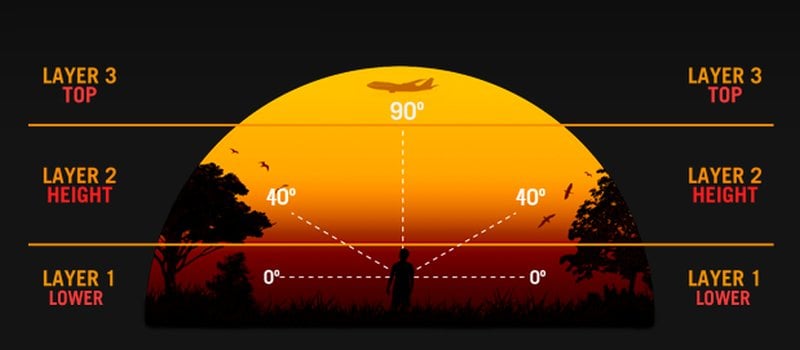

Auro 3D Layers
Auro 3D presents a "dome of sound" to the listener.
Auro-3D is all about a totally new sound experience that surpasses anything you’ve heard before. By fully immersing the listener in a cocoon of lifelike sound, Auro-3D creates the sensation of actually 'being there,” along with the best reproduction of color/timbre using the most efficient speaker layouts. The Auro-3D format is designed as a cross market solution with fully compatible and scalable speaker layouts based on the size of the room, and built on the specs of today’s 5.1 and 7.1 surround standards for professional cinema as well for home cinema. The groundbreaking Auro-Codec® technology is a key part of the Auro-3D format, and allows an easy integration in all audio markets (film, games, music, broadcast, etc.) without any need for changes in specs, bandwidth or delivery formats (existing Blu-Ray format etc.). This unique technology allows us to bring an “Immersive Sound” experience to all markets with high resolution audio in all channels.

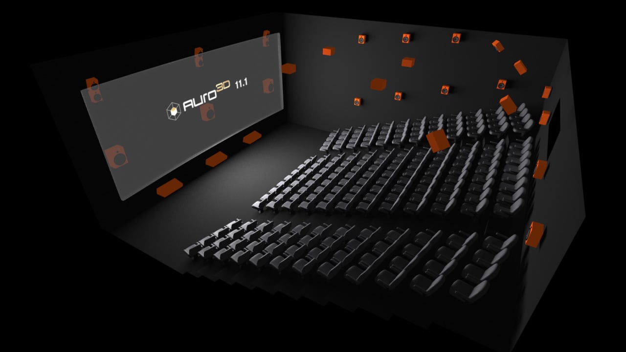

During the Tokyo convention in 2010, I presented the Auro 11.1 cinematic system, which is based on the existing 5.1 surround standard. It uses a unique 3-layered speaker layout that allows for a much more natural vertical spread of sonic energy in the hemisphere, which is key to getting the most enveloping experience. World famous Skywalker Sound installed their first Auro-3D Studio System in MIX A Studio during the summer of 2011. A few months later, this was followed by the announcement that Lucas film was to release “Red Tails” as the first movie ever in “Immersive Sound” using the Auro-3D format. Barco, worldwide leader in professional cinema projectors and exclusive partner of Auro Technologies for Digital Cinema, was immediately selling Auro 11.1 systems on a global scale.

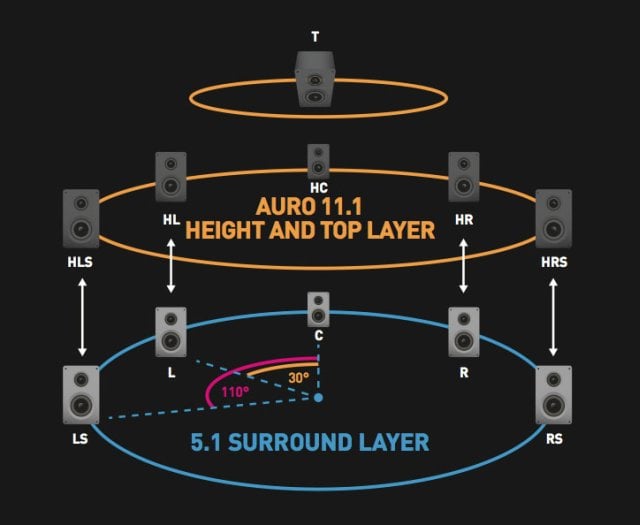

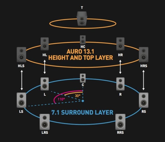

Auro 11.1 Auro 13.1
The Auro 11.1 and Auro 13.1 unique 3-layered speaker layouts
since we don’t have an ear on top of our head, we are not able to position sounds as phantom sources between two speakers placed vertically above each other.

Another important difference is the number of screen channels. Dolby Atmos is using the standard 3 main channels (L/C/R) and for large screens Lc and Rc as 5 channels in one single horizontal layer. In contrast, Auro-3D uses six screen channels in two vertical layers. Most engineers fall in love with Auro-3D initially because of the quality of the immersive experience thanks to the unique 3-layered system. However, after a few mixings they start to understand the power of having 6 screen channels, which gives them greater creativity, better A/V coherence, and more depth / transparency from the sound on screen. Even in an immersive format, this is still by far the most important part of the sonic presentation.
Auro-3D’s unique Height Layer
The next differentiator is that our Height Layer uses speakers in front of and beside the listener. Ceiling speakers are only needed for the” Voice of God channel” (directly above the listener), which is not a necessity in smaller home theaters. Installing height speakers thus far has never been a problem, in many hundreds of locations. At home, there is often room above the corner speakers of a standard 5.1 surround setup. Of course, if people don’t want to see cables on the wall, we have solutions for that, including wireless powered speakers.
Advantages of higher channel based scalability
Scalability is another positive factor. The Auro-3D format has channel-based configurations from Auro 8.0 up to Auro 13.1. This strategy has many advantages not only for content creation in all markets, but it also maximizes preservation of the creative intent, workflows, distribution, etc. Above a certain amount of discrete amplified channels (around 20), the use of object-based technology makes sense. But to avoid suffering from all the issues that full object based systems like Atmos must deal with, our approach stays different in order to keep all advantages related to the Auro-3D format as described above.

In commercial theaters, more is possible. For that reason I designed the Auro 22.1 format which uses the same speaker layout as the Auro 11.1 cinematic install, but deploys more zones naturally spread over the hemisphere. I always found it illogical to have the long side walls of a theater lined with an array of speakers creating a mono field, and then adding a stereo field on the back wall to create 7.1 surround. A better starting point would have been 6.1 with L/C/R along with side surrounds and a single back channel. From there, you can then make a stereo field at the sides and rear to create a 9.1 horizontal layer. The key to immersive sound is to mirror that same 9.1 layer, creating the Auro-3D Height Layer. The ceiling channels would be divided in the same way, creating a Top Front in stereo array as well a Top Back array in stereo. The end result is the Auro 22.1 speaker layout, which is an easy expansion by just adding a few amplifiers on top of the Auro 11.1 cinematic setup. The final option is the addition of the wide screen surrounds in lower and height layer, which creates the Auro 26.1 system.

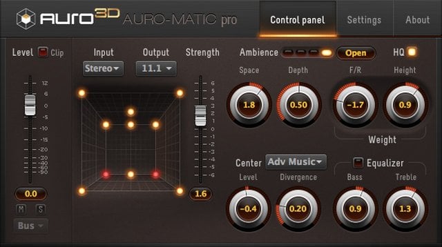

Quality of Auro-Matic up-mixing
The Auro-3D Engine also includes Auro-Matic®, which allows legacy content that people have at home in mono, stereo, or 5.1/7.1 to be automatically up-mixed in the Auro-3D format. Developments since 2006 have made this algorithm into what we feel the most natural sounding up-mixer available. It is impressive how even mono up-mixed to Auro-3D sounds incredibly natural, without changing the artistic intent of the original mix. There is no addition of distracting reverbs or changing the tonal spectrum or dynamics like other up-mixing algorithms typically do.
auro-matic upmixer
Auro-matic up-mixes legacy content into the Auro-3D format.
The Auro-Matic upmixer allows legacy content that people have at home in mono, stereo, or 5.1/7.1 to be automatically up-mixed in the Auro-3D format.

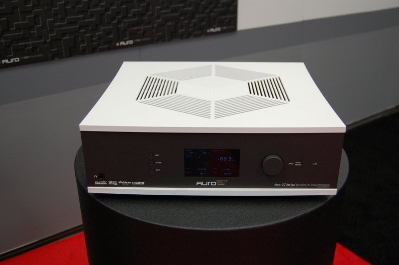

Wilfried: The power of our technology is full backwards compatibility. Not only are our speaker layouts based on the existing surround standards, but our technology allows us to integrate the Auro-3D master in the existing PCM standard, mandatory in each audio device. This solves a huge chicken-and-egg issue, which is always the problem with a new standard. There is already content that people have at home: hidden away in many Blu-ray discs are Auro-3D masters within the standard PCM. This concept makes the integration simple, and that is attractive for content makers since no extra investment is needed for the distribution. The same goes for the consumer who buys only one product while having two formats without any audible concession in each format.
Auro-3D Auriga A/V Receiver
Auro-3D's Auriga A/V receiver.
Auro-3D is fully backwards compatible making integration simple and easy for content makers since no extra investment is needed for distribution.

When we decided to bring Auro-3D out of the cinema and into the home, we were determined to get it right. We wanted to deliver true “Immersive Sound” to the consumer, to be the first, but also to be the best. I’m incredibly proud that we at Auro Technologies have done exactly that. A/V receivers and sound processors are ready and available for consumers to order. There are 3 Auro-3D branded sound processors and many A/V manufacturers will be launching Auro-3D integrated processors by the end of this year as well. The first car that will have Auro-3D integrated will be available to purchase at the end of 2015. The tools for game developers to create games with Auro-3D’s immersive sound are available as of now. Within the foreseeable future, Auro-3D will also be available on mobile platforms, delivering high resolution “Immersive Sound” by using just a single file, making Auro-3D the ultimate end-to-end solution to all markets

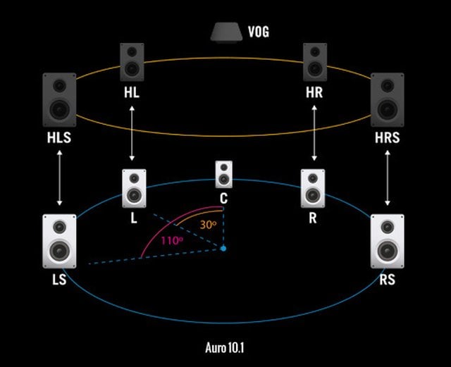

Audioholics: Looks like the speakers are located in the traditional “height” spots (excluding the 10.1 and 11.1 which use center height and top channels). Is this correct?
Wilfried: The Auro-3D speaker layouts are designed with a hierarchy in mind, meaning that we start with Auro 8.0 as the most efficient true 3D audio system. In order to achieve full backwards compatibility, we advise consumers at home to choose the Auro 9.1 system. Of course, for fly-overs and special effects, the addition of an overhead ceiling speaker (Auro 10.1) makes sense, but as already stated before, it is not necessary in smaller theaters. This third layer is treated as a mono channel in order to create the best scalability and largest sweet spot. In combination with the Height layer, this creates a very wide stereo field.
The height center speaker in the front (Auro 11.1 system) is needed in professional cinema theaters and is recommended for people who have a large screen at home. For very large home cinema theaters with at least 2 rows of seats, we suggest the Auro 13.1 system, which delivers the most immersive sound reproduction with the best audio quality and enough speakers to also make good use of object-based technology.
Auro Height
Auro-3D adds height channels over the existing 5.1/7.1 formats, and offers the option for "Voice of God" channels as well to complete their dome of sound.

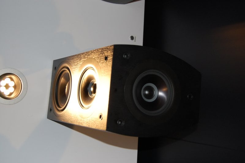

Audioholics:  Will Auro-3D offer an option like Atmos Elevation speakers to bounce sound off the ceiling or do you find that method to not be an effective solution?
Wilfried:
First of all, to create the most immersive sound, you don’t need sound from the ceilings but a vertical stereo field in front, sides and behind the listener between ear-level and a height of about 30°. The sound bouncing off the ceiling can never create the same quality of sound reproduction. Of course we looked into that as well, but we don’t like to make false promises. This doesn’t mean the effect won’t work, but it is not comparable with the real thing.
Elevated sounds cannot be created as vertical phantom sources without the use of psycho-acoustic effects like those used in the horizontal plane by using ‘sound bars.’ The quality of sound bars in the horizontal plane is not comparable with a 5.1 or 7.1 speaker system, and it will be even worse using that technology for the reproduction of height.  The use of such psychoacoustic effects (like notch filters) will always have a bad influence on the original sound quality of those height channels. The modes of the low to mid frequencies down to less than 300 Hz are key for our brain in spatial sound processing. The material of the ceiling has to reflect all those frequencies in the same way, as if the sound were coming from a height speaker. That is impossible. For that reason, above the ear-level layer we use a Height layer with speakers around the listener to enable the reproduction of the elevated source sounds as well as the most important native true 3D reflections around those source sounds.
The sound bouncing off the ceiling can never create the same quality of sound reproduction from a vertical stereo field.
Auro-3D supports various speaker layouts for the home, ranging from their Auro 9.1 setup for most home installations, up to Auro 13.1 for larger home cinemas. Auro 9.1 is based on a standard 5.1 Surround setup for the lower layer, augmented with four height speakers, sometimes referred to as the quadrophonic sky, positioned at 30º above the front left and right speakers. This setup is considered to be the minimum setup for real “Immersive Sound”, with a level of realism that can barely be surpassed by any other system given that the majority of the immersive effect is created by the interplay of the lower and height layers. From Auro 10.1 onwards, the speaker setups also have the third layer on the ceiling, to complete the ‘dome of sound’ all around the listener. This top channel is then mostly used for special effects such as fly-overs, similar to what happens in reality. The well-defined and fully compatible speaker layouts of the Auro-3D format for cinema and home guarantees the same immersive sound experience as it was originally intended by its creators.
Pioneer Atmos Speaker
Auro will NOT support Dolby's Atmos-enabled speakers, such as Pioneer's new Elite loudspeaker lineup.

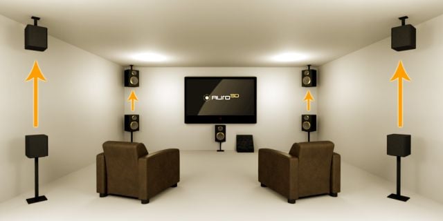

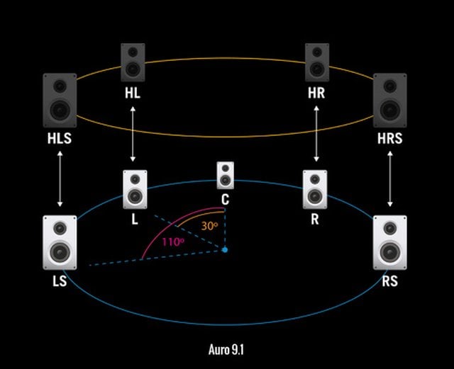

In order to maintain cross-platform compatibility, we would suggest the Auro 9.1 which is 5.1 bottom + four Height speakers located 30° above the ear-level front speakers
Audioholics: Is there one unified speaker layout that would be compatible with Auro, Atmos and DTS UHD?  If so, how many speakers would that involve and in what layout scheme?
Wilfried: In order to maintain cross-platform compatibility, we would suggest the Auro 9.1 which is 5.1 bottom + four Height speakers located 30° above the ear-level front speakers. This is close to the 5.1.4 format from Dolby, with the difference being that the angle to the listening position of the ceiling speakers will be closer to around 50° to 60°. This is a significant difference, and Auro-3D native productions could sound funny because reflections and source sounds mixed on 30° elevation for the Height channels won’t sound quite right being reproduced at around 50 to 60°. But if people install the Auro-3D speaker layout, they can playback Auro-3D content properly and due to Dolby's and DTS's claim that their object-based technology allows them a wide range of speaker layouts, an Auro 9.1 layout should provide good results there as well.
auro_3d 9.1 layout
The Auro 9.1 layout seen above should allow cross compatibility with the Atmos 5.1.4 layout.
