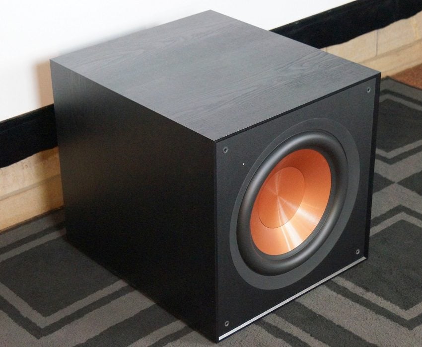

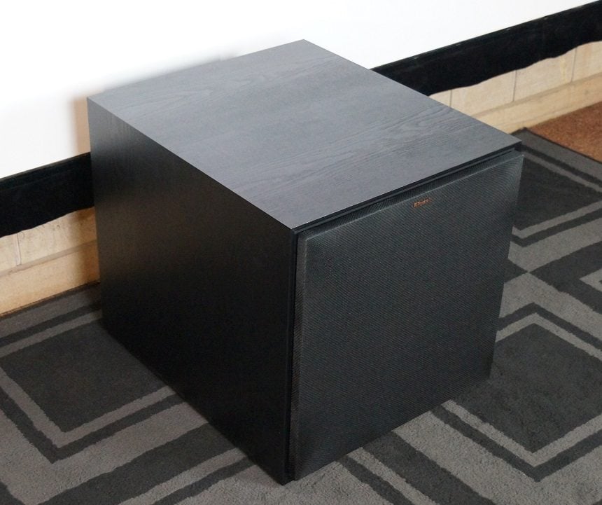

Appearance

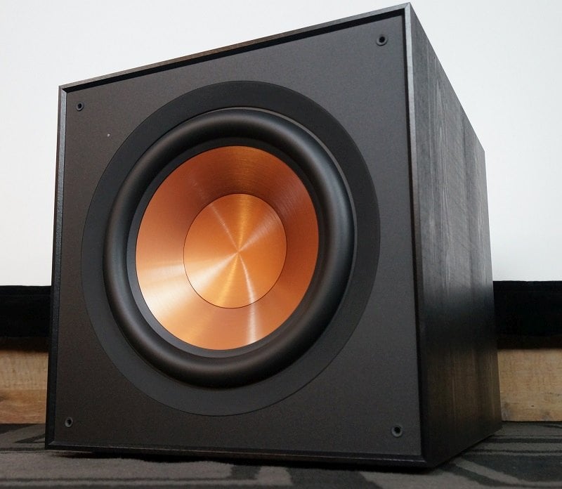

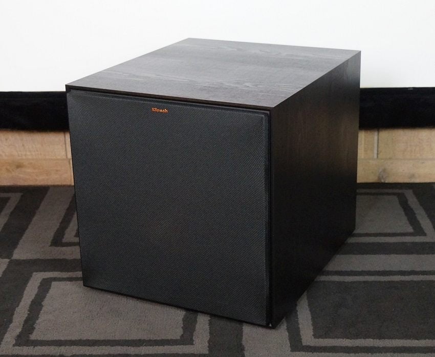

With its grille on, the R-121SW isn’t a very distinctive subwoofer. That isn’t to say it looks bad at all but rather it is a fairly routine black box like many other subs. It uses a black vinyl faux wood grain finish that can be seen in many other speakers and subs in this class. What is nice is that it is a fingerprint-resistant finish, unlike many satin or gloss finishes. All of the edges are hard angles and there is no edge rounding, so the cabinet doesn’t make much effort in hiding its boxiness. It disappears easily into a room corner for those who do not want something that attracts much attention. What helps in this respect is that it is on the smaller side of 12” ported subs, and it’s not a large subwoofer by most people’s standards, although it certainly wouldn’t be considered tiny either. It is only when the grille is removed that the sub visually separates itself from competitors. Removing the grille unveils Klipsch’s trademarked copper cone. To me, the copper cone design of Klipsch has always added a touch of class. Removing the grille also exposes a front-mounted LED power indicator that lets you know the sub’s power state. Overall, it is not a pretty subwoofer nor is it an ugly one. It just looks like a typical subwoofer.

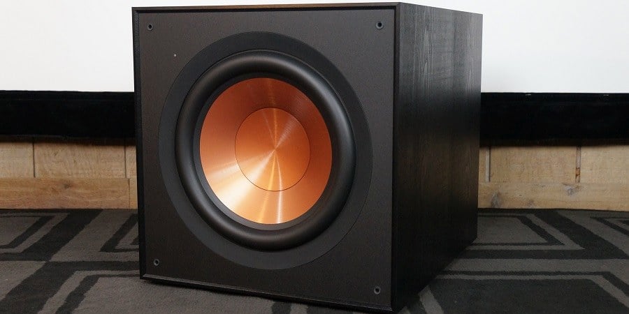

Design Analysis
The R–121SW seems to be a simple ported subwoofer, and that’s a good thing if it’s executed well. There is no need to reinvent the wheel when something works well. It uses a 12” front-firing driver in a box with a rear-firing port and is powered by a 200-watt (continuously rated) / 400-watt (peak) amplifier. That is the basic design overview, but let’s dig in a bit deeper to look at the specifics, and let’s start with the driver.
The driver’s cone is made from a material that Klipsch calls copper-spun thermoforming crystalline polymer (TCP). That sounds fancy, but, as far as I can tell, it is really just polypropylene with artificial cosmetic copper coloring. That is OK since, as we have said, there is no need to reinvent the wheel, and polypropylene is a good cone material on account of its light weight and stiffness. Klipsch says this cone has steeper angling for “a smoother response and improved accuracy and transparency.” Creating a steeper cone might make it more rigid, at least for the back-and-forth plane of motion that it’s intended to move in, and that could push flexing modes out to higher frequencies, but that isn’t normally a problem with subwoofer cones since they are relegated to such a low frequency band. The cone is attached to a stamped steel basket with a 1” thick surround and a Nomex spider. The motor’s magnet is not huge with a 4” diameter and 1” thickness, but the most important aspect would be the magnetic flux, which we don’t know.

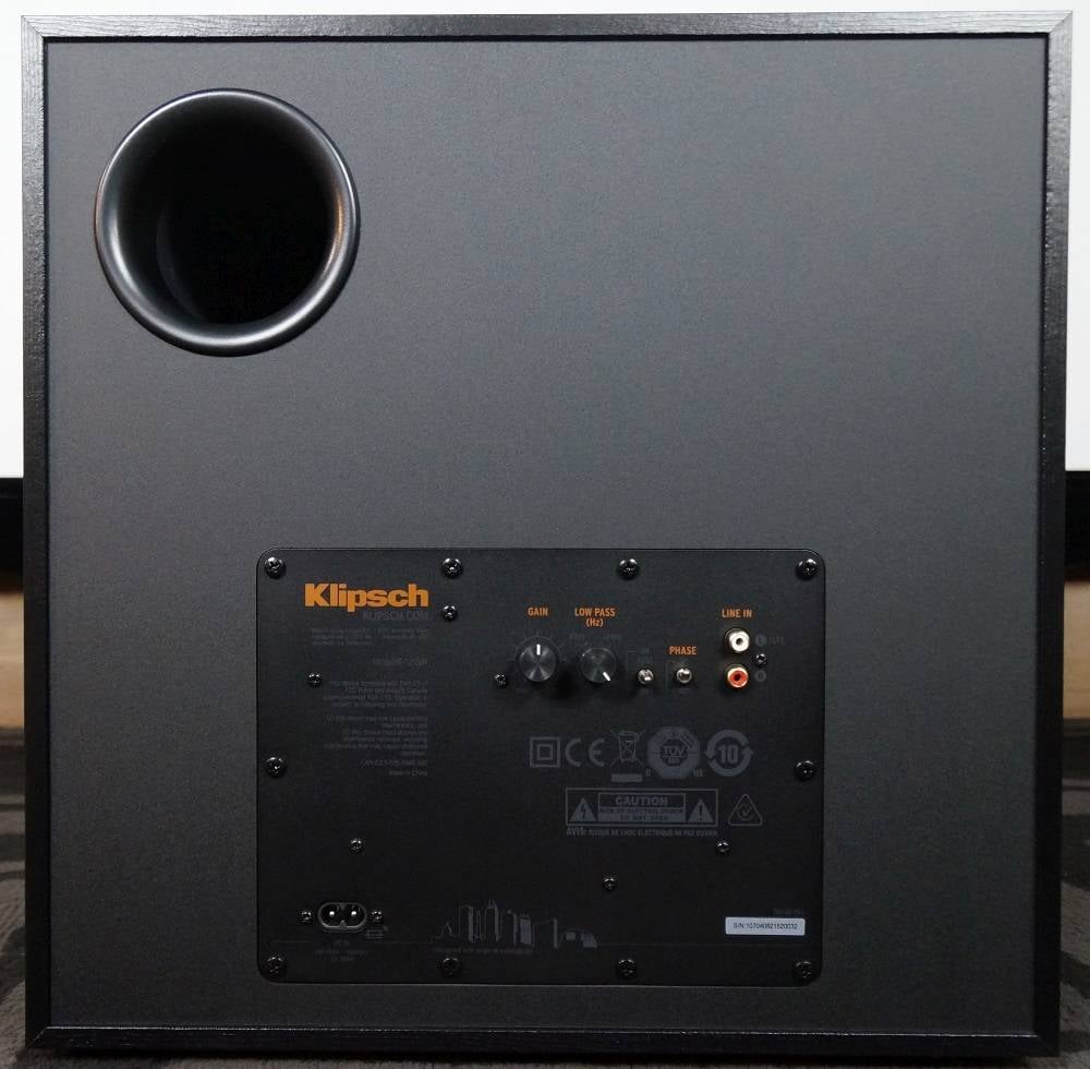

driver is powered by a 200-watt amplifier that Klipsch calls ‘all digital,’
which I presume means that it uses DSP processing. They don’t specify the
amplifier’s type, but it looks like Class D. It only has a basic control set
with a volume knob, a low-pass frequency knob that ranges from 50Hz up to
filter deactivation, a 0/180 degree phase switch, and an off/on/auto switch.
Inputs are only a pair of RCA jacks. It is a simple plate amp and doesn’t have
any extraneous features, and that is fine since most modern AVRs do most of the
subwoofer control anyway. For all the sophisticated subwoofer control methods
on higher-end subs like touch-sensitive screen displays, apps, and remote
controls, the vast majority of users just set the sub up and let the AVR deal
with it- as they should.

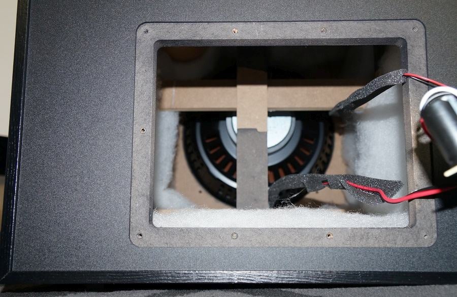

The cabinet uses ½” thick MDF side panels with a ¾” thick front baffle and a center brace to reinforce the midsections. There is polyfill lining the sides to help damp internal acoustic energy. The rear-mounted port has a 3” diameter and a 14 ½” length. It is only flared on the front. Those port dimensions suggest a relatively low tuning frequency, but we will see for sure in the performance analysis. The grille uses plastic pegs and grille guides to connect with the front. It only hides the driver but since it is just a fabric-draped frame, it wouldn’t protect the fragile cone from any heavy or fast-moving objects. The feet are some simple ⅝” tall hard rubber cylinders that get the job done.
As was said, this is a fairly simple sub on the surface, so there isn’t a whole lot more to discuss with this design, and many of the most important aspects that will determine performance are not outwardly visible, such as amplifier configuration or driver parameters. Let’s now see how it plays out in some typical use…

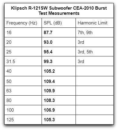

Klipsch Reference R-121SW Subwoofer Measurements & Conclusion

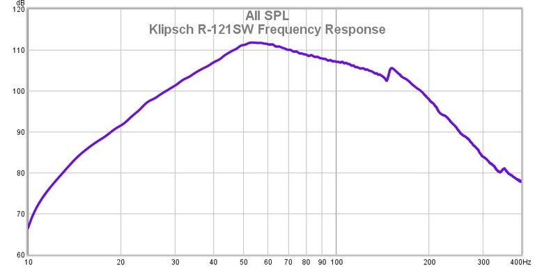

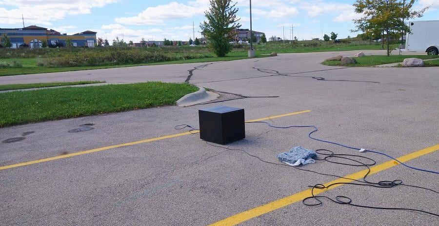

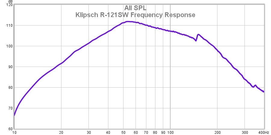

Testing on the Klipsch R-121SW was conducted with the microphone facing the woofer at a 1-meter distance with measurements scaled back to a 2-meter distance by subtracting 6dB. The temperature was recorded at 59F degrees with 70% humidity. The subwoofer’s gain was set to maximum, phase was set to zero, and the low pass filters were set to bypass.
The above graph shows the measured frequency responses for the R-121SW subwoofer. This response was produced by measuring the rear of the sub at 1 meter and the front of the sub at 1 meter and then averaging the two responses. A single measurement of either side doesn’t wholly capture the amplitude response of this unit. This is not quite the ruler-flat response that we see on more expensive subwoofers, but then this is not a tremendously expensive item. But those who are worried that it is not ruler-flat shouldn’t be; typical room acoustics pretty much make low-frequency ruler-flat responses a moot point since room modes will mangle the response anyway hence the need for equalization even for the most linear subwoofers. The response here centers around a broad peak at about 53Hz and has a gradual rolloff below that point down to the port tuning frequency. Below that point, the roll-off becomes steeper like we would expect to see from a traditional ported response. At about 16Hz and above, the response resembles that of a sealed sub. It looks to me like the port is more being used to reduce distortion and protect the woofer rather than giving the low-end of the response a big boost like in other ported subwoofers. The shallow low-end response should lend itself to pressure vessel gain which shores up the lower frequencies in an in-room response. Pressure vessel gain can give a very significant boost, especially in small to medium-sized rooms. This sub isn’t really made for large rooms, so this type of response is a good trade-off. This sub has a relatively low tuning for its size, but I guessed that we would see such a low tuning frequency by looking at the dimensions of the port. The upper-frequency extension is ok and we do get usable bass all the way up to 200Hz for those who want to use crossover frequencies higher than the standard 80Hz.
The above CEA-2010 measurements are
short-term bursts that show the subwoofer’s clean peak SPL before heavy
distortion sets in. Our measurements have been referenced to 2-meter RMS, which
is 9dB down from the standard requirement for the measurements to be shown at
1-meter peak. However most publicly available CEA-2010 measurements are shown
at 2-meter RMS, so we followed that convention. What we see here is a healthy
and respectable set of measurements for a small ported 12”. I was surprised the
R-121SW could net a passing measurement at 16Hz, but it did, although just
barely. The burst output trends generally follow the base frequency response
with most output hovering between 50-80Hz with a gradual rolling off above and
below that range. While the mid-bass region is about what I would expect, this
sub has more lower frequency oomph than I would have expected with 93dB burst
output at 20Hz and 95.4dB at 25. That does show that the deep bass that I heard
when watching “MoonFall” was not just my imagination. The above measurement set
technically would get this sub our Bassaholic’s ‘Small’ Size Room Rating, but
since it only misses the 31.5dB threshold by 1dB, and since it is highly
protected from being overdriven, I am going to give it a ‘Medium’ size rating,
meaning it should be sufficient for a room of 1,500 to 3,000 cubic feet. While
it’s not a THX Reference-level barn burner, I think most people would be pretty
happy with its output in a medium-sized room. For information on how the room
ratings are determined, please read our article “Bassaholic Subwoofer Room Size Rating Protocol”.

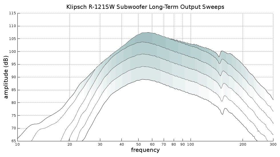

Testing for long-term output compression was done by first conducting a 20-second sweep tone where 50Hz hit 90 dB with the subwoofer 1 meter from the microphone (graph has been scaled to 2 meters for easy comparison with our other review measurements). We then conduct further 20-second sweeps by raising the gain by 5dB until no more output could be wrung out of the subwoofer. These tests show us the long-term continuous headroom that the R-121SW is capable of. Eagle-eyed readers will note that the nominal response shapes in this graph do not match that of the base frequency response that we posted above, and that is because this is taken at 1 meter from the woofer only, and this does lose quite a bit of port contribution to the output. There is a bit more deep bass headroom from the R-121SW than what is shown here, and what is missing would mostly be between the range of 13hz to 28Hz. Pulling the microphone back from the sub further would have yielded a response with more port contribution, but it would also have raised the noise floor of the testing conditions, and since this sub doesn’t have a huge amount of headroom, we opted for a lower noise floor.
With some deep bass headroom missing from this graph, I don’t want to offer too much commentary in that region since it would be speculative. What I can say is that the R-121SW has a healthy amount of mid-bass, surpassing 105dB from 45Hz to nearly 80Hz. That isn’t bad at all, and this little ported 12” can throw a nice jab. Compression doesn’t really alter the response shape until the last few dB, so this sub should mostly retain the same tonality from low drive levels to high drive levels.

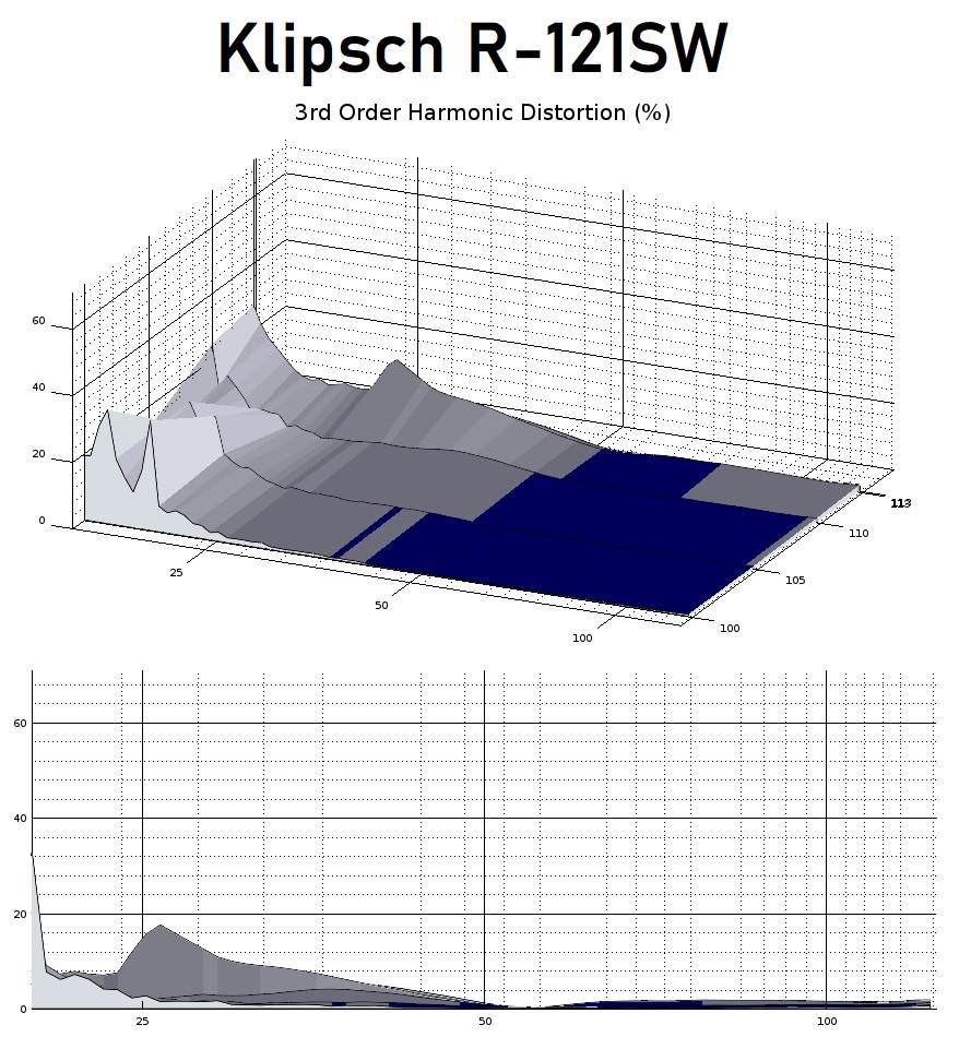

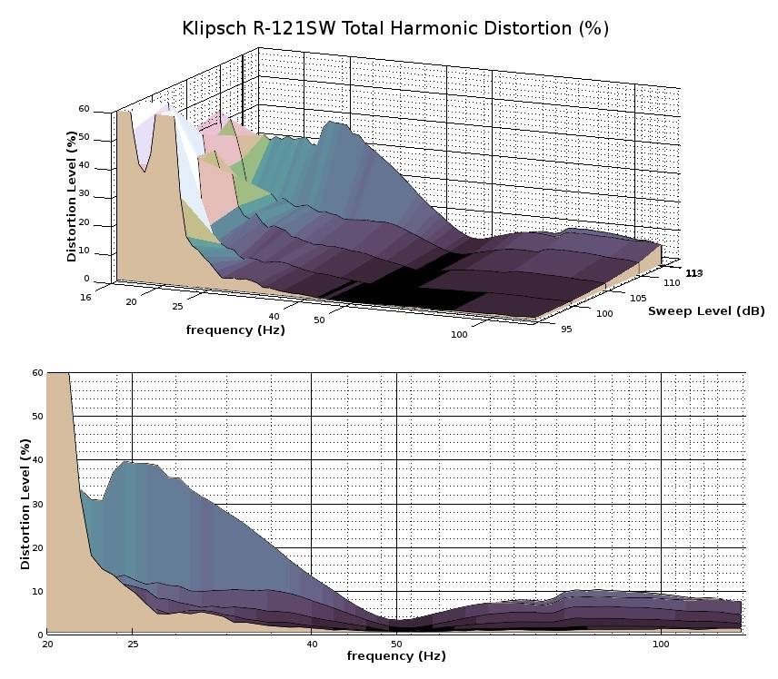

The above graphs show the corresponding total harmonic distortion to the long-term output graphs. Essentially, they depict how linear the subwoofer remains for the corresponding drive level seen in the long-term sweeps. The quantity being measured is how much of the subwoofer’s output is distortion and is shown here as a percentage. The results seen here are good for the class and pricing. Distortion stays below 10% above 45Hz even at the maximum drive level. In other words, this subwoofer has fairly clean mid-bass output even if you push it hard. At the highest drive level, meaning the last few dB that the R-121SW can produce, distortion does rise in the low end below 40Hz, but unless you push this sub to its absolute limit, it stays very well composed and largely keeps at or below 10% THD. The bass here is unexpectedly clean for a subwoofer of this size and pricing. In my outdoor testing for this sub, I noted that it was highly restricted from producing any kind of heavy distortion. It’s difficult to get this sub to make a bad noise; the rise below 40Hz is mostly comprised of the least audible distortion products and while they can be heard, they are not terribly jarring or dissonant. The driver doesn’t lose its composure, so the R-121SW is on a tight leash and cannot be over-driven.
The above graphs depict measurements of the constituent harmonics from the long-term output sweeps and are what the total harmonic distortion measurements are composed of for the 2nd and 3rd harmonics. These individual harmonics can give us a clue as to what might be the cause of some quirk or non-linearity. We are only showing the 2nd and 3rd here because they more or less reflect the higher even-order and odd-order behaviors, although higher-order harmonics tend to be much further down as a percentage of distortion compared to the second and third.

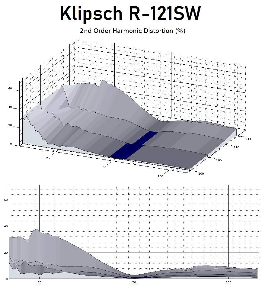

Here we can see that most of the distortion products of the R-121SW are even-order. The advantage to this is that even-order is less audible or objectionable than odd-order distortion products. The disadvantage is that it means that only one side of the driver’s motion or the signal waveform is being constricted or affected. And that means that there was probably an opportunity to iron out whatever was causing the distortion for more undistorted output. In the case of the R-121SW, I would guess that much of the even-order distortion is caused by induction effects. Induction occurs when the charged voice coil’s motion in the magnetic field creates a counter-current, but the problem is that the counter-current creates an opposing magnetic field that diminishes the initial, desired field. Induction tends to be a source of even-order distortion as well as a peakish frequency response as we see in the R-121SW. Many drivers use short-circuiting rings (often just called ‘shorting rings’) in the motor structure to address this, but it is more expensive to implement shorting rings, and I am not surprised that Klipsch decided to do without them in this lower-cost model. Shorting rings aren’t really needed for the distortion exhibited here since it is mostly at very low levels and also is of a more benign type. The rise in second-order distortion below 40Hz at the maximum drive level isn’t coming from induction but is more likely due to the moving assembly running into motor or suspension travel limits, so the inclusion of shorting rings wouldn’t help in that area. However, shorting rings would help to flatten the frequency response and increase upper-frequency sensitivity, so there are still real improvements that can be had by using them.

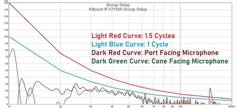

Group delay is the measurement of how much time it takes for individual frequency bands of an input signal to be produced by the speaker. It can indicate that some frequency components are developing slower than others or are taking longer to decay. It is generally thought that 1.5 sound cycles are needed for group delay to be audible at bass frequencies, although there is an argument that group delay should remain under 20ms to be completely unnoticeable, but that is likely meant for mid and upper bass frequencies.
I have included both port side and cone side measurements since I think that just posting the cone side measurements doesn’t fairly account for all of the group delay that the R-121SW is producing. In general, group delay here is fairly low, so there isn’t enough to worry about either way. With the exception of a pipe resonance at around 150Hz (which is unlikely to manifest into anything audible when using the standard 80Hz crossover frequency), group delay doesn’t surpass 1 cycle at any frequency. Normally, ported subs have a 1 cycle spike at the port tuning frequency where the port resonance lags behind the woofer output, but that isn’t seen here. One reason might be that the port seems underdamped compared to the rest of the response meaning that its output simply is not on the same level as that of the cone output, and likewise its contribution to group delay would also not be as great. Also, Klipsch could have implemented some kind of phase compensation in the DSP to keep group delay in line with that of the woofer’s output- we have seen that strategy employed by some other ported subwoofers such as Monoprice’s Monolith subs. The group delay from the R-121SW is above average, and its time-domain behavior is quite good.
