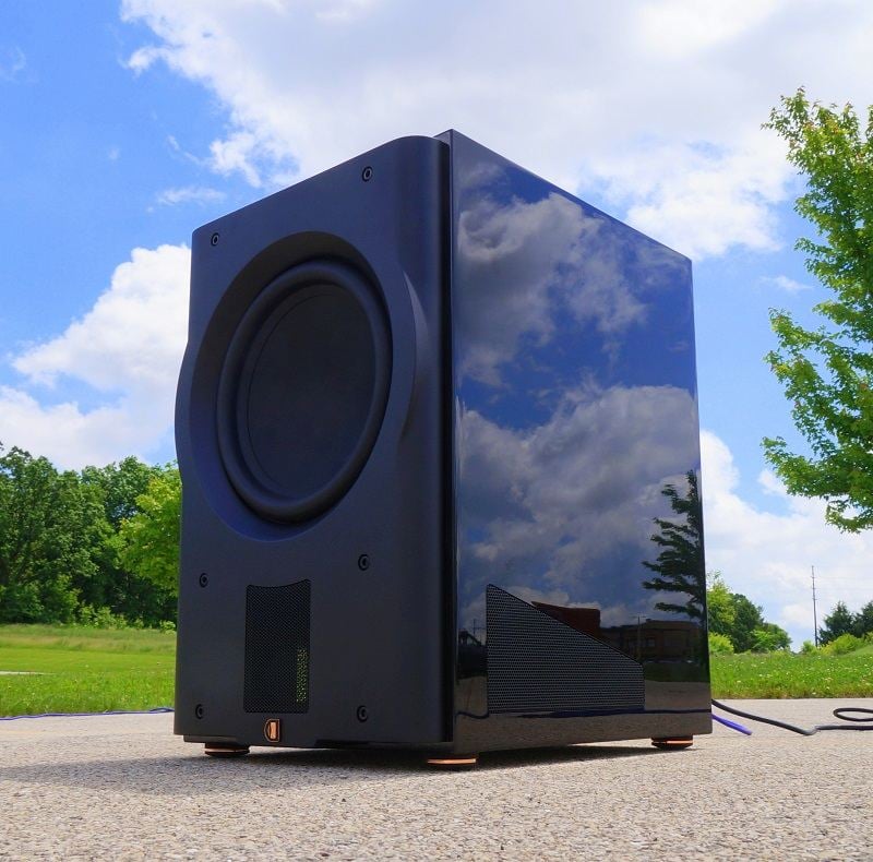

Appearance

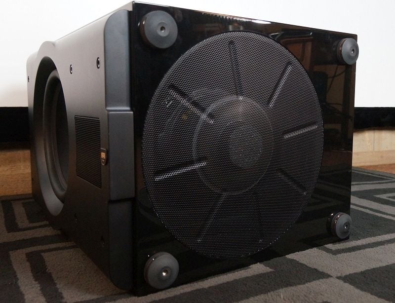

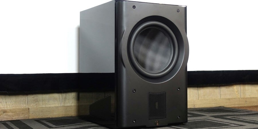

The

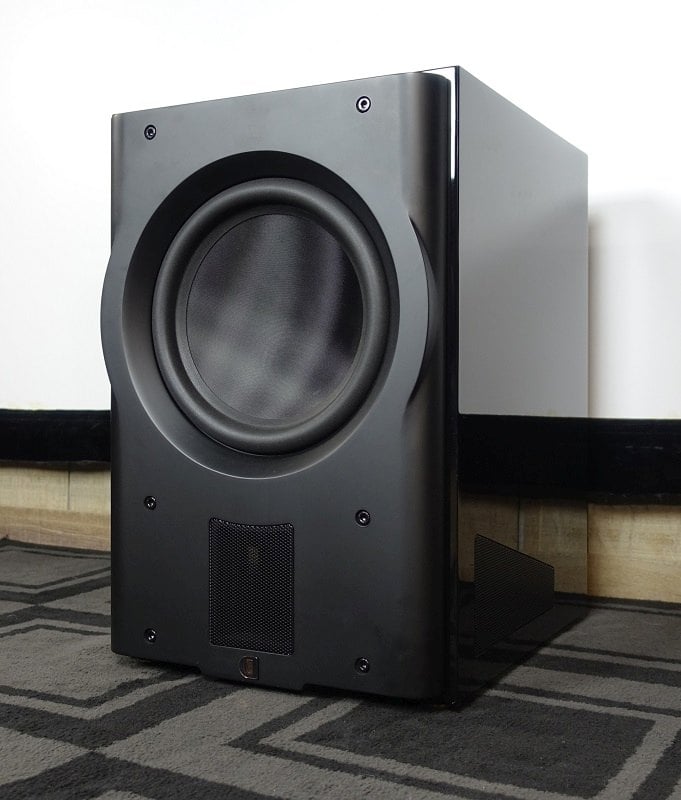

Perlisten R212s is a high-end subwoofer and it looks the role. It has a gloss
black, squared cabinet, but the front baffle is a rounded solid piece with a
premium satin black finish. The front-mounted driver is recessed fairly deep

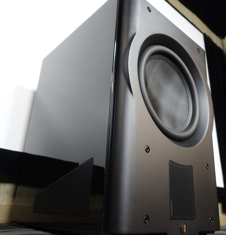

into the front, and it makes the sub look like a solid block (which it nearly
is). The other driver is mounted for a down-firing orientation and isn’t really
visible unless you look very closely since it is hidden by mesh grilles. The
R212s does not come with a grille for the front of the sub, so people who abhor
the sight of a driver cone might have to look elsewhere for their subwoofer

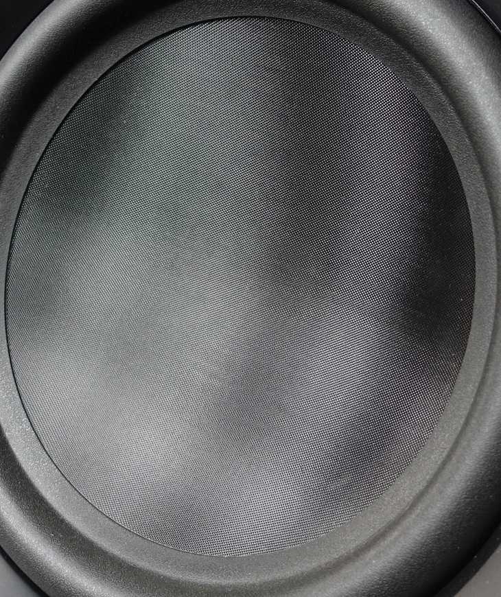

solution if they aren’t able to keep the subwoofer out of sight. The cone for
this sub looks very slick; it uses a dark grey glass-fiber weave that matches
nicely with the satin black baffle. A circular widening of the front baffle
around the cone is a stylistic touch that gives the sub a bit of flair. The amp
plate has a black brushed aluminum surface that looks nicer than most. It is
not a small subwoofer, but it isn’t huge, so while it won’t disappear in a
room, it won’t dominate it either. A touchscreen on the top front of the sub
adds a futuristic touch that gives the R212s a modernist aesthetic. It’s a sub
that is more stylized than the normal black boxes that most subs look like.
That may or may not be an attribute that some buyers are interested in, but I
think it looks pretty darn cool.

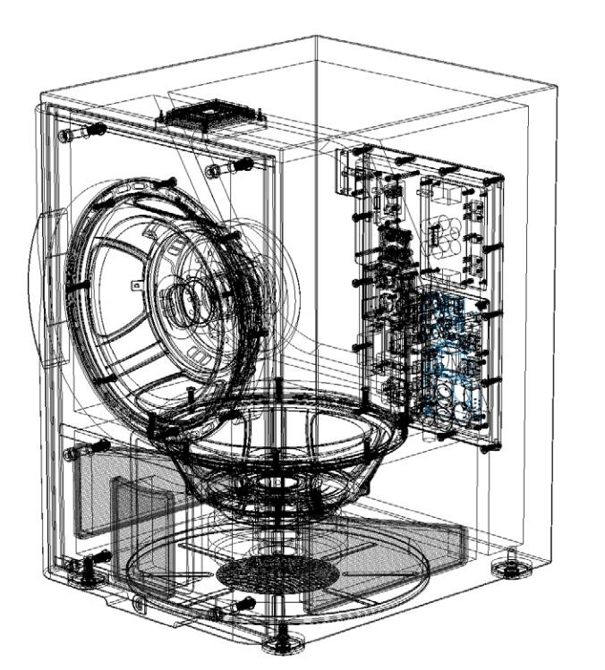

The R212s is not an ordinary subwoofer design. It is much like a scaled-down version of the D215s, so I will be quoting from the design description of that review generously. A basic single-sentence description of the R212s would be that it is a dual 12” driver sealed push-pull design. One of the most distinguishing elements of this subwoofer is the push-pull aspect, but what is that? This is a sealed dual-driver configuration where one driver is mounted with the cone facing outward and the other with the cone facing inward. The drivers are then wired in opposite phase of each other. So the cones of both drivers are moving inward and outward at the same time with respect to the cabinet, although they are moving inward and outward in opposite phase with respect to each other.
The advantage of the push-pull design is that the non-linear motion that only occurs in one way of travel is mitigated by the other driver since motion is restricted by the increase in air pressure by the inward motion of each cone. In other words, the cones are coupled together by the constant level of air pressure inside the sealed cavity, so the motion of one of the cones in one direction is always modulated by the other cone’s opposite direction of travel. If the cone has uneven excursion with respect to inward and outward oscillation (as all drivers do to some extent), that is balanced out by the interior air pressure change created by the opposite motion by the other driver. This reduces even-order harmonic distortions which are created by nonlinear motion in just one direction of the cone’s travel, and Perlisten claims a 10-12dB level of distortion reduction.
The drivers that Perlisten uses are humdingers. They have a glass fiber composite cone that is very stiff yet very light. The cone is connected to the frame via a beefy half-roll surround and multi-layer Nomex spider. Perlisten’s progressive suspension design is among the most sophisticated in the industry. Inner corrugations of the spider have a different thickness that enables a farther linear travel than one uniform piece of Nomex.
The basket is a formidable cast aluminum
piece that allows venting underneath the spider. The motor uses an enormous
double-stacked magnet that has been massively saturated for an enormous level
of magnetic flux. There are multiple aluminum shorting rings installed in the
motor to reduce the effects of inductance that should help to give the driver
more mid-bass sensitivity and less harmonic distortion. The voice coil is made
from aluminum as opposed to copper or copper-clad
aluminum. That might seem slightly counter-intuitive for a high-end design
seeing as how copper is more conductive, but that extra electrical resistance
can be made up by simply using a larger gauge wire, and the larger gauge wire
has the added benefit of being better for thermal dispersion since it has a lot
more surface area from which to radiate heat. Moreover, even with the larger
gauge wire, it is still lighter than copper, so using aluminum reduces moving
mass, thereby making the driver more sensitive. Perlisten specs this driver as
having a 20mm one-way linear travel which is a lot for a 12” driver but
believable given the build seen here. The driver as a whole is a heavy-duty
affair much like we have come to expect from Perlisten.

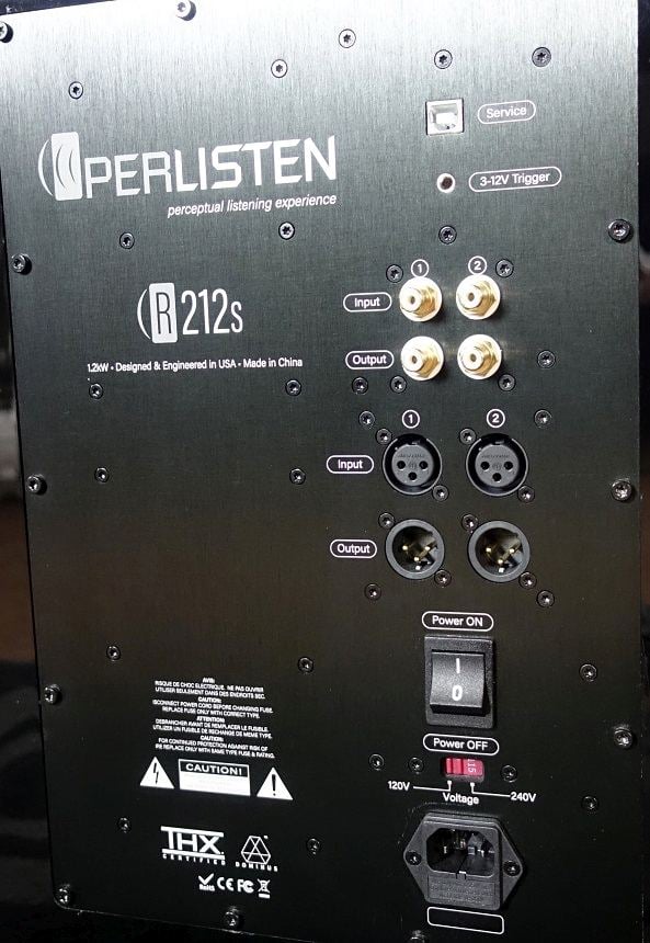

The amplifier is a 1.3kW RMS class-D design with some very sophisticated processing onboard. Processing is handled by a 32-bit ARM M4 Cortex processor and a 48-bit data path DSP which sounds like overkill for subwoofer range frequencies. The ARM Cortex Processor analyzes and adjusts the system performance at every millisecond to maintain sound quality and safe operating ranges. It can safely adjust itself to handle irregularities in the AC as well as high temperatures without needing to go into full shutdown. Many other aspects of system operation are monitored in real-time such as power supply output and current, amplifier temperature, power supply temperature, output voltage and current, short circuit faults, DC offsets, and AC undervoltage/overvoltage. In this regard, it has to have one of the most advanced amplifiers on any subwoofer at any price.

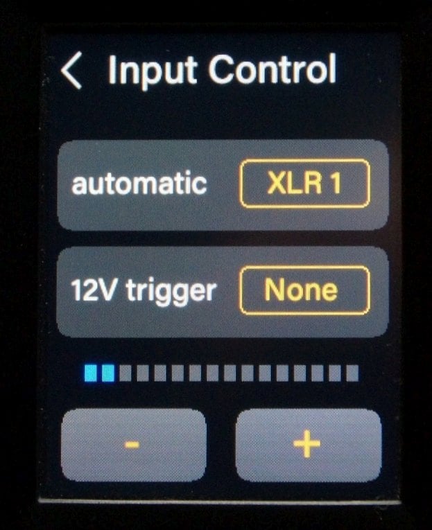

There are no controls on the back panel, and controlling the sub is done through a 2.4” LCD color touchscreen mounted on the top front of the enclosure, so it is much easier to adjust than fiddling with knobs on the back panel. The R212s can also be controlled through Perlisten’s subwoofer control app for those with iOS and Andriod OSs. Naturally, with such a powerful processor, many aspects of operation can be fine-tuned to the nth degree. Among parameters that can be controlled, the user has access to a 10-band parametric equalizer, a 0-270 degree variable phase, a 40Hz test tone generator, independent gain and wake-up controls for each of the sub’s four inputs, time delay, low-pass filtering from 30Hz to 160Hz at 6,12, 18, or 24dB octave slopes, and different operating modes for small rooms, large rooms, and THX mode. There are four inputs mirrored by four of the same style outputs: two unbalanced RCAs and two balanced XLRs. The sub can be hooked up and shared with multiple systems since the inputs can all be independently controlled. What is more, the volume controls on the R212s can control groupings of Perlisten subs, so if you have a multi-sub system of up to eight subs, you can use the controls to attenuate the entire system rather than having to change the gain on every single unit.

The enclosure is a very stout one made from high-density fiberboard rather than the conventional MDF. It uses 1” paneling for the main body of the enclosure and has a diagonal windowpane brace inside. It has a 2” thick curved front baffle piece mounted on the main cabinet for a tremendous 3” thick total front paneling. The interior space of the sealed compartment is likely smaller than it looks from the outside since it must have a good amount of elevation to give clearance to the lower driver motor. It isn’t a whole lot of interior space, but it doesn’t need it since the driver motors are so powerful. The feet are some broad rubber cones that have a polished copper trim ring.

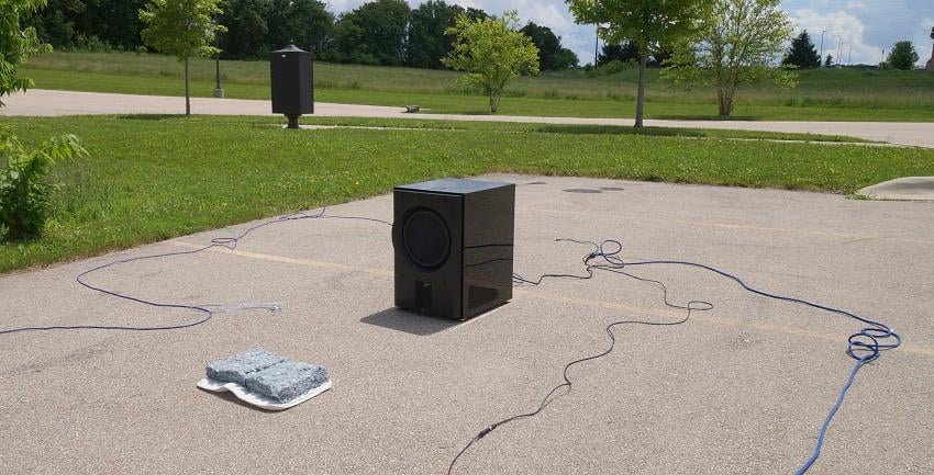

Testing on the Perlisten R212s was conducted with the microphone facing the woofer at a 1-meter distance with measurements scaled back to a 2-meter distance by subtracting 6dB. The temperature was recorded at 55F degrees with 70% humidity. The subwoofer’s gain was set to maximum, phase was set to zero, and the low pass filters were set to bypass.

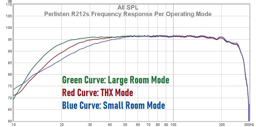

The above graph shows the measured frequency responses for the Perlisten R212s subwoofer per its operating modes. All the responses display a beautifully linear response all the way up to 200Hz with the low-end roll-off being the distinguishing factor between them. The “Small Room” mode rolls off at a higher frequency but at a more gradual slope that should make it a better fit in rooms with lots of low-frequency gain - these rooms tend to be small hence the name for the mode. The “Large Room” mode is for rooms that do not net much low-frequency gain. My own room does not get much gain, so this is the mode that I used for my own listening. This response is much like what would be expected from ported subwoofers: flat down to a low frequency followed by a steep drop-off. This mode holds a remarkably flat response that I might characterize as a +/-1dB window from 25Hz to 200Hz. The 200Hz upper end is great for those who want to experiment with higher crossover frequencies, and some people get better results than the standard 80Hz crossover. The THX mode follows a target curve mandated by THX, and I suppose it factors in some room gain, but THX has always been tight-lipped about their performance targets. Altogether, this measurement shows the R212s to be an extremely accurate subwoofer with respect to tonality.

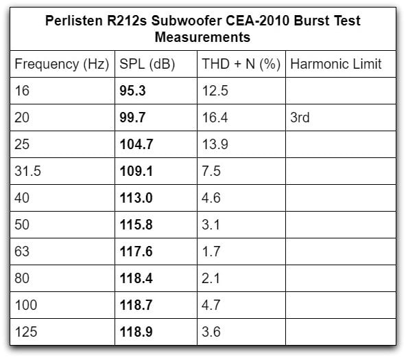

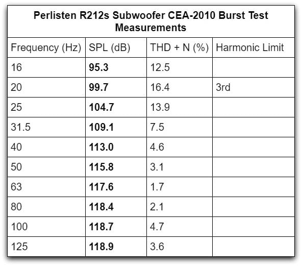

The above CEA-2010 measurements are
short-term bursts that show the subwoofer’s clean peak SPL before heavy
distortion sets in. Our measurements have been referenced to 2-meter RMS, which
is 9dB down from the standard requirement for the measurements to be shown at
1-meter peak. However most publicly available CEA-2010 measurements are shown
at 2-meter RMS, so we followed that convention. The results displayed here from
the R212s are very good and show this sub to be tremendously powerful. These
are what I might expect to see from a ported 15”. A sealed sub that can nearly
hit 100dB at 20Hz in this measurement set is a rare thing and prove that the
R212s has an enormous amount of displacement on tap. But it’s not just raw
displacement; it is linear, low-distortion displacement where the output does
not deviate much from the input signal. It is only at 20Hz where the R212s can
be made to surpass the distortion threshold for the CEA-2010 test, and even
then only just barely. This sub cannot be pushed into heavy distortion, period.
The THD percentages shown here are as distorted as the R212s can possibly get
from being pushed as hard as possible. It does not lose its composure no matter
what. Most of these measured distortion results would be totally inaudible. At
the worst of 16% THD at 20Hz, you would need to be listening for it in a pure
tone signal, and even then its audibility would be questionable. Much like we
saw with the D215s, Perlisten subs only produce very clean bass. While the
R212s could not be stressed hard, it isn’t able to generate enough deep bass
output to meet our Bassaholics “Extreme” Room Rating and so it gets a “Large”

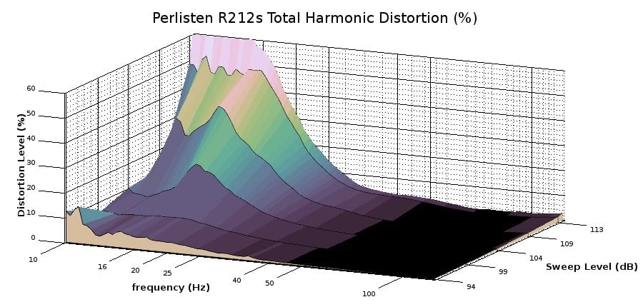

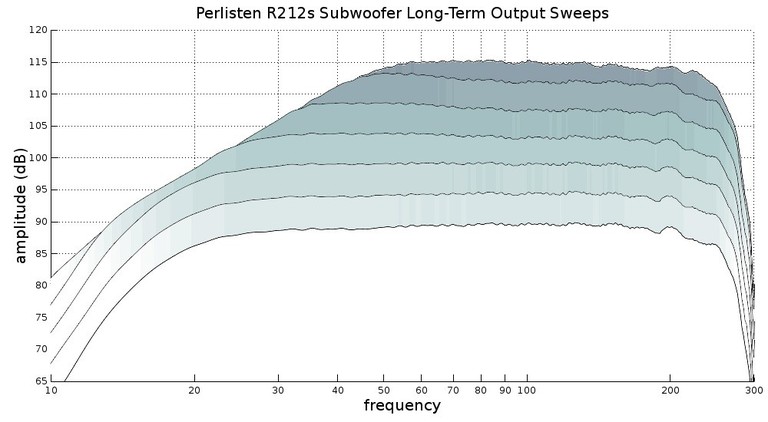

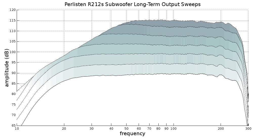

Testing for long-term output compression was done by first conducting a 20-second sweep tone where 50Hz hit 90 dB with the subwoofer 2 meters from the microphone. We then conduct further 20-second sweeps by raising the gain by 5dB until no more output could be wrung out of the subwoofer. These tests show us the long-term continuous headroom that the subwoofer is capable of. These tests were done with the R212s in its “Large Room” mode. The R212s holds its “Large Room” response shape up until the 100dB sweep where it starts to compress the response. Above that, higher drive levels squeeze out the EQ’d low-end until we can see its native sealed response. The highest drive level here very much resembles the “Small Room” mode response, and so if we had conducted this test in the “Small Room” mode setting, there would scarcely have been any change in the response shape from the lowest drive level to the highest. Again, the overall output levels depicted here show that the R212s is a very powerful subwoofer. It has a lot of deep bass output for a sealed subwoofer, but its mid-bass output is particularly potent with the ability to produce a continuous 115dB from 50Hz to 200Hz. For those who plan on getting a multiple sub system using R212s subs, they try much higher crossover frequencies than normal to take advantage of this level of headroom, since most speakers would not be capable of that kind of mid-bass output, even if they were connected to monster amps.

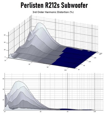

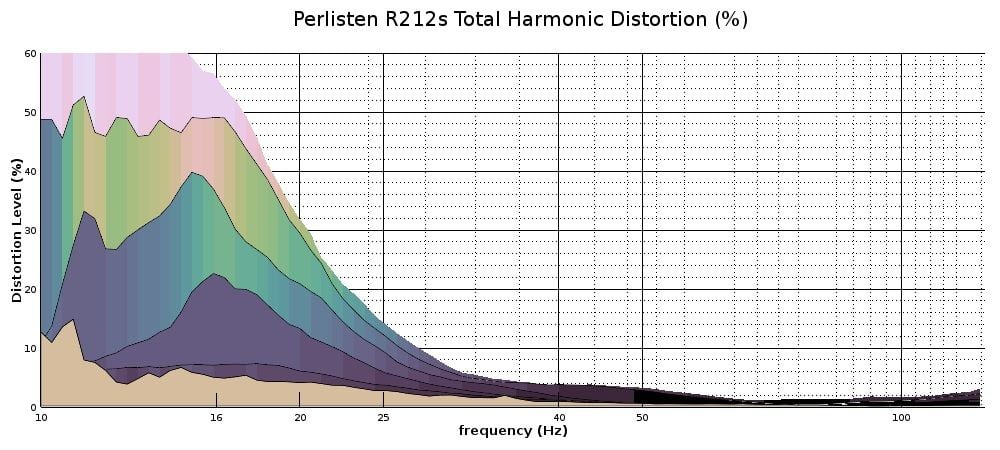

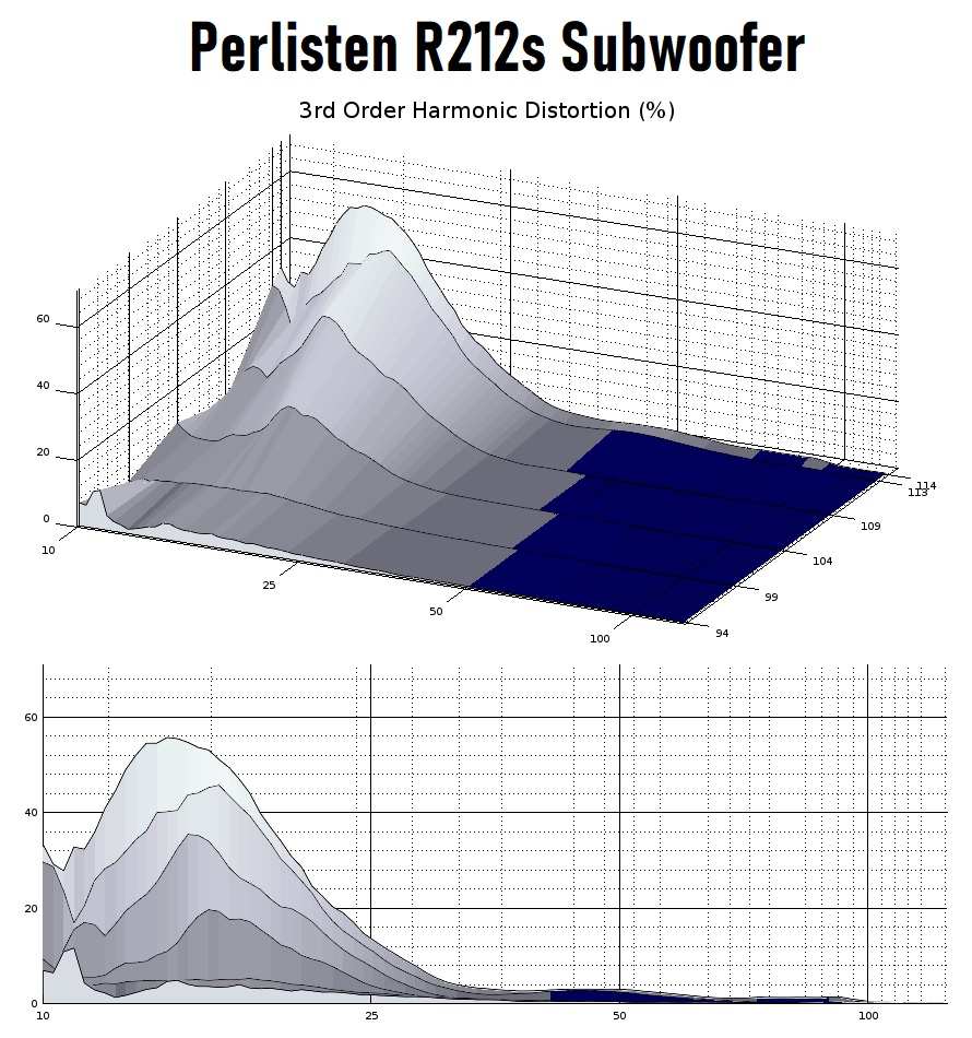

The above graphs show the corresponding total harmonic distortion to the long-term output graphs. Essentially, they depict how linear the subwoofer remains for the corresponding drive level seen in the long-term sweeps. The quantity being measured is how much of the subwoofer’s output is distortion and is shown here as a percentage. While the R212s can be pushed into some higher distortion levels in deep bass at a continuous drive level, it should be remembered that the rate at which distortion is rising here almost mirrors the rate at which the output is dropping off. It should also be noted that room gain traditionally shores up the fundamentals rather than harmonics, so room gain can act as a distortion reduction mechanism itself. Distortion only started to creep up at the 105dB sweep where it hits 20% THD at 16Hz. Pushing it harder than that does incur greater levels of distortion, but now we are nearing the maximum output that the R212s can generate. The lowest drive level shown here of the 95dB sweep keeps distortion down roughly below 5% from 16Hz and above. 95dB is pretty loud so it’s difficult to call that a nominal drive level. At nominal drive levels of 90dB and lower, the background noise of the testing site constituted a significant fraction of the measured distortion percentage, even though I had been testing in a relatively quiet environment, so I did not include those results. That means that the distortion produced by the R212s was so low that it could not be measured over the whisper of the background noise from the environment. That is extremely low distortion. Indeed, at nominal drive levels of 90dB or less, the R212s does not even come close to 1% THD above 40Hz. The drivers that Perlisten uses are pretty much marvels of modern engineering.

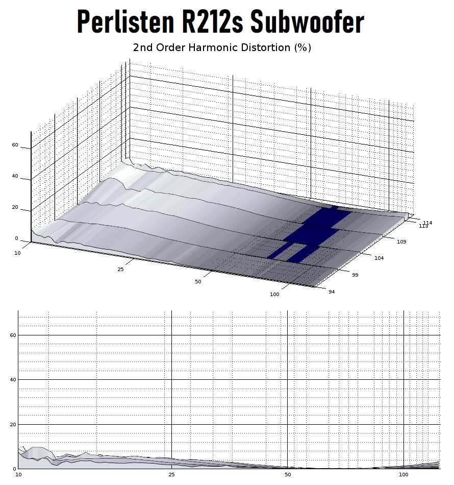

The above graphs depict measurements of the constituent harmonics from the long-term output sweeps and are what the total harmonic distortion measurements are composed of for the 2nd and 3rd harmonics. These individual harmonics can give us a clue as to what might be the cause of some quirk or non-linearity. We are only showing the 2nd and 3rd here because they more or less reflect the higher even-order and odd-order behaviors, although higher-order harmonics tend to be much further down as a percentage of distortion compared to the second and third.
Perlisten’s push-pull design claims to significantly reduce even-order distortion products, and the above graphs are very much evidence of that. The vast majority of distortion products stem from odd-order harmonics. There are very few even order distortion products. That is what would be expected from a push-pull design where that arrangement corrects for non-linearities that occur on only one side of the cone’s travel. It can’t help odd-order distortion where the non-linearity affects both sides of the cone’s travel. My guess is that there were probably not many even-order distortion products that the push-pull design could have corrected for to begin with. These drivers are so well-engineered that they have done quite a bit to reduce even-order distortion at the start such as the use of multiple shorting rings. There is also evidence of optimization where the drivers are striving for the highest possible linear throw, so any problems that occur on a single side of travel are ironed out, and odd-order distortion is all that remains because that is unavoidable as the moving assembly reaches its limits. I think that the push-pull design decision to knock out more even-order distortion is just icing on the cake.

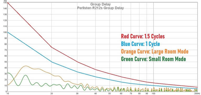

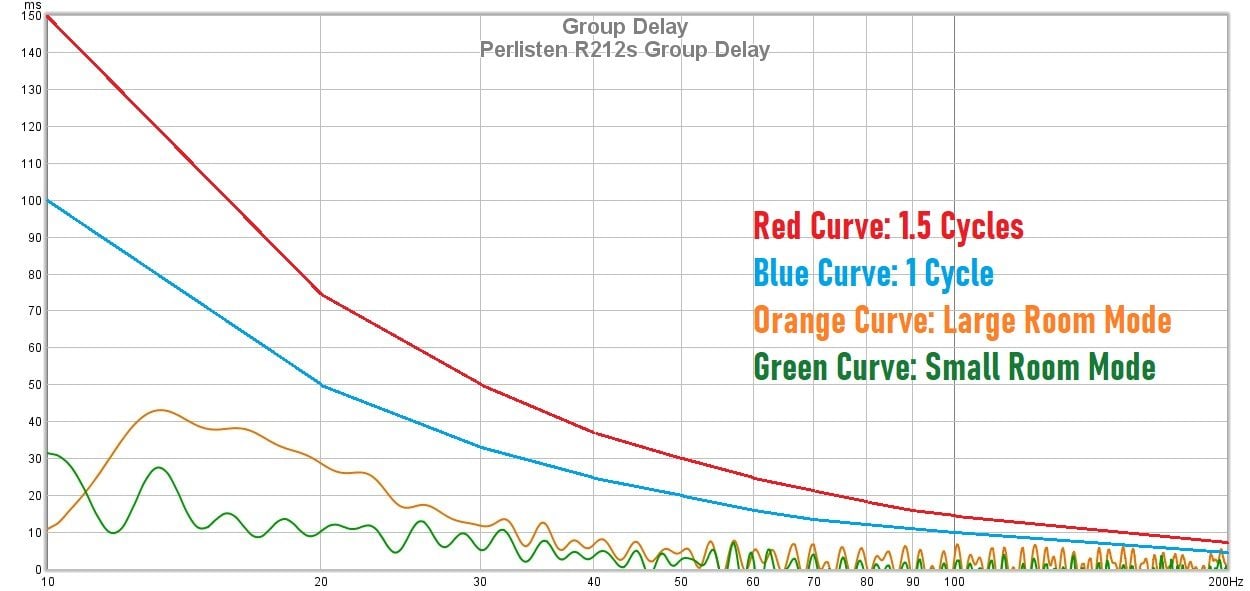

Group delay is the measurement of how much time it takes for individual frequency bands of an input signal to be produced by the speaker. It can indicate that some frequency components are developing slower than others or are taking longer to decay. It is generally thought that 1.5 sound cycles are needed for group delay to be audible at bass frequencies, although there is an argument that group delay should remain under 20ms to be completely unnoticeable, but that is likely meant for mid and upper bass frequencies.
The R212s posts some outstanding results in these group delay measurements for either mode. To keep the graph uncluttered, we left out group delay for the THX mode, but its delay is pretty much smack dab between the “Large Room” mode and “Small Room” mode in level. The “Large Room” mode does show a bit more group delay than the “Small Room” mode, and that is not surprising since it EQs the response more. Nonetheless, even the “Large Room” mode keeps group delay well below anything that would be close to audible. The “Small Room” mode group delay is so low that it looks like hardly any equalization or filters were used. It achieves one of the lowest group delay measurements that we have yet seen. For the mid-bass frequency band, where low group delay is most important, the R212s keeps delay under 5ms. For deep bass between 20Hz and 50Hz, delay averages between 10ms and 5ms. The time-domain performance shown here is phenomenal.
