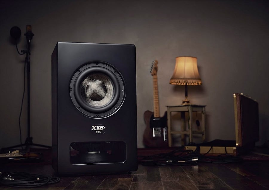

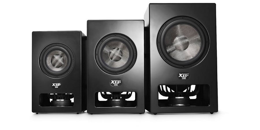

M&K Sound is launching a major new refresh of their celebrated X series called the X+. The original X series was launched in 2013, and although it had found a home in the recording studios of many major producers, technology had advanced considerably since its inception. The X+ series takes advantage of many of the new advances of modern subwoofer technology while still retaining the distinctive push-pull design of the original. The X+ also pushes the woofer sizes up a notch and deletes the dual-8” cone model while adding a dual-15”! The line-up now consists of the X10+ that has dual 10” woofers, the X12+ that has two 12”s, and the X15+ with its dual 15” cones.

Among the design innovations M&K implemented in their new X+ series, the drivers get a major makeover with a longer linear excursion along with 30% more voice coil for higher power handling. The drivers need improved power-handling since the amplifiers have all been beefed up considerably with a large increase in power. This increase comes courtesy of some class-D ICE amps which provide some of the most efficient power delivery among modern amplifiers. The drivers have carbon-fiber cones for a rigid yet light transducer that also looks pretty slick. It uses some extended aluminum shorting rings that M&K calls the “Distortion Killer Shorting Rings.” That should go a long way into reducing even-order harmonic distortions. Further distortion-reducing measures include increased venting at the woofers to mitigate distortion due to air turbulence.
Mood M&K X series subwoofer image
One thing that has not changed from the original design is M&K’s distinctive push-pull driver mounting system. This is a sealed dual-driver configuration where one driver is mounted with the cone facing outward and the other with the cone facing inward. The drivers are then wired in the opposite phase of each other. So the cones of both drivers are moving inward and outward at the same time with respect to the cabinet, although they are moving inward and outward in opposite phase with respect to each other. The advantage of this is that the non-linear motion that only occurs in one way of travel is mitigated by the other driver since motion is restricted by the increase in air pressure by the inward motion of each cone. In other words, the cones are coupled together by the constant level of air pressure inside the sealed cavity, so the motion of one of the cones in one direction is always modulated by the other cone’s opposite direction of travel. If the cone has uneven excursion with respect to inward and outward oscillation (as all drivers do to some extent), that is balanced out by the interior air pressure change created by the opposite motion by the other driver. This reduces even-order harmonic distortions which are created by nonlinear motion in just one direction of the cone’s travel.
