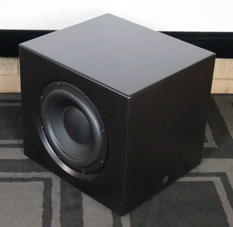

10d amp angle 1For our recent review of Sigberg Audio’s SBS.1 active speakers, Sigberg sent us their 10D subwoofer to complement the speakers since they needed a subwoofer to play full range, and the 10D is made to be easy to set up with the SBS.1 speakers. However, the 10D subwoofer is made to be more than just an accessory to the SBS.1 speakers. It has the design, functionality, and performance of a very serious audio product, and it warrants a close look in its own right. That is why we are going to take an in-depth look at it in today’s review. It is a smaller, pricey subwoofer, and there isn’t anything else on the market quite like it. Like the SBS.1 speakers, Sigberg made an audio product with a reasonable size that was uncompromised in every other regard. It uses high-end components in a high-end design and is built in Norway, and it looks (and costs) the part. The question that we have to ask now is how good can a small subwoofer get when it’s chocked full of the highest performing components currently available? And is it worth the $3.7k asking price (pricing is currently pinned on the Norwegian Krone, so dollar and Euro pricing may fluctuate a bit)? Let’s dig in to find out…
Packing and Appearance

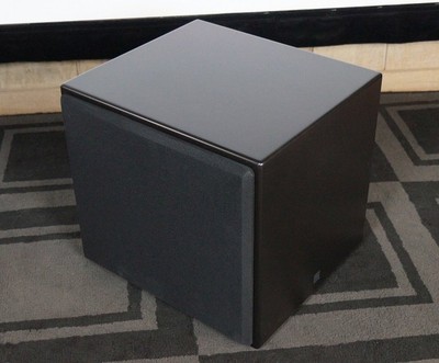

10d grille  10d above4

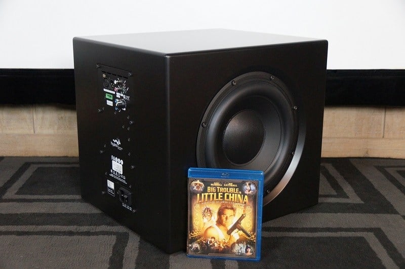

The 10D arrived in a heavy-duty cardboard box with some dense polyurethane foam packing. That should be adequate to protect it for routine shipping practices, but I think it could benefit from double boxing and another layer of foam in case shipping transit gets rough. Once unpacked, the 10D is revealed to be an understated yet attractive subwoofer. All the edges are rounded, and it has a fine satin black finish. Apart from the side-mounted drivers, the only detailed feature is the Sigberg emblem on the lower front of the unit. Its minimalism gives it an air of seriousness, but the rounded edges soften that a bit. That minimalism could have been emphasized a bit more if the drivers had trim rings around the frame, and if the cones had used inverted dustcaps, but those who want minimalist as possible will probably just use the grilles which hide the drivers altogether. They use magnetic grille guides so the side panels are that much cleaner looking. The feet are spherical and aren’t really visible when the sub is resting on them. There isn’t a whole lot more to say about the appearance of something with such a simple industrial design. It is classy-looking without being flashy or ostentatious.

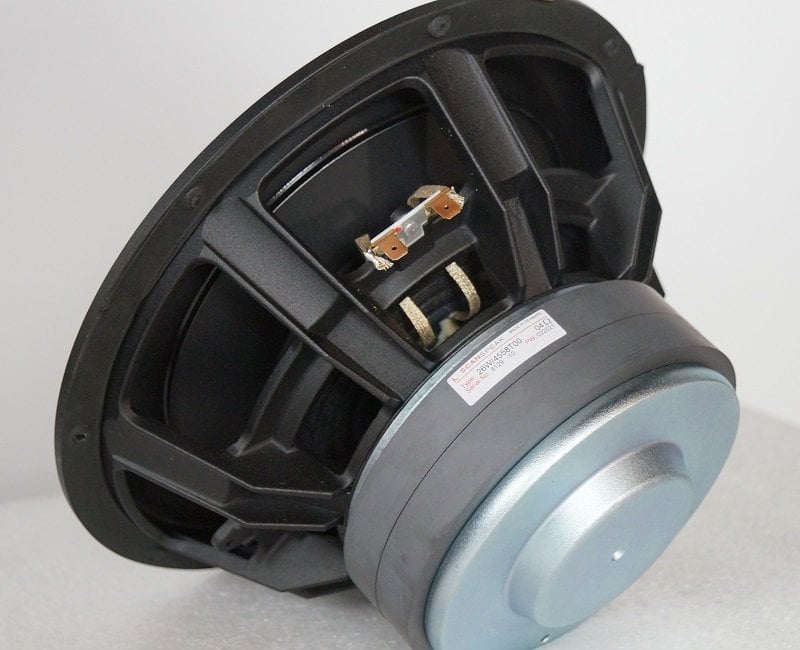

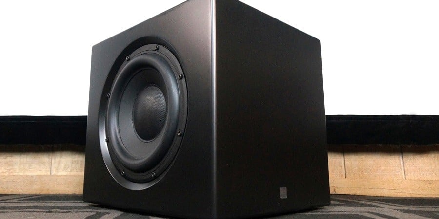

10d driver motorThe basic design of the Sigberg Audio 10D Subwoofer is a sealed sub with two dual-opposed mounted drivers and is powered by a 500-watt RMS Class-D amplifier. There is, of course, much more to it than that, so let’s dig into some of the details, and let’s start with the driver. Sigberg uses a Scan-Speak driver from the Discovery line, which is a known quantity among speaker designers for its wide bandwidth and linearity. It’s a driver befitting of a high-end subwoofer. It has 1” of linear travel, peak-to-peak, and over 2” of total peak-to-peak excursion, which is quite a bit for a 10” woofer. Two 10” woofers have about the same surface area as a 14” cone, so this subwoofer could be considered the equal of a sealed 14”, everything else being equal. However, everything else is not equal, since few 14” drivers would have anything like the combined motor properties of these two 10’s. One nice thing about splitting the displacement of a subwoofer among multiple drivers is that sensitivity can be retained and inductance can be lowered since there isn’t a whole lot of coil stuffed into a single motor. That means the moving assembly weighs less, thereby increasing sensitivity, and not as much moving copper in the gap will produce less inductance, thereby flattening the response as well as reducing even-order distortion.

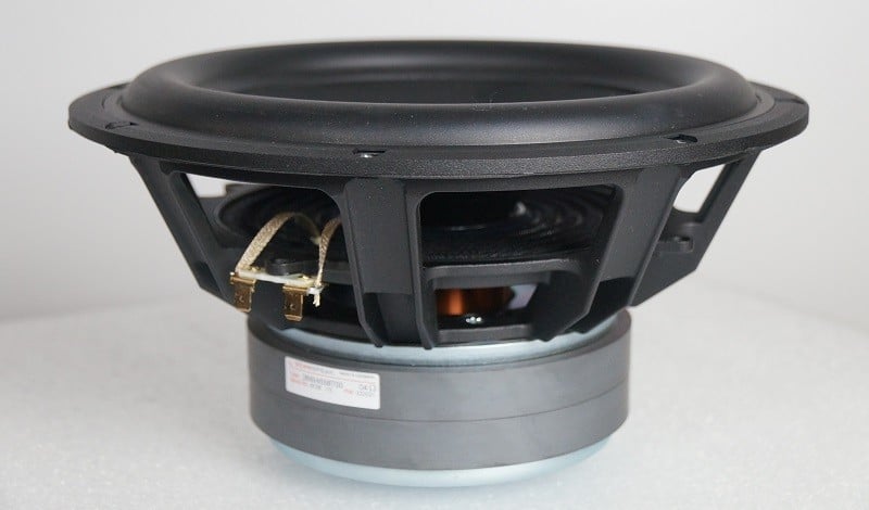

10d driver
The cone itself is made from aluminum and has a large glass fiber dustcap. Aluminum is a bit heavier than some alternative cone materials that could have been used, but it does have the added benefit of serving as a good heatsink. It attaches to the basket via a thin and light NBR half-roll surround that should provide a lot of travel before any serious tension sets in. The basket itself is a heavy-duty cast-aluminum piece that definitely will not flex in the slightest against anything the moving assembly could do. The motor uses a stack of two magnets for a combined thickness of 1 ⅜” with a 5 ¾” diameter, although those figures aren’t all that meaningful without knowing the magnetic flux they produce in the gap. I would guess they would provide a great deal of force, since this driver doesn’t appear to be using a huge coil to drive the moving assembly and would therefore be relying more on the magnets to provide force. Again, this is another good strategy to reduce inductance. The motor uses a 2” diameter voice coil around a titanium former. The heat conductivity of titanium isn’t very good, but it is light and is only weakly magnetic so it won’t interfere with the magnetic field of the motor very much. Venting of the motor is done in the basket under the spider. The backplate is slightly bumped out to allow for greater excursion without hard bottoming of the former.

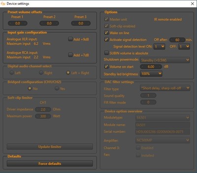

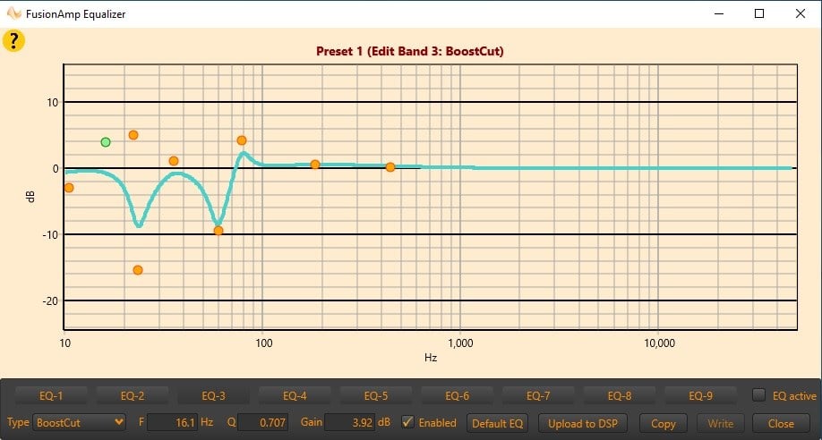

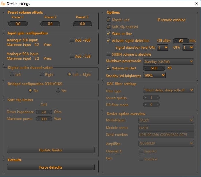

Hypex top screen  Hypex device settings

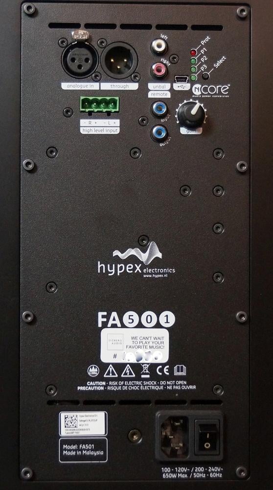

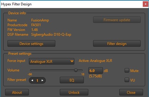

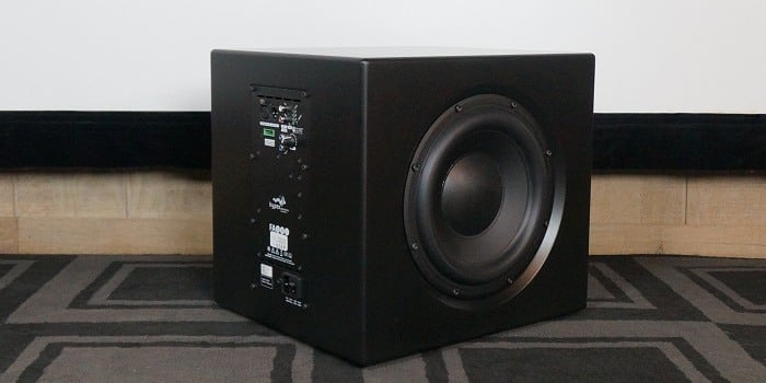

10d plate ampTo power the drivers, Sigberg has chosen Hypex’s FA501 amplifier, again using the acclaimed nCore modules much like Sigberg’s other offerings. This state-of-the-art Class-D amp provides 500W RMS of power with extremely low distortion and noise with linearity metrics that are much better than subwoofers could probably ever benefit from. The drivers are wired in a parallel circuit with the amp, and that might seem like a heavy load with two 4-ohm drivers, but the amp has been verified to be stable with the 10D’s electrical load. The drivers are given as much power as they can handle, and the limiters set by Sigberg ensure that they won’t beat themselves to death from over-excursion or melt from thermal overdriving as well.
The amp has a balanced XLR input and throughput, as well as left and right RCA inputs. There are also high-level inputs for those who want to connect it to a system via speaker wire. The amp also has a USB input with which its DSP functions can be accessed from a Windows PC, and Sigberg provides the USB Mini-B cable with which to connect the sub to the PC. There are three preset configurations that can be accessed from the amp controls: Preset 1 removes the low-pass filter so the sub can be used with external bass management. Preset 2 sets the sub up to be used with the Sigberg Audio SBS.1 speakers by lowpass filtering the subwoofer at 100Hz. Preset 3 lowpass filters the sub at 40Hz and is intended to simply shore up the lowest octave in systems that have no bass management. Included in the software is a 9-band parametric EQ, so the inevitable deformation that in-room acoustics does to the response can compensated for to a pretty fine degree. Of course, it is always good practice to address peaks with equalization and dips with placement, and, if it can be accommodated, a multi-sub system. Other aspects of the sub that can be adjusted are individual input gain, input level for wake-up, time to enter standby after no signal detection, LED brightness, among others.
 Hypex EQ

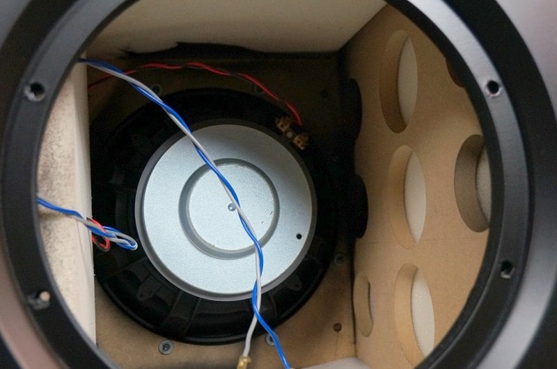

10d internalThe MDF enclosure is a fairly beefy one with the drivers being mounted on panels that are approximately 1 ¼” thick. Running parallel to the drivers are two full-length braces with large holes. There is a soft, rubbery foam lining the side walls for damping. The feet, as previously mentioned, are rubber half-spheres that give the sub a reasonable level of clearance. They aren’t hard rubber so they won’t scratch any hard flooring, and they are probably well-damped enough to absorb what little cabinet vibration might occur. With a dual-opposed driver orientation, the moving force that each driver imparts on the enclosure is canceled out by the opposite driver, and this prevents the drivers from transferring any rocking motion on the cabinet. That, combined with the heavy internal bracing, means that the 10D cabinet should be solid as a rock at every drive level. This level of build quality should be expected at this price point, and Sigberg delivers it. It can be felt in the 60 lbs. weight, a considerable amount of heft for such a small sub.
Looking at the overall design, as with the SBS.1 speakers, the 10D sub uses some of the very best components available, which is quite impressive. That is reflected in its price. Its design suggests a vehicle that is trying to produce an exceptionally high-fidelity sound from a modestly sized subwoofer. The ingredients are all present to do that, but how does it sound in practice? Let’s do some actual listening to see what all this technology and design amounts to…

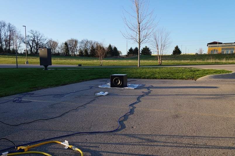

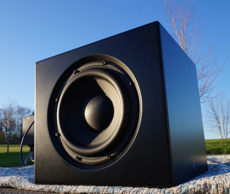

10D outdoor testing

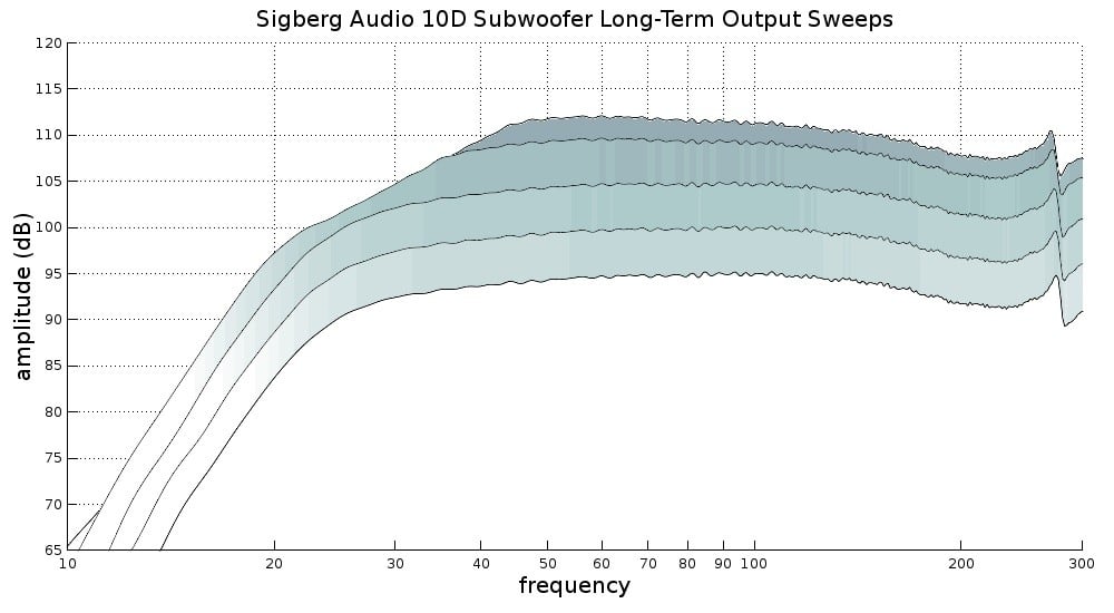

Testing on the Sigberg Audio 10D was conducted with the microphone facing the woofer at a 1-meter distance and then scaled back to 2-meters in our graphs by subtracting 6dB in output. The temperature was recorded at 49F degrees with 70% humidity. The subwoofer’s gain was set to maximum and the low pass filters were left off.

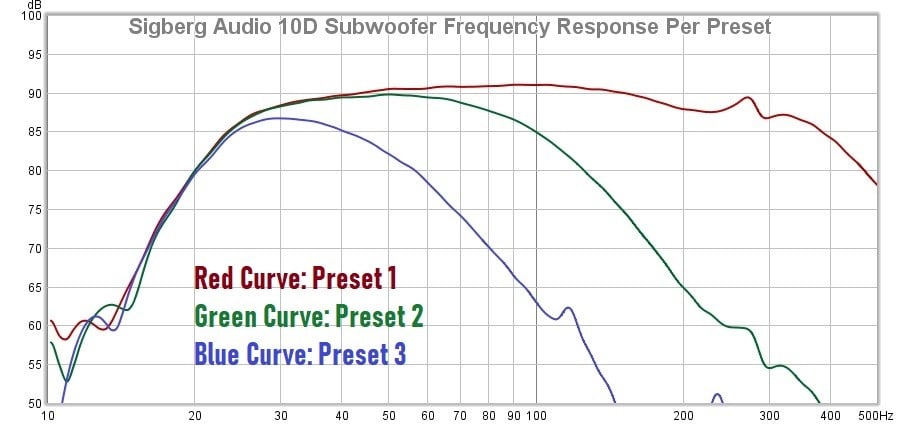

10d freq response
The Sigberg 10D measured like a much bigger high powered sub easily meeting our Medium Bassaholic room size rating.

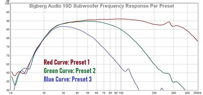

The above graph shows the measured frequency responses for the Sigberg Audio 10D subwoofer per its individual presets. Preset 1 is what most people will use, and this gets us a strong, flat response from 25Hz all the way to 400Hz. We can see here just how wideband these drivers are. The 10D has a very neutral response. We can see that the 10D uses high-pass filters to protect the low-end since the low-frequency roll-off does not have the standard 12dB/octave slope that a basic sealed subwoofer would have. Preset 2 has an upper-end gradual off that intends for it to blend in with the Sigberg Audio SBS.1 speakers.  As was mentioned before, Preset 3 is intended to simply shore up the deep end of loudspeakers in systems that do not have any kind of bass management at all like older style integrated amps. Many loudspeakers roll off the low-end response at around 40Hz to 50Hz, so preset 3 can get such a system some deeper bass without adding too much extra bass on top of the main speakers. I don’t expect that many people will use this sub in such a manner though.

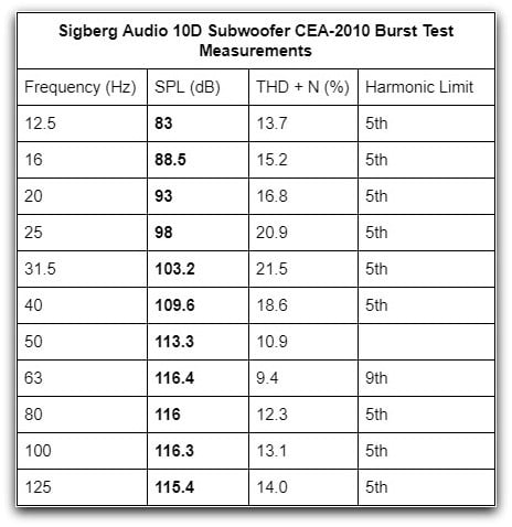

10D CEA-2010 table
Bassaholic mediumThe above CEA-2010 measurements are short-term bursts that show the subwoofer’s clean peak SPL before heavy distortion sets in. Our measurements have been referenced to 2-meter RMS, which is 9dB down from the standard requirement for the measurements to be shown at 1-meter peak. However most publicly available CEA-2010 measurements are shown at 2-meter RMS, so we followed that convention. This is a strong measurement set for such a small sub. It’s the kind of measurements I would expect from a high-powered sealed 12”. The mid-bass output matches some of the 15” subs that we have reviewed in the past and blows away all of the 12”s. It’s no wonder that the 10D proved to be so powerful on music tracks. This thing is a little beast! These burst-test numbers net it the Audioholics’ Bassaholics ‘Medium’ Room Size Rating which almost but not quite gets the ‘Large’ room rating, although if you are listening to acoustic music, this sub, with 116dB in the mid-bass range, could probably handle a large room by itself.
This little sub is a beast!
One thing to note is that the sub is distortion limited in nearly all tested frequencies. At first, I thought that was the drivers simply getting pushed hard by the amp, but Sigberg explained that it was not just the drivers becoming stressed but rather the soft-clipping limiter in the amplifier kicking in at large signals in order to protect the drivers. Soft-clipping will produce a spectrum of odd-order harmonics which is what I saw during testing. While the sub can be driven into amp-clipping, the bass sound at nominal and even high levels is very clean. At the edge of its performance envelope, the drivers will complain, and those complaints can be audible. In normal use, users are unlikely to run it that hard; indeed, I didn’t notice any bad noises in my own listening, and I did push it. However, in outdoor testing, when I sent it a very high input signal with the amp’s volume set to max, the distortion was clearly heard. For those who don’t even want to risk hearing any non-signal noises, one thing that Sigberg could do to avoid this is to change Preset 3 from just a “deep-bass only” preset to one that has the same response as Preset 1 except limiting the amp from clipping by simply reducing the signal amplitude instead of clipping it (I’m not sure how easy that is to implement in the Hypex amp settings). In other words, make Preset 3 a “strictly clean bass” setting, although that would come at the cost of dynamic range. That would probably be more widely used than the existing Preset 3 configuration.
10D comp sweeps
Testing for long-term output compression was done by first conducting a 20-second sweep tone where 50Hz hit 90 dB with the subwoofer 2-meters from the microphone. We then conduct further 20-second sweeps by raising the gain by 5dB until no more output could be wrung out of the subwoofer. These tests show us the long-term continuous headroom that the subwoofer is capable of. At the highest drive levels, the 10D does encounter some compression from about 25Hz to 40Hz, but it is relatively mild compared to most subs. This sub holds its beautifully flat response at all but the highest drive levels. At mid-bass, it can hold a continuous 110dB which, again, one would expect from a high-powered 12” or a typical 15”. Again, this is not the output one would expect from such a small sub.

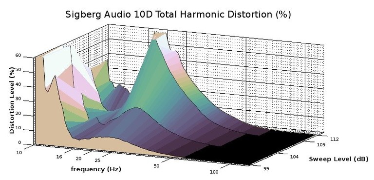

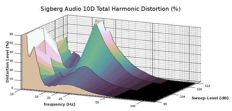

10d THD 3D

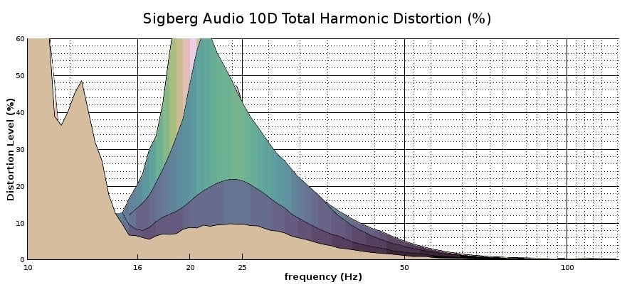

10d THD profile
The above graphs show the corresponding total harmonic distortion to the long-term output graphs. Essentially, they depict how linear the subwoofer remains for the corresponding drive level seen in the long-term sweeps. The quantity being measured is how much of the subwoofer’s output is distortion and is shown here as a percentage. One quick note; the spike of distortion that rises up as frequencies dip below 15Hz is primarily from background noise. This sub doesn’t produce much output at such low frequencies, and so background noise becomes a significant component of the recorded measurement.
One immediately apparent feature is the effect of the limiter; distortion goes up at a nearly logarithmic rate as frequencies go down, which is customary for a sealed subwoofer. But go down a bit further, and distortion rapidly falls down again, and that is from the limiter restricting cone motion. Without it, the voice coil may well beat itself to death. At the last few dB of headroom, distortion can get fairly high in deep bass, but below that point, the 10D keeps its composure very well. In mid-bass, the 10D doesn’t want to produce any distortion at all in this test, even at maximum drive levels. At the lowest sweep shown in this graph, the 95dB sweep, distortion never rises above 10% until below 15Hz. That means at nominal drive levels, the 10D is an extremely clean and linear subwoofer. The bottom line from these graphs is that it's just not terribly happy when pushed hard in deep bass but then very few sealed subs are.
Astute readers might note the discrepancy between the vanishingly low distortion in midbass in these long-term sweeps but higher distortion products in the burst tests. The reason for this seems to be that the amp has a protection circuit that clamps down on a continuous, extremely large signal, but doesn’t react similarly for a burst signal since that power can be sustained for a short period. While the sub can be driven pretty hard, it does have limiters that protect the drivers from self-destructing. I pushed the sub as hard as it could be pushed with an input signal, and it did not bottom out or give any other sign that the drivers were in danger.

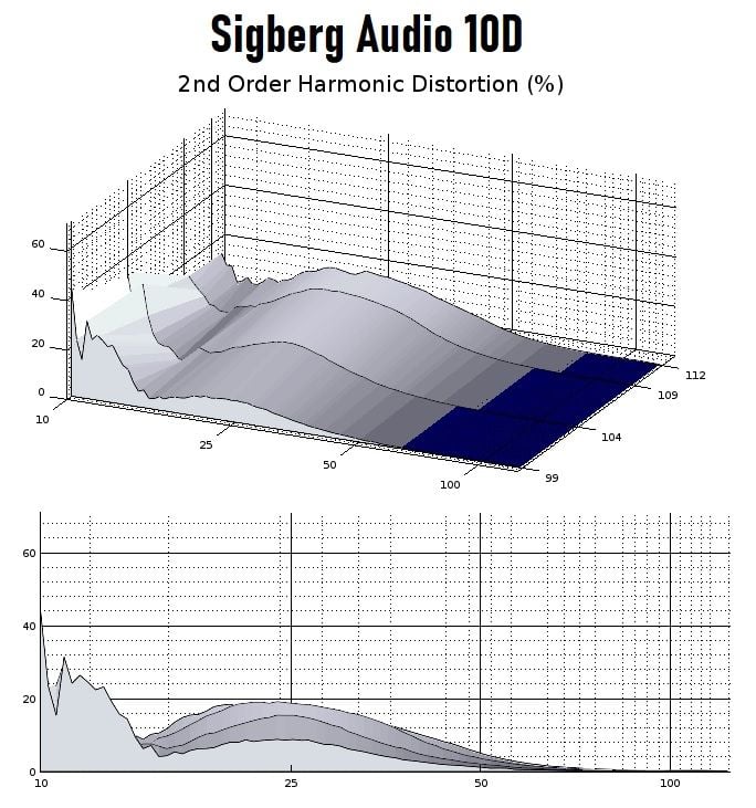

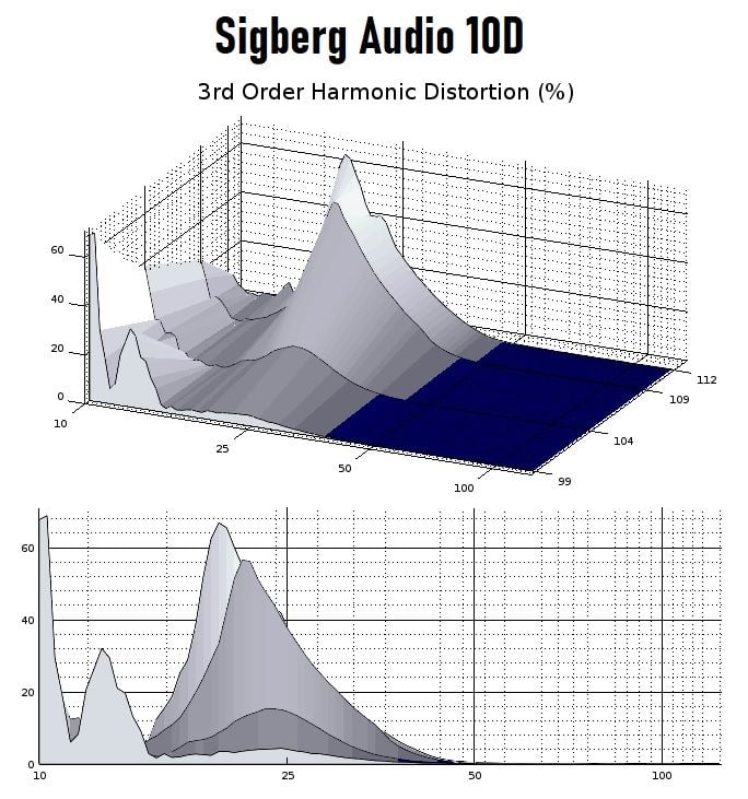

10d 2nd harmonic  10d 3rd harmonic
The above graphs depict measurements of the constituent harmonics from the long-term output sweeps and are what the total harmonic distortion measurements are composed of for the 2nd and 3rd harmonics. These individual harmonics can give us a clue as to what might be the cause of some quirk or non-linearity. We are only showing the 2nd and 3rd here because they more or less reflect the higher even-order and odd-order behaviors, although higher-order harmonics tend to be much further down as a percentage of distortion compared to the second and third.
An interesting feature to note with these graphs is that the even-order distortion rises with a pretty steady rate relative to drive level, but the odd-order harmonics stay extremely low until the highest drive level at which it skyrockets in deep bass. I would guess from that kind of distortion profile that the source of even-order harmonic distortion is primarily from induction which tends to scale evenly with output level. Induction can cause an asymmetry in the back-and-forth motion of the driver. What minuscule distortion that occurs in mid-bass comes from the even-order harmonics. An advantage here is that even-order harmonic distortion is more difficult to perceive than odd-order, and so in the music frequency band, what little distortion exists is a less intrusive sort. Once the driver nears its limits, we can see from the 3rd harmonic graph that both directions of travel get evenly impacted by a restriction in its excursion.

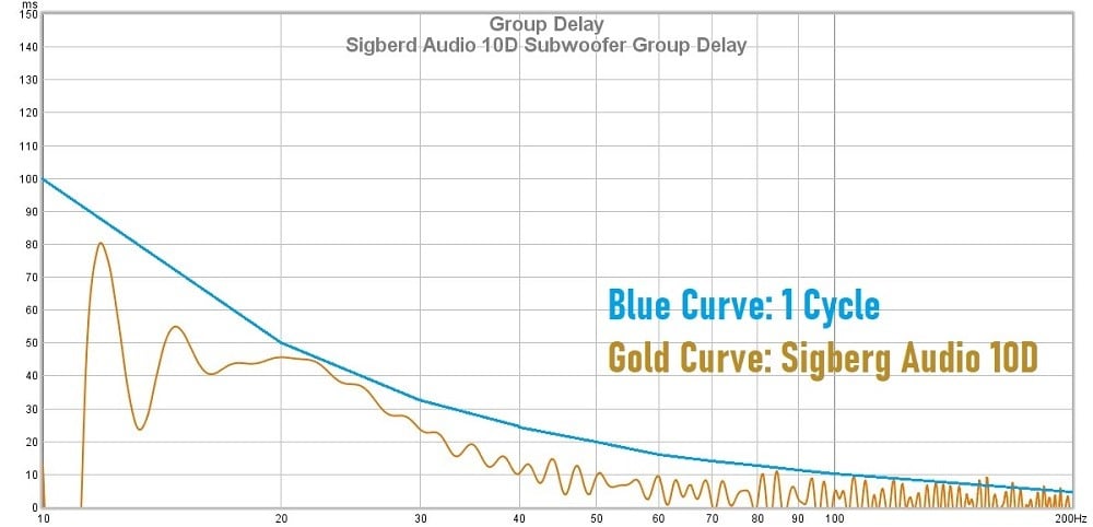

10D Group Delay
Group delay is the measurement of how much time it takes for individual frequency bands of an input signal to be produced by the speaker. It can indicate that some frequency components are developing slower than others or are taking longer to decay. It is generally thought that 1.5 sound cycles are needed for group delay to be audible at bass frequencies, although there is an argument that group delay should remain under 20ms to be completely unnoticeable, but that is likely meant for mid and upper bass frequencies.
Normally I include a 1.5 cycle curve on this graph, but since the 10D does not meaningfully exceed even 1 cycle, I didn’t even bother. The 10D posts some overall very good results here, staying below 10ms above 50Hz. Group delay does start to rise a bit below 35Hz or so, and that is due to the high-pass filter that Sigberg has employed to protect the sub. It has a remarkably mild time-domain effect considering how steep its effect on the frequency response is. Overall, this is a very good showing, and this sub will have a sharp sound without any audible decay times.

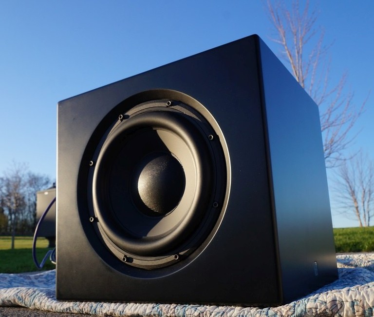

10d outdoors

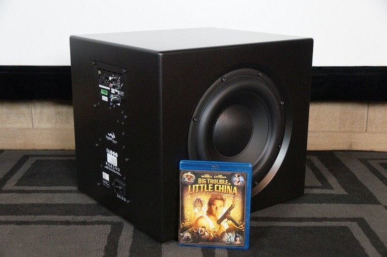

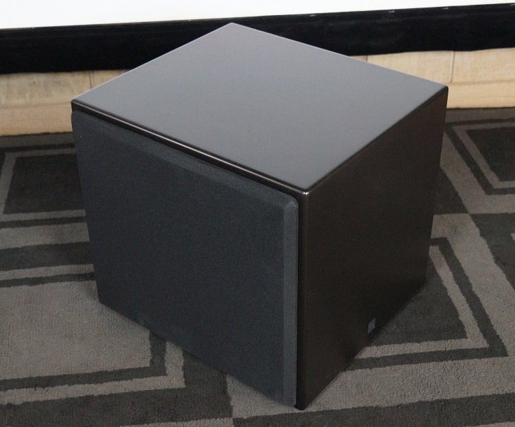

The Sigberg Audio 10D is about as small as subwoofers can get and still have serious performance.
Aside from its performance attribute, the 10D looks quite nice. The satin black finish is impeccable, and the rounded edges give this a classy look that wouldn’t be out of place in higher-end interiors. One huge advantage that it has is its size; it doesn’t have that much of a physical presence, and none but the pickiest household members would object to its presence if placed out of the way. The build quality is well above average; it feels like a boulder to pick it up and is deceptively heavy for such a small sub. It has a very good feature set that includes balanced and unbalanced inputs as well as speaker-level inputs. It is highly adjustable and comes with a 9-band parametric EQ along with a host of other variables that can customize its behavior.
