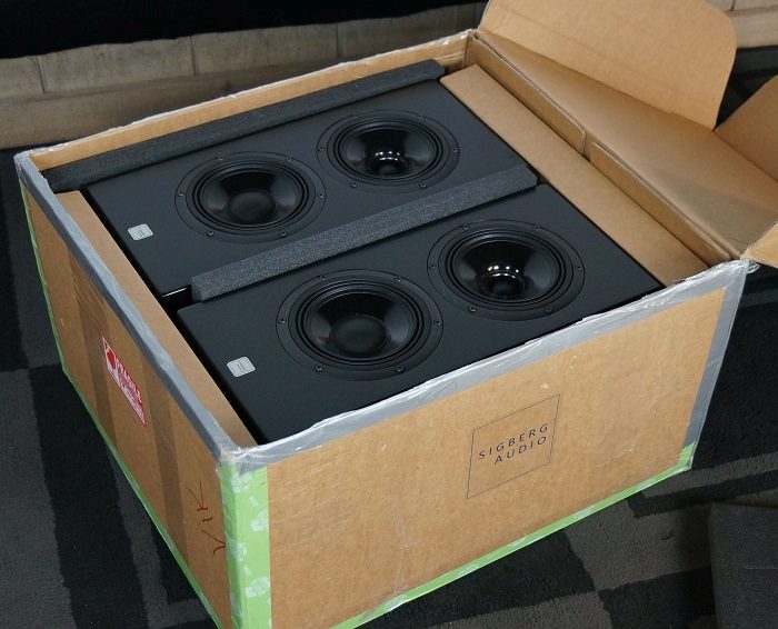

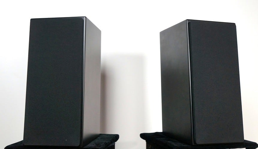

The SBS.1 arrived in a double-layered cardboard box and tucked in some stiff foam stand-off pieces. The packing should be adequate for normal shipping practices, but I do think that something of this price point might benefit from thicker foam pieces just in case of an abnormally rough shipping transit.

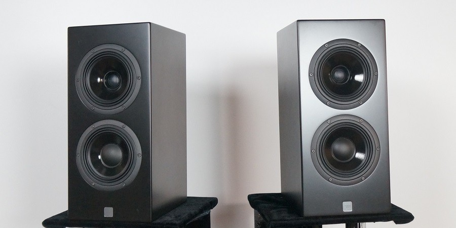

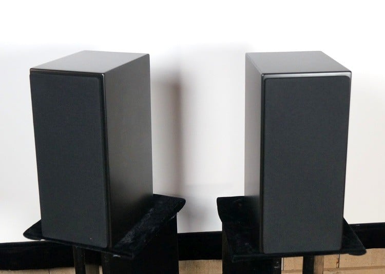

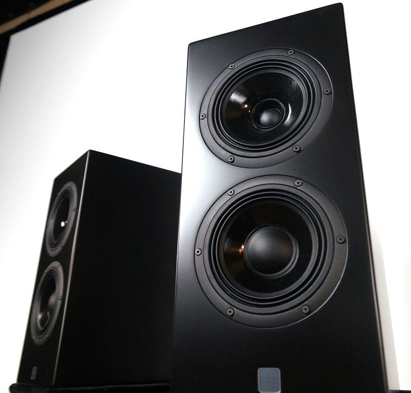

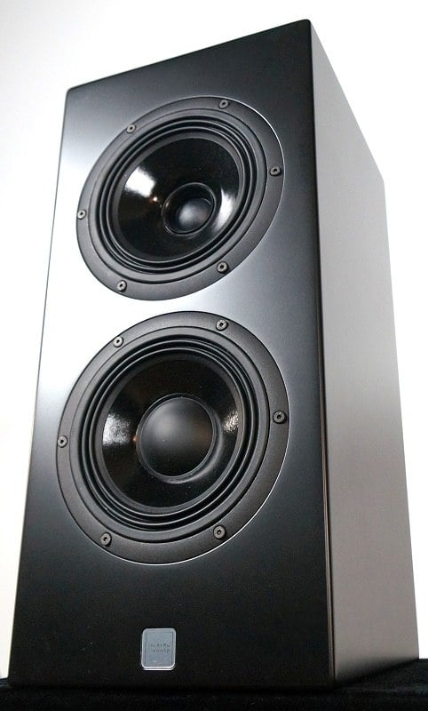

Once out of the box, the SBS.1 speakers present themselves as sleek black units with a fine satin black finish. The edges and corners have a slight rounding and the cabinet shape has a slight backward lean that combines to give them a streamlined look that is a definite improvement over the standard oblong box that most speakers use. The driver cones have a glossy sheen that stands out as the aesthetic focus of the SBS.1 from an industrial design standpoint. There is a small Sigberg logo at the bottom front of the speaker to help save it from being too minimalist. The included grilles hide the entire front of the speaker and do make them look a bit drab, but some people loathe the appearance of drivers, so manufacturers must supply grilles. Overall, these speakers look quite nice without being flashy, and I would call them elegantly restrained. They would not be out of place in a luxurious decor, and their simple, sleek styling would enable them to fit in almost any type of interior design.

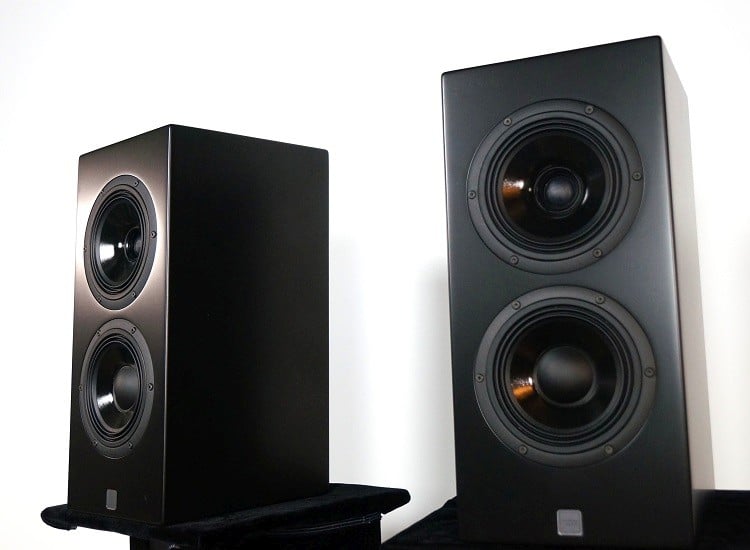

Design Analysis
As
mentioned before, the SBS.1 speakers are active bookshelf speakers that are
intended to be used with a subwoofer. They are a 2.5-way sealed design that
uses a coaxial driver. Let’s get into the details by starting with the drivers.

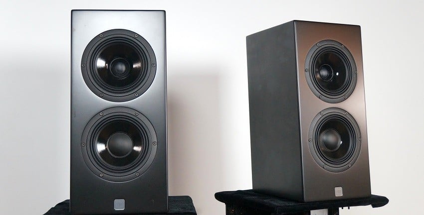

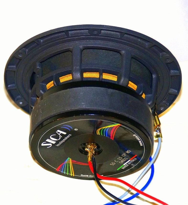

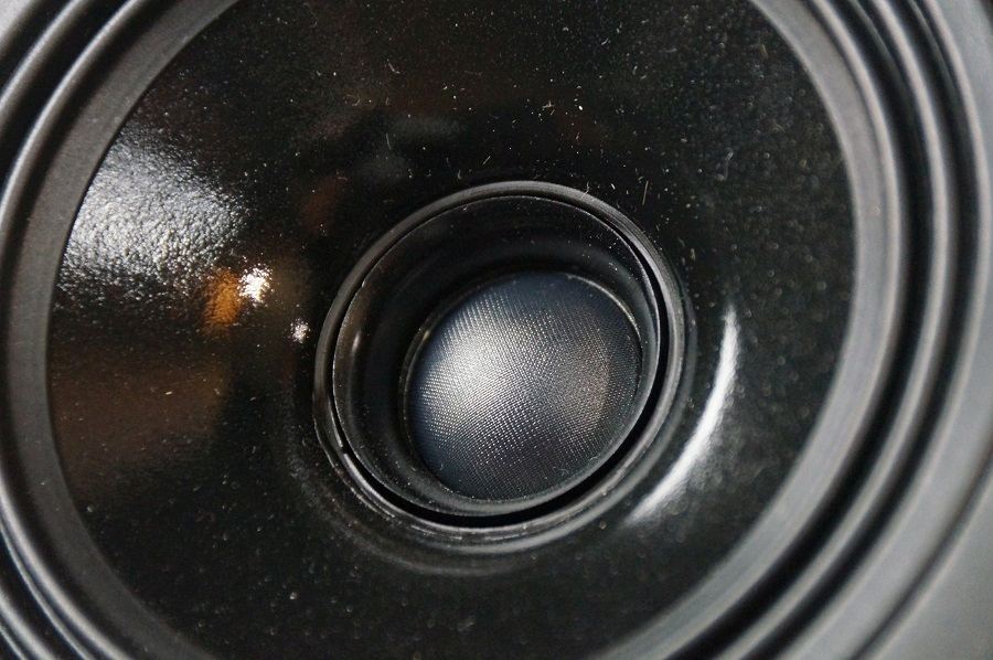

The tweeter is a 1” silk dome embedded in midwoofer ,which is used as a
waveguide. There are two midwoofers; one of which is used in the coaxial driver
and one standalone midwoofer mounted below it. Coaxial designs have the
advantage of having the tweeter always be in phase with the midrange driver. One of the advantages of coaxial designs is that
the acoustic center of the woofer and tweeter remains the same irrespective of
where you are in relation to the speaker – above, below, left, right, or center
of the driver. That means the drivers are not only time-aligned on-axis, they
are time-aligned at any off-axis angle as well. With a typical speaker where
the tweeter is above the woofer, that is not true. When the speaker is
time-aligned on tweeter axis, standing above or below the speaker will place
you closer to the tweeter or woofer respectively, so the woofer and tweeter are
no longer time-aligned as the sound from the tweeter will arrive first. This
affects the phase matching between the drivers and causes peaks and dips in the
response.
Since the upper midwoofer shares the same bass range as the
lower woofer, the SBS.1 should be much more of an acoustic “point source”
speaker than typical. Most loudspeakers try to emulate a point source location
from the tweeter’s position. This is often done with mixed success. The success
of this approach is key toward getting all of the drivers to add up to a
coherent, unified sound. The SBS.1 takes this very seriously, with the coaxial
driver blending in with the midwoofer with no timing difference caused by
distance difference, since there is no distance difference. The midwoofer’s
shared frequency ranges also assists here because there is no crossover
transition where they could cause conflicts at any angle. The 600hz low-pass
filter on the lower woofer will enable both woofers to act as a single point of
acoustic emission since the center-to-center spacing of the drivers, which is
about 6.5 inches, is much less than the upper-end wavelength of the low-pass
filter which is 22.6 inches.

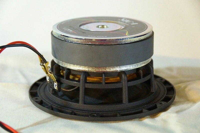

As was mentioned before, the midwoofers do not attempt deep bass at all, and the low end of the response window for the SBS.1 is 90Hz (+/-2dB). This brings advantages and disadvantages. The obvious disadvantage is the speaker needs a subwoofer in order not to sound thin due to lack of deep bass. That is a reasonable compromise because if you can afford these speakers you can certainly afford a subwoofer or two. There are two big advantages of this design choice both of which are directly related to that unyielding maxim of loudspeaker design, “Hoffman’s Iron Law,” which essentially states that you can have two of the following three attributes but never all three: smaller size, deeper bass, or wider dynamic range. Most speakers trade each of those attributes to varying degrees, but the SBS.1 goes in hard for small size and dynamic range at the expense of deep bass. This means that these speakers should be able to get very loud, and of course, that they are very reasonably sized. Their specs suggest that they should get extremely loud for their size, but we will see for ourselves in the ‘listening sessions’ segment.

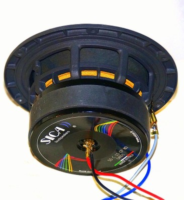

The midwoofers use coated paper cones which can be a good material to reach higher frequencies without severe breakup modes. The cones are attached to the driver frame with a double-roll surround. Double-roll surrounds can often be used to trade excursion for sensitivity, and that makes sense in this design which is going for dynamic range over low-frequency extension. The midwoofers use some beefy 4” diameter and ¾” thick ferrite magnets. That is fairly heavy-duty for 5.5” midwoofers, and it feels weighty (although what really counts is the actual magnetic field strength in the voice coil gap rather than the magnet size). The midwoofers also use a copper shorting ring to reduce distortion products. The woofers are rated for 120-watt power handling (by the AES 2-1984 standard) and so make a good match for the onboard amplifiers.

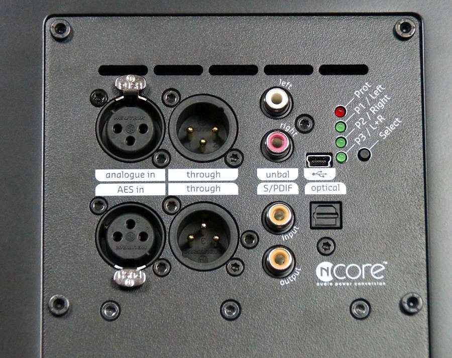

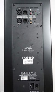

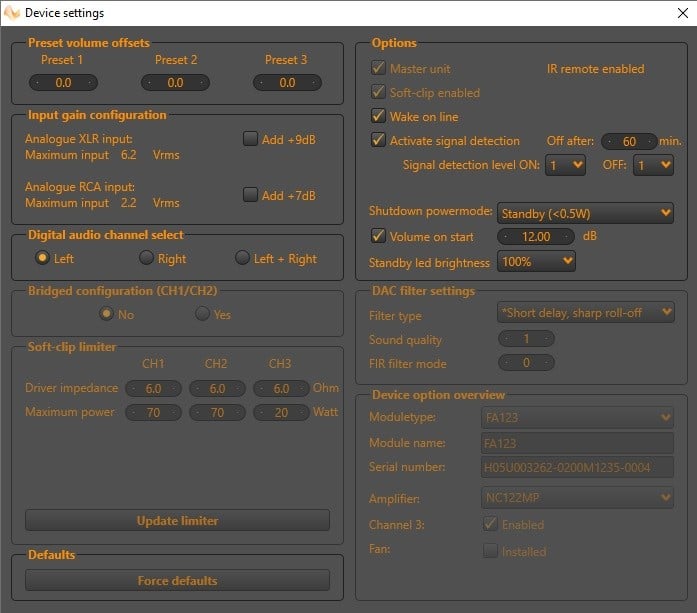

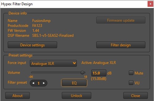

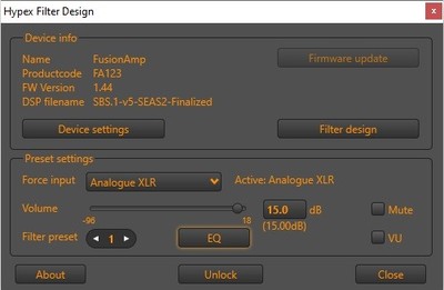

As powered speakers, the SBS.1s use some of the highest performing electronics available. Each speaker uses three Hypex nCore amplifiers. These are state-of-the-art class-D amps, which are some of the lowest distortion and lowest noise amps around. In fact, these are the lowest noise active speakers I have encountered to date. They are dead quiet unless you place your ear right up against the tweeter where there is a very faint hiss. Each midwoofer gets 125 watts RMS and the tweeter gets 100 watts RMS for a system total of an astounding 350 watts RMS per speaker. That is a lot of power for such a small loudspeaker, and it should have a tremendous amount of dynamic range for its size, especially considering that the drivers are rated to handle that much power. The SBS.1 uses an active crossover, of course, and the crossover slopes are not traditional ones. The tweeter/midwoofer crossover frequency is 2.5kHz and the high and low pass filters start with a gradual 1st order slope but become a sharper 2nd order slope as the filter progresses. Being a 2.5-way speaker, the coaxial midwoofer shares the bass range with the lower woofer, but the lower woofer gets high-passed at 600Hz. Sigberg tells me that this unusual mixed order filter structure was done to improve the phase response.
The SBS.1 has a variety of connectivity to accommodate most system types. On the analog input side, there is a balanced XLR input and through, as well as unbalanced RCA left and right inputs. On the digital side, there is an AES input and through, a S/PDIF input and output, as well as a TOSLINK input. For the digital inputs, there is a selector that lets you designate the speaker to playback the left, right, or both channels, although the speaker pair come preconfigured for left and right channels, so it shouldn’t be necessary to make that selection unless you want to double-check it. Many digital sources only offer a single S/PDIF or TOSLINK output, and in those cases, the user will need to get a splitter to divide the signal into two streams. Digital audio signal splitters can be inexpensive, but they are small and widely available, so that shouldn’t present a problem.

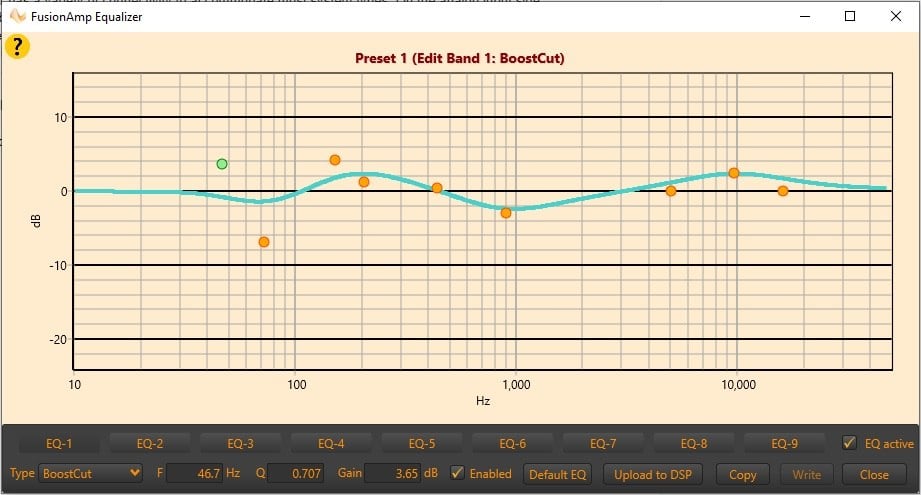

The SBS.1 amplifier has three preset response curves to choose from: Preset 1 provides a flat response, Preset 2 gives the treble a slight elevation to compensate for grille use, and Preset 3 shelves the treble by a few dB for those who prefer a warmer sound. Users also have the option of tailoring the response to their own taste because the SBS.1 comes with a 9-band parametric equalizer when they download the DSP software provided by Sigberg’s website. Users will need to hook up the SBS.1 to a PC with Windows 7 or higher using the provided USB cable to access the equalizer, but the equalizer was easy to use. I would recommend most users to just stick with the provided presets for the best sound unless they really know what they were doing with an equalizer. The Hypex software package also allows the user to adjust other parameters such as gain settings, standby settings, LED brightness, and a few other options.
The SBS.1 speakers have an active limiter so they can be played loud without worrying about overdriving the woofers. In my own listening, the amp was somewhat warm to the touch at idle but never became hot even after higher-level listening. Sigberg tells me that there are built-in thermal sensors that will lower the maximum output by 6dB if they detect excessive heat, but that has never happened in any of their testing. That is not surprising considering the enormous efficiency of class-D amplifiers where much less energy is lost as heat compared to class-A/B designs.

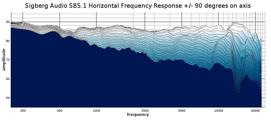

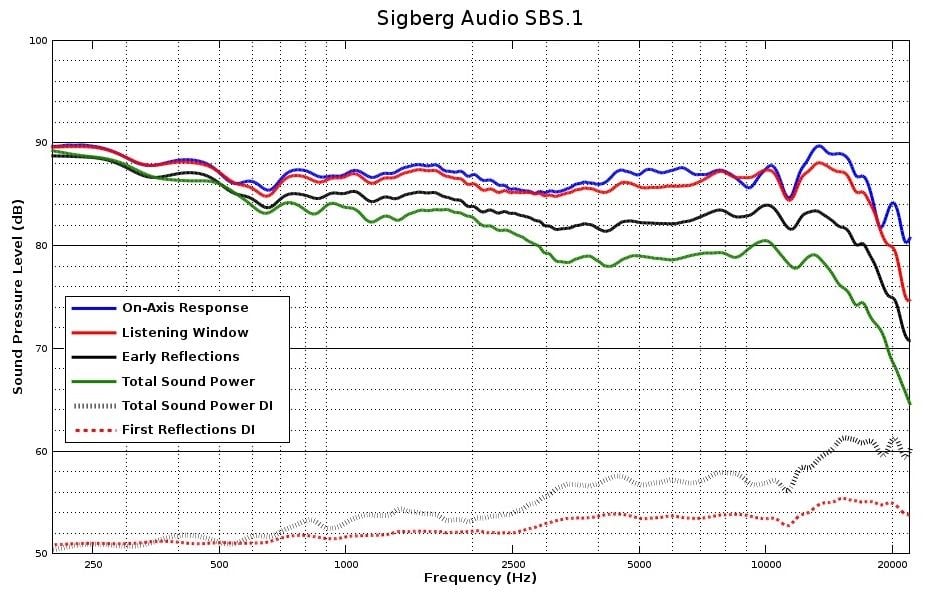

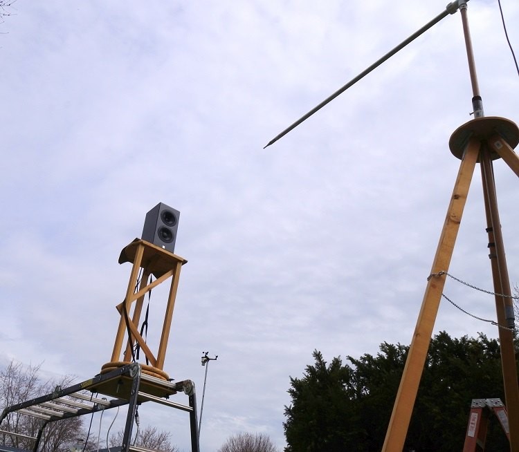

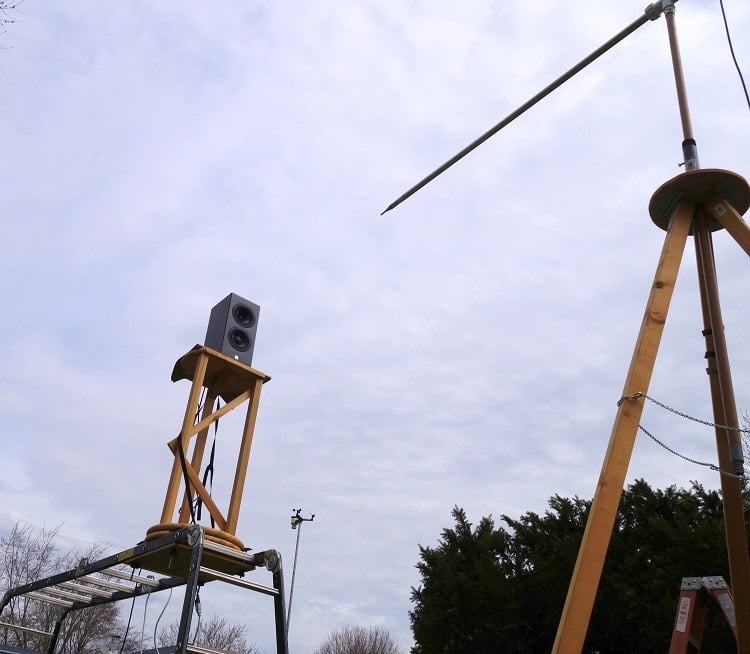

The Sigberg Audio SBS.1 was measured in free-air at a height of 7.5 feet at a 1-meter distance from the microphone, and the measurements were gated at an 11-millisecond delay. In this time window, some resolution is lost below 250 Hz and accuracy is completely lost below 110 Hz. Measurements have been smoothed at a 1/24 octave resolution.
The above graph shows the direct-axis frequency response and other curves that describe the SBS.1’s amplitude response in a number of ways. For more information about the meaning of these curves, please refer to our article Understanding Loudspeaker Measurements Part 1. These graphs show an impressively flat response from upper bass all the way up to upper treble. The bass does seem to be slightly elevated, and the upper treble past 10kHz shows a small dip followed by a slight lowering of output starting at 15Khz. Keep in mind that the “Listening Window” graph is more important here than the on-axis response, and it is quite flat over much of the bandwidth shown here. That tweeter is performing beautifully. Directivity is nicely controlled, and there don’t appear to be any major dips or peaks that would make this speaker difficult to equalize. That also means that the SBS.1 will have fairly predictable performance in any normal room, and acoustic treatments aren’t needed to address any flaws of the speaker.

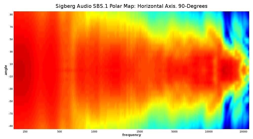

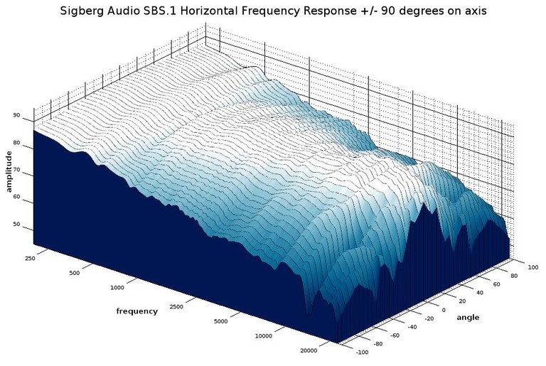

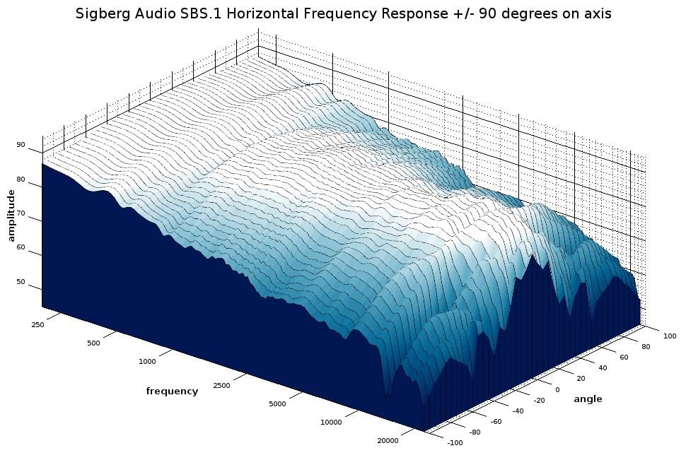

The above graphs depict the speaker’s lateral responses out to 90 degrees in five-degree increments. More information about how to interpret these graphs can be read in this article: Understanding Loudspeaker Review Measurements Part II. Here we get a closer look at the horizontal dispersion of the SBS.1, and we can see that there aren’t any jarring response swings except a little bit in upper treble where it doesn’t really matter. There is a slight sag that occurs just above 3kHz outside of the 40-degree angle; it is a low Q dip, but it is shallow and would only matter as a reflection since no one is going to be directly listening to these speakers at such a far off-axis angle. Overall, we have nicely flat responses over any reasonable angle that anyone is realistically going to be listening to. This speaker will have no tonal shifts over a very wide listening area.
The above polar map graphs show the same information that the preceding graphs do but depict it in a way that can offer new insight regarding these speakers’ behavior. Instead of using individual raised lines to illustrate amplitude, these polar maps use color to portray amplitude, and this allows the use of a purely angle/frequency axis perspective. The advantage of these graphs is they can let us see broader trends of the speaker’s behavior more easily. For more information about the meaning of these graphs, we again refer the reader to Understanding Loudspeaker Review Measurements Part II.
The solid red color over so much of this graph tells us that the SBS.1 is emitting a constant level of acoustic energy over a wide area and across a wide range of frequencies. This speaker covers a large area with neutral sound with little deviation. The most consistent coverage can be seen to be within a forty-degree angle of the front-facing direction of this speaker, and that will encompass pretty much anywhere anyone is attempting to hear the speakers. Again, we see no major peaks or nulls at off-axis angles. The in-room sound of the SBS.1 might be a bit on the warmer side seeing as how there is more bass at far outer angles. A speaker with such small bass drivers won’t be able to restrict directivity until relatively high frequencies, and that is what we are seeing here where the dispersion doesn’t become a bit more consistently restricted until above 2kHz.

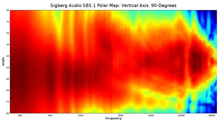

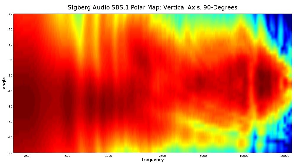

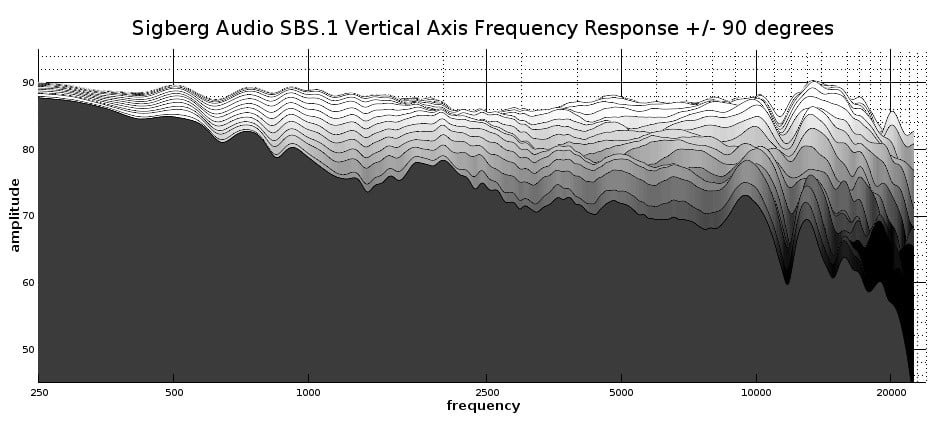

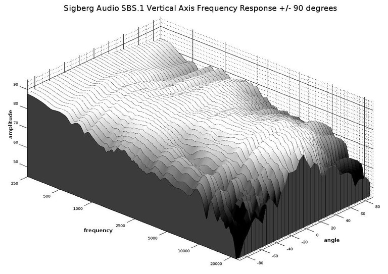

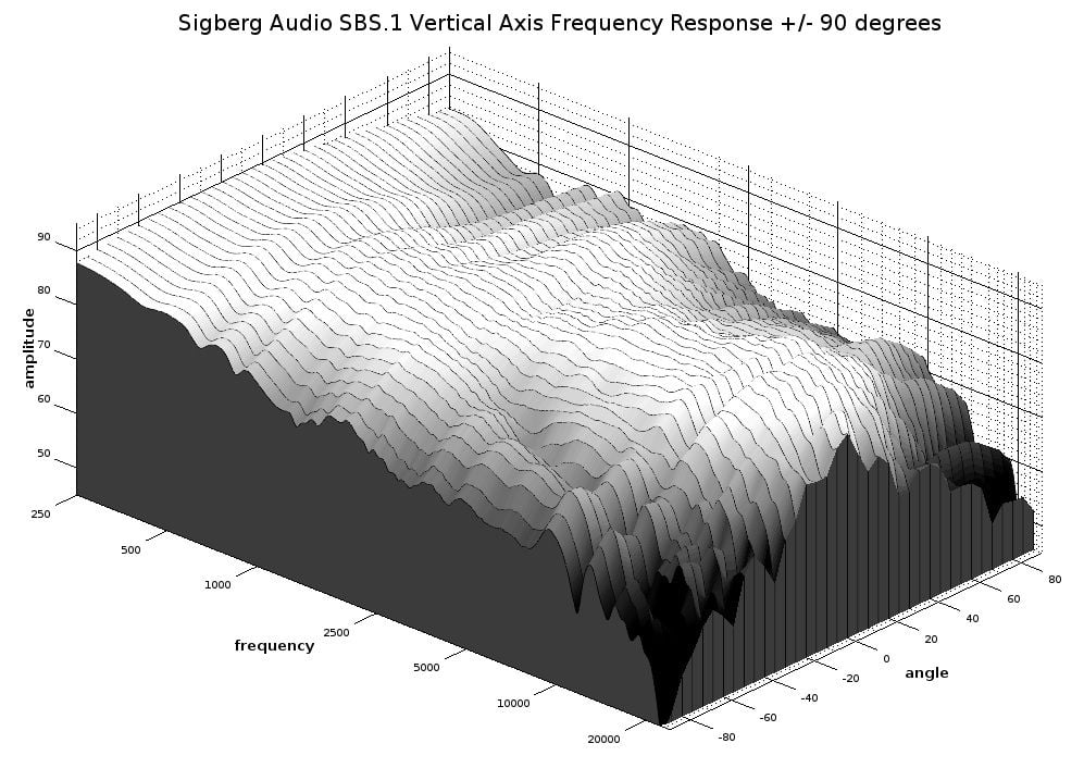

The above graph shows the SBS.1’s speaker’s response behavior along its vertical axis where zero degrees is directly in front of the tweeter, negative degree values are below the tweeter, and positive degree values are above the tweeter. We don’t normally throw in a ‘profile’ view of the vertical responses, but I think it is appropriate for the SBS.1 to show how much it resembles the horizontal axial response- as would be expected. The vertical dispersion is similar although not the same as the horizontal dispersion, so, as was mentioned earlier in this review, these could be used on their side just as well as upright in a vertical orientation. It won’t do much to affect the sound. To reinforce this aspect of the speaker, let’s take a look at a polar map of the vertical dispersion:
In our polar map of the vertical response of SBS.1, we do see better that it isn’t an exact match of horizontal response, but it is not massively different either. This speaker has a wide dispersion on both axes. One difference that we see is some kind of comb-filtering in the upper bass region between 500Hz and 1kHz in the upper half of the vertical axis. I don’t know what to attribute this to except that the shape of the cabinet would be a factor there since it is one of the major things that is asymmetrical on the vertical axis. It is not at all a big deal in practice, and I only mention it as a point of academic curiosity. Nonetheless, you still get a nicely uniform response out to forty degrees much like the horizontal dispersion.

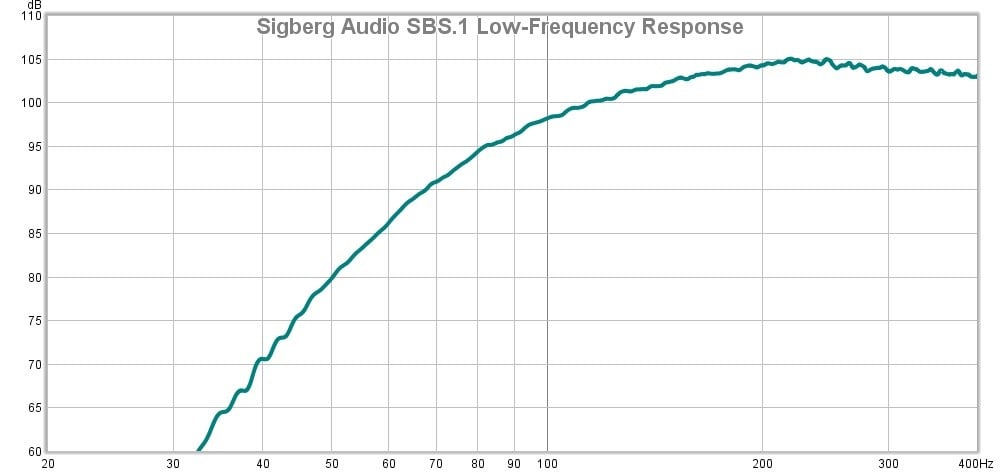

The above graphs show the SBS.1’s low-frequency responses that I captured using groundplane measurements (where the speaker and microphone are on the ground in a wide-open area). The SBS.1’s roll-off looks to start at 200Hz, but it rolls off at an extremely gradual 1rst-order slope until 80Hz where it starts to roll off at a 2nd order slope. Typical room gain will shore up the response a bit, but the speaker would sound quite lean on its own without a subwoofer. As the manufacturer says, the SBS.1 needs a subwoofer. Since it uses a sealed cabinet with a traditional sealed roll-off, integration with a sub should be fairly straightforward. I would experiment between 80Hz, 100Hz, and 120Hz crossover points to see what works best in the user’s particular room, however, 100Hz and 120hz crossover frequencies are better used with a multi-sub system so that subwoofer localization doesn’t become a problem.
