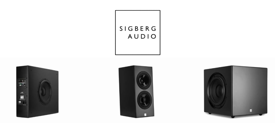

The SBS.1 Active Speaker

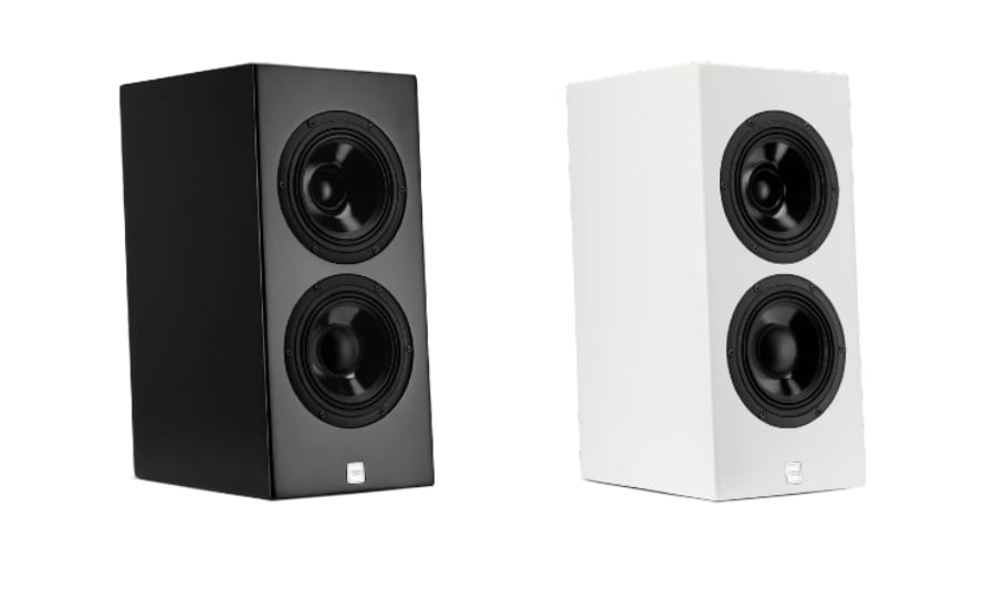

Sigberg describes the SBS.1 active speaker ($7,068/pair) as “the heart of the system.” It’s currently the only non-subwoofer speaker in the brand’s lineup (though that is likely to change soon). The SBS.1 looks like a reasonably compact and very attractive bookshelf speaker with a sealed cabinet, available in a high-quality satin white or satin black finish. Just over 16 inches tall, the SBS.1 is a 2.5-way design with a coaxial driver that places a 1-inch silk dome tweeter inside a 5.5-inch mid/bass driver. An additional 5.5-inch driver reaches down to the speaker’s bottom end at around 90Hz, but rolls off at around 400Hz at the high end, allowing the coax driver to handle the blend with the tweeter. Unlike a true midrange driver, which would only play between the top of the woofer’s range and the bottom of the tweeter’s range, the coaxial mid/bass driver also reaches down to about 90Hz (this is what makes the SBS.1 a 2.5-way design, rather than a 3-way design). Each driver is powered by its own Hypex nCore amp, with a total of 350 watts per speaker. Built-in DSP provides access to a 9-band parametric EQ, allowing the user to correct for in-room deviations from the desired frequency response. EQ presets adjust the tonal balance of the speakers to suit personal preference.
If you’re a bass-lover, I know what you’re thinking. This speaker costs 7 grand and can only dig down to 90Hz? Most speakers of this size can play quite a bit lower than 90Hz, but the SBS.1 eschews low bass duty on purpose; it actually uses an active high-pass filter at the low end to reduce bass output. This configuration limits driver excursion and distortion, even when the speakers are pumping out high SPLs. Because the SBS.1 is designed to work with a dedicated subwoofer, it can focus on the critical mid-bass region, delivering “sensitivity and dynamics (that) are unheard of for its size,” according to Sigberg. The use of dedicated subs means that the 5.5-inch mid/bass drivers in the SBS.1 don’t have to work as hard when the speakers are rocking out. And because the SBS.1 uses dual mid/bass drivers, the required excursion for each driver is cut in half. Sigberg says that when paired with one of the company’s subs, the SBS.1 can play seriously loud with zero strain. “The result is the soundstage of a large floorstander, perfectly integrated,” according to the company. The large soundstage and pinpoint imaging that Sigberg promises can probably be attributed to the point-source nature of the coax driver, which delivers even dispersion characteristics off-axis for a wide sweet-spot. The speakers were designed to sound best with zero toe-in. Sigberg says that “the focus was 95% music” throughout the development of the SBS.1 speakers, but notes that the design team’s “relentless pursuit of dynamics and effortless delivery makes them an excellent choice for movies as well. The fact that they are designed to be paired with subwoofers makes them feel right at home in a movie setup.” It wouldn’t be difficult (nor would it be cheap) to use 5 or 7 SBS.1 speakers, paired to some good subs, in a home theater environment. Ideally, you’d want a preamp/processor with balanced outputs, and the ability to place power outlets discretely around the room. Assuming your room acoustics don’t cause too much trouble, using identical speakers for all channels can yield perfect timbre-matching that can be hard to come by any other way. But you’ll have to look elsewhere for height-effects speakers.

Subwoofers
Sigberg
says that the SBS.1 can be used with any high-quality subwoofer, but naturally
the company would encourage the use of its own designs, which reportedly
“provide clean and neutral sound all the way from the deepest bass and far up
in the mid-bass range. They are built to compete with expensive floor-standing
speakers in terms of precision, realism, and authority.” Sigberg currently

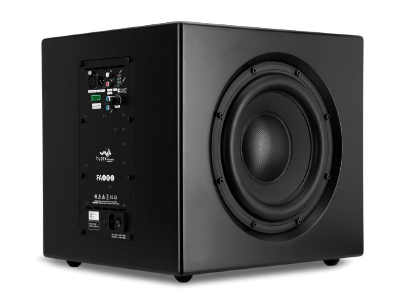

makes two types of subs. The 10D ($4,038 each) is a sealed, force-cancelling
subwoofer with two active 10-inch drivers mounted in a dual-opposing configuration on the sides
of the super-compact cabinet. Sigberg says that the 10D is the most compact
dual 10-inch subwoofer in the world. Its familiar cube-like shape measures
roughly 14 x 14.5 x 16 inches. According to the company, the compact
form-factor isn’t just an aesthetic benefit; it also allows for a more rigid
cabinet, contributing to the 10D’s “exceptionally low vibration and clean
output” for a sound that is “loud, deep, and precise.” A pair of SBS.1 speakers
can be used with a single 10D, or with a pair of subs for even higher output
and better overall sound. Sigberg claims an impressive in-room frequency
response of 19-250Hz.

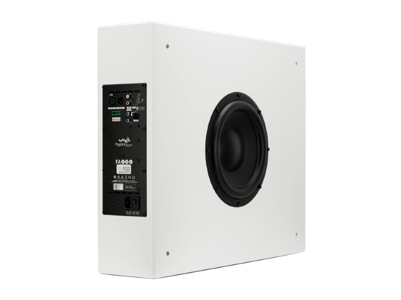

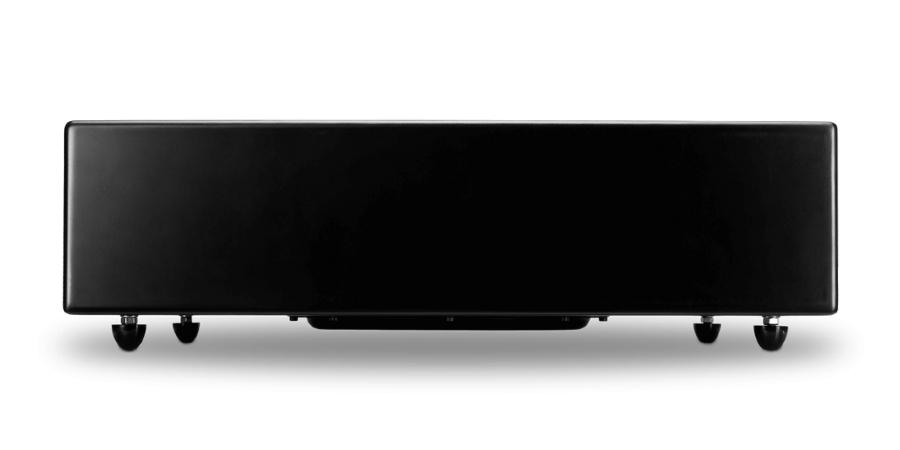

As you might surmise from the name, Sigberg’s Inkognito subwoofer is designed to blend easily into modern living spaces. Available in both 10-inch ($3,028/each) and 12-inch ($3,589/each) versions, the Inkognito’s slim, shallow cabinet is less than 7 inches deep, allowing it to be positioned in a variety of ways. It can be laid flat like a pizza box and slid underneath a sofa, or it can be attached to a wall using an optional mount. It can also be placed on the floor in both horizontal and vertical orientations. But unlike other “lifestyle” subwoofers, the Inkognito promises “both high-end sound and realistic sound pressure during music and movies,” thanks to heavy-duty drivers (weighing more than 13 lbs each), powerful amps, and clever use of DSP. Sigberg’s designers recognized that accepting the natural frequency response of the driver in a sealed cabinet “would have left a lot of bass on the table.” Using simulation and DSP, the team was able to maximize cone travel at any given frequency. The result is flatter frequency response, and significantly louder and deeper bass than would be possible without DSP, according to Sigberg.
All Sigberg Audio subwoofers also have a built-in, active limiter, which means “you will never experience your subwoofer bottoming out or running out of steam.” Like Sigberg’s speakers, the subs feature 9-band parametric EQ which is an invaluable tool to help smooth out in-room frequency response. To access these controls, you must connect a computer directly to the sub via USB.

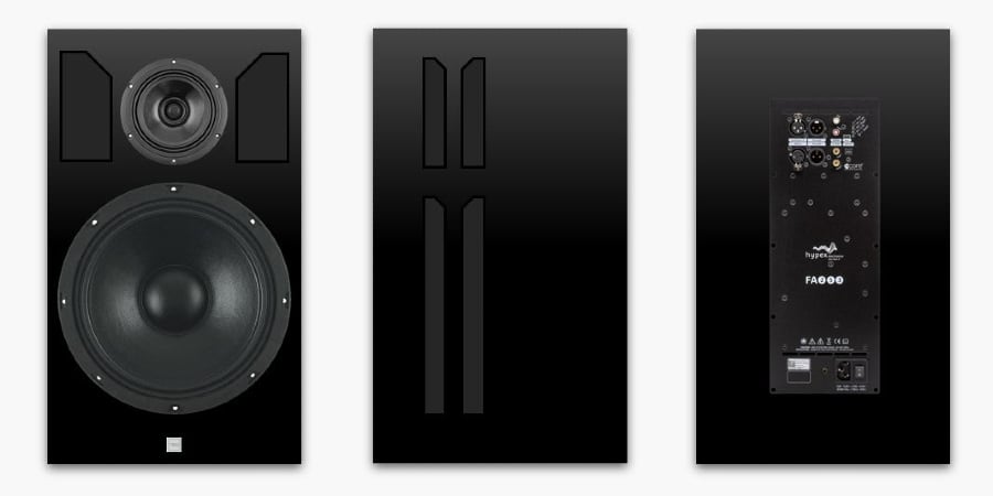

Sigberg is currently working on a larger speaker called the Manta.1 Dual Cardioid Concept (price TBD), which is a 3-way design mating a coax midrange/tweeter driver with a high-power, high-sensitivity 12-inch mid/bass driver in a passive dual cardioid enclosure. The coax driver is installed in a dedicated, vented chamber to reduce reflections from the front and side walls, resulting in improved soundstage, unique vocal performance, and increased clarity during complex musical passages, according to Sigberg. On either side of the coax driver, ports are cut out of the front baffle. This simulates a narrower baffle for the midrange driver, which Sigberg says leads to ideal dispersion characteristics across that critical frequency range. In the bass, the Manta.1 claims to achieve cardioid-like performance all the way down to 100Hz, effectively targeting bass pressure towards the listening position. Like the smaller SBS.1 speakers, the Manta.1 is designed to be paired with one or more subwoofers.
