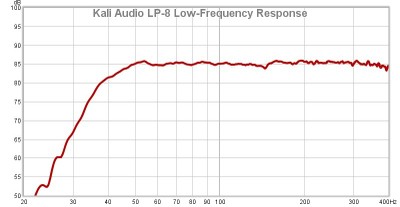

- Frequency Response (-10dB): 37Hz - 25kHz
- Frequency Range (+/-3dB): 45Hz - 21kHz

- Very good bass extension

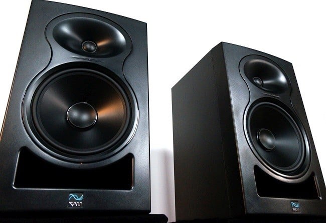

Reviewing the Kali Audio LP-8 studio monitor might seem slightly unusual for regular readers of Audioholics. We are a home-audio focused site and do not normally deal in pro audio gear. However, studio monitors often find their way into home use with the prevalence of ‘bedroom studios’ where people have made a room in their home into a recording or mixing space. The performance demands of studio monitors and home audio speakers have a lot in common; they are both sound reproduction tools that, one would hope, strive for accurate reproduction of the source content. Whether that content is an album or a movie or a work-in-progress shouldn’t really change the behavior of the loudspeaker; it should be blind to content. This being the case, a monitor should be as adept for recreational home audio listening as conventional home audio loudspeakers. One of the things we will be looking at is how these monitors fare for that purpose as well as monitoring purposes.
Kali
Audio is a newer manufacturer that was launched in January of 2018.
Since then
they have made a splash with rave reviews for their products among pro-audio
reviewers. Our interest in Kali had been piqued by the engineering pedigree
that they brought with them from JBL’s pro-audio division, along with their
stated goal of making JBL LSR 300 series ‘killers’. JBL’s LSR30X line is a very
successful and highly regarded budget monitor series that leveraged JBL’s
research into state-of-the-art waveguide technology for ‘prosumer’ use. Kali
uses one of the principal engineers involved in the design of JBL’s
sophisticated waveguides with the intention of making a superior monitor to the
LSR30X for the same cost. Given how well-performing the LSR30X monitors are,
that is quite ambitious, however, Kali has the expertise to do just that given
their engineering team’s familiarity with JBL’s monitors.

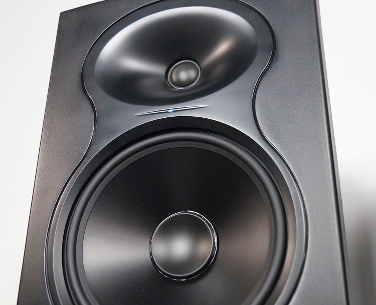

Appearance
Aesthetics
don’t normally factor into the decision when ch
oosing studio monitors - at least it
wouldn’t in a perfect world. But, if we are being honest, we still want our
speakers to look nice, even in a working environment. Monitors tend to go after
a different aesthetic style than home audio and are more businesslike than
‘furniture-esque’ as many home audio speakers aim for. That isn’t to say they
have to look crude but rather a sleek kind of utilitarian style, and that is

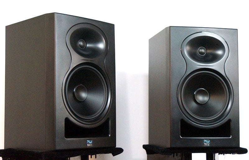

what the LP-8s go for. The LP-8s may not be as living room decor friendly
without wood grain paneling, but they wouldn’t look out of place in a gaming
setup or media room. The LP-8s do not look pretty in the normal sense of the
word, but I do think they look cool. All of the curved lines on the front
baffle make it look a bit more organic than just drivers mounted in a box. A
small blue LED on the front lets the user know when it is powered. For home
use, it might not look too out-of-place in rooms with modernist decor. It’s a black
box, but it’s a black box with some style.

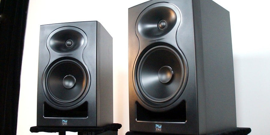

Design Analysis
The
basic design used by the Kali Audio LP-8 is a very common one among monitor
manufacturers in this segment and price range; a two-way active speaker with an
8” woofer and 1” dome tweeter in a waveguide. But, contrary to surface
appearance, the LP-8 separates itself in attention to detail.

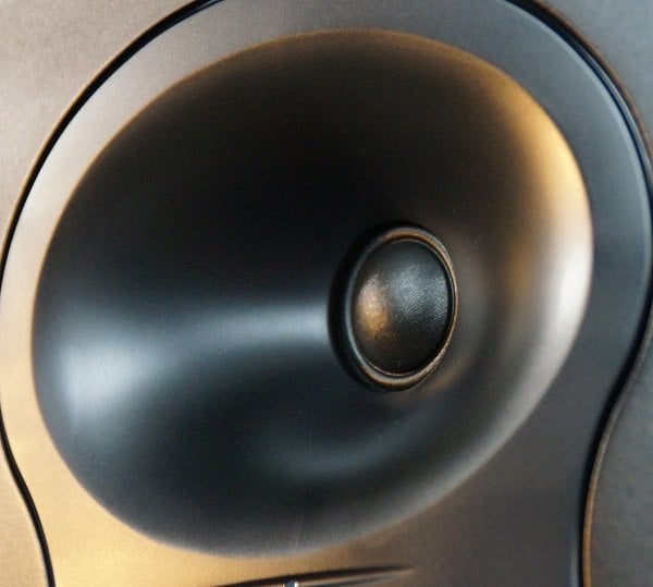

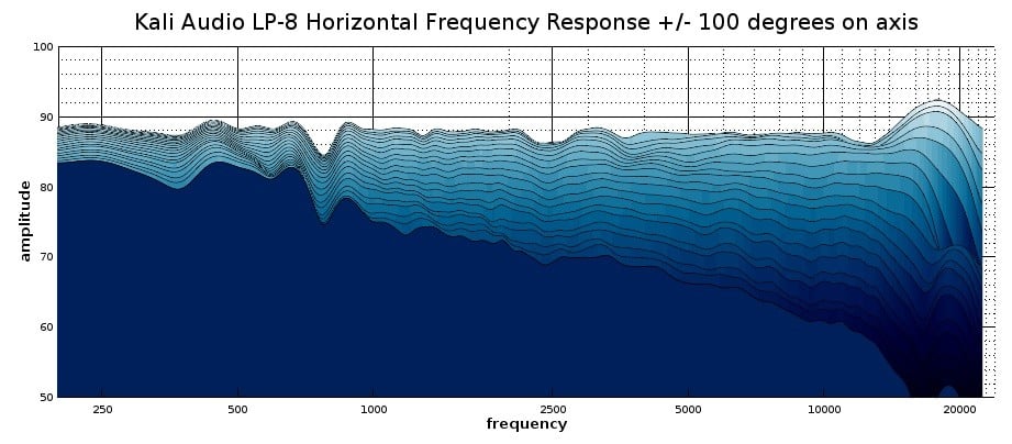

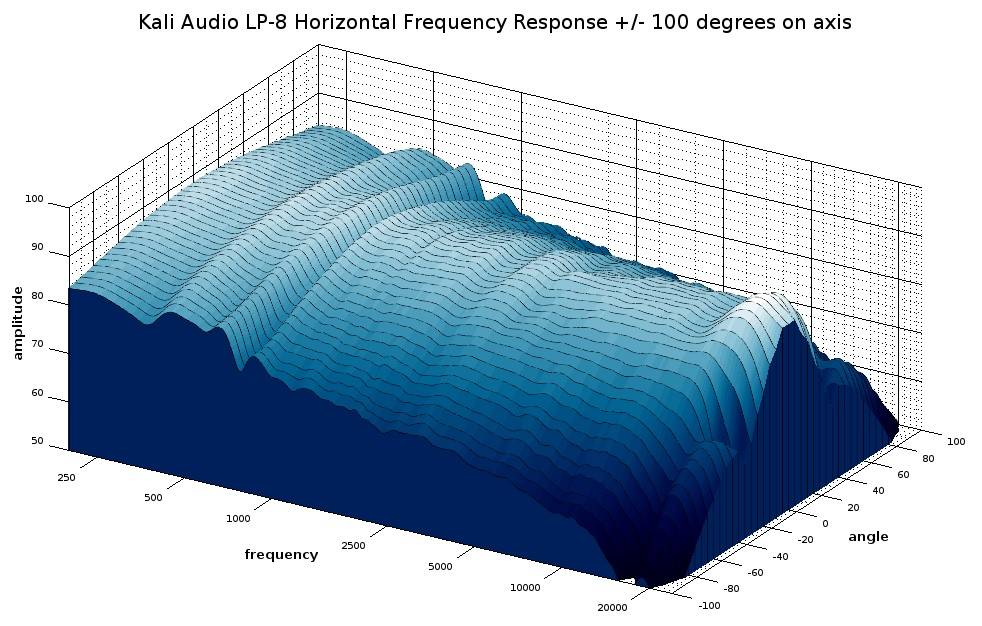

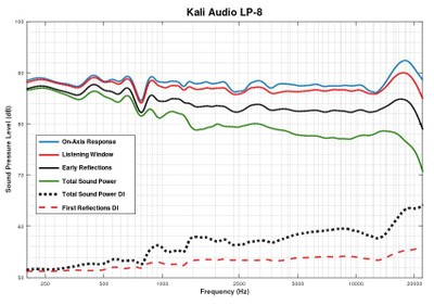

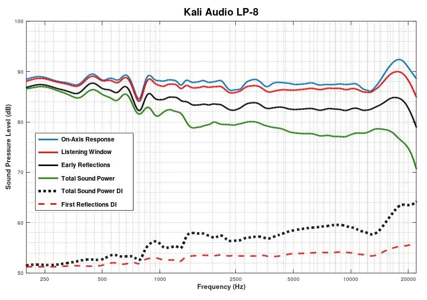

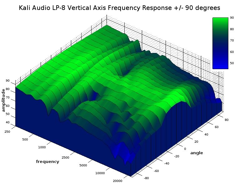

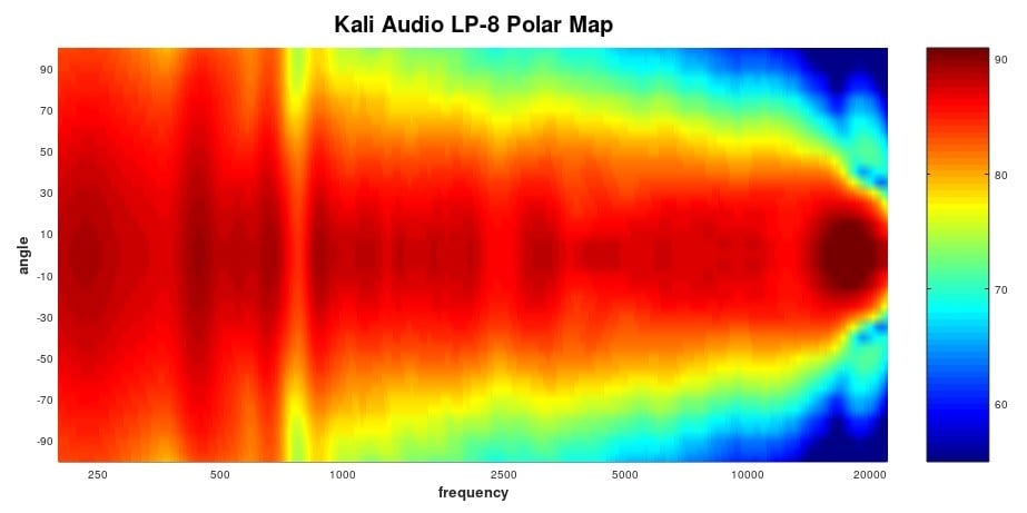

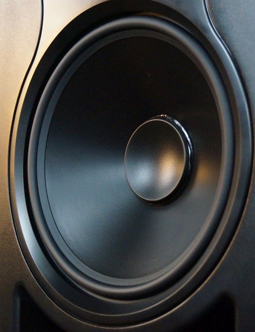

One design detail is the waveguide that Kali calls the ‘3D Imaging Waveguide’ which uses some of the latest advancements in acoustic research and sophisticated computer modeling to achieve some very specific performance targets. It is intended to control directivity for a narrow dispersion on the vertical axis and a wide dispersion on the horizontal axis so that there are few acoustic reflections coming from a floor, desk, or ceiling, but there is a wide-angle of even coverage over a lateral plane of listening positions. It is attempting to control dispersion in an even manner as well so that the response remains uniform at all angles in the front hemisphere of the speaker. This is done to preserve an even tonality across a breadth of listening positions.
Kali
uses a beefy 8” woofer. A smaller woofer might tend to incur
distortion at higher drive levels.
They claim that the coils and magnets are larger than competing monitors, and
they have implemented a dual-layer voice coil. The reason for this is their
performance target of a low-distortion, continuous 85 dB loudness level at the
listening position with 20 dB of headroom above that. The listening position
they design for is someone seated at a 2.8-meter distance. If those SPL targets
sound familiar that is because they are the same used by THX for reference
level listening. While these are not THX-certified monitors, they are looking
to achieve the same kind of performance level at the listening position.
There are no fancy materials used in the woofer or tweeter, instead, the components use conventional materials but optimally designed for these specific performance targets. The woofer cone looks to be made of polypropylene and the tweeter looks like a fabric dome tweeter. I asked the designer, Charles Sprinkle, about the design decisions in this respect, and this was part of his answer:
I think the transducers are noteworthy, not for exotic materials or extra features, but for how we optimized the design using FEA to get the best performance that we could for the money spent. There is literally nothing wasted in these designs. The motor force as a function of excursion is coordinated with compliance as a function of excursion to maximize linearity and reduce distortion. Of course, we did have to spend extra money on the magnet. In order to use a two-layer coil and reduce flux modulation, we had to use a bigger voice coil and motor for the same motor strength. This was worth the spend as distortion was reduced by 6dB.
--Charles Sprinkle

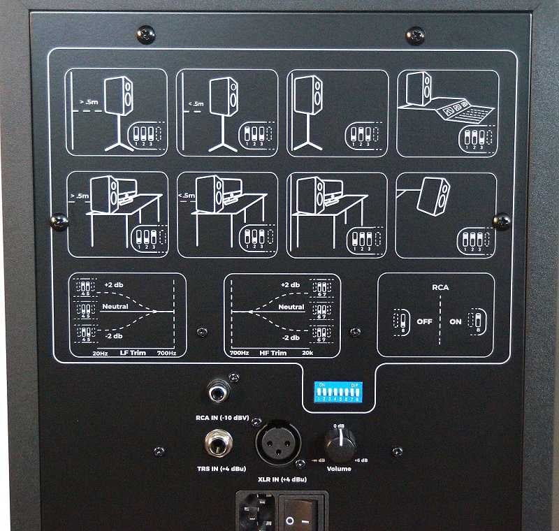

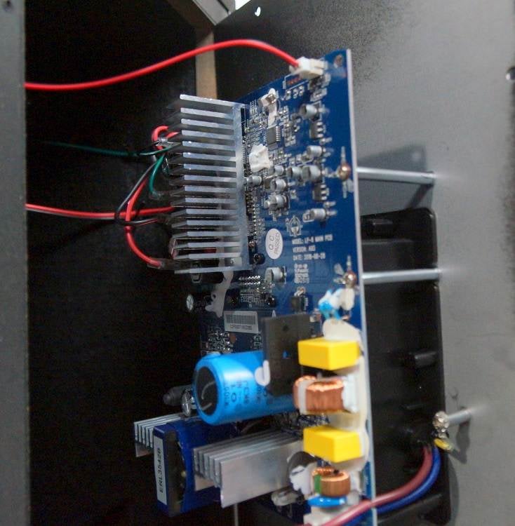

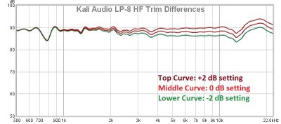

The LP-8 woofer uses a dedicated 60-watt amplifier, and the tweeter uses a 40-watt amplifier with a 1.8kHz crossover between the drivers. The combined 100 watts should allow the LP-8 to get quite loud at typical mixing console listening distances. For home use, that should be enough power for most people’s listening tastes as well, even though they might be at a farther distance. The DSP abilities of the amp should allow the designers to easily EQ out any serious resonances, so hopefully, we get a neutral response right out of the box. The amp can be connected by balanced TRS or XLR inputs and an unbalanced RCA input.
There are ways to alter the response with dip switches on the amp panel to compensate for different acoustic conditions. The default position of the dip switches set the speaker up for a neutral response in a free space that is not close to any large surfaces or boundaries, however, proximity to surfaces and boundaries can cause havoc on the sound thereby wrecking a tonal balance. The dip switch settings can be adjusted to compensate for sub-optimal acoustic conditions, for example, if the speakers are set up next to a wall, or on a mixing console, or on a shallow desk or some mixture of those conditions. What they are adjusting for is boundary gain which can inordinately boost the bass levels; the closer the speaker is to any boundary or surface, the more bass the sound will naturally induce as an acoustic consequence. While it is a nicety for home audio products to have an accurate response, it is critical that studio monitors do so, so this is an important feature. If you are mixing sound with more bass than you realize, the produced content will have a shortfall of bass since you inadvertently compensate for the excess bass.
The front baffle of the LP-8s is a plastic molded piece that feels relatively solid. The side panels are made from ⅝” MDF and are internally lined with a thick layer of stuffing. The port is a shaped slot port that is flared on both ends to reduce turbulence. Kali Audio claims to use airflow simulations to optimize the laminar flow of air in the port.
All of these design details look to add up to a whole lot of speaker for the $500/pair asking price. Let’s now give them a listen to hear what they sound like…

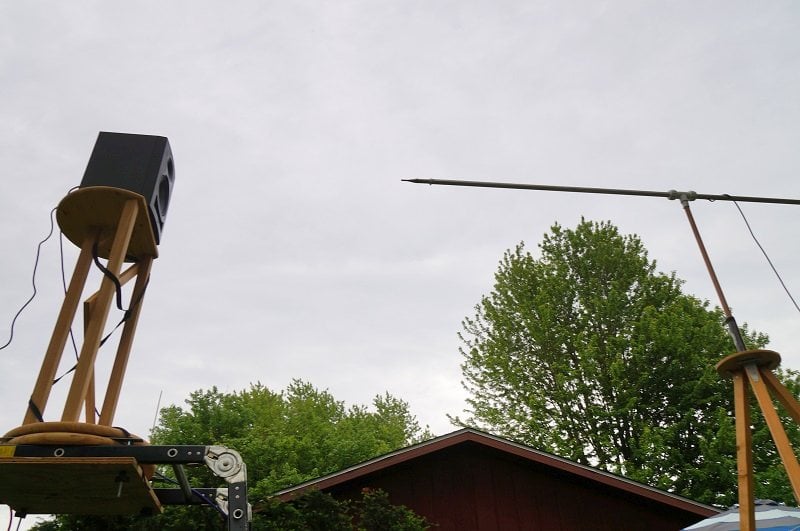

Kali Audio LP-8 Monitor Measurements & Conclusion
The Kali Audio LP-8 speaker was measured in free-air at a height of 7.5 feet at a 1-meter distance from the microphone, and the measurements were gated at an 11-millisecond delay. In this time window, some resolution is lost below 250 Hz and accuracy is completely lost below 110 Hz. Measurements have been smoothed at a 1/12 octave resolution.
The above graph shows the direct-axis frequency response and other curves that describe the speaker’s amplitude response in a number of ways. For more information about the meaning of these curves, please refer to our article Understanding Loudspeaker Measurements Part 1. The first thing to notice is that it is a terrifically flat response overall. There is a high-Q dip around 800Hz, but existing research has shown is that narrow dips like that one are not very audible. The response rises to a bump past 15kHz, but there isn’t much content in that range, and many people’s hearing isn’t very good in that range either, so that bump is not very consequential. The listening window curve and early reflections curve have a very good correspondence to the on-axis response, so the LP-8 should have the same sound over a wide angle from the on-axis direction. This graph depicts what I had heard in listening to these speakers: neutrality. They are a balanced, accurate loudspeaker, and that is exactly what you would hope to see in a studio monitor.

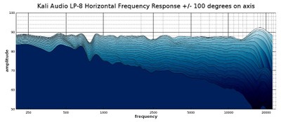

The above graphs depict the speaker’s lateral responses out to 100 degrees in five-degree increments. More information about how to interpret these graphs can be read in this article: Understanding Loudspeaker Review Measurements Part II.
Looking at the horizontal axis in individual measurement angles, we get a close look at just how superbly the LP-8 waveguide is controlling directivity. This waveguide is excellent. There is also outstanding directivity matching between the woofer and tweeter. I can’t even see a hint of the crossover point in here. This speaker will sound the same at any reasonable listening angle in front of it. Another advantage of such good directivity behavior is that any acoustic reflection will resemble the direct sound at the listening position, so this speaker should work well in a wide variety of acoustic conditions. You shouldn’t need to resort to using acoustic treatments to get these speakers to sound good. It is apparent that a uniform dispersion pattern was taken very seriously as a design goal in the LP-8s.
The above polar map graphs show the same information that the preceding graphs do but depict it in a way that can offer new insight regarding these speakers’ behavior. Instead of using individual raised lines to illustrate amplitude, these polar maps use color to portray amplitude, and this allows the use of a purely angle/frequency axis perspective. The advantage of these graphs is they can let us see broader trends of the speaker’s behavior more easily. For more information about the meaning of these graphs, we again refer the reader to Understanding Loudspeaker Review Measurements Part II.
Here we can better see how far off-axis the listener can be in before we start losing output versus frequency. What can be seen is that you could be listening out to a 50-degree angle from the front axis while still getting a full, even sound up to 15kHz. This adds up to a 100-degree angle of a good tonal balance and loudness in front of the speaker. Probably not many people will be listening at a 50-degree angle, but, with the LP-8s, you could, and they would still sound good. There are advantages to this sort of dispersion pattern even if you only listen directly on-axis; the early reflections are a major contribution to what we perceive as sound quality, and for the best sound, they should have as close correlation to the on-axis sound as possible. These speakers do that admirably well.
The above graph shows the LP-8’s response behavior along its vertical axis where zero degrees is directly in front of the tweeter, negative degree values are below the tweeter, and positive degree values are above the tweeter. The LP-8s make a good showing here for a two-way speaker of their design type. They maintain a full and even response down to 20 degrees below the on-axis angle and 10 degrees above. This is a bit better than normal, and most listening positions will fall within this angle. Nulls from crossover cancellation don’t really kick in until outside of this angle. This means that for the best sound, as always, try to listen around tweeter height, but the sound won’t change much if listened at a somewhat lower angle as well, so you don’t need the speakers aimed directly at you if they are mounted at a slightly higher elevation than your listening position.

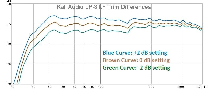

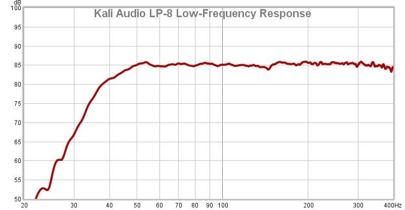

The above graphs show the LP-8’s low-frequency responses that I captured using groundplane measurements (where the speaker and microphone are on the ground in a wide-open area). Again, we see an admirably flat response, here down to 50 Hz with a strong response down to 40 Hz. These things have real bass, and it is accurate bass. This bass extension covers almost any kind of acoustic music with a few extreme exceptions such as some pipe organ music. This is enough to handle much of the range that electronic music uses as well. Even the rowdiest dubstep music rarely reaches below 40 Hz. Most music listeners could easily get by without subwoofers using the LP-8s.

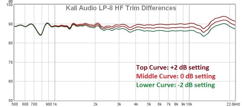

The above two graphs exhibit a few of the changes that can be made to the response using some of the dip switch toggles on the amp plate (note the “LF Trim” graph has a much tighter Y-axis window than preceding graphs). There are a lot of different ways to alter the response, and these are just a handful of some of those altered responses. For those using these speakers for applications where accuracy is a must such as mixing and content creation, there are a bunch of different boundary compensation settings that can be used, but it is strongly advised that the response is verified with measurements in situ, as no two acoustic settings are exactly alike, and they will impact the low-end frequency response in different ways that can’t be perfectly anticipated.
