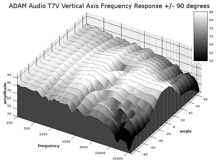

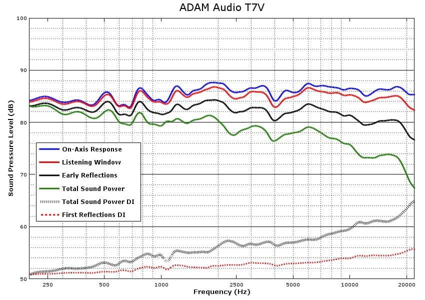

- On-axis response is not as restricted as would be hoped for in a monitor
- Narrow vertical response requires tweeter level listening

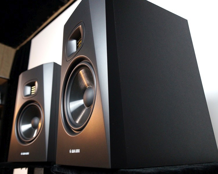

In for review today, we have the T7V, a two-way near-field monitor with a 7” woofer and 1.9" AMT waveguide tweeter that retails for $500/pair. What separates these from ADAM’s higher-end models is fewer features and less powerful amplification. However, the fundamental sound quality should be largely intact, minus some dynamic range. Now, let’s dive in to see what ADAM has brought into this price range.

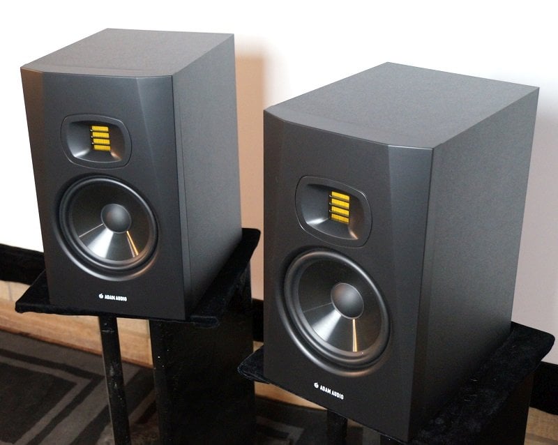

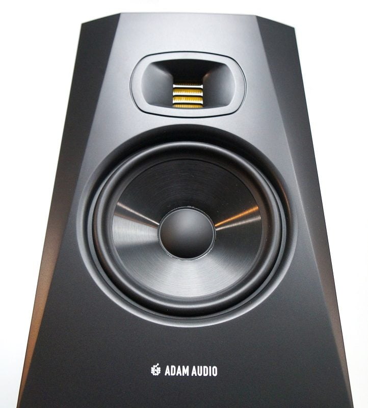

Appearance
One paradox a
bout ADAM Audio’s budget T series is that they look
quite a bit nicer than ADAM’s more expensive speakers. In removing some of the
features of the higher-priced series, ADAM has simplified the industrial design
which has cleaned up their appearance. While monitors are supposed to be just a
tool for accurate sound reproduction and aesthetics should take a distant back
seat in favor of sound quality, this series of reviews of monitors for
Audioholics are also looking at their potential for home audio application, so
looks matter for our purposes. As a speaker for home use, the T7V looks nice.

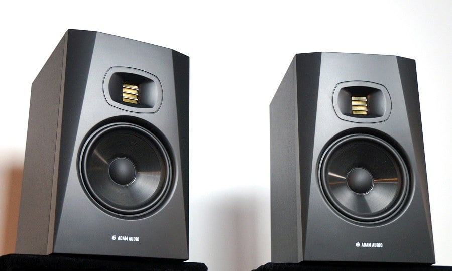

The T7V uses a molded plastic front baffle with a smooth exterior that could pass for a satin black finish. There is an increase in upwards beveling that lends the cabinets some style while ostensibly reducing baffle diffraction. A shiny, black polypropylene woofer with a flat black dustcap blends in with the satin black baffle, while a gold-colored AMT tweeter mounted in a shallow waveguide breaks the monotony of black with a touch of class. A small ‘ADAM AUDIO’ logo adorns the bottom of the front baffle. A textured vinyl wrap is used on the side panels. Overall these look nicer than most studio monitors and could pass for home audio speakers if one were to use them in that application.

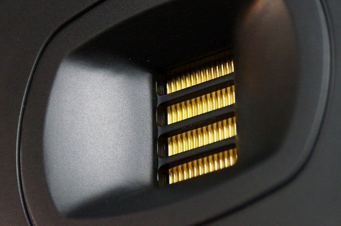

As was mentioned before, ADAM Audio’s
chief feature has always
been the use of AMT tweeters. Back when ADAM Audio first launched, AMTs were
not widely used, but nowadays they are fairly common. AMT stands for “Air
Motion Transformer.” As opposed to a conventional dome tweeter that
pistonically oscillates a little dome, AMT tweeters contract and expand the
folds of a pleated membrane to produce sound. To explain using an example,
imagine the folded surface of a half-closed curtain- then line the interior
folds of the curtain with conductive rods on adjacent sides of the folds, and
set two powerful magnets on the sides of the curtain. Run some alternating
current through the conducting rods and their newfound electromagnetic field
will rapidly collapse and expand the folds of the curtain, and, in doing so, squeeze
air in and out of the folds, thereby creating pressure waves that we experience
as sound.
A major advantage of AMT tweeters is that since the folds of the diaphragm are much deeper than they are wide, the air is ejected out at a much faster speed than the vibration of the diaphragm itself- as much as five times faster. Another advantage is the very light mass of the diaphragm, which makes it very easy to move and to change direction since it does not have the momentum of the weight of a typical dome tweeter. These elements give AMT tweeters an extended response well into ultrasonic frequency ranges. Also, since AMT tweeters can have a relatively large surface coupled with the air, they can have a very wide dynamic range.

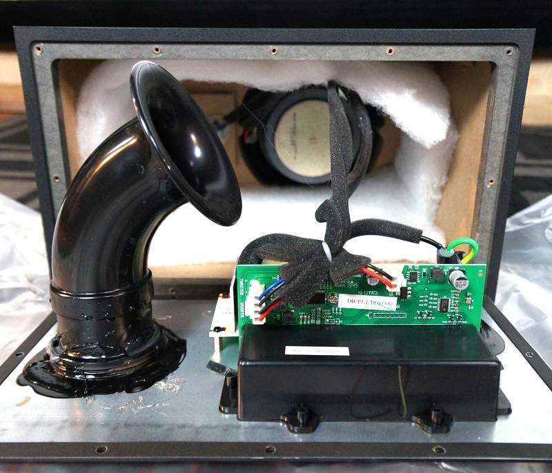

The tweeter is mounted in a waveguide that ADAM Audio calls the ‘HPS Waveguide.’ It was designed with computer modeling to have a wide, even horizontal dispersion with a narrow vertical dispersion. The tweeter is crossed over to a 7” polypropylene woofer at 2.6kHz. ADAM Audio claims a 39Hz low-frequency extension, but they do not give a tolerance to that number. I would guess it is a -10dB figure, but we shall see in the measurements.

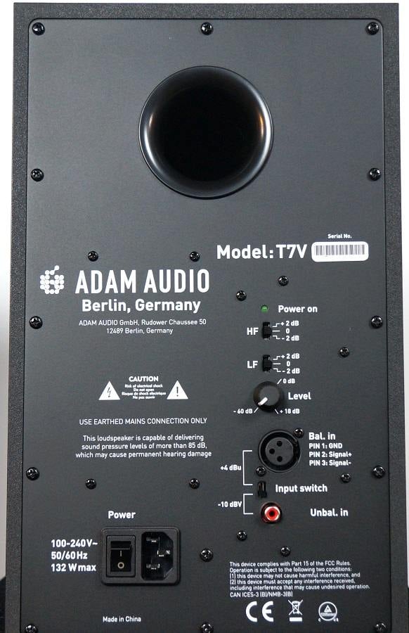

The T7V is a
self-powered speaker that has a class-D amp for each
driver. The woofer uses a 50-watt RMS amplifier while the tweeter uses a
20-watt RMS amplifier. ADAM’s literature says that a pair of these things can
hit 110dB at 1 meter. That is quite loud to be sure, but they don’t mention any
distortion figures in that specification, which is needed to make it more
meaningful. The T7V’s can accommodate an unbalanced RCA input or a balanced XLR
input. I would like to have seen a TRS input, but its omission is not a big
deal. The output can be controlled by a gain knob along with a high-frequency
shelf filter and low-frequency shelf filter. Each filter can adjust the
response by +/-2dB.
The cabinet uses ½” MDF side-panels with a 1 ½” thick front baffle. The interior is lined with a thick layer of polyfill damping. The T7V is a rear port-ported speaker that uses a 2” diameter port that has a constant curvature with flaring on both sides.
Overall, the T7V looks sensibly designed with attention to detail along with some promising design decisions. Let’s now see how it sounds in practice.

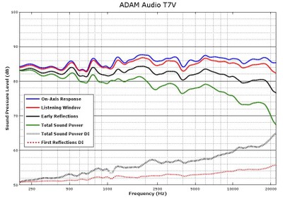

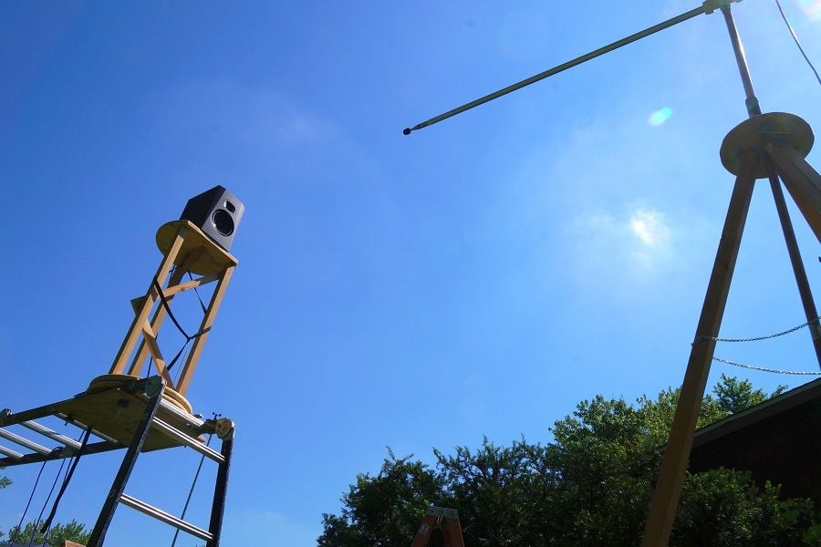

The ADAM Audio T7V speaker was measured in free-air at a height of 7.5 feet at a 1-meter distance from the microphone, and the measurements were gated at an 11-millisecond delay. In this time window, some resolution is lost below 250 Hz and accuracy is completely lost below 110 Hz. Measurements have been smoothed at a 1/12 octave resolution.

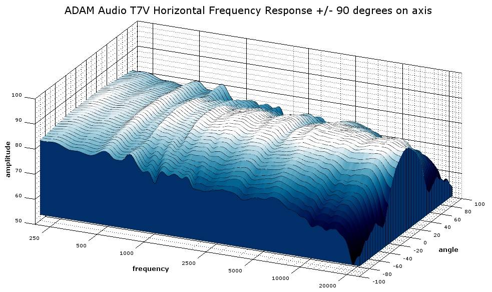

The above graph shows the direct-axis frequency response and other curves that describe the speaker’s amplitude response in a number of ways. For more information about the meaning of these curves, please refer to our article Understanding Loudspeaker Measurements Part 1. The response here isn’t perfect but it isn’t bad either. The chief problem is that there is a slight imbalance in the overall response that occurs in the upper midrange, at around 1.5kHz. It is as if there is a slight shelf filter that bumps up the response from that point upwards by about 2dB on average. The T7V would have a relatively flat on-axis were it not for that discontinuity. I didn’t notice this imbalance in my listening, although I did feel that the speaker did have a crisp and detailed quality. A response like this accentuates the upper harmonics of voices and instruments but doesn’t put emphasis on any single narrow range since it is all elevated. The problem is that a studio monitor should not be accentuating anything. The good news is that there is good correlation between the on-axis response and off-axis responses which we can see in the smooth directivity indexes, so there doesn’t seem to be any directivity errors, and this speaker could be reliably equalized since its reflected sound should be a good match for its direct sound.

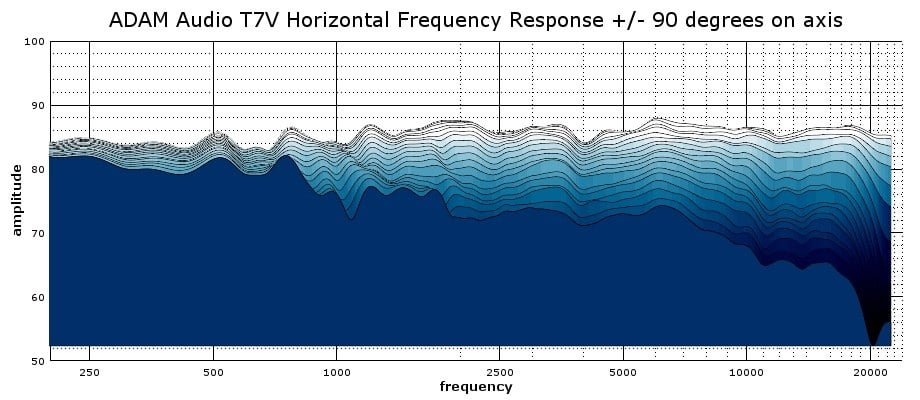

The above graphs depict the speaker’s lateral responses out to 90 degrees in five-degree increments. More information about how to interpret these graphs can be read in this article: Understanding Loudspeaker Review Measurements Part II. If one takes the time to look closely, one thing that can be seen on the above graphs is that the elevated upper ranges do get flattened out with respect to the lower range at off-axis angles. In fact, the responses from twenty to thirty degrees fall within a relatively tight window. The thirty-degree angle holds the response tight within about a +/-1.5dB window from 200Hz to 18kHz. The most accurate response occurs within this angle range, and those who want the least coloration in the sound should have the speaker angled so they are listening to the speakers at a twenty to thirty-degree angle. The waveguide looks to be doing a good job of maintaining uniform directivity over the tweeter’s bandwidth.

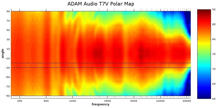

The above polar map graphs show the same information that the preceding graphs do but depict it in a way that can offer new insight regarding these speakers’ behavior. Instead of using individual raised lines to illustrate amplitude, these polar maps use color to portray amplitude, and this allows the use of a purely angle/frequency axis perspective. The advantage of these graphs is they can let us see broader trends of the speaker’s behavior more easily. For more information about the meaning of these graphs, we again refer the reader to Understanding Loudspeaker Review Measurements Part II.
As we have seen before, the directivity is pretty well controlled for the most part. The tweeter does begin to beam a bit, but that doesn’t occur until around 10kHz so isn’t likely to be of much audible consequence. If we track the horizontal traces at twenty degrees and thirty degrees, we see pretty much just a solid hue of red indicating a response without much deviation. Again, that seems to be the most neutral angle of this speaker’s output. That kind of listening angle can typically be achieved by having the speakers facing straight ahead in parallel rather than having them face the listener directly. Perhaps ADAM Audio assumed that the user would give them that kind of placement and designed them accordingly? The only problem with that theory is that ADAM clearly states in the user manual that the speakers should be aimed directly at the listener.
The above graph shows the T7V’s response behavior along its vertical axis where zero degrees is directly in front of the tweeter, negative degree values are below the tweeter, and positive degree values are above the tweeter. In this graph, we can see that the best responses occur on-axis and ten degrees below. Above and below that range, crossover cancellation starts putting holes in the response, which is typical of two-way designs like this. Still, that is a relatively narrow vertical angle to be listening in. These speakers sound best where the tweeter is level with your ears or slightly above your ears.

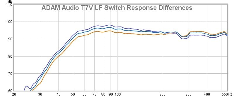

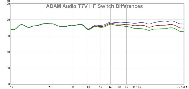

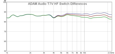

The above graph exhibits the changes that can be made to the response using the ‘HF’ switch on the amp plate with the blue curve representing the ‘+2dB’ position, the red curve representing the ‘0dB’ position, and the green curve representing the ‘-2dB’ position. The most neutral sound happens with the T7V set to ‘0dB.’ If you want a bit more of an aggressive sound, set it to ‘+2dB,’ but if you want the treble to be a bit more laid back, use the ‘-2dB’ setting.

under review, and, as usual, I will start with the weaknesses. The only real
flaw in the ADAM Audio T7V is that it is not as fully tonally balanced as one
would expect in a studio monitor. There is a slight elevation in the response
from about 1.5kHz and above, and while that wouldn’t be terribly significant
for recreational listening, that response couldn’t help but impact the sound
mix for content creation which is what these are made for. Anyone who uses
these monitors to create a sound mix may find that their recording will sound
slightly recessed on a neutral sound system. One workaround for this is to
listen at about a 25-degree angle instead of an on-axis angle. Another slight
aberration is that the low-end is not neutral either, and the elevated bass is
going to impact the mix as well. The good news is that can be easily alleviated
by setting the ‘LF’ switch to ‘-2dB,’ but the problem here is one would
naturally assume that the ‘0dB’ setting yields a neutral response, and that is
not the case. If you mixed content with the ‘LF’ switch at ‘0dB’ or especially
‘+2dB,’ you may find your mix sounding a bit thin on bass in other sound
systems.
