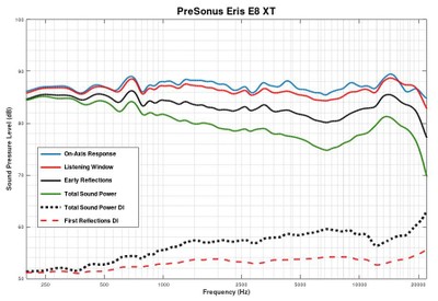

  • Neutral, accurate response
  • Good dynamic range
  • Nice look for a studio monitor
  • 40 Hz extension
  • Useful tone control knobs
  • Includes high-pass filter for easy subwoofer integration
  • Crossover null occurs close under on-axis angle

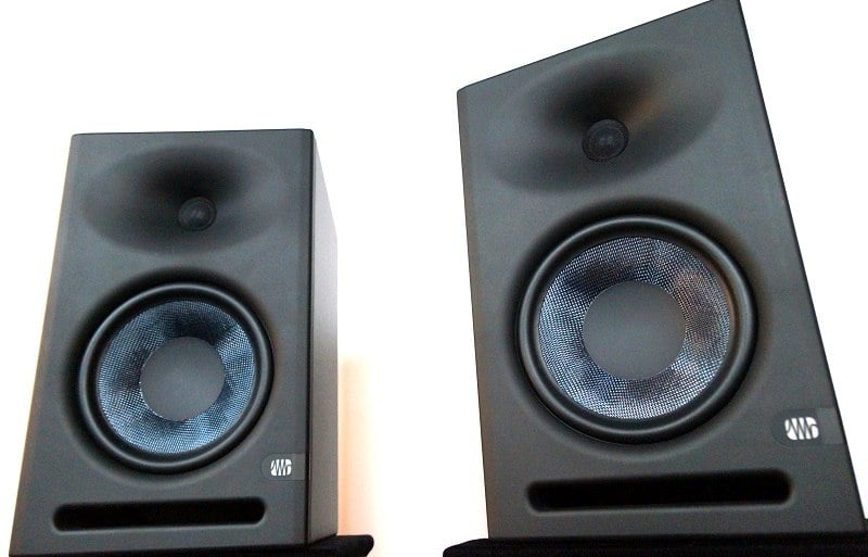

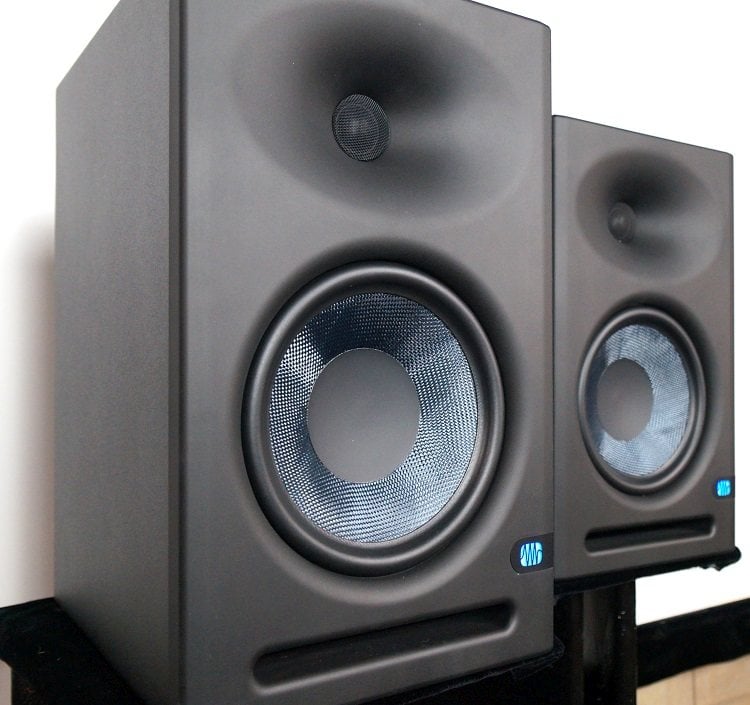

Continuing our serieEris pair13.jpgs of reviews of studio monitors, we have the PreSonus Eris E8 XT. Like many of the other monitors in its class, it is a self-amplified design using an 8” woofer and a tweeter loaded into a waveguide. It has a lot in common with the Kali Audio LP-8 including similar size and weight, a slot port under an 8” woofer, an elliptical waveguide around a dome tweeter, and a host of response-shaping options on the amp. It is among the more popular monitors for online retailers of pro-audio gear so we thought it would make for a good inclusion for our look at monitors. PreSonus has been around since 1995 where they started manufacturing studio gear such as compressors, limiters, audio interfaces, and mic preamps. They started producing loudspeakers in 2014, and the Eris line was one of their first series. In the short time since their launch, the Eris series has become one of the best-selling studio monitors on the market. This brings us to the question of what the Eris series has done to garner that level of success in such a short time frame? What is so special about these speakers? Let’s dig in to find out….
Appearance

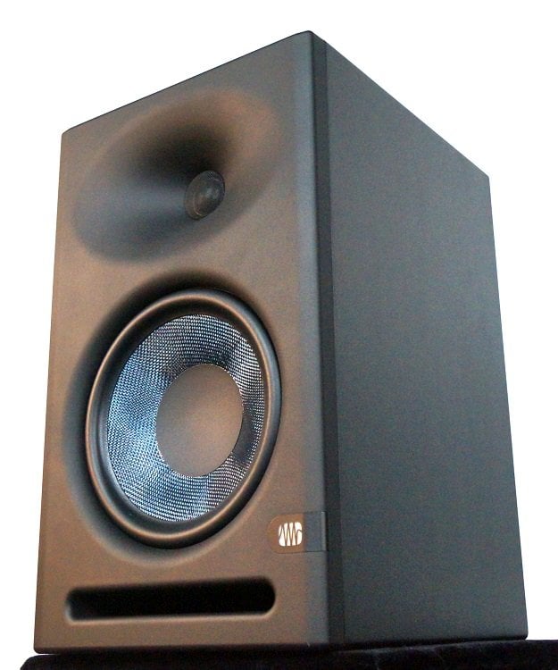

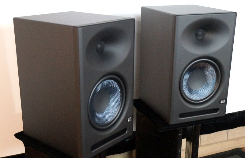

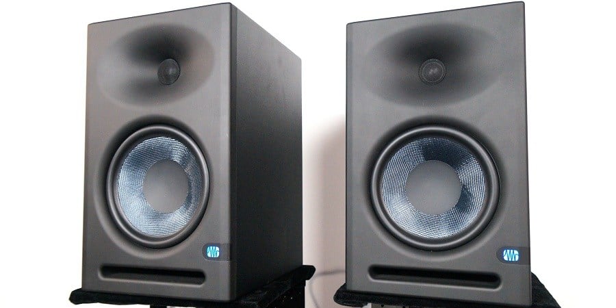

Among monitors, tEris pair.jpghe Eris E8 XT monitors look pretty darn good. Looks shouldn’t normally be a high priority for selecting a studio monitor, but in reality, appearance does affect the purchase, and as monitors go, the E8 XT is pretty slick looking. It has a smooth front baffle with no screw holes and gently sculpted curves for the waveguide and woofer mount. A blue woven-fiber woofer cone adds a cool and distinctive touch. A small PreSonus logo below the woofer glows when the speaker is powered. I think this speaker looks as good as many home audio speakers I’ve seen. It is so minimalist there is not much more that I can say about its looks. If PreSonus made a white version of this speaker, that would actually have a very high ‘spouse approval factor’ for a studio monitor. What is holding it back from having a place in a living room is the dark grey color.

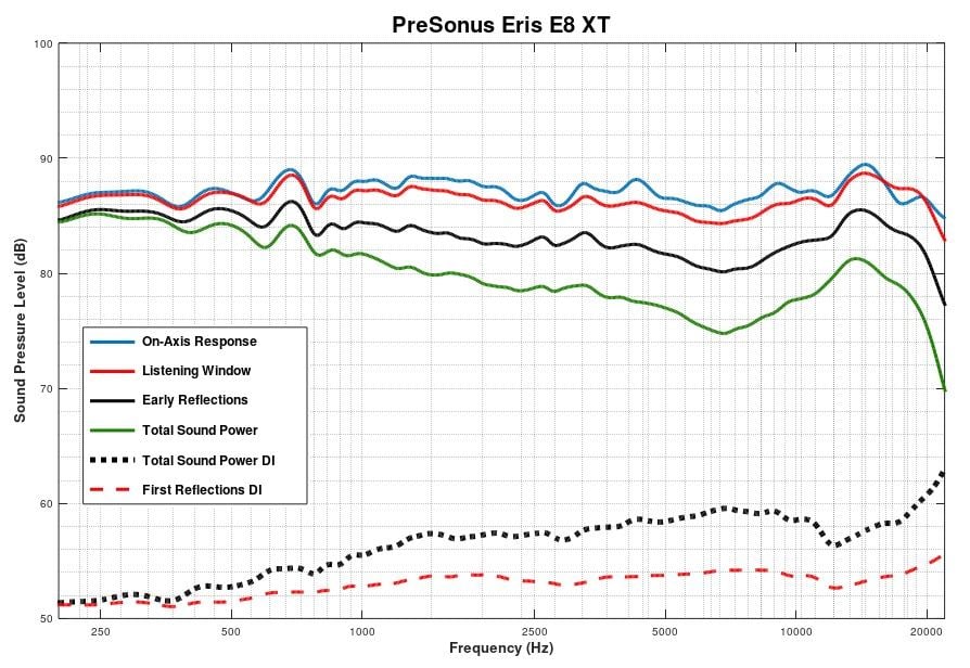

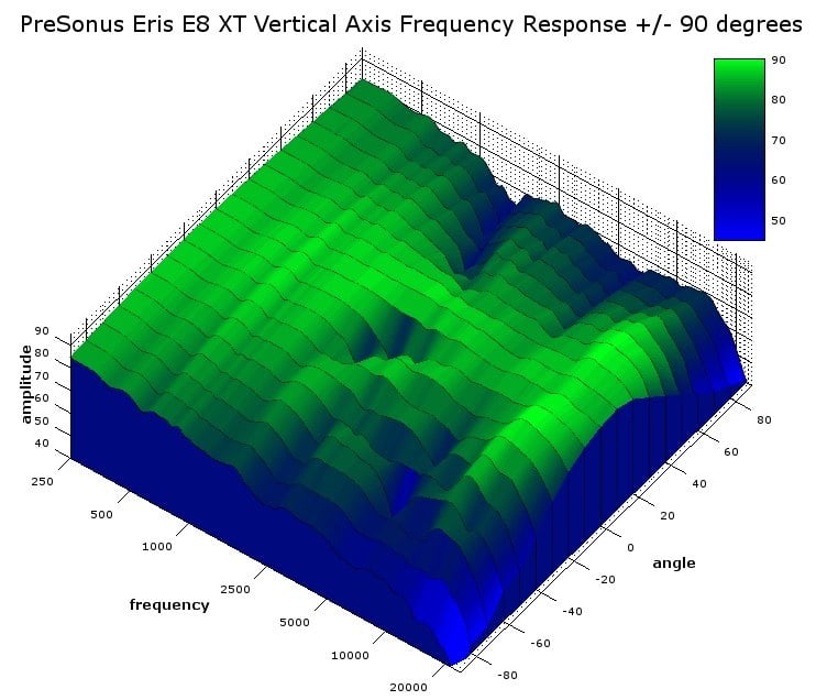

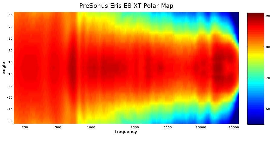

Design Analysis

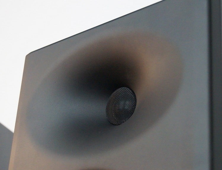

The Eris E8 XT occupies the 8” woofer range of studio monitors that have a bit more dynamic rEris tweeter2.jpgange and extension than their 5” or 6.5” counterparts, so it is a somewhat large speaker and a bit hefty at 23 lbs. The cabinet is made from ⅝” MDF with a vinyl laminate and a molded plastic front baffle mounted on an MDF face. There is a thick layer of polyfill lining the interior. It has a 1.25” silk dome tweeter with a rear-mounted heatsink set in a waveguide that PreSonus calls the EBM waveguide (where EBM stands for Elliptical Boundary Modeled). This waveguide is designed for a 100°x60° coverage which provides broad horizontal dispersion and narrow vertical dispersion. PreSonus doesn’t mention directivity control in any discussion about the waveguide, but the shape of the waveguide looks as though that could have been a guiding principle in the design. The measurements will tell us what PreSonus’ priorities were in the waveguide design when we look at the test results.

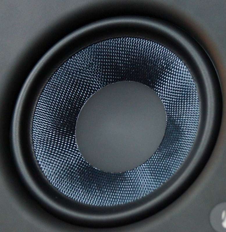

PreSonus Eris E8 XT 8" Woofer

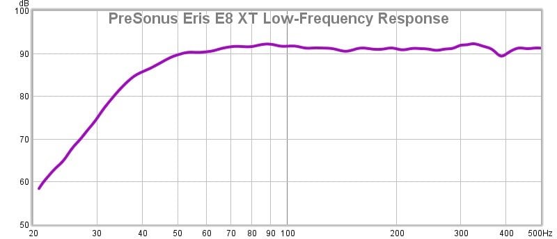

The 8” woofer uses a woven composite cone that has a beefy-looking surround. It uses a ¾” thick, 4” diameter magnet on the motor that is vented through the pole piece. Underneath the woofer is a slot port. PreSonus claims a 35Hz low-frequency extension but doesn’t give a window for that figure. That extension spec needs more context to be meaningful, but we will get a look at the extension in the measurements. The woofer is driven by a 75-watt amplifier and the tweeter is driven by a 65-watt amplifier for a combined total of 140 watts of amplification using a class A/B amplifier (although none of that is specified as peak, RMS, or continuous). The crossover frequency between woofer and tweeter is listed as 2.2kHz. The specs also list a 105dB maximum peak SPL at 1 meter, and that should be adequate loudness for pretty much anyone.

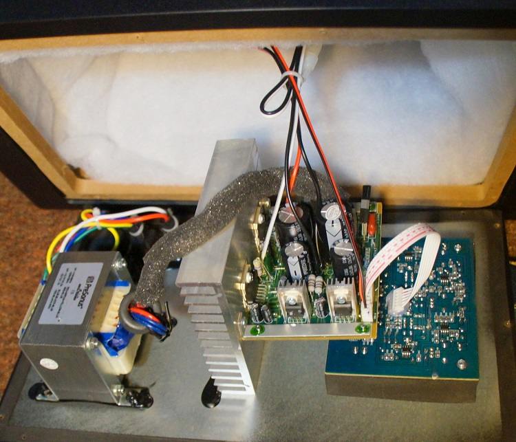

Internal look at the Amplifier of the ERIS E8 XT

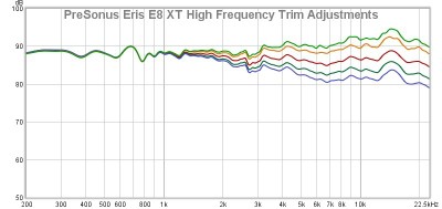

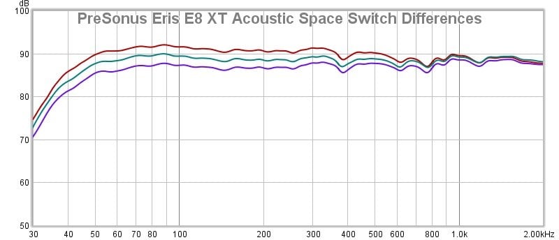

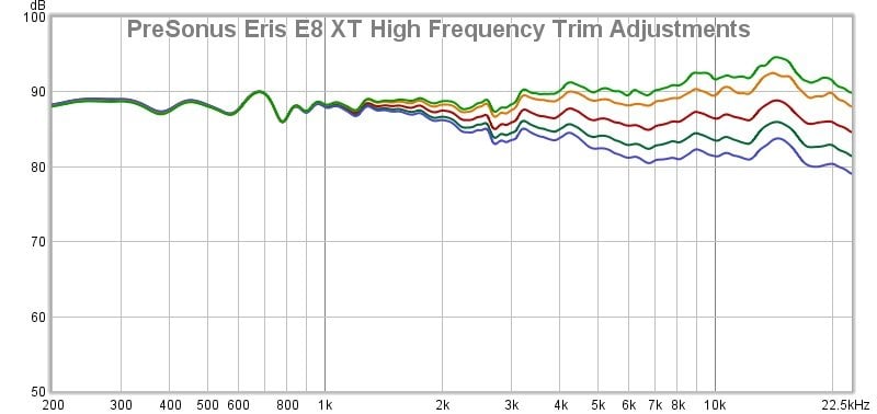

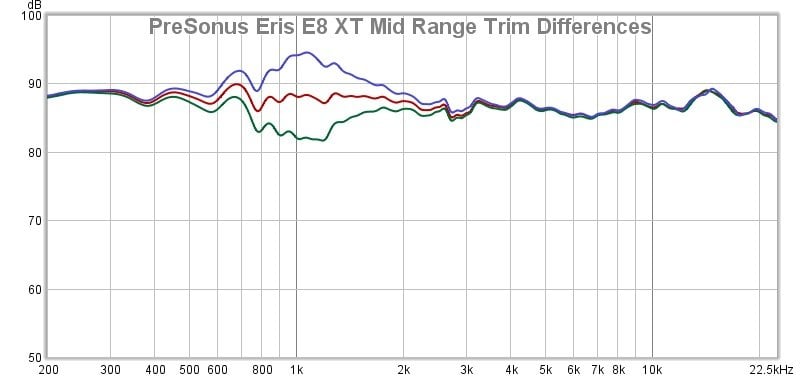

Connectivity is comprised of balanced XLR and TRS inputs and an unbalanced RCA input. There are a host of controls that can alter the frequency response to compensate for different acoustic conditions. A boundary gain level switch can cut the low-frequencies by 2 or 4 dB which can come in handy where the E8 XT has to be placed near surface boundaries which can disproportionately boost bass. There is a high-pass filter that can come in useful if the E8 XT is paired with a subwoofer in a system with no bass management. It can set the filter frequency at 100Hz, 80Hz, or let the speaker go as low as possible. That high-pass is a really good idea since most ‘prosumer’ audio systems don’t have an easy way to blend a sub in with the speakers; this allows the speaker to cross over to the sub in a much more controlled manner, especially since most subs have adjustable low-pass filters. The E8 XT also has knobs that can boost or cut the midrange frequencies or treble by 6 dB. Along with these response shaping controls, there is a gain knob.
The overall design suggests a high performing monitor, but let’s set theory aside for now and see how it all adds up in practice by giving the Eris E8 XTs a listen…
