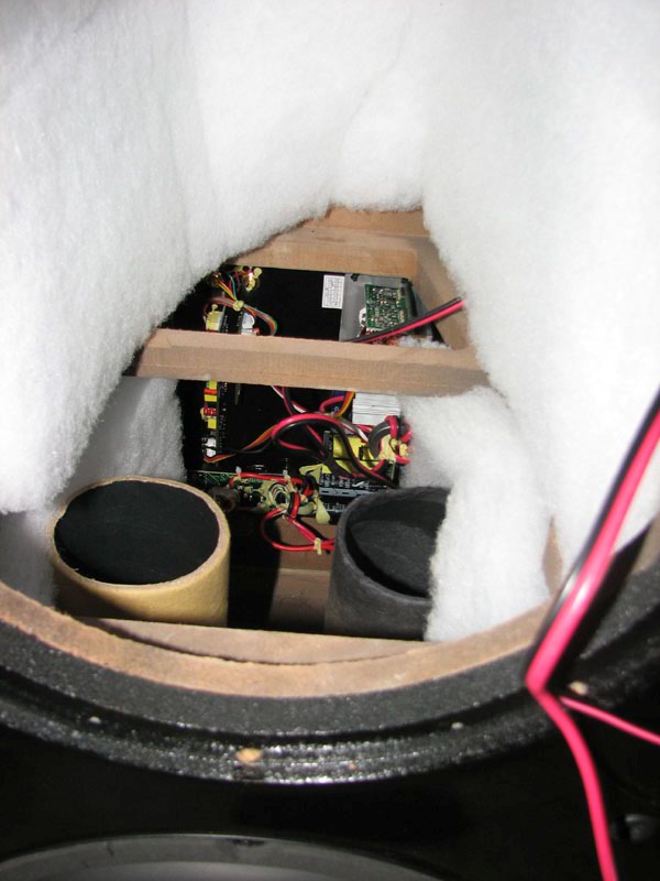

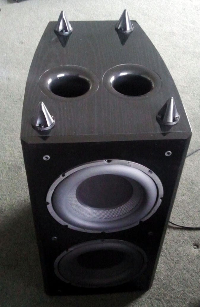

Although the EMP ES1010i sub is rather lightweight for its size, its internal build quality indicates that it isn’t too shabby. Rather than using the square hollow box I often find with subwoofers at this price point, EMP employs a rigid and thick cross brace, plenty of insulation and a double thick front baffle. The side walls are a bit thin at 0.6” but EMP didn’t cut corners on the front baffle, sandwiching two 0.6” sheets of MDF to yield a whopping 1.2” thick layer. This is arguably where you need the most rigidity in a subwoofer since you’ve got heavy recessed mounted drivers affixed to it. The contoured shape of the cabinet also really gives a classy look to this product which should win over points with your significant other. The ES1010i is available in two finishes: red burl (as reviewed) and black ash. I feel the red burl looks particularly stunning from a distance but don’t mistake it for the type of finish you would get in a multi thousand dollar unit. Only upon close inspection do you notice its flaws which are certainly far more forgiving than other units I’ve seen at this price.
EMP ES1010i Internal Look (left pic) ; bottom firing ports (right pic)
There are two 3” bottom firing port tubes which appear to be constructed from thick cardboard material. The ports are flared on the outside of the cabinet (good) but not in the inside (not so good). My review units had the standard size port tubes. EMP has since then made a running change to lengthen the ports to increase low end bass extension which is discussed in greater detail in the measurements portion of this review.

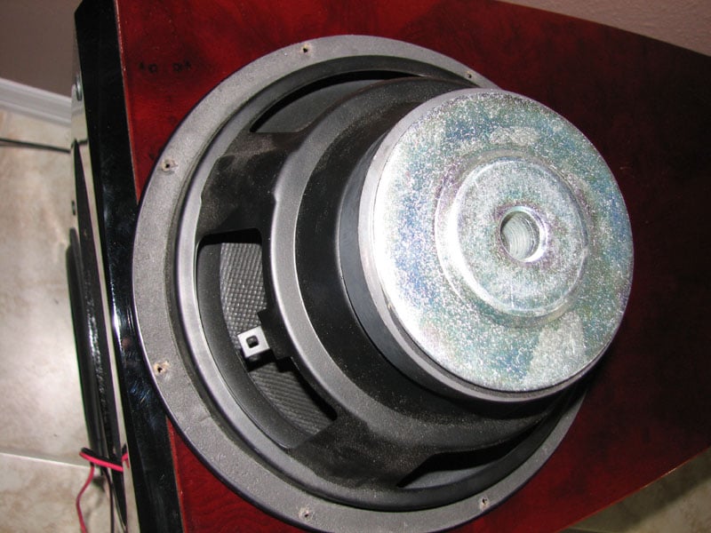

EMP ES1010i Subwoofer Driver
The ES1010i employs two 10” poly matrix cone (fancy term for a type of plastic construction) drivers each with a 1” wide butyl rubber surround, a stamped frame with a fairly hefty motor structure (40 oz) and vented pole piece, and a 2” voice coil. This driver is similar to the one found on their ES10i subwoofer but is 8-ohms instead of 4-ohms and has a slightly higher complaint spider to the lower resonance frequency allowing the sub to play down lower thus increasing its extension. While this driver is rather generic in construction, strength in numbers helps by placing two of them into the enclosure to increase output while also lowering distortion.

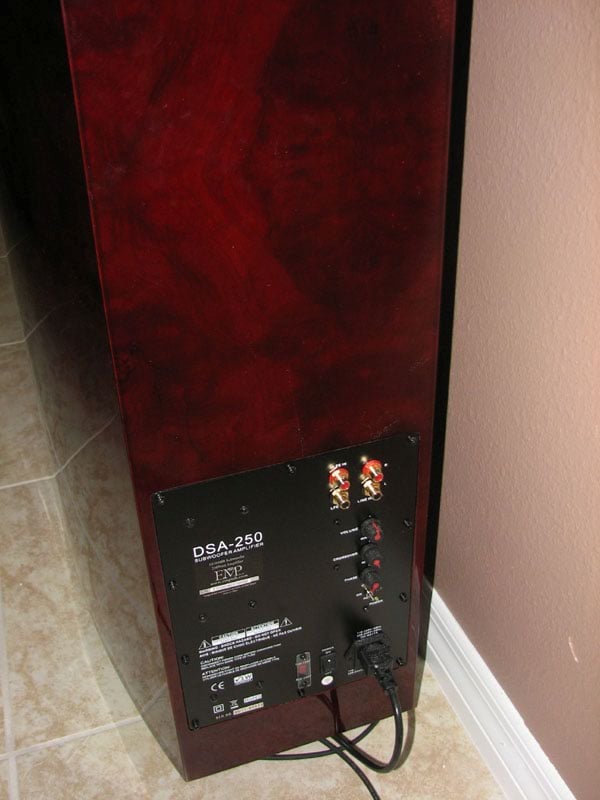

The ES1010i plate amp model # DSA-250 is a 250 watt linear Class D amplifier with continuous variable phase and crossover control (surprising at this price point). The subwoofer crossover is adjustable from 50Hz to 150Hz but can also be defeated by utilizing the LFE input of the sub. The ES1010i also has stereo L/R inputs and outputs. The sub has auto-on capability and a detachable power cord. It also features an analog limiter to ensure that, no matter how hard you drive it, you cannot cause it to misbehave or destroy itself.

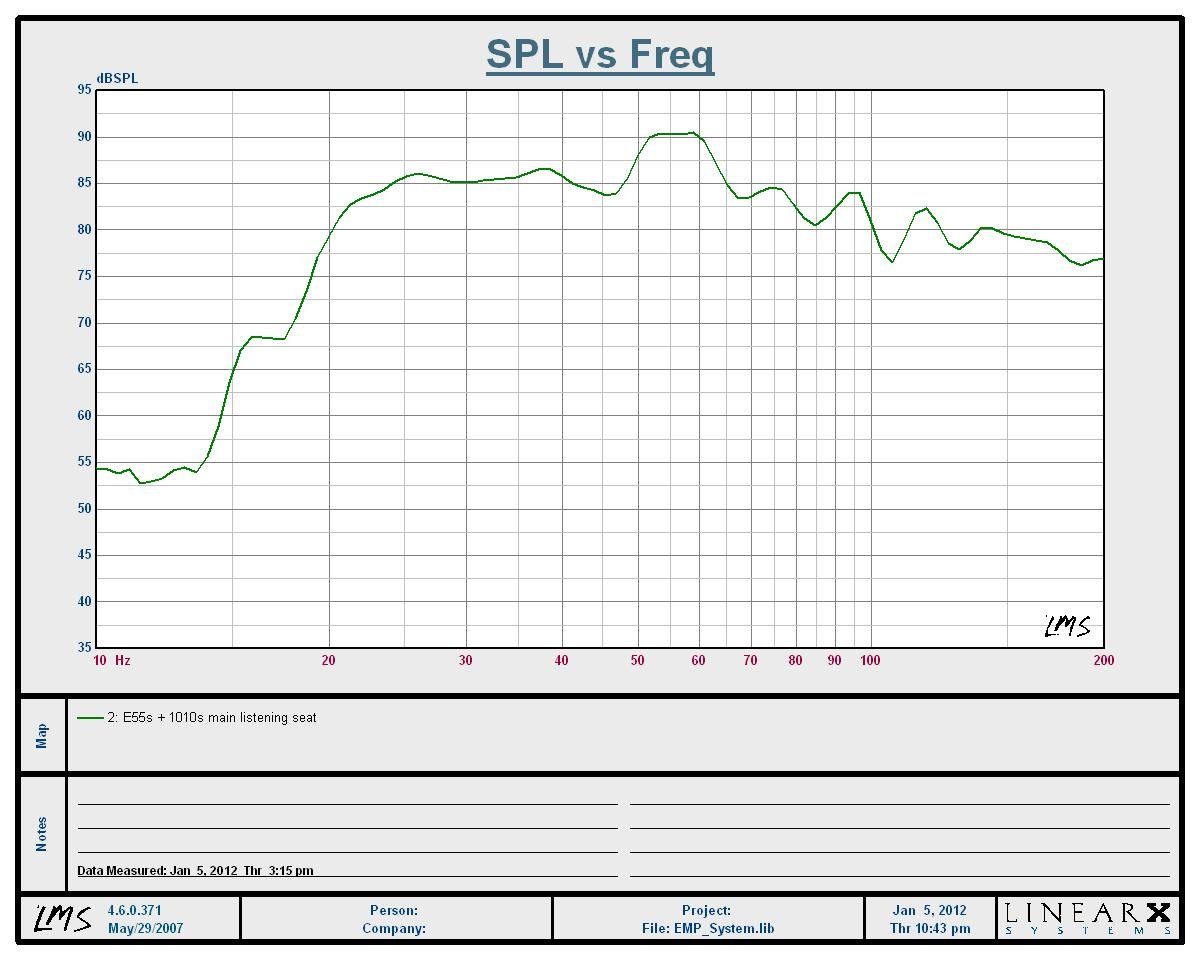

After pulling measurements at the primary listening seats, I did some quick listening tests in two-channel to make sure I achieved proper integration between the front speakers and subwoofer(s). Success. By running the E55Ti’s full-range, the system was able to produce a very full sounding bass response and seamless transition between the front towers and the subs. Although the ES1010i’s output is rather limited below 30Hz, room gain was my friend as you can see with the measurement below taken at the primary listening area.
In-Room Frequency Response of (2) ES1010i subwoofers + E55ti Towers at the Listening Position
This measurement was pulled at the primary listening area 12ft from the front of the room. This is a very linear response achieved maintaining +-5dB from 20Hz to 100Hz. The modified ES1010i subs with longer port tubes would have produced 2-3dB more gain in the 25-30Hz region for this install, so you can expect more performance than what I was able to achieve on products shipping to actual customers.

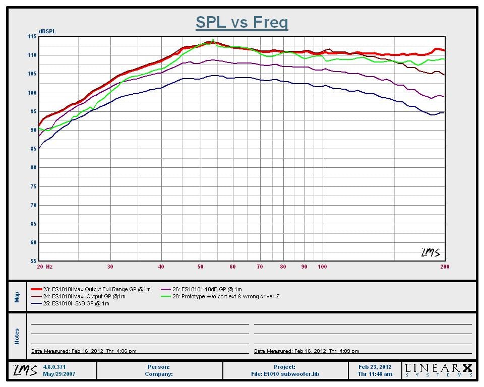

EMPtek ES1010i Subwoofer Review Measurements and Analysis
All tests were conducted using 1 meter groundplane technique outdoors. The mic was placed on the floor firing at middle of the cabinet surface containing the dual 10” drivers. The grille cover was removed during this testing. All tests were conducted using continuous reverse sine-wave sweeps. Sweep tones tend to really stress a subwoofer as the motor structure warms up and pushes the sub out of its nominal operation like it would in real world usage but they don’t always allow for the ability to find max SPL per discrete frequency like the CEA2010 test method. This is why it’s important to make apples to apples comparisons in our published tabulated data tables when viewing subwoofer output levels tested either to CEA-2010 or reverse sine-wave sweep testing.
For more information, see: Audioholics Subwoofer Measurement Data Compilation & Report
EMPtek ES1010i SPL vs Frequency (1 meter groundplane)
The ES1010i review sample I initially reviewed accidentally had a 4-ohm driver installed from their ES10i subwoofer model which lowered the overall impedance the amplifier saw to 2.7-ohms instead of 4-ohms (by running two 8 ohm drivers in parallel). This put more strain on the amplifier and thus dropped the overall output almost 3dB below 40 Hz as you can see in the green trace. EMP has since then sent me the correct driver to make the correction. They also have increased the port tube length on new products shipping to increase usable bass output below 40Hz as you can see in the red trace.
The ES1010i proved to be a bit too small for its own good. Because of the smallish internal volume, the system exhibits a fairly significant peak at resonance (50-55Hz) which may explain why at times I felt the upper bass sounded a bit thick or overemphasized. Users finding this not to their liking are encouraged to use an external PEQ such as ones found in modern A/V receivers to notch this out but I suspect some listeners will perceive it as a benefit for increased slam factor especially given its modest output capabilities at lower frequencies. Personally I’d love to see EMP increase the box volume (by adding vertical height), flare the internal ports to further reduce the potential for chuffing and employ a small PEQ notch at system resonance in a future but likely costlier product offshoot.
System tuning appears to be around 30Hz with about a 16dB/octave roll-off below tuning. The high pass on the amplifier is 12dB per octave. The measured acoustics slope is 30dB per octave between 20Hz and 10Hz.
With the LPF disabled (using the LFE input), this sub is flat out to 500Hz. This makes blending this sub with a small satellite speaker system as easy as pie, since you can choose a higher-than-80Hz crossover point without losing any upper bass thanks to the light mass of the drivers. On the downside, this sub also exhibits limited 20Hz, so corner placement is a must if you want to get this sub to produce as much tactile response as possible.
I scaled the Max output data to 2 meters (rms) and tabulated it below for comparative purposes to other products previously reviewed.
Frequency (Hz) SPL (dB) 20 85 25 91 30 97 40 102.5 50 106 60 105 80 105 125 105
2 meter groundplane measurement RMS SPL Sweep Results for EMP ES1010i
The ES1010i sub maintained good composure through all my sweep tests. Only at the maximum sweep level did I hear some cabinet noise at higher frequencies (above 80Hz) and some port chuffing below 25Hz, but the limiter did a great job of ensuring the sub was never overdriven at low frequencies which is what matters most
