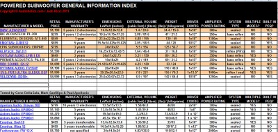

Tab 1: Subwoofer General Data
This tab is rather self explanatory. The brands are alphabetized and data such as price, dimensions, dimensional volume, weight, driver type, amplifier rating, system alignment, etc is tabulated in corresponding columns. When a sub has multiple tuning modes it is listed as “yes”. This means the manufacturer has provided a method for changing the tuning of their sub by either plugging ports or engaging different EQ settings, or a combination of both. If the sub has an EQ on board we list it as “yes”. Some subs even come with built in auto setup and room correction options which you can read about in their corresponding formal reviews.
We broke up the data collected by Josh Ricci in the top table for the first two tabs and data collected by other staff (myself included) in the bottom table for the first two tabs. The reason for this is Josh is our primary reviewer testing per our new subwoofer measurement protocol which adheres to CEA-2010 testing. Many of the reviews in the bottom tables were either done before we established our new measurement protocol or they were conducted by reviewers not setup on a CEA-2010 test rig. Later on we discuss how to correlate the results done by different testers and methods as closely as possible.
Also notice that each brand/model# is hyperlinked to our formal review for that product. If you want to dive into more detail on our tests or subjective impressions, just click the product and our review will open in a new browser.

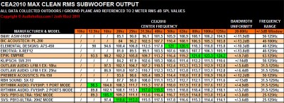

Tab 2: CEA 2010 Output Results
Tabulated CEA 2010 test results are located in this tab from 10Hz to 125Hz in 1/3rd octave increments. Our measurements are conducted at 2 meters using groundplane technique. While the test program reports peak SPL data, we convert all of our data to RMS data at 2 meters which more closely resembles 1 meter 4pi (freespace). Though it’s not as flattering to report 2 meter RMS data as it is to report 1 meter peak data to the manufacturers whose sole purpose may be a marketing slogan, we do this because it’s a more accurate way of representing actual product performance.
We always publish distortion data for all max output measurements done using CEA-2010 test signals. This is the only way to determine pass/fall to ensure you have accurately achieved true maximum output of the product under test. To get distortion data for a particular product, you will have to reference the formal review for that product. In our reviews, you will find even more elaborate test results including frequency response, group delay, max long term compression tests, and much more. Please reference our SVS PB13-Ultra and Velodyne DD18+ reviews as examples.
Some quick translations:
- For every doubling of distance you subtract 6dB (1 meter to 2 meter to 4 meter, ….)
- To convert Peak SPL to RMS SPL you subtract 3dB
Thus, to convert 1 meter peak to 2 meter RMS would involve you subtracting 9dB for every SPL measurement at each frequency. If you want to convert 2 meter RMS to 1 meter RMS you need to add 6dB for every SPL measurement at each frequency. I can continue with more examples but just remember to always make sure you are comparing RMS or peak data when making SPL distance conversions.
Tab 2:
of CEA 2010 Output Results
Bandwidth Uniformity (20-80Hz) - This a measure of how closely the subwoofer maintains a constant output across the entire frequency range. If a sub maintains +-6dB that means it exhibits no more than a total swing of 12dB for the entire frequency range of 20Hz to 80Hz. In most cases the tighter this number the better. In extreme cases, if a designer remains to focused on bandwidth linearity as a primary design goal, they can ultimately sacrifice too much output and/or extension. In addition, employing a steep High Pass Filter (HPF) will cause the system to ring at its roll off points. This can also result in a dramatic and sudden falloff of output below the subwoofers 3dB point which will nullify the advantage of picking up room gain at the lower frequencies. This type of behavior can be seen by closely inspecting the frequency response of the product and how steep the slope is on the High Pass Filter (HPF) employed. We illustrate this in our formal reviews of the products via frequency response sweeps and also provide group delay measurements and engage in listening tests to determine if the product suffers from such sonic nasties.
Frequency Range – This is a measure of the bandwidth the product is able to maintain its output with no more than +-3dB of variance.

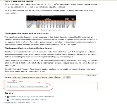

Tab 3: Sweep Output Results
Tabulated test results are located in this tab from 20Hz to 125Hz in 1/3rd octave increments using a continuous reverse sinewave sweep. Our measurements are conducted at 2 meters using groundplane technique. Distortion isn't measured during these sweep tests but levels are increased for each progressive sweep until compression is observed or mechanical or audible distortion is heard. If mechanical noise or distortion is heard, the sweep is redone at a reduced level until the output sounds clean. That level is then recorded as the maximum sustained sweep level for the product.
We do our best to correlate how CEA-2010 burst tests and reverse sinewave sweeps can directly compare but it’s far from a perfect translation.
What happens at low frequencies (driver limited output)?
What we’ve found is at low frequencies where the subwoofer is driver limited, the results between CEA-2010 test signals and continuous reverse sinewave sweeps usually correlate within 2-3dB (down to 20Hz) of each other. The only exception is when a particular product has a very aggressive limiter which can either react too quickly causing it to prematurely limit output during continuous sweep tests or not react quickly enough resulting in excessively high distortion output using CEA-2010 test signals.
What happens at high frequencies (amplifier limited output)?
We’ve found at frequencies where the subwoofer is amplifier limited, the results between CEA-2010 test signals and continuous reserve sinewave sweeps usually produce lower results for the reverse sinewave sweeps between 3-6dB (up to 80Hz) depending on how high the tester continued to power sweep the subwoofer beyond its low frequency compression point.
There is no perfect translation between CEA-2010 and reverse sinewave sweep testing of subwoofers. This is why it’s a good idea to look at both sets of data for each product or try to directly compare competing products tested using the same test signals and methodologies.
Bandwidth Uniformity & Frequency Range for these results is also listed and computed in the tabulated data in a similar fashion to how it was done for the CEA-2010 test results of Tab2.

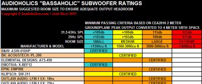

Tab 4: Bassaholic Room Size
Tab#4 provides our Room Size rating for the subwoofers tested based on their CEA-2010 or reverse sinewave sweep output in according to our Room Size Rating protocol. We have found the room size rating to really be a function of how much output the particular subwoofer produces below 30Hz because most subwoofers simply start running out of gas at this point. This means whether the sub was tested via CEA-2010 or reverse sinewave sweep test method, we can still approximate a room size rating with a good confidence using either testing method.
Tab 4: Bassaholic Room Size Rating
The top table shows results based on CEA-2010 testing conducted by Josh Ricci. The bottom table shows results using reverse sinewave sweep testing by reviewers other than Josh Ricci.
As a refresher, here is the breakdown of our room size rating. The subwoofer must be able to product the minimum SPL#s shown below when their test data is translated to 4 meters 1/8th space.
| Room Size Rating | Dimensional Volume | SPL @ 4 meters | SPL @ 4 meters |
 | (L x W x H) | 25Hz | 30Hz to 63 Hz |
| Small | < 1,500 ft^3 | < 103dB | <109dB |
| Medium | 1,500 ft^3 to 3,000ft^3 | >/= 103dB | >/= 109dB |
| Large | 3,000ft^3 to 5,000ft^3 | >/= 109dB | >/= 115dB |
| Extreme | >5,000ft^3 | >/= 117dB | >/= 123dB |
If the subwoofer you are considering receives a “Large” room size rating, that means it will likely be able to hit full playback reference levels without being overdriven in a 3,000ft^3 to 5,000ft^3 room assuming you corner load the subwoofer. The room size criteria and reference levels are listed at the top of the tabulated results for your reference when making product comparisons.

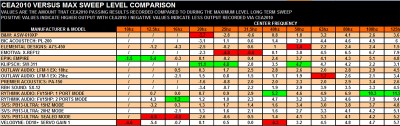

Tab #5: CEA2010 Max Sweep Comparison
The final tab of our subwoofer measurement spreadsheet exists to study how closely CEA-2010 and reverse sinewave sweep data track each other for each product under test. The subs in this data table are all tested by both methods and by the same reviewer, namely Josh Ricci.
Tab 5: CEA2010 Max Sweep Comparison
The table features data for all commercial subs tested under both measurement signal types (CEA2010 and reverse sinewave sweeps). Positive values indicate higher output levels were achieved using CEA-2010 test signals while negative values indicate less output was recorded using CEA2010 test signals.
