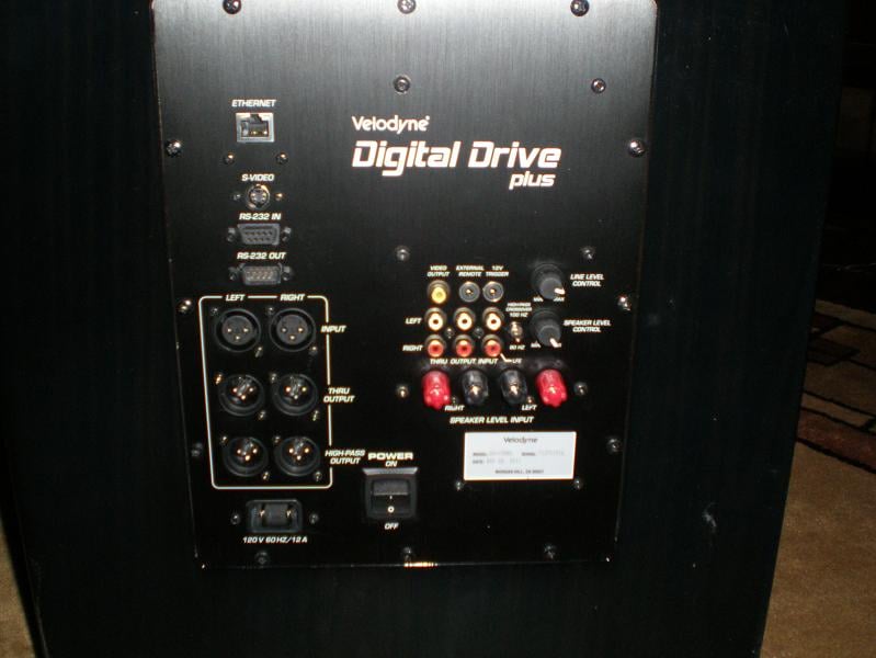

To recap, for all Velodyne Digital Drive Plus sub owners, regardless of sub size, there are three sets of inputs on each sub. One set for speaker level inputs, one set for single-ended line level, and one set for XLR line level. The speaker-level inputs and the single-ended inputs have dedicated input level controls, so input stage overload is not a factor, but the XLR inputs do not have level controls.
For those of us driving the DD Plus subs with full-range balanced outputs from our pre-amps, input overload is a very real factor. As cjwhitehouse noted, many owners running XLR cables are using sub volume levels of “5” to “10”, when Velodyne ships the sub with a default of “30”. I called Velodyne and asked if there was an XLR input sensitivity fix, and they never responded.
Some time ago it occurred to me that the fix was simple - use XLR line level attenuators ahead of the XLR inputs on the sub. Fixed levels (-10db, -20db, etc.) are available from Parts Express for about $10 each, and Audio Technica makes some more expensive adjustable ones. I tried the -10db versions from Parts Express.
What a difference! I remember that first listening session with the attenuators in-line clearly, and it was several months ago. Prior to the attenuators I was running the DD18 Plus's volume control at “8”, and now I use “25”. So what? Well, two things changed. First, the granularity of volume adjustment is so much finer. Before, “7” was too little and “9” sounded bass-heavy. Now I can fine tune the bass level depending on the recording from “20” to “30” and the subtlety of effect is very nice. Second, the sub's EQ is more effective and appears to be more accurate when I do in-room measurements. I don't know for sure that input overload was causing the problem, but the attenuators made a significant, easily audible and measurable improvement in the sub's usability and EQ performance.
As I said, most users won't care because they'll probably use the single-ended inputs. But if you are using the XLR inputs on Digital Drive Plus subs with full-range pre-amp outputs I highly recommend trying XLR attenuators.

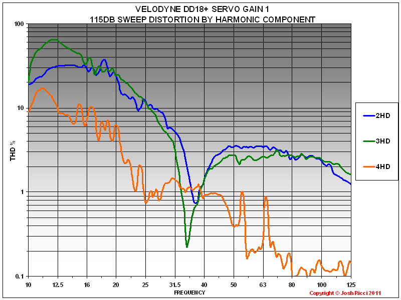

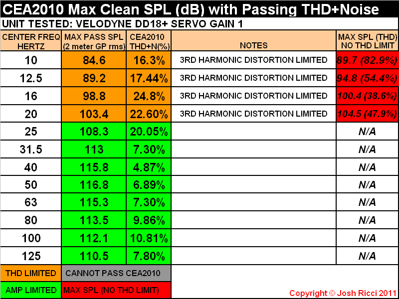

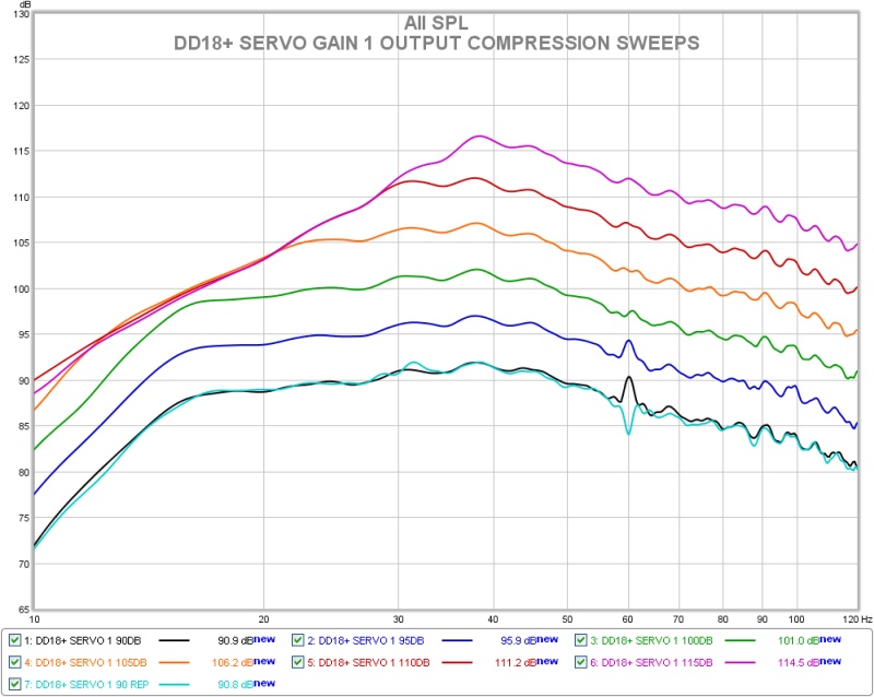

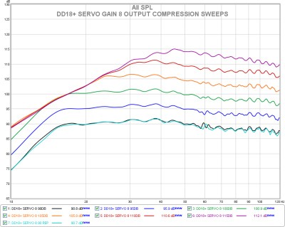

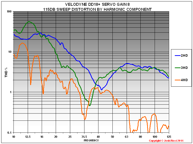

I am confused by your high rating of this subwoofer.
Please look at the distortion chart.

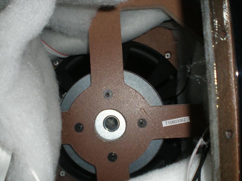

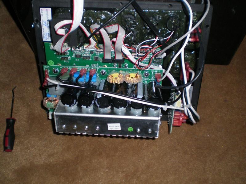

I couldn't help but notice the white foam inside the cabinet (in the design section).
Isn't that too close to the amp when bolted/screwed on? If the amp is hot wouldn't the foam catch on fire? Or is it made out of fireproof material?
