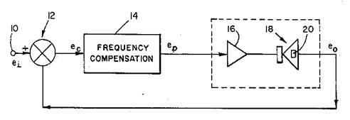

Fig 2: Illustration from U.S. Patent # 4, 727,584, “Loudspeaker With Motional Feedback”
In the DD-18 we
find the successful embodiment of such patented, innovative technology, 2+

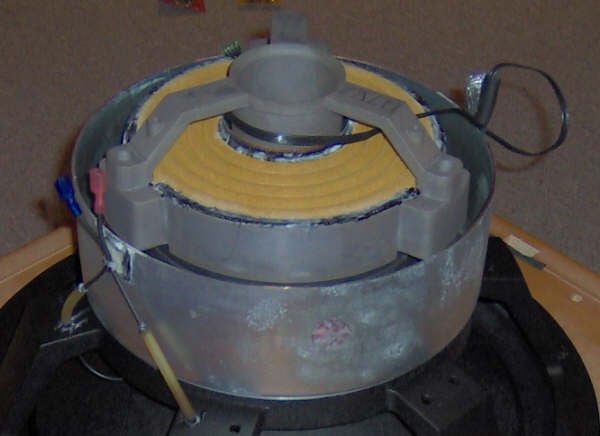

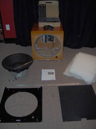

Velodyne DD-18 Inside Look

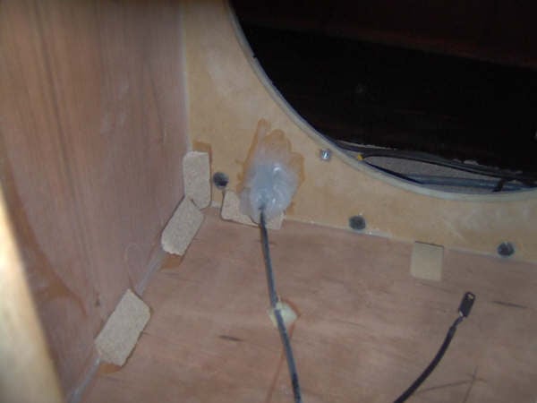

Figures 4a – c: Inside the DD-18 (Left): System disassembled, meter stick & 12” ruler included for scale; Middle: Looking forward from back of cabinet toward inside of faceplate. Note XLR jack sealed in silicon to eliminate wind noise. (Any hardware found in the amplifier - or anywhere else in the cabinet - that could provide a path for air leakage was sealed). Light gray band seen in driver aperture is the gasket. Dark lead seen at lower-right of the photograph supplies faceplate indicator light with current. Right: looking back at cabinet back panel and system amplifier, Note use of glue blocks throughout.
Removing the grill cover, black gloss-finish fascia and driver revealed a moderately damped, well sealed cabinet built up of 1” (2.54 cm) panels. Glue blocks were used throughout. No cross bracing of any kind was used in construction of the cabinet. Driver and fascia held in place using Allan-bolt/t-nut mounting hardware. Both driver & amplifier openings are gasketed. The system rests upon 4 ¼-20 threaded aluminum feet with rubber inserts. They work very well in making sure the unit stays put.
The driver used in the DD-18 is certainly an heroic looking device! Features include a Kevlar-reinforced cone with a 15.2” (38.6 cm) effective radiating diameter, variable-thickness EPDM surround, 1.25” (3.18 cm) (peak-to-peak linear excursion (1.75” (4.45 cm)(on transients), tandem, 3” (7.62 cm) wide, 6” (15.24 cm) long, push-pull voice coil, wound on a woven glass/polyamide resin former, a 24lb (10.89 kgs) magnet structure and a die cast aluminum basket.
Figures 5a –c Bottom right: DD-18 Driver with 1’ ruler included for scale; Top left & right: driver and voice coil. Bottom left: close up of motor assembly. At left in image: power leads encased in surgical tubing. Image center: bottom of drivers two linen spiders showing. At right of image: Accelerometer leads. Velodyne doesn’t attempt to make their drivers pretty for press photo shots. You won’t find any chrome or gold finish, just a raw, high performance driver. But then again, beauty is in the eye of the beholder.
Figures 6a,b: Left: DD-18
Accelerometer (left end attached to driver). Right: Accelerometer & lead
seen at right. Note holes in the bottom, left-hand side of cone.
Yet another interesting feature of the DD-18’s driver are
the clusters of small holes seen at the bottom of the cone in Figure 6b. Purpose? Velodyne’s design intent
can be found in the Description of the
Preferred Embodiment section of US Patent #4,727,584 “Loudspeaker with
Motional Feedback”:
“The function of the hole clusters 38 is to control the speed of waves propagating radially outward of the cone, so as to provide that the speed varies to some extent with the radial angle. That is, the propagation speed in the sectors containing a cluster of holes will be different from an adjoining sector not containing such a cluster. Sonic waves resonate at a slightly higher frequency between the hole clusters than through the clusters. The consequence of such an arrangement is that a somewhat “jumbled” pattern of sound waves is created, which apparently combine in a fashion to prevent marked resonance effects leading to instability.”

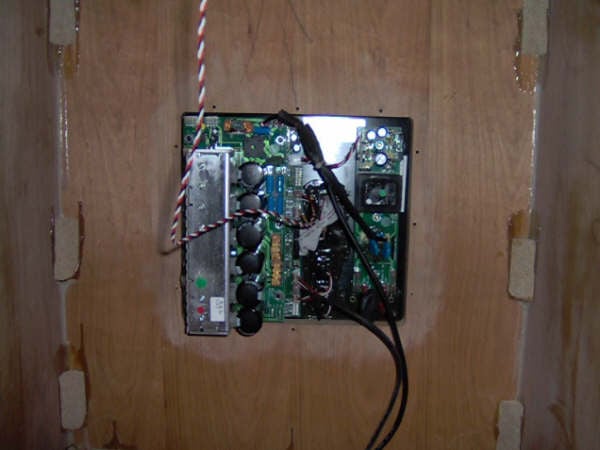

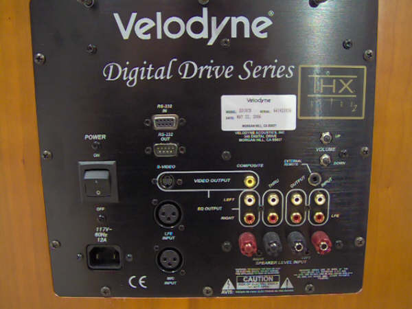

The Amp & Digital Drive: The Virtuous Cycle
Figures 7a,b: (Left) DD-18
Amp. Note array of jacks at left running top to bottom, sealed to prevent air leakage. (Right) DD-18
control panel, recessed & gasketed, bolted into back of cabinet. Provides
data, audio & video interconnects along with On/Off switch and volume
control.
Digital Drive is an impressively comprehensive subwoofer control system. It encompasses digital implementations of all crossover, filter, phase, contour functions as well high-gain servo control (featuring accelerometer A-D sample rates up to 15.8k) and all linked into an extremely efficient Class D power amp.

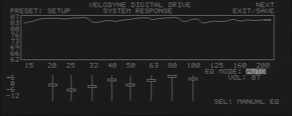

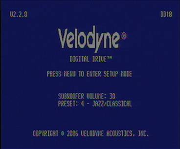

Figure 8: Introductory Screen.
Power up the DD-18 and the introductory screen is what your OSD greets you with. It presents basic operational information such as Firmware version, Model ID, sub volume and whichever default preset has been selected.
![remote.gif](remote.gif)

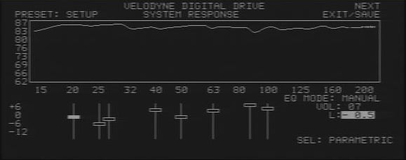

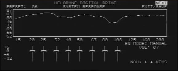

Punch “Menu” then “12345” on the remote and you’re taken to the System Response\PEQ Screen (Figure 9). Here, the system indicates the volume is at 30, manual mode is in effect and the response is flat lining as the supplied setup mic was not connected to the system when the screen capture was done.
Setting equalization can be fully
automatic, fully manual or a combination of the two, letting, the DD-18 run the
equalization set up automatically, then manually tweaking the results. The
system monitors the process and its effects on the resulting dB spl curves via
the supplied mic. Being able to watch changes in DD 18’s amplitude response due
to changes made at the PEQ is as useful as it is efficient.
Figure 9: System Response\PEQ Screen

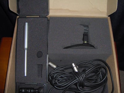

Figures 10a, b: Mic w\ 1’ ruler for scale, Mic kit with accessories
Figures 10a & b show the included mic along with various included accessories, such as the tabletop mic stand, mic clip for stand mount, 20’ XLR to XLR mic cable, windscreen, and carrying case. Also included but not shown are a 25’ video cable and 25’ audio cable.

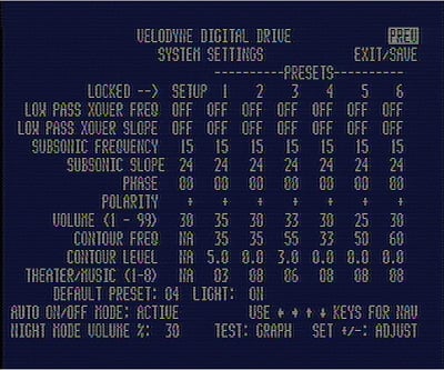

The third and final screen in the series presented by the DD-18 is the Presets screen, seen in Figure 11.
Figure 11: DD-18 Presets Screen
The DD-18 comes from the factory with its 6 presets preset. (One of the six functions as an EQ defeat)
On the remote they’re labeled:
1. Action/Adventure
2. Movies
3. Pop/Rock
4. Jazz/Classical
5. Custom (yours to tweak as you see fit to do)
6. EQ Defeat (especially useful for before/after comparisons
with Preset 5)

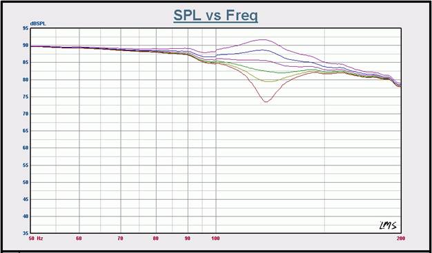

Referring to Figure 11, from the top down the function/parameter fields are:
- Lowpass Crossover Frequency: adjust the upper limits of the subs response
in terms of frequency (15 Hz to 199 Hz, increments of 1 Hz)
- Lowpass Crossover Slope: adjust the upper limits of the sub’s response
in terms of slope (6 dB to 48 dB/Octave in 6 dB/Octave increments).
- Subsonic Filter Frequency: Set the sub’s LF limit in terms of frequency (15 Hz – 35Hz, 1 Hz increments)
- Subsonic Filter Slope: Set the sub’s LF limit in terms of filter slope (6 dB – 48 dB/Octave, 6 dB increments)
- Phase: Set sub’s output signal phase (0° to 180°, 15° increments)
- Polarity: Set subs polarity (toggle between “+” and “-“, equivalent to a 180° phase reversal
- Volume: Set individual preset volume (gain) separate from that of system master gain control.
- Contour Frequency: Sets contour boost/cut frequency of Contour EQ
- Contour Level: Amount of boost/cut at contour frequency of Contour EQ
- Theater/Music: Set the amount of distortion-limiting servo gain; 1 (Theater, min. servo gain)
8 (Music, max servo gain, minimum distortion).
- Default Preset: Select the sub’s default preset; the preset the sub automatically runs at startup.
- Auto On/Off Mode: On at signal sense, off 15 minutes after the last detected signal.
(L & R In sum to mono, in effect, increasing sensitivity to the incoming signal by the auto on/off process, making it more effective at detecting low-level signals).
- Night Mode Volume: Preset max. gain level.
- Light: Sets the logo light on or off. Default is on.

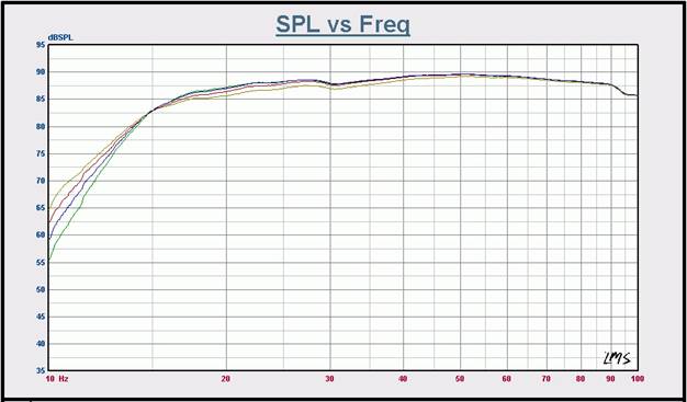

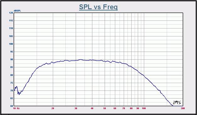

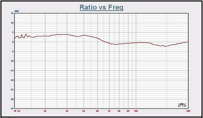

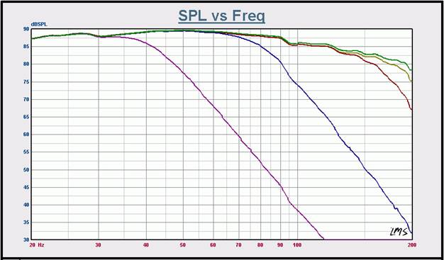

So how well did the PEQ work?
Pretty well, actually. Figures 12, 13, and 14 tell the story.
Figure12 is the pre-AutoPEQ picture, Figure 13, post-AutoPEQ and Figure 14, post-AutoPEQ followed
by a modest amount of manual tweaking. Subjectively speaking, the audible difference between the system response as seen in Figure 12 & 14 was truly substantial; best described as the lowest few octaves of the system pulled into focus, delivering an increase in precision and clarity that would have to be heard to be believed. Excellent!

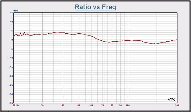

There are a couple things that should be kept mind when viewing the figures. First, the plots generated by the Velodyne display are 1/3rd Octave smoothed. Second, the amplitude response generated is for the main listening position only; move away from that position and the response will change both audibly & measureably.
Figure 12: System response, pre- AutoPEQ, as measured at the main listening position 9’ (2.7m) directly in front of sub.
Figure 13: System response, post- Auto PEQ, as measured at the main listening position 9’ (2.7m) directly in front of sub.
Figure 14: System response, post- Auto PEQ, with additional manual tweaking, as measured at the main listening position 9’ (2.7m) directly in front of sub.

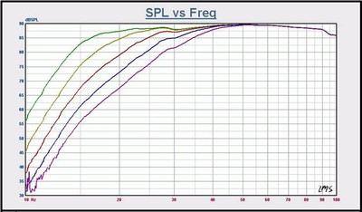

Velodyne DD-18 Measurements and Analysis
Graph 1: System amplitude response, 1m, On-axis @ 2.828 Vac , Preset 4 Engaged. Measurement environment: Outdoors, nearest reflecting surface: 30m (~100’) No smoothing applied.
In Graph 1 we see the DD-18, measured outdoors, pole-mounted, driver firing upwards, approximately 30m (~100’) above the ground. The system’s measured amplitude response goes far in explaining the sub’s exceptional subjective characteristics. The smooth mid-band performance, artifact-free low & high frequency roll off, are all factors contributing to the systems 5-star performance. (The hashy appearance of the response plot in ~<12 Hz was due to a low flying airplane that happened by while the sweep was underway and should be ignored).

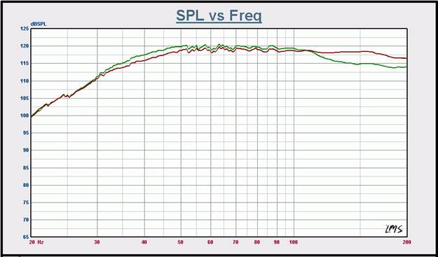

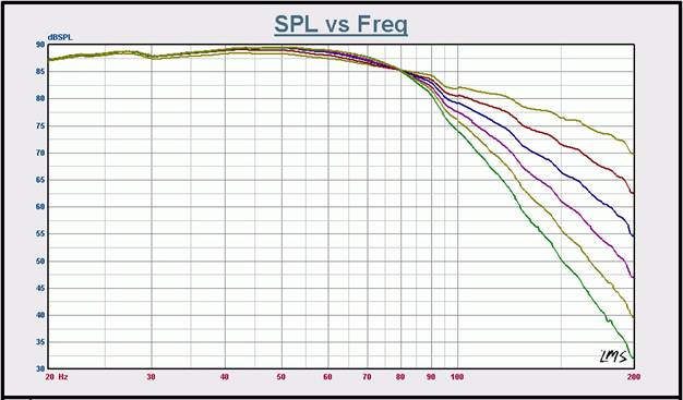

Graph 2: Max dB spl curves, 2m, on-axis, scaled to 1m. Green curve: Servo @ 1, Red Curve: Servo @ 8. Measurement environment: Anechoic.
Graph 2 shows the DD-18’s max. dB spl response plots, with two curves provided to present the systems response with Servo gain at 8 and at 1.Increased distortion components add in to the mix increasing dB spl output slightly at Servo setting 1. The degree to which increased distortion will increase the overall amplitude magnitude is frequency dependent. Note also the upward shift of the LF knee when compared to that seen in Graph 1. This results from the processors functioning correctly and keeping the driver’s excursion within software-defined, safe limits.
Graph 2b: Normalized THD&N curves; Servo settings 8 & 1
I also ran 2 quick THD&N sweeps, one at Servo setting 1 and again at 8, both at the same drive level used in generating the curves seen in Graph 2. Dividing one curve by the other for easy comparison, the results are seen in Graph 2b. Not unexpectedly, an increase of a few dB below about 65 Hz is seen in the THD&N levels at Servo setting 1 when compared with Servo setting 8. (Had both THD&N curves been identical, normalizing one to the other would have produced a flat line spanning the graph at 0 dB).
Graphs 3 – 8 are a walk through the various digital processing features built in to the DD-18; tested/measured not only to see if they work (don’t laugh – I’ve bumped into subs where some of the processors didn’t function correctly) but how and how well they work.

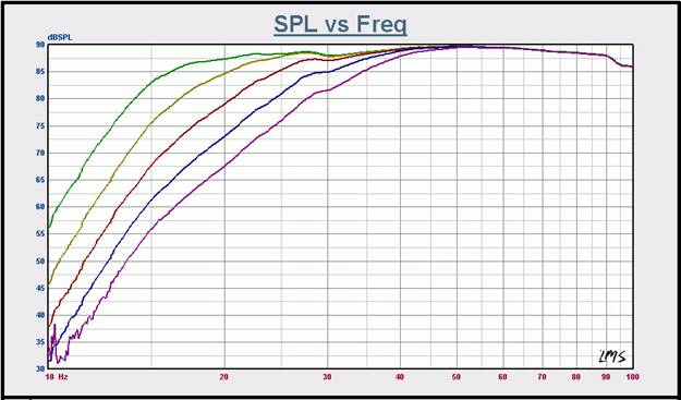

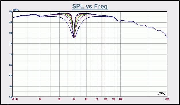

The subsonic filter (Graphs 3 & 4), Contour EQ (Graph 5)(acts as an extra, limited-function EQ), low pass crossover (Graphs 6 & 7), and PEQ in combination with the supplied mic (Graph 8, along with Figures, 12, 13, and 14) are all essential features that help the end user integrate the sub with their existing system while at the same time maximizing the performance of the sub within that system, further helping to maximize the performance of the entire system. With the comprehensive array of processor/control features and the Velodyne everything-is-important design approach where it comes to the cabinet, driver, servos, & power amp, you have in one neat package all the ingredients for a world-class sub. Just get it. You can always turn it down later if it’s too loud.
Graph 3: Subsonic filter slope, 6, 12, 18, and 24 dB/Octave. Filter frequency: 15 Hz. Measurement environment: Nearfield, scaled to 1m.
Graph 4: Subsonic filter frequency, 15 to 35 Hz in 5 Hz increments. Slope set to 24 dB/Octave Measurement environment: Nearfield, scaled to 1m.
Graph 5: Contour EQ: +6 dB to -12 dB in 3 dB increments. Contour frequency: 120 Hz
