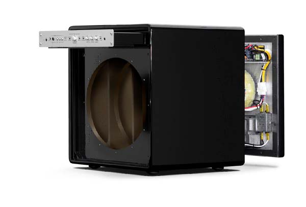

JL Audio Fathom f112 Subwoofer Review

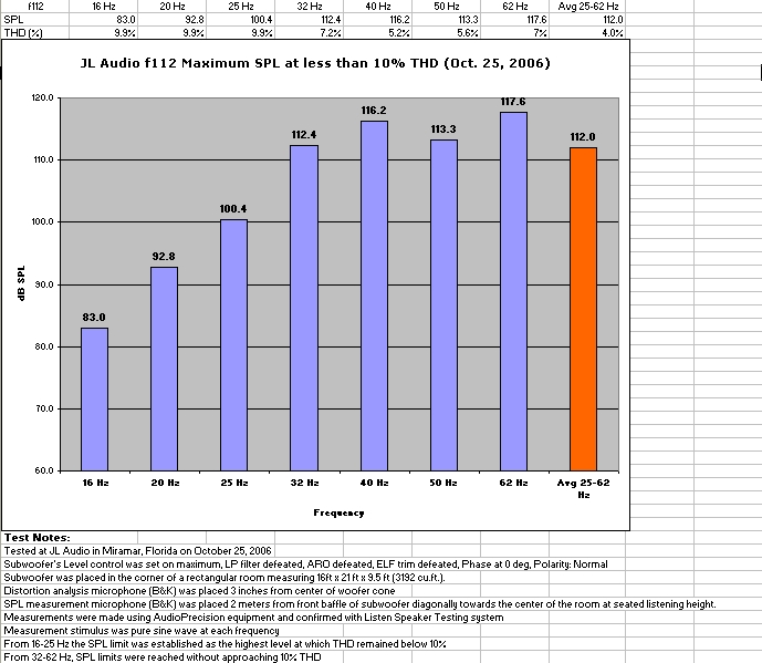

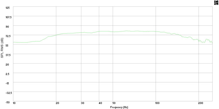

Frequency Response (+1/-3dB): 20-200 Hz Amplifier Topology: Class D switching Amplifier Power: 1500 W RMS (short term) Woofer: 12” (nominal) mineral filled polypropylene cone with a polyester foam surround Effective Piston Area: 84 sq inches Effective Displacement: 287 cu inches Maximum average SPL (in room): 117.6 dB |
Low Pass Crossover: 30-130 Hz variable at 12dB or 24 dB/octave Polarity/Phase: 0 or 180 deg/0 to 280 deg variable Dimensions (HxWxD): 18.00” x15.00” x 18.63” (Including feet) Weight (each): 115 lbs (net) Enclosure Type: Sealed enclosure. |
- Powerful sub capable of tactile bass.
- Detailed, precise low frequency output.
- Musical with excellent micro and macro dynamics.
- Superb build quality and finish.

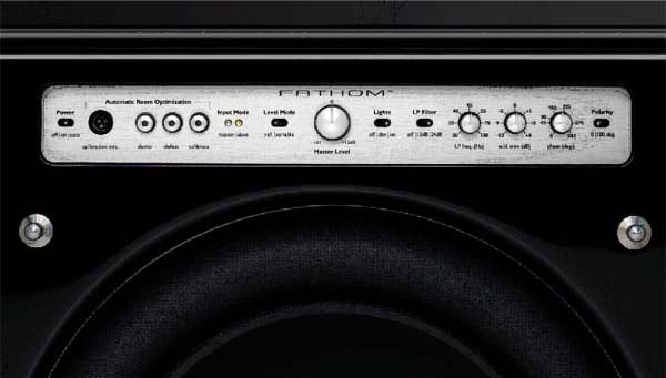

- ARO feature will take the mud out of the listening experience.
- Heavy.
- Power switch located under grille.
- Automatic Room Correction (ARO) can be finicky to set.
- Gloss finish is easily smudged, requires frequent cleaning in the presence of little fingers.
- Heavy.
Introduction

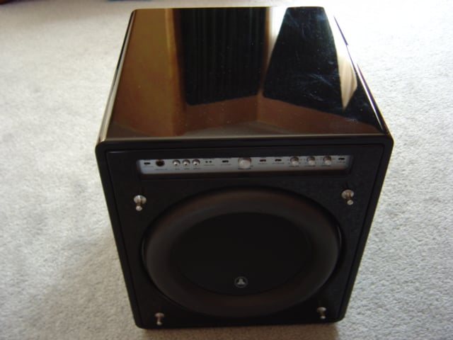

The JL Audio has produced a very serious subwoofer in the Fathom f112, the smallest sibling in their home audio line.. This is a powerful sub capable of prodigious deep bass output. Make no mistake; if you have loose objects in the house, this sub will locate them and point them out. Also, be prepared to find interior partition walls complaining into adjacent rooms. For the best possible listening experience, find all loose items and secure them. For those who have not experienced a subwoofer capable of generating bass to the limits of human hearing, one with substantial output capabilities down into the subsonic range, the JL Fathom f112 with acquaint you nicely. Add this sub to your auditioning shopping list if you are after ultra high performance, reasonable box size and cost.
