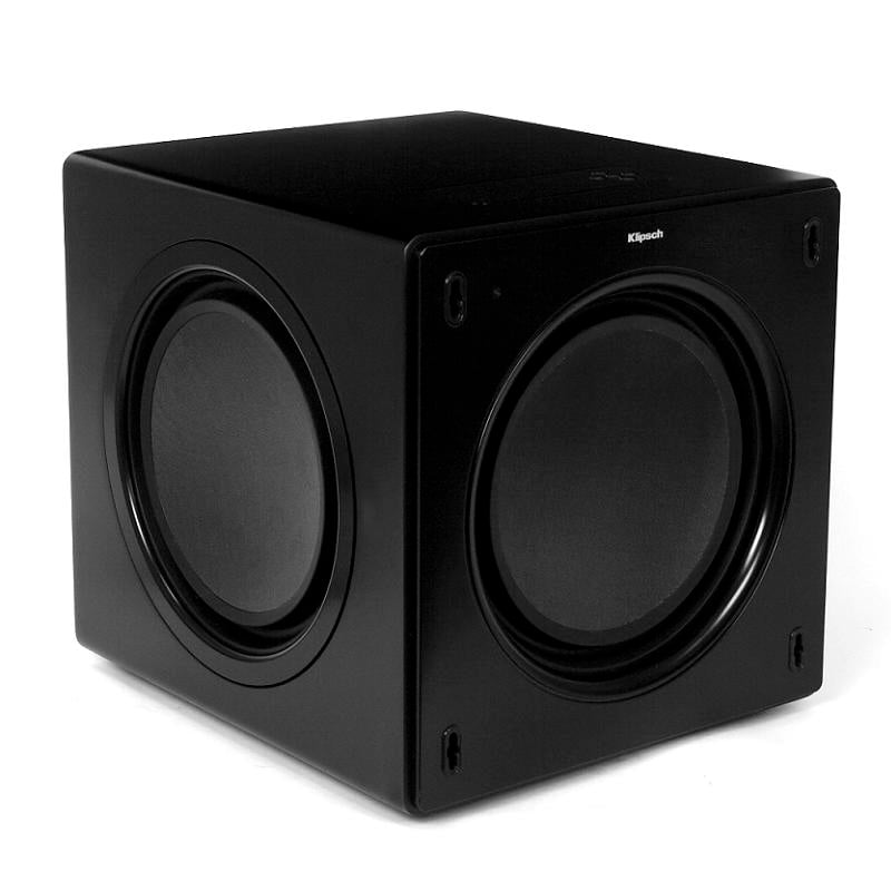

  • 10” forward-firing driver
  • Dual 10” side-firing passive radiators
  • Amplifier: BASH® Digital Hybrid, FTC Rated Power: 500w continuous @ <2% THD / Dynamic Power: 1200w

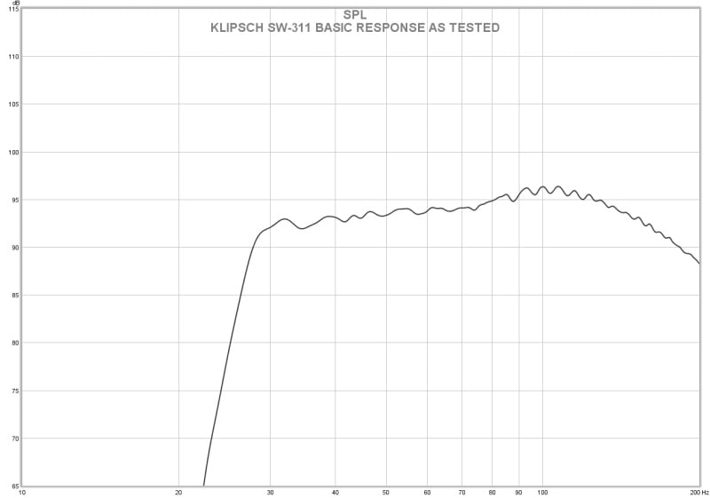

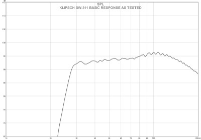

  • Frequency Response: 22-120Hz +/-3dB

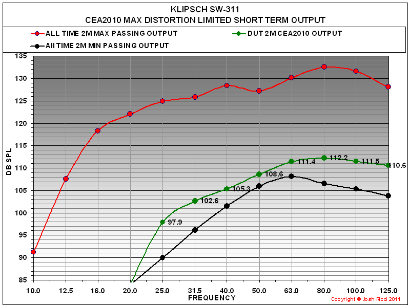

  • Maximum Acoustic Output: 118dB @ 30Hz 1/8th space, 1 meter
  • Finishes:  Black satin
  • Dimensions (H/W/D): 13” x 13” x 14”
  • Weight: 37 lbs.
  • Warranty: 2 years (Bumper to bumper)

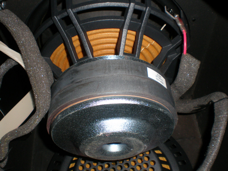

Driver features
  • Die-cast aluminum frame
  • 4 layer copper voice coil
  • Aluminum former
  • Highly damped, non-resonant woven fiberglass driver and passive radiator cones
  • Inverted rubber surround on driver and passive radiators
  • Vented pole piece
  • Dual stacked ferrite magnets

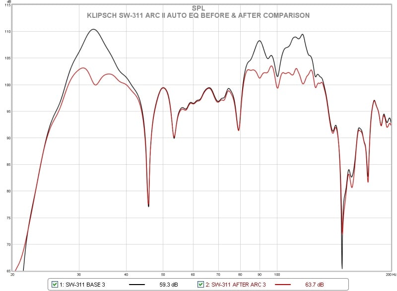

  • Patented Adaptive Room Correction II (ARC) with 12 active filters

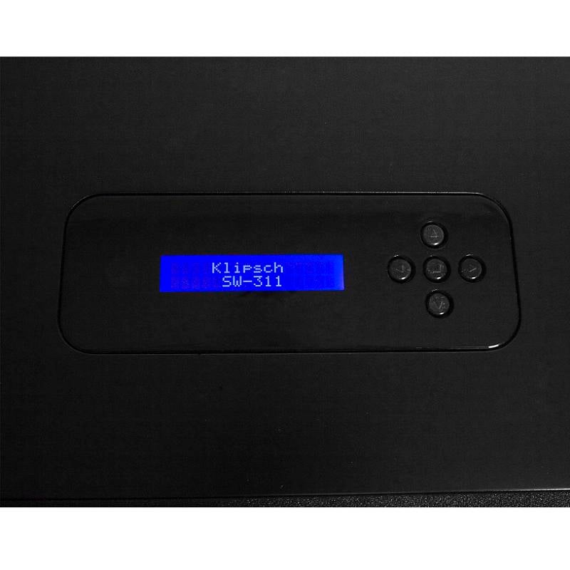

  • DCS: Digital Control System with built in LCD screen and adjustable DSP controls

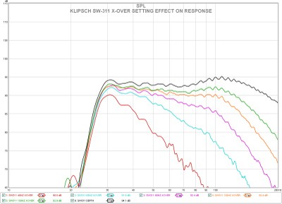

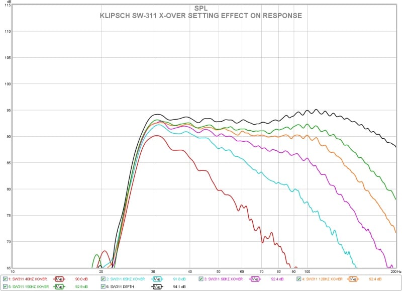

  • Low Pass X-over: 40-150Hz with selectable: 12, 18, 24, 36 and 48dB octave slope (Can be disabled)

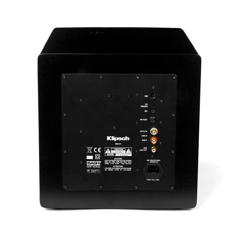

Inputs/Outputs
  • Unbalanced (RCA) left (LFE) and right inputs
  • Unbalanced (RCA) mono subwoofer output for daisy chaining
  • 12v trigger
  • Microphone input (ARC II)
  • USB input for advanced ARC II management (Not typically utilized by user contact Klipsch)
  • IR sensor for control via AV remote

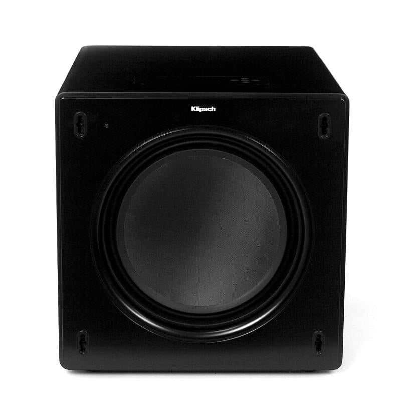

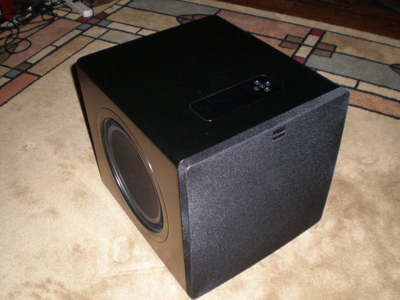

SW-311-Angle 800.JPGKlipsch is a brand that should be familiar to most audio enthusiasts and is commonly equated with highly efficient and dynamic speakers utilizing horns in some form or another. Klipsch has been in official operation since founded by its namesake Paul W. Klipsch way back in 1946 and is one of the longest operating American speaker companies. 65 years later the outfit has gone from handmade batches in a small garage to being a large global company with products in what seems like every conceivable market niche. They have developed a large and dedicated community of owners and fans over the years, with a lively discussion forum and yearly pilgrimages for Klipsch users. I myself have been using Klipsch main speakers in my HT system for the last 3 years or so, (Two pairs of CF-4’s and a KV-4 center channel.). However the subject of this review is not any of their current model speakers, but is instead their SW-311 subwoofer which sits at the top of their current Reference line of subwoofers.

SW-311-Back 800.JPGAfter receiving the SVS PB13-Ultra and having to deal with its 180lb weight as shipped I was grateful when the box containing the SW-311 showed up weighing in at about 45lbs and roughly a 6th of the size. Unpacking the subwoofer was uneventful and straightforward. The SW-311 came is a heavy gauge single layered box, with reinforced corners and cardboard corner inserts. There is the usual large recessed top and bottom foam pieces which fit the subwoofer like a glove. The subwoofer itself was enclosed in a cloth bag also. The rest of the contents consisted of the detachable power cord, owner’s manual, ARC II microphone and grill. The packaging is not the heaviest or most protective that I have seen but in light of the small size and relatively modest weight of the unit it should be more than adequate. Once I had the SW-311 unpacked the first thing that struck me was that this was a seriously small subwoofer. It comes in under 1.4 cubic feet in total external volume taken up. That is smaller than some bookshelf speakers and smaller than my KV-4 center channel! It is very compact as far as home theater subwoofers go and is more akin in size to what you might usually see coupled with a 2.1 computer audio setup. You should be able to fit the SW-311 in just about anywhere. The SW-311 only comes in one finish apparently, which is the satin black proudly worn by the review unit. It is a classy and understated appearance that should not call attention to its self, but looks nice when, or if it does happen to become the focal point of attention. The fit and finish is good and the DCS control system sporting its blue LCD screen, along with the textured slightly reflective surface of the 3 10” cones, give it a high tech look.

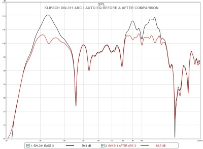

I would say ARC could easily be worth $500 if there is no other EQ system in play - especially if location possibilities for the sub are limited, but does Audyssey leave us short such that ARC adds an audible improvement?
ARC is one of the better built in auto-EQ systems that I have encountered thus far and I would agree with your assessment. If you already have EQing capabilities whether automatic in a reciever, or manual through an EQ unit with measurements, then ARC is not so important. However if you have neither of these, such as with many 2 channel systems, ARC could make a very large improvement in the response in that case.

Can you comment on the benefit realized from running ARC after Audyssey (and which version of Audyssey you used) for your listening test?
The weight and appearance suggest that the Klipsch SUB-310 may be essentially equivalent in cabinet and drivers to the 311 - except without ARC and 400W instead 500W. If this is the case, it begs the question of whether the ARC system is worth $500 to people who already have Audyssey.
