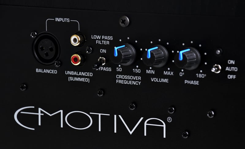

Power Output: 300 watts RMS, 500 watts peak
Frequency Response: 22Hz to 200Hz (in-room)
SPL: 110 to 113db (in-room)
Balanced Input: 1V
Unbalanced Input: 500 mv.
Phase Adjustment: 0 - 180 degrees @50Hz
Low pass Crossover: 50-150Hz variable, 24db/oct
Warranty: 5 year transferable
Dimensions: 14.5" W x 14.5" H x 15.25" D
Weight: 38 lbs.
