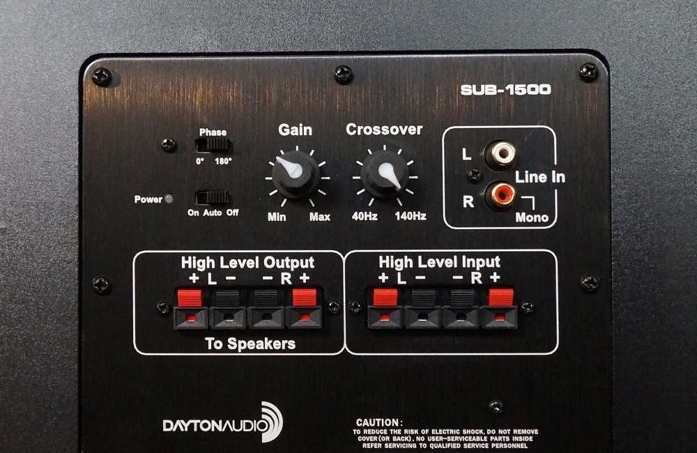

- Inputs: RCA line level & speaker level
- Outputs: Speaker level
- Crossover frequency control: Continuously variable from 40 Hz to 140 Hz @ 12 dB/octave
- Phase switch: 0/180 degrees

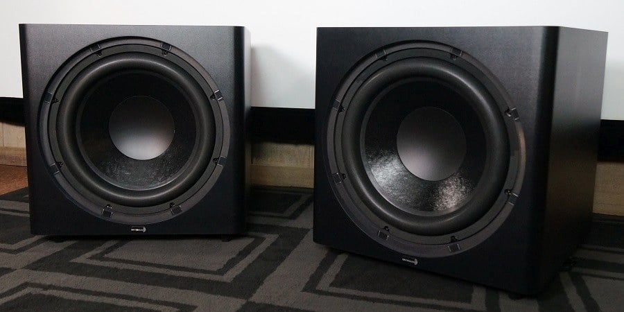

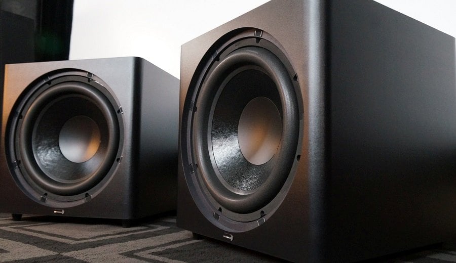

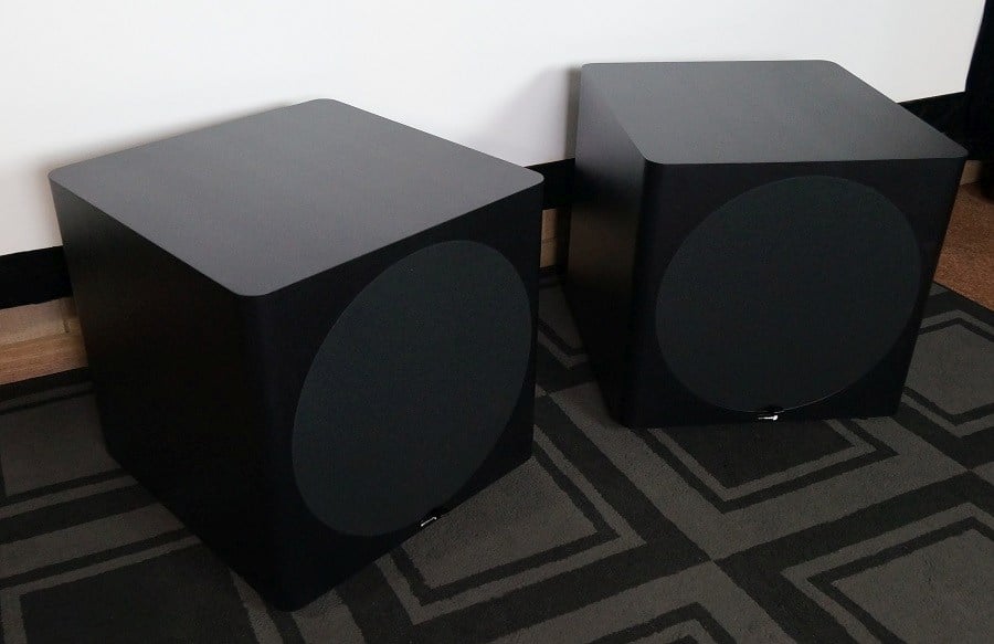

The SUB-1500s arrived in double-boxed packing which is very unexpected at this low price point. Inside the boxes, there are two large polyethylene foam pieces sandwiching the top and bottom of the subs. The subs are wrapped in a plastic bag to protect them against moisture and scuffs. Overall, the packing is very good for the cost of these units. Since they are not very heavy, they should be adequately protected against normal shipping abuse.

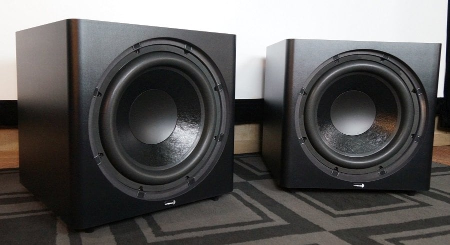

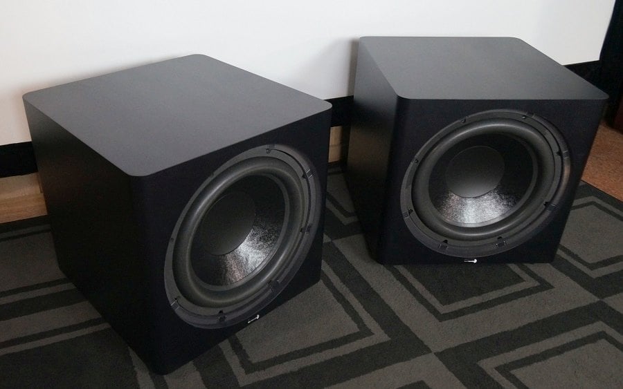

Once unpacked, we are met with two nice but fairly conventional-looking subwoofers. They are not ugly but not gorgeous either, just standard subwoofer appearance. They use a matte black textured vinyl finish that does look a tad plasticky but it does not scuff easily nor leave fingerprints easily. There are grilles that hide the cones, but they do not cover the entire front baffle like most sub grilles. Without the grilles, we get a look at the woofers, which are treated paper cones with an inverted dustcap and a beefy half-roll surround. I think the subs look rather plain with the grilles on, but without the grilles, they have more character and look like they mean business. The overall shapes of the subs are cubes with just a bit over 19” of side lengths. One aspect that does a lot to soften their appearance is some rounding of the vertical edges; that is a nice touch and helps to make them less boxy looking. I like the simplicity of the design, and that will go a long way toward making them fit in a wide range of rooms.

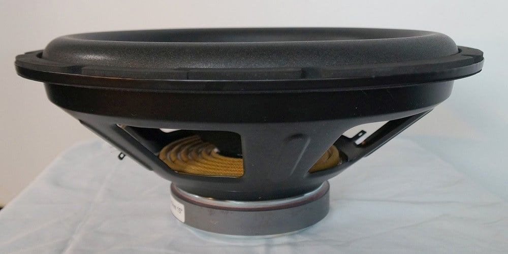

Dayton Audio specs this as a 15” subwoofer, and the driver really does
measure 15” from the edge of the frame. Most subwoofer manufacturers spec their
driver diameters like this, although some are a bit more conservative and spec
their driver diameters at the mid-section of the surround. The cone looks to be
made from treated paper and has an inverted polypropylene dustcap in the
center. It attaches to the frame via a large 1 1/2” surround and a 6 ½”
diameter Nomex spider. These suspension components are attached to a stamped
steel frame. The motor is not monstrous and uses a 13/16” thick slug that is 5
¾” in diameter. That doesn’t really tell us how much flux it sends through the
gap, which is what matters the most. Since this is not a super high-excursion
driver (indeed, Dayton Audio specs it at Xmax at 7.5mm), I would imagine that the
magnetic strength is sufficient. The backplate is slightly bumped out, and
venting is done through the pole piece.

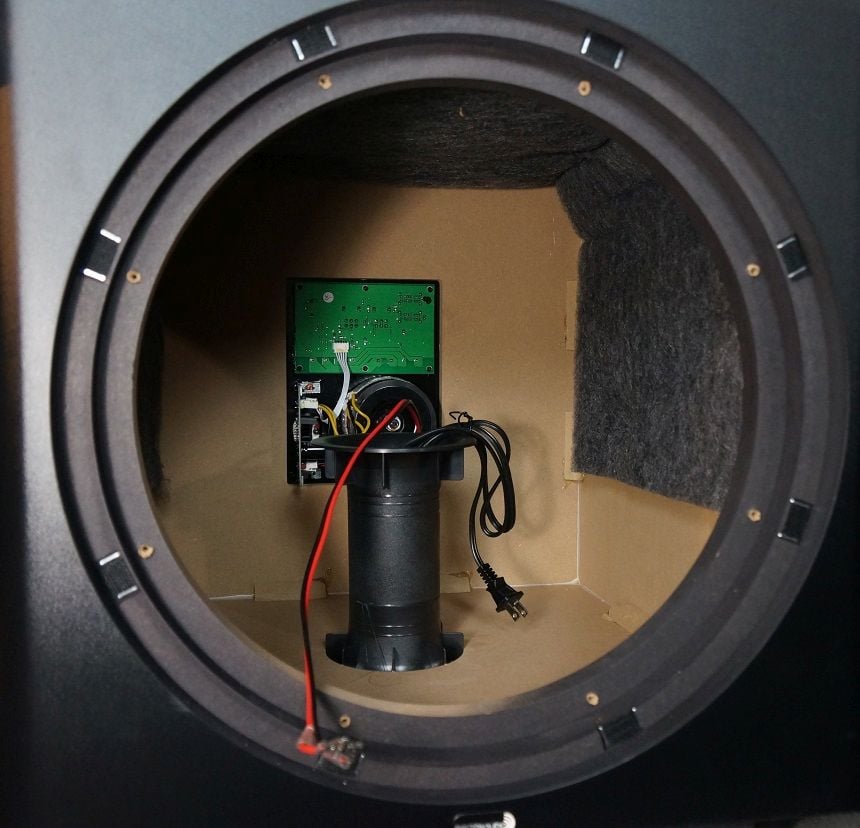

It is powered by a 150-watt RMS amplifier. While that might not seem like a lot compared to some of the multi-kilowatt sub amps we have seen around here, the driver’s sensitivity is rated at 91.9dB, so that should be plenty of power to make it thump. The controls are simple: there is a 0-180 degree phase switch, an auto-on/off power switch, a gain knob, and a 40Hz-140Hz crossover knob. Connectivity is comprised of a pair of RCA inputs and a pair of speaker-level inputs as well as a pair of speaker-level outputs. I am not sure how many people still use speaker-level connectivity on subwoofers, and I feel like Dayton Audio could have jettisoned that feature to save on manufacturing costs without any loss of sales.

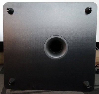

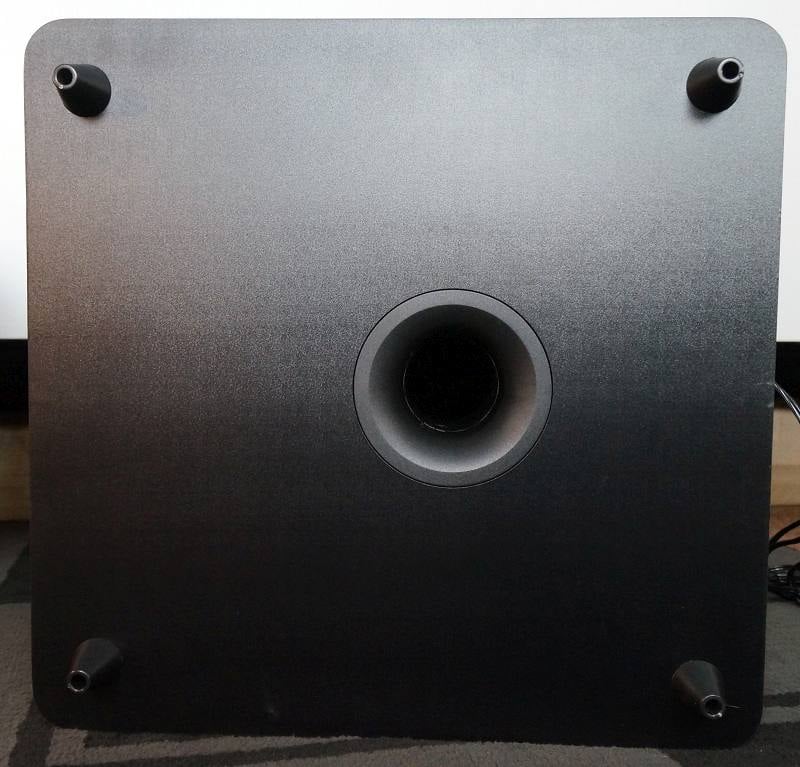

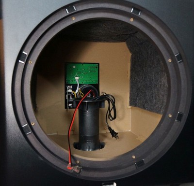

The SUB-1500 uses an MDF enclosure with a bottom-mounted port. The port has a 7 1/4” length and 3” diameter and is flared on both ends. The feet are some tall plastic cones that would certainly give the port enough clearance to move air. The front baffle is 1 ½” thick with additional thickness for the driver mounting, and the side panels are ¾” thick. Bracing is just two corner braces at each internal edge. There is some acoustic stuffing lining the side walls but not a lot.
There is opportunity here for some significant improvement for owners who are willing to modify their sub and void the warranty. It would be easy and cheap to add some cross-bracing and a lot more acoustic stuffing. The cabinet can be made a lot stronger by just adding a few rods at the midsections of the panels. And adding masses of acoustic stuffing can have the effect of making the enclosure act larger through isothermal absorption. This is when the fibrous materials of the acoustic stuffing act like a heatsink and absorb the acoustic energy thereby increasing the compressibility of the air inside the enclosure. The stock form of the subwoofer is probably adequate, and I am not sure how much these structural improvements would bring, but they would not take much time, effort, or money to do.

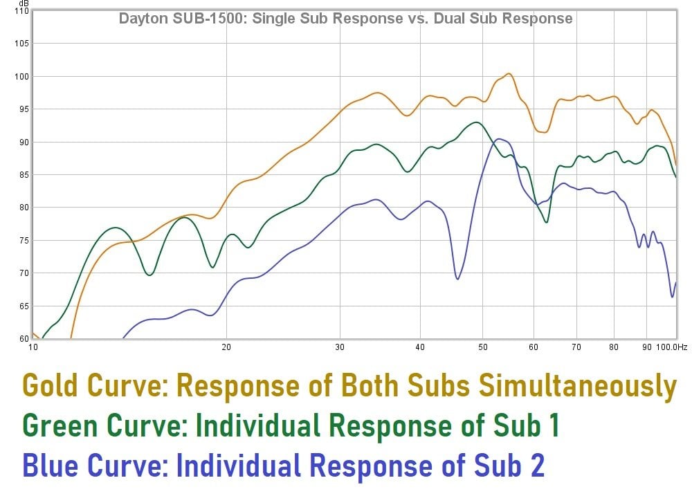

So why get two subwoofers rather than just one? The main answer to that question has to do with how room acoustics affect low-frequency sound waves. Audioholics has many articles that deal with this issue such as Early Reflections and Bass for Small Room Acoustics, Listening Room Acoustics: Room Modes and Standing Bass, and History of Multi-Sub and Sound Field Management for Small Room Acoustics. For those not inclined to pour over these somewhat technical articles, the short version is that the wavelengths of low-frequency soundwaves are much larger than normal domestic room dimensions, and to complete the wave cycle, the sound waves double back into the room. When the sound waves overlap on themselves, they can cause large peaks and cancellations in the room response, so some bass frequencies will be very loud and others will be very weak. A good way to hear this for yourself is to walk around your room while playing a pink noise tone on your subwoofer and notice the changing tonality from different areas of the room. One of the best tools we have to fight this effect, at least for subwoofer-band frequencies, is the use of a multiple subwoofer system to even out these peaks and dips in the response by averaging out the room modes per sound source. Let’s take a quick look at how that can work by using the two SUB-1500s in my own room:
The above graph shows the individual responses of the SUB-1500s in my room (the green and blue curves) and then the response of both subs measured simultaneously (the gold curve). The individual responses are what happens when I place the subs in the front left and right corners of my room. As we can see, the individual responses are rather erratic with the green curve generating a peak at 49Hz and a null at 62Hz and the blue curve creating a massive null at 46Hz followed by a massive peak at 53Hz. On their own, these peaks and dips can be audible. The peaks can be tamed with equalization, but the nulls cannot, but we can address the nulls with a multiple subwoofer solution.
The
gold curve shows how both subs can average out the response for a relatively
flat curve before any equalization. It still shows a peak at 54Hz followed by a
dip at 62Hz, but these are now relatively minor deviations from the baseline
response with about 3dB magnitudes. Equalization can flatten that response out
even further, and since there are two subs in play, the equalization will be
more consistent and predictable. Multiple subwoofer systems also make the
response more consistent across seating positions over the room, and since
equalization doesn’t need to change as much, its effects will also be more consistent
across different listening positions over the room as well. This isn’t just a
few abstract plots on a graph; this constitutes an audible improvement as well.
This is why we at Audioholics always advise a multi-sub setup wherever
possible.

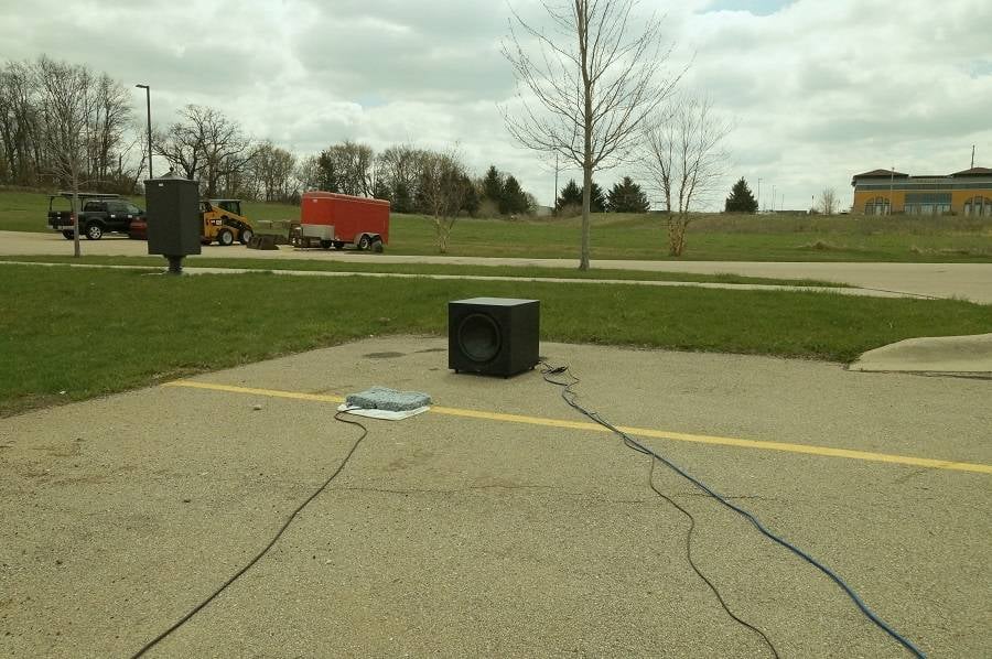

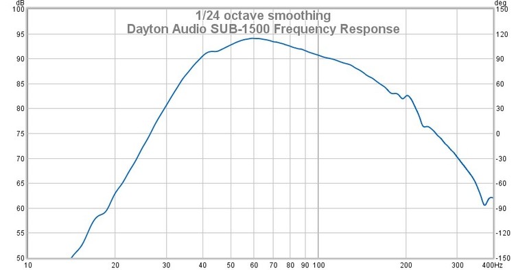

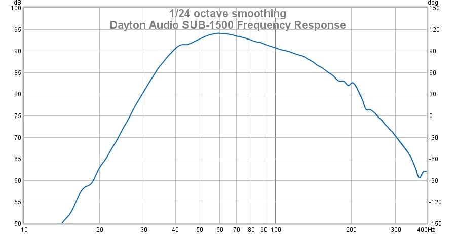

Testing on the Dayton Audio SUB-1500 was conducted with the microphone facing the woofer at a 1-meter distance with measurements scaled back to a 2-meter distance by subtracting 6dB. The temperature was recorded at 55F degrees with 55% humidity. The subwoofer’s gain was set to maximum, phase was set to zero, and the low pass filters were set to the maximum frequency of 140Hz.

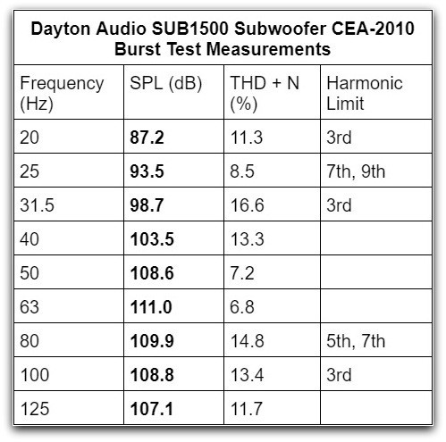

The above graph shows the measured frequency response for the SUB-1500 subwoofer. Right away, we can see that this sub isn’t really geared for deep bass below the mid-30Hz range. In-room, users can expect a usable response down to 30Hz. My room gets relatively little low-frequency gain, and I still managed a decent response down to 30Hz. The flattest bandwidth occurs from about 40Hz to just over 100Hz, but I think users would be able to get usable output all the way up to 160Hz if they wanted to use such a high crossover frequency. As has been said before, the range of this sub will suffice for almost all acoustic music and most non-acoustic music. It will capture most of the bass in modern movie soundtracks as well, but not all of it. However, given the cost of the SUB-1500, I don’t know any similarly priced subwoofer that could dig any lower. If you want deeper bass, you will have to up your budget significantly.
The above CEA-2010 measurements are short-term bursts that show the subwoofer’s clean peak SPL before heavy distortion sets in. Our measurements have been referenced to 2-meter RMS, which is 9dB down from the standard requirement for the measurements to be shown at 1-meter peak. However most publicly available CEA-2010 measurements are shown at 2-meter RMS, so we followed that convention.
While I don’t have much to compare the SUB-1500 with at its low price point, I think it puts out some respectable numbers here. Compared to the subwoofers that we reviewed at around the $500 price point, it gets outpaced at 40Hz and below but starts to close the gap at 50Hz. At 63Hz and above, it largely matches the performance of those $500 subwoofers.
One interesting aspect to note is the recorded distortion; at 40Hz and above, it is mostly limited by the amp instead of distortion. While it hit the distortion thresholds at 80Hz and 100Hz, it wasn’t able to go much past that point. It could be pushed to produce distortion, but it wasn’t nearly as bad as I was expecting from a $260 subwoofer. In fact, the bass it did produce was surprisingly clean, and it was pretty reluctant to make flagrantly bad noises. To be sure, it wasn’t as well-controlled as subs that we have reviewed that were multiple thousands of dollars, but it was far better than I would have anticipated given the build and pricing.
This measurement set earns the SUB-1500 our Bassaholics ‘Small’ Room Rating, and it is held back by its performance at 25Hz. By our protocol, that technically means it should only be sufficient for up to a 1,500 cubic foot area. However, I would note that I do feel it could handle a larger area if you aren’t all that concerned about bass under 30Hz. For bass at 40Hz and above, it is much more capable and could handle a larger room. For more information on how our room ratings are determined, read our article: ‘Bassaholic Room Size Rating Protocol.’

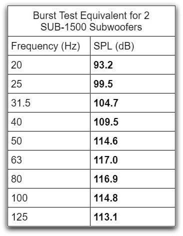

We are reviewing the SUB-1500 as a dual subwoofer set, so what happens with two of them? The process to determine that is easy; we just double the output by adding 6dB. And when we do that, we get the below table:
Those are some pretty big numbers for a
$520 subwoofer system, and it explains why it was so potent in the electronic
music that I cranked hard on it. Comparing these numbers to the $500 subs that
we reviewed, it has now mostly caught up with them down to 25Hz, and at 50Hz
and above, it makes major gains against them. At 63Hz and above, it largely
doubles their output. A dual SUB-1500 subwoofer system hits very hard in
mid-bass and matches the mid-bass output we have seen from far more expensive
subwoofers. It’s also worth mentioning how efficiently they are generating this
level of sound. All of this output is coming from two 150-watt amplifiers. Many
other subs that can hit these levels need a lot more power than what is being
supplied by these amps to accomplish this.
A dual SUB-1500 system would merit a Bassaholics ‘Medium’ Room Rating, but again, it is held back by the 25Hz criteria of or protocol, and if you are looking at 30Hz and above, it could handle a significantly larger room. However, we should add one important caveat to the above numbers: a full 6dB gain going from a single to dual subs can only be had if you place them very close to each other, but this is not what we normally recommend for a multiple subwoofer system. Doing so can not address the dips and nulls caused by room acoustics, and it negates this major advantage of a multi-sub system. It maximizes output at the expense of sound quality. We recommend spacing the subs apart in a manner that best addresses low-frequency nulls formed by the room’s acoustics. In such a configuration, with the subs properly set up, you should still see a net +3-4dB increase in output from dual Sub-1500s compared to just having one in your system.

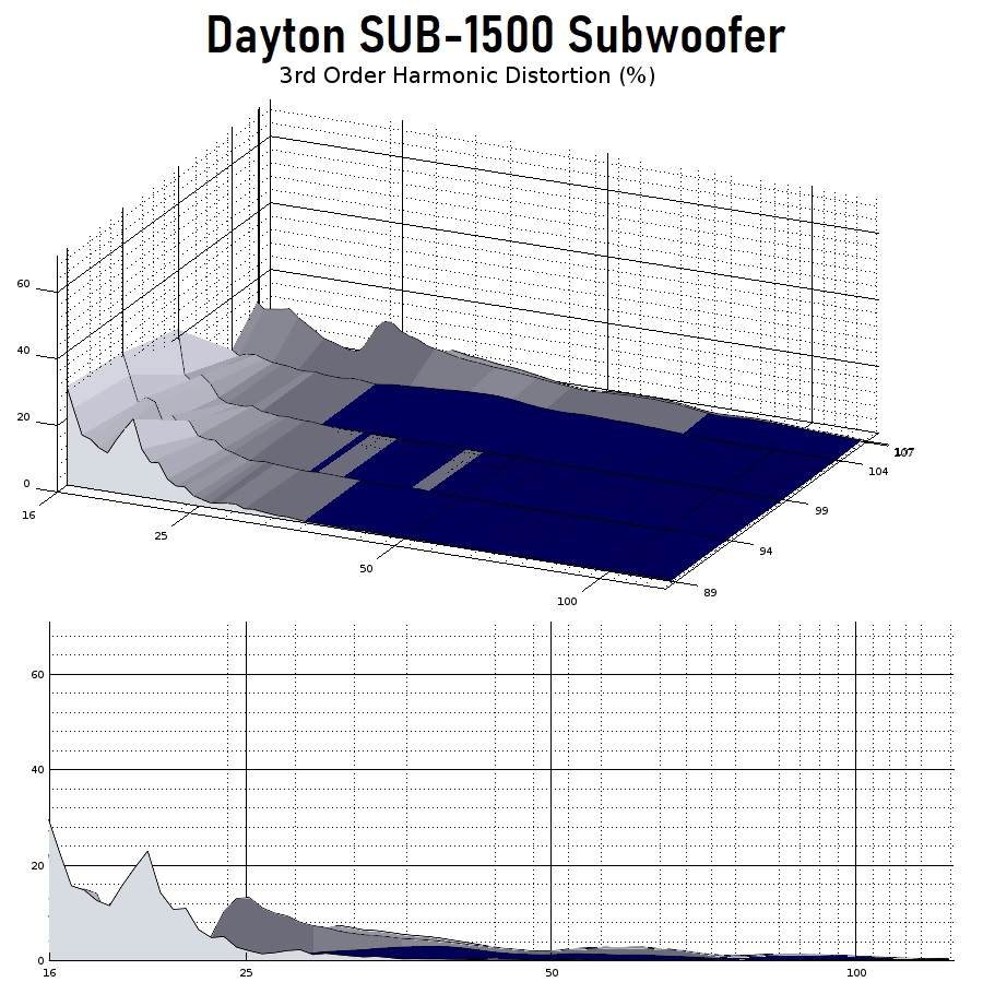

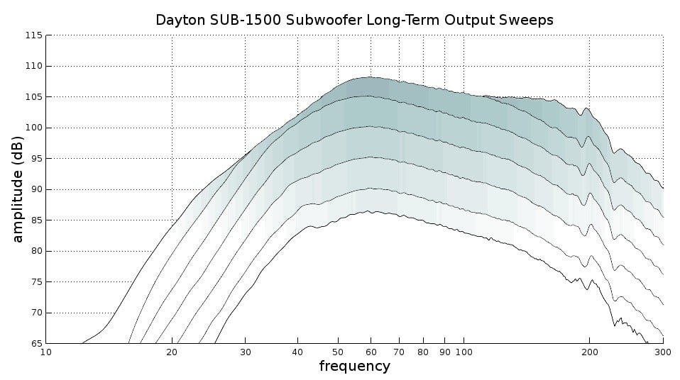

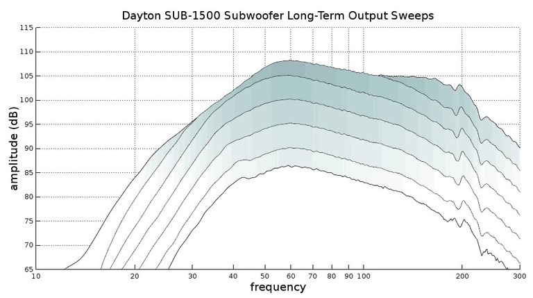

Testing for long-term output compression was done by first conducting a 20-second sweep tone where 50Hz hit 90 dB with the subwoofer 1 meter from the microphone (graph has been scaled to 2 meters for easy comparison with our other review measurements). We then conduct further 20-second sweeps by raising the gain by 5dB until no more output could be wrung out of the subwoofer. These tests show us the long-term continuous headroom that the subwoofer is capable of. The SUB-1500’s story for this graph parallels our burst test measurements: lots of mid-bass and progressively loses steam below 50Hz. Relative to our $500 subs, it matches their 50Hz output but gets surpassed below that range. If one were to add 6dB, we would have the total output of two SUB-1500s in which case it would match the deep bass output of the $500 subwoofer category and blow way past any of them in mid-bass.

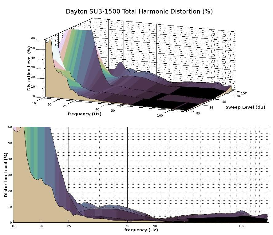

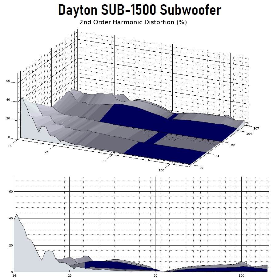

The above graphs show the corresponding total harmonic distortion to the long-term output graphs. Essentially, they depict how linear the subwoofer remains for the corresponding drive level seen in the long-term sweeps. The quantity being measured is how much of the subwoofer’s output is distortion and is shown here as a percentage. The SUB-1500 does surprisingly well considering its cost and construction. At nominal levels, it stays well below 10% THD down to 25Hz, and from 40Hz and above, it hovers around 1% THD. This is pretty fabulous performance for something that only costs $260/ea. Push it harder and distortion does creep up, but even then, it is reluctant to surpass 10% THD above 40Hz, even at maximum drive levels. It isn’t comfortable below 25Hz at any drive level, but the good news is that it doesn’t produce much output at all, so there isn’t much audible distortion to be had if you send it a high-level signal for deep bass. If you try to reproduce deep bass below 30Hz on this sub, it won’t complain very much but it won’t try very hard either, but if you throttle this sub at 40Hz and above, not only will it give it some real muscle, it doesn’t lose much self-control in doing so.
The above graphs depict measurements of the constituent harmonics from the long-term output sweeps and are what the total harmonic distortion measurements are composed of for the 2nd and 3rd harmonics. These individual harmonics can give us a clue as to what might be the cause of some quirk or non-linearity. We are only showing the 2nd and 3rd here because they more or less reflect the higher even-order and odd-order behaviors, although higher-order harmonics tend to be much further down as a percentage of distortion compared to the second and third.
Odd-order distortion for the SUB-1500 doesn’t really crop up until the final 5dB or so of its performance envelope (the rise in distortion below 25Hz at lower drive levels is likely environmental noise in both of these and not actually an artifact of the sub itself). Even-order harmonics rise at a steadier level with an increase in amplitude and are more consistent across the frequency spectrum, and I would guess that is from some induction. It is not a lot, even at the highest drive levels, and I wouldn’t guess it to be audible. Even-order harmonics tend to be more difficult to discern, especially in music, since it usually comes with a natural harmonic of whatever instrument is producing the fundamental and is therefore much more easily masked.

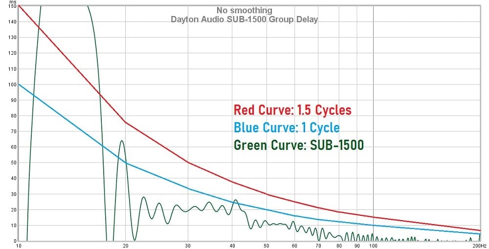

Group delay is the measurement of how much time it takes for individual frequency bands of an input signal to be produced by the speaker. It can indicate that some frequency components are developing slower than others or are taking longer to decay. It is generally thought that 1.5 sound cycles are needed for group delay to be audible at bass frequencies, although there is an argument that group delay should remain under 20ms to be completely unnoticeable, but that is likely meant for mid and upper bass frequencies.
The SUB-1500 does well enough in this measurement but not perfectly, although perfection shouldn’t be expected in this price range. At 50Hz and above, the group delay is excellent, but 40Hz does manage to exceed the 1-cycle threshold. At some points, I characterized the SUB-1500 to have a ‘tower speaker sound,’ and this may be partially responsible. Many tower speakers would share some of these traits since they have a similar tuning frequency. While they can have some output below their port tuning frequency, they lose definition, and I think the same is partially true for the SUB-1500. While it has some lower bass output, it doesn’t sound as sharp in that range as subs with lower tuning frequencies. I do think it is possible that this slight amount of lag around 40Hz gave it a really massive sound for electronic bass music. A lot of electronic bass music has bass lines and kick drums with fundamentals right in that area, and adding a touch of delay could have the effect of making them sound ‘big’ but without sounding sluggish. Whatever the cause, I really loved the sound that this subwoofer lent to that style of music. There is some sub-30Hz output, so there will still be some oomph for explosions and effects sounds, and thankfully effects sounds like rumbling don’t usually need pinpoint accuracy to sound fine. But as we have seen before, this sub is happiest at 40Hz and above.
