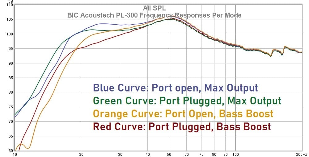

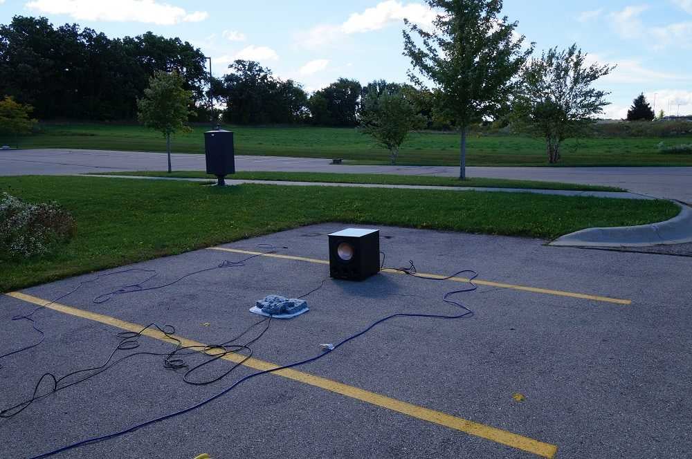

PL300 outdoor testing
Testing on the BIC Acoustech PL-300 was conducted with the microphone facing the woofer at a 1-meter distance with measurements scaled back to a 2-meter distance by subtracting 6dB. The temperature was recorded at 59F degrees with 70% humidity. The subwoofer’s gain was set to maximum, phase was set to zero, and the low pass filters were set to bypass.
PL300 responses
The above graph shows the measured frequency responses for the PL-300 subwoofer per its operating modes. While these responses are not the perfectly flat ones that we often see with DSP subs with a finely EQ’d response, there is still a lot to like here considering the price of this sub. Plugging the port maintains a strong response to below 20Hz, especially in the “Max Output” setting. In fact, the “Max Output” with a plugged port is probably the setting that makes the most sense for this sub and is the one I would recommend. The main advantage of this sub is its deep bass extension, and that is what I would try to exploit as much as possible. The PL-300 does have a somewhat peakish response centered at 50Hz, and that combined with a downward slope above that point indicates that the driver is running into induction effects. Induction occurs when the voice coil’s motion in the magnetic field creates a counter-current, but the problem is that the counter-current creates an opposing magnetic field that diminishes the initial, desired field. Many drivers use short-circuiting rings (often just called ‘shorting rings’) in the motor structure to address this, but that does add a significant cost increase to the driver, and given the cost of the PL-300, it probably doesn’t have a shorting ring. The addition of a shorting ring would have brought down the 50Hz peak and brought up the reduced mid-bass output above 60hz.
While the sub could have had a tidier response with a shorting ring, the reality is that typical room acoustics will mangle the response much more than induction effects, so it’s not a big deal in practice. Plus, many users will just use an auto-EQ system like Audyssey, which will fit the response to its target curve anyway, so the natural response of the sub is almost a moot point. That being said, those who don’t EQ their subs might be left with softer mid-bass with a traditional 80Hz or higher crossover frequency. As I mentioned in the ‘listening sessions’ part of this review, I initially thought I had a slight phase mismatch due to this response when I measured the room response. What is more, induction effects do reduce overall headroom by making the system less sensitive in mid-bass frequencies, so the PL-300 will run out of steam in mid-bass earlier than if shorting rings had been employed. This can be negated if the user has the option of using a lower crossover frequency like 60Hz as I did.

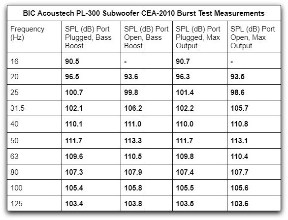

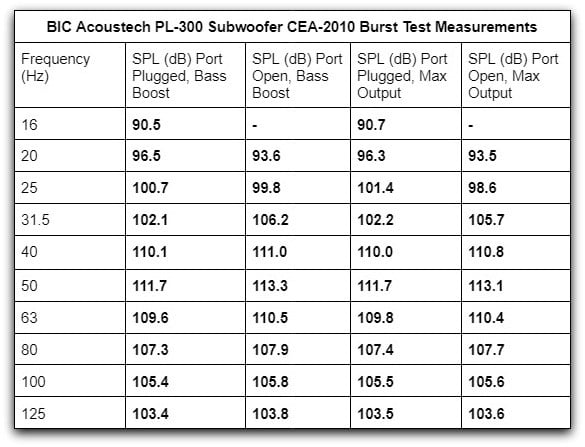

PL300 CEA2010 table
The above CEA-2010 measurements are short-term bursts that show the subwoofer’s clean peak SPL before heavy distortion sets in. Our measurements have been referenced to 2-meter RMS, which is 9dB down from the standard requirement for the measurements to be shown at 1-meter peak. However most publicly available CEA-2010 measurements are shown at 2-meter RMS, so we followed that convention. For $450, the PL-300 is putting out some pretty good numbers. Since this is the sub being pushed to its maximum limits, plugging the port is making a much larger difference than the ‘Bass Boost/Max Output’ switch. Plugging the port delivers more headroom at 25Hz and below, but leaving it open delivers more headroom at 31.5Hz and above. With the ports open, the PL-300 struggled at 20Hz and would not post a passing result at 16Hz. If this sub is being used for music, I would run it with the ports open, but for movies with very deep bass, plugging a port would be my choice. We can see that bass above 80Hz is really getting hammered by induction effects, so I would not use a crossover frequency above 80Hz. If the user has speakers with very capable mid-bass headroom then 60Hz might be even better so that the PL-300 is pouring power into ranges where it is most effective rather than dumping power into ranges where it is less efficient. Altogether, these numbers illustrate the trade-offs that are being made with the variable tuning system, and the user can decide where the sub’s strengths should lay.
Bassaholic MediumThese burst test numbers make the PL-300 a peculiar sub to assign our Audioholic’s Bassaholic Room Rating. With a port plugged and set to “Max Output” mode, this subwoofer clears our ‘Large’ room rating for deep bass at 25Hz but barely clears the bar for 31.5Hz to 63Hz for the ‘Medium’ room size. That nets this sub a ‘Medium’ room size rating indicating it should be sufficient for strong bass in a room of up to 3,000 cubic feet, although this particular sub will have more deep bass than most subs that achieve the ‘Medium’ room rating.

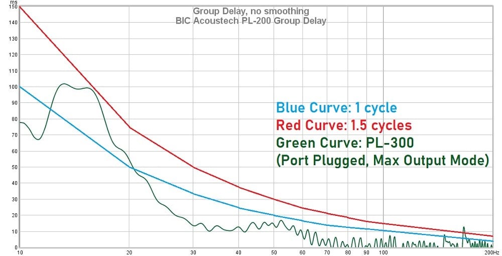

PL300 Group Delay resized
The time-domain performance exhibited much better than what I was expecting given that this is a low-cost subwoofer.
Group delay is the measurement of how much time it takes for individual frequency bands of an input signal to be produced by the speaker. It can indicate that some frequency components are developing slower than others or are taking longer to decay. It is generally thought that 1.5 sound cycles are needed for group delay to be audible at bass frequencies, although there is an argument that group delay should remain under 20ms to be completely unnoticeable, but that is likely meant for mid and upper bass frequencies.
The results shown here are very good. The PL-300 doesn’t even cross below lowest threshold of concern, 20ms, until well below 30Hz, and it doesn’t reach 1 cycle of delay until 20Hz, the lower edge of what is commonly considered humanly audible frequencies. The time-domain performance exhibited much better than what I was expecting given that this is a low-cost subwoofer that is more geared for home theater. I believe a reason for that is the simplicity of the system as a whole; there just aren’t a lot of filters interfering with the individual frequency timings of this sub. We do see a hump that centers around 50Hz, and I think that is at least partly due to inductions effects again. Past research has shown that induction can take a toll on transient performance, and here we see a rise in group delay where the inductance-related peak is. However, it is still so low that this is an academic matter and not one that is humanly audible, so it isn’t anything to be concerned about. Nonetheless, technical improvement in group delay is another argument for the addition of a shorting ring. Port tuning seems to be maybe 18Hz in this tested mode with a port plugged, and that is extremely deep for such a low-cost sub.

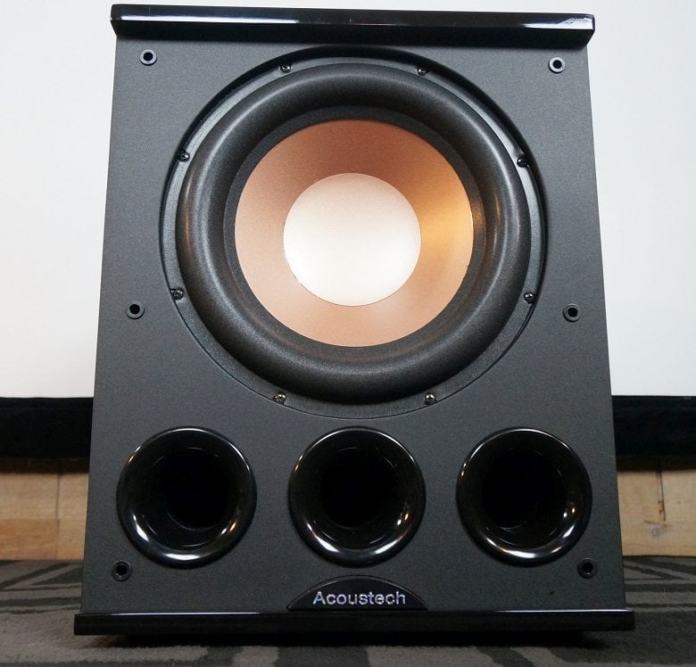

PL300 hero5
In addition to its extension, the PL-300 has good output for its size and cost. In burst testing, it was capable of 90dB at 16Hz, 100dB at 25Hz, and 110dB at 40Hz; those numbers are nothing to sneeze at, especially for the pricing. That would be sufficient for most people especially if they are not trying to fill a large room with bass. As I said before, I was running the sub with a pair of powerful $10k/pair tower speakers that were fed with 300 watts of amplification per channel, and at the levels I was listening to, the PL-300 managed to make a positive contribution to the system. While the speakers could probably have left the subwoofer in the dust at higher loudness levels, that didn’t happen in my own listening at medium-to-loud levels. The system as a whole sounded legitimately good, and the PL-300 played a part in that.

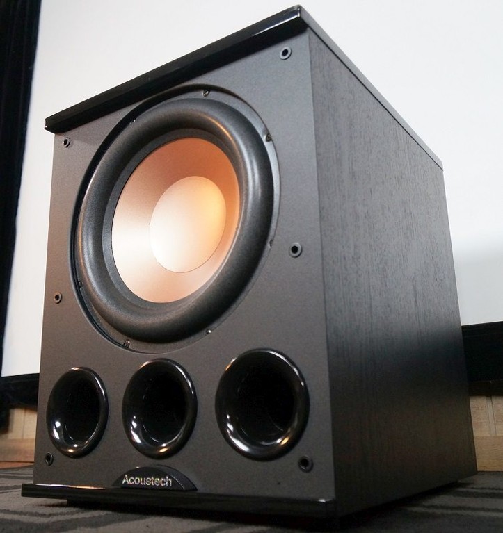

PL300 hero
In the end, I liked the PL-300. It isn’t perfect, but its particular strengths make it a strong choice for some very common situations. If you are trying to add some real low-frequency extension to a system that already has good mid-bass performance without spending a fortune, these are a great choice. The PL-300 has ok mid-bass so it can be used with smaller speakers, but its performance from 20Hz to 60Hz is where it shines. With sub-20Hz extension, it can make a sound system be legitimately full-range, and it does so for less than $500. That makes it a very useful tool for a lot of people.  The 5-year amplifier warranty is an unusual, but welcome feature that just sweetens the deal.
