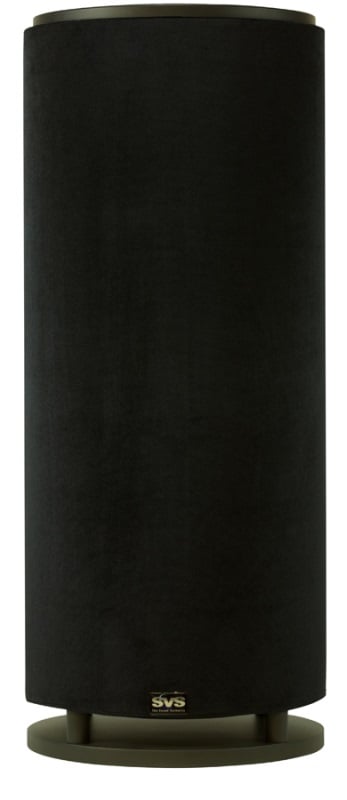

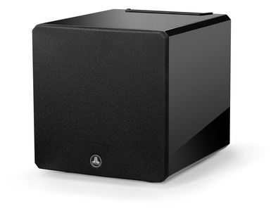

The JL Audio e110 (left) and SVS PC12-Plus (right) are made for tight spaces

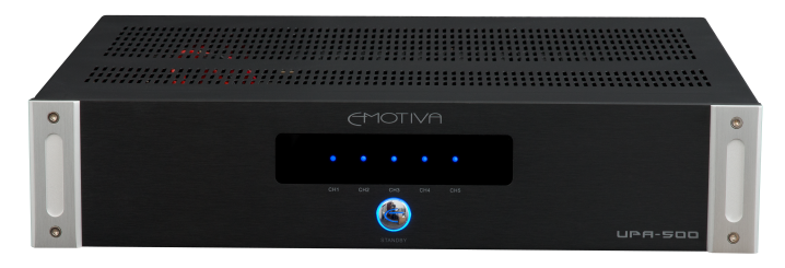

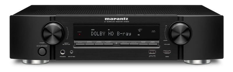

Buying compact speakers is an obvious way to save space, but not as many people realize that there are also compact receivers, Blu-ray player, amplifiers, etc. For example, the Marantz NR series receivers are just a little over 4” tall. The Emotive UPA-500 5 channel amplifier is also a hair over 4” tall, but it’s unlikely you would need an external amp to drive compact speakers. Keep in mind that we don’t recommend purchasing “combo” units that combine multiple pieces of equipment together, as these units tend to be unreliable.
  Emotiva UPA-500                                                    Marantz NR-1603
