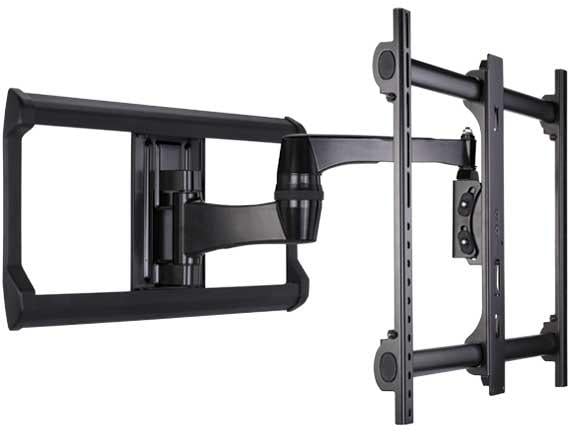

Full-Motion / Articulating
Full-motion
wall mounts give you the ability to pull your TV out from the wall and swivel it
any direction. They can also tilt up or down, and push back flat against the
wall when you want. Full-motion mounts are great for corner installations. They
also worked well for mounting a TV in old cabinets that were made for a deep
CRT television. The mount can attach to the back of the cabinet and the arm
will bring the TV flush to the front, making it look like the TV is floating. These mounts are typically more expensive and slightly
more difficult to install than tilting or low-profile options. Some dual arm full-motion
mounts can pull out from the wall up to 30” or more, while the less expensive single arm options typically come out about 10”. we recommend about a 20+” arm for
corner installations of large TVs. Keep in mind that you will need longer cords
with a full-motion mount. We recommend a minimum of 8’, but 12’ is optimal in
most situations. You will likely use up about 4’ of cable by routing it in such
a way that the mount can move without pinching cables. Another consideration is
that even when pushed flat against the wall the TV will not be as close to the
wall as with a tilting or low-profile mount.
Bottom Line: Great for corners, cabinets, recessed locations, and other situations where the TV needs to pull out and swivel. They are harder to install, more expensive, and require longer cords.

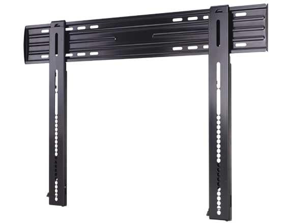

Low-Profile
A low-profile mount is used when you want the TV as close to the wall as possible. They do not tilt or swivel at all, but are typically the least expensive of any type of mount. Unfortunately, in some cases the TV is so close to the wall that you cannot get the cables to plug in. If the cable connections are on the back of the TV, facing the wall, you will need 90 degree adapters and will have to use spacers to bring the TV out from the wall. If the connections are on the side of the TV you are in better shape, but sometimes the cords can push the bottom of the TV out, making the TV tilt slightly upwards. Unless you need your TV as close to the wall as possible, we tend to recommend tilting wall mounts over low-profile designs. An alternative option would be to utilize a full-motion mount within a recessed cavity which will provide the cleanest look because the TV can be flush with the wall.
Bottom Line: Least expensive wall mount option. Easier to install than full-motion. Mounts TV closer to the wall than full-motion or tilting, on a flat wall. Cables might make the TV tilt up.

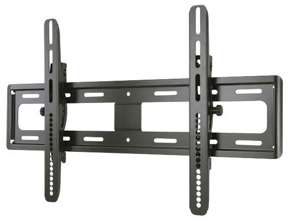

Tilting
A tilting wall mount is the right choice for most installations. It mounts very close to the wall; many tilting wall mounts are actually considered “low-profile tilting”. These mounts can typically handle more weight than a full-motion design and provide for easier installation. The TV does not actually move up or down on the wall, just tilts up or down and it cannot be pulled out from the wall. This is a great choice if the TV the being mounted above eye level.
Bottom Line: The best choice for most installations. Allows for the TV to tilt up or down. Less expensive than full-motion mounts, but more pricey than low-profile. Easier to install than full-motion.
