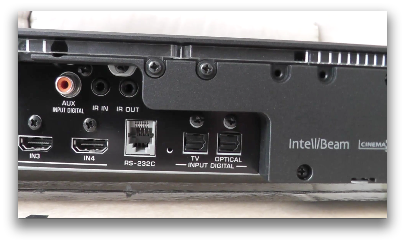

Soundbars typically control only the audio, though we will be looking at a high-end model today that does video switching as well. You will get the best performance by using an HDMI cable if your soundbar accepts one. Many will offer a digital connection labeled optical or co-ax; this is your next best solution after HDMI. The Red and White “RCA Analog” connections should only be used if you have no other option.
Let’s assume you have two typical sources, a Blu-ray player and a high-def cable/satellite box. For a more basic setup, like the Klipsch HDT-SB3, the most simple setup is to connect your Blu-ray and cable/sat box to your TV via its HDMI inputs. Then, run a single optical or digital co-ax cable from your TV to your soundbar. HDMI carries both Video and Audio, so your TV will take the video signal and display it, then send the audio signal through the digital cable to your soundbar. When you switch inputs on your TV, it will switch video and audio, making sure the picture being displayed and the sound sent to the soundbar always match.

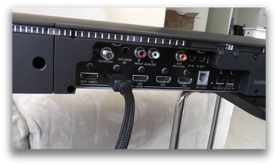

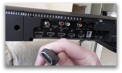

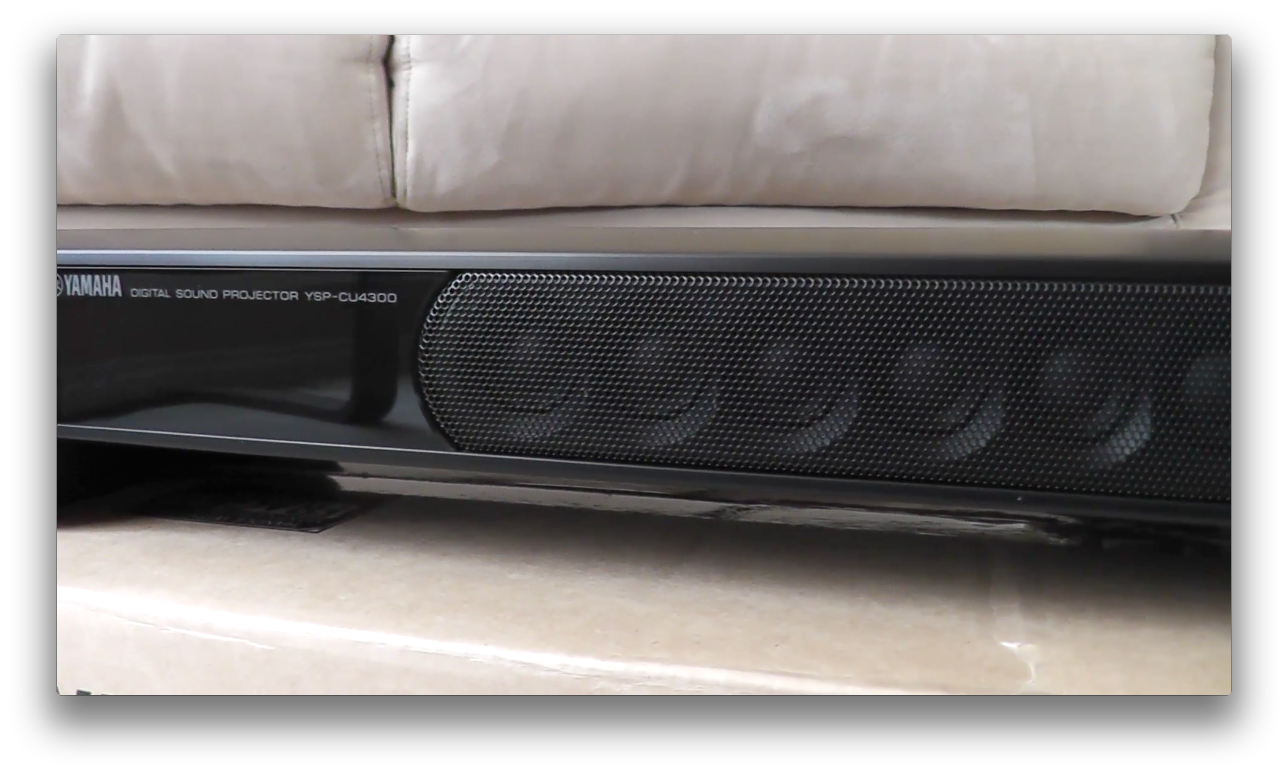

Let’s look at the connection for a more advance soundbar like the Yamaha YSP-4300. This soundbar has HDMI inputs and switches both audio and video, so you can connect your sources directly to the soundbar. Then, run an HDMI cable from the soundbar “Out” to the display’s HDMI “In”. With this setup, you’ll change audio and video inputs through the Soundbar only, not through the TV. The soundbar will play the selected audio and send the selected video to your TV.
Your soundbar should be mounted on the wall or a table, close to the bottom (or top) of your display, and centered underneath it. Now connect your AC and power on your soundbar. If a subwoofer is included, it can be placed in the most convenient or inconspicuous location, and power that on as well. A wireless subwoofer may also need to be “linked” with the soundbar, usually accomplished by pressing a button or setting a switch on both the soundbar and subwoofer, and letting them “find” each other. If you want to learn more about getting the best performance out of your subwoofer based on placement, check out the articles on Audioholics, and keep your eyes peeled for future videos.
