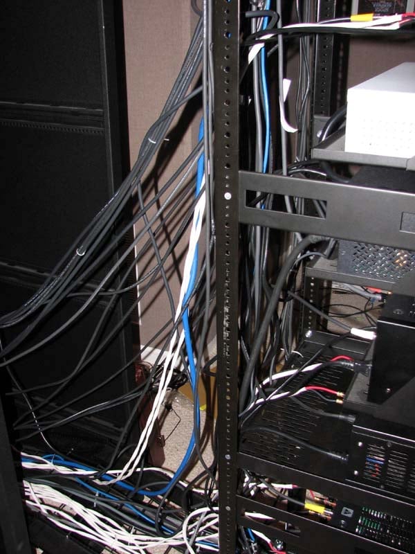

Cable Management
Step 2: Prewire your Room
- Plan out your speaker locations and how to route cables to them.
- Route your data and cable/satellite connections as closely to your HDTV and/or equipment rack as possible.
- Route RCA level cables to designated subwoofer areas or plan on going wireless.

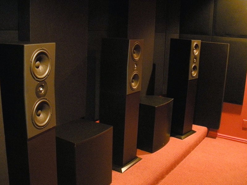

Example of optimal front LCR speaker placement
Step 4: Plan out the Speaker and Furniture Positions for Optimal Performance
- Follow our guidelines on Speaker Placements and 5.1 Speaker Set Up.
- Remember don't block line of sight from the speaker drivers to the listeners.
- Keep the couches or theater seats off a back or side wall of possible. Follow our 1/4L placement if you can.
- Subwoofer positioning is critical for good bass.

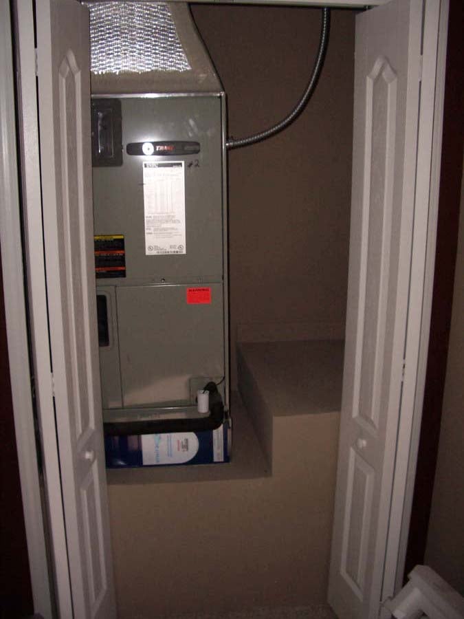

HVAC with think pocket door (left); HVAC with solid core door and acoustical insulation (right)

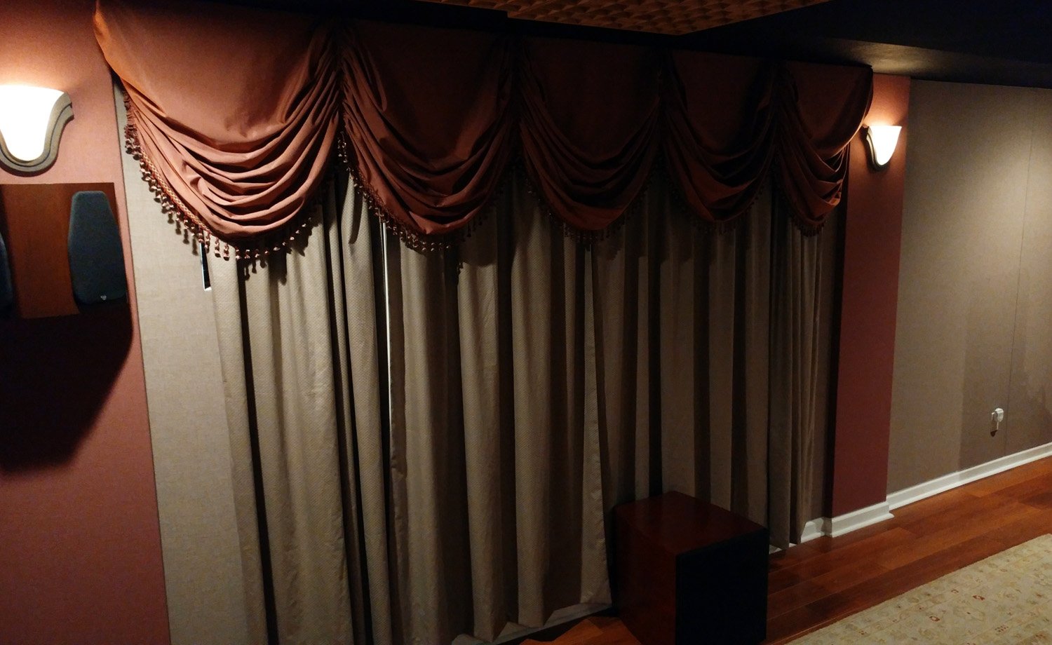

- Whether you're using a fixed pixel display or front projection, low light is the best environment to preserve picture dynamics.
- Have the option to kill natural room light sources with drapery, curtains, etc.

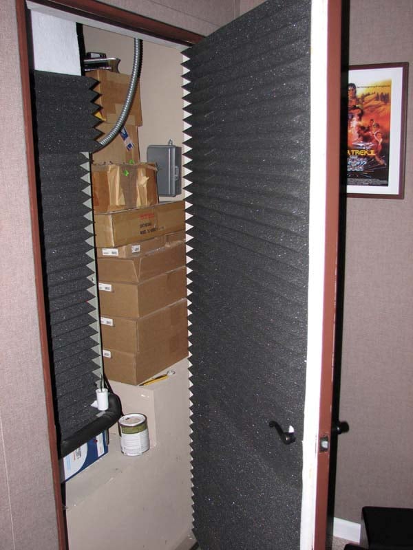

- Reduce HVAC and other external noise sources to preserve audio dynamic range.
- If air handler is in the same room as your theater, use heavy insulation to mask sound.
