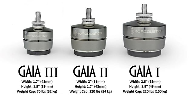

IsoAcoustics doesn’t make a one-product-fits-all solution. There are different GAIA isolators for different speaker weight classes. After discussing my setup with Sean, we determined that the GAIA I, rated for floor standing speakers 220 lbs or less would be an ideal fit for the Revel Ultima2 Salons while the GAIA Titan Theis, for floor standing speakers and subs weighing 320 lbs or less would be the right solution for the RBH SVTR Signature speakers.
Each GAIA model is designed by speaker weight. Find out the weight of your individual speaker and you can determine which GAIA is right for you. The online calculator makes product selection easy.
IsoAcoustics makes it easy to select the right product for your particular needs. Simply go to their online calculator and select your product category (speaker, subwoofer, turntable, etc.), enter in the manufacturer and model and voila! You’ll get your product’s dimensions, weight, recommended isolator, and the thread size you need.

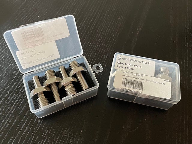

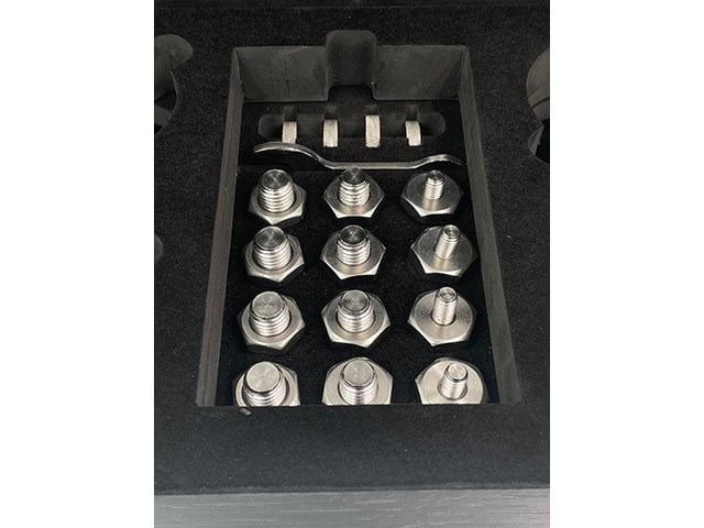

Here is a detailed view of the thread sizes included with my GAIA Titan review set.
The thread size is critically important. Each GAIA model comes with three stock thread sizes that may or may not fit your speaker. Neither my Ultima2 Salon nor the RBH SVTR took the standard GAIA thread sizes. The Salon2s for example, take a 1/2”-13 thread size and the RBH SVTR take a 3/8”-16. The GAIA I comes with M8-1.25, M12-1.25, ¼”-20 and the GAIA Titan Theis come with ½”-13, M8-1.25 and M14-2.0.
If your speakers do not fit the stock thread sizes, you can order the correct threads for your speaker. In this instance, IsoAcoustics sent me the proper threads for the RBH SVTR Signature Towers.
The threads came packaged in two sets.
The online product selector or your local IsoAcoustics dealer will be invaluable to help determine that all-important detail. Don’t assume that the stock threads will fit your speaker and don’t force a different thread size into your speaker. Should you need a different thread size, you can order it through an authorized dealer.

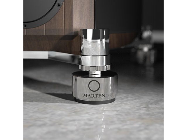

IsoAcoustics isolators have already gotten the attention of some well-known speaker brands through an OEM (Original Equipment Manufacturer) program, including Dynaudio and Spatial Audio Lab. In August 2021, Marten announced it will include IsoAcoustics isolators on the Coltrane 3 and Coltrane Tenor 2 models joining the Coltrane series, Mingus Orchestra, and the Parker series. In September 2021, PSB is slated to launch their new flagship line of speakers that include IsoAcoustics isolators. There are additional conversations with manufacturers about which IsoAcoustics could not publicly discuss details. Check out the full list of current IsoAcoustics OEM partners.
IsoAcoustics has a growing list of OEM partners who are including IsoAcoustics isolation solutions as part of their products.

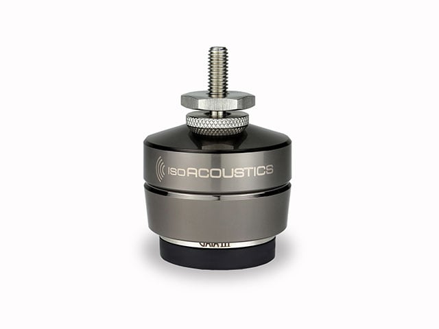

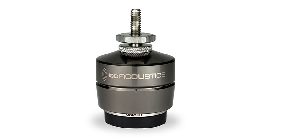

He told me that each isolation foot consists of three parts: A top isolator, bottom isolator, and connector. The way it works is a function of how the three parts work together and the characteristics of the materials comprising the isolation feet. The materials, he said, have four aspects: The durometer (hardness), the viscoelastic properties, material thickness, and shape. The top isolator connects to the GAIA housing, which in turn is connected to the bottom of the speaker. The bottom isolator is connected to the supporting surface.
I did ask for a deeper dive on the materials and composition and Sean was coy about divulging those secrets. The isolator is best described as a “resilient elastometer.” Fair enough.
The bottom of the isolation feet have a small concave shape that provides a suction cup connection to smoother surfaces. I noted this effect on both my Revel Ultima2 Salons and RBH SVTR Signature Speakers on both hardwood and composite surfaces. The suction cup effect isn’t so strong that you can’t move the speaker. At the same time, it provides just enough friction that it doesn’t become a furniture slider. It’s almost Goldilocks perfect.
Unlike other isolation products I’ve used (like Sorbothane) IsoAcoustics isolators are made of a resilient elastomer that do not leave a residue or marking on the floor. Indeed, even with speakers weighing over 205 lbs, there was no residue or marking left on the floor even after months of use. The materials also don’t change properties with humidity or temperature fluctuations.

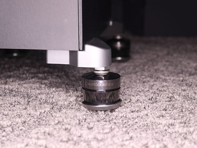

If you're wondering "what about carpet" then you'll be happy to know that IsoAcoustics also has carpet spikes that sit under the cup portion of the GAIA. The carpet spike cups are independent of the GAIA isolators so that you can remove them and use your GAIA on hardwood anytime. The carpet spikes will run you an extra $59.99.
IsoAcoustics GAIA have optional carpet spikes so that you can use them on carpeted surfaces.
Sean told me that while other foam or rubber isolators will isolate well over a narrow frequency range, their three-part design not only works across the full frequency range, but also that their solution is more effective. All the energy is managed by the isolators, which are tuned to work over specific weight ranges.
Detail view of the IsoAcoustics GAIA isolators with the carpet spike cup
I’ve used various isolation products before and the thing that probably surprised me the most was to learn that IsoAcoustics isolators are directional. Sean told me that the directional performance is important when used with speakers and subwoofers because the isolators are designed to be aligned with the speaker’s drivers. When the speaker’s drivers are pulsating back and forwards, the speaker’s energy is primarily directional. For this reason, the isolators themselves are directional.

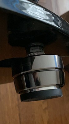

IsoAcoustics gives you a visual clue to installing the isolators them properly. The directionality of the isolators is aligned with the logo facing forward. You can also turn the isolators 180 degrees (facing backwards) if you don’t want to see the IsoAcoustics logo. Sean told me that when aligned properly, the isolators resist lateral movements and oscillations. This results in improved sound clarity and focus.

Detail of an IsoAcoustics GAIA III isolator.
The analogy Sean related was to imagine a pipe bolted to the wall that’s hit with a hammer. Vibrations travel down the pipe, hit the wall, and come back. IsoAcoustics claims that these reflections cause a loss of clarity and any artifacts that are replicated in both channels are perceived to be in the middle and cause the soundstage to collapse. If that’s indeed the case, then you should be able to measure the effects. Well, that’s exactly what the IsoAcoustics team did.

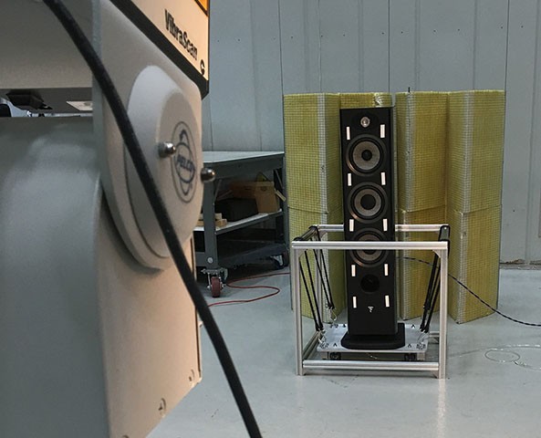

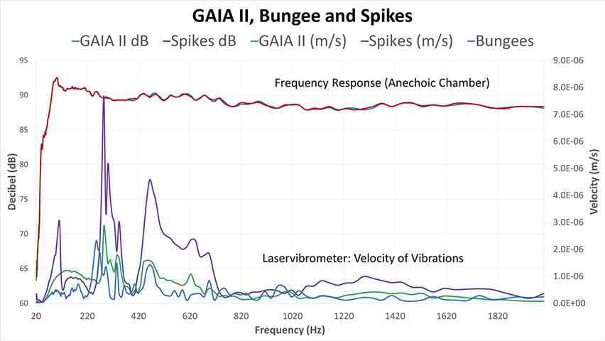

To demonstrate this point, IsoAcoustics set up a test environment at the National Research Council (NRC) of Canada. Dr. Floyd Toole’s, Dr. Sean Olive’s, and Todd Welti’s work at the NRC has laid a strong foundation for what much of what we now hold as fundamental truths in acoustics and psychoacoustics of loudspeakers and headphones. Perhaps we should rename the NRC the Sacred Temple of the Audio World.
IsoAcoustics tested speakers on GAIA isolators and then the test was repeated with the speakers raised onto spikes using solenoids. The test was repeated yet again with the speaker base suspended by bungee cords. According to the controlled environment, variation in height was kept to within ¼” (less than ½ a wave length at 20 khz) when changing between spikes, GAIA’s or bungee. This setup allowed for the testing of each setup while keeping other variables consistent.
You can see that the GAIA reduced the velocity of vibrations relative to spikes and more closely tracked the vibration isolation afforded by bungee cords.
The results showed that the vibration isolation the GAIA provided was similar to the isolation with bungee cords. The cabinet vibrations of the speakers isolated with GAIA and with bungee cords resulted in a reduction in cabinet vibrations through the introduction of an absorption layer that reduced secondary reflections.

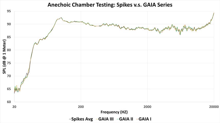

What’s important to note throughout is that using the GAIA isolators didn’t dampen the speaker’s bass output nor did it change the speaker’s frequency response. You won’t see any differences when measuring using an SPL meter for example. That’s actually a good thing. One of the knocks against isolation products is that they can make the bass muddy or suck it out. The data shows that this is not the case here.
The GAIA did not alter a speaker's frequency response. Here is a comparison of the measurements of the speaker with spikes and with the GAIA.
The broad takeaway from these experiments is that GAIA isolators address harmful vibrations and help mitigate boundary effects without impacting the speaker’s sound was measurable.

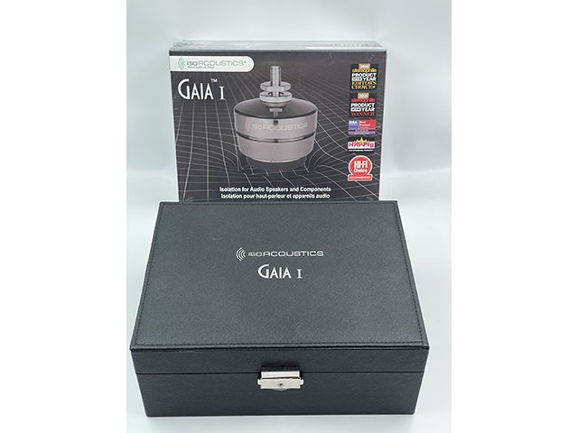

When the GAIA models arrived the first thing that struck me was the sheer weight of the boxes relative to their size. The GAIA I and GAIA Titan are meticulously packaged. The GAIA I come in a stamped, imitation leather box with soft, suede-like interior. Each GAIA isolator is individually protected in molded padding.
The GAIA I box and cardboard sleeve

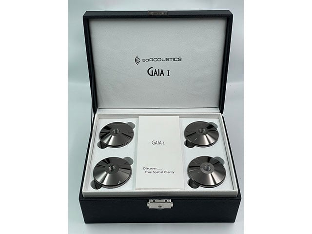

The boxes for the GAIA I and GAIA Titan were impeccable. Look at the gorgeous, high gloss piano black box that the GAIA Titan come in.
The GAIA Titan takes the whole packaging experience up to a different level. They come in a black, piano gloss wooden box. The GAIA Titan’s box is complementary eye candy for your high gloss, piano black speakers.

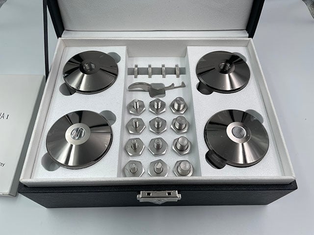

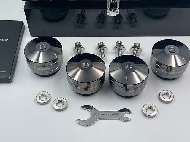

The GAIA I isolators with included threads and wrench above.
Detail of the IsoAcoustics GAIA Titan included isolators and accessories. Each isolator comes wrapped in a clear plastic to ensure you don't scratch them prior to installation. The photo above includes the plastic covering, which is the reason why you may see some bubbles on the finish in the photo above.

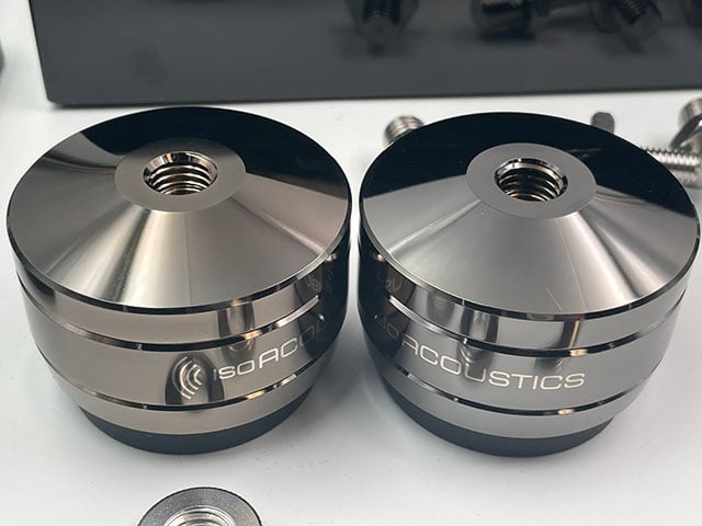

Note that the left GIAIA Titan isolator has a slightly different finish than the right GAIA Titan isolator.
Once installed, it was very difficult to see the difference as the brushed aluminum finish of the isolators picks up the color of the flooring.

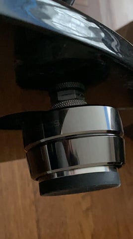

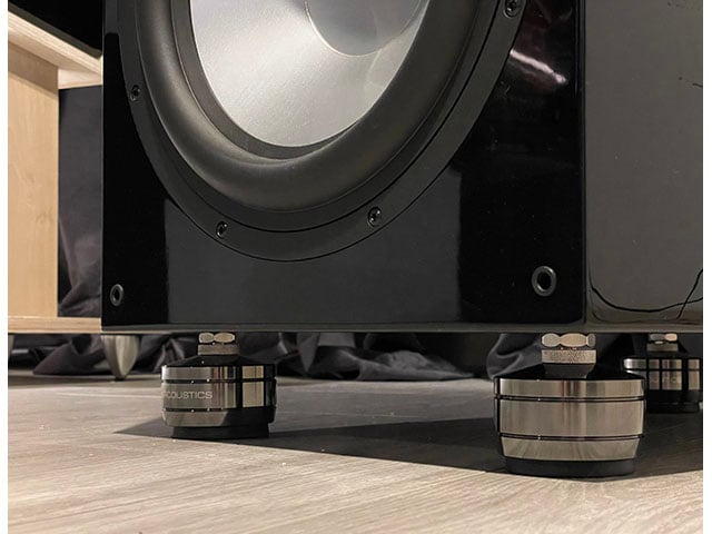

Detail of the bottom of the Revel Ultima2 Salon base with the GAIA I installed.

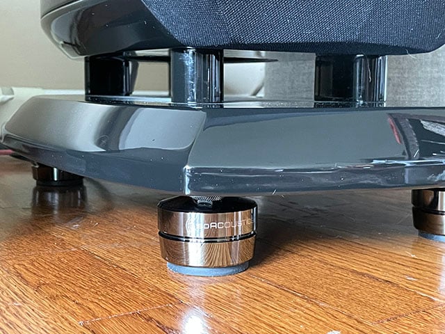

Detail view of the IsoAcoustics GAIA I installed on my Revel Ultima2 Salon

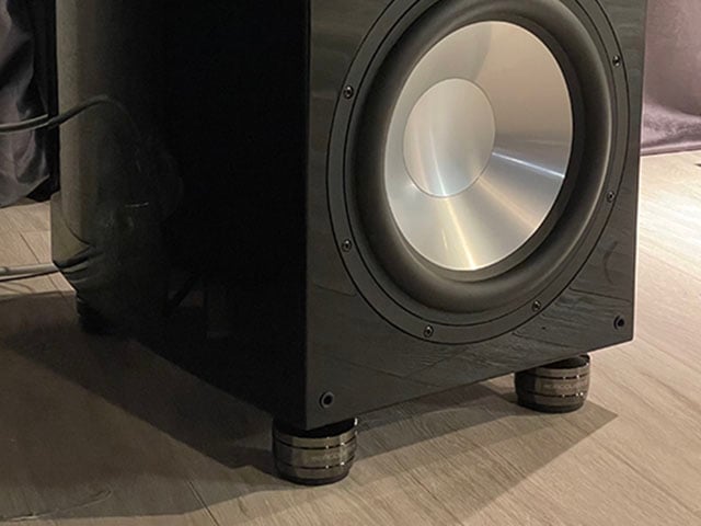

I installed the GAIA I on Revel Ultima2 Salons on a hardwood floor. Associated equipment with the Ultima2 Salons included an Anthem AVM 60 and Benchmark AHB2 power amplifiers configured in dual mono sourced with an Oppo UDP-205, Cambridge Audio CXNv2, Roon Nucleus server, and AppleTV 4K as sources. The setup was plugged into a Bryston BIT 20 Power Isolation Transformer on a dedicated 20-amp circuit. During my review period, I complemented the Salon2s with an SVS SB16-Ultra and SB13-Ultra subwoofers placed within two feet of the Salon2s—a perfect test of the decoupling prowess of the IsoAcoustics GAIA.
The second setup consisted of GAIA Titan Theis installed onto RBH SVTR Signature Speakers on a concrete floor with a vinyl flooring overlay. Electronics included a Denon X8500H AVR, an Oppo UDP-203, Roon Nucleus server, and AppleTV 4K. The subwoofer modules of the SVTR were configured as subwoofer LFE channels and driven by RBH SA-500DSP monoblock amplifiers. I did not use my Monoprice Monolith 7 amplifier during the review period as one of the amplifier channels is awaiting replacement.
The substrate under the RBH SVTR was a concrete floor with vinyl planks on top.

Goal number one, did they solve my hardwood floor conundrum? Well, after nearly a decade of fumbling through different solutions on hardwood, the GAIA isolators have indeed become my ultimate solution for speakers on hardwood. Here’s what I found:
- The GAIA provided a stable support for my Salon2.
- The suction cup design prevented any accidental repositioning of the speakers—even with an accidental nudge or a bit of force. I bumped up against the Salon2 and even put a bit of pressure with my hands against the side of the Revels. In both instances, the GAIA isolators kept the Salon2 firmly in their designated position.
- There was no marking, scratching or residual impact on my hardwood floor. Even after months of use, the GAIA kept my hardwood floor in perfect condition.
- Fine-tuning speaker placement or moving the speakers was a breeze. Tipping the Salon2 a bit until the suction released from the floor allowed me to put a towel or rag under the GAIA. From there on out, I could move the Salon2 to play with positioning or move them out of the way for another speaker review. I didn’t need to be concerned about damaging my hardwood floor or going through different prophylactic gyrations.
Goal number one? Check, the GAIA are an ideal solution for hardwood floor setups.
