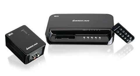

IOGEAR Powerline Build Quality and Remote

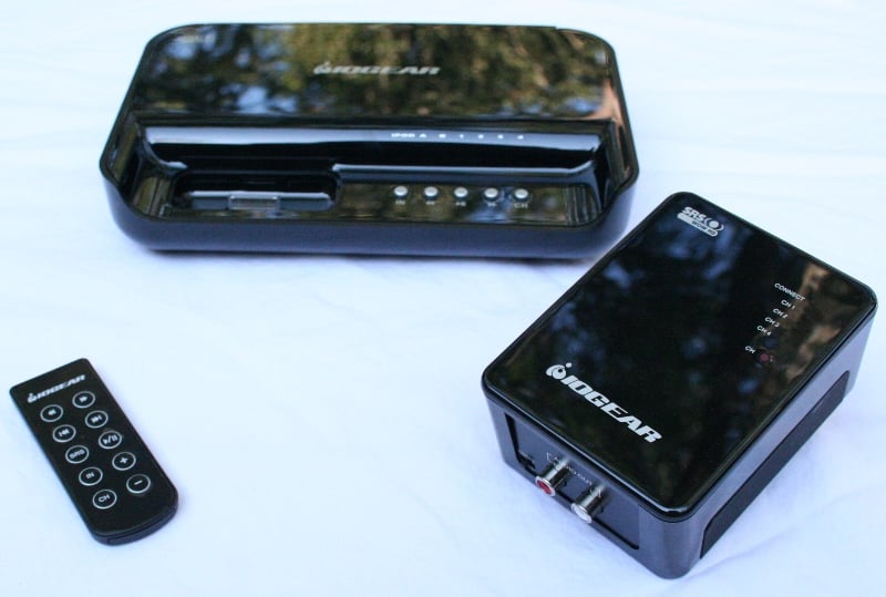

The
packaging of the IOGEAR Powerline Stereo Audio System is impeccable with a
single transmitter on top, a receiver underneath, and a hole full of wires,
cables, a remote, and a "wall-wart" receiver. The wires are all of
the throwaway kind red and white RCAs. The power cord is detachable (a good

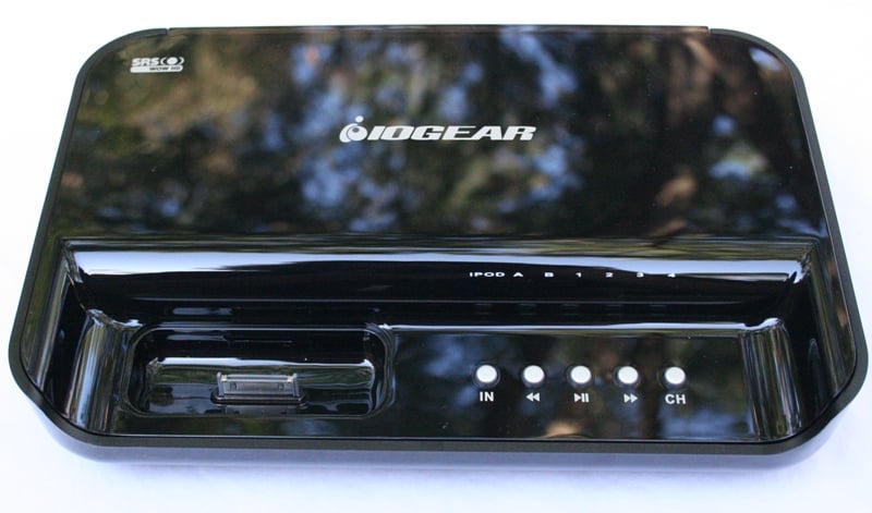

thing) and the remote is small and thin. The transmitter looks like an alarm
clock without a digital display and in its place an iPod dock. IOGEAR provides
adapters so that nearly every flavor of iPod and MP3 player will work. There
are control buttons on the front for the iPod and to select the input.

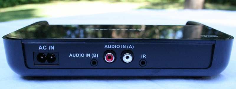

There are three ways to get
information into the transmitter - iPod direct, 3.5mm cable (from a computer or
headphone output), and red and white RCA. Each input is labeled. The
transmitter can send to up to four different receivers. The kit comes with only
one receiver but you can purchase more separately. This is a bit misleading
implying that you can stream to four zones. In actuality, you get four channels
so if you want to send the same audio to 15 different receivers at the same
time, you just have to set them to the same channel. If you want to have audio only
in a specific room (and not to the other receivers), you can use a specific
channel for that. At that point, you can't use the transmitter to send to any
other channel.

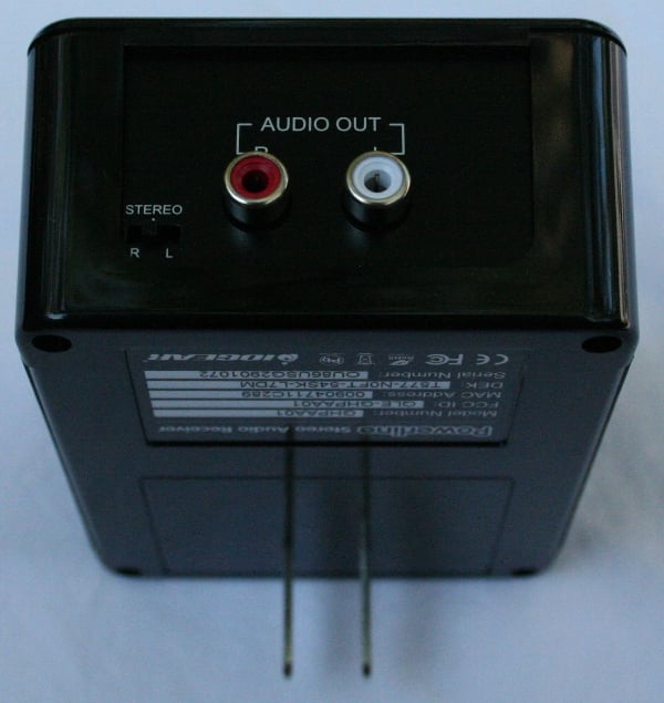

The
receivers are fairly large wall-warts that have red and white RCA outputs on the
bottom. Don't fear, if you need to connect up a 3.5mm equipped amp (like you'd
find in computer speakers), IOGEAR provides a cable for that. There is a
Left/Stereo/Right switch on the bottom as well. This will come in handy if you
are using the IOGEAR Powerline Stereo Audio System to pipe audio to the back of
your room in a 5/7.1 setup. The front sports a readout to tell you if it is
connected and to which input. All of the components sport a glossy black finish
that is both attractive and well executed. The wall-warts are large and
ungainly but they fit very snuggly in the wall which should help any of you
insisting on using heavier cables from pulling it from the wall.

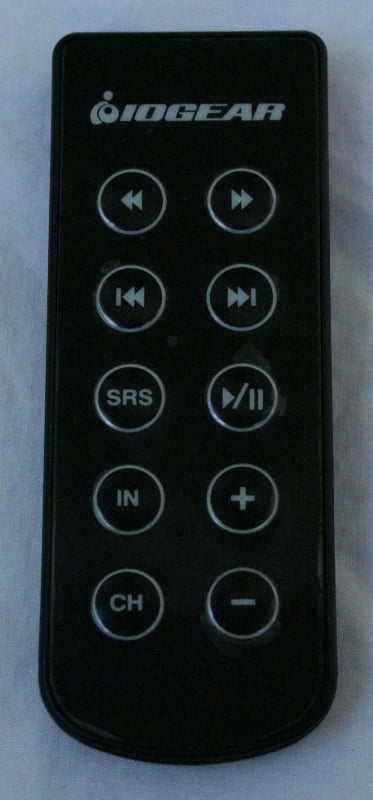

Remote
The remote is small, thin, and easily lost. It has all the required
buttons including controls for the iPod and volume and a "switching"
button for each channel (cycles through the channels). There is also a SRS
button to engage the SRS WOW HD. You'll DEFINITELY want to keep this remote
safe and out of the bottom of the couch. Considering that nearly every remote
these days has some universal properties, any room you'd need to control the
volume or iPod functions, these should be programmed into a one of the remotes
already in the room. The dedicated remote for the Powerline Stereo Audio System
should be tucked away safe as once it is lost, you'll probably need some sort
of specially trained dog to find it. Other than it's size, it has all the
requisite buttons and was responsive enough.

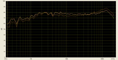

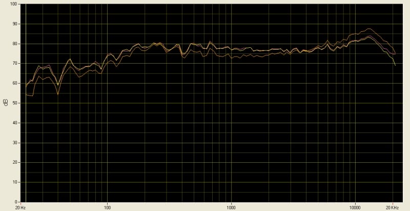

My first thought was that I'd measure the differences between a test signal sent direction to an amp and one sent over the IOGEAR Stereo Audio System. Using the Sencore SP395A FFT Audio Analyzer and a Seymour AV 500x1 Ice Amp, sent a pink test tone to a Salk SongTower QWT speaker. I level matched the each of the inputs and settings. I wasn't so worried about mic position so don't look at it to see the true measurement of the speaker response (if you want to see that, look at the review) but to see differences. I used Impact Acoustics cabling (where applicable).
What I hoped to see was two lines overlapping perfectly (I'd have been happen with nearly perfectly). That’s exactly what I got with the pink and yellow line. I'm assuming that the orange line the SRS WOW HD engaged and it shows deviation pretty much everywhere but especially in the upper and lower regions. The SRS WOW HD was (as far as I can tell) engaged out of the box. There is no LED on any of the devices to let you know it is on or off. This presents a serious problem as the differences between the on and off audio quality is quite startling (as you can see). Not the least of which is the SRS on (I think) decreases the overall volume by about 2-3dB (I had to bump up the volume from the SRS off position). If you are using the IOGEAR Powerline Stereo Audio System to send audio to the back of the room, this could make a pretty huge difference. From SRS Labs website:
To address this challenge, SRS has developed SRS WOW HD, an advanced version of its SRS WOW audio enhancement technology. It is the industry's most comprehensive solution from a single provider. SRS WOW HD adds new user-selectable high frequency contouring as well as definition enhancement to SRS Labs' WOW technology, further improving the perception of clarity and acoustic space.
Apparently, IOGEAR has taken the "user-selectable" out of it and selected it for you. Remember, SRS is only really designed to make radio and MP3s sound better and probably shouldn't be used with higher fidelity sources. What is important from the measurements was that the IOGEAR Powerline Stereo Audio System was able to pass the signal cleanly.

Comparing the IOGEAR to direct connection revealed absolutely no audible differences. Now, switching time wasn't instantaneous but it was as fast as I could make it. Given the measurements above, I really wouldn't expect to hear a difference. Next, I listened to a number of albums with the SRS engaged but really, it only took a few seconds to know that something was askew. The Oppo through the IOGEAR was grainy and distorted, especially through the midrange. It sounded like bad radio reception. The Oppo connected directly, however, sounded crisp and clear. The difference was night and day. Whatever the SRS was doing is obviously not making good music sound better. With Internet radio or a bunch of squashed MP3s, it might make a difference for the good but it will take experimentation on your part on whether or not you like it. Personally, even with Internet radio, I didn't. It made the soundstage a bit wider but overall the increased brightness and the grain in the midrange made the tradeoff too costly for me.
