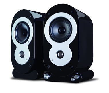

Swans S200A Multimedia Speakers
- Product Name: S200A
- Manufacturer: Swans
- Distributor: HiVi
- Performance Rating:
- Value Rating:
- Review Date: February 14, 2007 11:02
- MSRP: $ 679 (Internet-direct - $499)
Speakers:
System
series: HiVi Active Studio Monitor / High-End Multimedia
System type:
Active 4th-order 2-way vented-box system
Driver
configuration:
- woofer: Shielded 5.25” Polycone Midwoofer
- tweeter: 28mm Danish-Style Soft Dome Tweeter
Frequency
range: 47Hz-20kHz(-6dB)
Horizontal
dispersion: 15deg in 250Hz-8000Hz< ±4dB
Vertical
dispersion: 5deg in 250Hz-8000Hz< ±4dB
Harmonic
distortion: 100Hz-20kHz≤1%(2.83V/1m)
Amplifier system:
Frequency
range: 20Hz-20kHz(-3dB,-0.5dB)
Rated
power: 32W×2(5Ω,1kHz,THD<0.1%)
Signal-to-noise: >86dB
Distortion: THD<0.06%(8Ω,1kHz,10W)
Input
sensitivity: 700mV
Input
impedance: 22kΩ
Bass
adjust: ±3dB(100Hz)
Treble
adjust: ±3dB(10kHz)
Separation: >65dB
Finish: Piano Merlot/black mesh; Piano Black
available
Dimension: 195×246×363(mm)
Net
weight: 8.4Kg(main box)/
6.7Kg(subsidiary box)
- Aesthetics
- Excellent imaging
- Great bass
- Easy setup
- Fully shielded
- Large
- No headphone jack for defeating speakers (VOIP, etc)

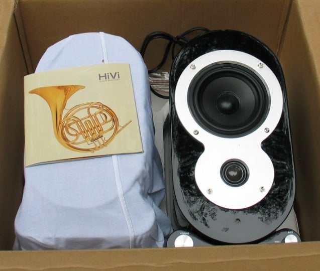

The Swans S200As came packaged fairly well, single-boxed
with styrofoam end caps and wrapped in a white cotton drawstring bag. The piano
black finish, while extremely well done, doesn’t exactly love the white cotton
so much. I ended up having to grab a black cloth and wiping off a bunch of
lint. A black bag would have been much preferred. The oval shape is designed to
reduce cabinet resonance.

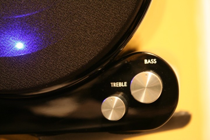

Along with volume, there is also a treble and bass control.
There are no markings on the dials save a small dimple indicating where the
potentiometers are set. The dials go from about 7
to 5 o’clock. The bass control was a little scratchy at the low end

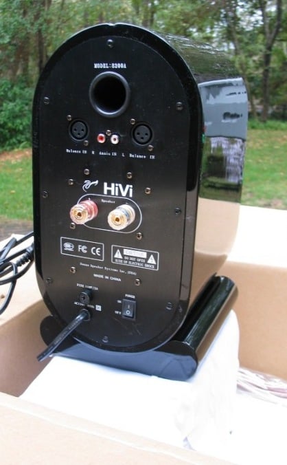

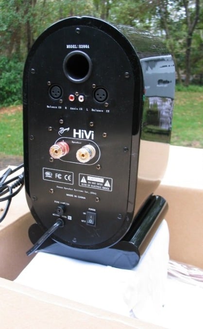

(meaning the dial felt as if it were dirty). The back of the amp has both RCA
and balanced inputs, a pair of speaker outputs for the other speaker, an on/off
switch, a permanently attached power cable (which seems at odds with balanced
inputs to me), and an inch and a half wide port. The amp casing is a very

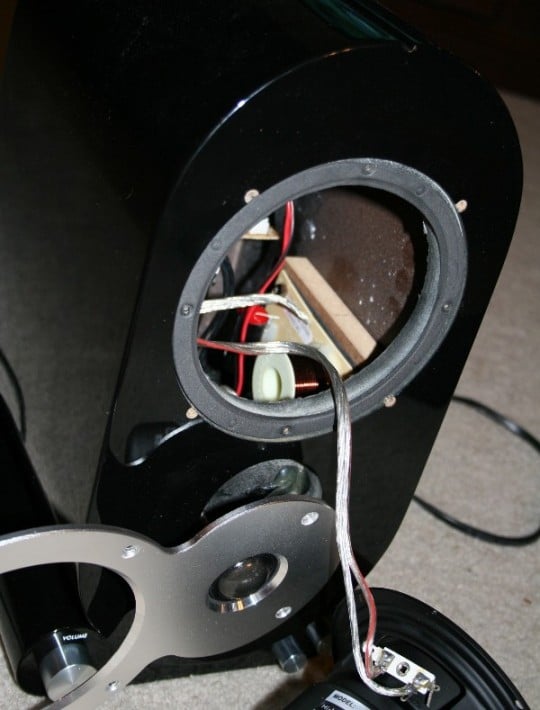

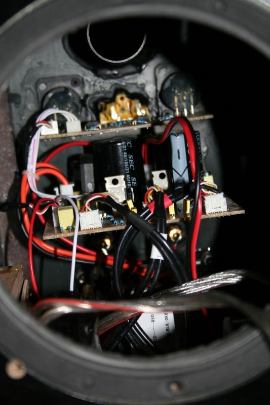

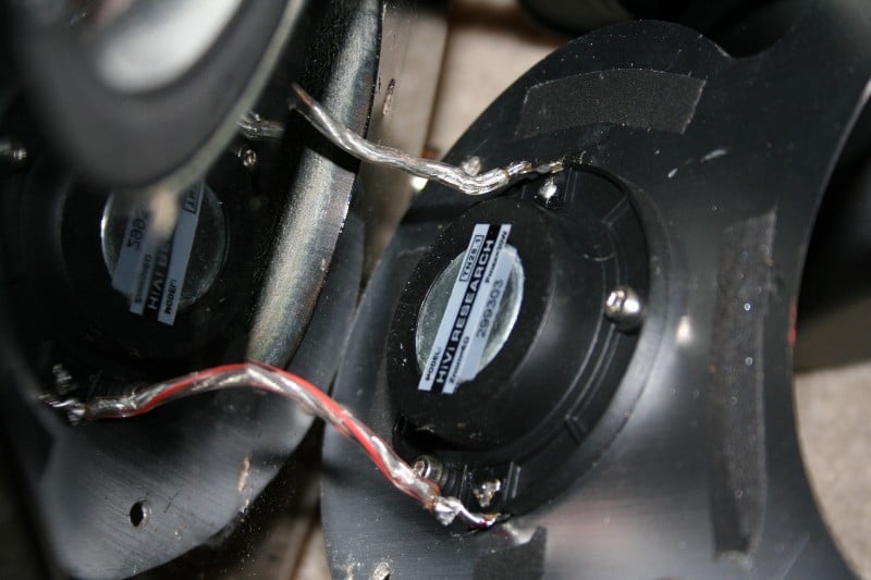

attractive black brushed aluminum. The enclosure is constructed out of 5/8” mdf
and there is no bracing. The electronics are attached to the back plate as well
as both the sidewalls on glued on wooden braces.

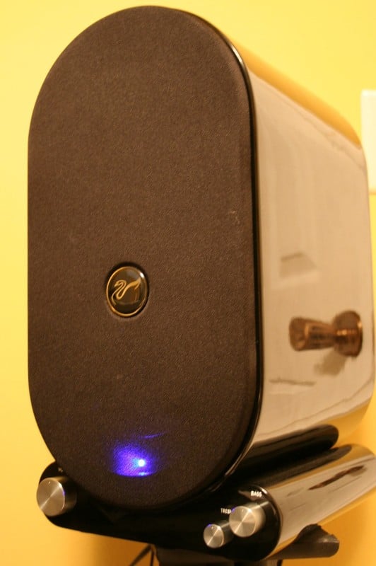

with every other multimedia speaker set I’ve ever used, the one with the volume
control is set up as the right channel. There is a little blue led that shines
through the speaker grill on the right channel when the speakers have power.
